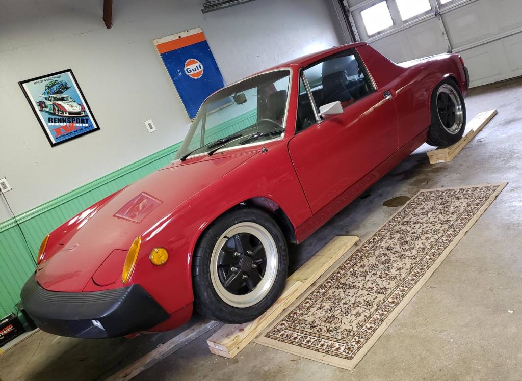

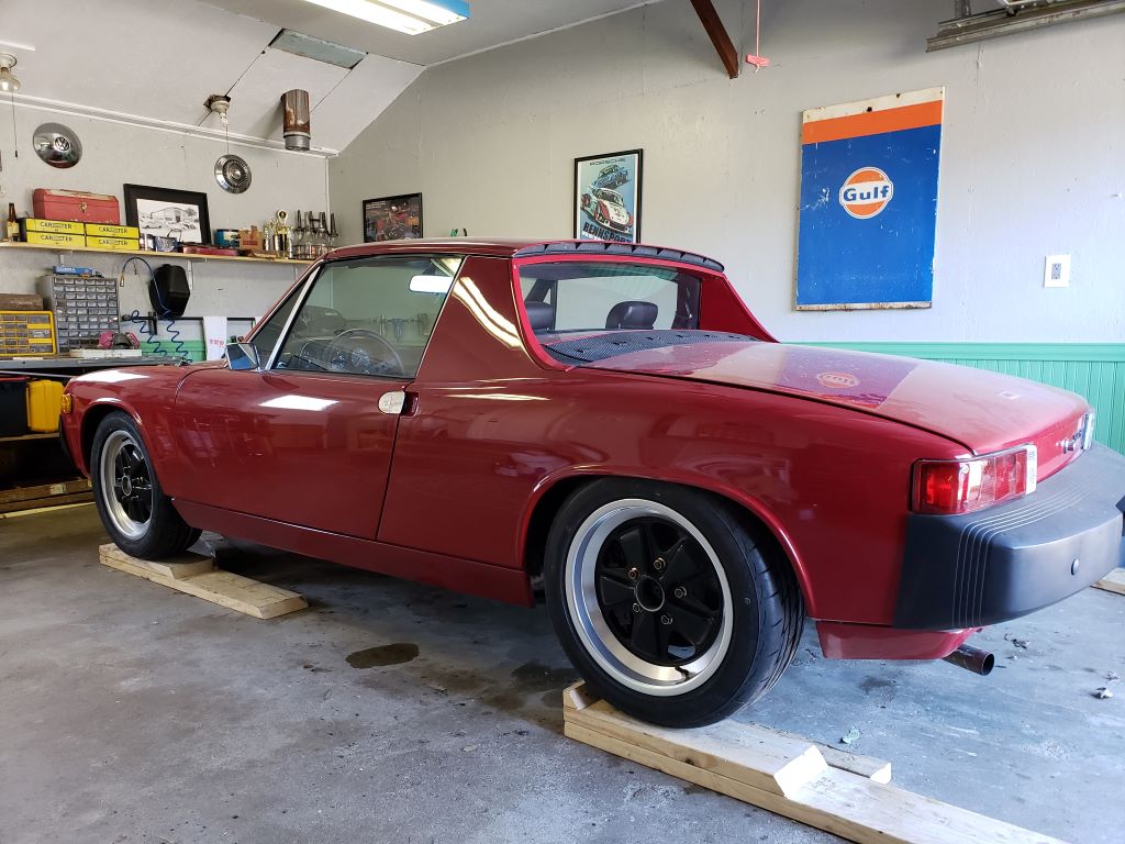

Figured I would share a few pics of my 5 lug swap on my 75. I used 3.5 spaced 911 struts and Boxster calipers all around using the Rebel Racing kit. Wheels are 16x6 and 16X7 fuchs with 195/55/16s on all 4. I originally had 911 wheels all the way around but the rears had a slight interference with the calipers. Rather than use spacers I switched to 951 rears and the fit is great.

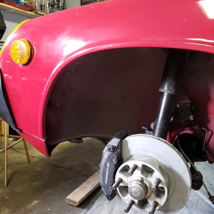

Do you have pics of the 911 struts with the wheels off?

QUOTE(JOEPROPER @ Apr 17 2019, 08:41 AM) *
Let me take a look

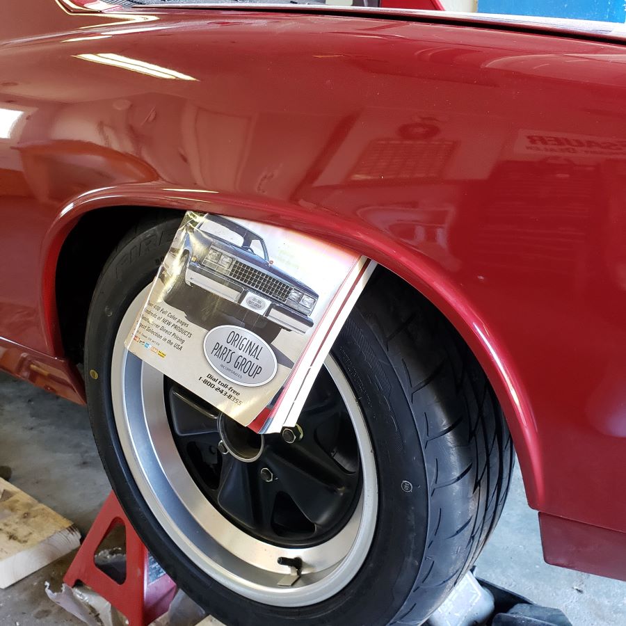

I had to stretch the quarters about 3/4" to fit the 7s. not the most conventional method, but it worked. I hammered the lips up and then used soft books on the wheels and jacked the wheel up into the wheelwell. Took several tries adding books and moving them front to back, but I got what I needed without scarring up the quarters.
is this helpful?

QUOTE(twistedstang @ Apr 17 2019, 08:48 AM) *
Nice job. I've never seen anyone do it with books, but I did it with a fender roller. Did you heat the paint?
