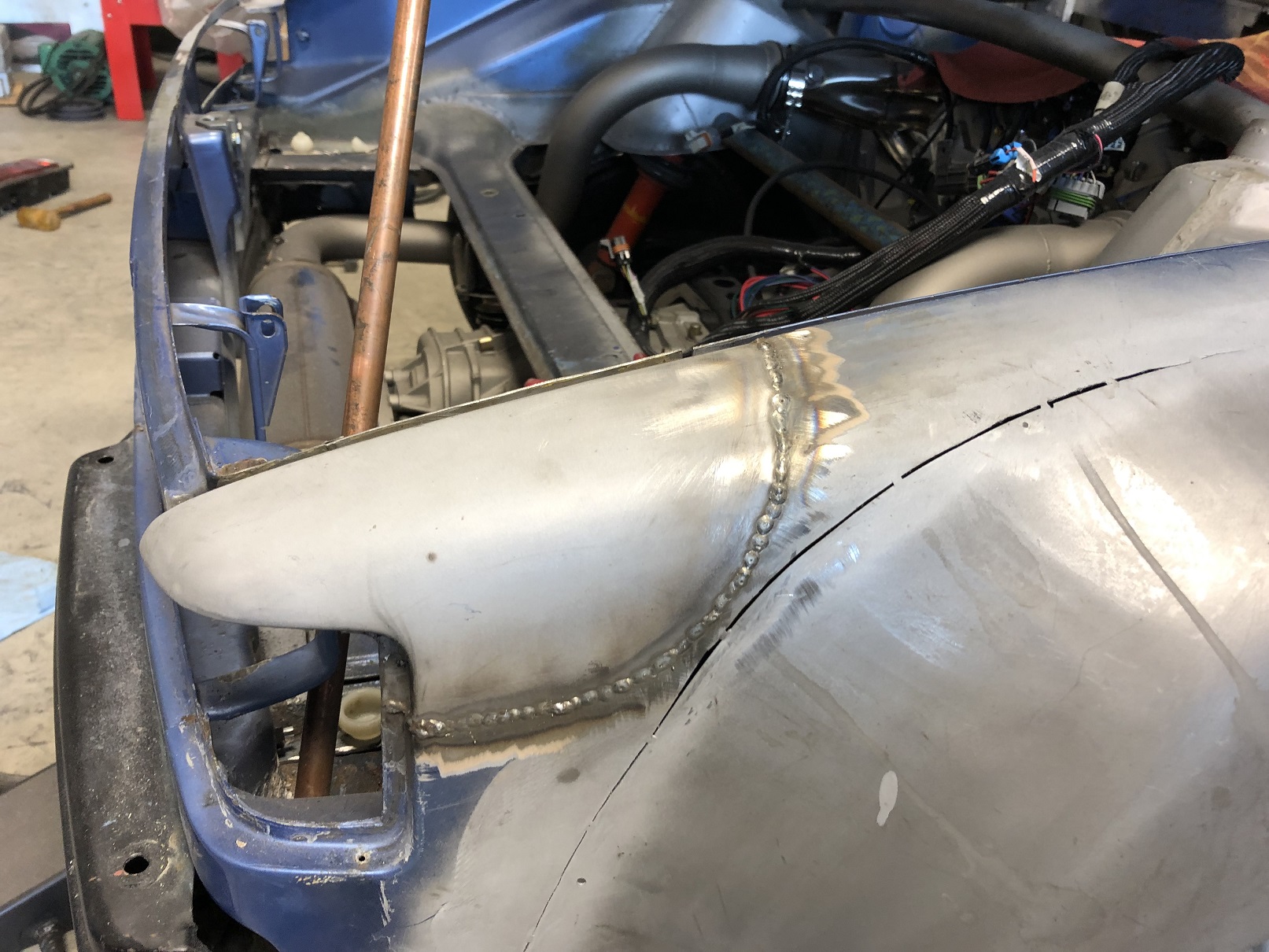

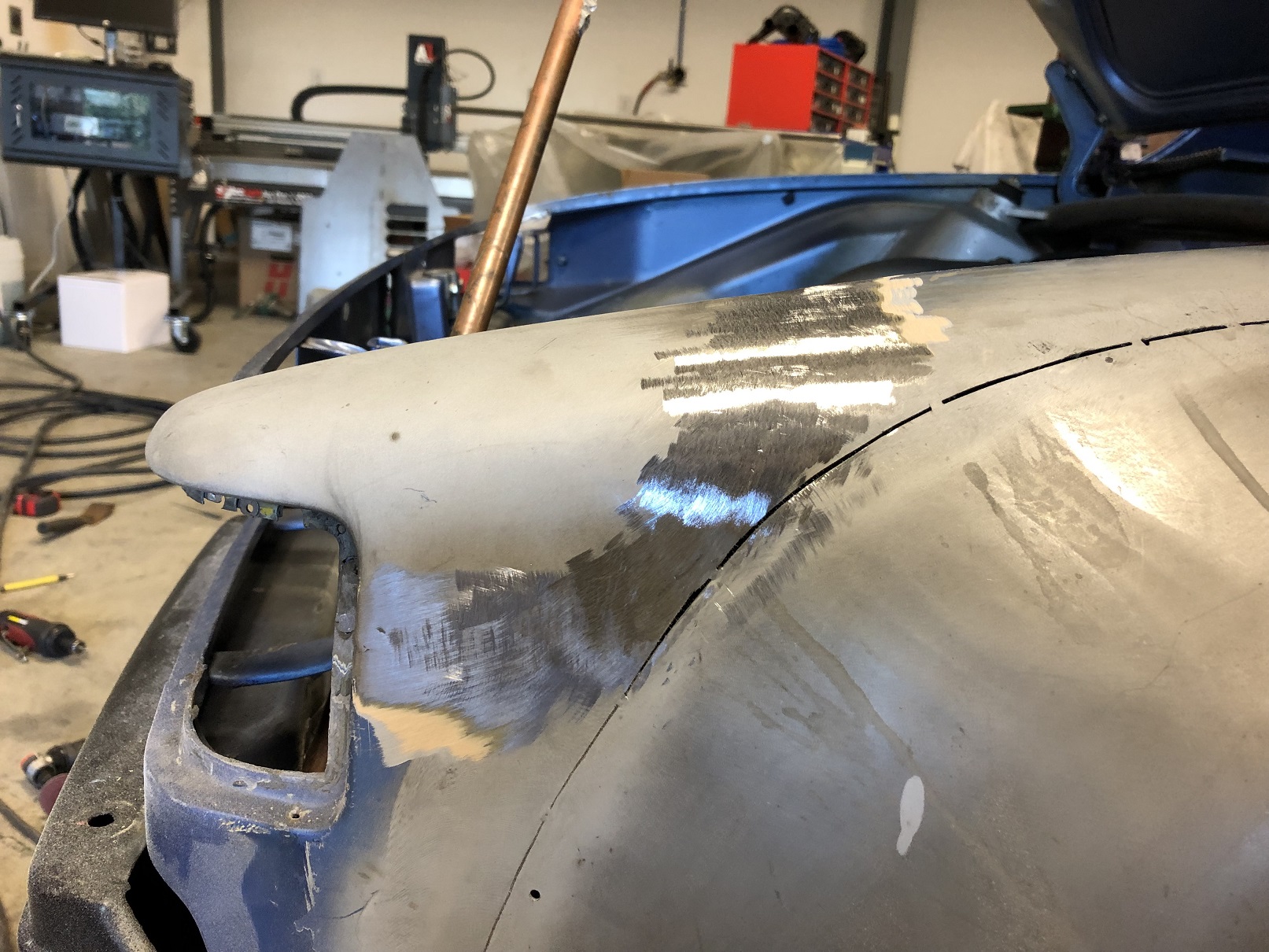

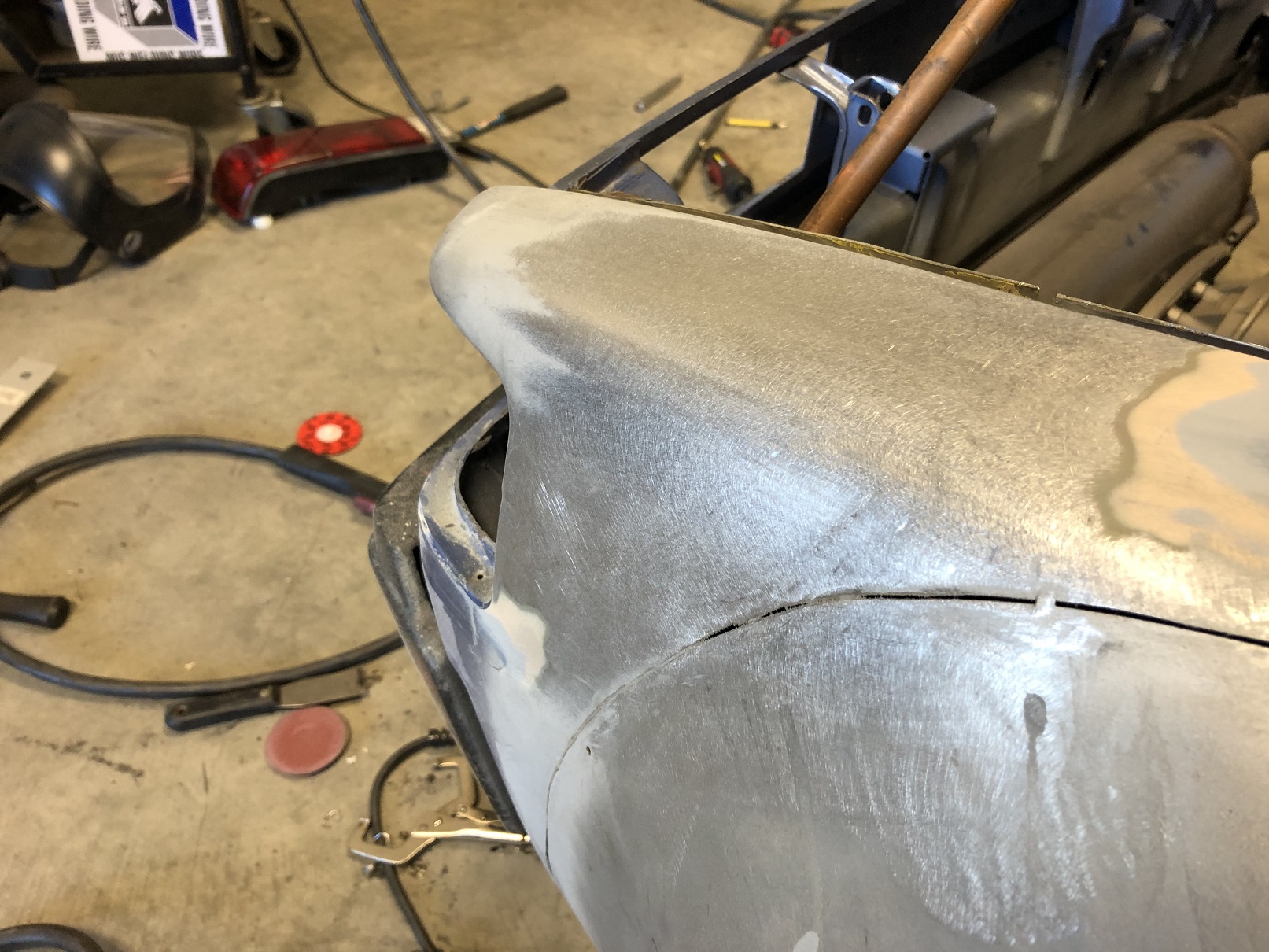

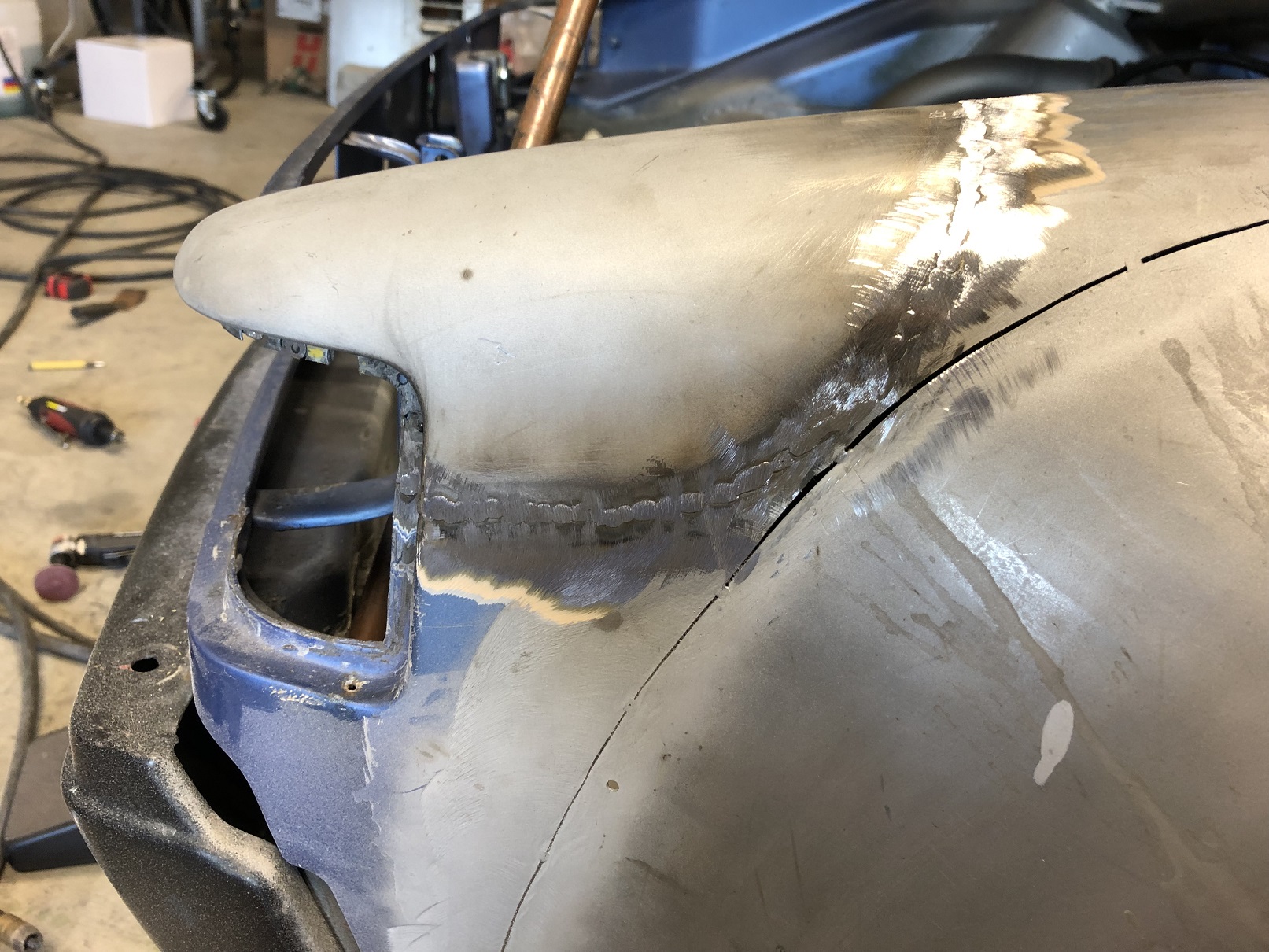

I follow this process:
- 3 inch air angle grinder w/ Roloc backer pad
- 3M Cubitron abrasives
- Start w/36 grit, use a steep angle and cut only weld material. Go SLOWLY. I used a "long-ish blip, blip" to keep accurate control over the cutting. Once "close" to the parent material:
- Switch to 80 grit. Shallower angle, same go SLOW approach.
- Once the edge of the weld starts to show a blend with the parent material:
- Switch to 80 grit on a DA to do final blending.
The 3M stuff cuts so quickly, I have yet to experience heat-related distortion.
Pics of a recent repair using the above approach. Hope this helps.
