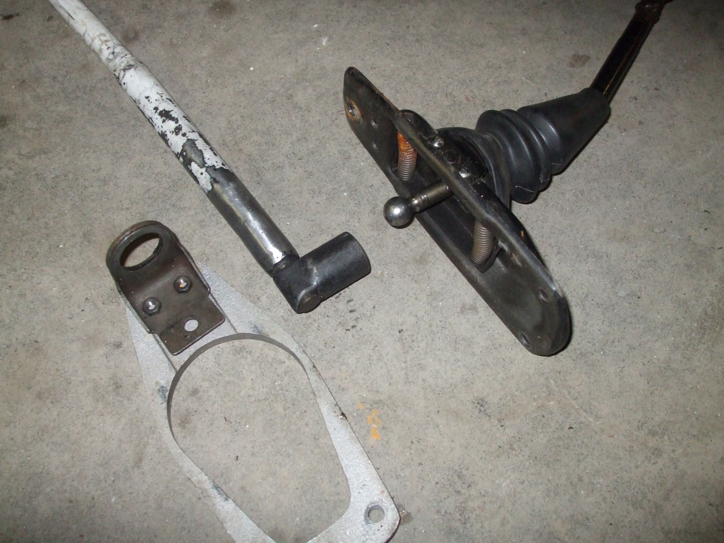

I'm having a brain fart moment, I can't remember which shifter I used for my '67 bug with a 911 (901) 5 speed tranny.
The rod broke right at the shifter, I had to weld it up, it could be out of a 76 911.... but it might be 914.
Which bushings do I need?

I believe it’s the same bushing for 914/911

And a ball cup bushing. How does the detention plate edge look?

Same for early 914.

It us

Mikes914 fixed me up, he had two bushings with different ID's it took the larger one.
