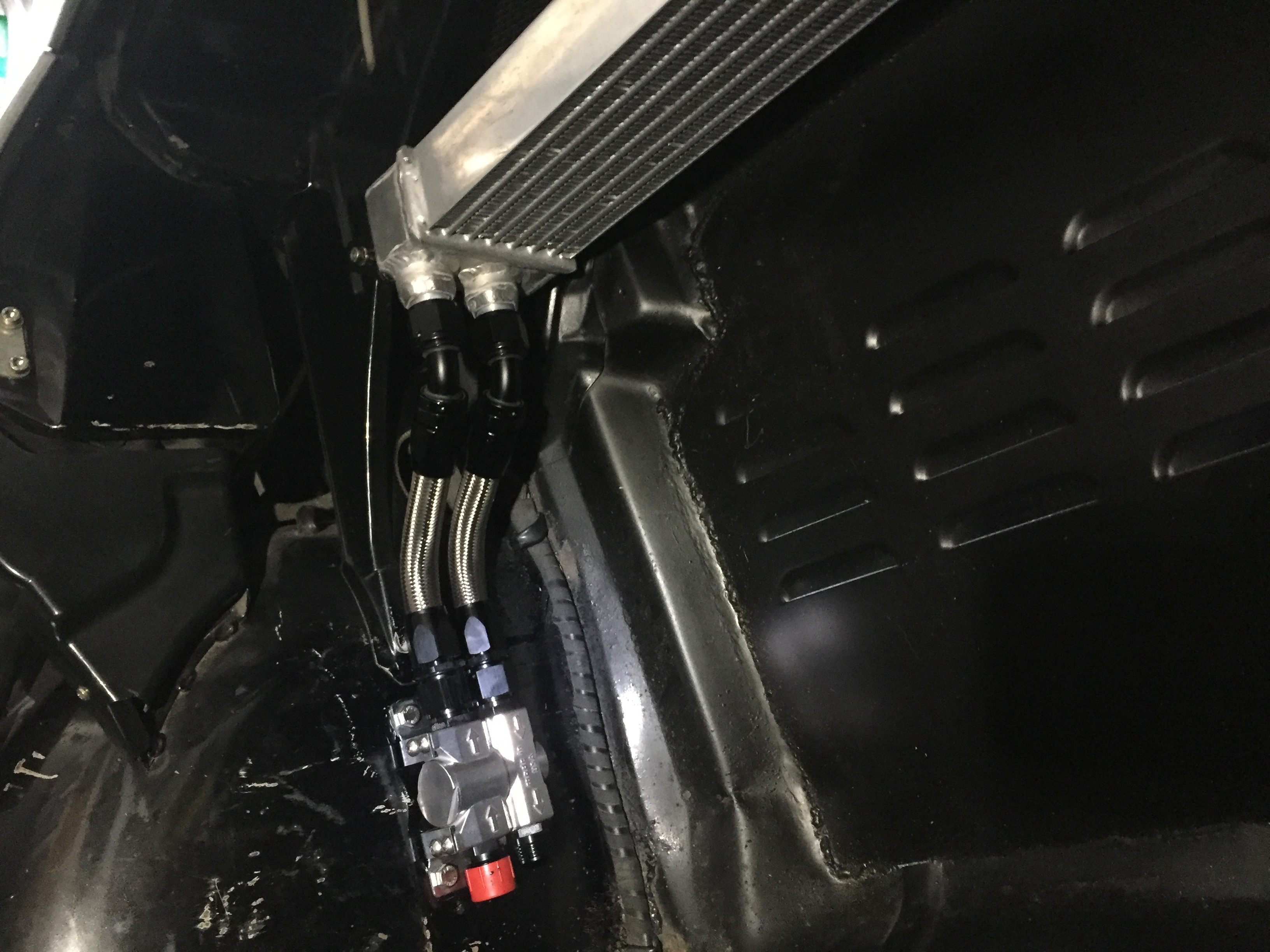

Mine in on (actually in) the rear firewall and it rarely ever opens on freeway cruising so the oil goes right back to the tank without ever going to the front of the car.

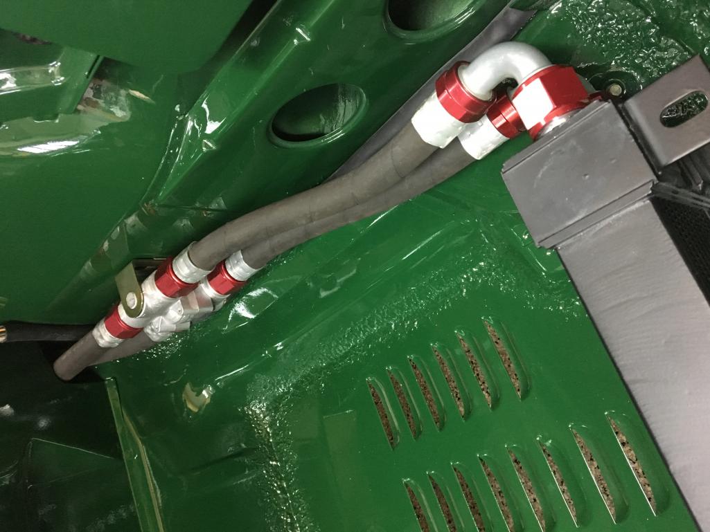

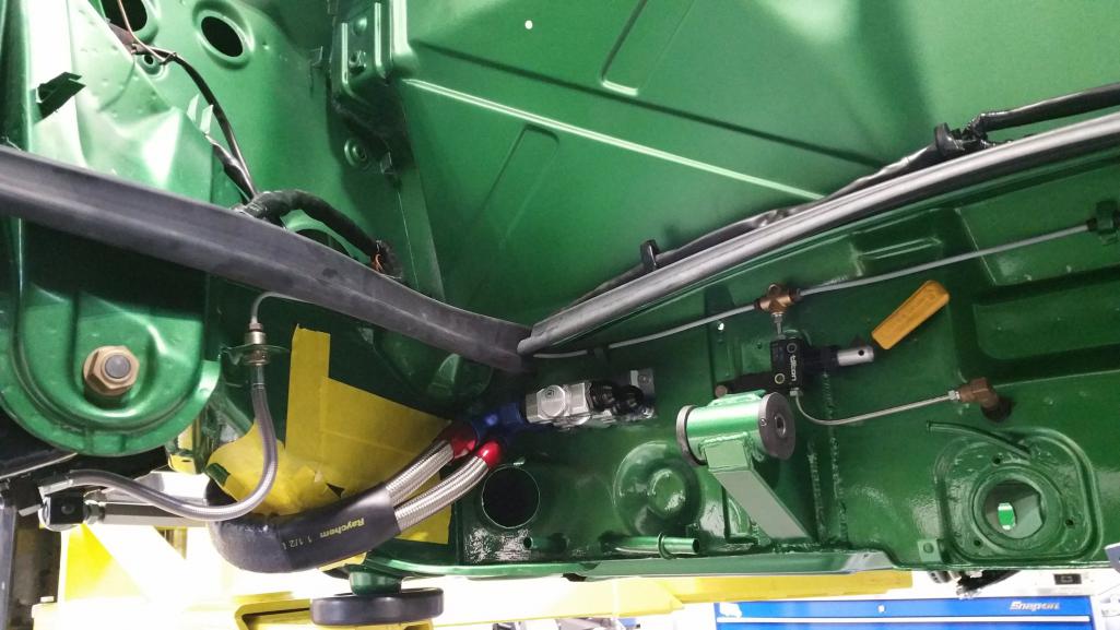

I ran mine in the same place in the front trunk exactly like your first picture.. I talked to James Patrick about and he said it would work okay as long as it is low in the car. I bought those same parts from PMS but I opted not to use the inline filter.
Are those pictures of the same Irish Green car?
