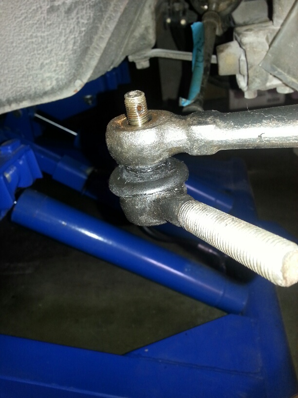

2) Having much trouble taking apart the front suspension.
a) Can I just use a fork to pry this off or do I need a puller/pusher device? I have neither so trying to avoid buying both. Soaking in PB Blaster now. Boot is already torn so a fork would do no damage, just looking for the easiest way.

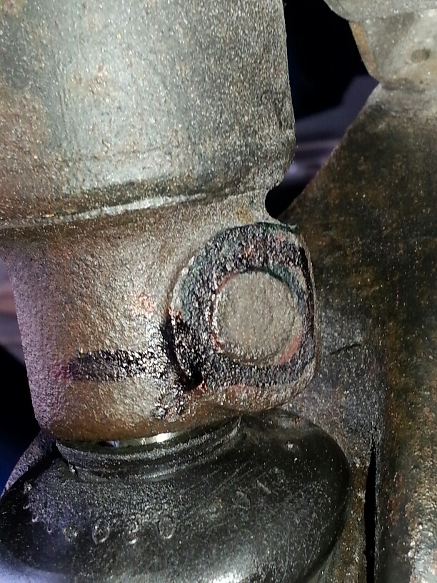

b) According to the Haines Manual the bolt/pin shown is suppose to come out to release the ball joint (held in by a semi-circle feature?). Mine looks like it is permanently attached to the strut. How do I get it out?

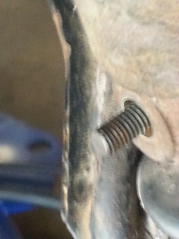

3) When removing the control arms do the adjusters need to be wound loose? Can the cross support bar be left in place?

Yes you can use a fork. Put the nut back on the bolt and whack it with a hammer. It will loosen. (IMG:style_emoticons/default/beerchug.gif)

1) You can but it is only a temporary solution at best. The problem is finding replacement CV joints. See other treads on this site for details.
2)
A. Do Not Pry. Ideal case is use a tie rod puller - actually pretty cheap to buy or often available to rent at AutoZone, PepBoys, NAPA, etc.
Alternative is to soak it in liquid wrench - wait for this to work to loosen any surface rust. Then use two hammers. One heavy hammer and a lighter ball peen hammer. Use the heavy one to hold steady behind the cast iron knuckle. Use the lighter one to whack the cast iron knuckle (several times). This will usually free the tie rod end from the knuckle.
B. There is a wedge shaped taper pin there. It needs to be soaked in liquid wrench. Then drive out with a soft faced hammer or brass drift to release the ball joint.
In either case A or B, a little heat helps but you have to be very careful not to melt or burn the rubber boots if you are planning to reuse them. Don't overheat the strut either - the cartridge has oil in it that will be degraded by high heat.
3) You can wind them loose but likely the torsion bar splines are corroded into the caps. More liquid wrench. More heat at ends being careful since bushings are rubber - no heat if you plan to reuse the A-arm bushings. Lots of wiggling back & forth, Lots of hammering with soft dead blow hammer. More swearing. Cross bar can be left in place.

For item #2, I'll second Superhawk - use a tie rod puller. Not expensive, or you can do the AutoZone loaner tool (I have, then bought one). Works like a charm.

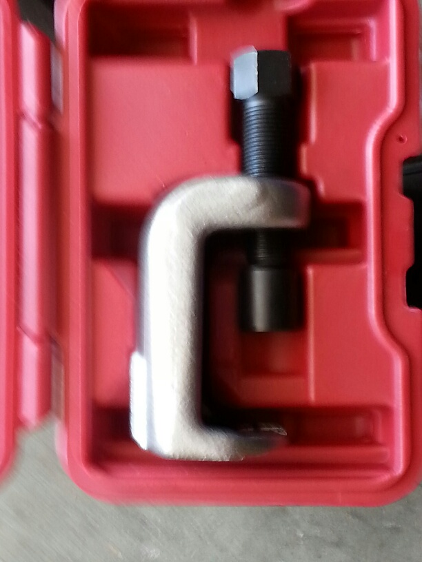

2a) Followed your advice and went to Autozone. This is the tool I used. Both Pitman style pullers were too large. Lucky Autozone is close to my house. What a bang when it let loose.

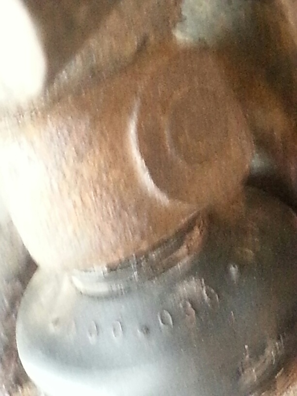

2b) Just want to make sure this pin is to come out. I'm soaking in PB Blaster. What tools have others used to drive this pin out?

I hate the fork tool as they tend to destroy the rubber boot...ok if you are replacing the ball joints.
Proper ball joint removal tools are the way to go as mentioned,I have a Sykes one made in the UK ,wind it up tight and strike each side of the arm together with 2 hammers for the tight ones ,forget penetrating lube as it won't do squat on tapers.
Yes last resort is to use some heat on the steering arm with a butane torch .
If you are reusing the ball joints refit the nut so you don't mushroom the thread with a ball joint tool when removing.
When refitting new or good used ones hit them in to the taper with a brass or hard nylon face hammer so they don't turn when refitting the nuts.

What is the proper tool for removing the pin attaching the strut to the A-arm ball joint?

Put the nut back on the threads, grab the biggest hammer you have and give it a good smack. Those pins are suppose to be a one time use only. You can buy new ones at PP, PMB or the dealer.

I used a tool like the one you got from Autozone - you may have to use some "spacers" like large washers or nuts to position it.
I prefer soft faced hammer (copper or brass) to minimize mushrooming of the stud and/or the nut. Best if you thread the nut almost all the way on leaving about 1/8" gap to the strut bottom. If this doesn't work with a good whack or two, heat the strut bottom with propane torch then try again. I've reused these pins before but the point was that if you bugger up the treads, they are replaceable.
Not a bad idea to replace ball joints on any car as old as teener's. Getting those off is another fun project. (IMG:style_emoticons/default/aktion035.gif)

More heat and I got the ball joint pins out. Kind of a strange non-symmetrical taper. (IMG:style_emoticons/default/confused24.gif)
