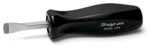

I too did one this week (new 914 rubber piece). After all the comments on how brutal it was, didnt know what to expect. Was non issue. Use a little glycerine started at the top of the A pillar, got the back edge and then pushed in the outside edge. I used a wider tool, a dzus fastener tool, its short and a wide blade.

With out this forum, I would have tried to slide it (with massive frustration). The method I used, if I recall, is how 914rubber has posted, as the way they do it.
This was the tool I used, it being so short really gave good control, and the wide blade didnt want to dig into the rubber.
