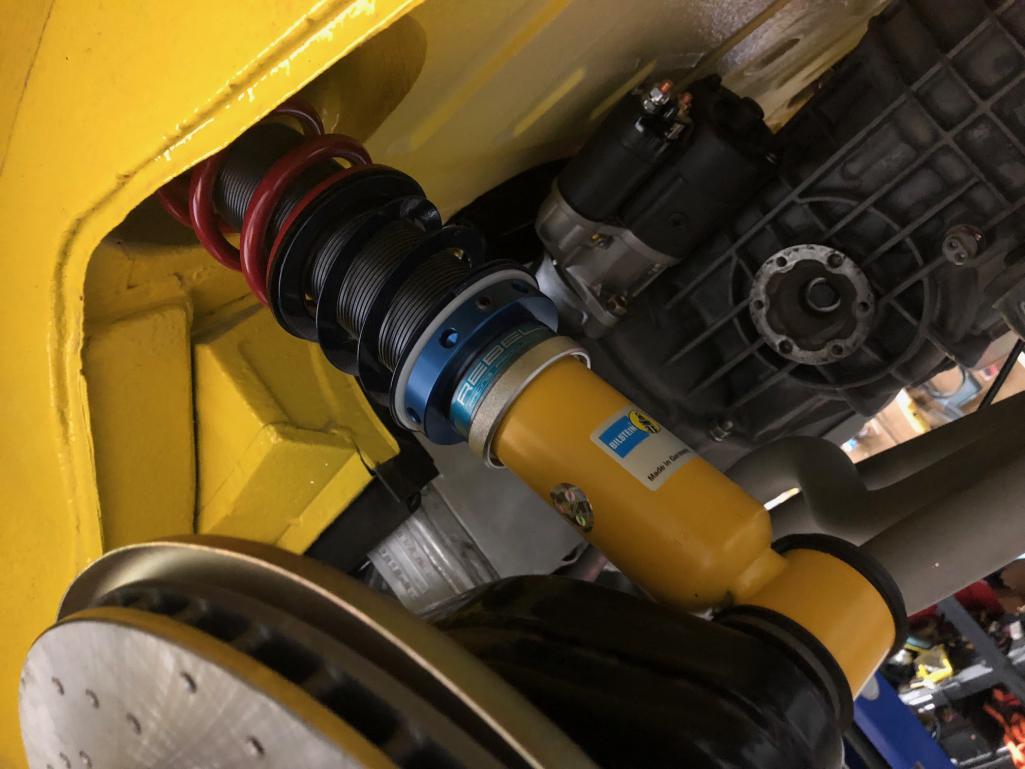

Super early S caliper with backings. Note the color. For those that do know my car the 30th 6 at PMB. So, if Eric put them on my car that should tell you something.

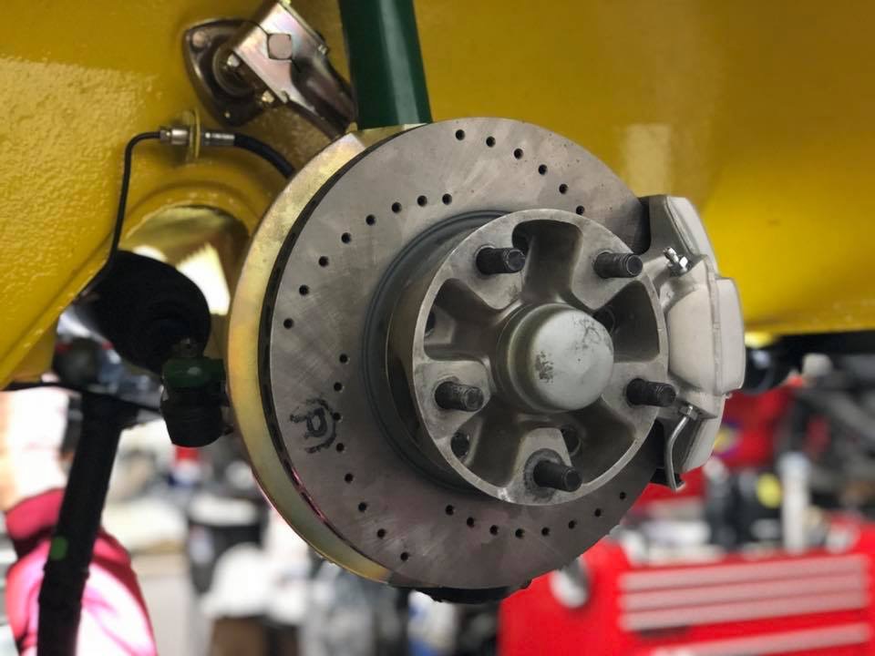

Rear on 41 with 914-6 V calpers spaced
Bob BAttached Image
