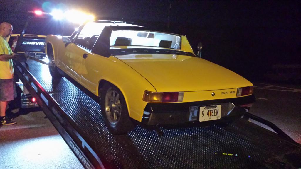

A couple of nights ago, we were taking the 914 out for an evening drive to dinner. It didn't feel quite right and there were more backfires than normal (we are used to a few burbles under decel) and all of a sudden, it just died about 8 miles from home. We were unable to restart the car and were getting no spark.
We decided to sleep on it. I researched the history of the car from the previous owner here (he did a great job documenting his activities) and found this was not the first time with these symptoms.
