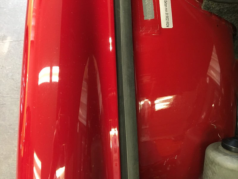

Here's the finished product cut and buffed and reassembled...

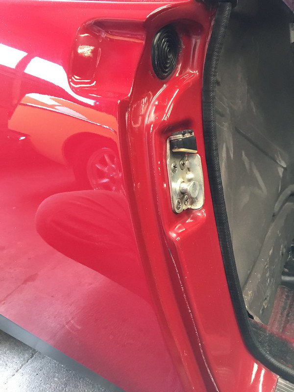

Here are the jambs and frunk in original paint compared to the respray...
(IMG:http://www.914world.com/bbs2/uploads_offsite/live.staticflickr.com-20876-1564960620.2.jpg)
(IMG:http://www.914world.com/bbs2/uploads_offsite/live.staticflickr.com-20876-1564960620.3.jpg)
Take your time to have your paint supplier carefully match the paint you are going to apply to the body with the jambs or other areas that the sun hasn't weathered.

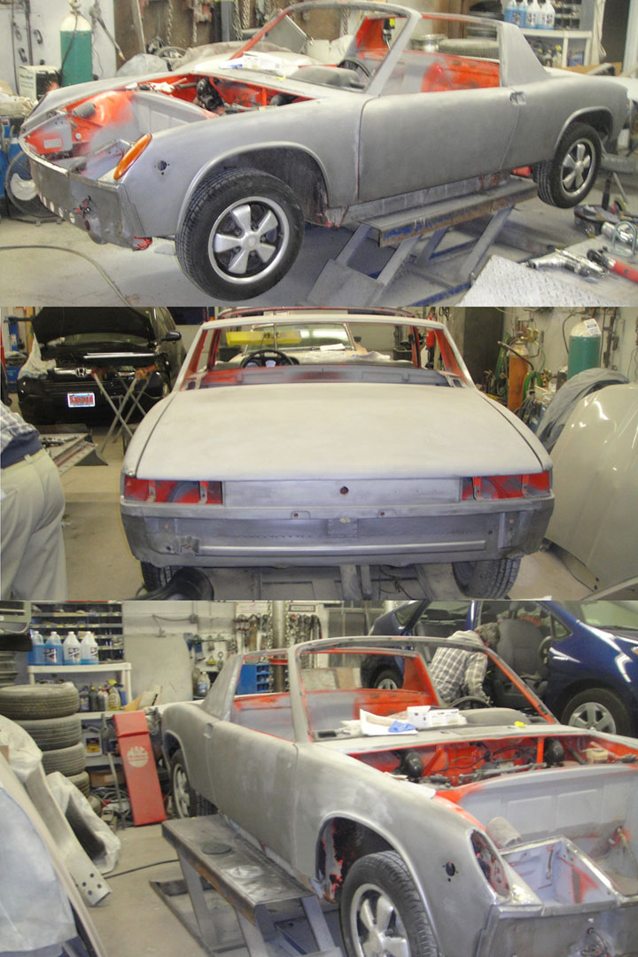

Really depends on the condition of the body.
This is how far my car was stripped..... Soda Blasted, a few years ago.
Didn't go crazy with the blasting.
I had my car painted once in the early 80's but the body was in pretty good shape.

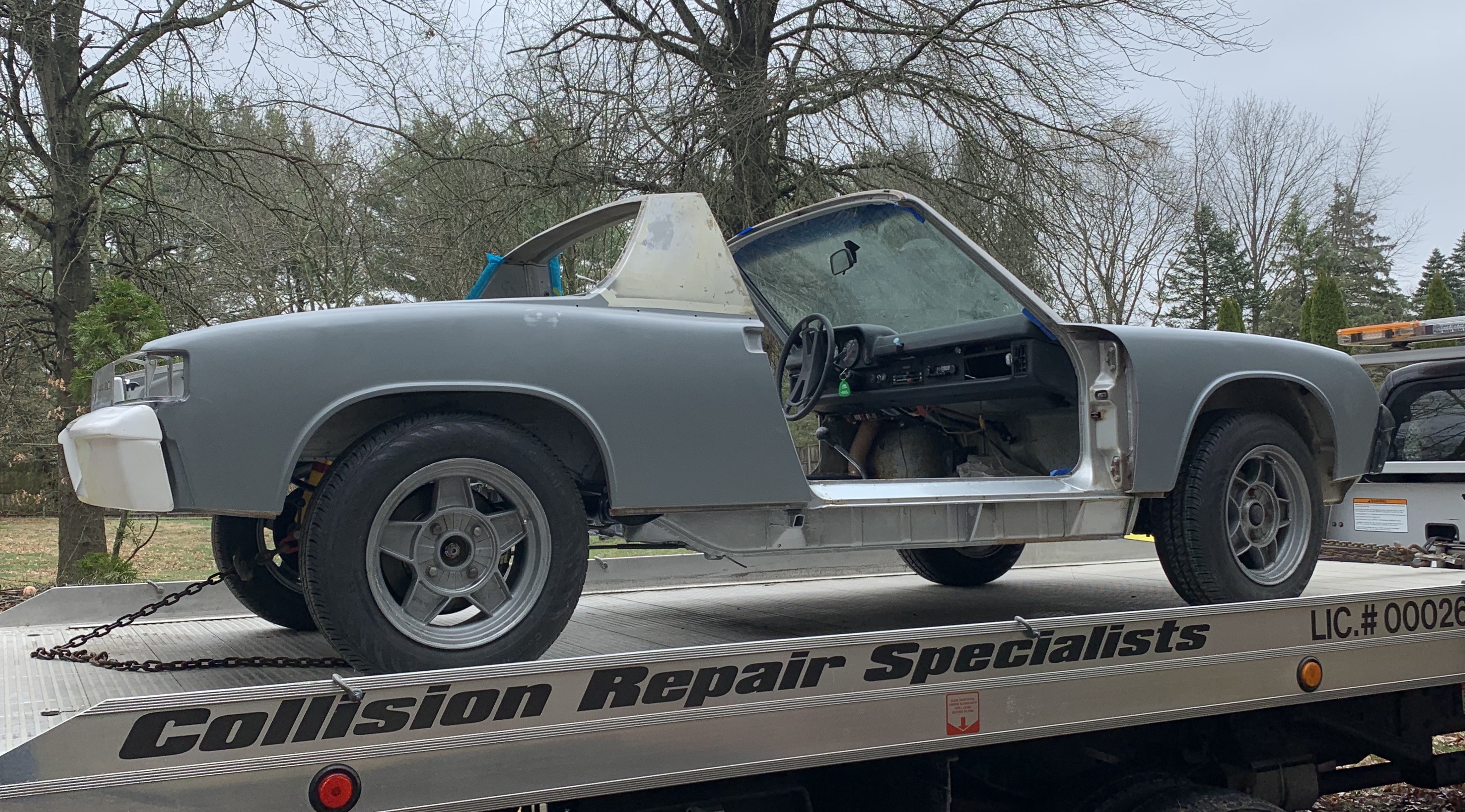

Found a competent and trustworthy body/paint shop around the corner.
Of he goes for some new paint.
Doors and hoods will be painted off the body and
yes, after long discussion with my painter, I agreed
to have the door jamb painted as well.
Hence, I’ll be ordering stickers from Poland soon.
