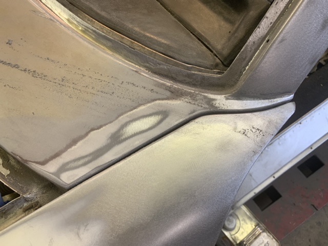

draganc
post Mar 31 2020, 09:02 PM
Post #21
Posts: 725
Joined: 2-November 09
From: central new jersey
Member No.: 11,000
...Attached Image
Cairo94507
post Apr 1 2020, 09:12 AM
Post #22
Michael
Posts: 10,802
Joined: 1-November 08
From: Auburn, CA
Member No.: 9,712
Nice looking metal. (IMG:style_emoticons/default/beerchug.gif)

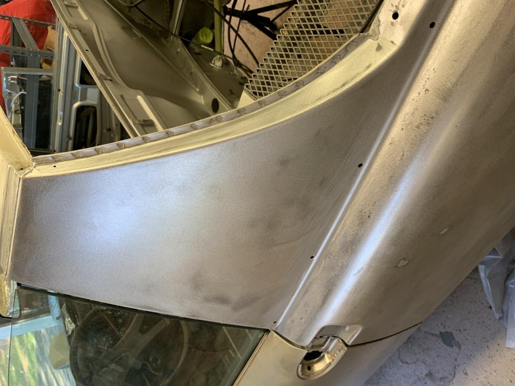

draganc
post Apr 3 2020, 09:26 PM
Post #23
Posts: 725
Member No.: 11,000

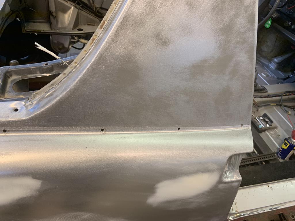

More good news! (IMG:style_emoticons/default/piratenanner.gif)
914_7T3
post Apr 3 2020, 11:20 PM
Post #24
Posts: 1,906
Joined: 3-April 17
From: Los Angeles, CA
Member No.: 20,991
A beautiful sight indeed.

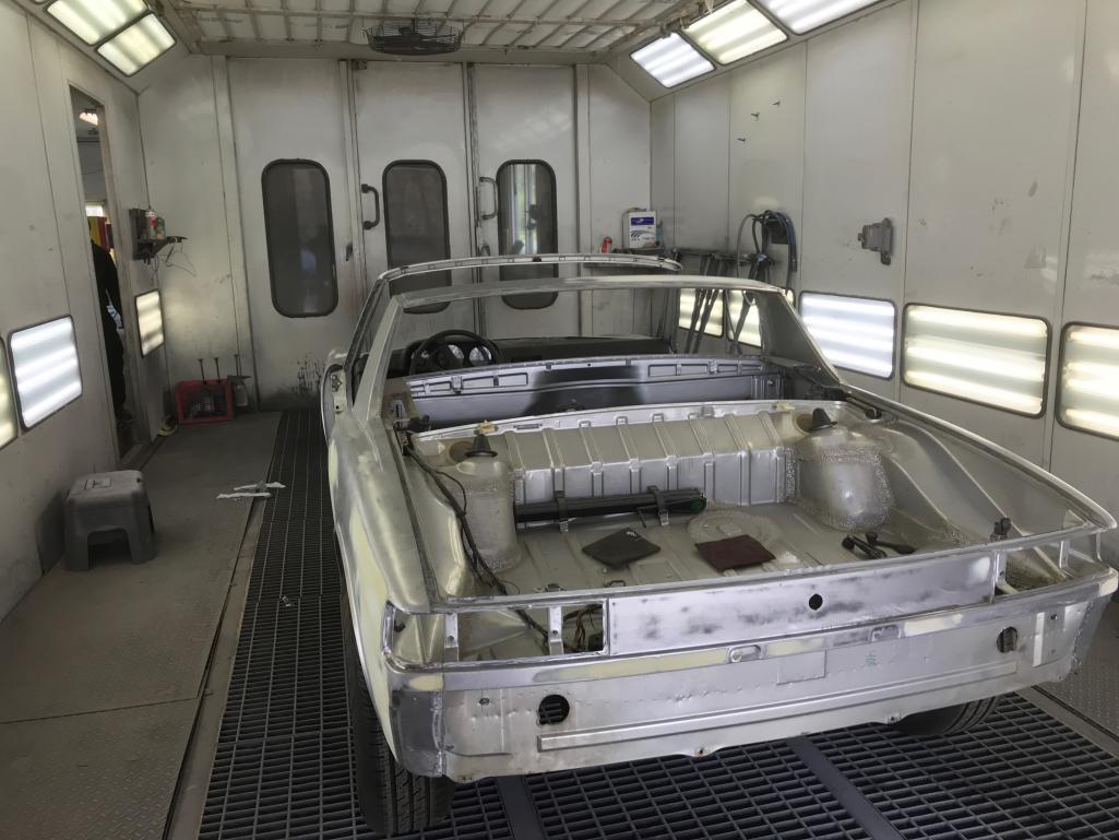

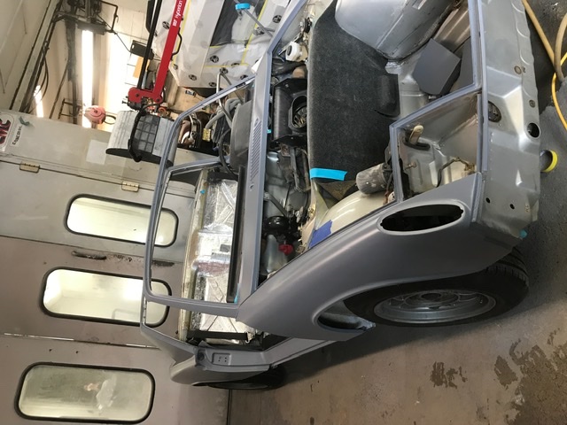

And we are progressing:

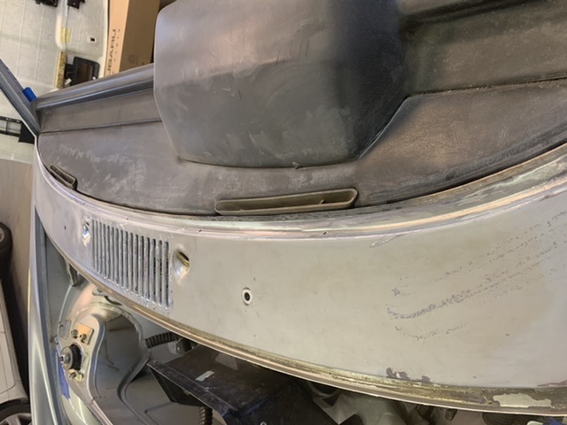

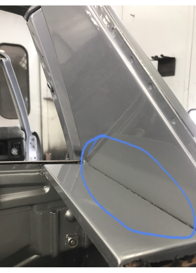

What’s the group’s take in finishing or seam “sealing”
the inside of the sail?
Thanks!!
Cairo94507
post Apr 25 2020, 08:44 AM
Post #28
Michael
Posts: 10,802
From: Auburn, CA
Member No.: 9,712
I do not recall that ever being seam sealed. (IMG:style_emoticons/default/beerchug.gif)

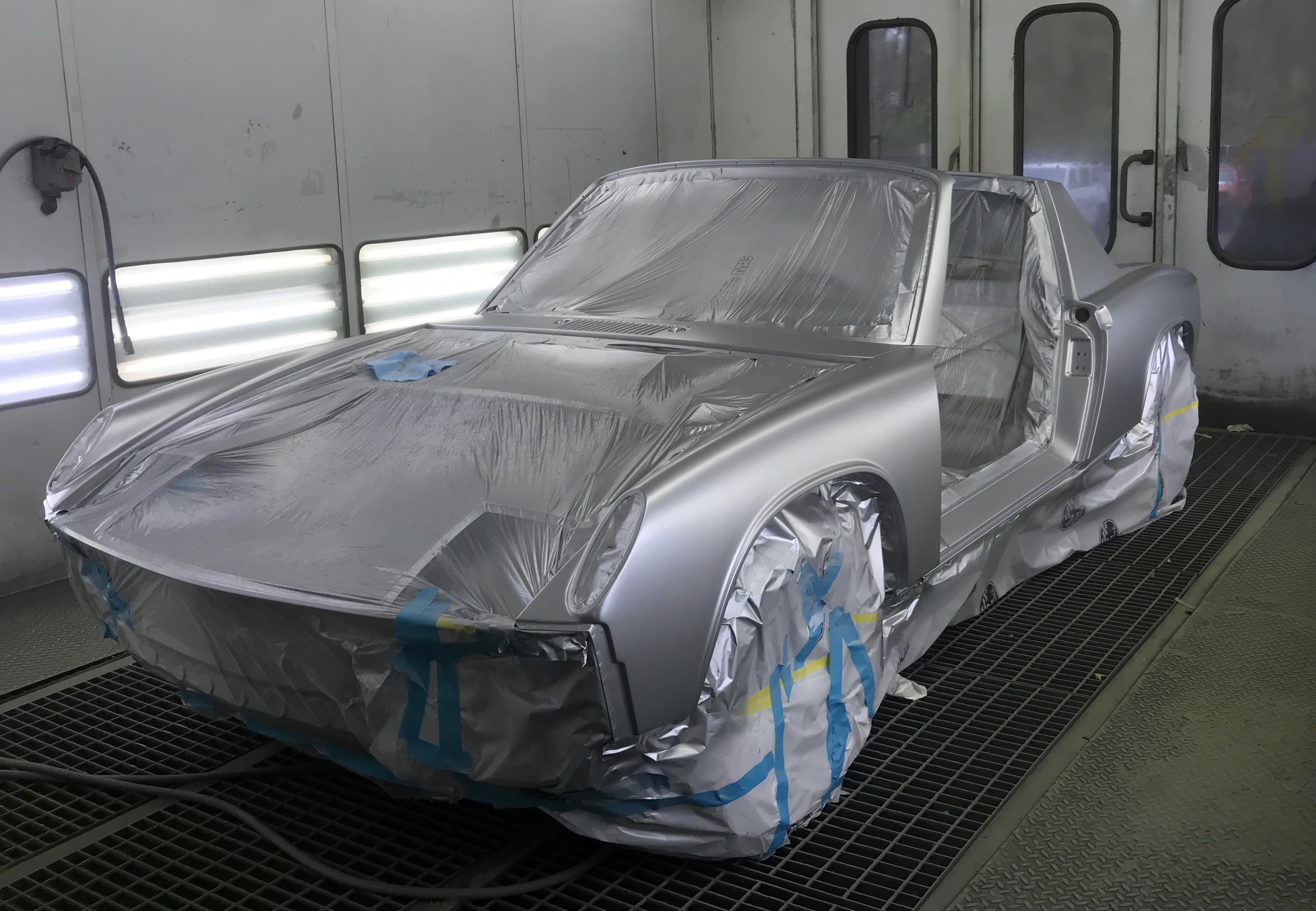

draganc
post Apr 30 2020, 02:55 PM
Post #29
Posts: 725
Member No.: 11,000

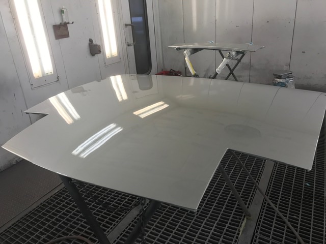

And we are moving along!
I’m sure most of the forum can appreciate my excitement,
to see this picture, after 10 years in the works.
Next step is the clear coat......
BeatNavy
post Apr 30 2020, 03:04 PM
Post #30
Posts: 2,967
Joined: 26-February 14
From: Easton, MD
Member No.: 17,042
(IMG:style_emoticons/default/piratenanner.gif) Big day, congratulations!
Cairo94507
post Apr 30 2020, 03:14 PM
Post #31
Michael
Posts: 10,802
From: Auburn, CA
Member No.: 9,712
Absolutely stunning. Once the clear coat is on it is going to look like glass. Very big milestone indeed. (IMG:style_emoticons/default/beerchug.gif)

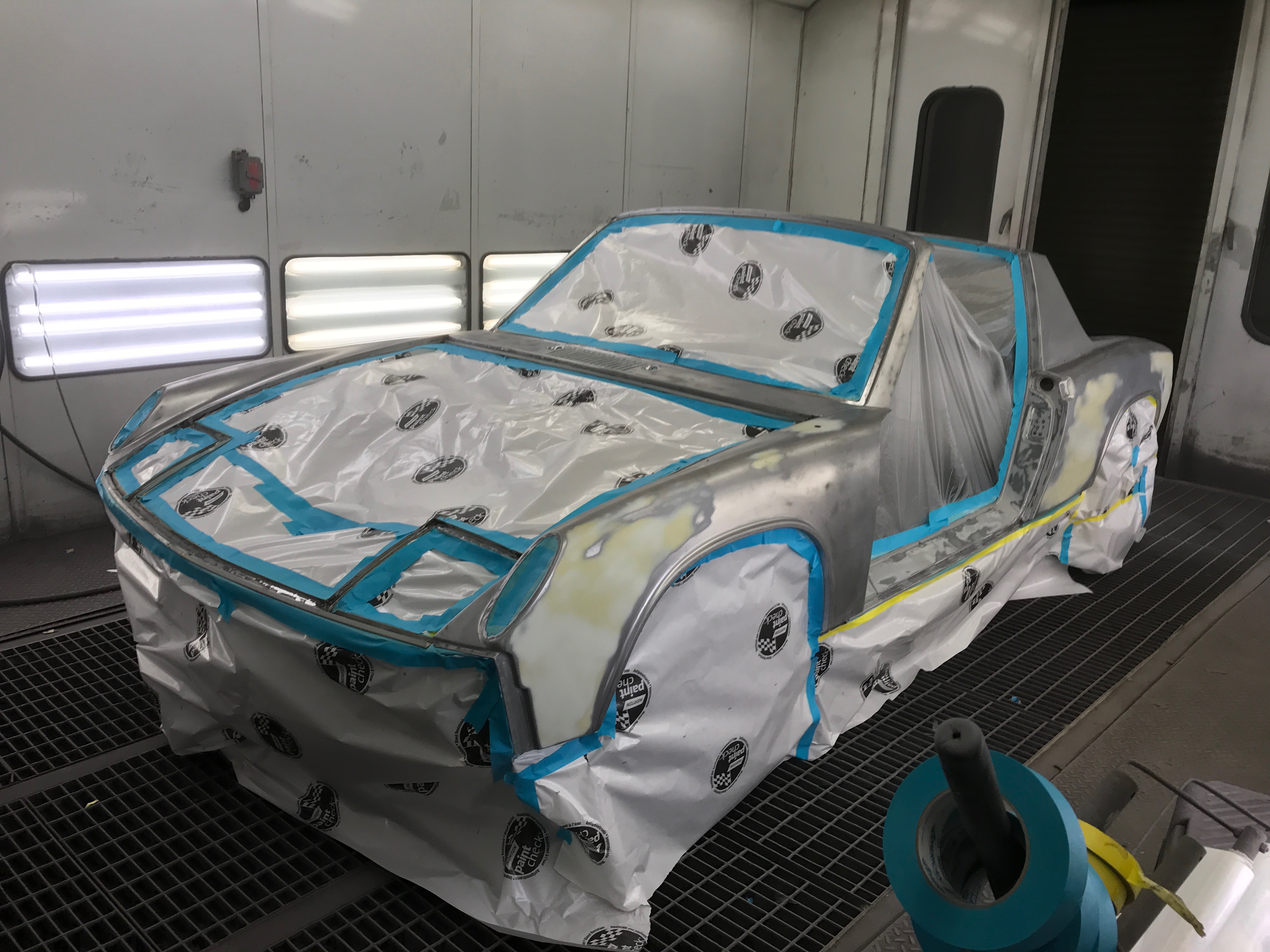

draganc
post May 1 2020, 08:00 AM
Post #32
Posts: 725
Member No.: 11,000

draganc
post May 1 2020, 02:53 PM
Post #34
Posts: 725
Member No.: 11,000

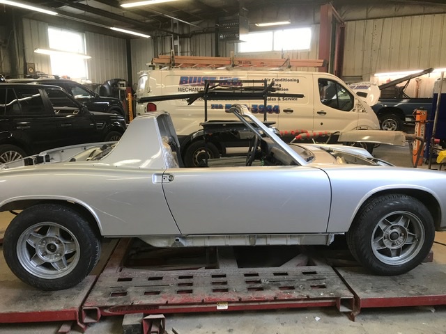

One more before assembly:

never paint the jambs, behind the bumpers, under the rockers, inside the door ends and bottoms, nor under the trunks unless the car is a disaster. In your case having such a nice original paint silver car, you could even paint up to the windshield clips and avoid removing the windshield. You will have to remove the deck lids, stripping the engine lid of its parts, remove the headlight covers and eyebrows, painting them separately, then remove the bumpers windshield trim roll bar trim bumpers, rocker panels, wiper arms and bolts, fender to cowl seals side markers front turn signals rear tail lights, tape off all wire ends, pull out the ski rack buckets in the front windshield frameblock off the fresh air intake vent, remove the front and rear trunk seals, the squeeges and vent window seals, windshield top seal, and carefully strip the exterior paint on the doors fenders and quarters of the body and then very carefully mask off everything. DO NOT paint inside the roll bar as I am sure that that paint is fine, and only tape into the rear quarter seam at the edge of the door jamb.
Taping of correctly and thoroughly is the key to avoid overspray (for example removing the exterior door latches but not covering the interior mechanism, or taping off the squeege gutter, not stuffing paper in the door jambs when spraying the doors etc. sand and sand and block and block then glasurit base coat clear coat
