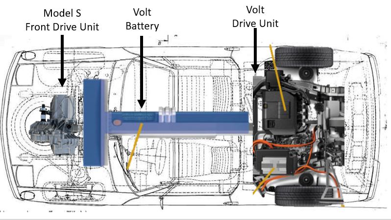

So here goes nothing. I'm kicking off my build for a 400+hp awd electric conversion of my 74 914. I will part out a Volt and use the drive unit in the rear of the car, the battery will be rotated 180 and go in the tunnel between the seats. A Model S drive unit will power the front wheels completing the AWD.

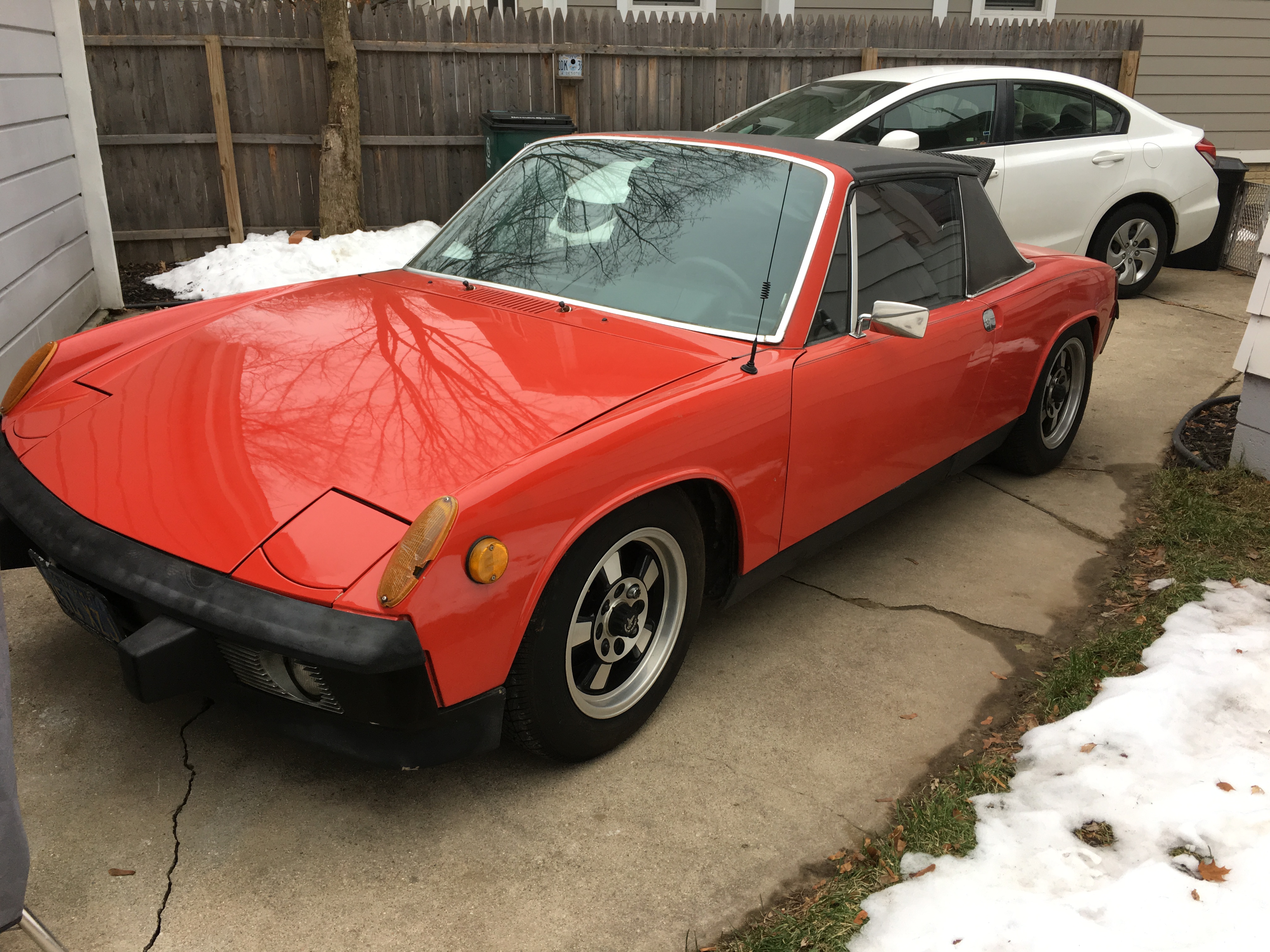

My 74 914 2.0 I picked up for $3400. It was a California car but the jacking points are rusted out.

How are you going to synchronize the two engines?

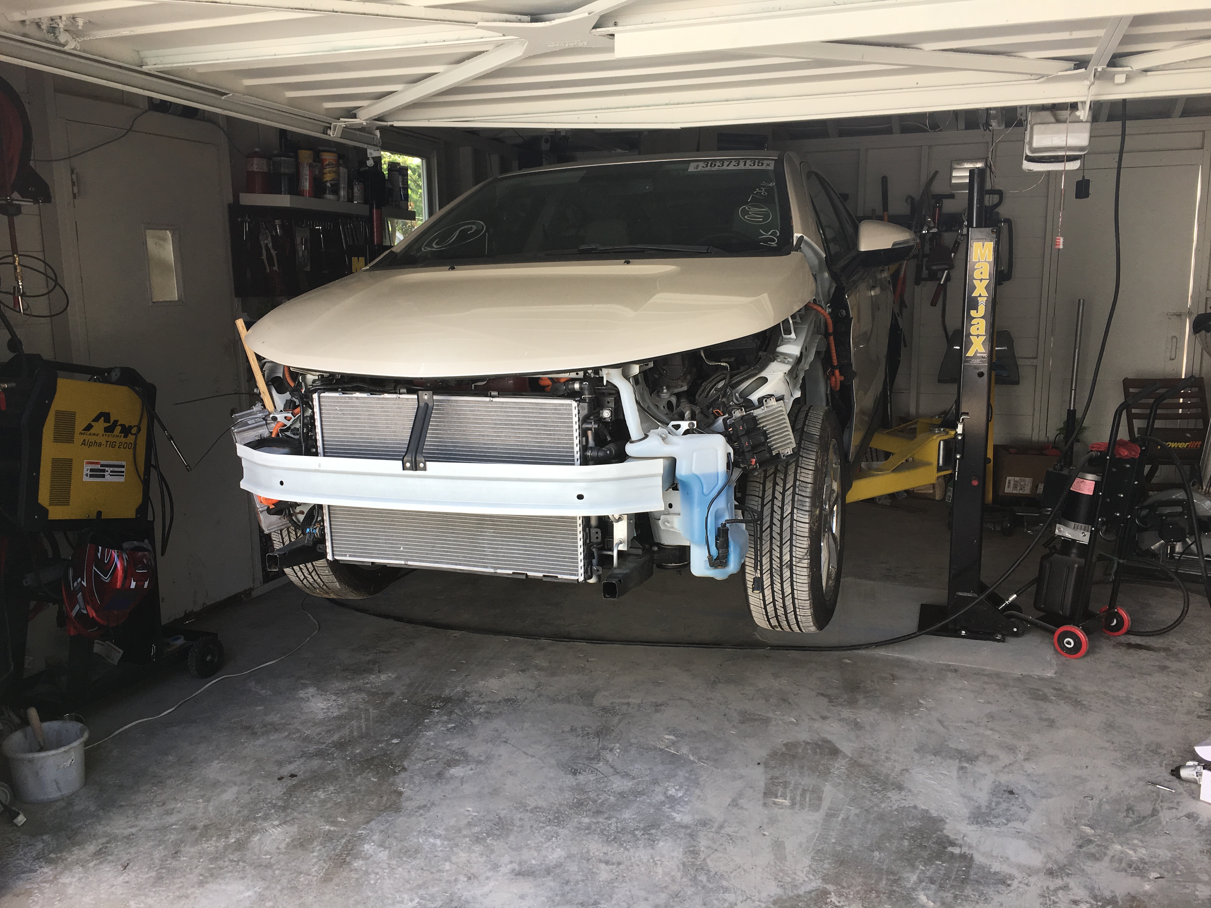

The 2013 Volt with parts only title I will use the battery and drivetrain from.

I would just add more batteries instead of the front engine. You will need some weight on the front to get traction in front any way.

I also like this project. Love the can-do spirit. I'm also curious about how the front and rear motors will be synched. Someone mentioned brakes. From what I've read, both the Volt and Model S have regenerative braking. Any chance this will be incorporated into the build?

After retiring from Ford I worked at a consulting company where one of the projects was the conversion of a Toyota Corolla to battery electric using Li-Ion batteries. The scope of that project was easier than your conversion because there was no IC engine to deal with and there was only one electric machine. We used a Siemens motor and a Borg Warner single speed trans axle. I architect-ed the Motohawk controller and wrote the Simulink software that "glued" all of the bits together including the battery management system, motor controller and shift lever. The was no thermal management system for the battery packs that were packaged in three locations (not recommended). Your biggest challenge will be the software to make the battery pack and the electric motor happy and allow it to function. Those OEM systems require a lot of handshakes to enable them to function. (We also did some consulting on the VOLT battery system).

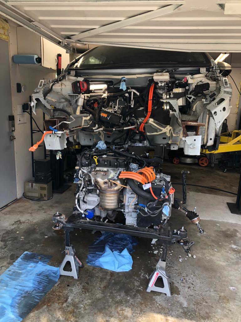

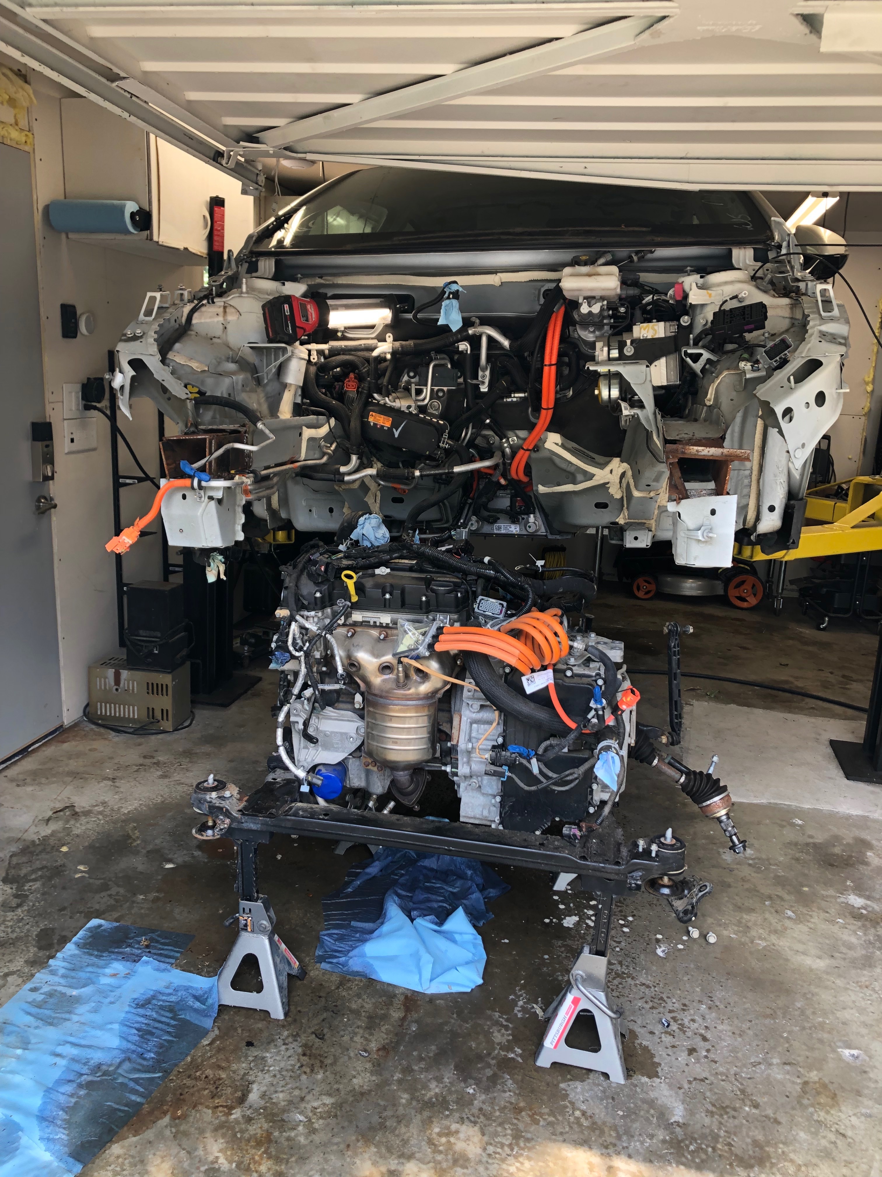

Dropped the drive unit/generator from the Volt.

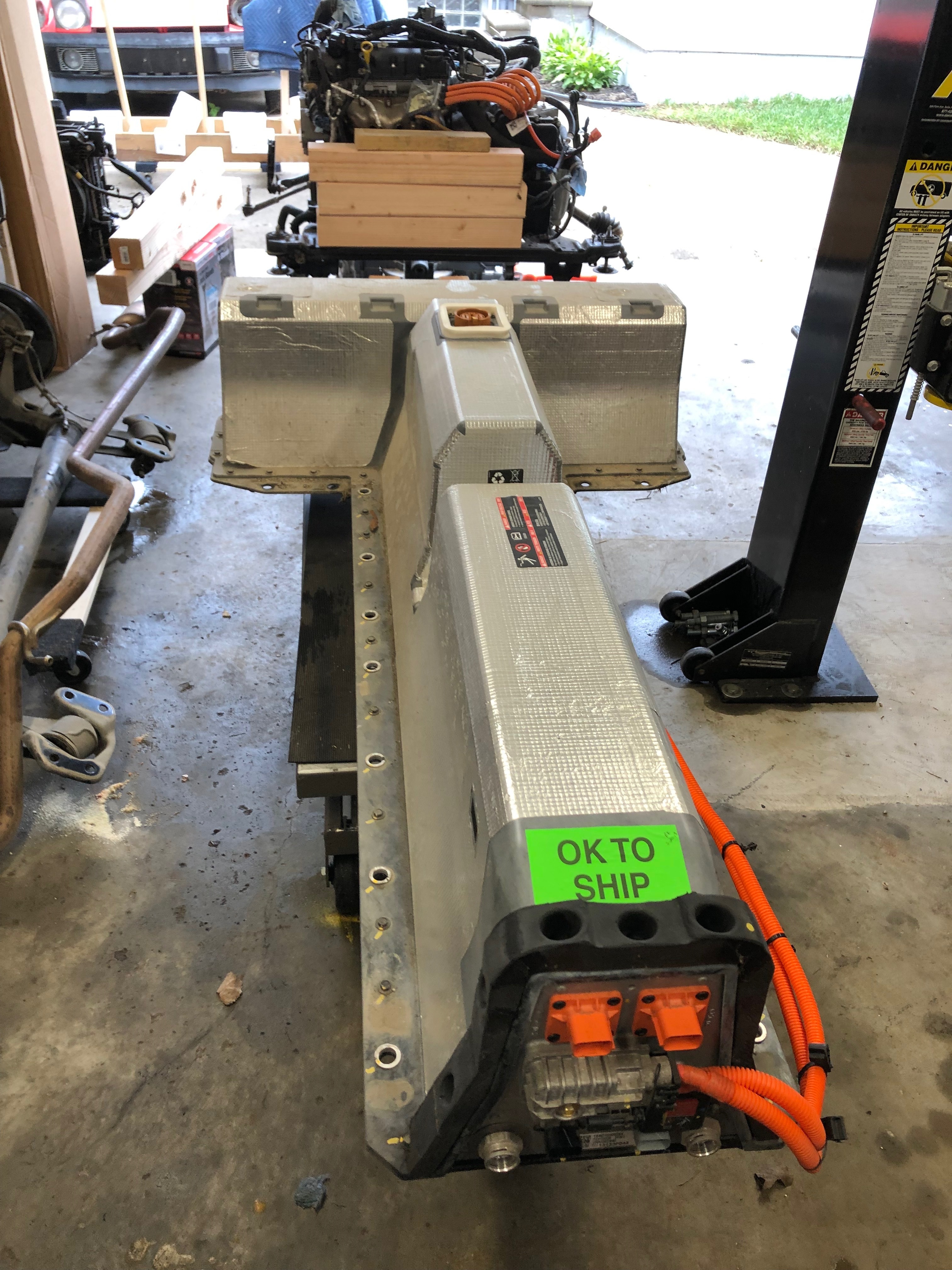

Battery dropped as well. Time to get the shoe horn out.

Are you running the Volt generation unit also? I would be down with that one. I have only seen one but there is a volt running around that has a diesel powered generation unit. Last time I saw it pop up, it was getting a true 126 Mpg, think diesel locomotive, very same concept.
As for all the stuff, all he needs down the center tunnel is the batteries, everything else can be ran out the logs if need be. A 5 gallon fuel cell will get you a pretty far piece as the volt is a hybrid, and the Bolt was the true electric.
Best of luck with the build, your resume suggests you can work out the drive sync issue with a bit of software and a controller. Couple of wheel sensors or flange sensors and you could sync them up no issue.
BTW if you look at two builds on here your center tunnel should not be an issue, and you will actually increase rigidity if done correctly.
