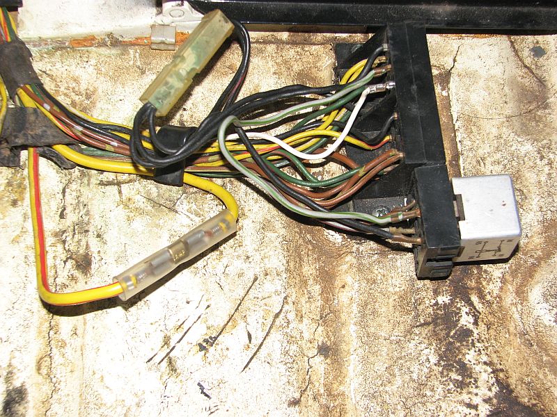

I bought a used OEM switch from @Bdstone and keep it in my glovebox. Heard too many bad things about the aftermarket switches. You might check the voltage on the yellow wire going to the starter solenoid. Disconnect it and turn the switch to read. Does tapping on the starter with a hammer make it work. Or does jumping the terminals on the solenoid make it work?

Had same problem, went through a few switches. Problem turned out to be an intermittent short on the fuel pump wire, had a bare spot that would sometimes rub against metal. Found it when it completely shorted out, not sure why the fuse didn't go before that.

is the yellow wire under pass seat , bypass mode,,connected directly together..

I had the exact same problem with my '74. Sometimes it would crank and rather frequently you'd hear the pump run but the starter wouldn't engage. I pulled the ignition switch, and wouldn't ya know it, the back of the housing was cracked.
Purchased a new switch, installed it, seemed to work fine and then shortly after had the same issue. Pulled it out, and hey, it's slightly cracked again. WTF.
Installed a second new switch and it had the same behavior. This time I decided to hunt around and found that if I wiggled the relays under the passenger seat while holding the switch to "START" I could get it to crank.
Do exactly what "sixnotfour" posted. Bypass all the seatbelt interconnect BS and I bet you'll be on your way. If not, it could be a bad starter solenoid. I'd say ignore any cracks in the ign switch housing for now until you confirm nothing else is causing the issue.

Thank you, everyone, for the replies and ideas! I had been reading quite a few threads in various places about things to try. The starter and solenoid are good. I don’t have the seat belt sensor under the passenger seat, since it’s a ‘73.
is that confirmed

Since I'm a cheap 914 SOB I just wanted to make sure "genuine" ignition switches are the only way to go. Looks like there's roughly a 5 times price difference compared to the aftermarket switches. (I do plan on using the relay.)
My switch was working but I found this when I took it out.
