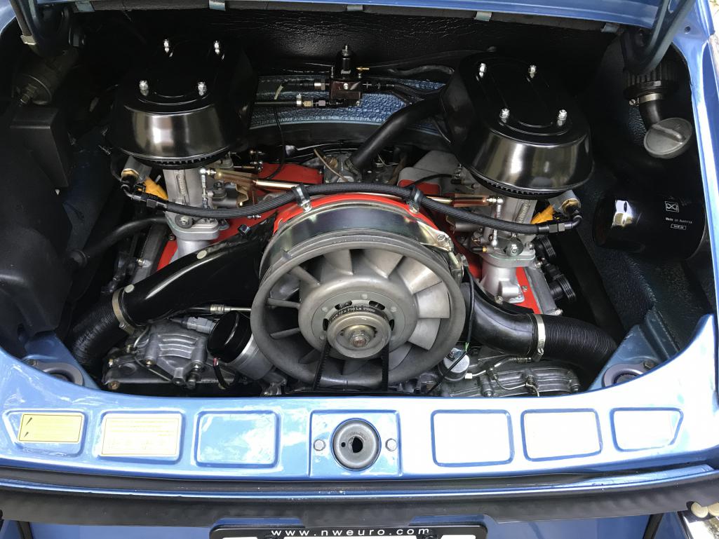

Send member adidas a PM. He is working on my ‘72 914 with CIS 2.7 right now. He can probably take pictures for you.

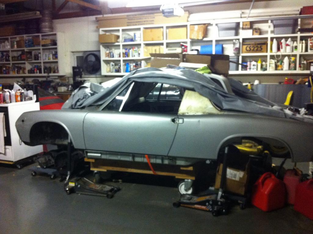

Well, I repaired the passenger side outer longitudinal with a replacement part from RD and all went fine so I'll continue on with this car. I was surprised with the absence of rust inside the the box section that I replaced. I still need to grind down my plug welds. In general, this car is mostly rust free, but it had been in at least a few crashes.
It does measure out, according to the workshop manuals.
Now I get to proceed on to re-fitting the 75 front fenders and back dating them as well as modifying the miscellaneous reinforcements for the front trunk (the front panel is obviously different from the earlier cars that I have).
Does a stock 2.7 need a front cooler? I'm not sure, but if it needs one, I may want to mount the lines like a GT on the drivers side under the rocker panel. My last conversion, I went through the heater tubes as it has headers and no heat anyway, but now some folks seem to offer heat exchangers for conversion cars...

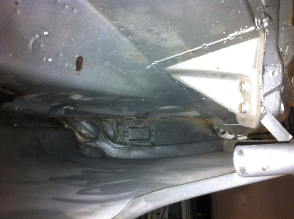

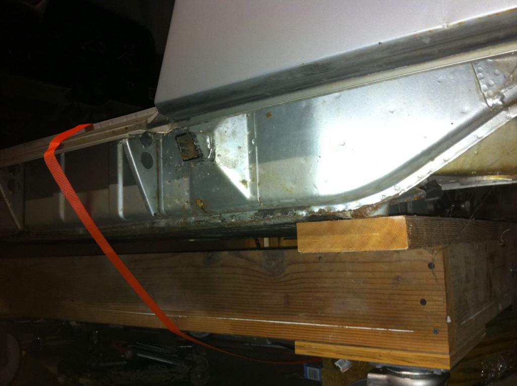

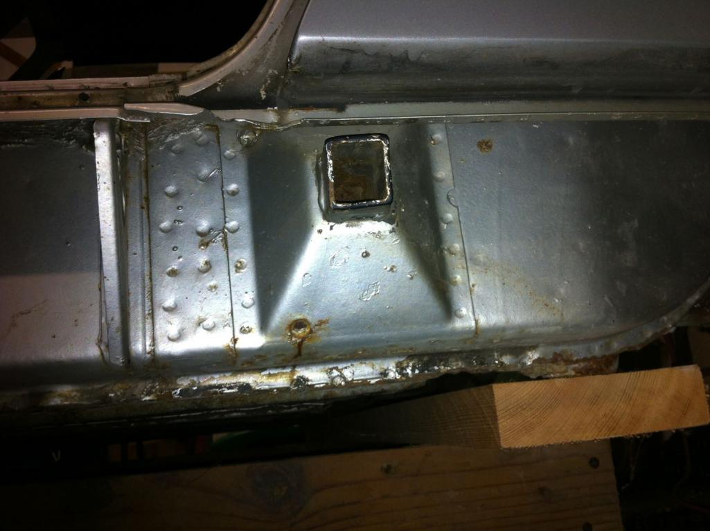

A couple of pictures of what I'm dealing with...

Were all 914 Bodies painted white before color was applied?
I had heard this rumor a long time ago and believed it to some extent, but now with this current car, I believe it even more.
I was cleaning the glue off of the sail panels with glue remover and the 45 year old glue is coming off after some effort. Under the glue is glossy original paint down low on the sail panel, but the higher up I get, the silver fades away and I'm left with gloss white up at the top of the roll bar. I'm fairly certain that the white is factory applied paint, but was the whole car painted white first or just the upper portion of the roll bar? Why would they have done this, just to keep them from rusting prior to actual color application? This 914 shell has the most in-tact original paint that I have started a project with. I'm so glad that this one really has nearly zero rust to deal with.
I'm guessing this topic is already covered somewhere, but I can't seem to click on the search function today.
