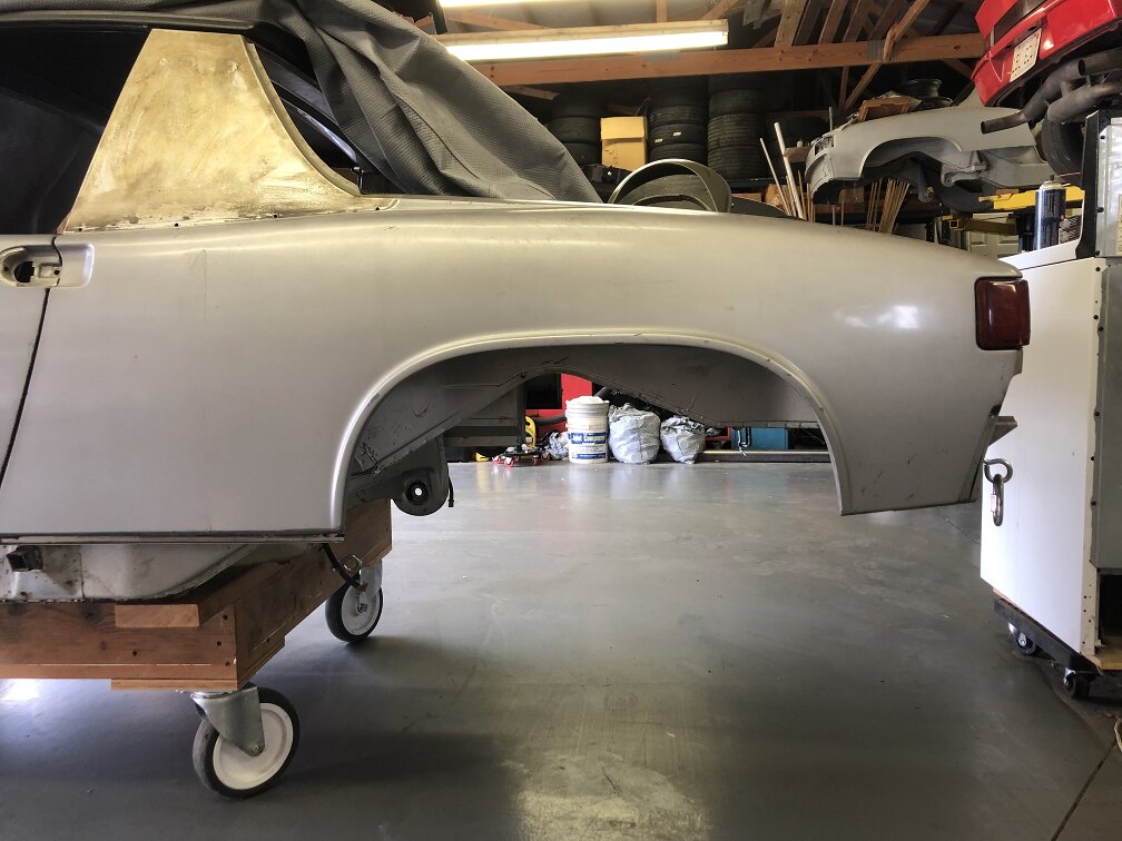

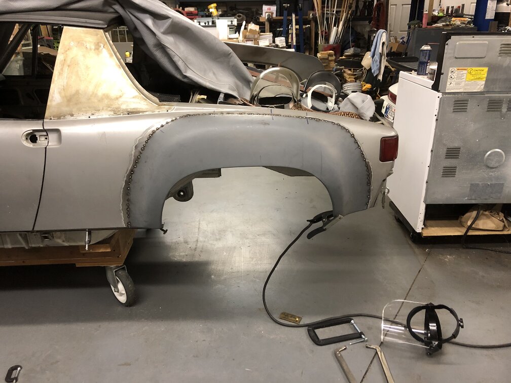

Started doing the flares thing on this car.
Before:
After:

Thanks for the update.
Where did you source the flares? Happy with the fit?

QUOTE(Tdskip @ Sep 25 2020, 05:20 AM) *
It's been so long ago, that I forget who I bought them from (it was an individual). I've had these for around 15 years. They were pressed out on the dies that AA and RD made around the time I bought these.
They fit well.

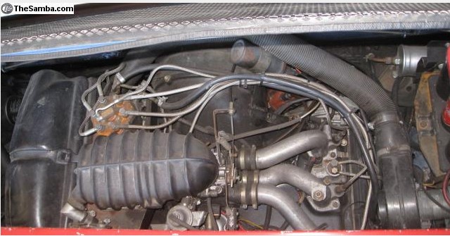

CIS is a better choice than most give it credit. It's very simple mechanical fuel injection only needing one electric pump. The 914-6 I bought was converted using a 2.7 with CIS. The PO turned the airbox 90 degrees instead of leaving alone. It's....interesting and gets in the way of the spark plugs. When I go to paint the 914, I'll pull the engine/trans and put things to a more stock or traditional position.

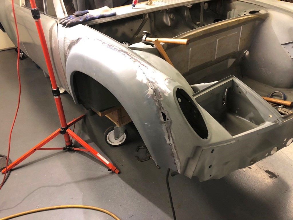

Anyone know or remember a member here REZRON? This tub was bought from him way back in 2005 and sat for many years (in my Dad's garage until 2016). It was supposed to be a tub from CA and had some damage to the passenger side long, and I knew both front fenders had been replaced and the passenger side wasn't attached. The hell hole is solid, and most of the rear end is rust free and original paint underneath.
The doors fit well enough (better than most I've seen). I replaced portions of the passenger side long after pulling the pinch seam back straight.
I started on the rear flares and all went well, so I moved to the front. Ran into issues in the front that I wasn't aware of. I knew the passenger side fender was not attached which I didn't mind, and I knew the drivers side had been replaced. What I had failed to notice was that the underside of the bottom of the front trunk was badly beaten up. The inside of the front trunk appeared straight.
Someone had used filler to flatten out the inside of the front trunk and failed to straighten out the sheet metal or even paint it during some repair at some point. I found this when beating out a dent inside the passenger side front inner fender and the bondo popped. Bad on me for not checking until now. I recall that REZRON was supposed to have been a a body shop person. Looking back, I should have known, but still makes me mad as there wasn't disclosure about the floor of the front trunk, the bulkhead in front of the gas tank and the area between the bulkhead and the firewall in front of the passenger compartment. After searching the threads and reading some of his threads from 15+ years ago, there were indications that someone in the past had performed some poor repairs in the front, but wasn't made clear at the time of sale. Luckily, this thing was cheap and it isn't rusty.
Many hours later (and much frustration), I have removed all the plastic filler in the front trunk, used a hammer and dolly (and other straightening devices for many hours and days) to straighten the floor, bulkhead, inner fenders, and area between the bulkhead and the firewall. Pretty sure I invented a few new phrases for DAPO's.
I have checked and verified the suspension pick-up points to be accurate and I can now proceed to re-attaching the passenger side front fender, and completing the flare installation. Restoration Design has some new pieces that I plan to purchase including a new gravel pan (bottom cover plate for steering rack). I hope to post some pictures of progress soon.

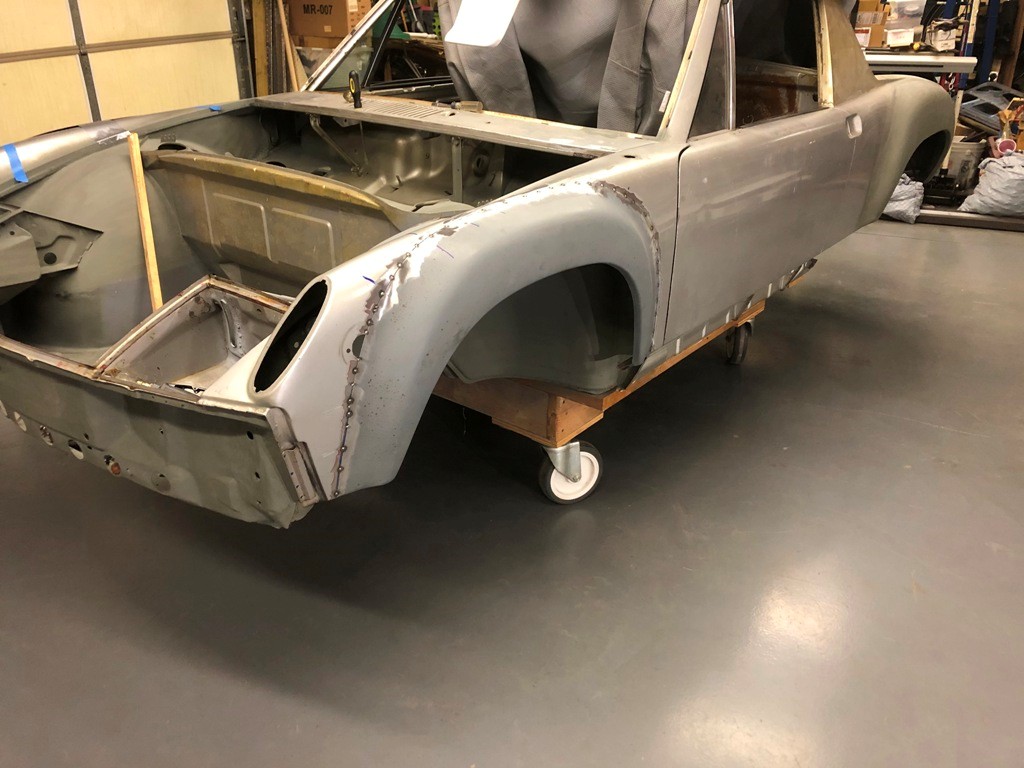

So, nobody knows Rezron. Hmm. Anyway back to the project....
I have attached the passenger side fender and resumed tack welding the flares onto the front end. I have a few more sheet metal warps to work out, as well as a few more areas to give my attention, but I think this tub will be fine after the TLC that I am applying. I will eventually need some aluminum trim (roll bar and windshield frame) and possibly some early chrome bumpers to finish this thing (hint, hint... wink, wink, nudge, nudge, say no more).
