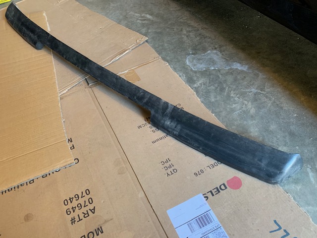

I'm going to need a new front bumper top from 914Rubber, but I'm hoping to save the rear one. It's in really nice shape but it looks dirty, dull/faded (see pic below). What's the best way to bring it back to looking its best?

I have had luck with 150, 400, 600 sand paper then “back to black”.

Wash with dish detergent then Vaseline and leave it in the sun for a bit. Buff with soft cloth.

Those are two interesting, and quite unique, approaches. I’ve previously used back to black and it has worked well initially but not held up very well. But that was on a harder material. Would the Vaseline method last longer?

Depends if it's a garage queen or daily driver. Just re-apply as needed.
If the vaseline doesn't work, you can always sand but might as well try easy, first.

Rub glycerin into it. It requires reapplication from time to time, but its not petroleum based so it will not deteriorate the rubber.

Hot water and soap. Wipe with acetone. Shoot with penetrating vinyl dye.
You should keep most of the texture. Really a matter of cleaning opening up any pours, and the vinyl dye will make it a satin color.
This is if the rubber is not too far gone. If it’s wavy the internal structure is failing. You can still use it, but it’s a matter of time.

Thanks to all for the ideas. I’ll weigh my options. I don’t see the VHT vinyl dye locally but I do see Duplicolor vinyl and fabric paint. Does anyone know if that’s the same as vinyl dye (i.e., is vinyl dye a paint)?

After the sanding, one of the best detailers on the east coast who is a friend says this is the best stuff there is:

The cleaning and prep is the key to a longer lasting solution,used the Duplicolor and it lasts 3yrs or so if not applied to a clean surface it starts to degrade in about 18 months.
The sun here in NZ is rather vicious.
I would stick with a product known to be suitable for bumpers,good luck.
