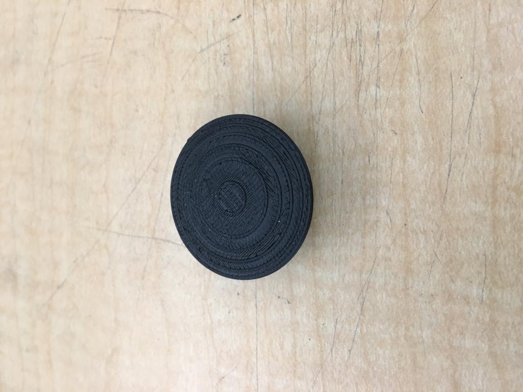

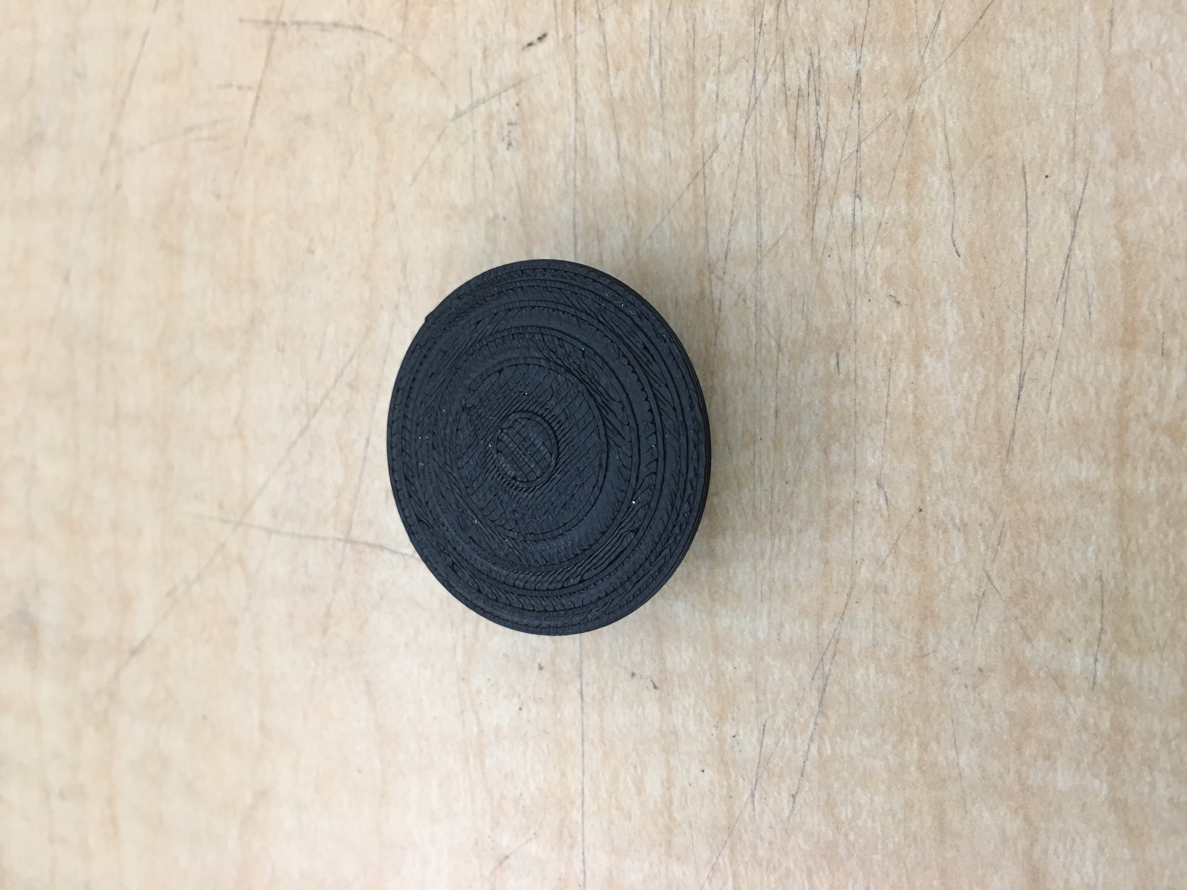

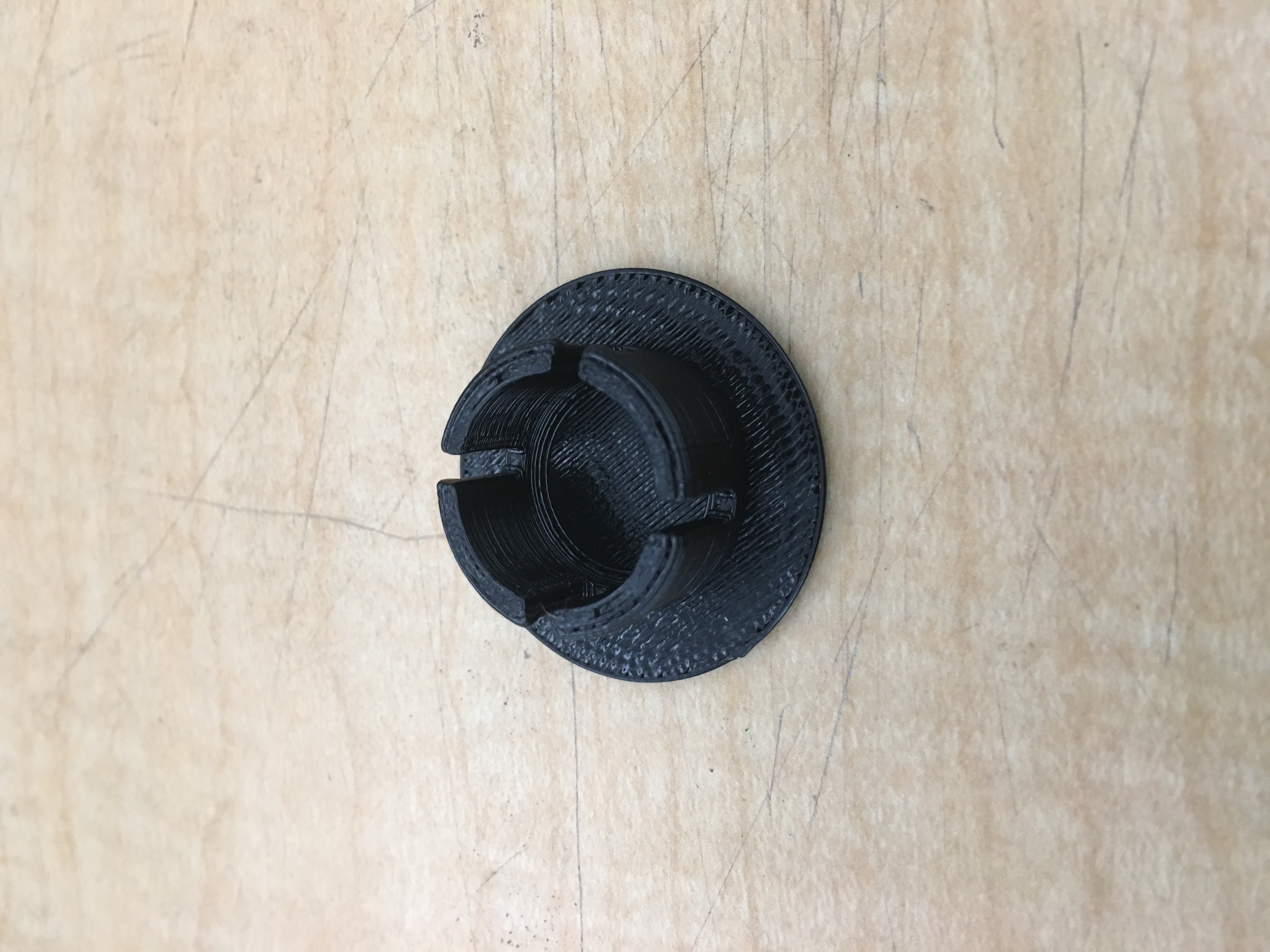

Hi All,
Would like to see if someone with a '75 or '76 could pull the plug out of their rear bumper and take a couple of pictures for me. I 3D printed a version (pictures attached) but would like to see what an original looks like.
Thanks, Rob

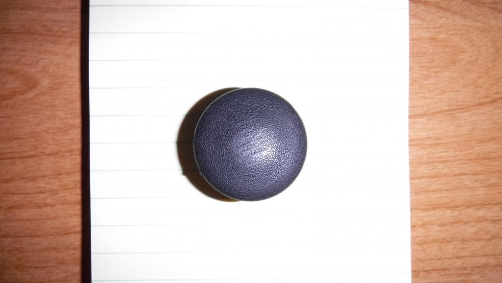

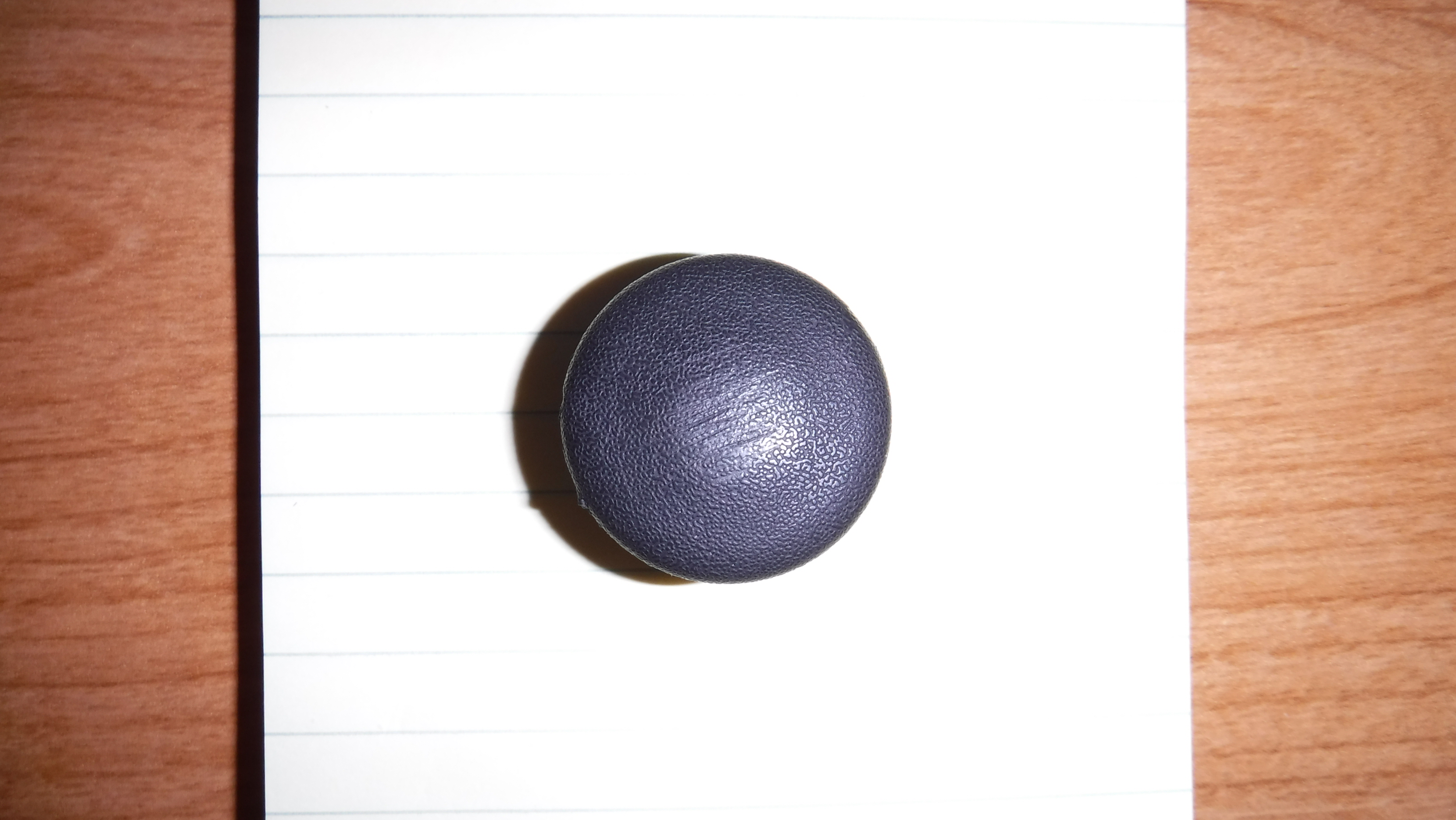

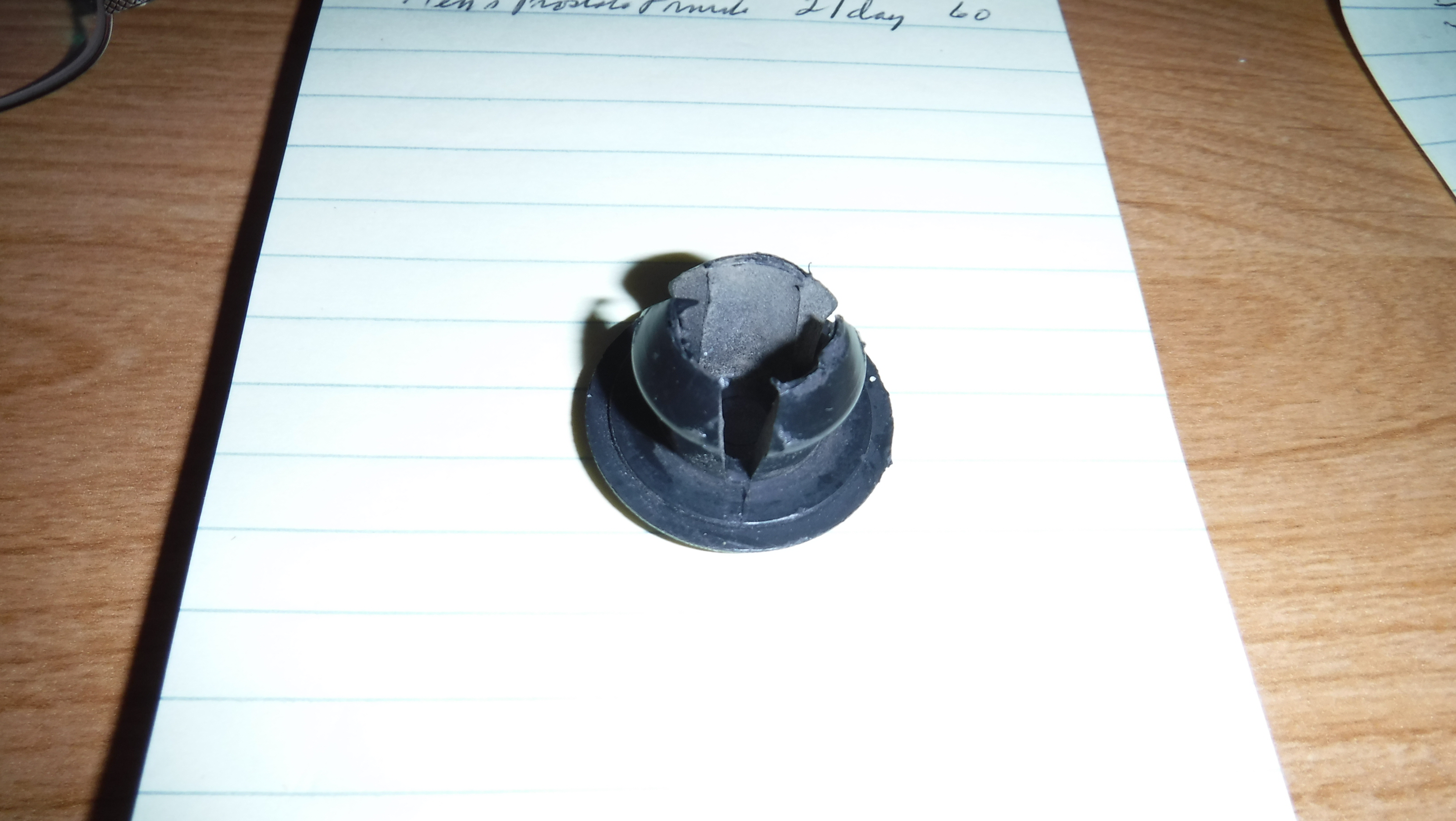

Here you go (76):

Awesome thanks

EDIT: Sorry, we have the natural-color nylon Tow Hook Plug 914 722 107 10 which can be painted black prior to installation, but it only fits 1970-74. The black color Tow Hook Plug 914 722 107 11 for 1975-76 is smaller and is NLA.

The 70-74 tow plug in the bumper is actually larger than the 75 76 We make the chrome plug, which is a good item but the late one can be substituted with the later 911 part
