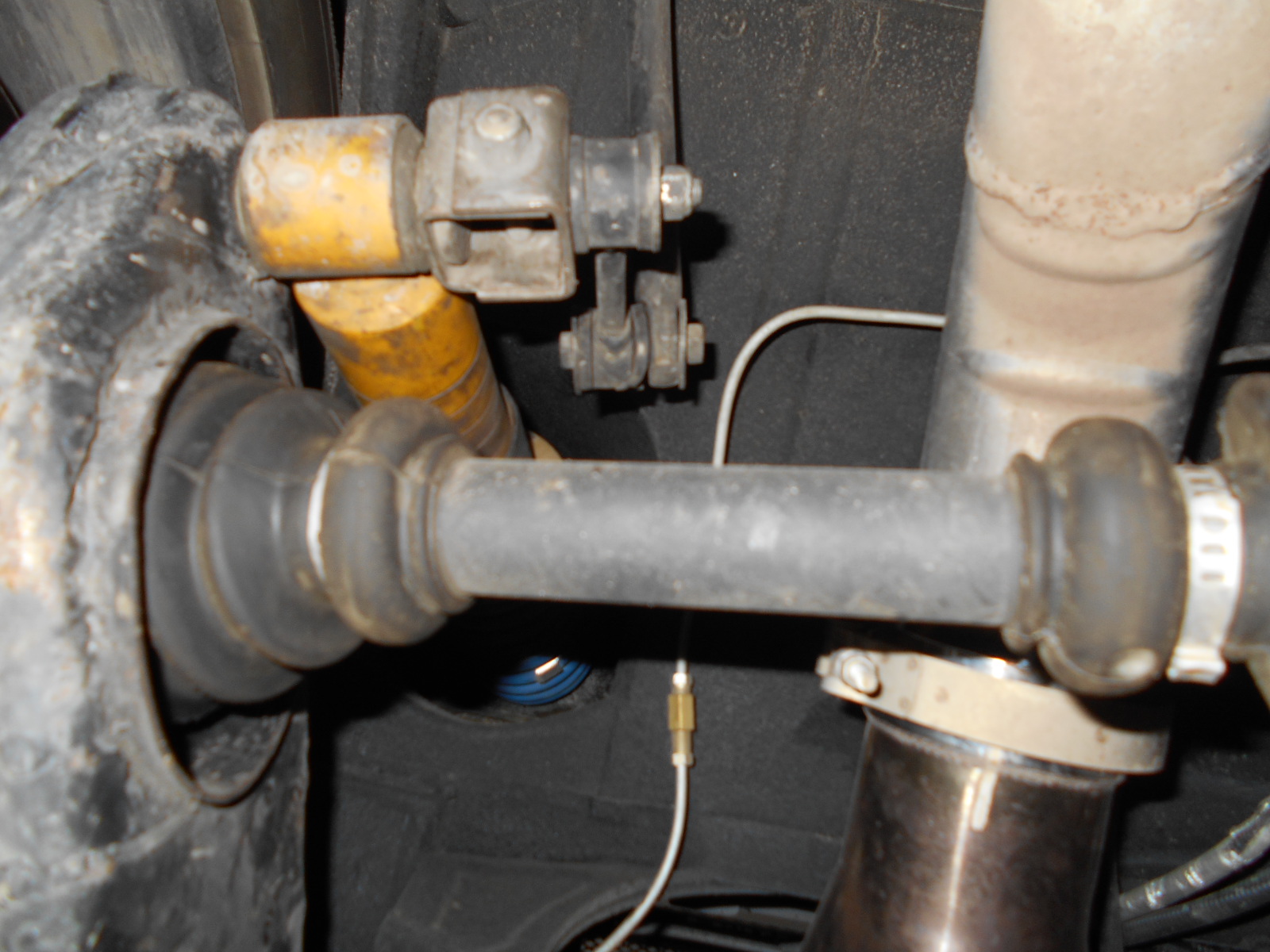

QUOTE(partwerks @ Sep 8 2019, 04:21 PM) *
From my trans to my wheels, my axles go uphill at a 10 degree slope. Is that too much?
They angle forward a bit also, but it don't appear to be that much.
Something else just came to mind (IMG:style_emoticons/default/idea.gif) ... I'm wondering if you'll need to shorten the axles once you raise the trans upward (IMG:style_emoticons/default/confused24.gif)
What happens when you lift the car? ... is there any binding on the axles when the trailing arms move downward?

QUOTE(partwerks @ Sep 12 2019, 05:05 AM) *
I wonder if the adapter plate could be made with an offset, so it could come up higher?
Possibly.
Hard to tell how much 'wiggle room' you've got from the pic angles we're seeing. How much room is there between the sides of the trans in relation to the mounting points?
Also, measure the clearance above the trans to determine how much it can move up.
See if something like this will work for you. Modify the existing bracket to lower the mounting points on each side of the trans while leaving enough clearance that the top of the trans doesn't hit the trunk floor.

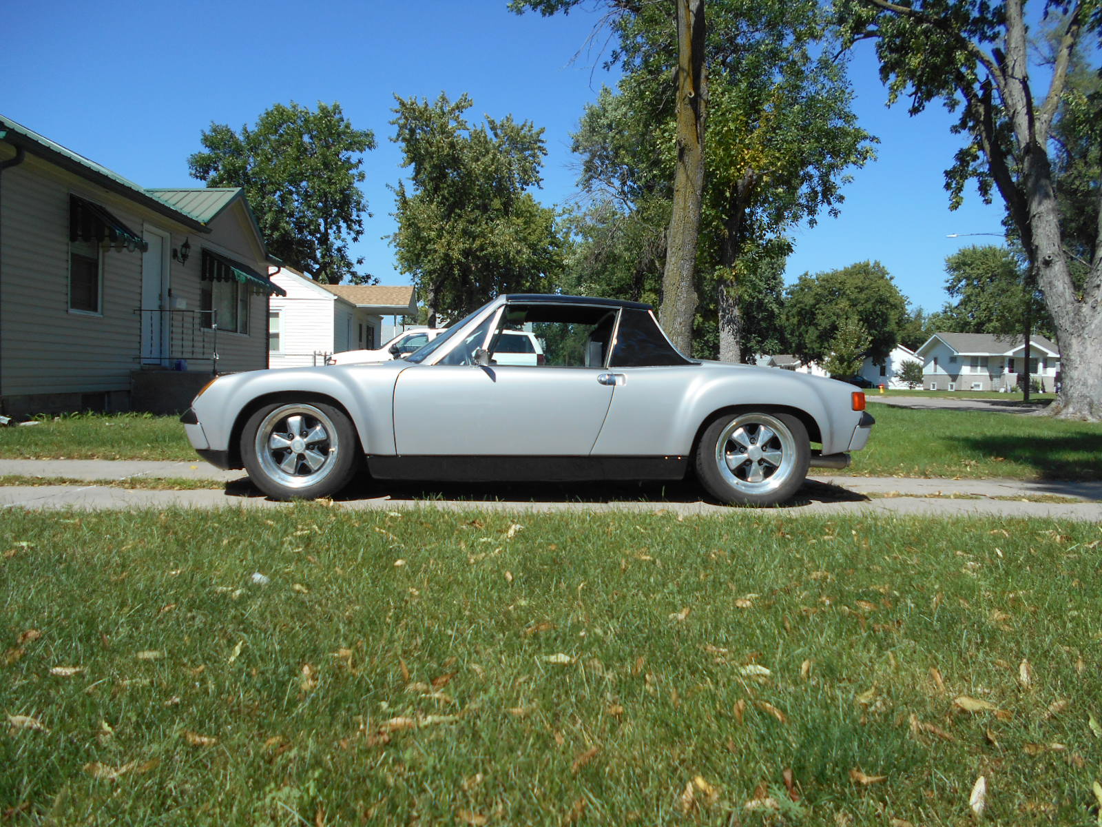

Can we get a pic of the side of the car to see how low you are?

partwerks
post Sep 15 2019, 05:47 PM
Post #34
Posts: 1,642
Joined: 7-September 06
From: Grand Island, NE
Member No.: 6,787
Andyrew
post Sep 15 2019, 08:15 PM
Post #35
Spooling.... Please wait
Posts: 13,381
Joined: 20-January 03
From: Riverbank, Ca
Member No.: 172
It's low but I've seen lower. I say modify transmission mount.

It was originally Green, but the previous owner had it black. This one replaced the 3.6 conversion I had stolen back in 2006, and so I had it painted a color I like.
