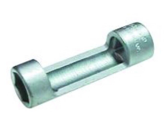

What's up guys. I've recently installed the oil pressure relocation kit by 42 Designs. Is there a best method of tightening the threaded line with the engine tin on? My last attempt was with a 'crows-foot' wrench attachment which was too large to fit down the tin hole.
Is there a specialty tool similar to an O2 sensor wrench that doesnt interfere with the line?

You could try one of these. They come in various sizes used for Audi/VW shock nuts.
They were designed to allow the use of a allen wrench to hold the top of the shock, while you undid the shock nut.
The other thing you can do is buy a cheap socket and cut a window in the side of the socket with a hand grinder or Dremel tool.
(IMG:http://www.914world.com/bbs2/uploads_offsite/i.ebayimg.com-20561-1567996357.1.jpg)

That tool looks it could possibly work. I could use a set of pliers to clamp down on it. Thanks I'll look into this.
