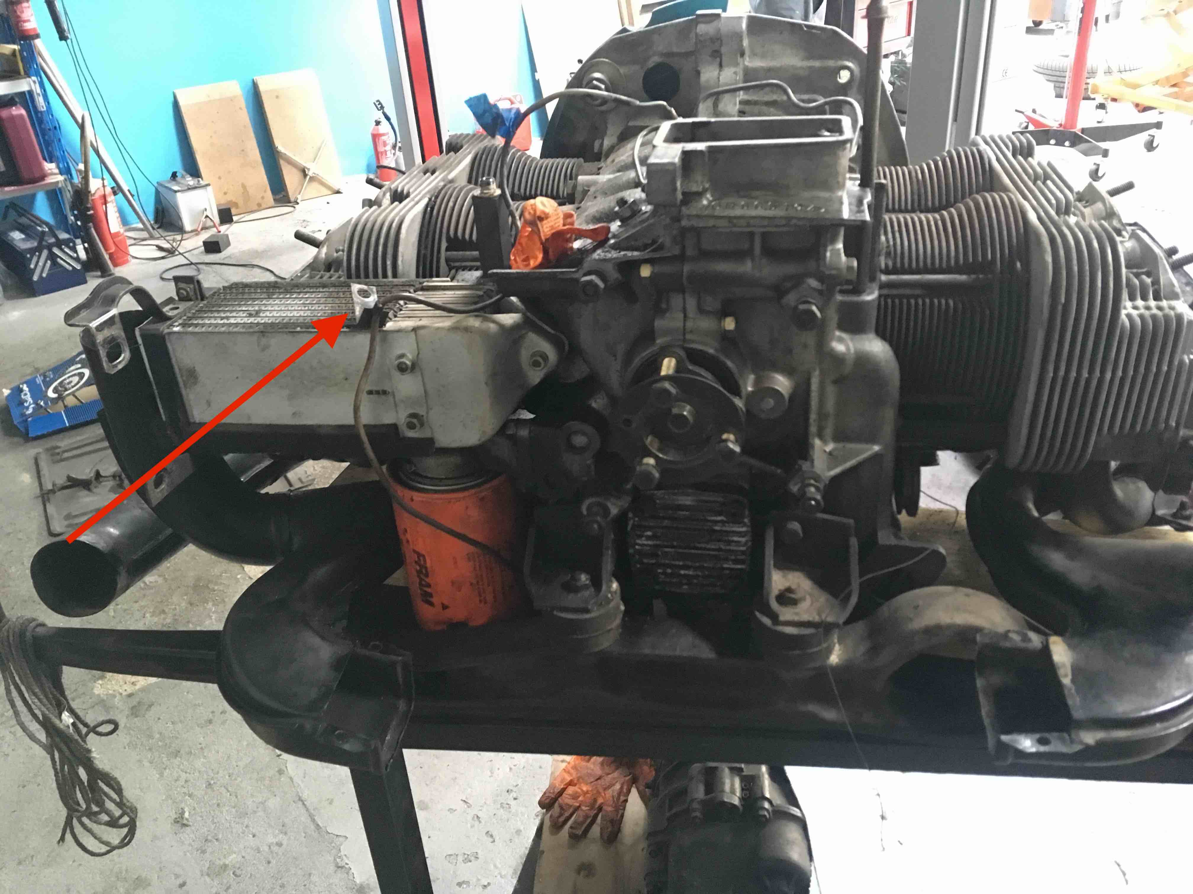

Bonsoir, I need some help to re-find the wire way for the oil temp sender.
Thanks

That's the wire that comes from the taco plate under the engine. My '71 did not come with an oil temp sender so I ran the wire over to the alternator wires to the top of the engine then tie wrapped it to the wire bundle from the engine to the relay board. I do not know how the OEM wire route was done.

The sheet metal wire tab goes on the side of the fan housing
