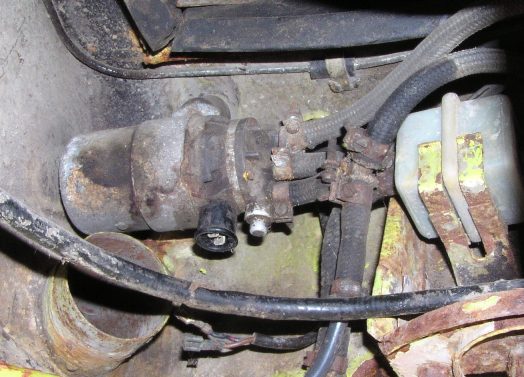

I had a rare leak in the plastic tunnel lines. I replaced with Tangerine Racing stainless steel lines. Don’t drive your teener until all leaks are repaired.
Seeing the picture from above post is just amazing. Same original cloth lines! Yikes!
