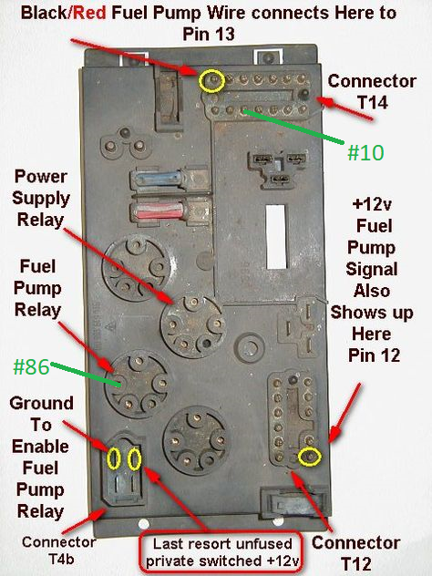

Using some tips from some other threads, I checked the voltage on Pin 14 with key off and pin 8 on the connector with key on. In both cases I got 12 V as I should.
I also checked continuity from pin 10 on the board to pin 86 on the FP relay socket, but got no continuity there on any of the boards which I have.
It still seems odd that I could have 3 bad relay boards. I've attached an image that I found in one of the threads. I've added my own notes in green for the locations of pins 10 & 86. Assuming that I've got that right, is the lack of continuity the problems with my boards?

Is your fuel pump fuse OK? (91) in the pic below.
Also note that pin III seems to be directly connected to 86 on the fuel pump relay.

QUOTE(SirAndy @ Sep 18 2019, 12:12 PM) *
Yes. I have continuity between pin III and pin 86. The fuel pump fuse has been confirmed to be good.

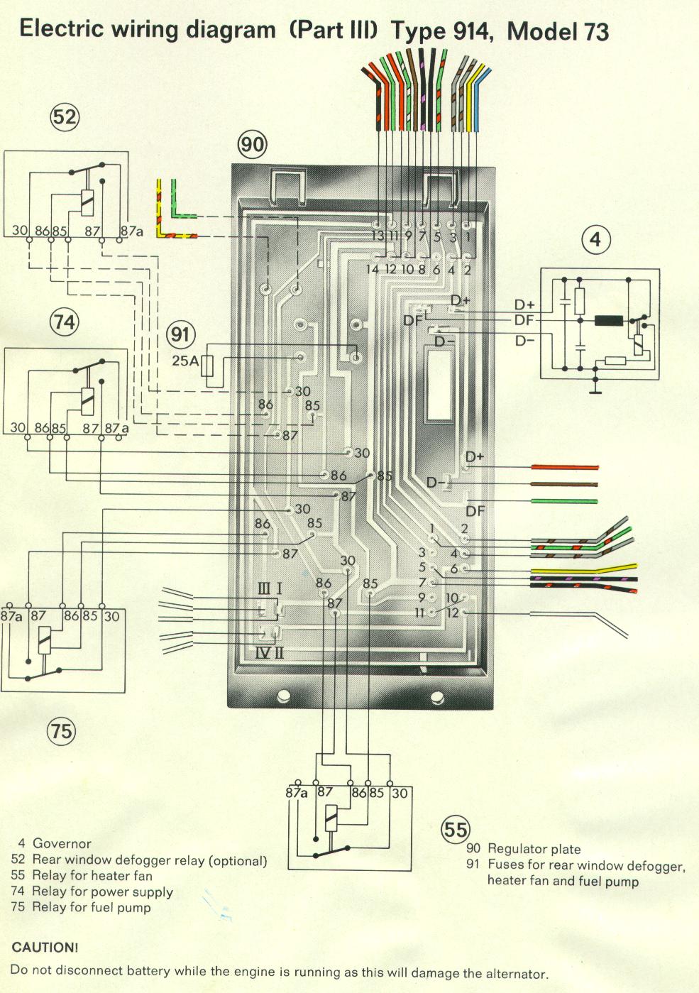

It works again!
After reviewing the diagram, I decided to check continuity between pin 10 and pin 86 on the Power Supply relay (75). It checked out.
At this point I plugged in all the relays and the 14 pin connector and tried it again. Much to my surprise, the pump ran like it was supposed to and the car started and ran just fine.
I'm thinking that I just had a loose connection all along. I'm suspecting that it was something in the 14 pin connector, but I really don't know how to pin that down.
