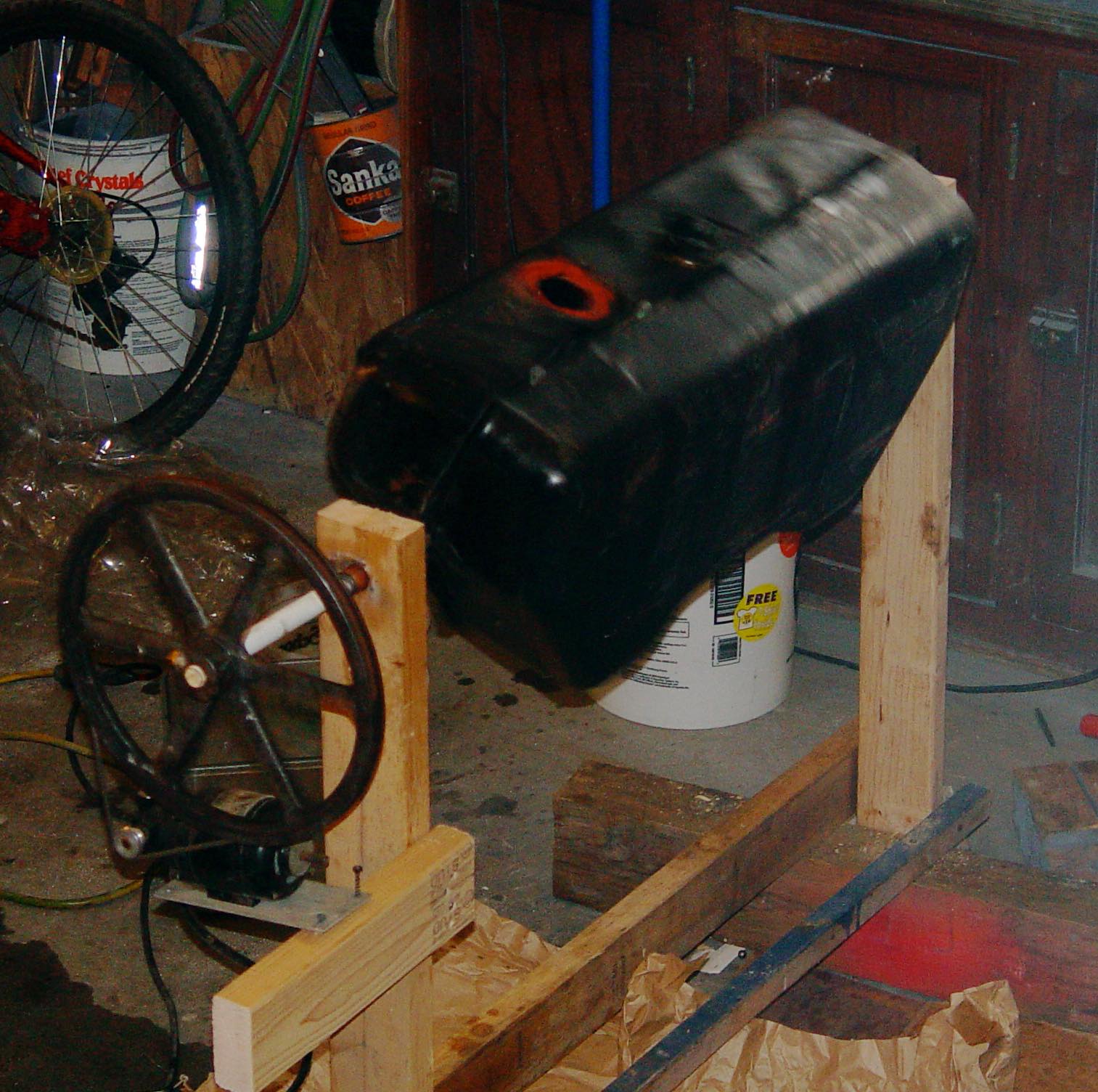

I show this every so often
The filler hole is covered with a disc of plexiglass screwed on with the normal screws sealed with RTV. Tank is filled with phosphoric acid, chain lengths and bolts. Count the pieces as you put them in so you are sure to get them back out. Have done this with three gas tanks. Didn't seal because I don't know how well the sealer works: does undercoating prevent rust?
Makes one hell of a noise. Can substitute gear motor or electric drill to drive the rotisserie. Or use the gear motor from an old bar b q rotor.

This is genius. (IMG:style_emoticons/default/evilgrin.gif)
