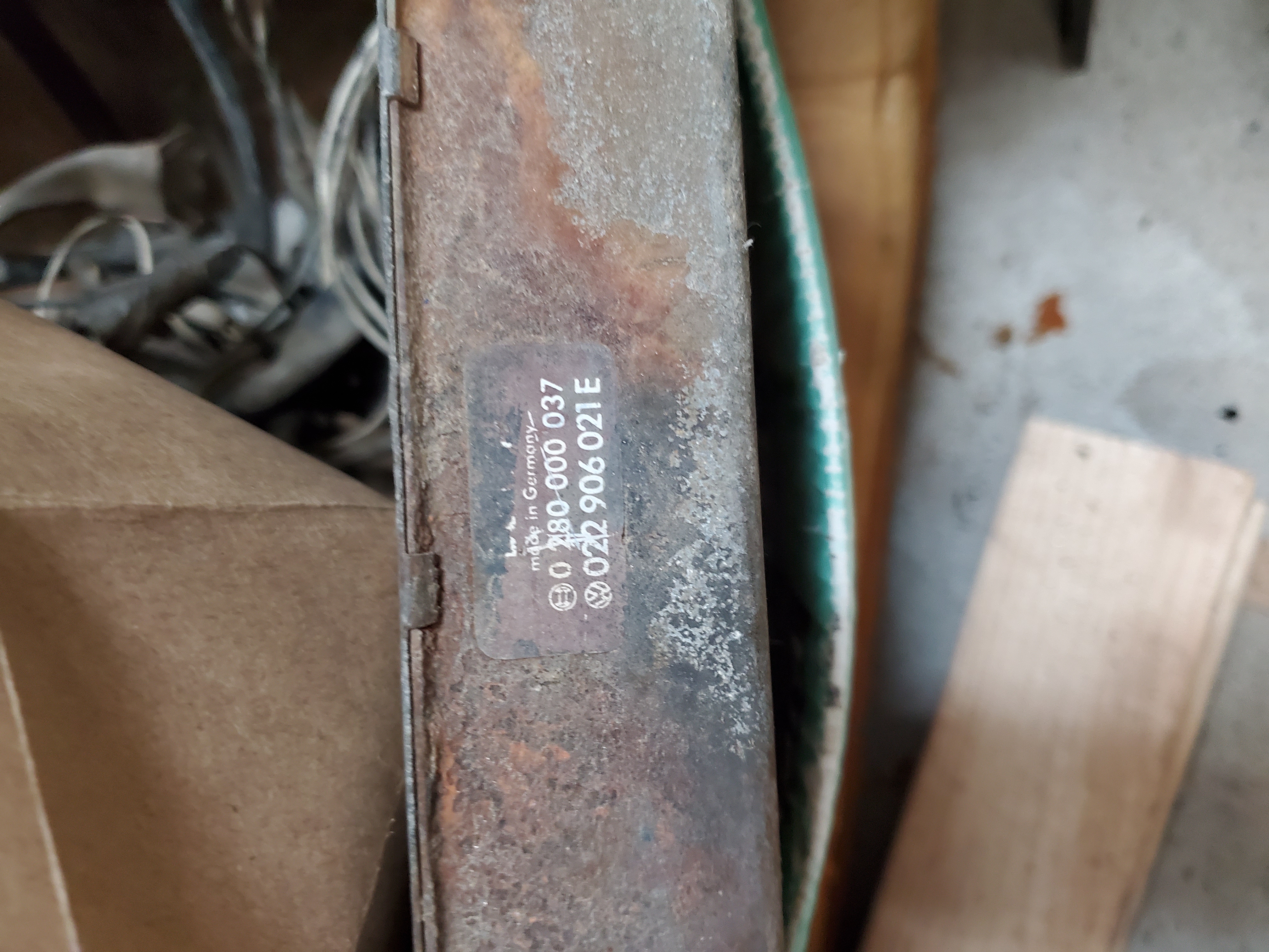

The next set of numbers (the file is too big and wont let me post) is 022-906-021 B
And under the Bosch logo is 0280-000-015

your picture shows a ECU from the D-jetronic your car has original a L-jetronic .

The 037 ECU is correct for either a 1973 1.7L or 2.0L engine. Engine swap from the original 1.8L?

The ECU you show looks like it has been wet for a long time.

QUOTE(JeffBowlsby @ Oct 2 2019, 03:12 PM) *
No these are spares we have for the car. So should I invest in a new ECU?

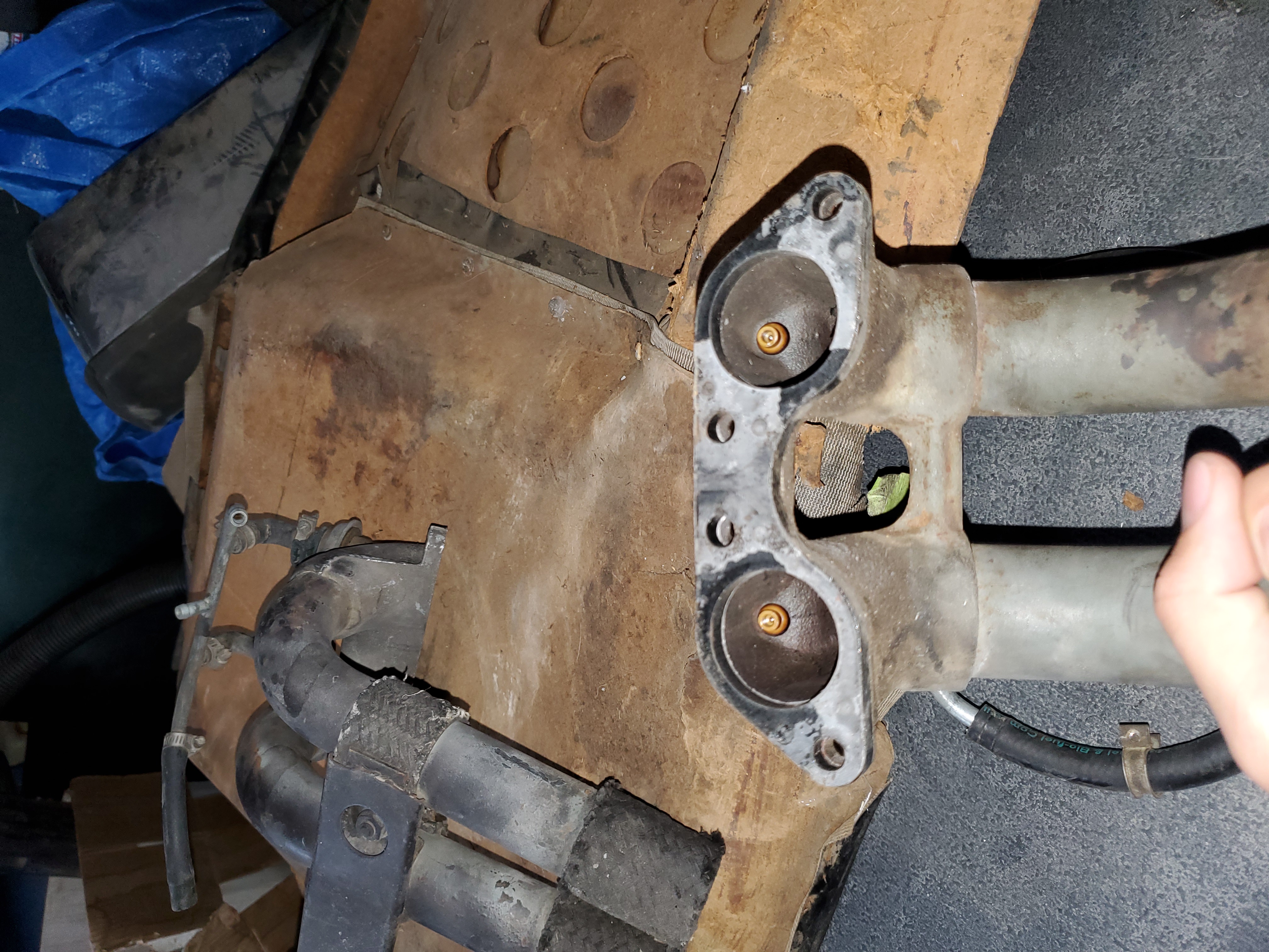

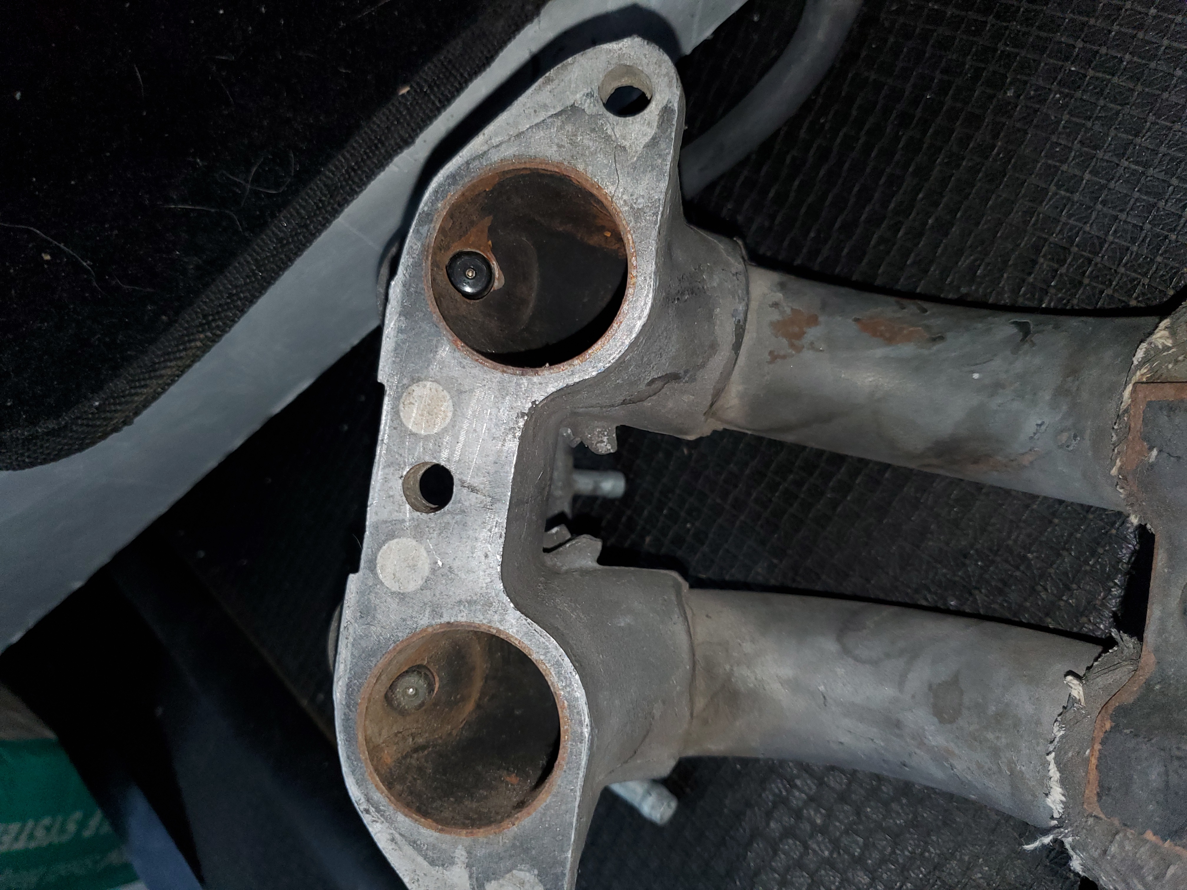

Do you know if you have an L-Jet system or a D-Jet system? If you don't know, just post some pictures of the rest of the EFI system and we can tell from them.

QUOTE(ClayPerrine @ Oct 3 2019, 01:46 PM) *
I actually have both systems. Just dont know which to use. I'm rebuilding the car after some serious fire damage

Yes. You can not hook up an L jet ecu to a D jet harness. Completely different systems. Many other differences. Do you know what parts are D jet and which are L jet? If not post pictures of what part you have.
