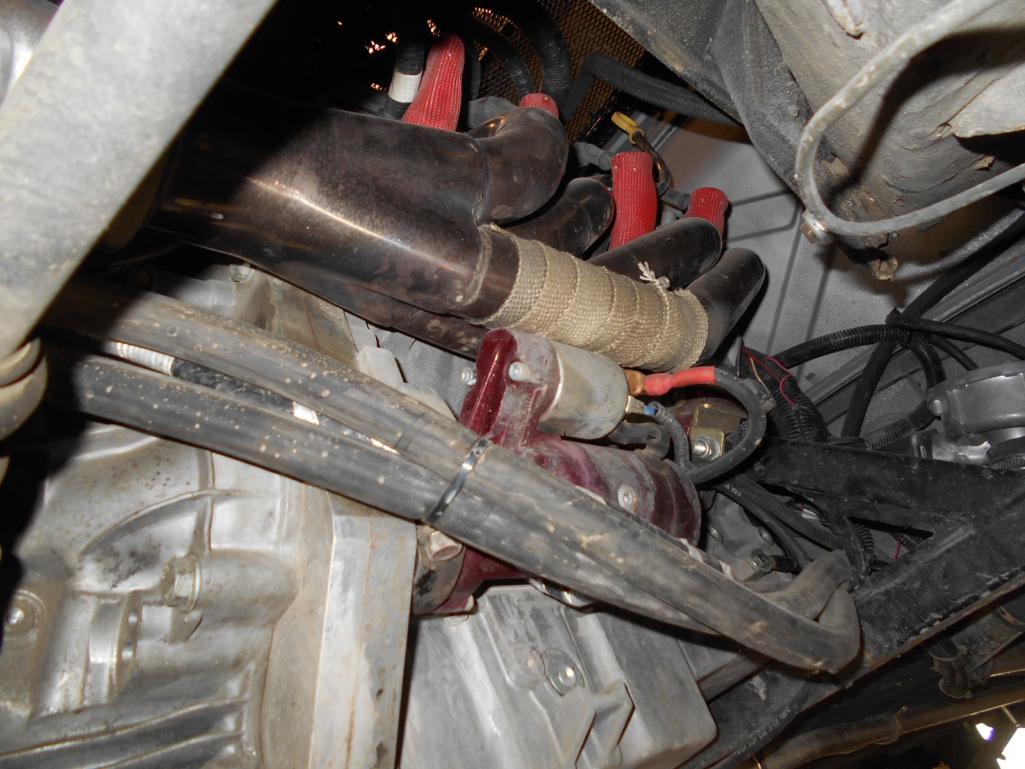

QUOTE(914forme @ Oct 8 2019, 05:43 PM) *
yes it has been done
These pictures are of a 6 speed version, but the 5 speed will use the same adapter plate and flywheel. (Subie)
I wonder, since the 5/6 can both be used on that adapter plate I have then.
Would the starter on the 5 be in the same postion as the 6?
