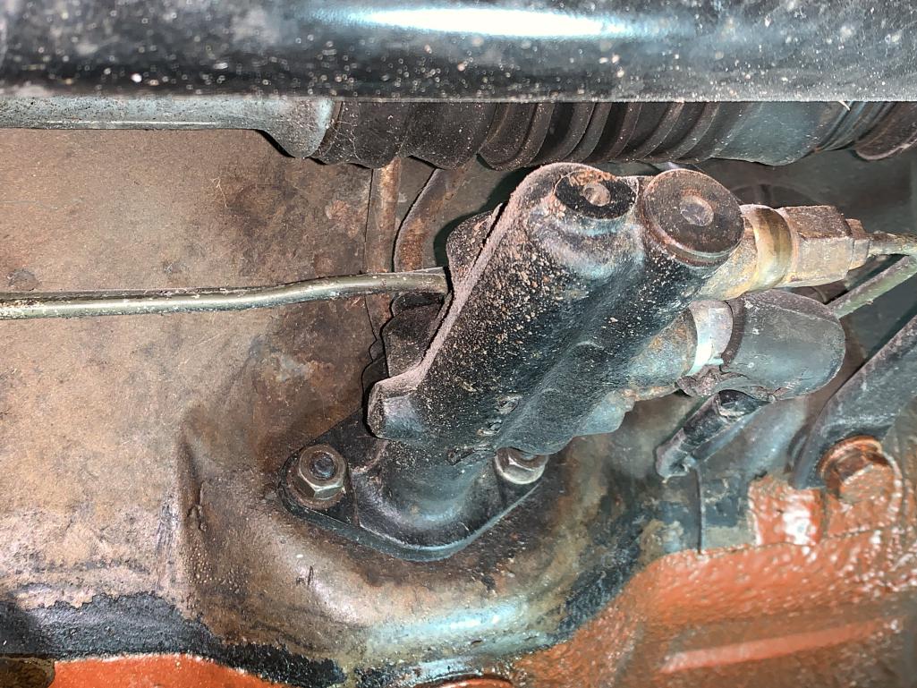

After returning from Okteenerfest the car sat a couple weeks, and after taking it to Cars and coffee I parked it again but backed in and a few days later pulled out and noticed 2 small puddles , front at rear- cleaned it up them parked the car , then a few days later checked again and it’s for sure under front.
I was initially worried that I had a front crank seal when I thought it was from the back, and I am releaved that it’s not from the motor,
I did all that last year and am proud to say it’s been a leak free motor since then, and I didn’t want to pull the motor or trans.
BUT this is brake fluid, and I can’t really explain why this would suddenly spring
A leak (IMG:style_emoticons/default/confused24.gif) . I replaced all brake lines and the 19mm master cylinder about 3-4 years ago, no leaks no issues since then.
And I don’t have loss of pressure on brakes so I am assuming it’s the supply line so I guess I will be pulling the belly pan to investigate. Will post more info when I get a look just wonder why just now? I know the washer is there under the supply line connection, just weird this started now???

So last night pulled carpet and took a look under he pedal board and no fluid under the
Pedals and m.c. inside, so next is tonight I will try and get car jacked up and pull the cover to steering and m.c. . Btw brake pedal is firm with no loss of pressure so I am expecting to see a leak at the supply line - More fluid on the floor after it’s just sitting for a few days so it’s just leaking out from gravity.

You may need a mirror and flashlight to inspect the top of the master. My bet is a leak around the input lines.
A cheap cell phone endoscope is helpful to see into remote areas.

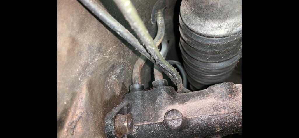

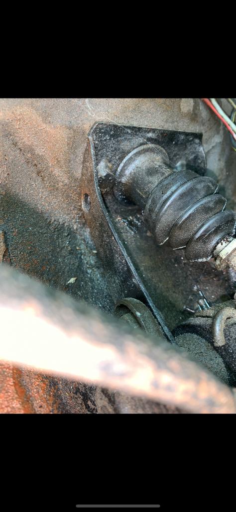

After closer investigation and looking outside at the supply lines tonight, seeing no leak from the master cylinder at the supply or the outgoing lines, I went back in to look closer, and yes there is fluid under the pedals cluster inside.... (IMG:style_emoticons/default/headbang.gif)
DRPHIL914
post Oct 8 2019, 07:22 PM
Dr. Phil
Posts: 5,828
Joined: 9-December 09
From: Bluffton, SC
Member No.: 11,106
Outside under MC and on top are dry, just wet at wall where Mc goes thru but really wet under at the low spot here pedal cluster bolts down to floor

Well lines coming down are dry , lined up fine- BUT Mc will be replaced before car is driven again it looks like but this MC was new less than 5 years ago- hey Eric Shea, is the still under warranty?

I'm certainly no expert but it sounds like it went bad. That's what kills the pedal cluster. Brake fluid on the oem plastic bushings.

It might just be the grommets which can be replaced. I would have a new master and a pair of grommets ready.
