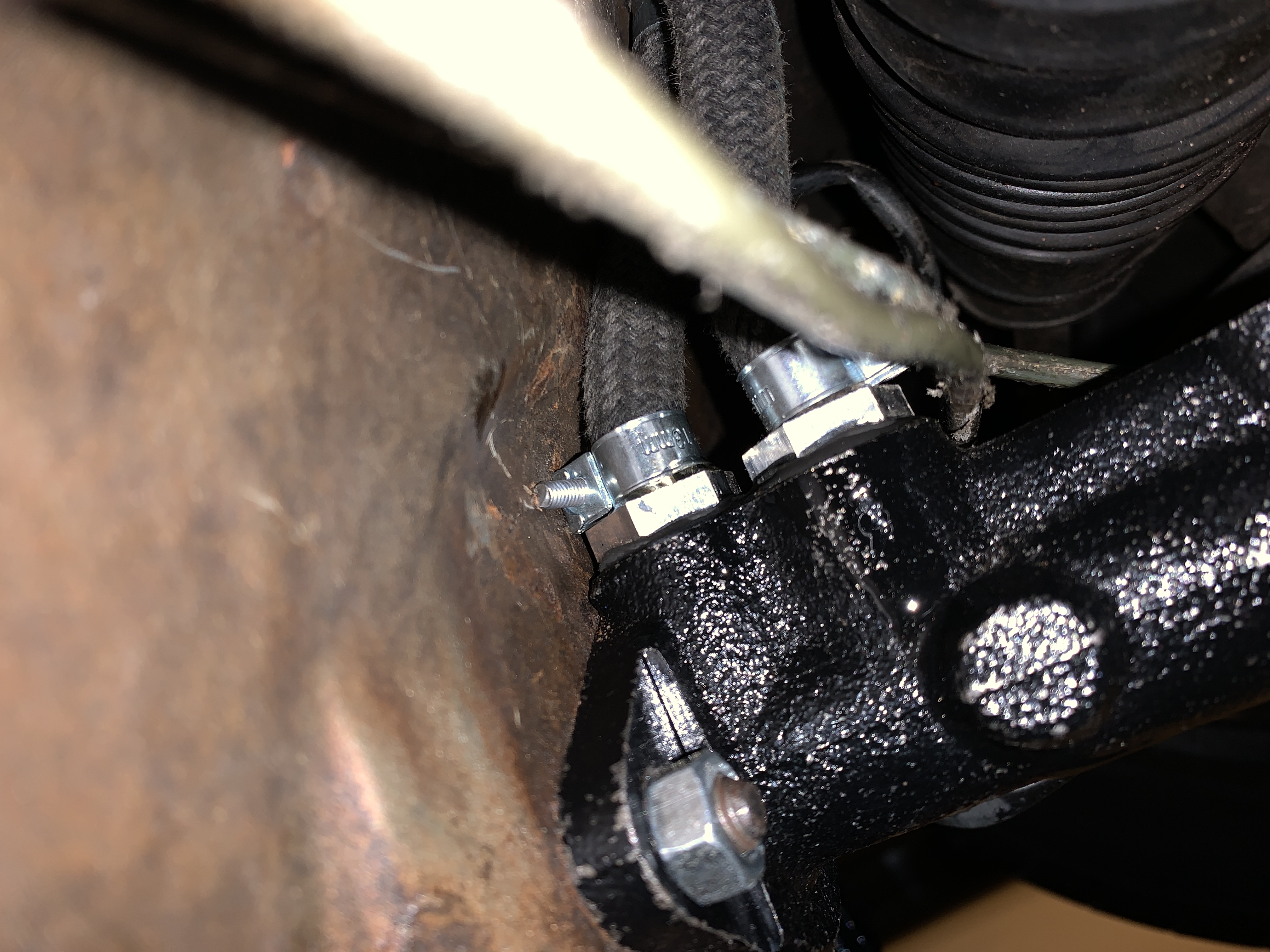

DRPHIL914
post Oct 18 2019, 07:10 AM
Post #28
Dr. Phil
Posts: 5,971
Joined: 9-December 09
From: Kennesaw, GA
Member No.: 11,106
I did get this project partly completed last night, taking out the old one was not that hard, about 20 minutes to get it pulled out, and once out of course you can see the front seal was leaking , as evidenced by the fluid inside the car.
I ordered the 19mm new MC from 914rubber which has the threaded connection on top so you can clamp the new lines on. it is up and in place but not fully connected yet, due to lack of time(prior commitment) , but I should be able to connect the lines tonight in just a few minutes.
my biggest issue is that I am doing this laying on my back with car on jack stands, and its a bit tight in there with the steering rack in place etc, would be easier with at least a scissors jack tp get it up higher, I now have a knee I cant bend very far due to a torn meniscus so it gets tricky trying to bend and roll around under a car (IMG:style_emoticons/default/dry.gif)
I hope this MC and the seals last longer than the last one, because 4 years is NOT long enough, I hope I don't ever have to do this job again.

DRPHIL914
post Oct 18 2019, 09:40 AM
Post #32
Dr. Phil
Posts: 5,971
From: Kennesaw, GA
Member No.: 11,106
I would assume this could be rebuilt and a new seal installed? if so how hard is this to do? is this something you do Mark? or PMB?

post Oct 19 2019, 04:12 PM
Post #40
Dr. Phil
Posts: 5,971
From: Kennesaw, GA
Member No.: 11,106
5 hours , MC in, pedals removed floor and pedal cluster cleaned up and reinstalled - that had to be done , that was about half the install time, the other 2.5 was fighting with the hose onto the new fittings and getting it proper and tight- in the end, it looks ok but
It has to come back out! Major leak from between the new fittings and the MC- the supplied o-rings are not doing their job and that really sucks. I had a feeling about that when I first installed the new fittings as I had a hard time keeping those o-rings from squishing out, I should have listened to my gut at the time and called 914rubber about the o-rings possibly being too big- now it has to come out and I have wasted my whole afternoon.
So that’s it, I and not going to have the car at car show next Saturday or the cruise in on Thursday. I don’t have another afternoon or night between now and then to Fuchs around with this and re-do it.
BTW, this took longer to do than the last time with just pressing the grommets and lines in place but I figured what the heck, let’s do this it should be leak proof and never mess with it again-
I think the design itself is fine, but not the thing to be doing if your steering rack is still in and you are lying in your back under the car. But MC was shot so it had to be done.
Well maybe tomorrow I will pull it and see if Lowe’s has an O-ring that will work ,but I may be more frustrated right now then I have really ever felt doing a repair on this car.
I need to go take a blood pressure pill I think I am going to blow a gasket (IMG:style_emoticons/default/icon8.gif)
