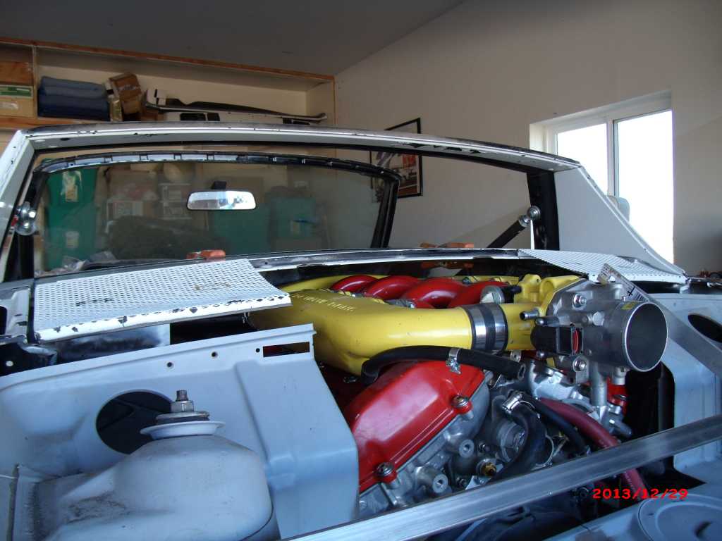

(IMG:http://www.914world.com/bbs2/uploads/post-1191-1473387402.jpg)
Engine fit before rear firewall extension - pic1
(IMG:http://www.914world.com/bbs2/uploads/post-1191-1388356682.jpg)
Engine fit before rear firewall extension - pic2

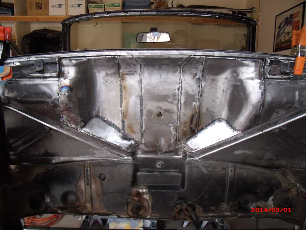

(IMG:http://www.914world.com/bbs2/uploads/post-1191-1393708888.jpg)
Rear trunk/firewall extension
(IMG:http://www.914world.com/bbs2/uploads/post-1191-1468298588.jpg)

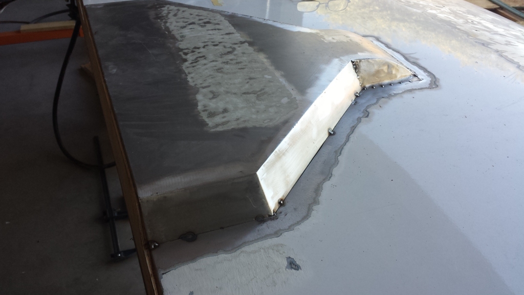

Engine lid/trunk modifications
(IMG:http://www.914world.com/bbs2/uploads/post-1191-1497711925.jpg)

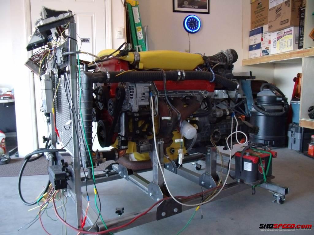

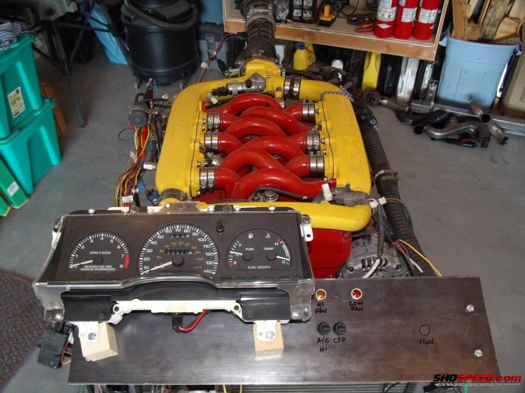

Motor details:
  • Crank, bearings, valves, guides, and seals inspected and replaced as needed
  • Valves lapped
  • Replaced pistons with used
  • New piston rings
  • Honed cylinders
  • Lapped valve seats
  • Walbro GCL601 Fuel Pump
  • FP-Minimum Current: 12 Volts
  • FP-Operating Pressure: 45 PSI
  • FP-Minimum Flow @ Outlet: 32 GPH (121 LPH) High Pressure

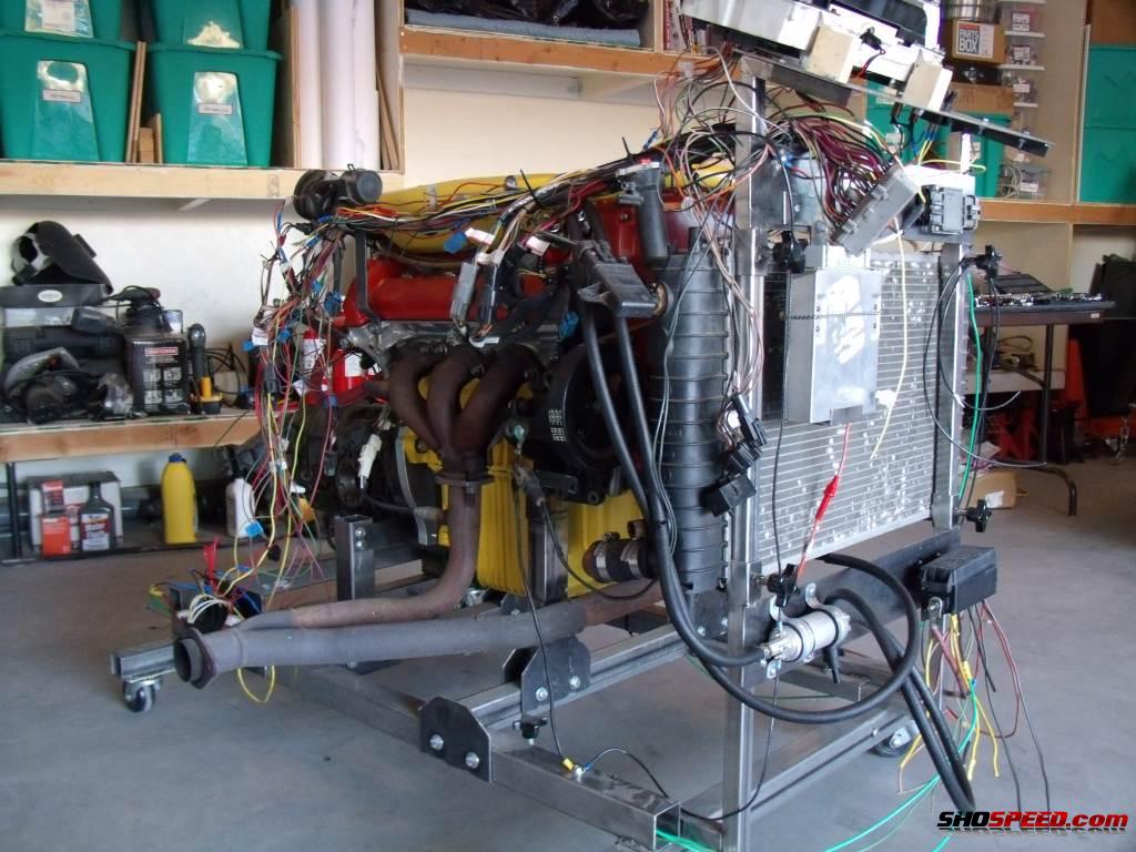

  • Complete test harness used for bench testing
  • All engine sensor output verified during bench tests
  • All CEL codes resolved during bench testing
  • Completed several hours of running to seat piston rings
  • Intake runner outer seams ground smooth
  • Heads professionally cleaned and decked
  • Replaced numerous freeze plugs in block
  • DIS relocated off the plenum housing
  • Polished exhaust manifold shields
  • Polished fuel rails

Bench Test Prep - pic1
(IMG:http://www.914world.com/bbs2/uploads/post-1191-1352143772.jpg)
Bench Test Prep - pic2
(IMG:http://www.914world.com/bbs2/uploads/post-1191-1352143781.jpg)
