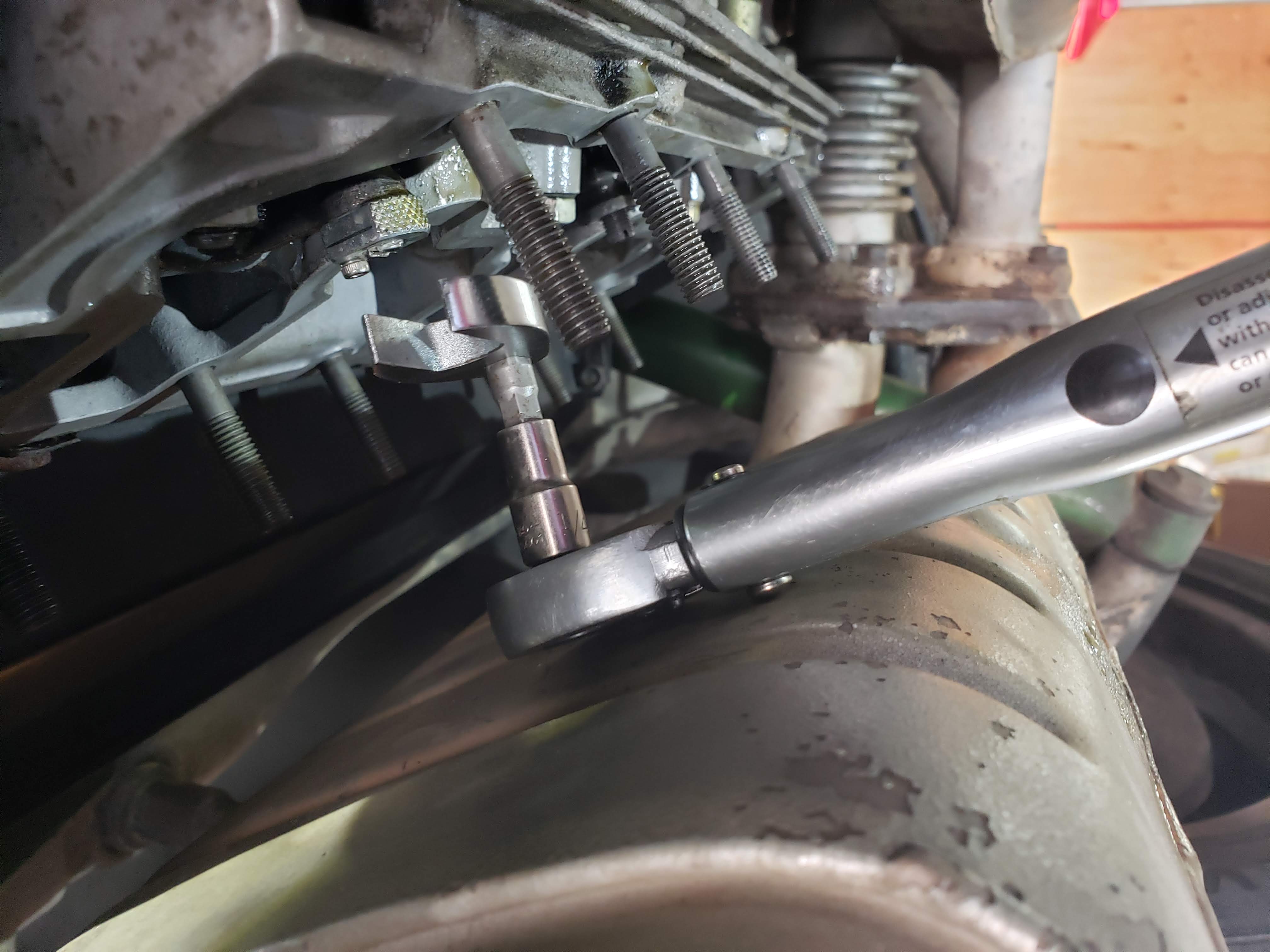

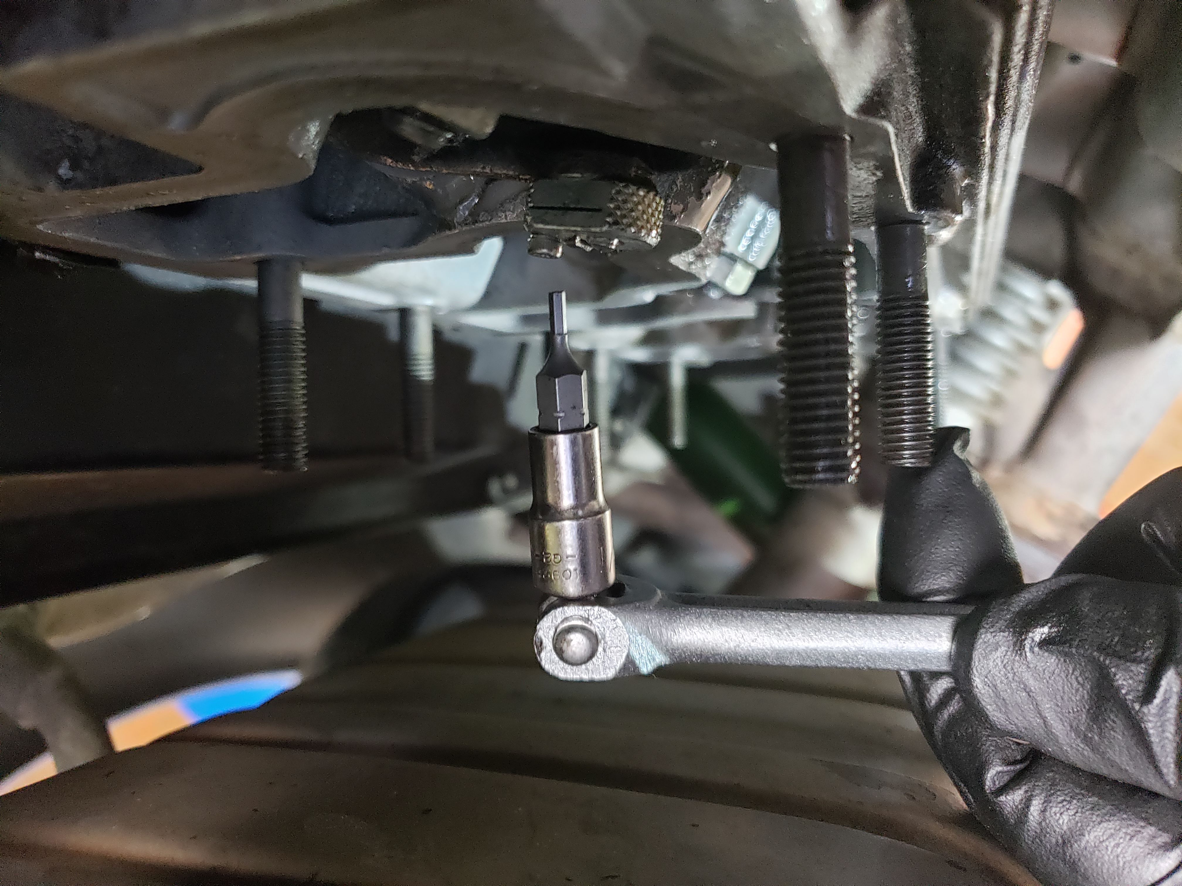

For spaces where the T-handled wrench does not fit without removal of components (or dropping the engine), you can use a 1/4 drive to tighten the small cap screw and a standard torque wrench set to 10Nm to do the torquing with whatever extensions you need. I know that my '78SC is not a 914 set up, but here are some pics of me working around the CAT on the left exhaust bank.

when I see this performed on a 914 with heat exchangers I'll get the kit. I have a hard enough time with the shim method and don't see this working on a typw 4 In the Car.
