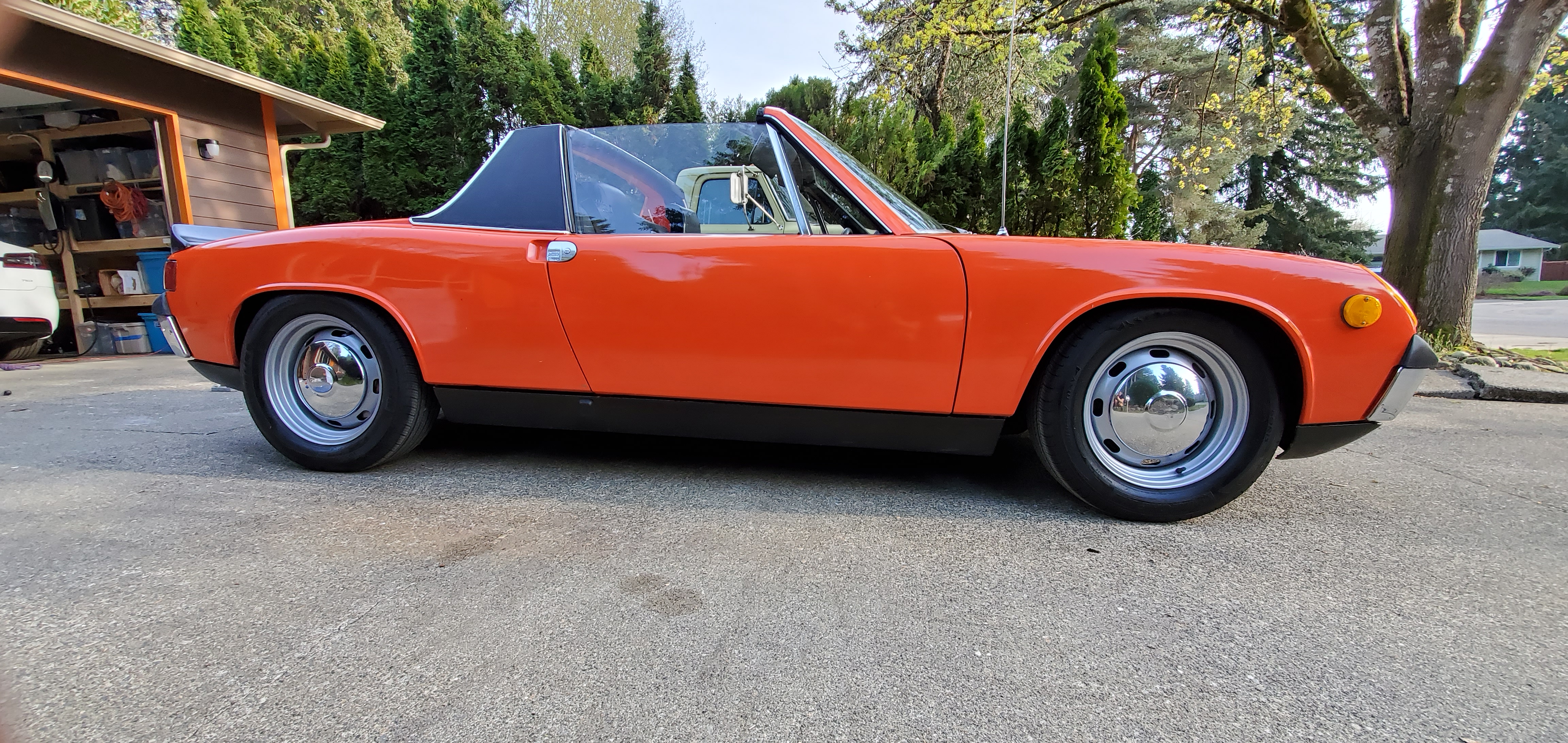

Got these awesome Steelies from Sierra Madre and hubcaps from a member, so happy with how it turned out! Mostly solved the riviera wheel rub issue although these 195s are just barely squeezing into the right rear. Was able to lower the Bilsteins to the 3rd from top with the 914rubber springs and I'm very happy with the results!

post Apr 13 2020, 08:54 PM
Post #115
Posts: 11,759
Joined: 22-March 03
From: USofA
Member No.: 453
DAMN! Looks great!
bigkensteele
post Apr 13 2020, 09:09 PM
Post #116
Major Member
Posts: 2,200
Joined: 30-August 04
From: Cincinnati, OH
Member No.: 2,660
That looks fantastic! Love steelies with the right stance.
PanelBilly
post Apr 13 2020, 09:11 PM
Post #117
Posts: 5,998
Joined: 23-July 06
From: Kent, Wa
Member No.: 6,488
Looks old how does it track?
