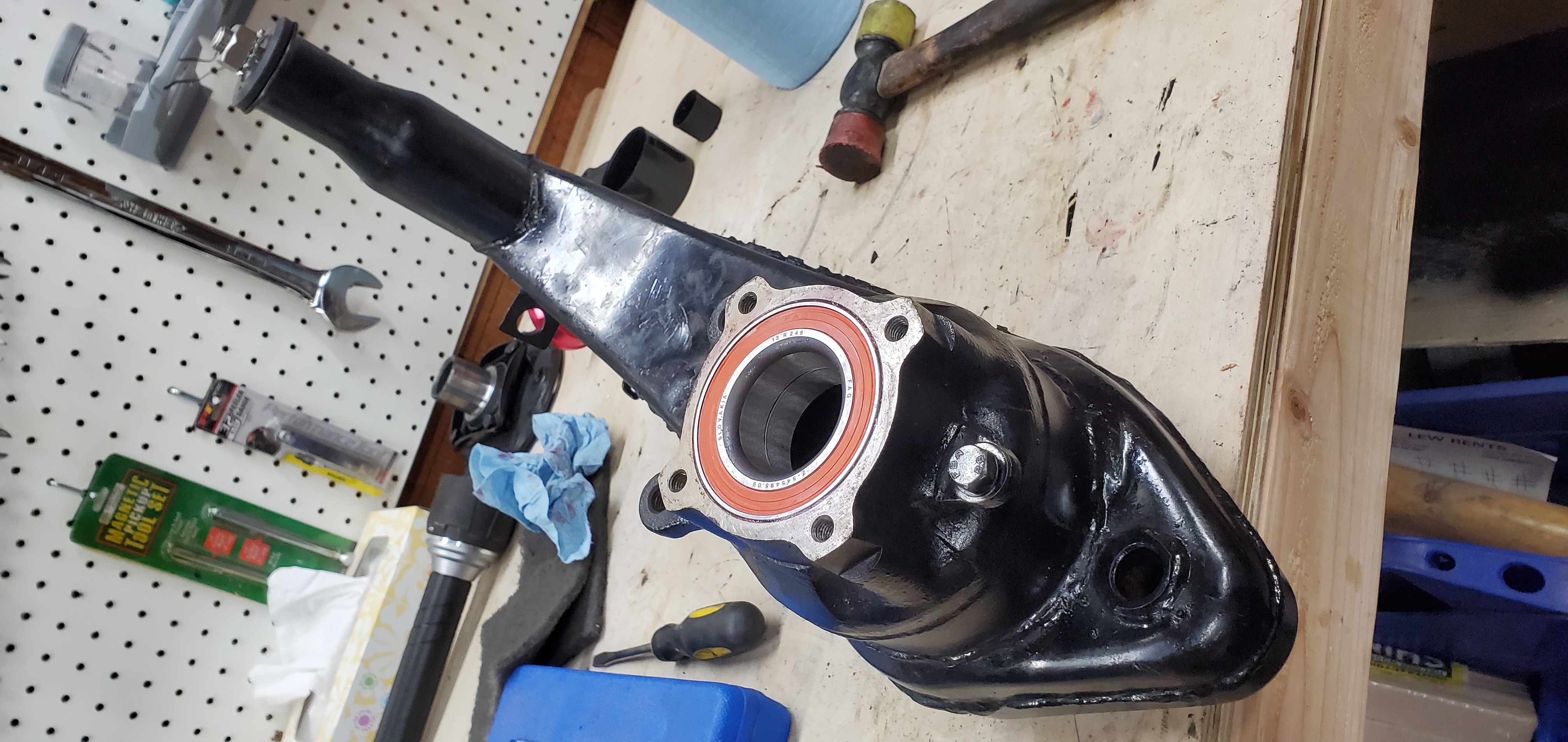

Bearings are in! Going to make a threaded tool to compress the hubs in evenly like Eric Shea's video shows
Got these really nice pivot arm shafts/bushings from 914rubber @mikey914
@914werke hooked me up with a replacement hub (PO destroyed one and reinstalled anyway) and some hard brake lines.
CV joints re-packed and new gaskets. 1 gasket was completely missing and was throwing grease inside the control arm by the hub. Glad I caught that.
Tomorrow will try and get the hubs installed and the stainless lines in and then I think I'm ready to start bolting this thing back together!!

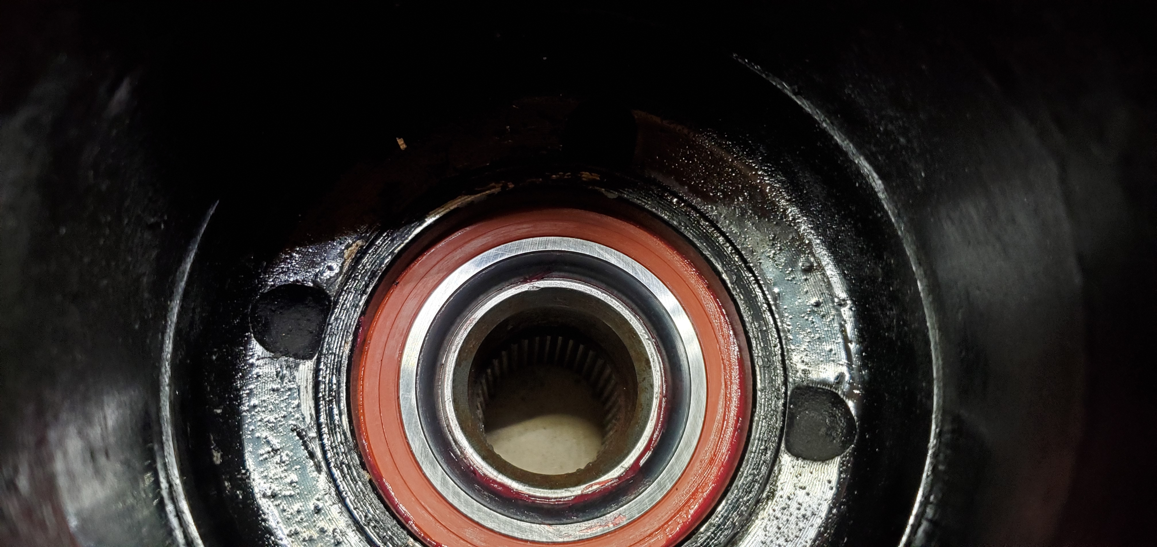

Maybe a stupid question...how do I know when the hub is installed fully? Will it bottom out? Can I push in too far?
Is this enough?

Should the hub shaft be flush with bearing?? Attached Image
Tbrown4x4
post Nov 15 2019, 01:14 PM
Post #46
Posts: 709
Joined: 13-May 14
From: Port Orchard, WA
Member No.: 17,338
The shoulder on the hub will bottom out on the inner bearing race. The hub doesn't go ALL the way through. The hub and the stub axle traps the inner races when you torque the axle nut. (To the proper torque, of course.)

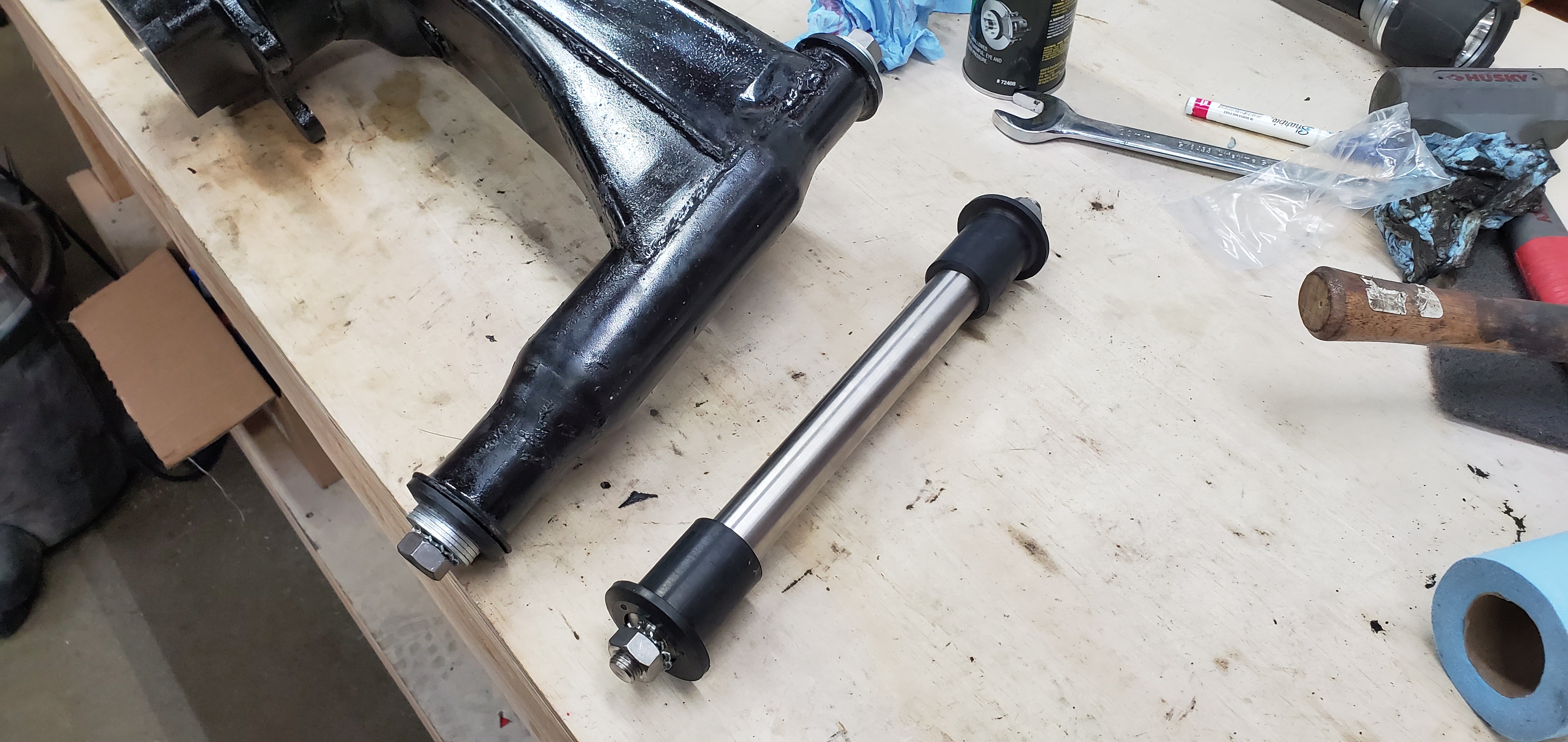

QUOTE(914werke @ Nov 7 2019, 03:14 PM) *
Shafted!
I've been curious, since you mentioned it in an earlier post, if milling the shafts like that causes any "slop" in the fitment of the new bushings, presuming they are designed for factory dimension of the pivot shafts.
914werke
post Nov 15 2019, 03:35 PM
Post #48
Posts: 11,759
Joined: 22-March 03
From: USofA
Member No.: 453
If you look at the process for installing either the various Delrin / poly or the OE replacement rubber versions it is typically necessary to "clearance" the plastic ones, & use a special tool to draw the tight rubber over the shafts for the fitment.
The .01 removed to clean any corrosion isnt significant enough to adversely effect fitment.
IF you are going Polybronze they (Elephant) provide new shafts with their kit.

Mikey914
post Nov 15 2019, 06:19 PM
Post #50
The rubber man
Posts: 12,784
Joined: 27-December 04
From: Hillsboro, OR
Member No.: 3,348
Actually when Elephant made their rods they used a standard size tube that was not metric line the OEM. The bushings they made are to go with their rod, so they don’t work well with the stock rods (and the ones I made).

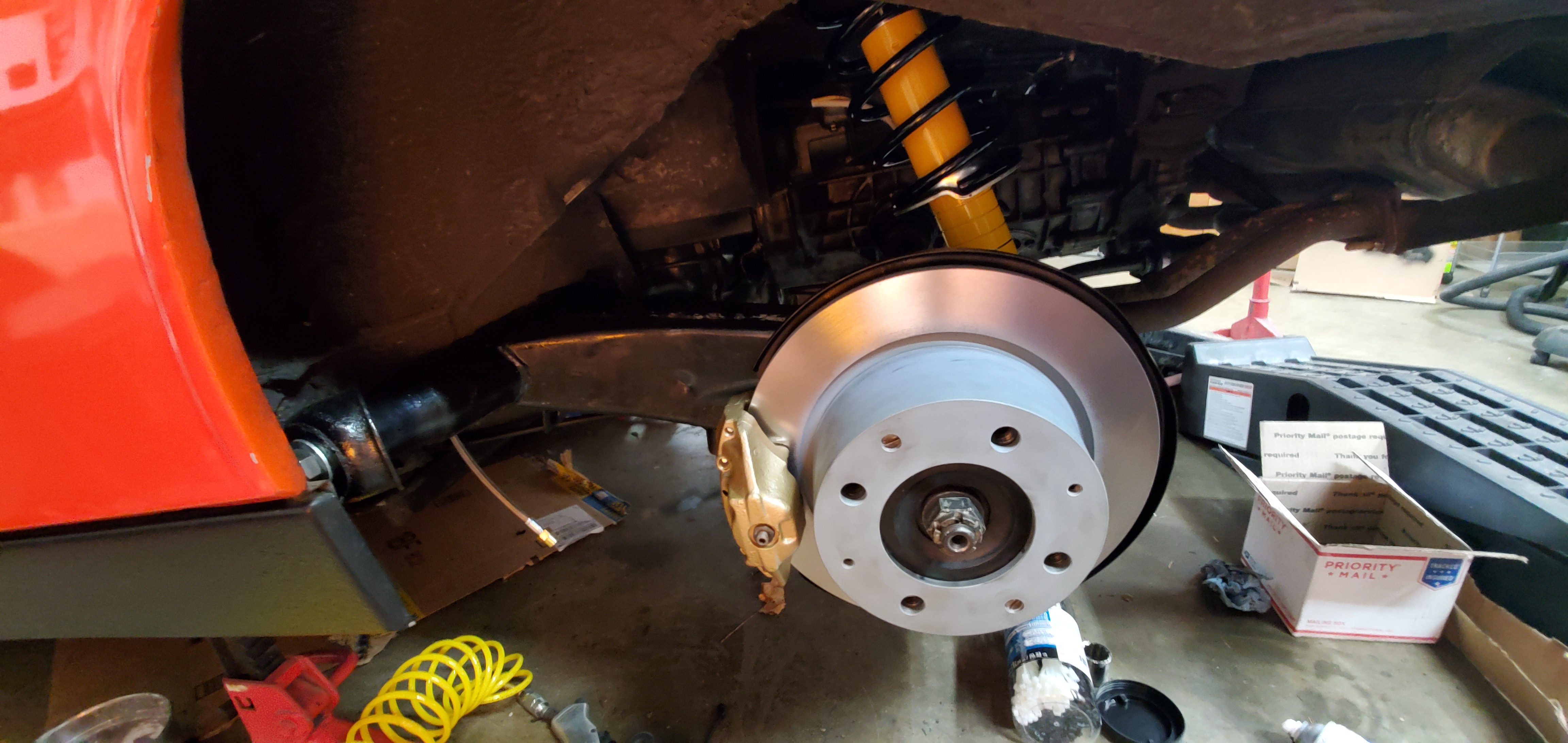

Starting to see some progress and feeling like I didn't ruin everything and she may drive once more. Lol!Attached Image

QUOTE(914werke @ Nov 15 2019, 10:21 PM) *
QUOTE(Mikey914 @ Nov 15 2019, 04:19 PM) *
(IMG:style_emoticons/default/confused24.gif) why would you bother with used OE ones if you are getting new ones as part of their (elephant) kits?
Yes but you can't use the rubber without their shafts.
It will not fit correctly as they made a non standard size.
tvdinnerbythepool
post Nov 23 2019, 12:54 PM

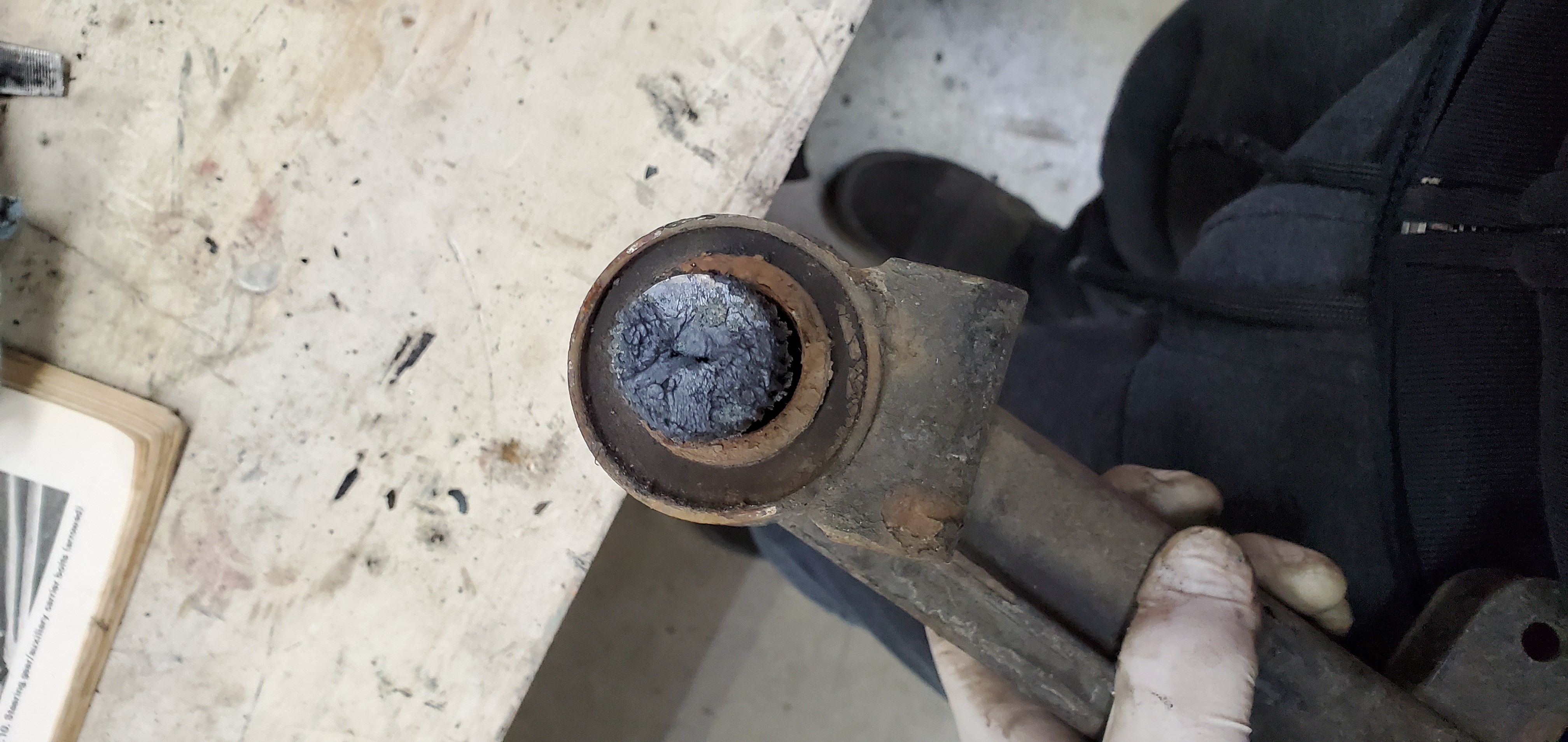

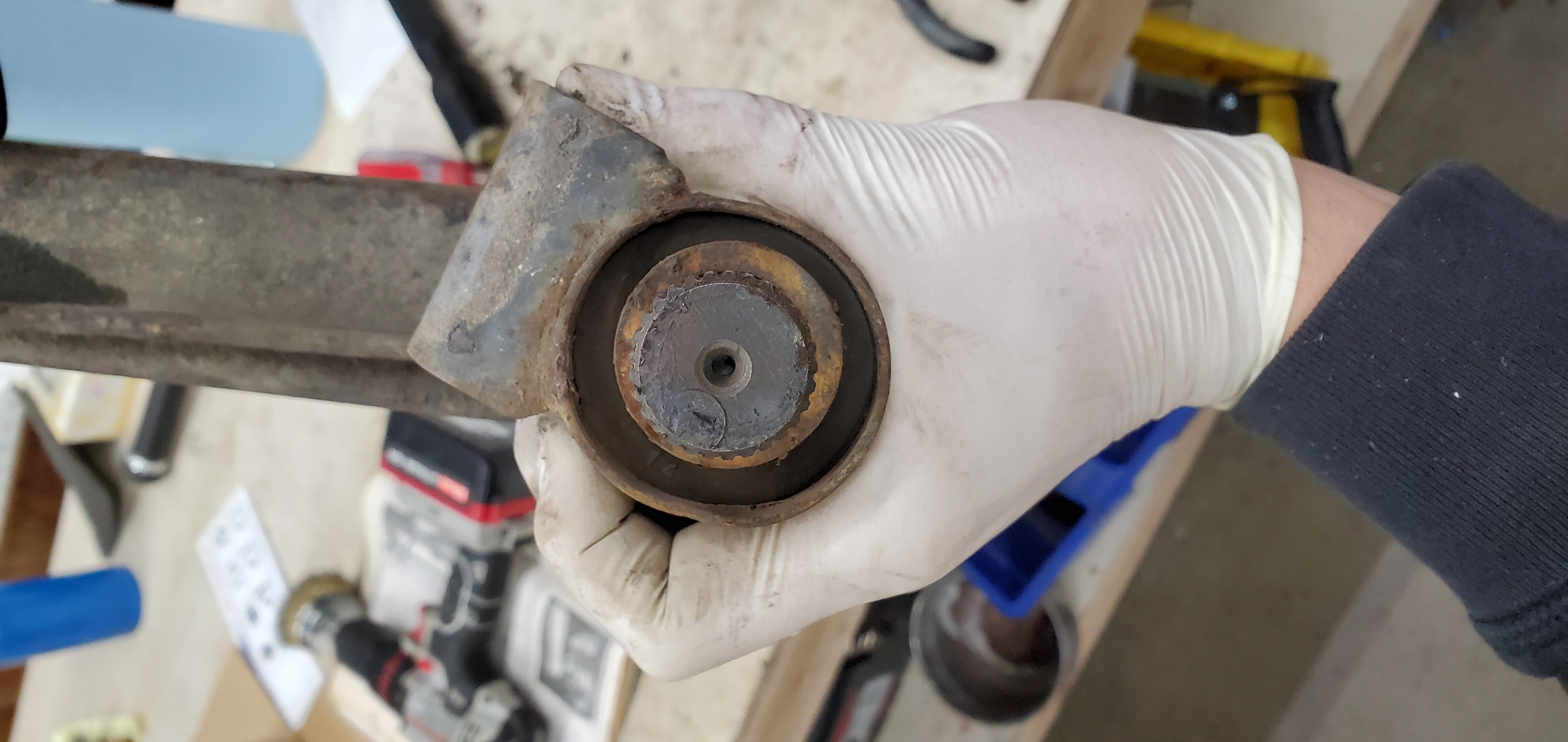

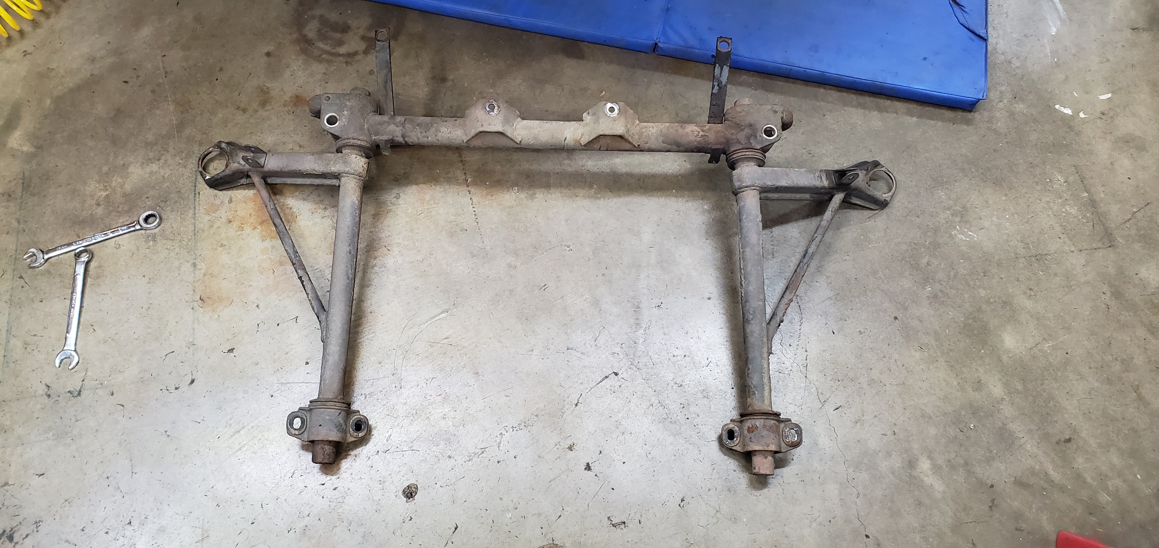

With the back pretty much wrapped up it's on to the front.
Ripped it all out and have a pretty good plan of action.
New A Arm Bushings/Install Tool (914 Rubber + Ian's Video should help)
Bilsteins on the way to match the rears
New Rotors, Pads, Bearings, Ball-joints
New Stainless soft lines
Rebuilding Calipers (Rears went well so here is round 2 for me)
Tie Rod Ends (Stock not turbo upgrade for me)
Bought the install tool for the ball joints, got the old ones out with the air chisel in about 10 seconds surprisingly!
Bushings were totally shot, out of round and a mess.
Anyways, guidance as always appreciated. Have most of the parts on hand if not already shipping to me so I'm hoping to keep the momentum between trips.Attached Image
tvdinnerbythepool
Post #55
Posts: 310
Joined: 24-July 18
From: Olympia, WA
Member No.: 22,336
tvdinnerbythepool
post Nov 23 2019, 12:55 PM
Post #56
Posts: 310
Joined: 24-July 18
From: Olympia, WA
Member No.: 22,336
This was the worse of the two sides
post Nov 23 2019, 01:31 PM
Post #57
914-6 GT in waiting
Posts: 20,922
Joined: 19-September 09
Member No.: 10,825
Heat up the fittings that hold the bushings until you see some smoke and then twist them off by inserting a large screwdriver and turning. Wear leather gloves. Propane works fine for this. MAP is just faster.
