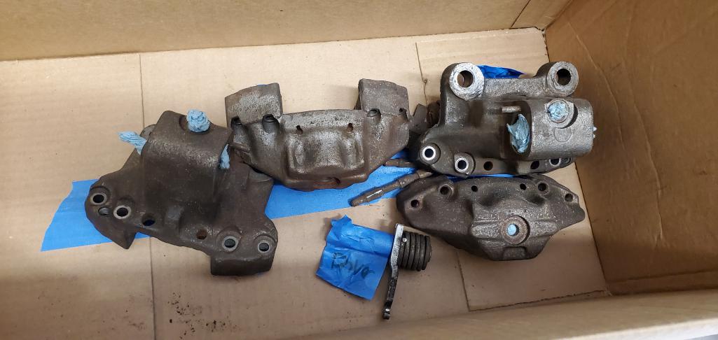

tvdinnerbythepool   Hey guys! I've seen a few methods online b...   Oct 24 2019, 10:24 PM
mepstein   Hey guys! I've seen a few methods online ...   Oct 25 2019, 06:13 AM
914werke   From that pic it looks like you may have more work...   Oct 25 2019, 12:24 AM
Tbrown4x4   I'm reading that you are blasting the calipers...   Oct 25 2019, 05:01 AM
tvdinnerbythepool   @914werke for sure! It was a ton of work just...   Oct 25 2019, 09:59 AM

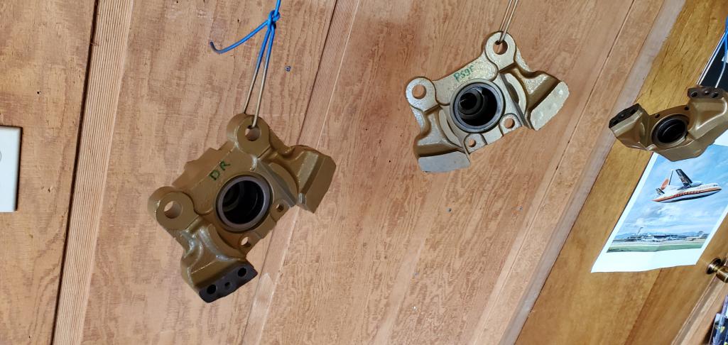

tvdinnerbythepool   Calipers stripped, blasted and painted. Will repo...   Oct 31 2019, 08:14 AM
Tdskip   It will be. Like all vintage German cars 914s resp...   Oct 31 2019, 10:12 AM

DucRS   Calipers are looking good! Please chime in o...   Oct 31 2019, 11:10 AM
mepstein   Here’s Eric’s /PMB Performance video for rebui...   Oct 31 2019, 11:18 AM
tvdinnerbythepool   @ducrs I followed the pelican disassembly article...   Nov 1 2019, 07:30 AM
mepstein   I’m pretty sure all the calipers had nuts for th...   Nov 1 2019, 07:34 AM
tvdinnerbythepool   I’m pretty sure all the calipers had nuts for t...   Nov 1 2019, 07:45 AM

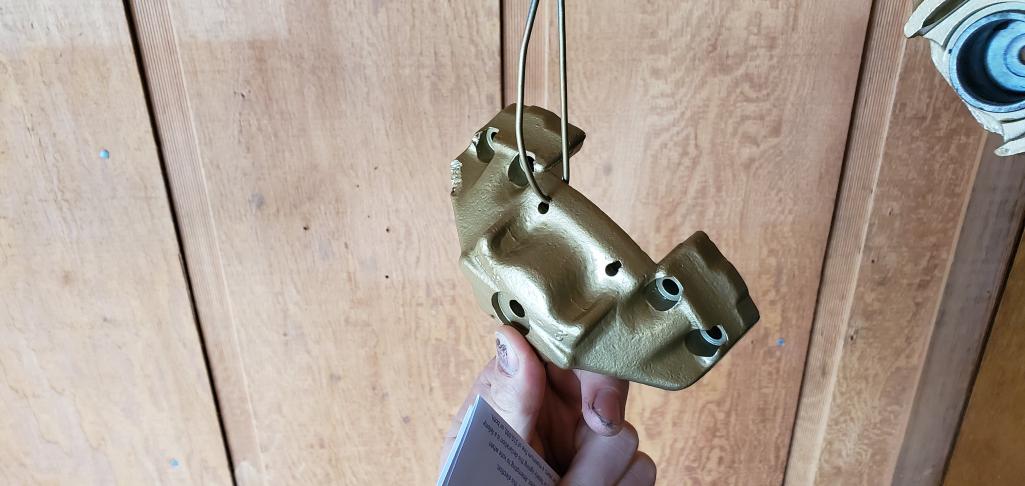

tvdinnerbythepool   Drivers side caliper rebuilt! Still sourcing b...   Nov 5 2019, 07:46 PM
eatpez   Drivers side caliper rebuilt! Still sourcing ...   Nov 5 2019, 08:00 PM
Tbrown4x4   Yes, those look great!   Nov 5 2019, 09:34 PM
