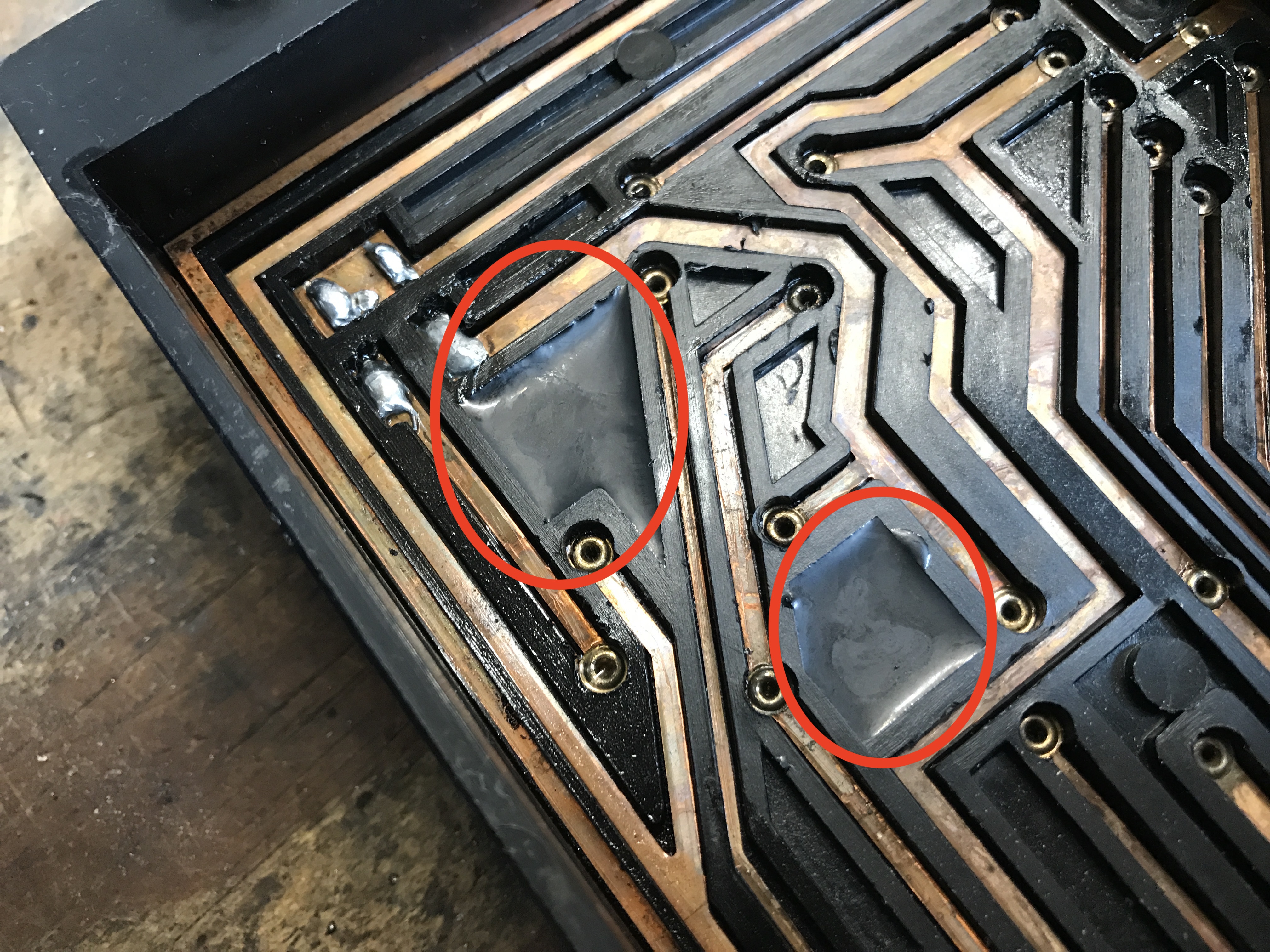

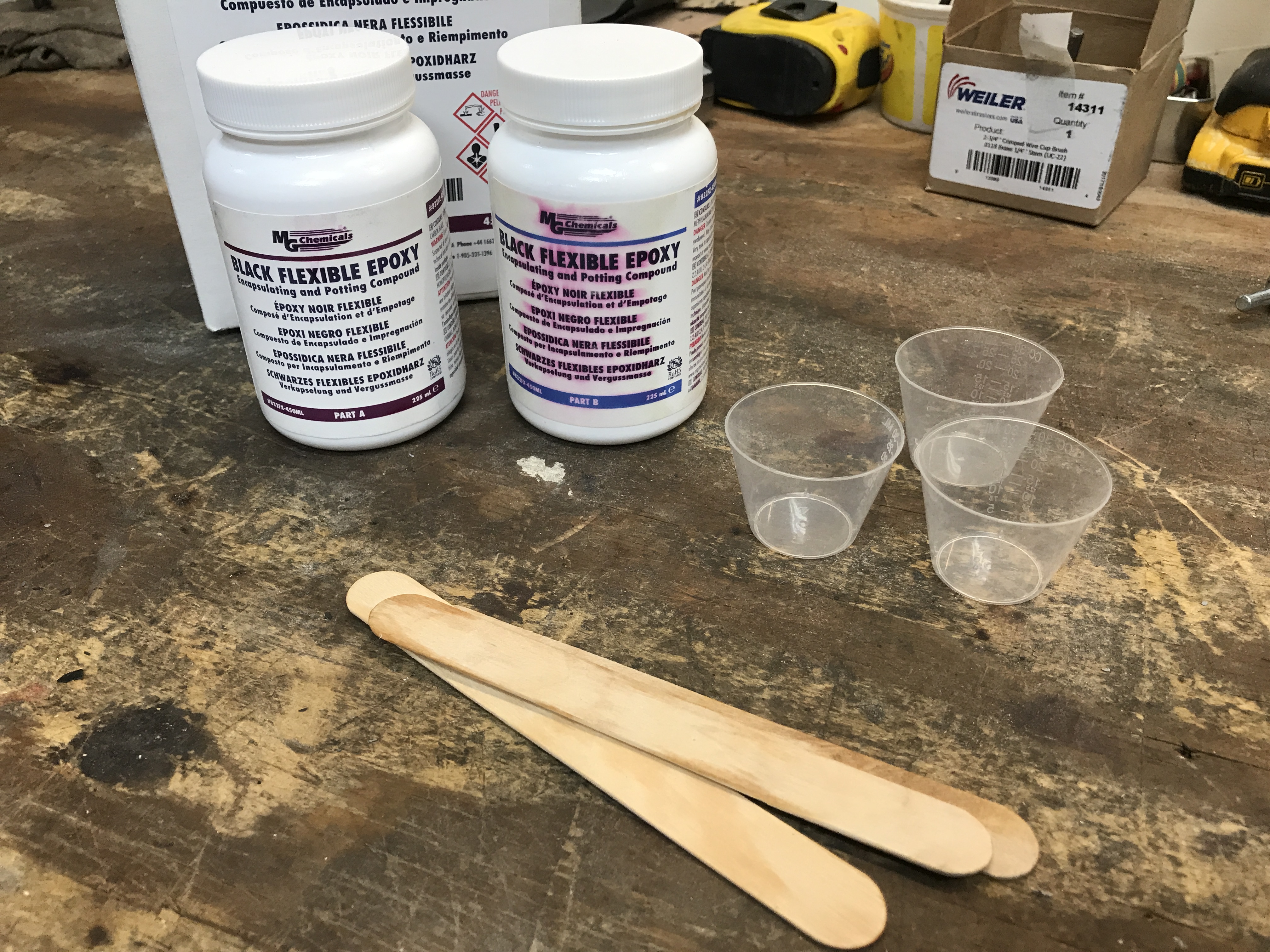

AndI decided to test the epoxy potting compound I bought for re-sealing the bottom of the relay board.
bkrantz
post Sep 9 2020, 07:03 PM
Post #1262
Posts: 8,827
Joined: 3-August 19
From: SW Colorado
Member No.: 23,343
This is supposed to be flexible so I hope resisting to cracking.
bkrantz
post Sep 9 2020, 07:04 PM
Post #1263
Posts: 8,827
Joined: 3-August 19
From: SW Colorado
Member No.: 23,343

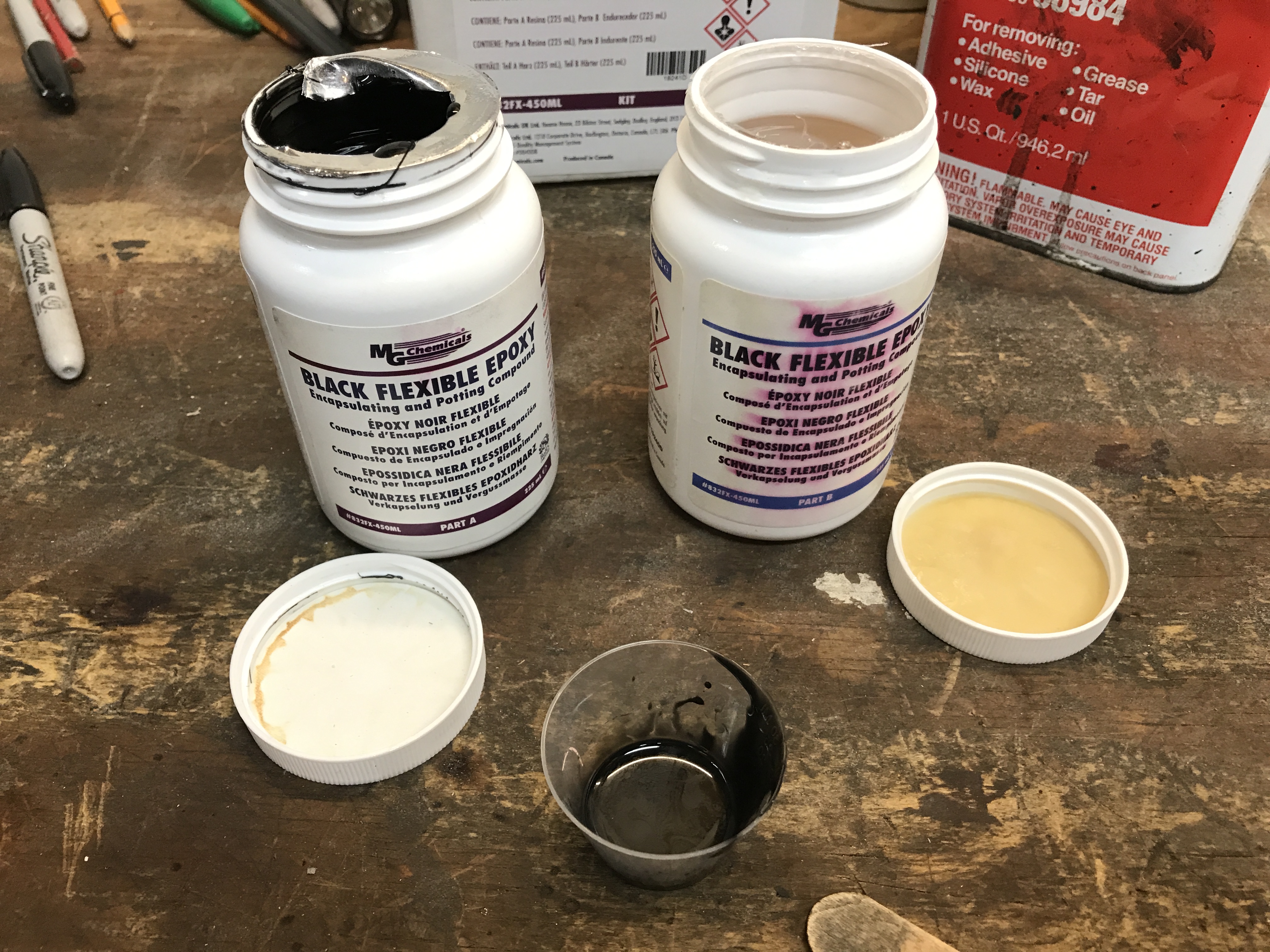

Seems simple enough, with a 50-50 mix and long curing time.
bkrantz
post Sep 9 2020, 07:07 PM
Post #1264
Posts: 8,827
Joined: 3-August 19
From: SW Colorado
Member No.: 23,343

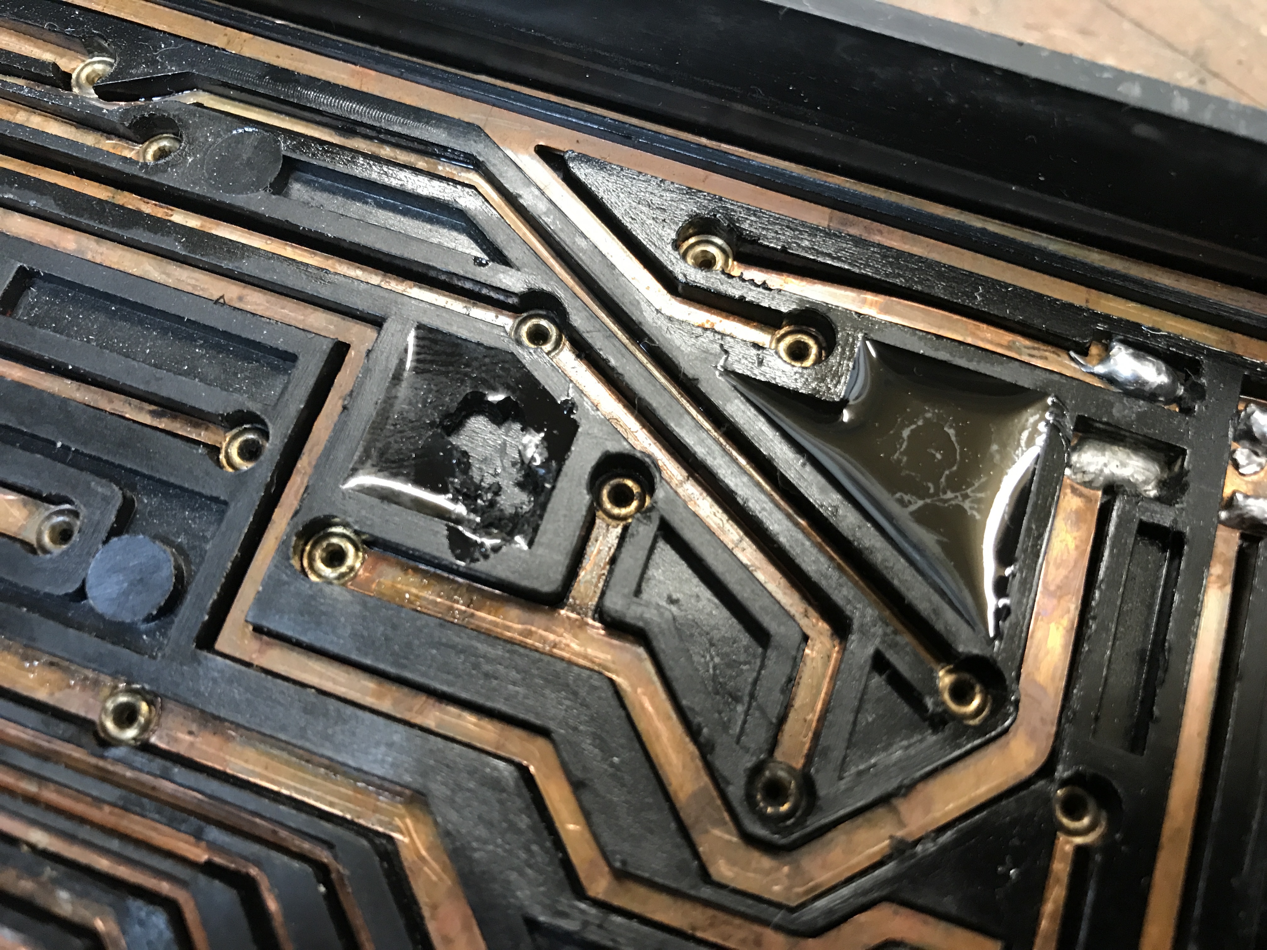

To test the adhesion to the relay board plastic, I partly filled two cavities.

QUOTE(bkrantz @ Sep 9 2020, 07:07 PM) *
Looks great - I am following with interest.

QUOTE(bkrantz @ Sep 9 2020, 07:03 PM) *
That's the stuff I used and it works great. Definitely the way to go. I had planned to sell off my left over (there is enough for 3 boards in a pack) but kept finding uses for it in other projects and decided it was worth keeping on hand.

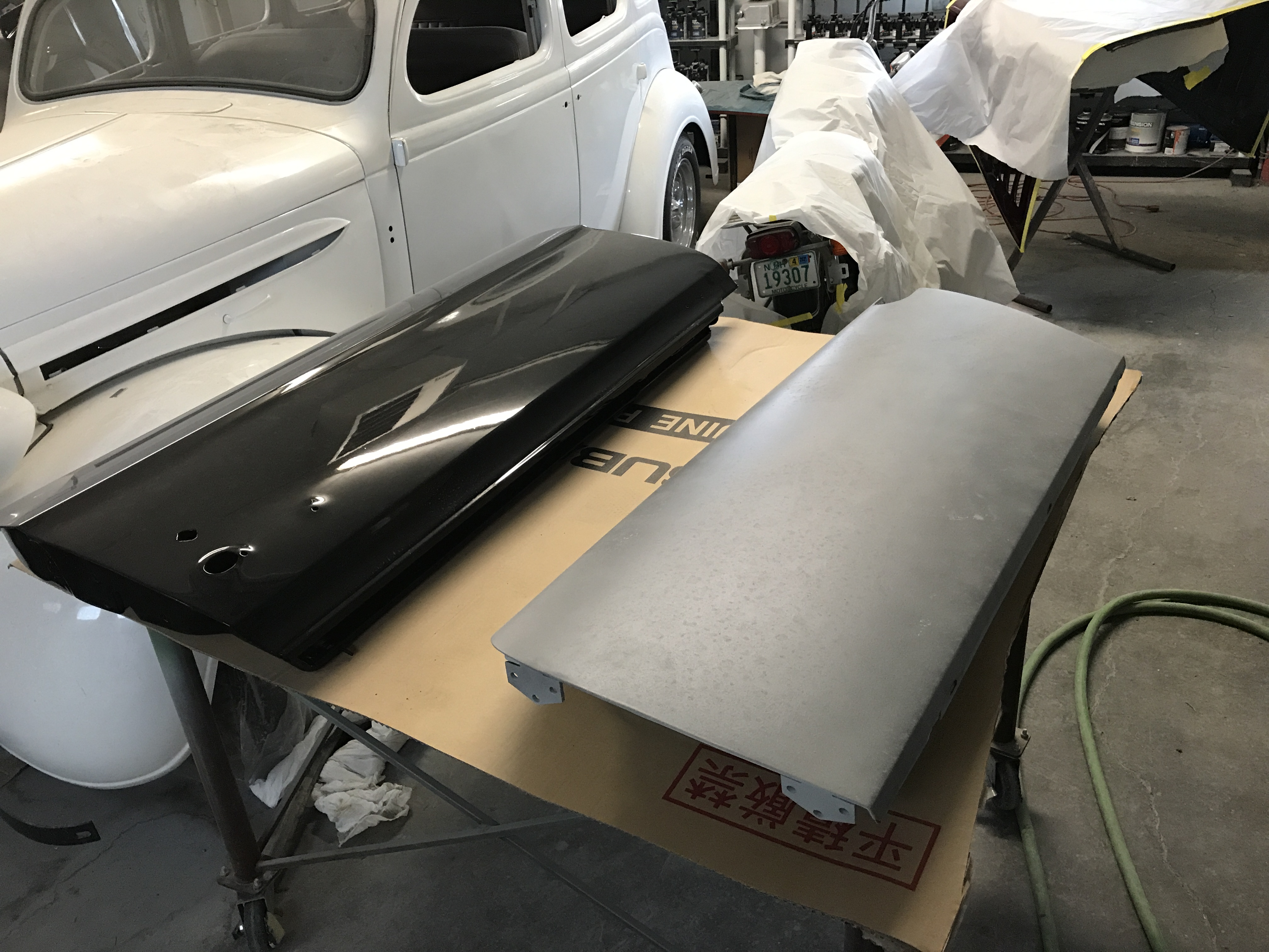

Visited the body shop today, and progress has begun again. They are hand sanding doors and lids.
bkrantz
post Sep 10 2020, 07:56 PM
Post #1270
Posts: 8,827
Joined: 3-August 19
From: SW Colorado
Member No.: 23,343

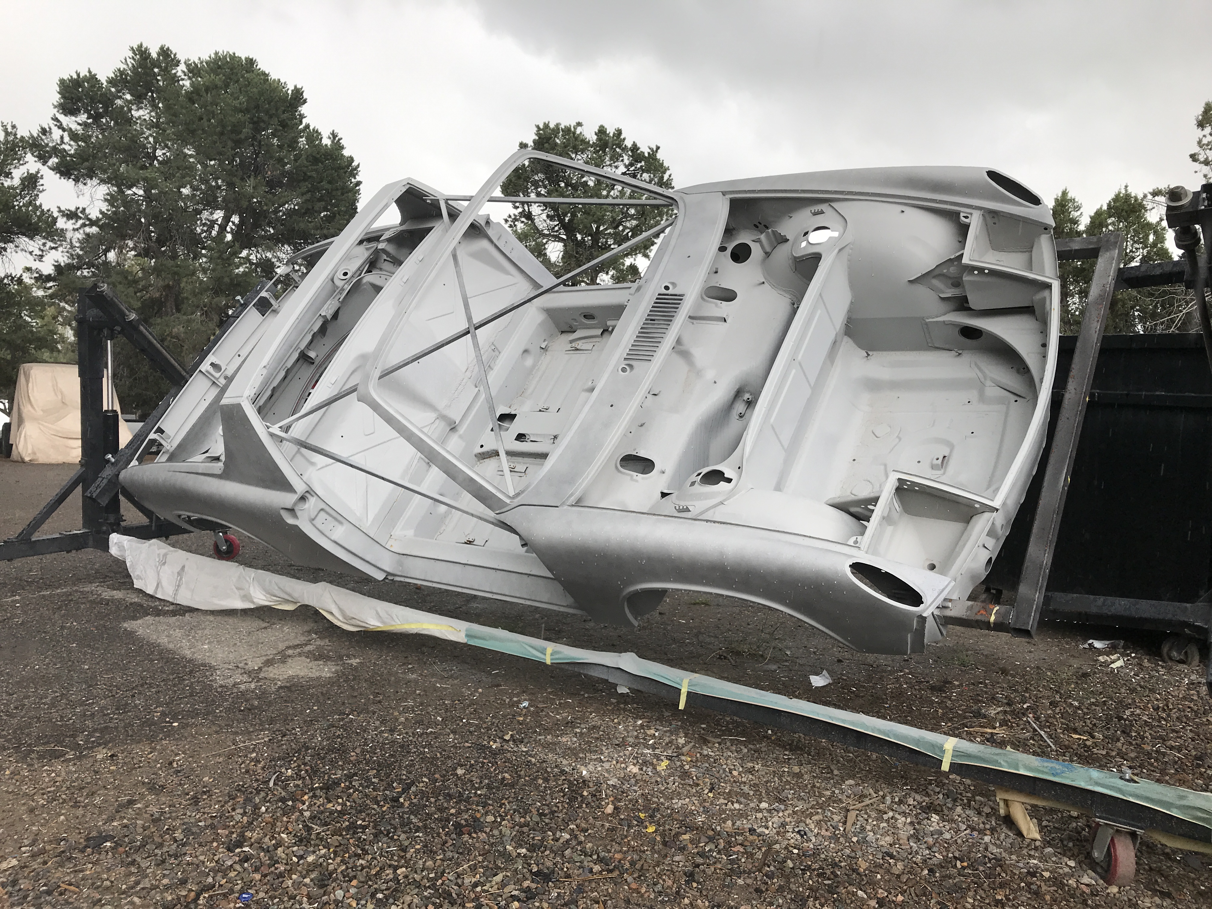

The body is again outside, but they should be sanding this next week.

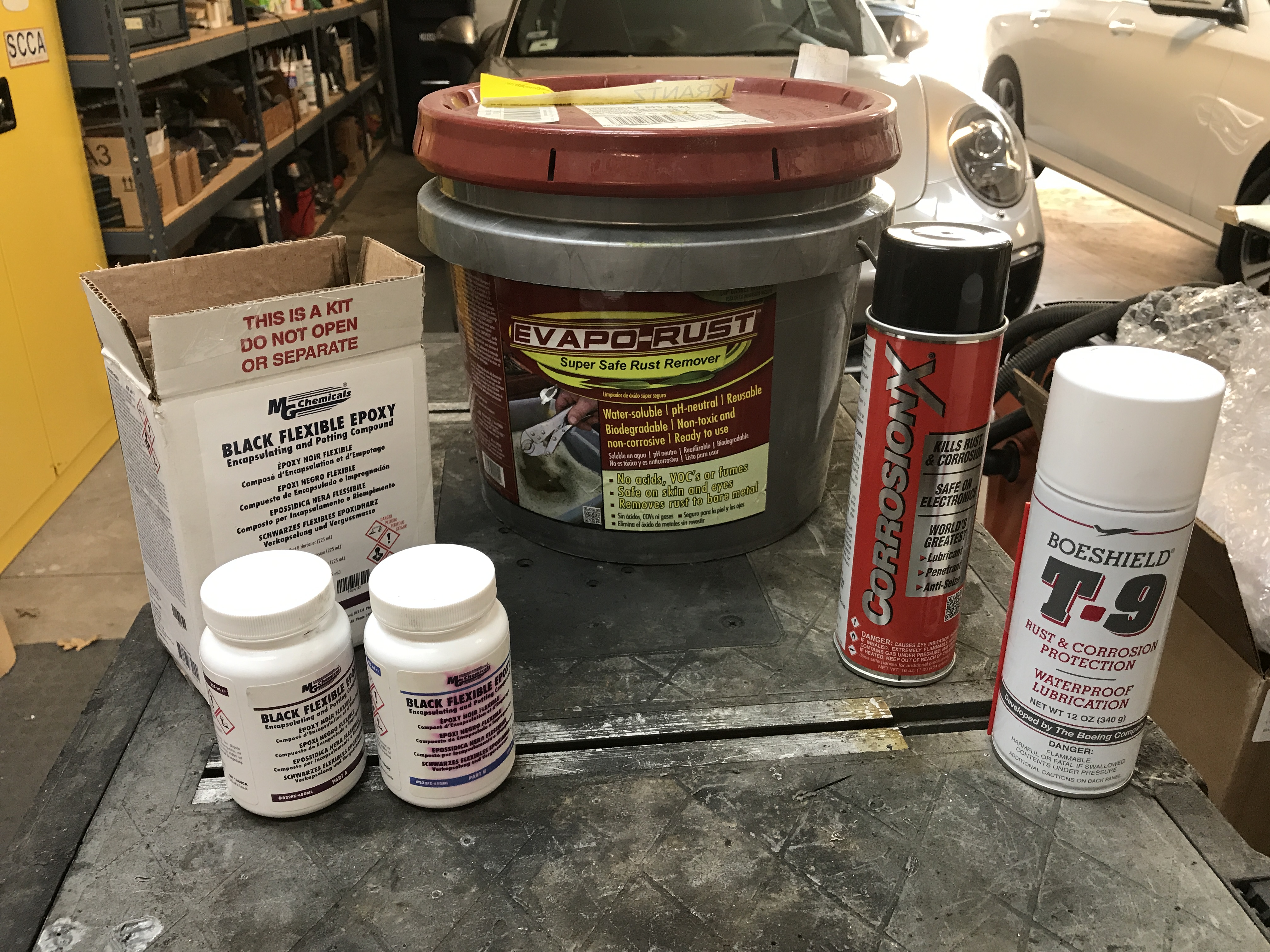

Chemistry lab today. Time to play with these and more.

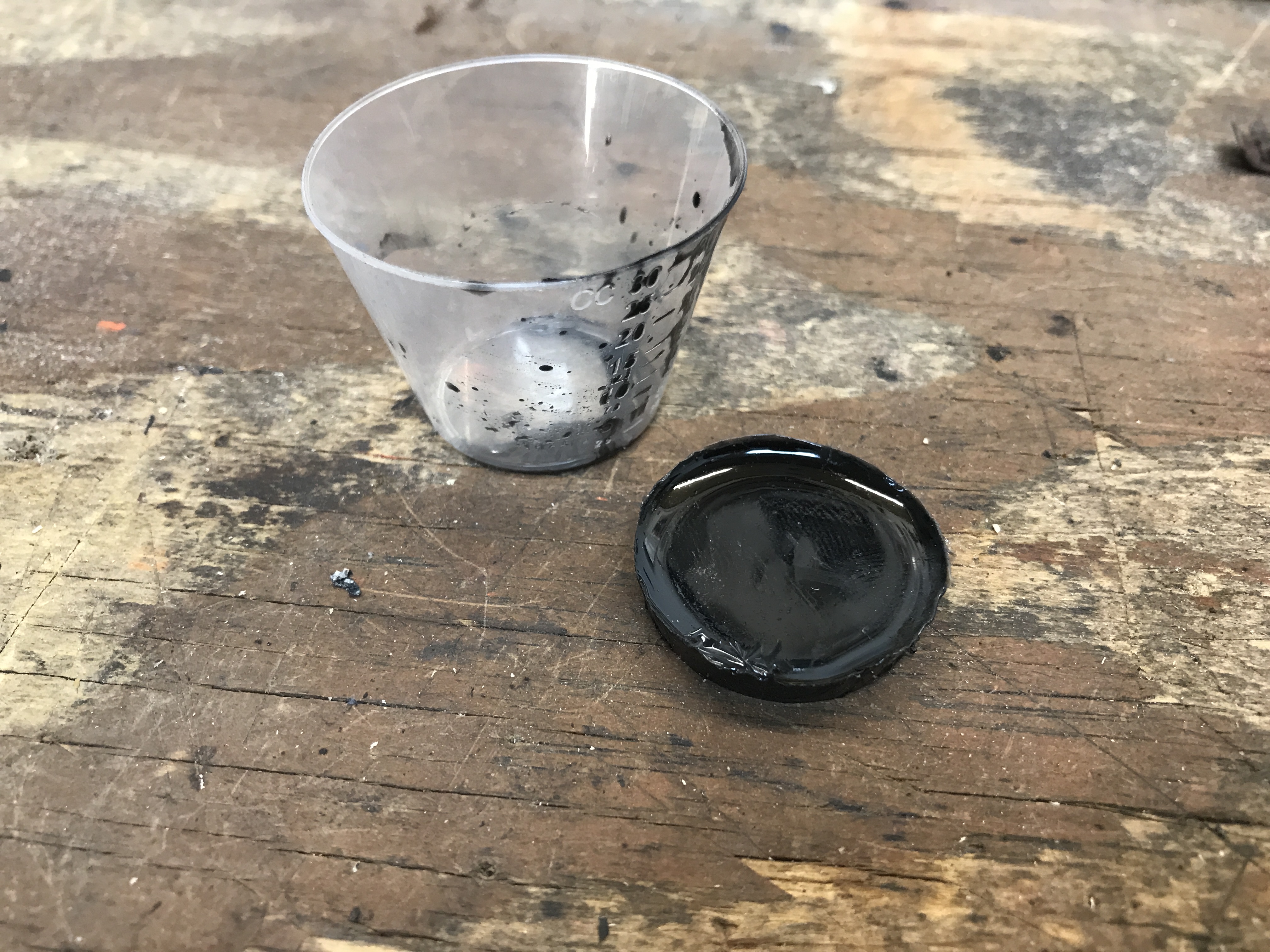

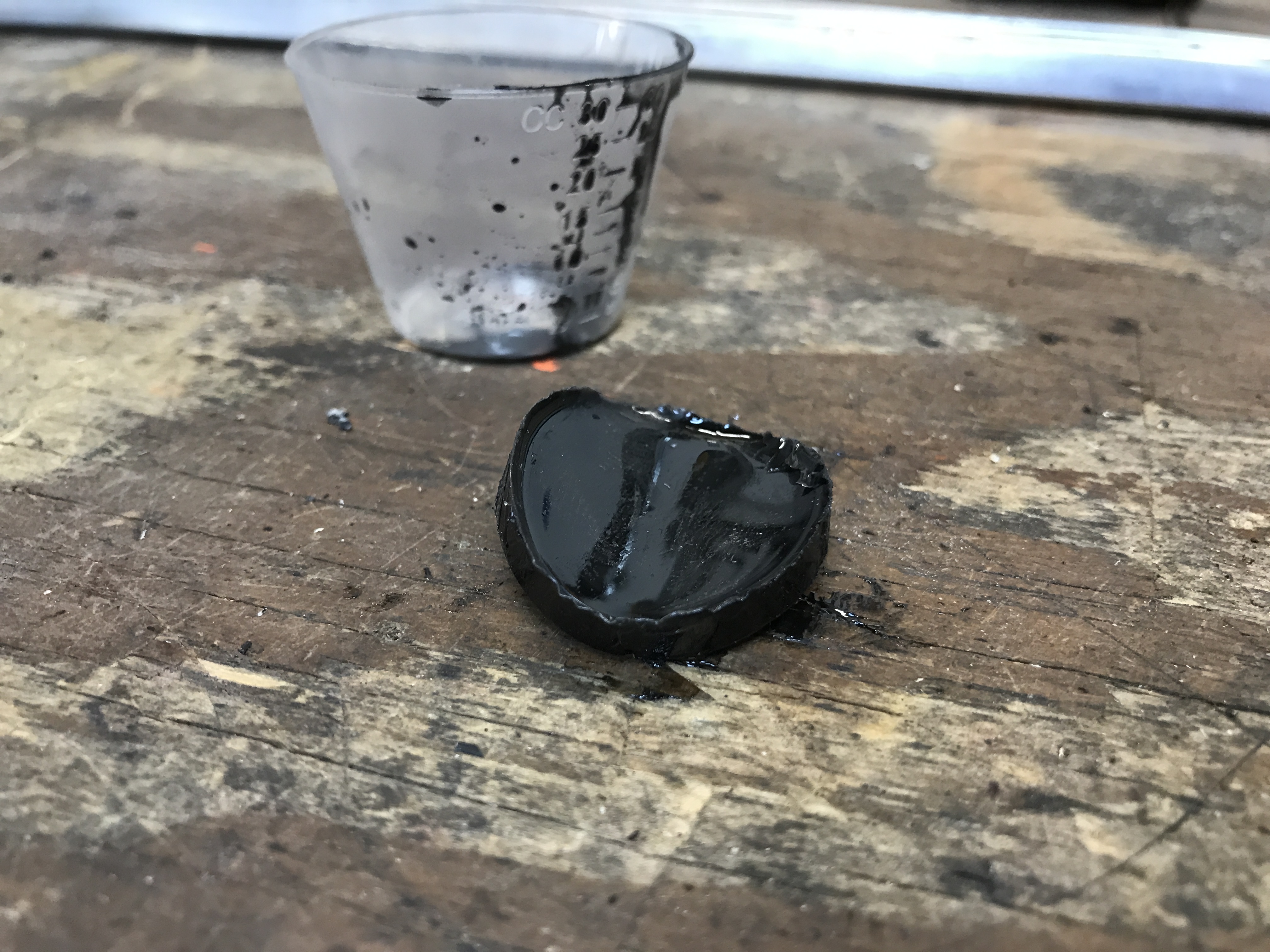

First, check on the flexible epoxy from 2 days ago. The bit left in the mixing cup is nicely solid.
bkrantz
post Sep 11 2020, 08:13 PM
Post #1273
Posts: 8,827
Joined: 3-August 19
From: SW Colorado
Member No.: 23,343
And also very flexible, able to fold in half and spring back.
bkrantz
post Sep 11 2020, 08:15 PM
Post #1274
Posts: 8,827
Joined: 3-August 19
From: SW Colorado
Member No.: 23,343
I also checked the test spots I poured on the relay board. The epoxy sticks very well, and I was able to peel up a bit only with quite a bit of force.

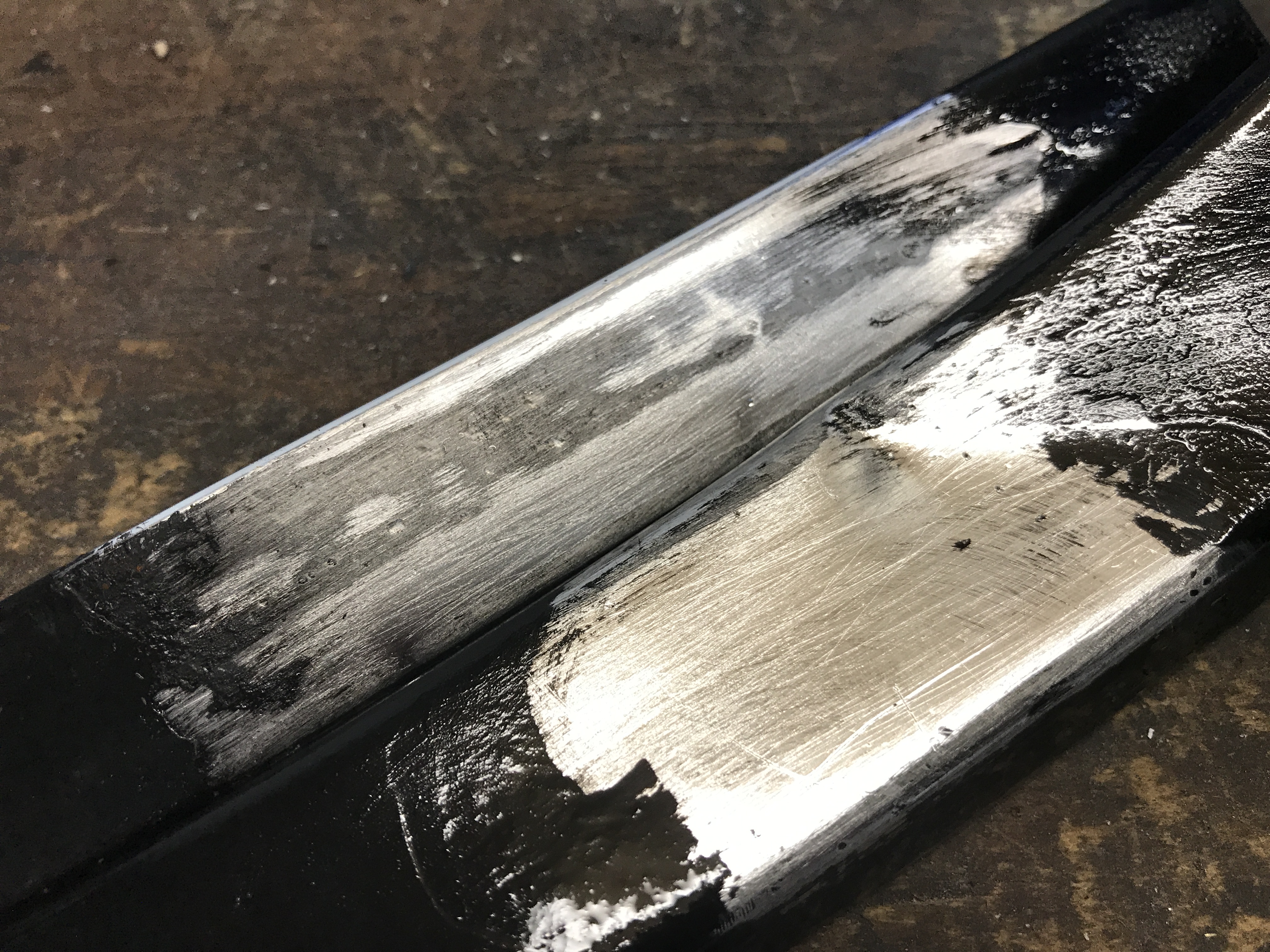

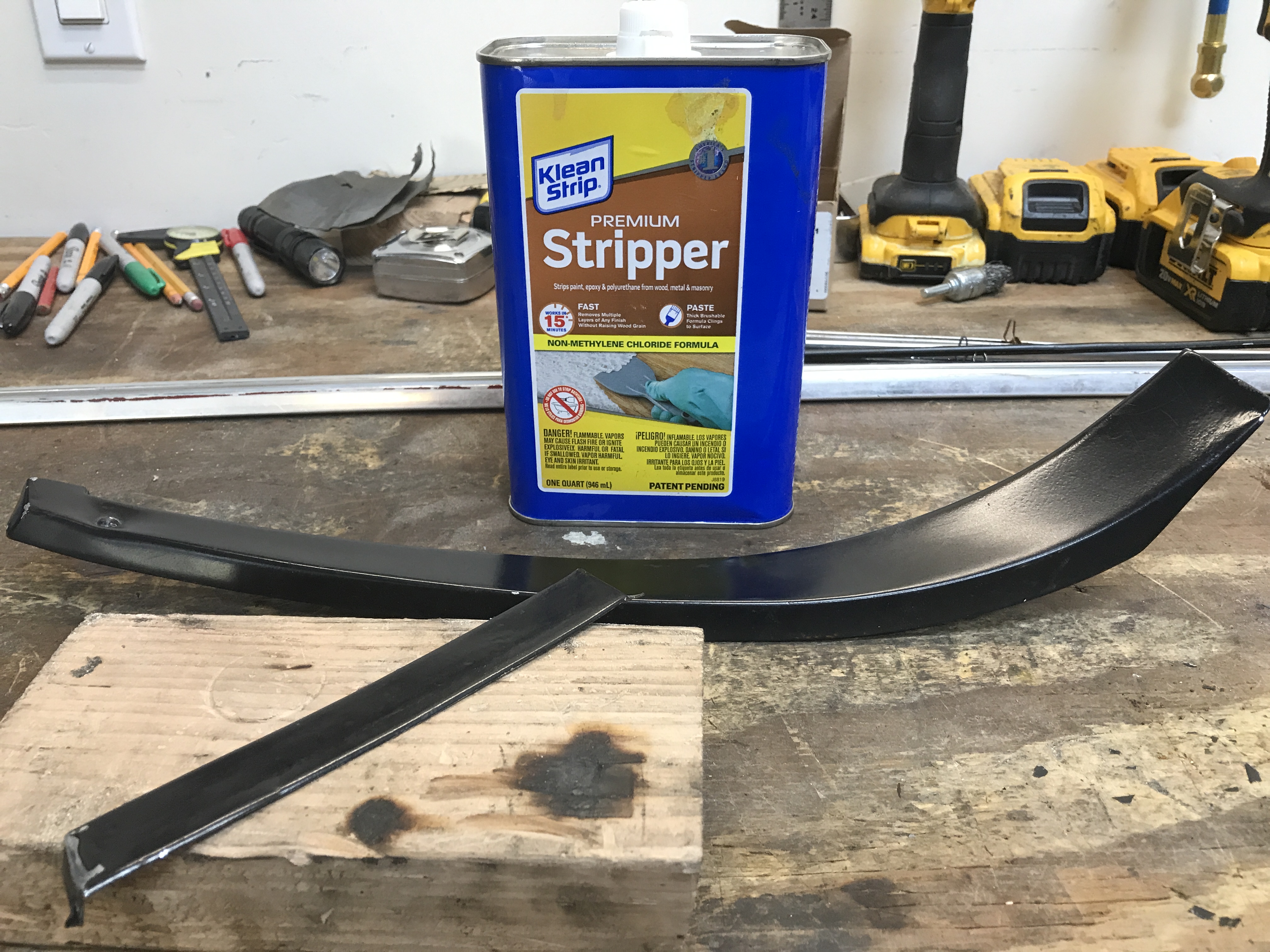

Next, I tried some paint stripper on the blacked out trim from my car.
bkrantz
post Sep 11 2020, 08:19 PM
Post #1276
Posts: 8,827
Joined: 3-August 19
From: SW Colorado
Member No.: 23,343
The stripper works well enough, but reveals that like on the chrome bumpers, some PO sanded the polished surfaces before painting.

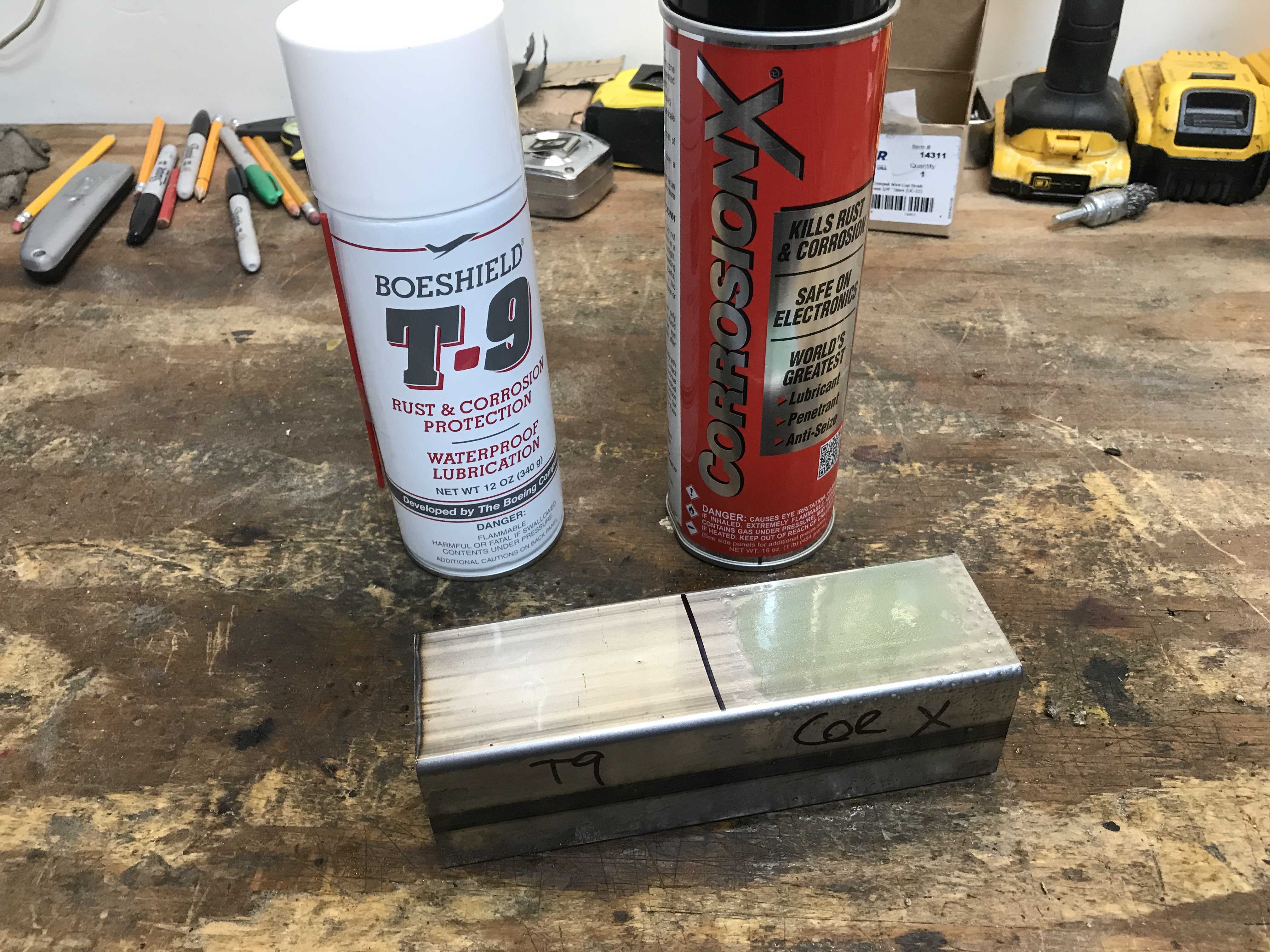

Then I started a test for materials to protect unpainted steel. I sprayed these on a piece of raw square tubing. These will need 24 hours to dry.

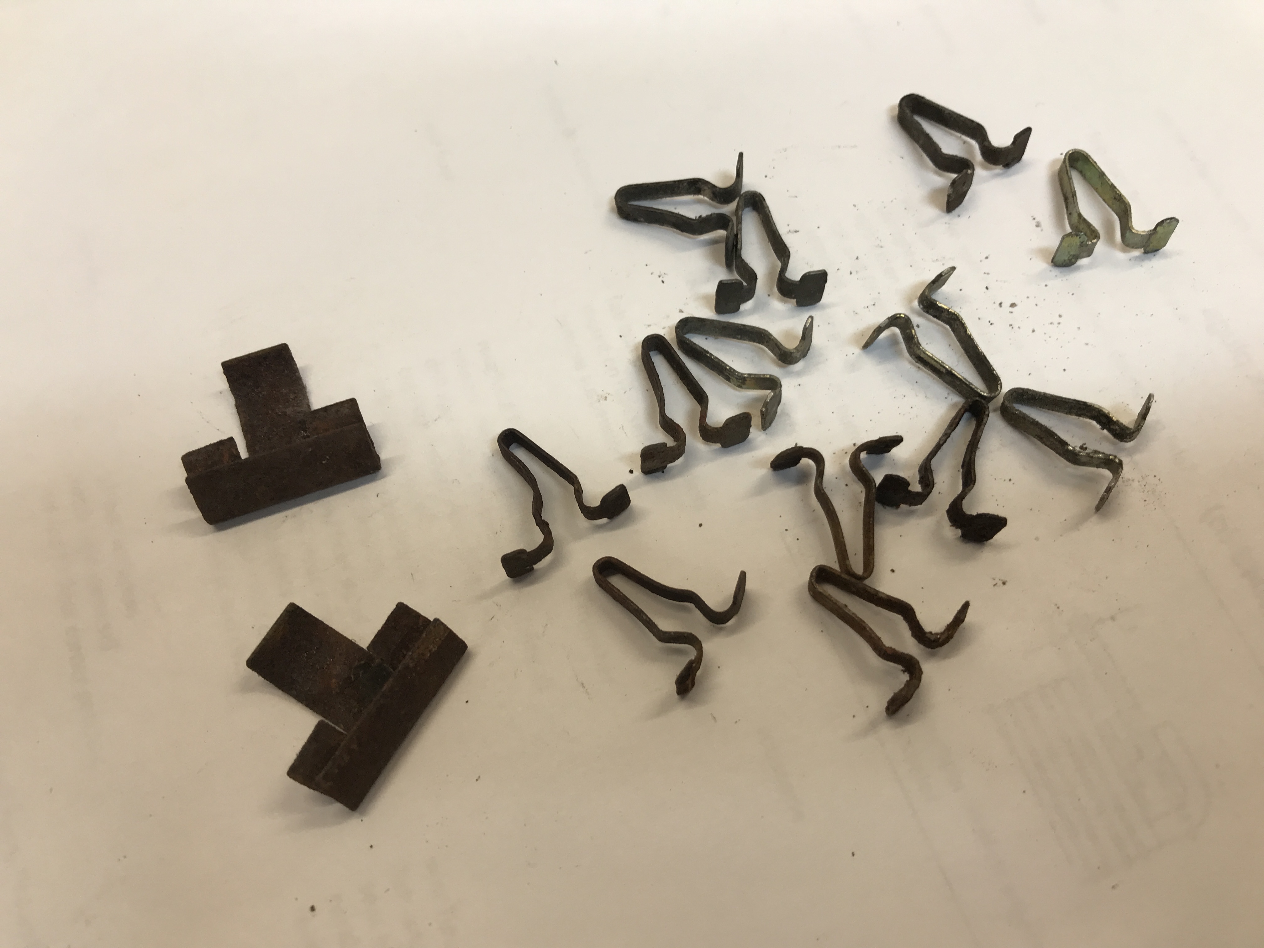

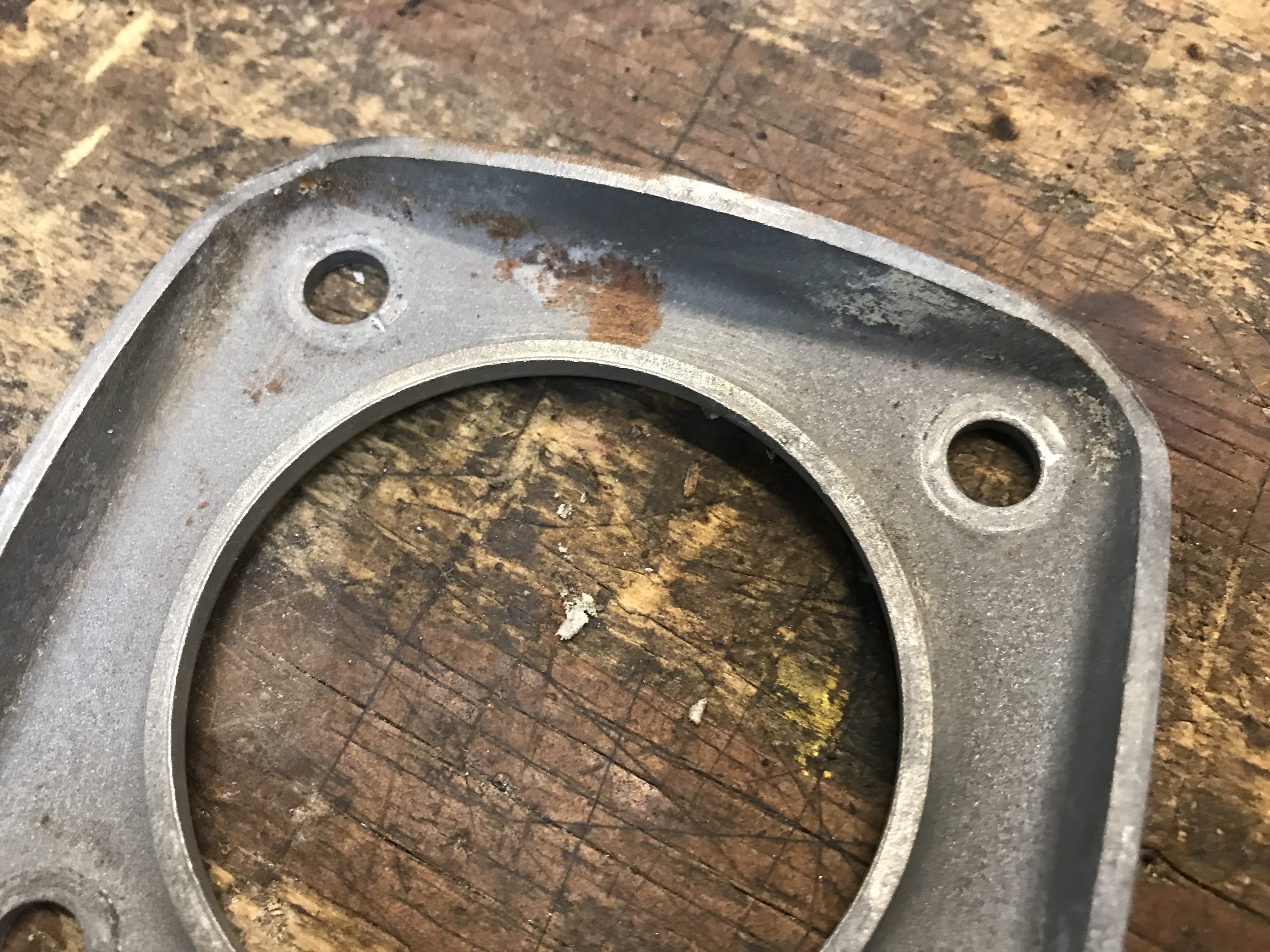

Finally, I gather some miscellaneous small parts with variable amounts or rust, like the retaining clips for the targa hoop trim.
bkrantz
post Sep 11 2020, 08:25 PM
Post #1279
Posts: 8,827
Joined: 3-August 19
From: SW Colorado
Member No.: 23,343
And the rear wheel bearing retainer plates.

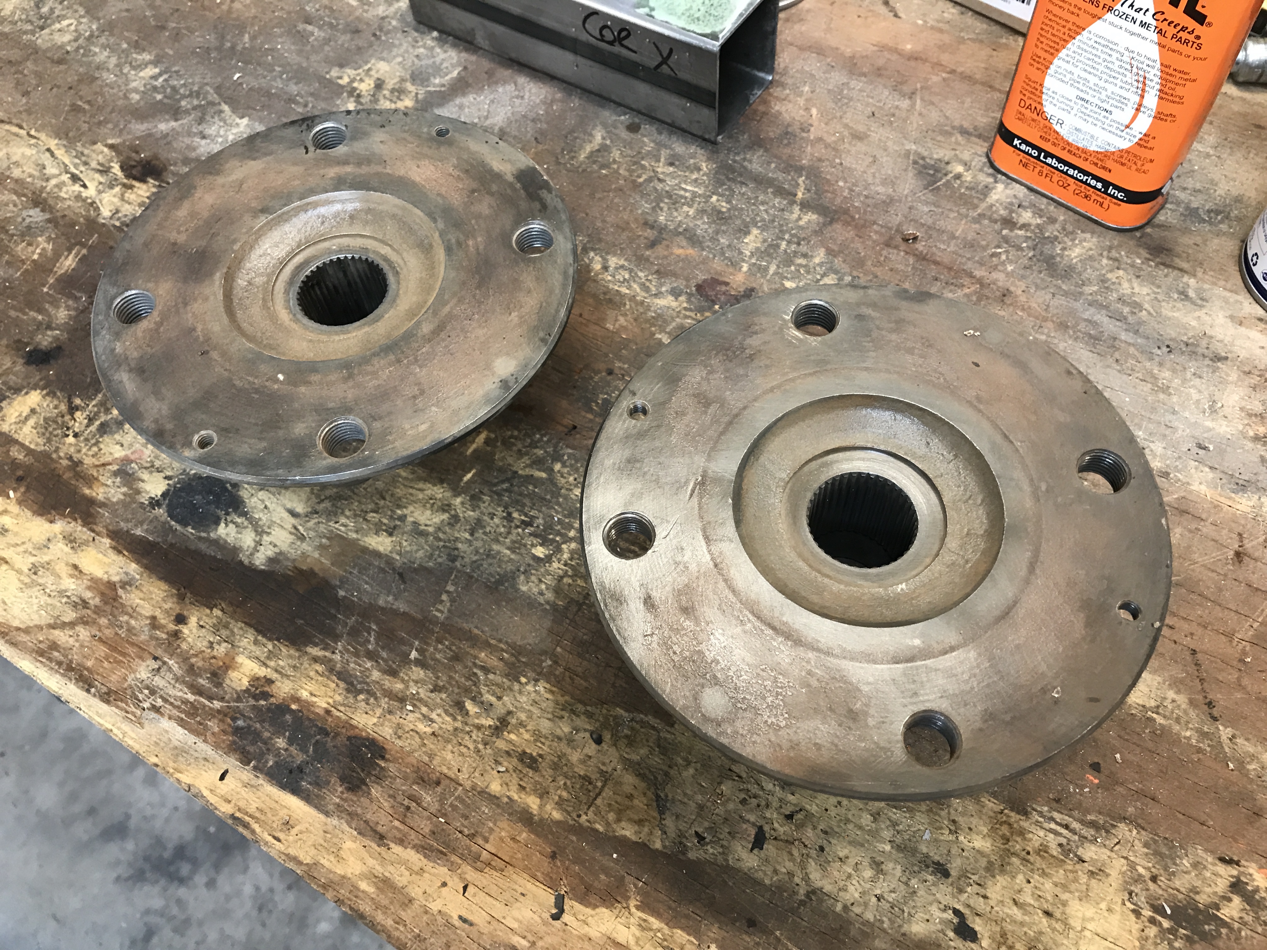

bkrantz
post Sep 11 2020, 08:26 PM
Post #1280
Posts: 8,827
Joined: 3-August 19
From: SW Colorado
Member No.: 23,343
And the rear wheel flanges.
