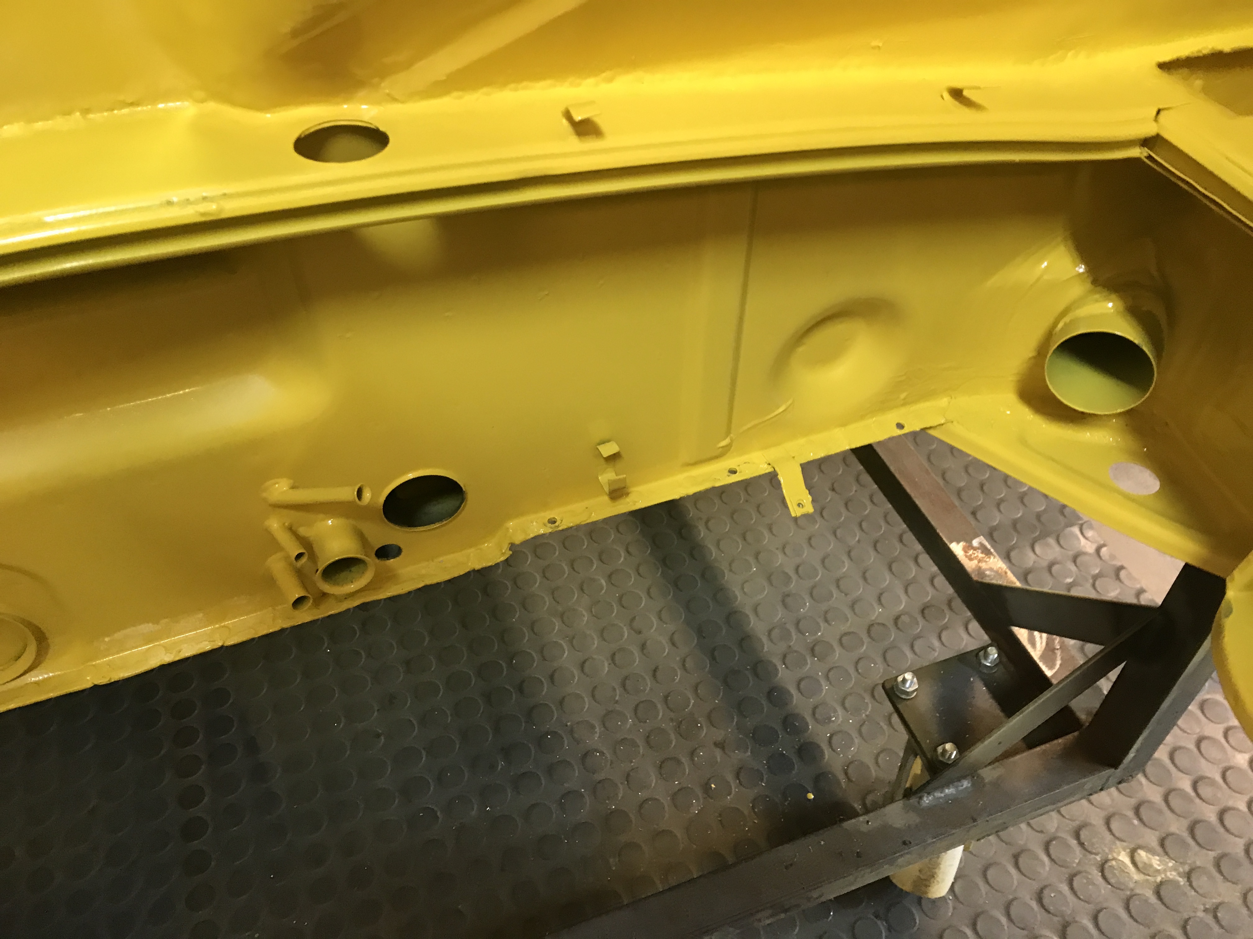

I usually use about 10 of those cans on a car before paint. I do everything I can find.
I have had it come out other holes and get everywhere, hence, Before paint.
Blankets and tape everywhere while working and all will be well.
Let the fun begin.

Thanks. I probably should have done it before paint, but I managed to get the sealer where I wanted without too much mess.

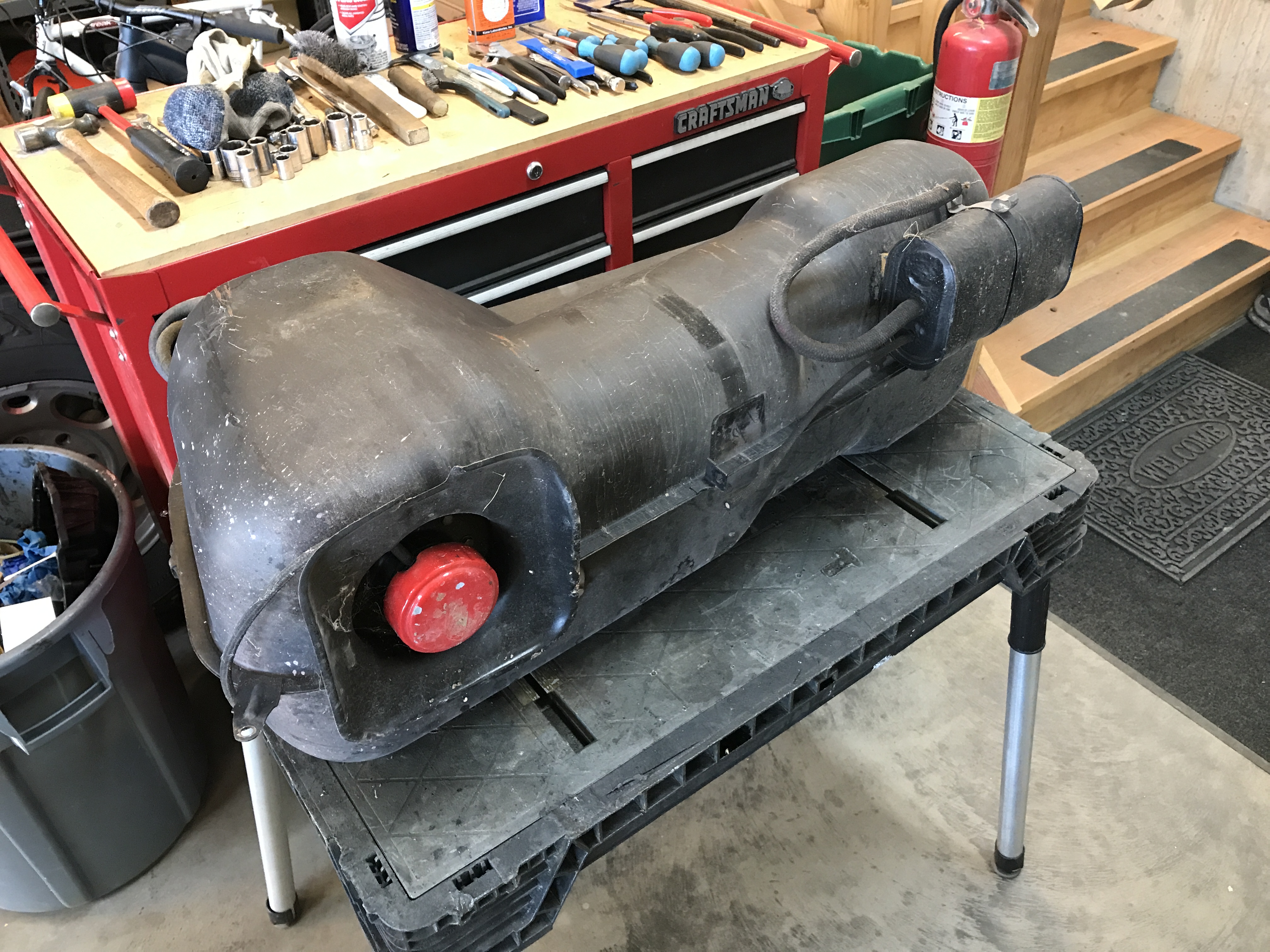

Some schedule changes means some work plan changes. I will have a chance to drop off the fuel tank for cleaning, so I pulled it from storage.
bkrantz
post Nov 15 2020, 08:39 PM
Post #1584
Posts: 8,710
Joined: 3-August 19
From: SW Colorado
Member No.: 23,343
Tank stripped of fittings and sender.

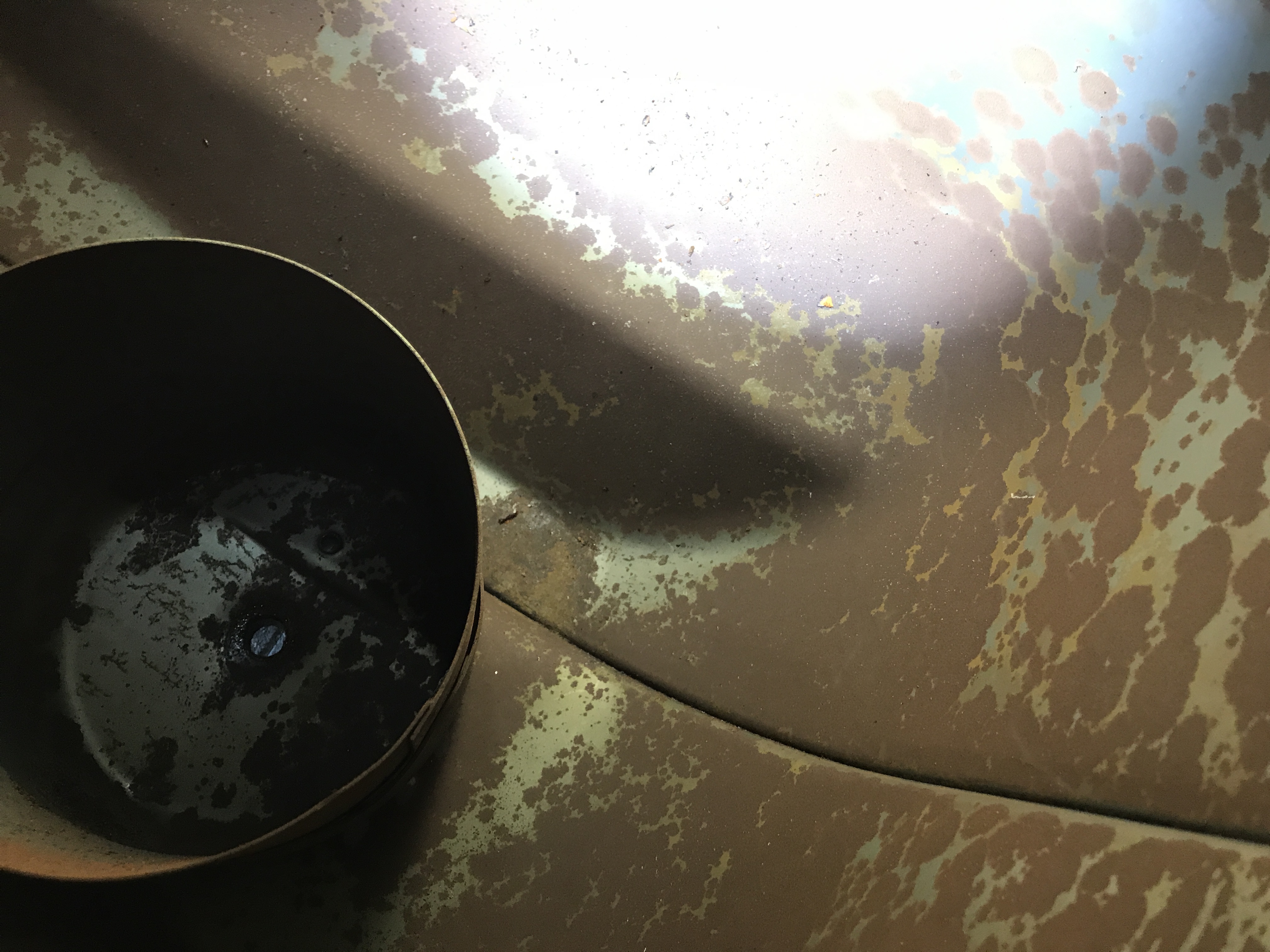

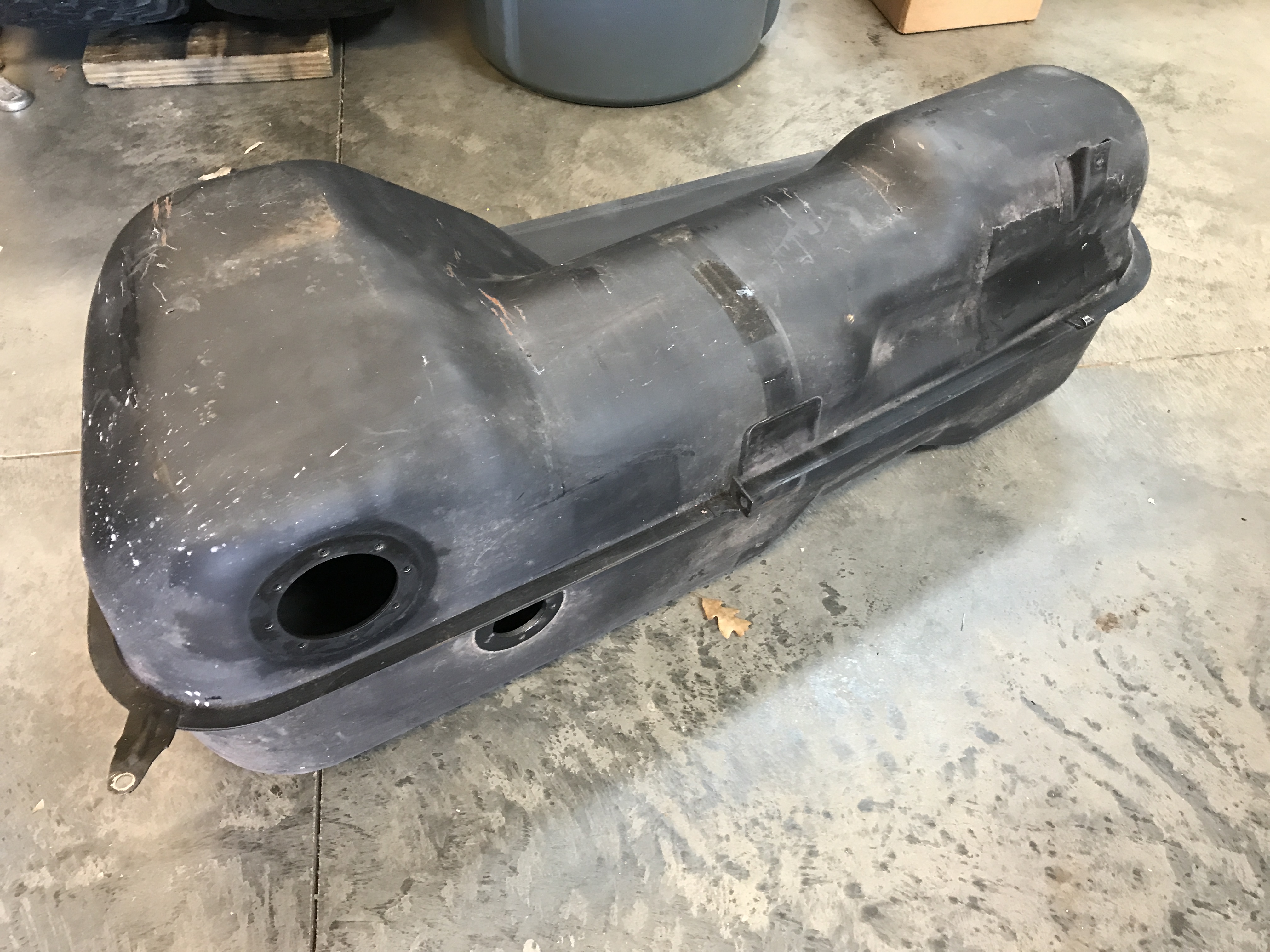

A peek inside--some surface rust.

QUOTE(bkrantz @ Nov 15 2020, 07:39 PM) *
Are you using the radiator shop in town on N. Main? He is pretty good.
He did my friends 356 tank last year.

We are making a run to Tucson. At least one shop there offers the RENU process. I am also taking some interior parts, including the seats, to talk with some custom upholstery shops.

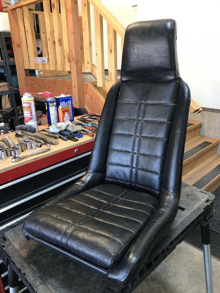

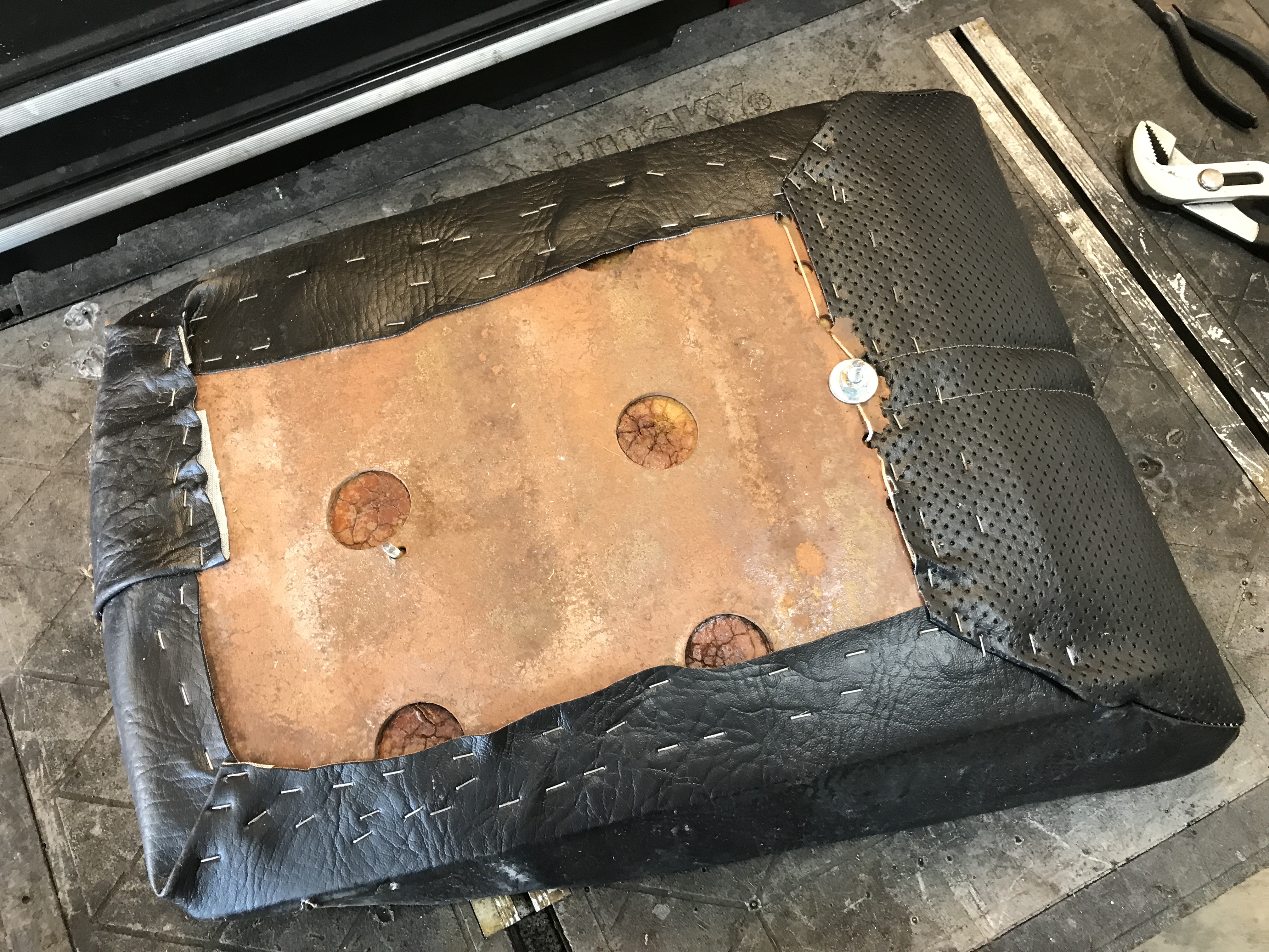

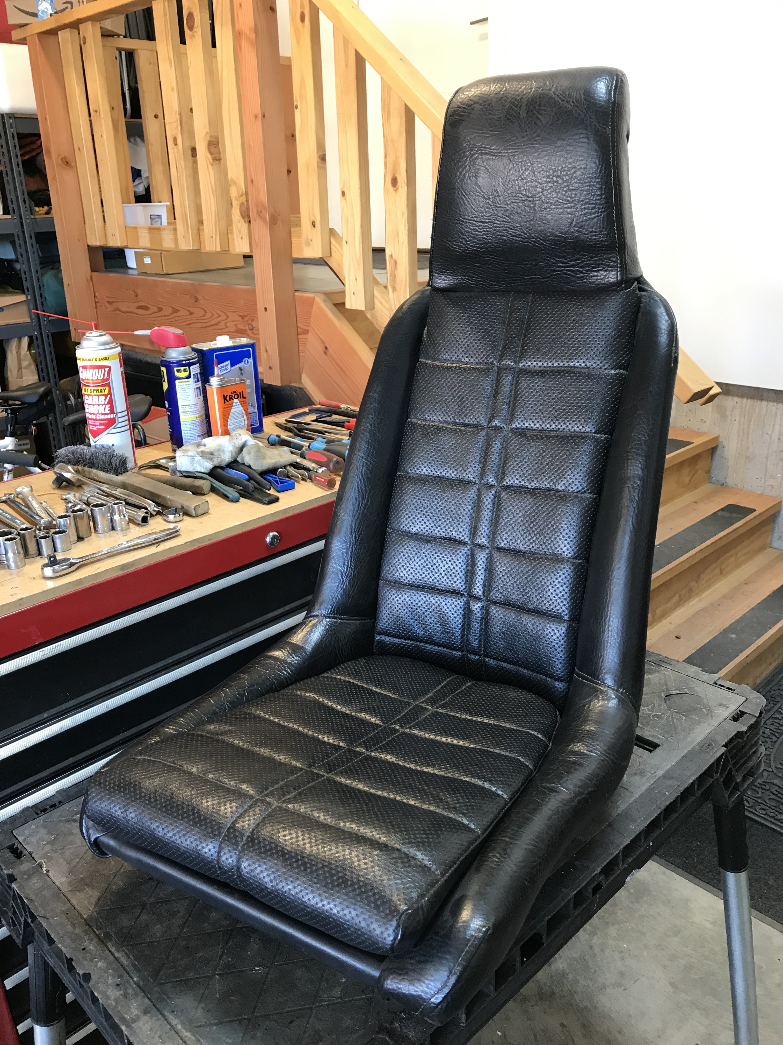

Here's what my seats looks like now, essentially a stock look. A couple of the side bolsters are a bit lumpy. The bottom cushions are original (I think--could be extra padding on top), but are maybe a bit thick for me--I will need every bit of head room, at least with the top on.
bkrantz

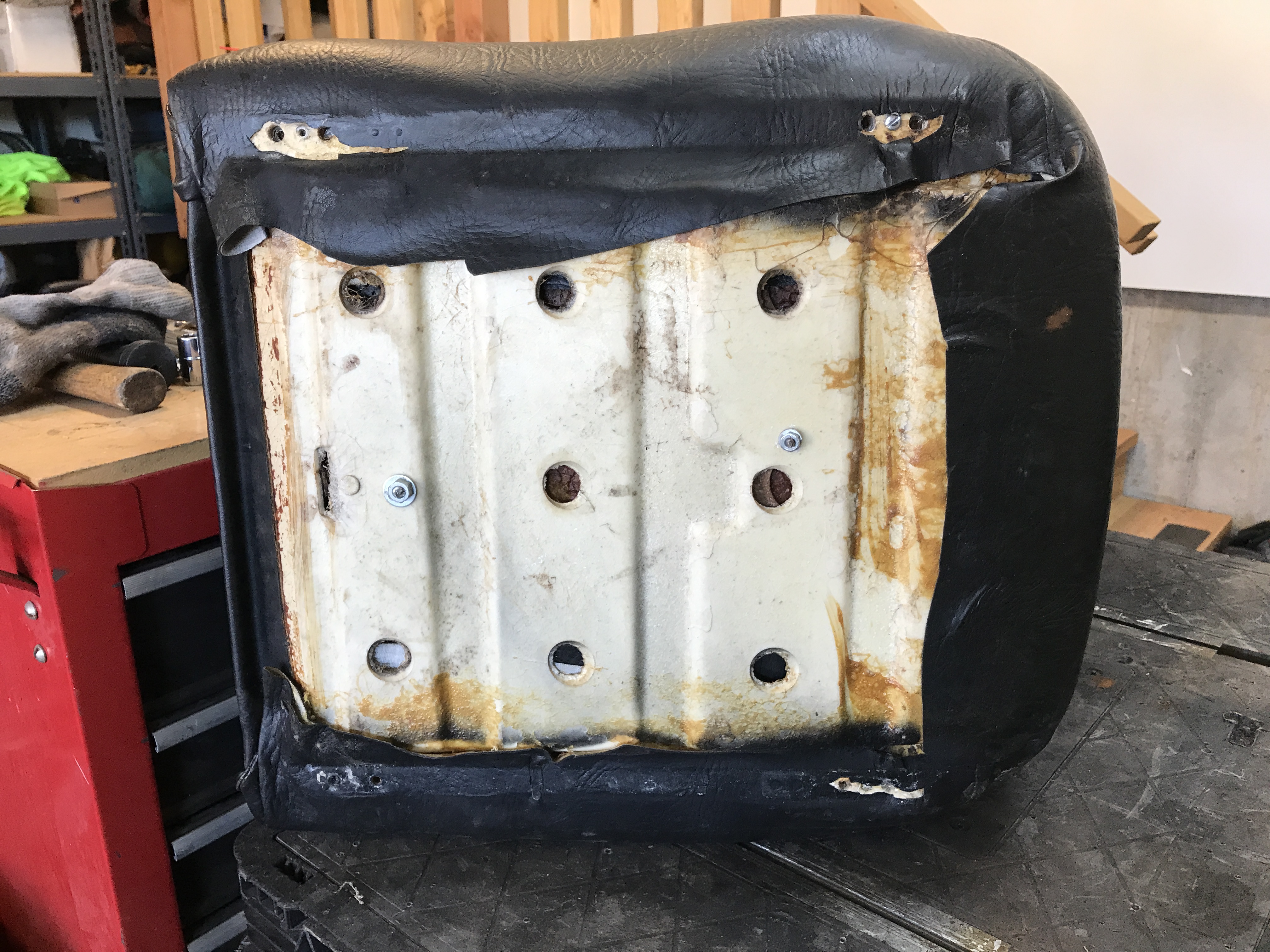

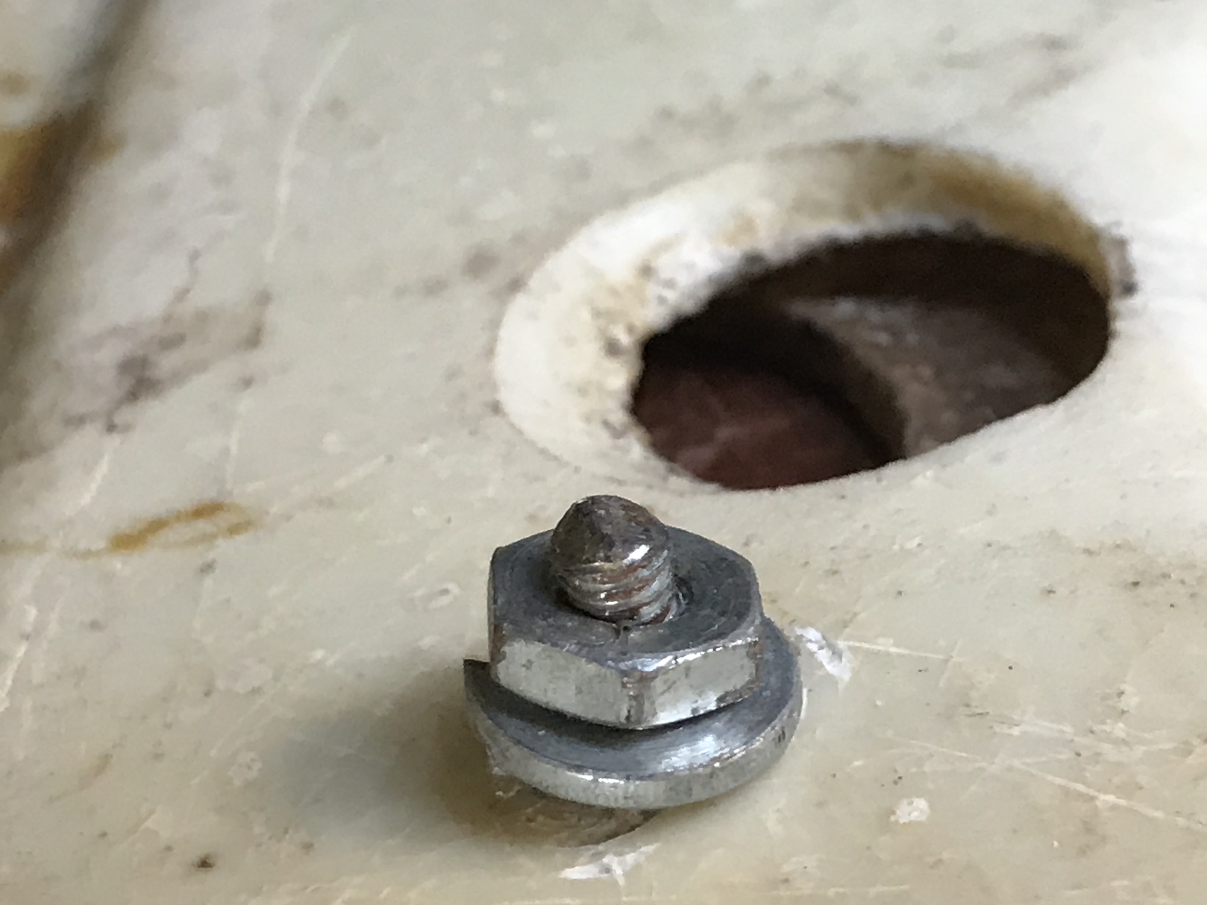

The bottoms are also attached with custom PO bolts.

No retaining clip on the base board.
raynekat
post Nov 16 2020, 10:03 PM
Post #1592
Posts: 2,171
Joined: 30-December 14
From: Coeur d'Alene, Idaho
Member No.: 18,263
QUOTE(bkrantz @ Nov 16 2020, 06:53 PM) *
Hence the nice "bolt work" from the PO. (IMG:style_emoticons/default/smile.gif)

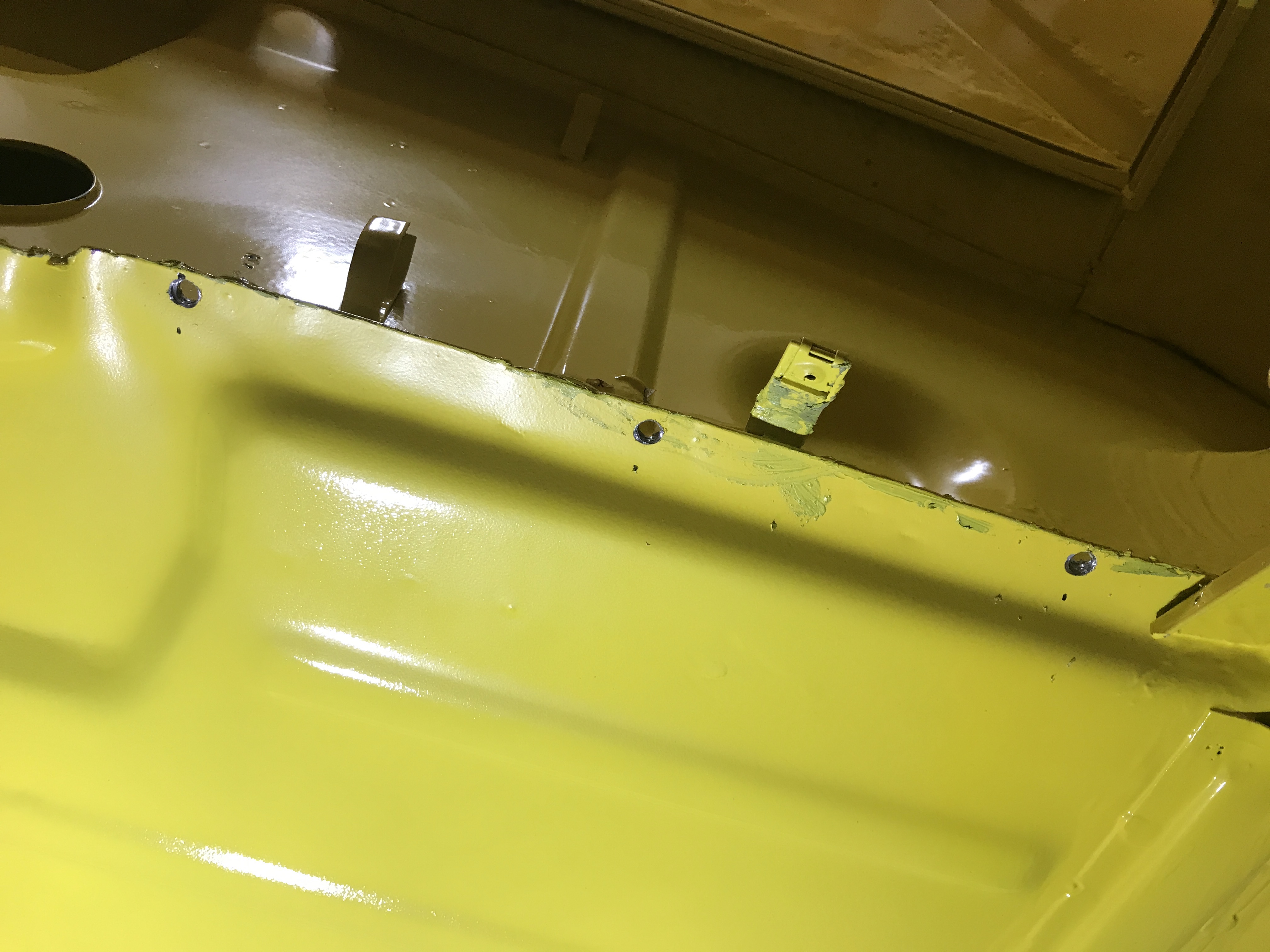

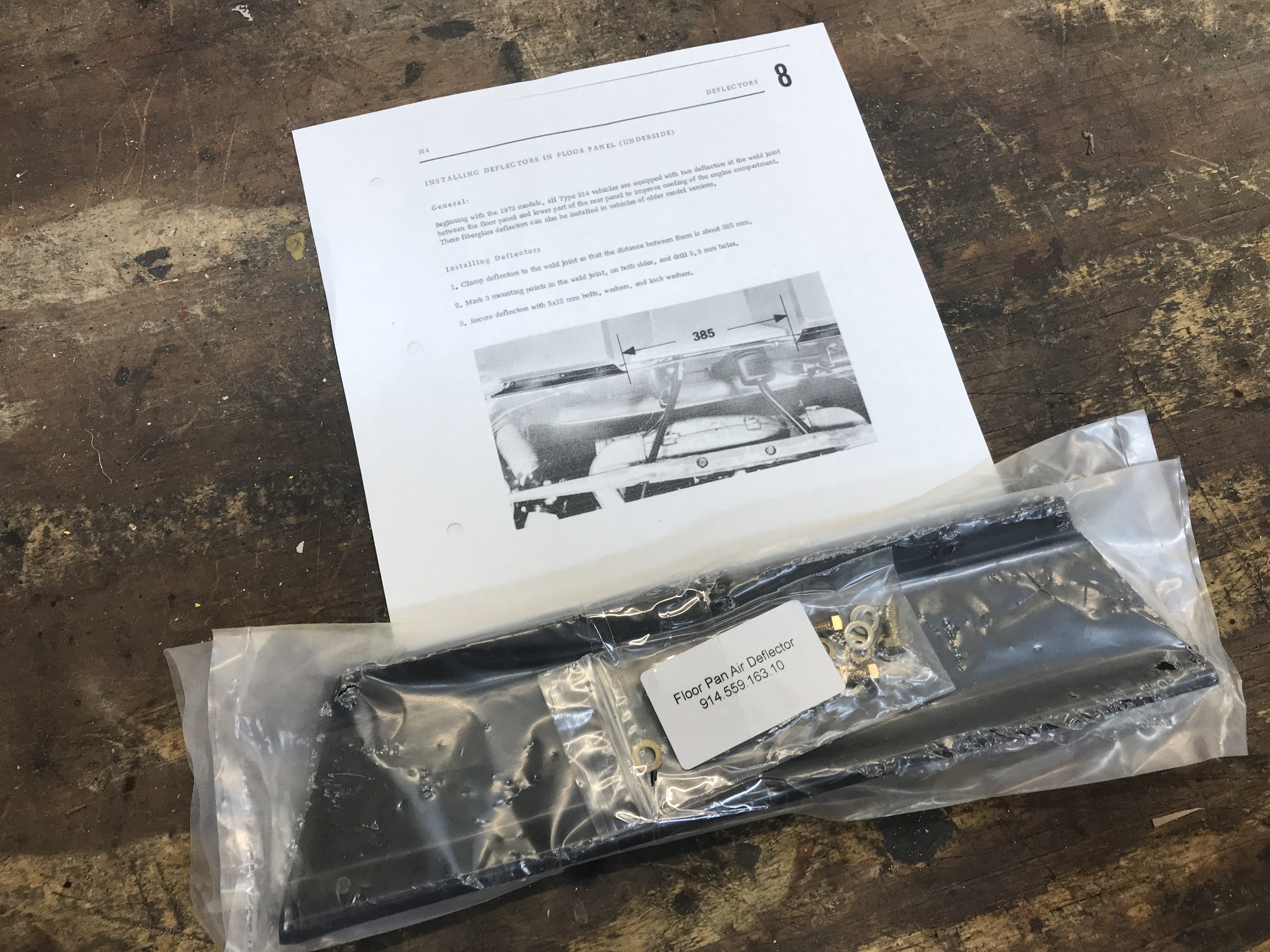

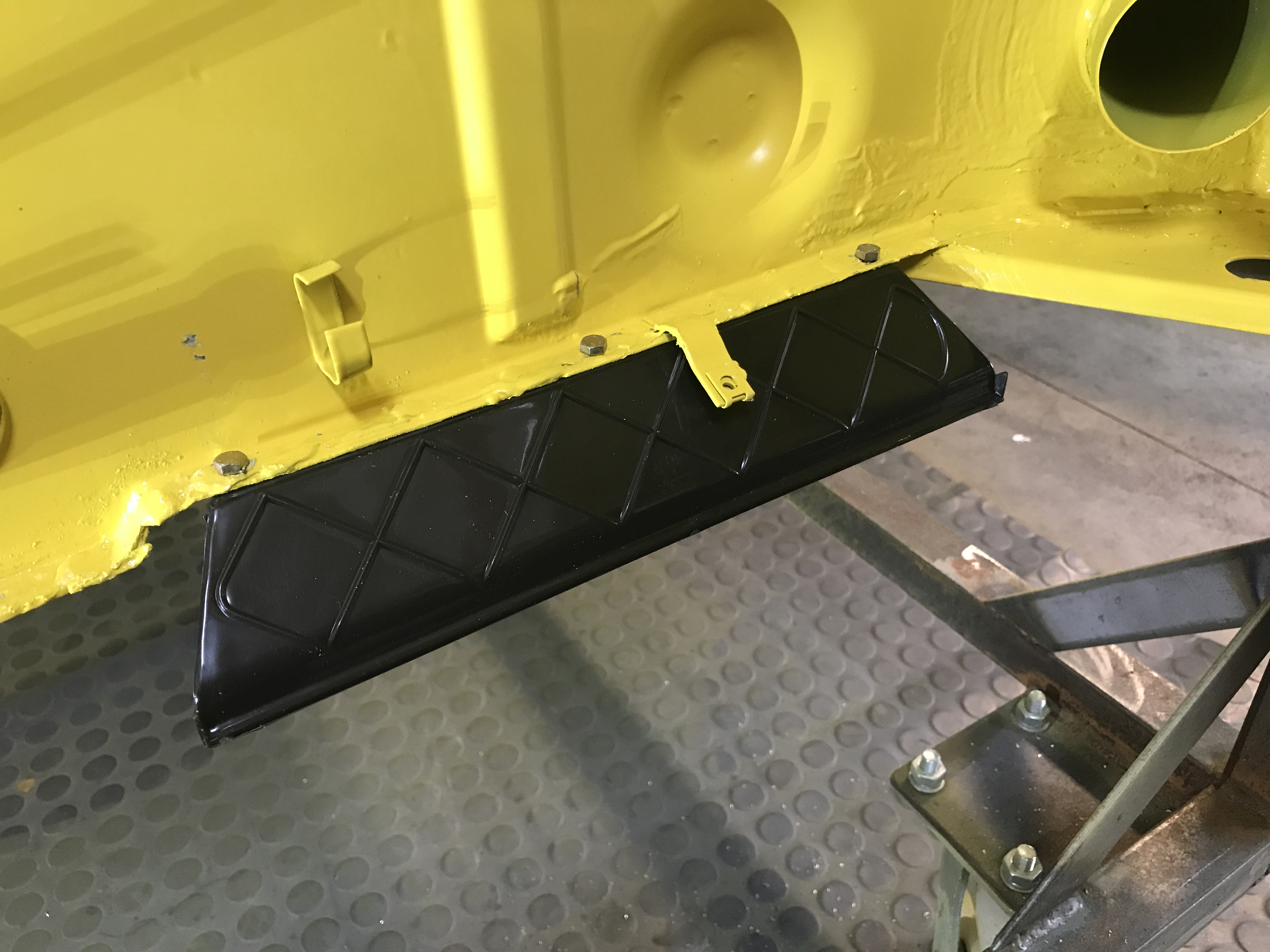

Another slight detour: I remembered that to mount the engine compartment deflectors I needed to drill holes, something else I forgot before send the car to the paint shop.
Here's the deflector kit from 914 Rubber, and the page from the shop manual with the magic spacing dimension.
bkrantz
post Nov 17 2020, 08:09 PM
Post #1594
Posts: 8,710
Joined: 3-August 19
From: SW Colorado
Member No.: 23,343
Holes drilled from below.
bkrantz

bkrantz

bkrantz

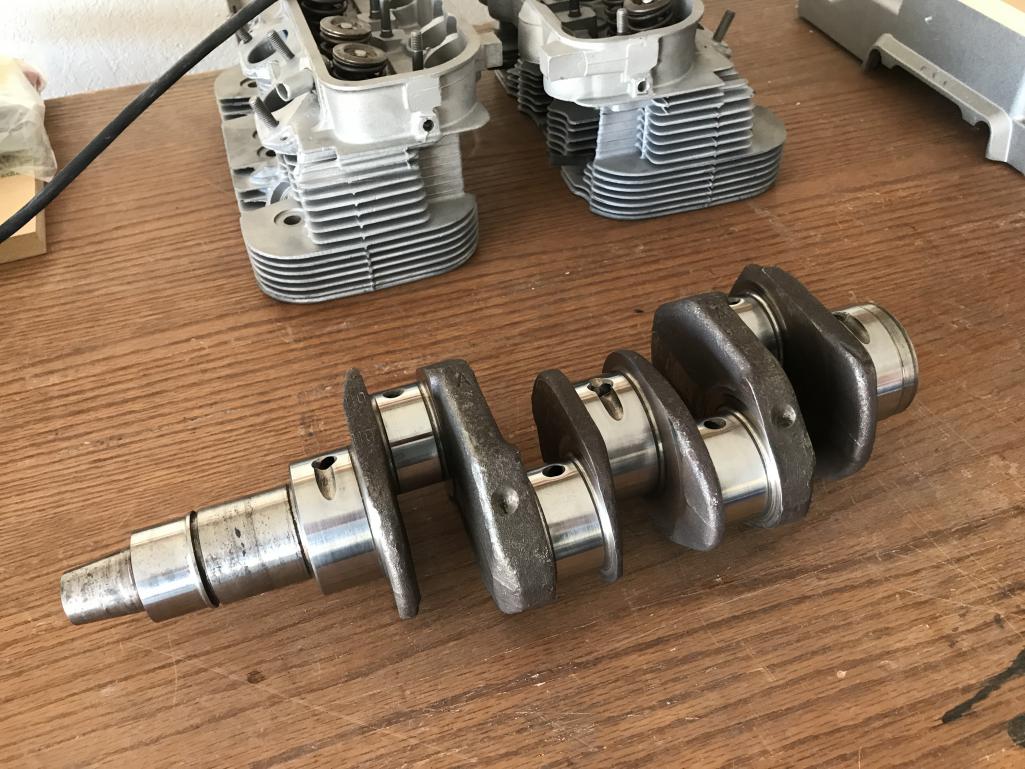

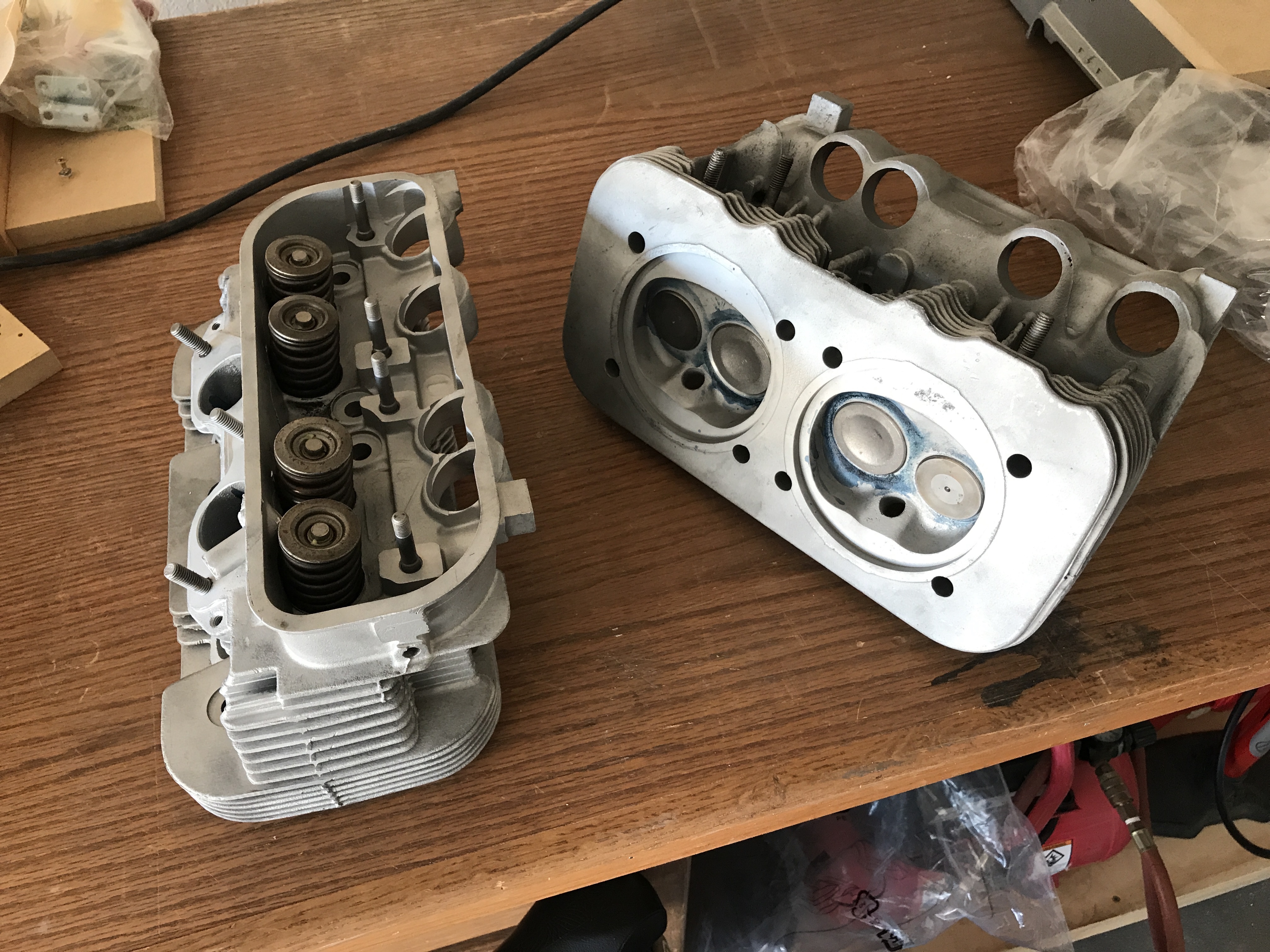

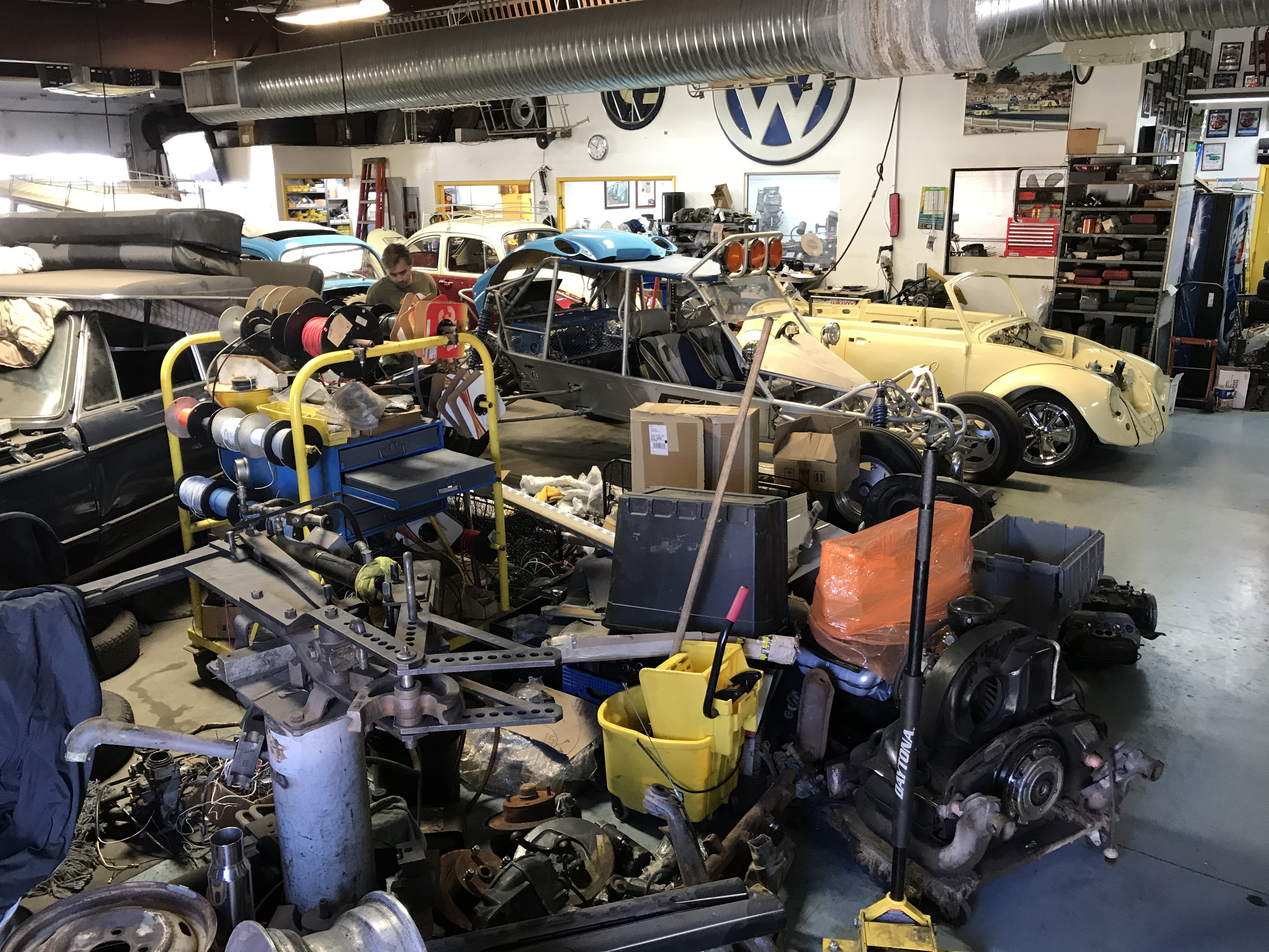

I picked up some of my engine parts from Competition Engineering in Phoenix.
bkrantz
post Nov 19 2020, 08:52 PM
Post #1598
Posts: 8,710
Joined: 3-August 19
From: SW Colorado
Member No.: 23,343
Lots of air-cooled clutter.
bkrantz
post Nov 19 2020, 08:54 PM
Post #1599
Posts: 8,710
Joined: 3-August 19
From: SW Colorado
Member No.: 23,343

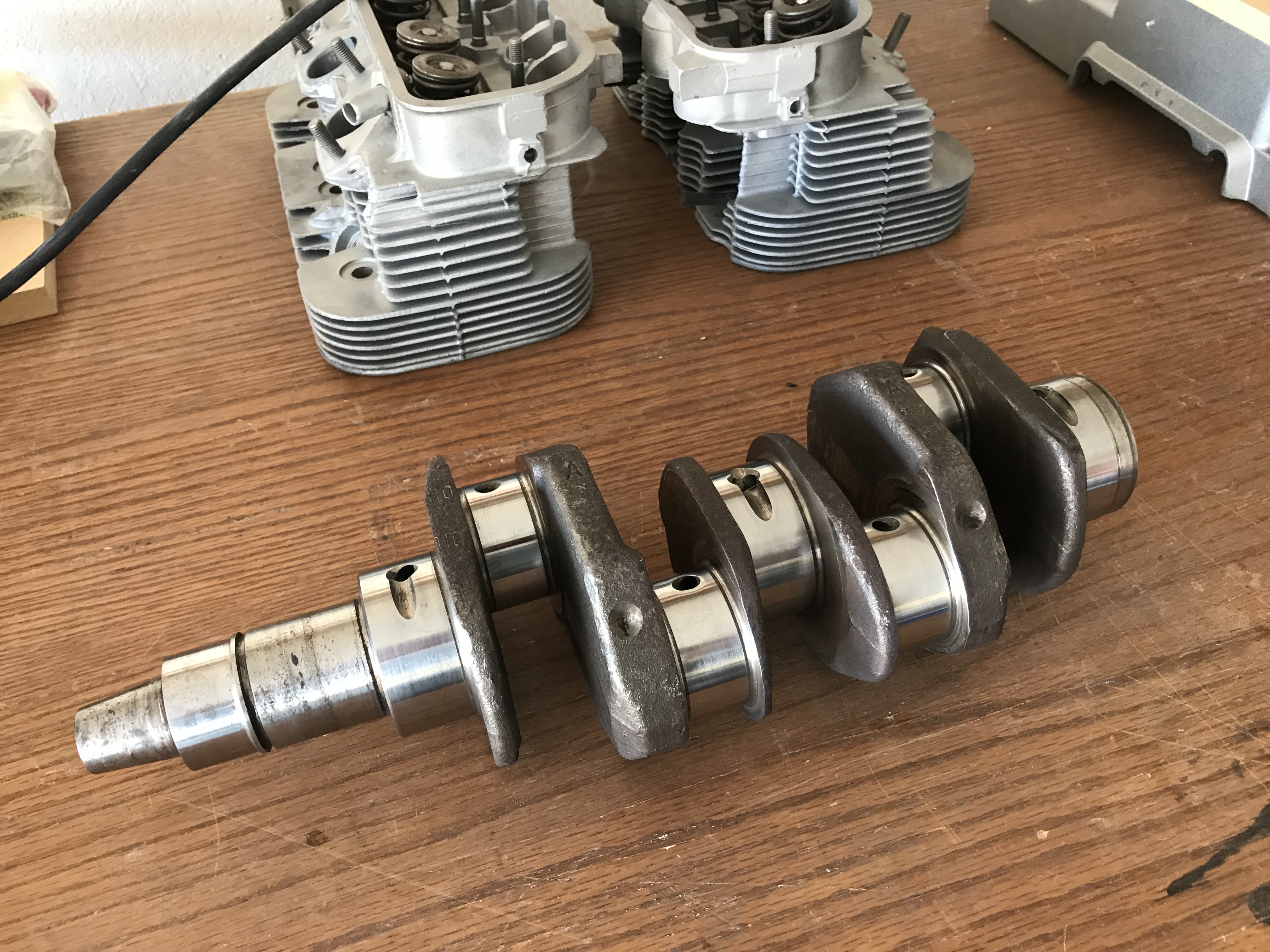

Heads with complete (stock) valve job.
bkrantz
post Nov 19 2020, 08:55 PM
Post #1600
Posts: 8,710
Joined: 3-August 19
From: SW Colorado
Member No.: 23,343
Crank checked and journals polished.
