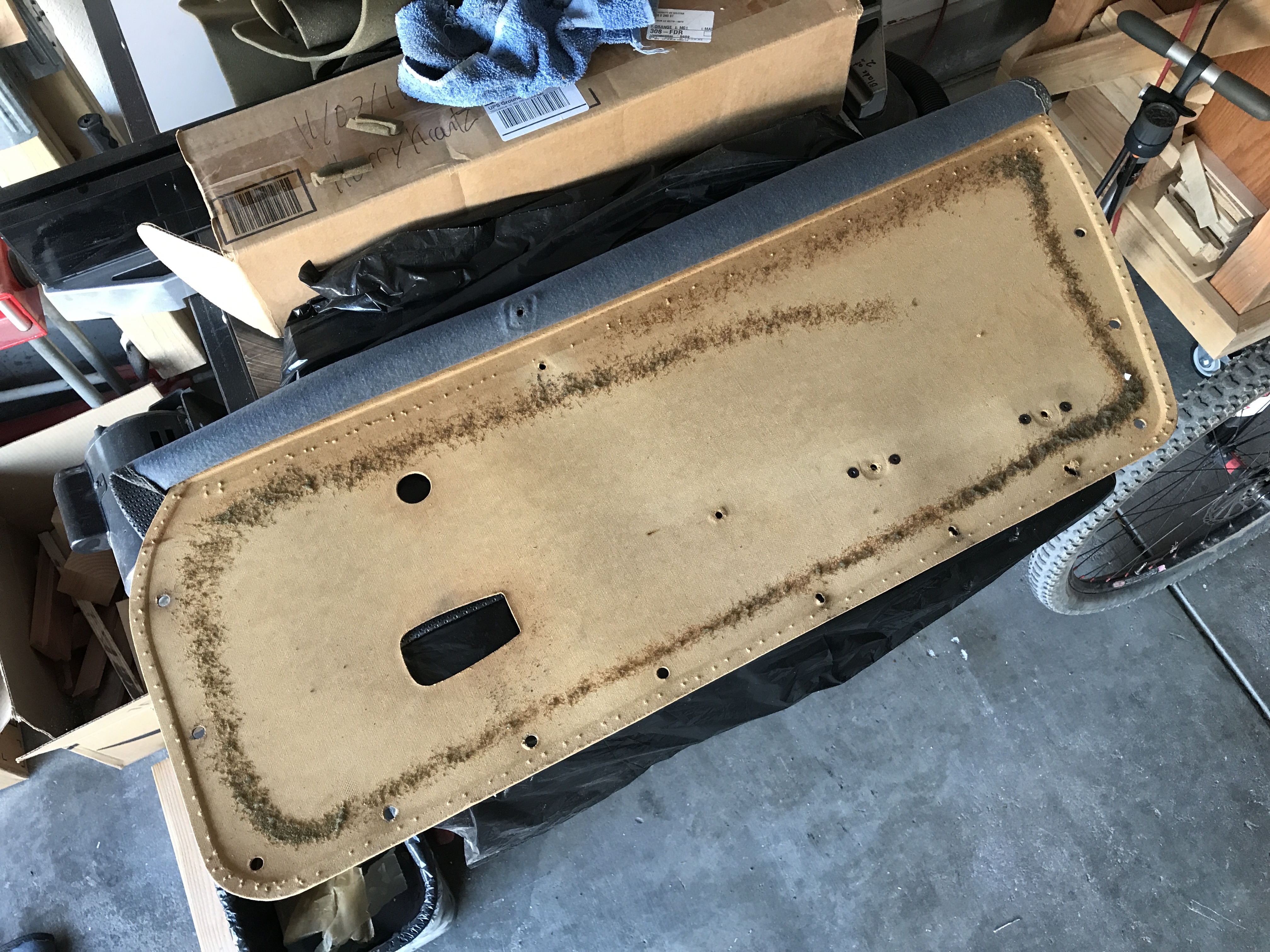

The door cards are in generally good shape, but have a bit of warping, especially on the driver side. I stripped the original vinyl so I could try to straighten the worst spots.
I sprayed both sides with water, placed them on flat concrete, and weighted them down with lumber scraps. We will see tomorrow if I made things better or worse.

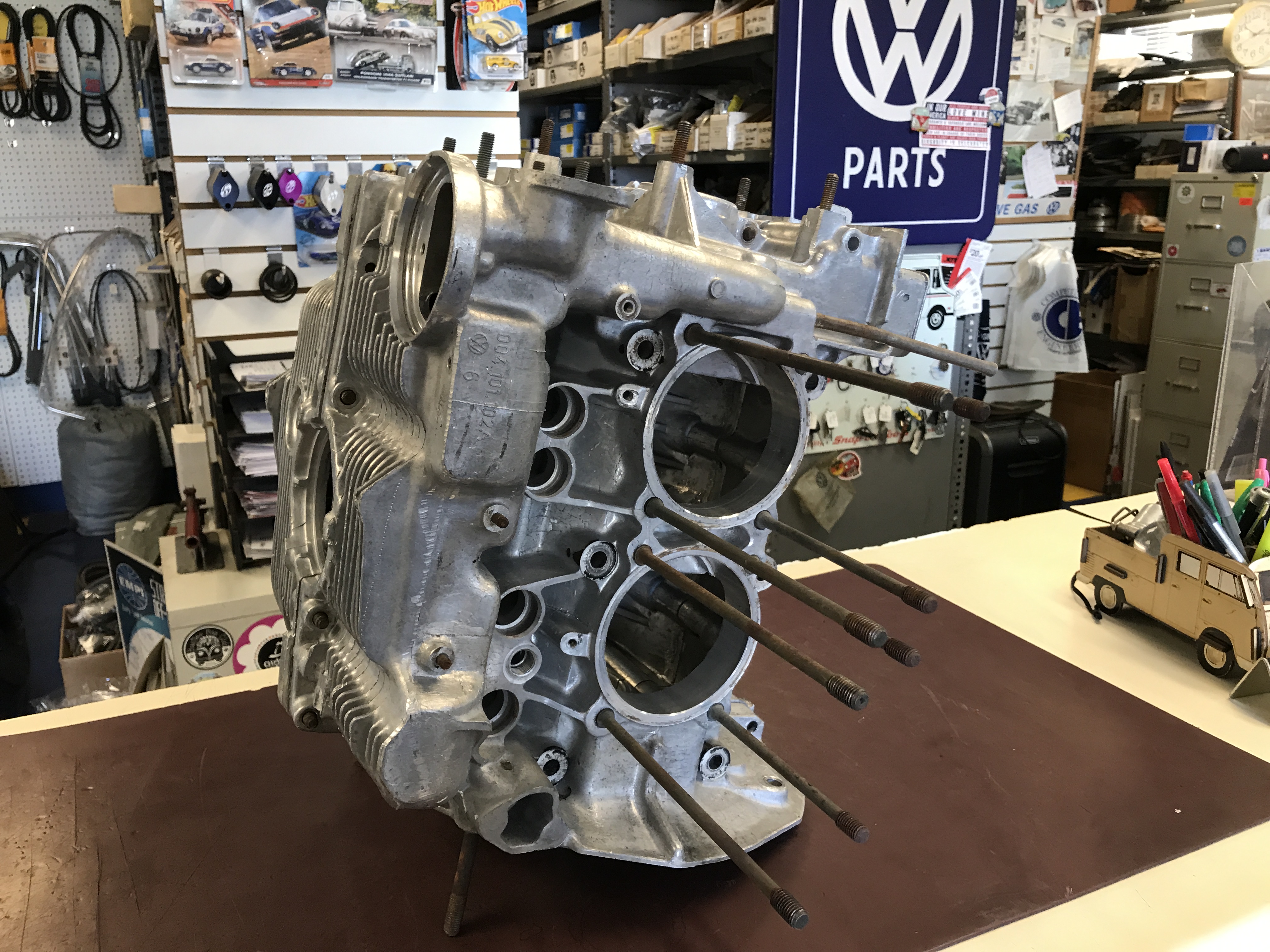

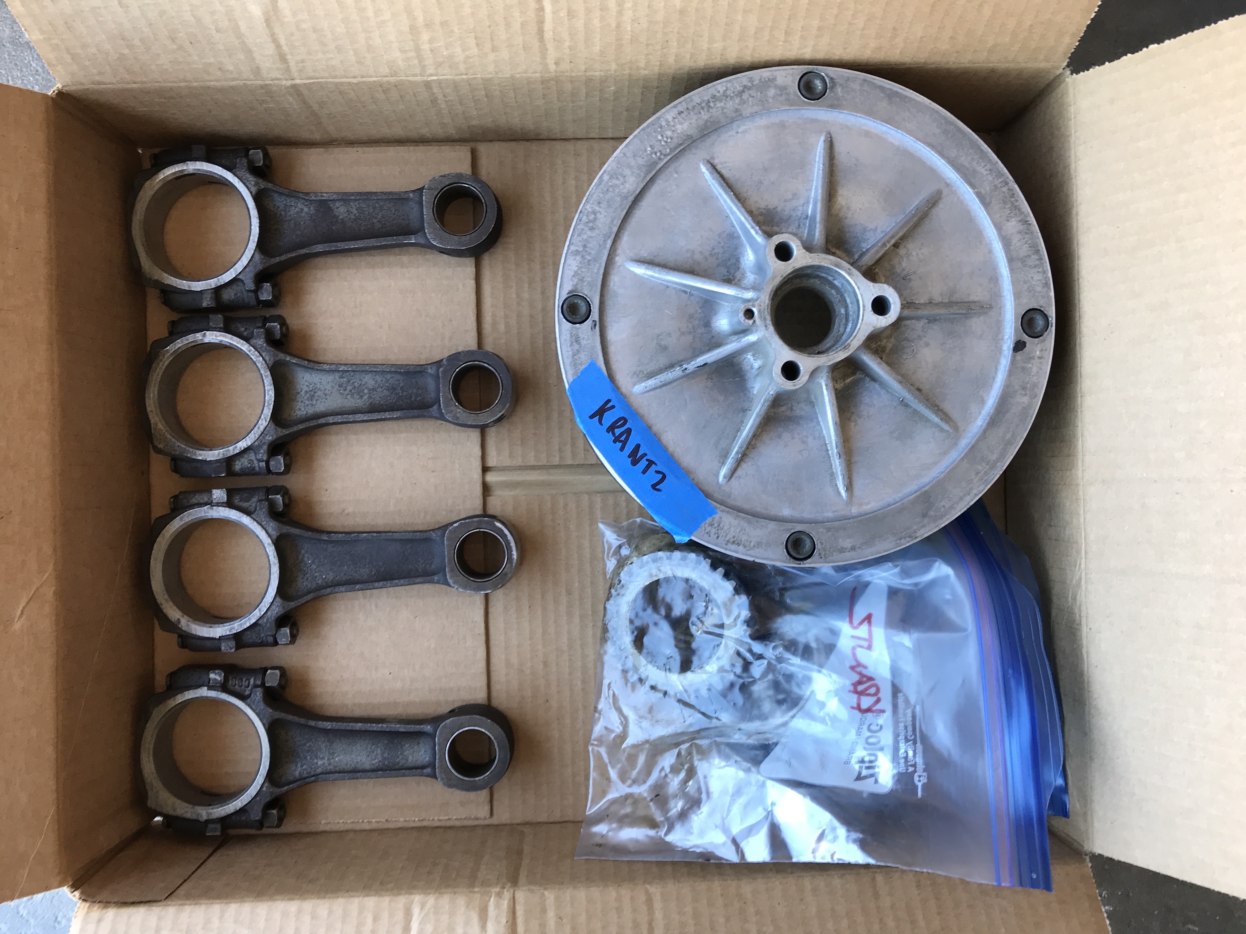

I picked up the rest of my engine parts at Competition Engineering in Phoenix.

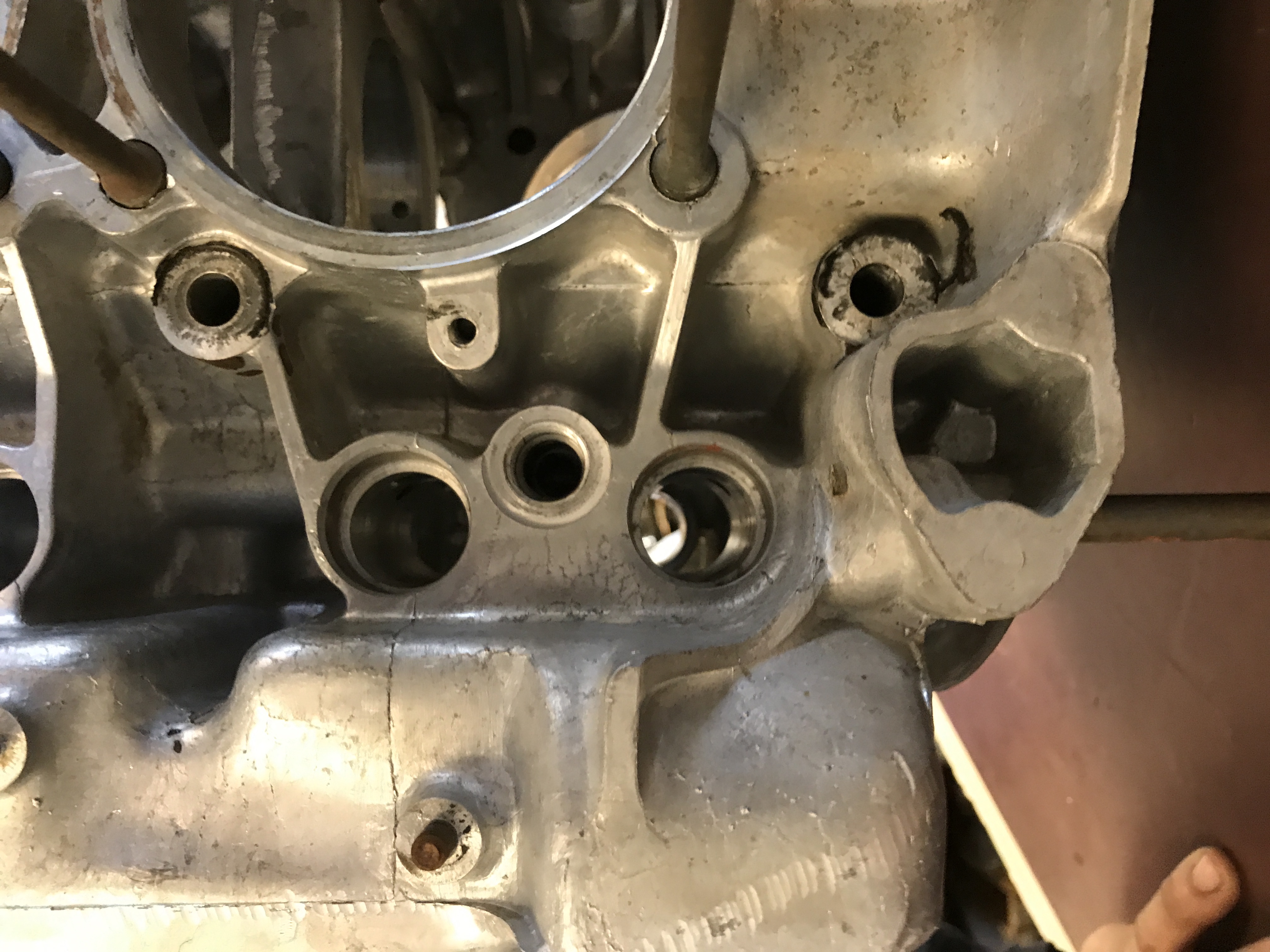

Dan checked the case for flat and square, and then drilled and tapped all the plugs.

They also balanced the rods.
