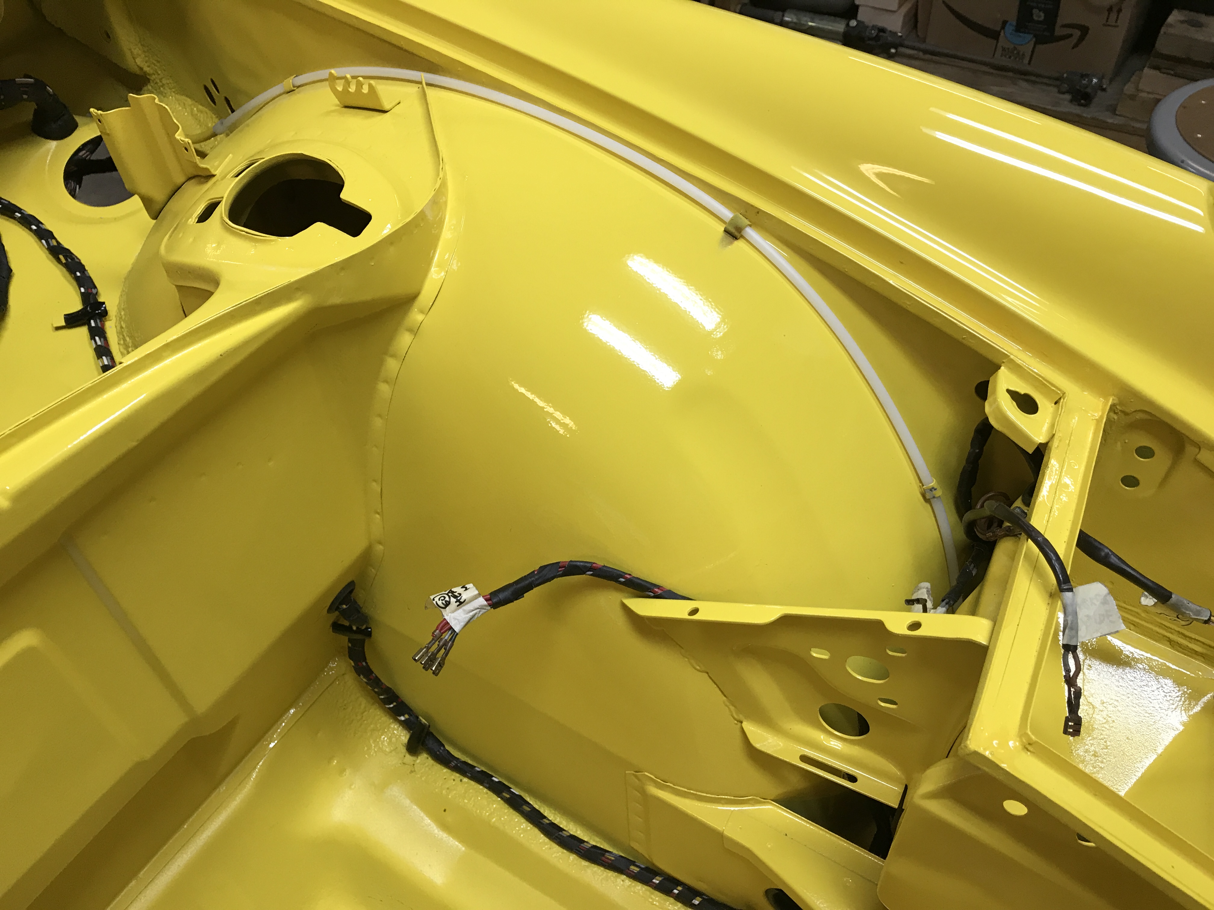

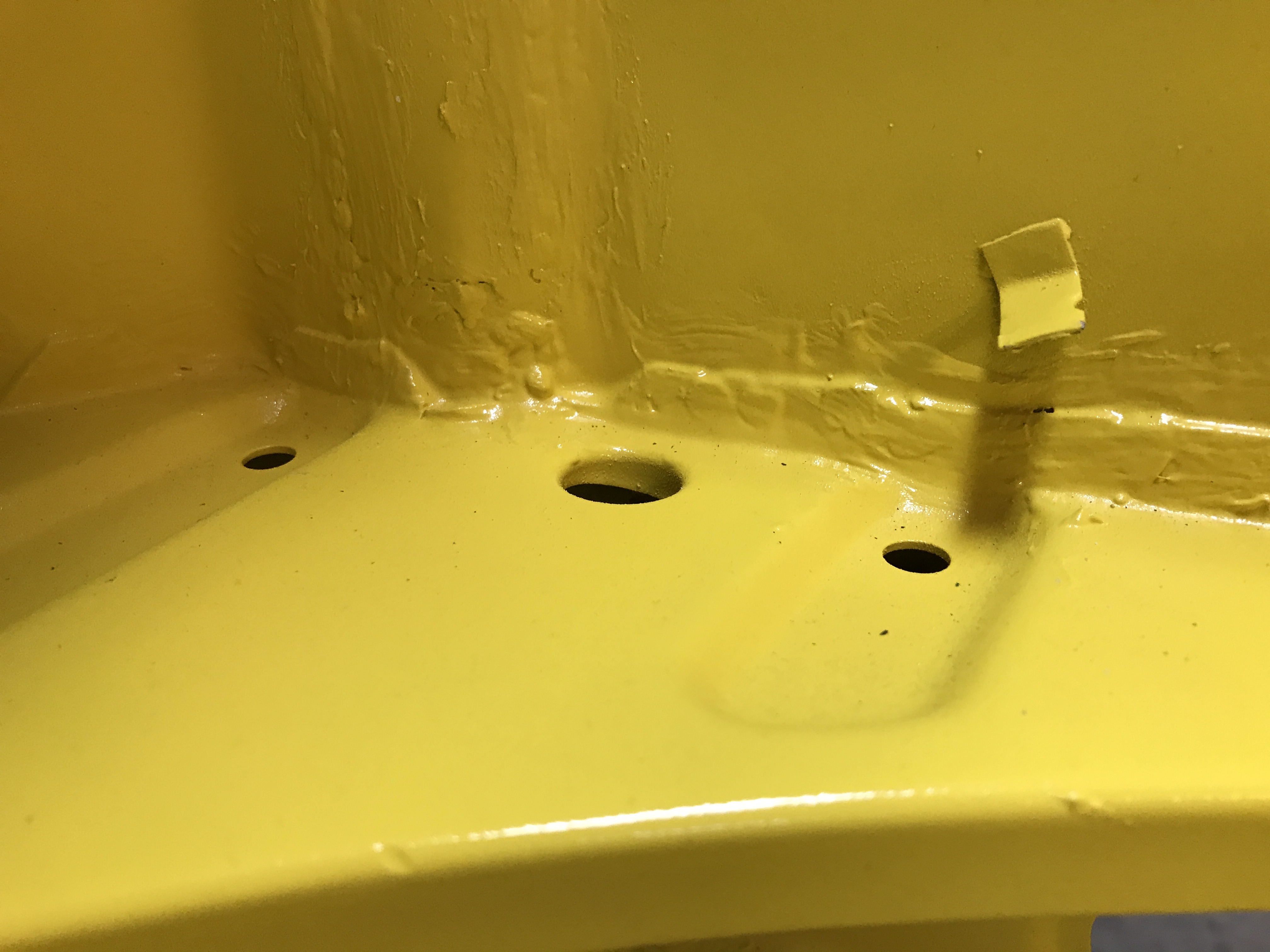

Along the inner fender--easy enough to follow the tabs.

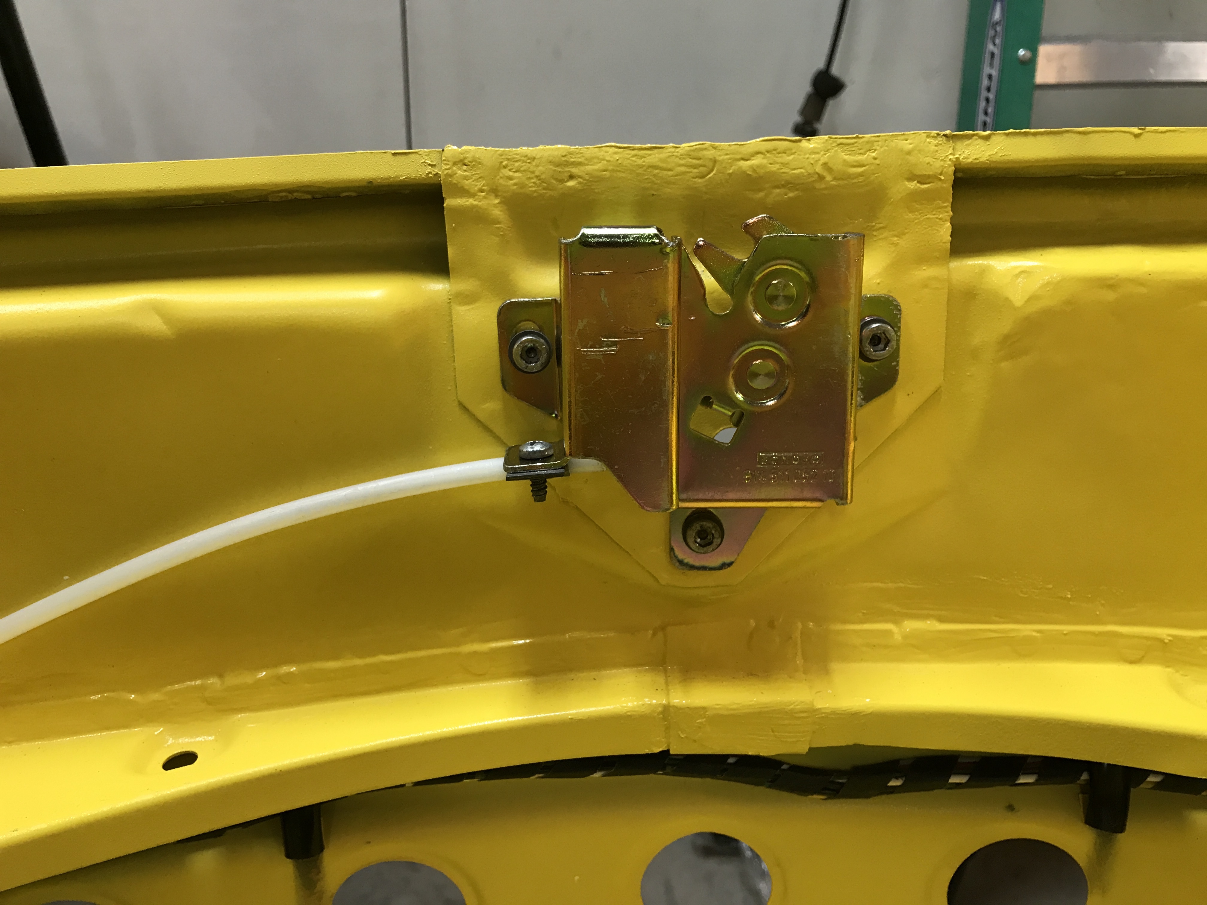

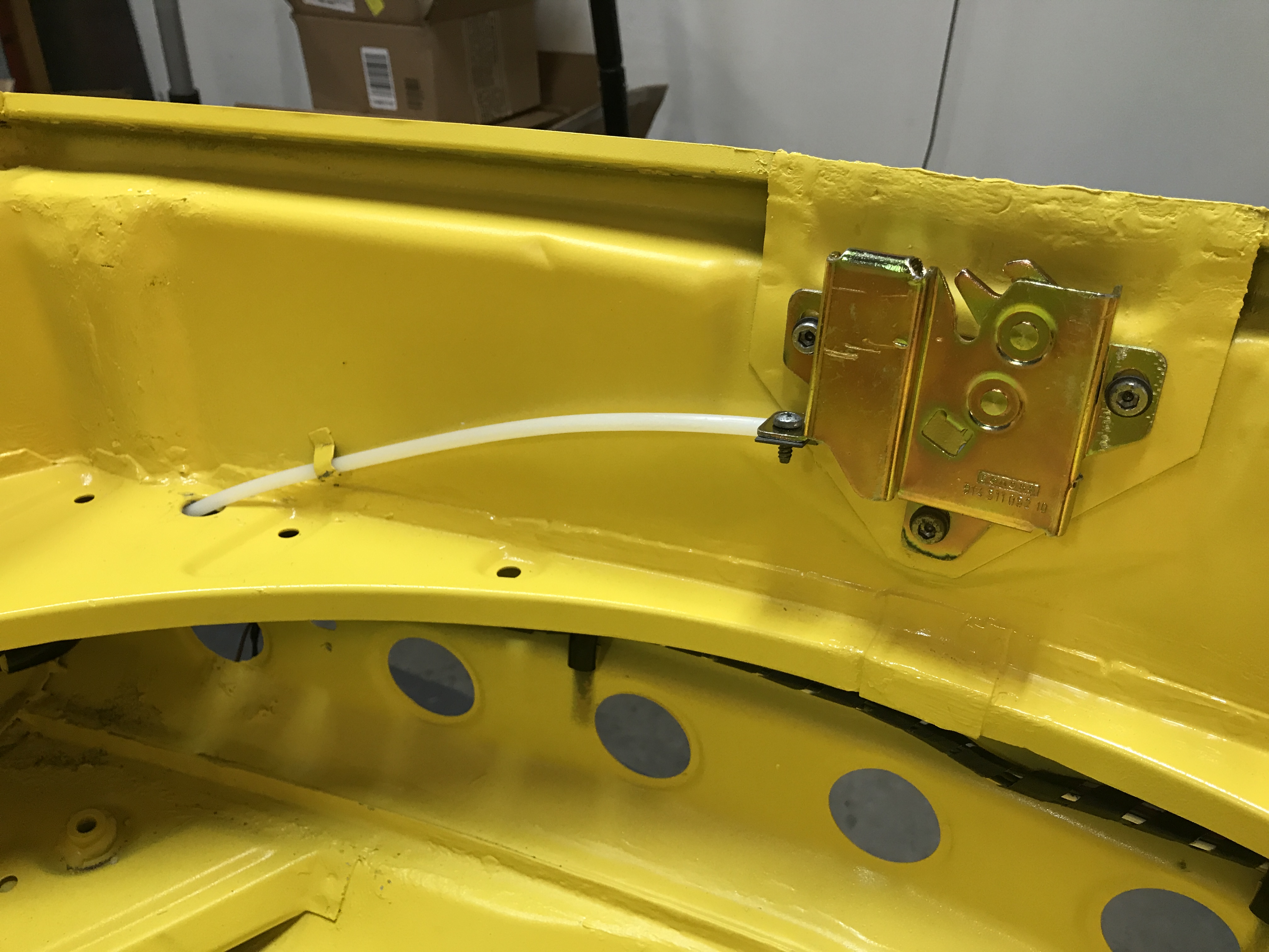

I used this hole in the horizontal brace, but decided to roll the edge to protect the housing.
bkrantz

And into the latch.

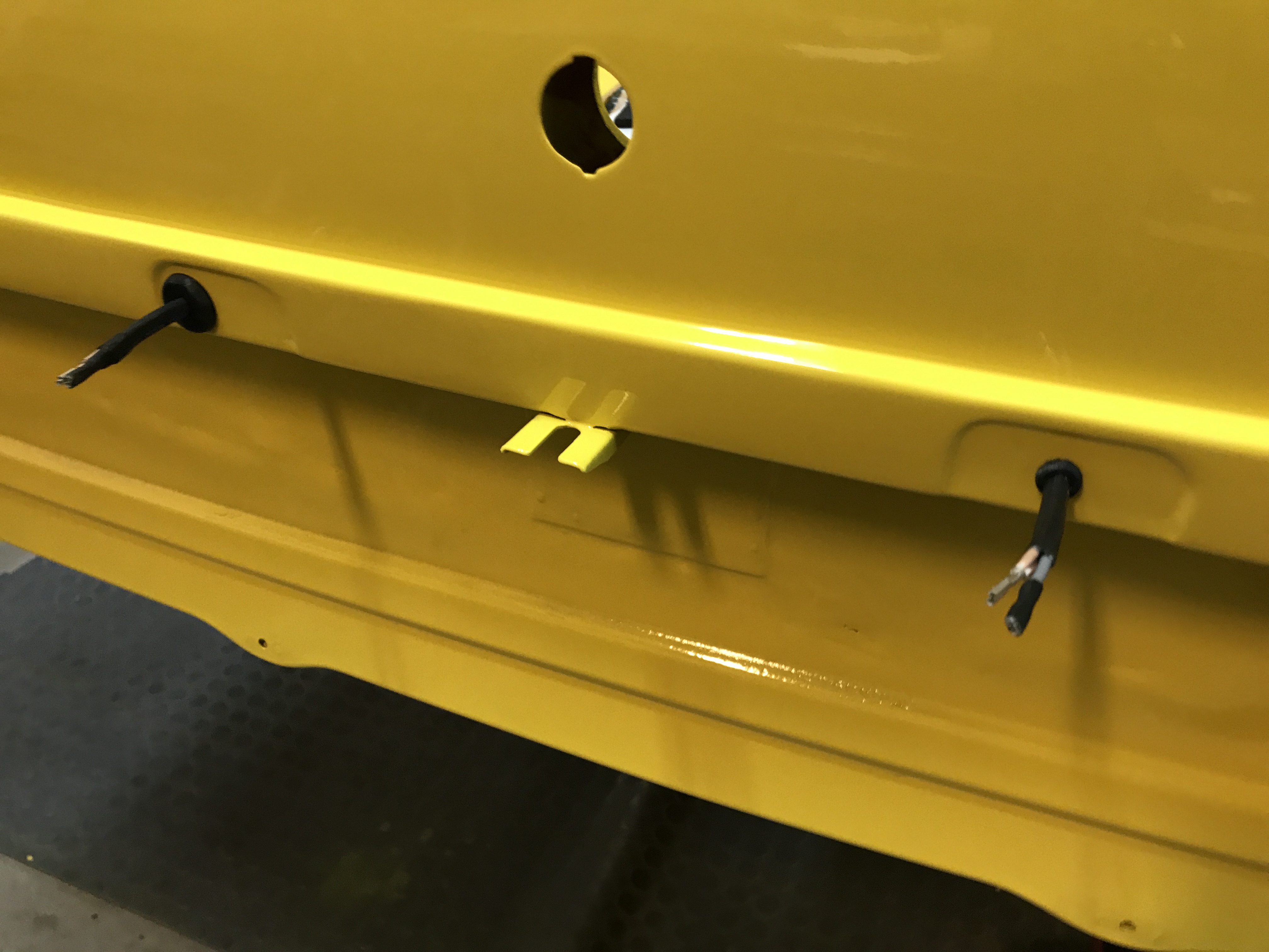

More wiring details: grommets and leads for the rear license plate lights.

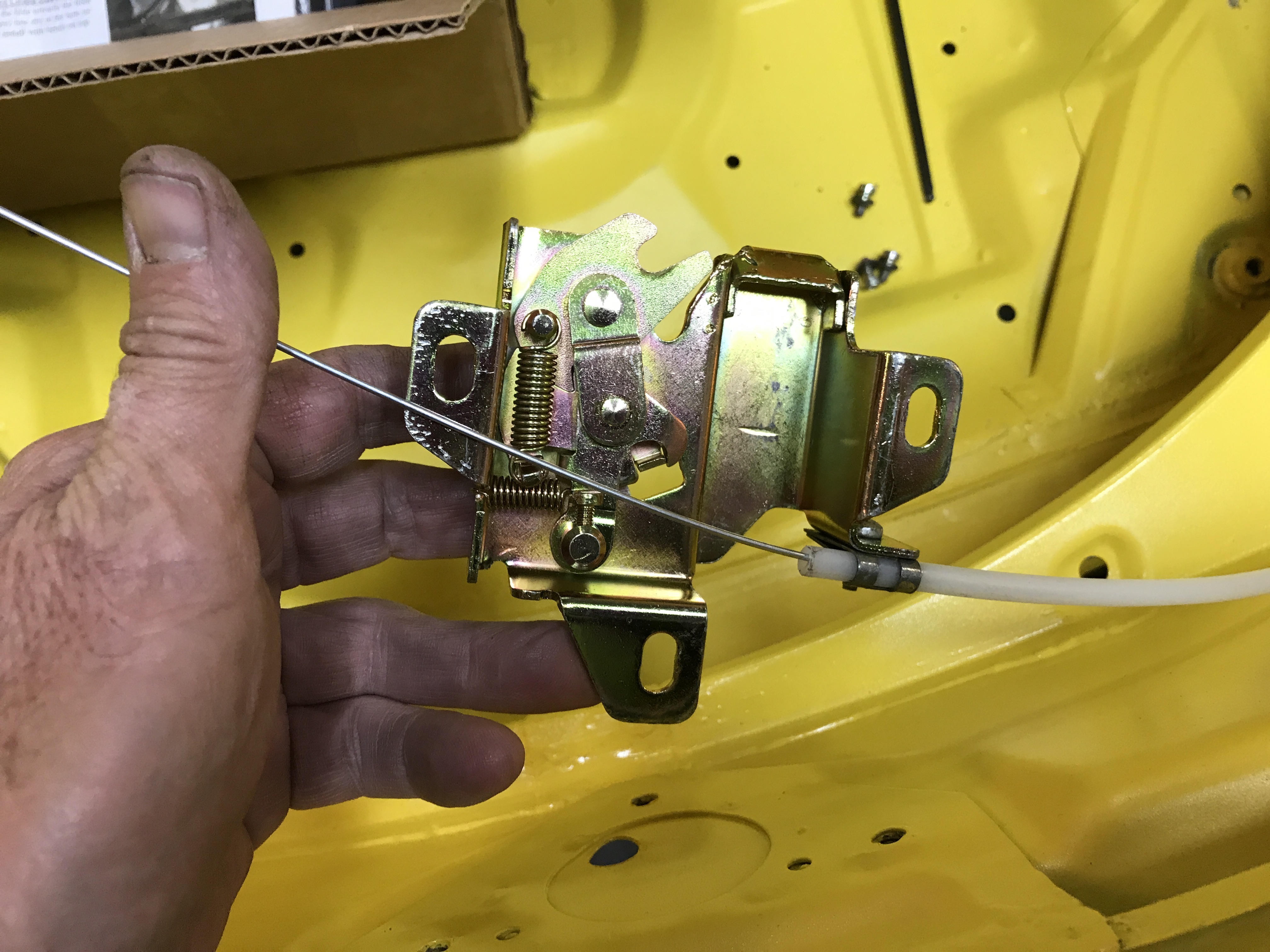

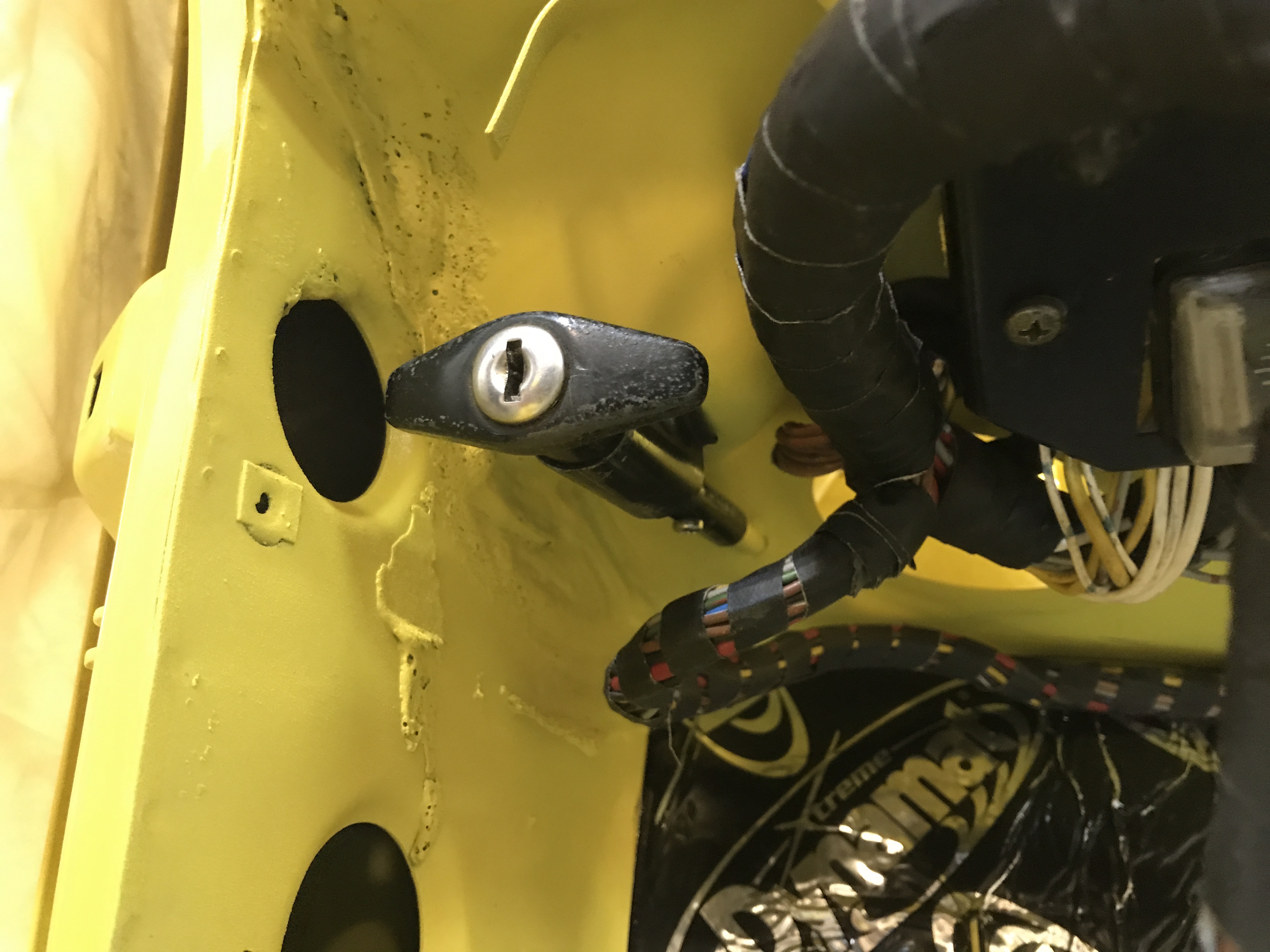

I also finished up the frunk release.

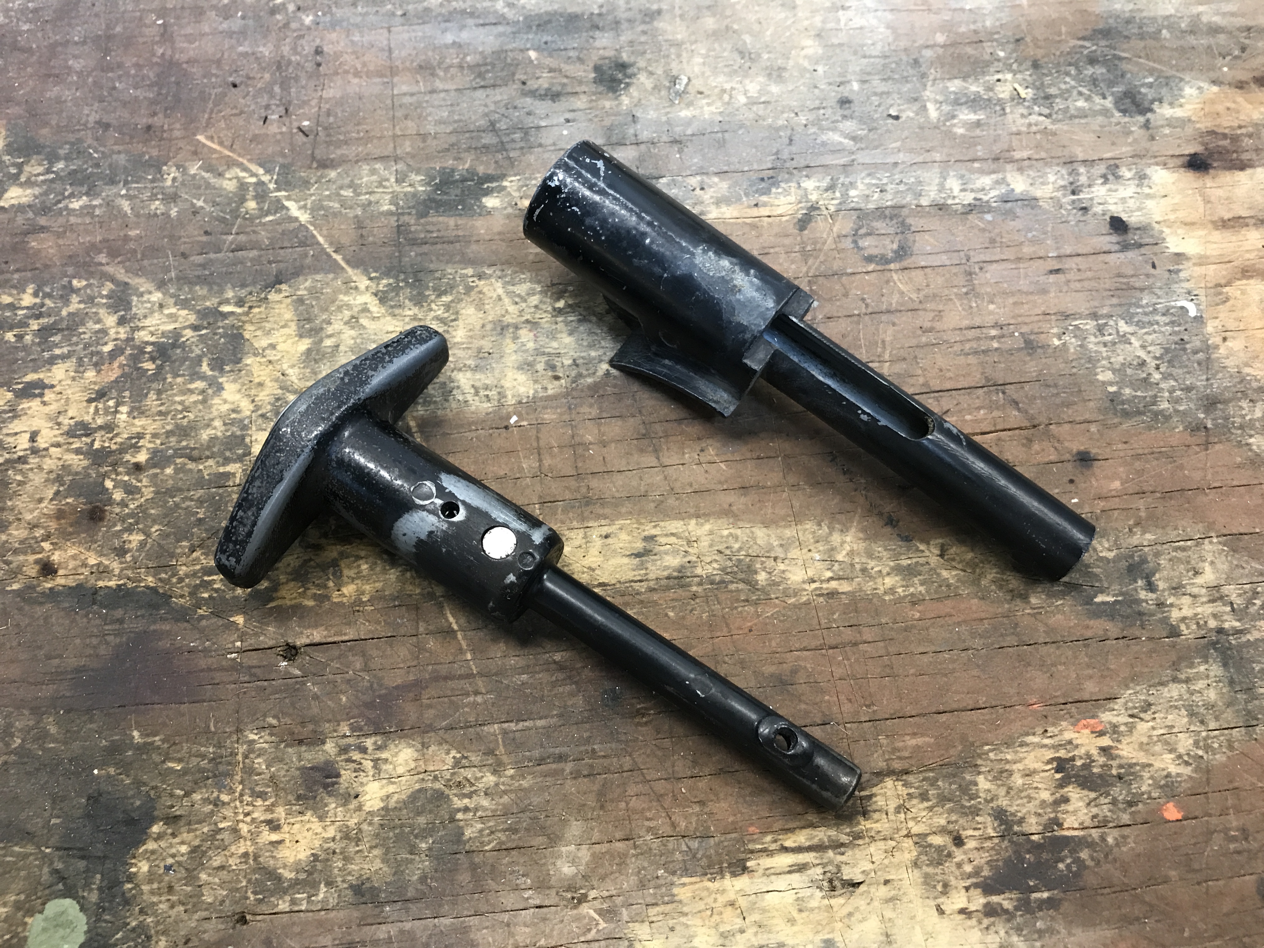

Here are the handle and receiver, cleaned up. I made a run to Home Depot for a 4mm pan head bolt.

Here's the pull wire, before trimming.
bkrantz

And the latch mounted in place.

Member No.: 23,343
With the release handle ready for action.

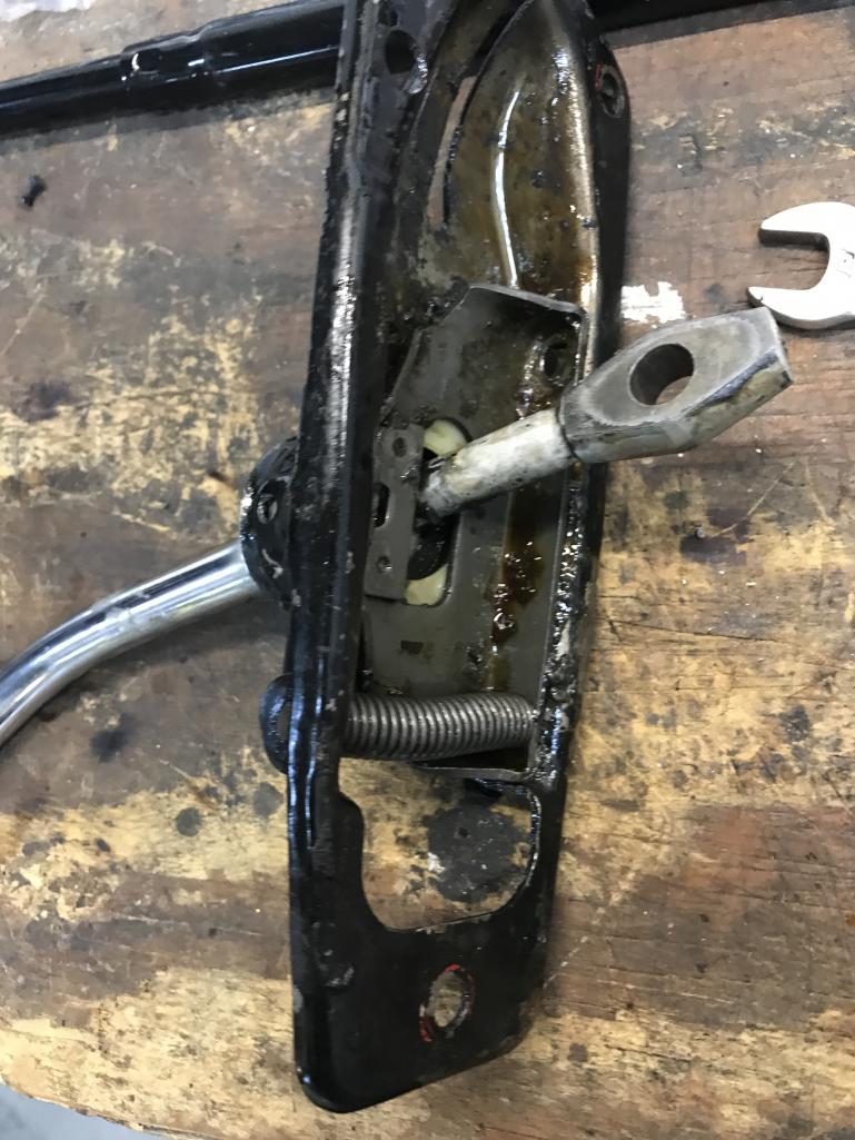

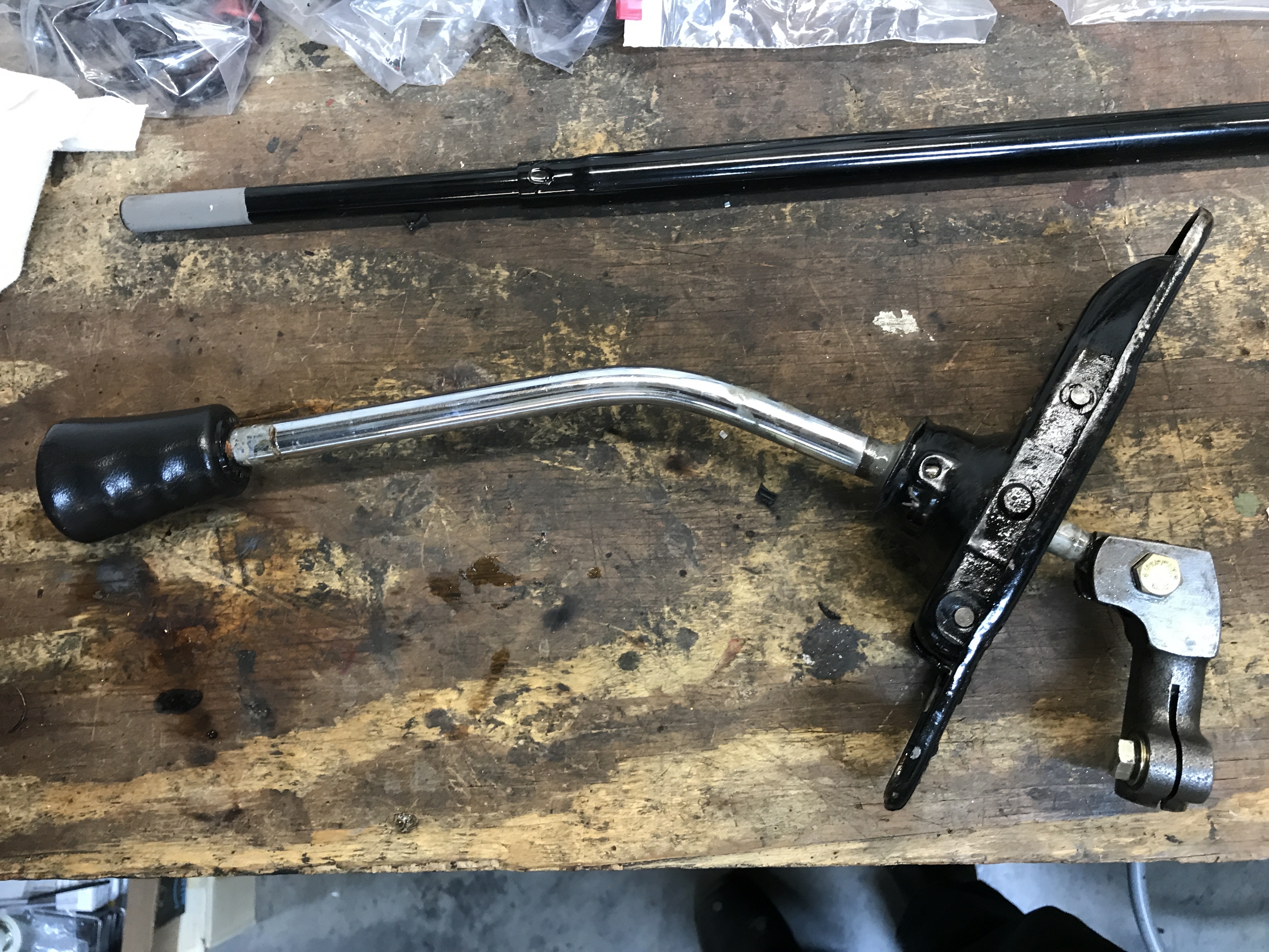

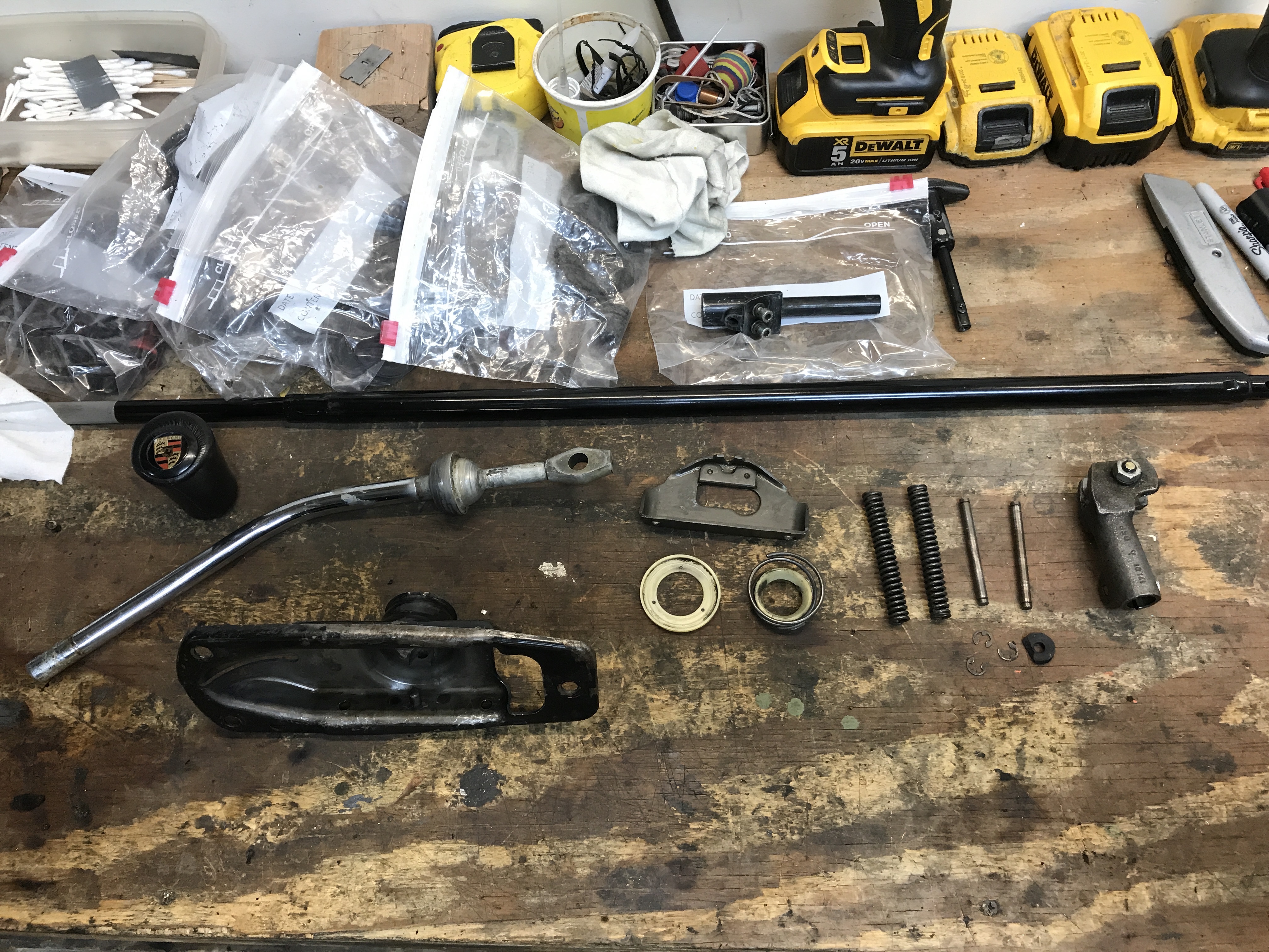

And then I started on the gear shift lever, in prep for installing this and the tunnel shift rod.

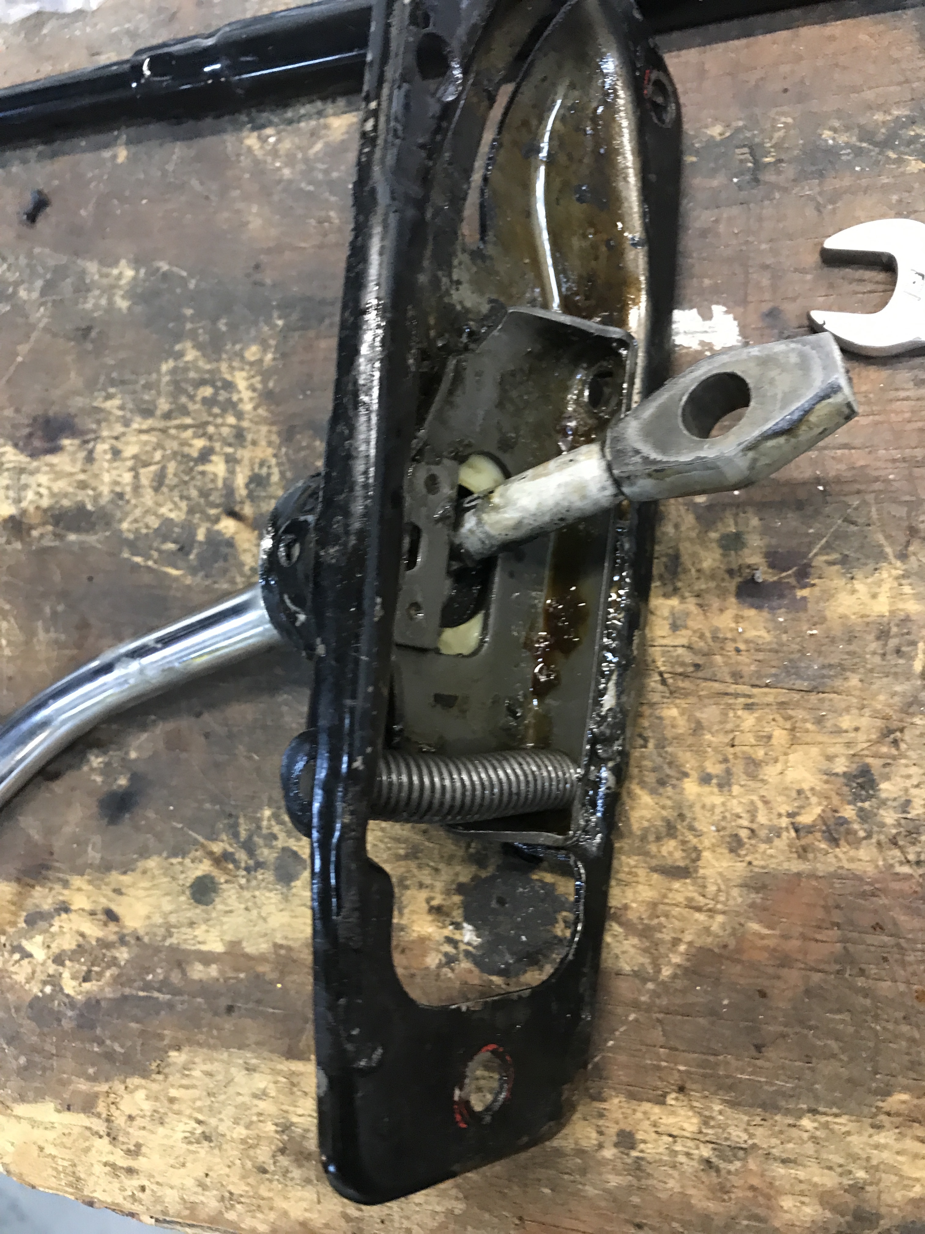

That's 50 year old vintage grease.
bkrantz
post Dec 24 2020, 09:37 PM
Post #1795
Posts: 8,763
Joined: 3-August 19
From: SW Colorado
Member No.: 23,343
After initial cleaning. I tried to use my parts washer, but it sits outside and the temp this morning was -2F, and the solvent was not so useful.

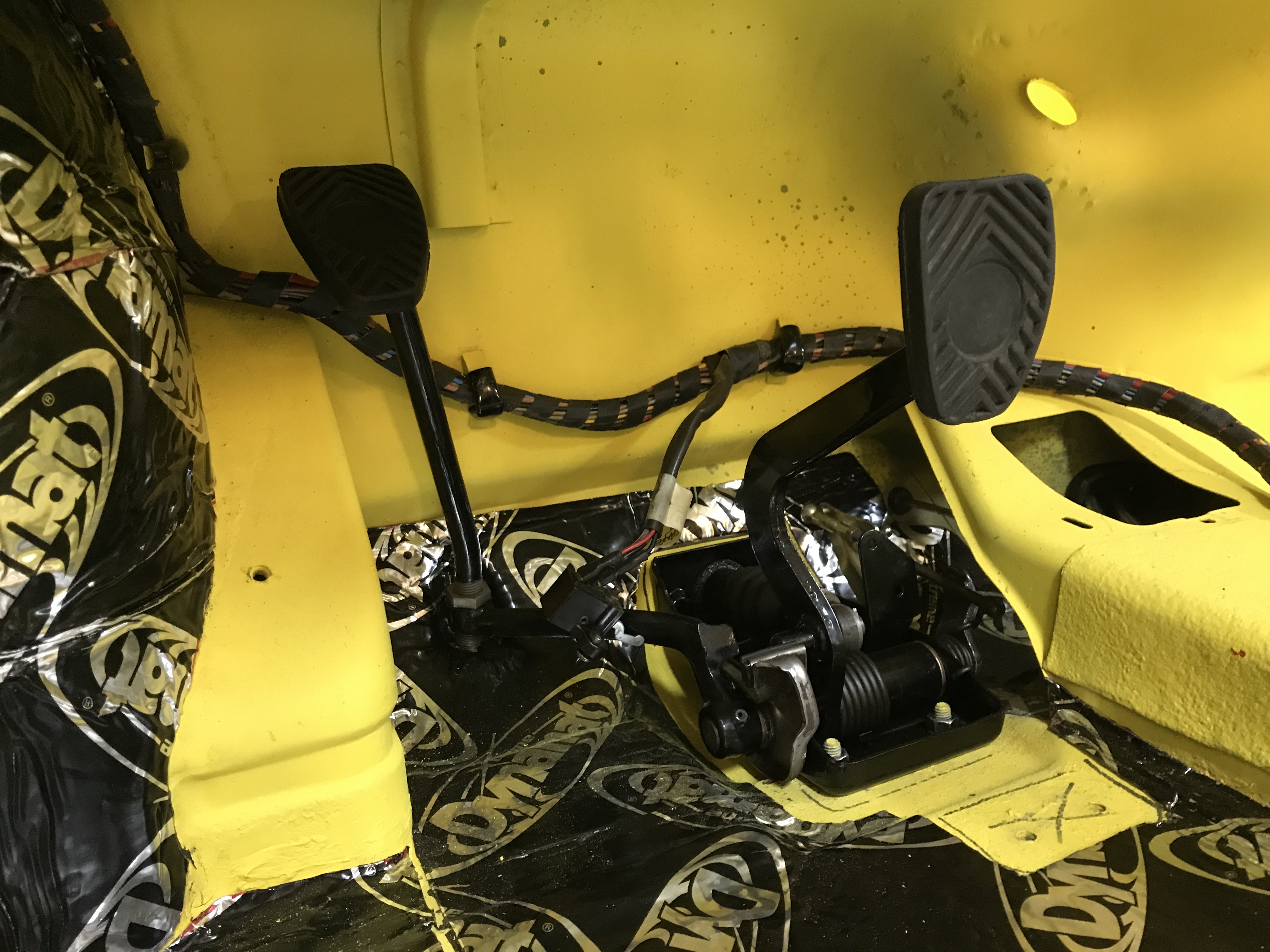

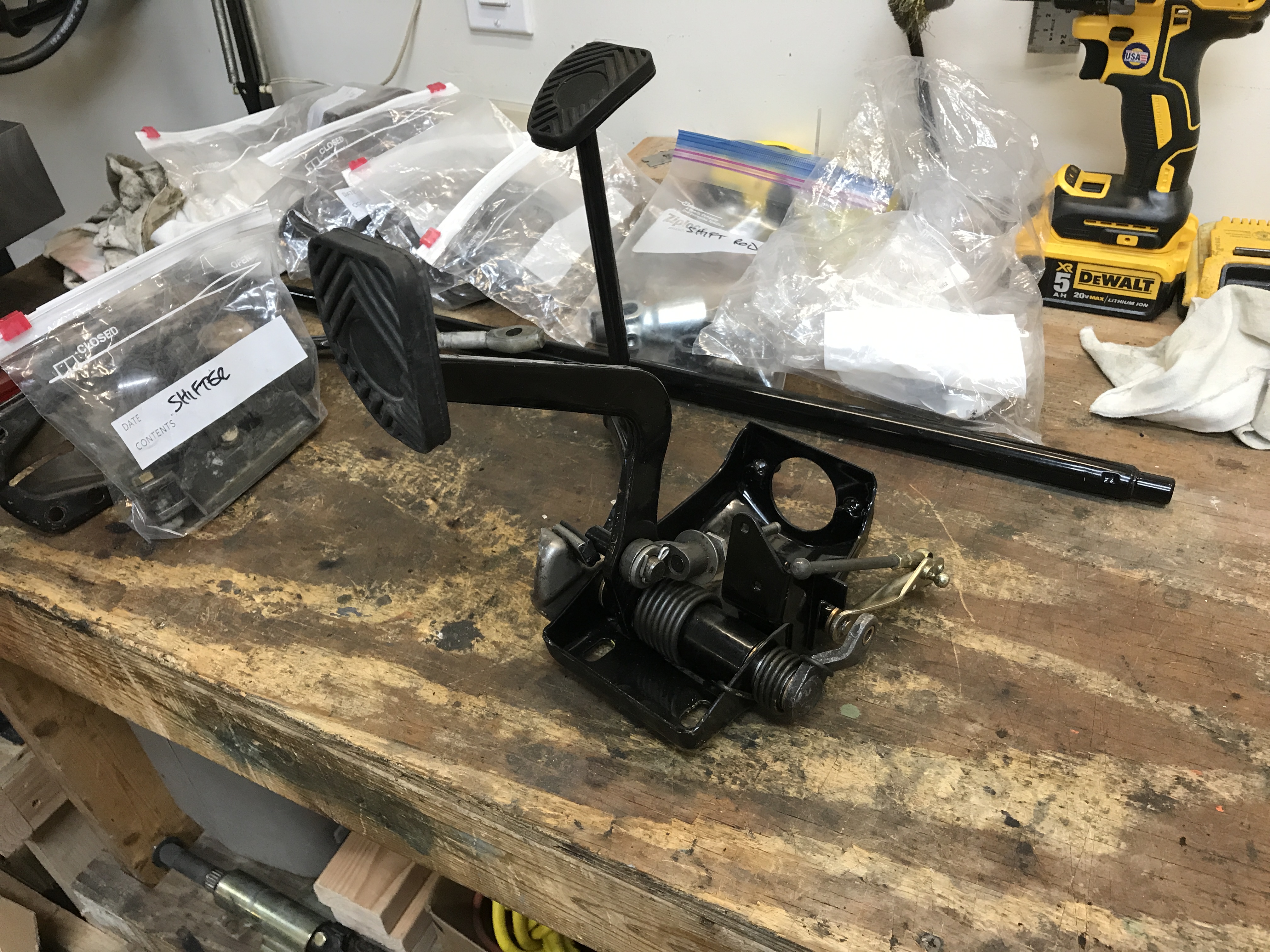

I need to order a circlip before I can rebuild the shift lever (see the clever PO substitution of a slice of rubber tubing for the lost circlip). So I decided to mount the pedals.
Here is my pedal cluster, that I previously rebuilt, with powder-coated parts.
bkrantz
post Dec 26 2020, 08:18 PM
Post #1797
Posts: 8,763
Joined: 3-August 19
From: SW Colorado
Member No.: 23,343
Pedals in place, with shiny new hardware.

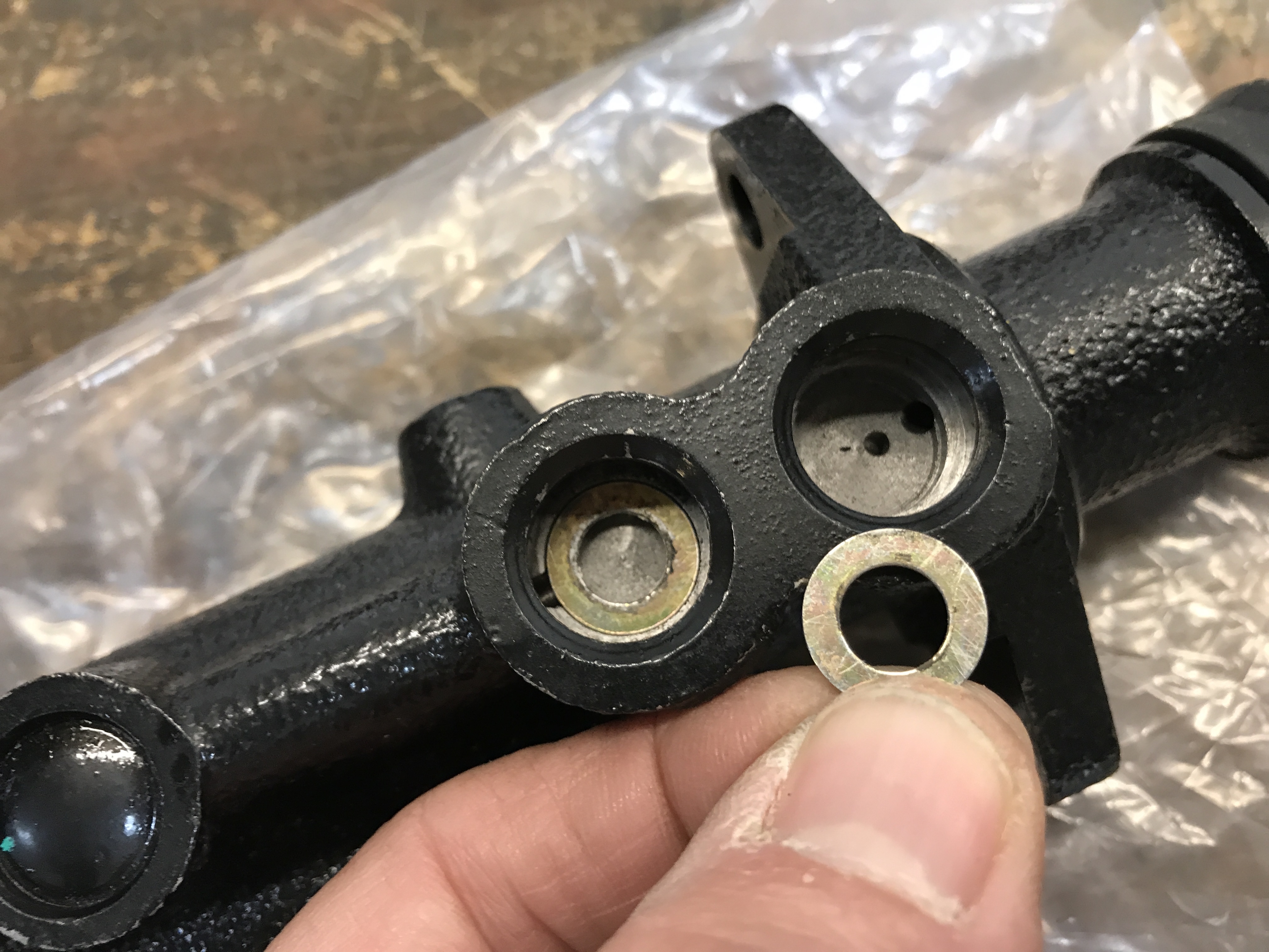

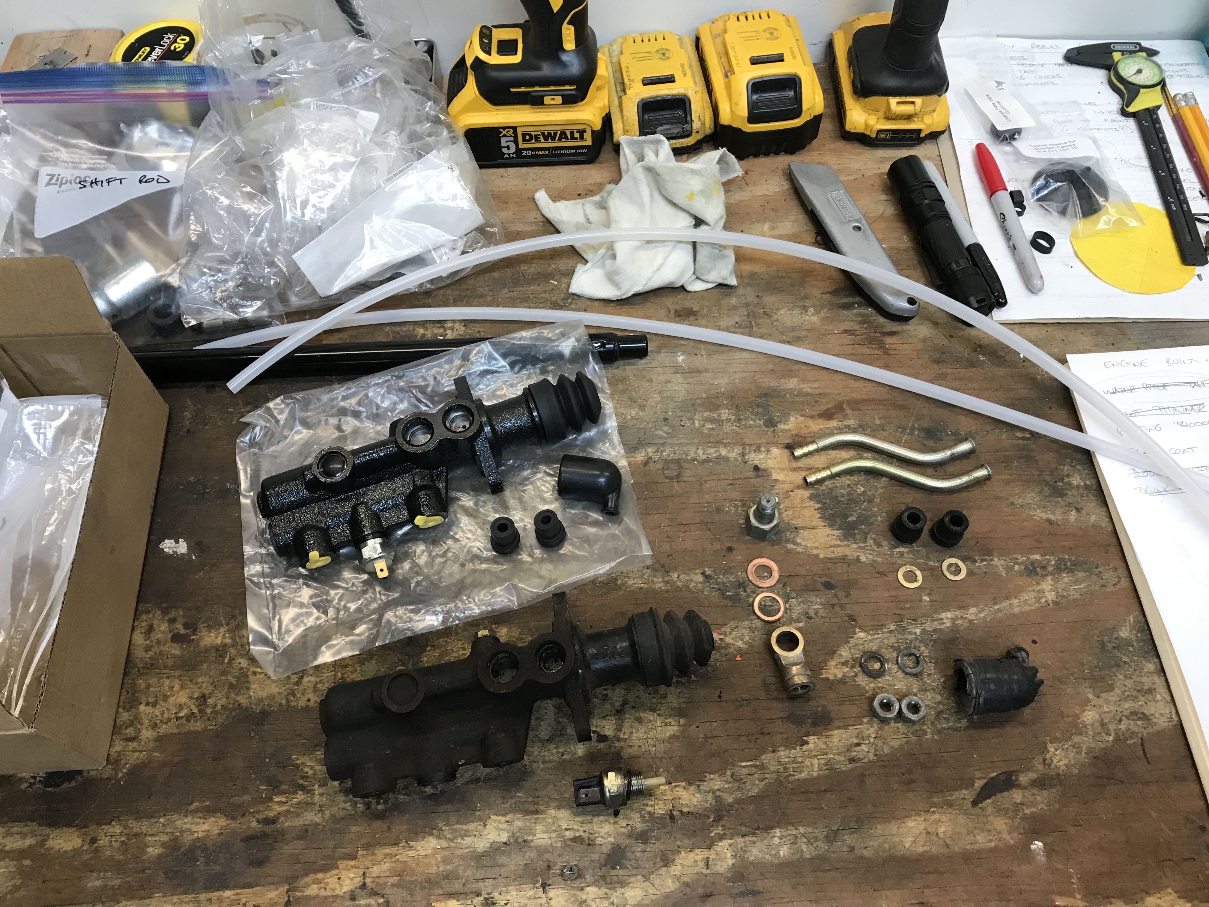

I then tackled preparing the new master cylinder. Here's the new 19mm MC from 914 Rubber, along with all the old parts.
bkrantz
post Dec 26 2020, 08:22 PM
Post #1799
Posts: 8,763
Joined: 3-August 19
From: SW Colorado
Member No.: 23,343
Step 1, transfer the inner washers for the supply lines.
bkrantz
post Dec 26 2020, 08:23 PM
Post #1800
Posts: 8,763
Joined: 3-August 19
From: SW Colorado
Member No.: 23,343

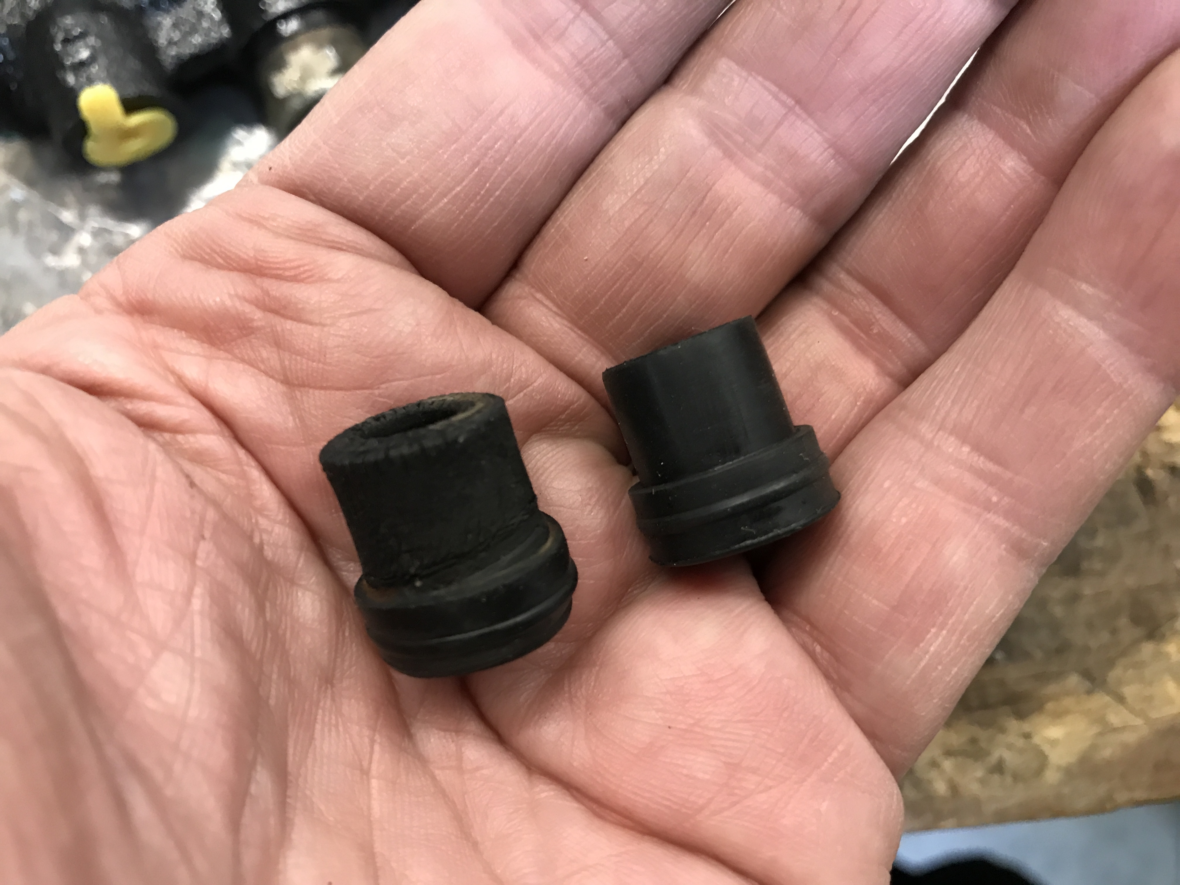

And then re-install the new rubber grommets (old on the left, new on the right).
