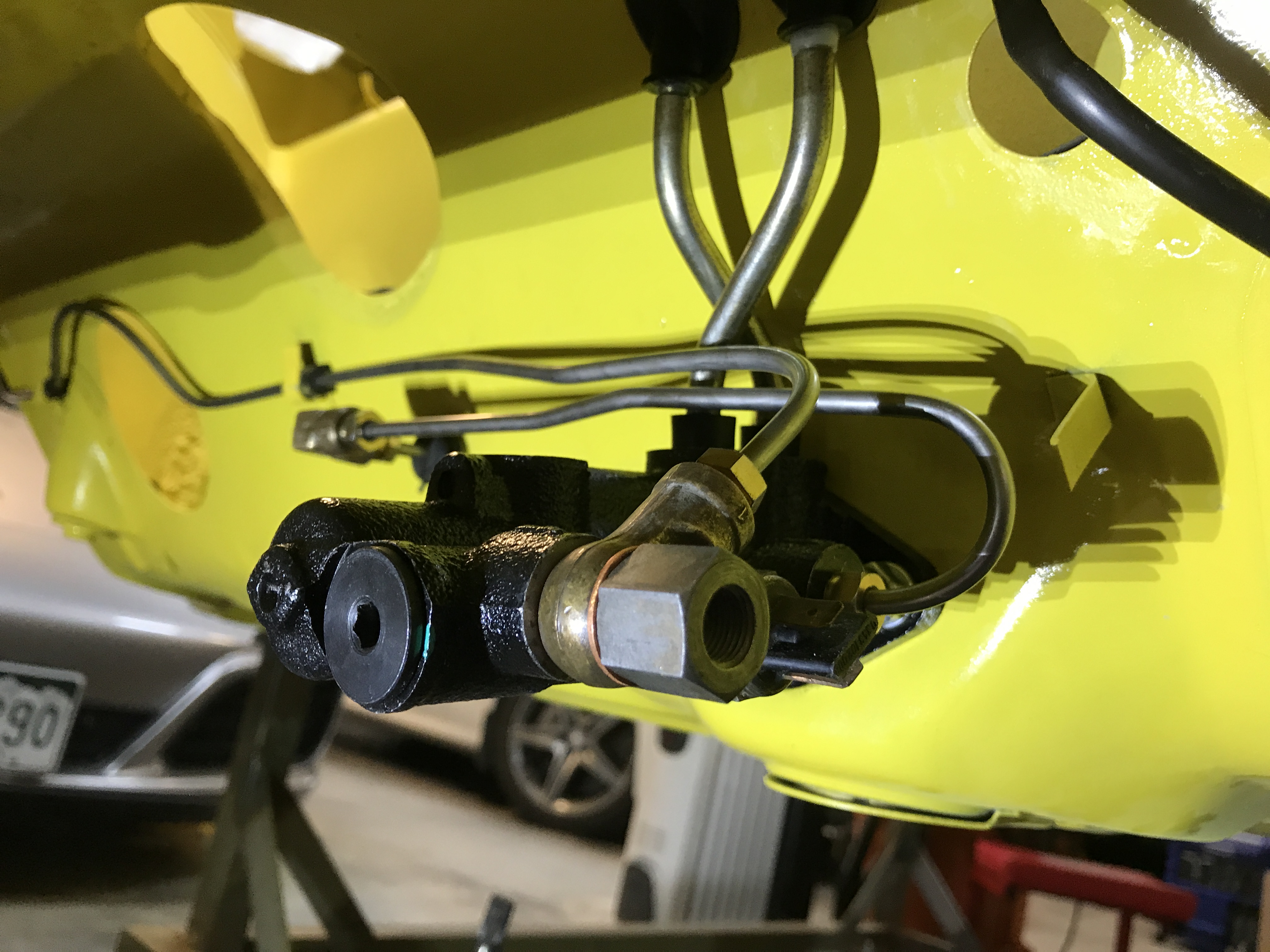

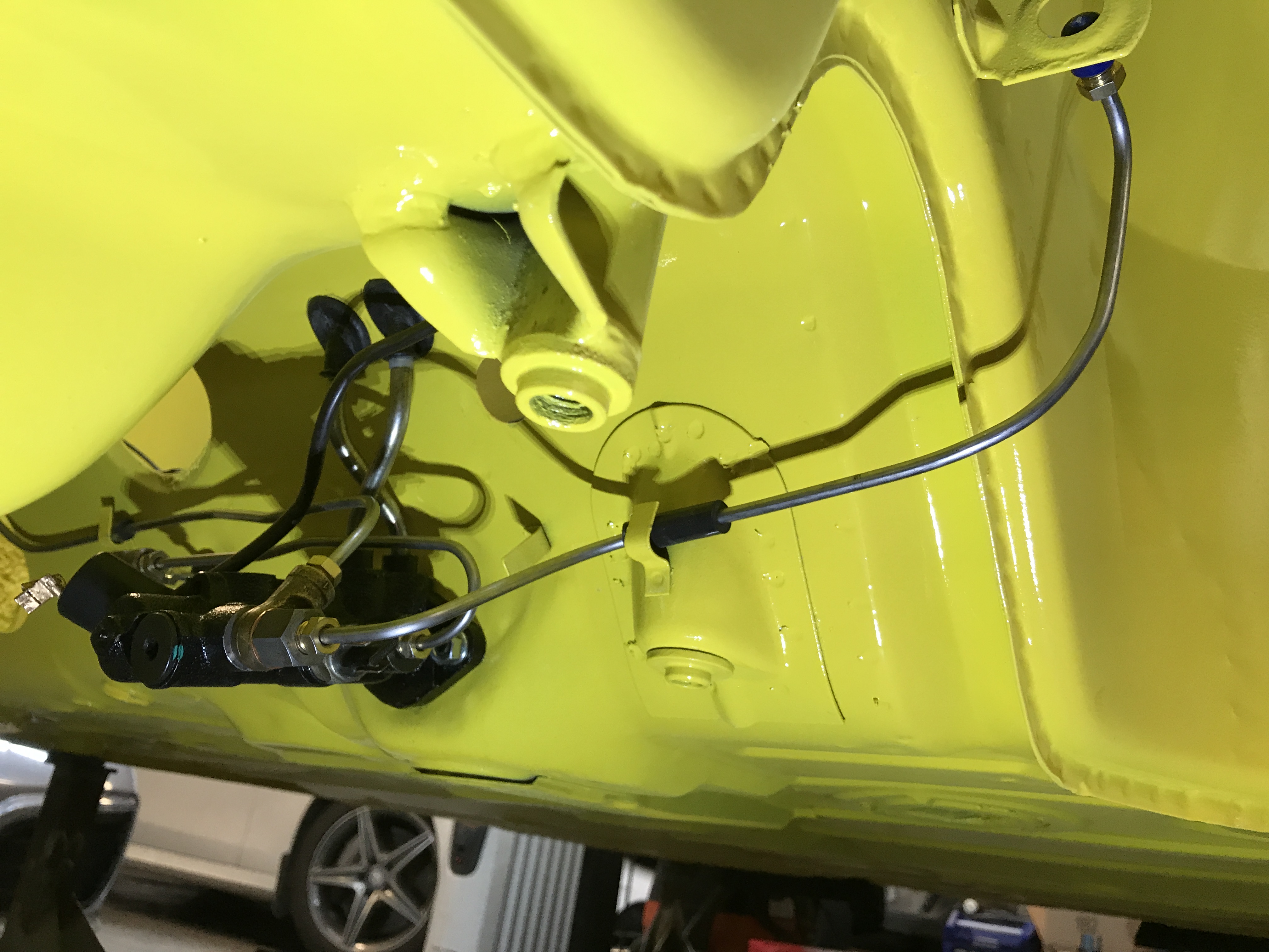

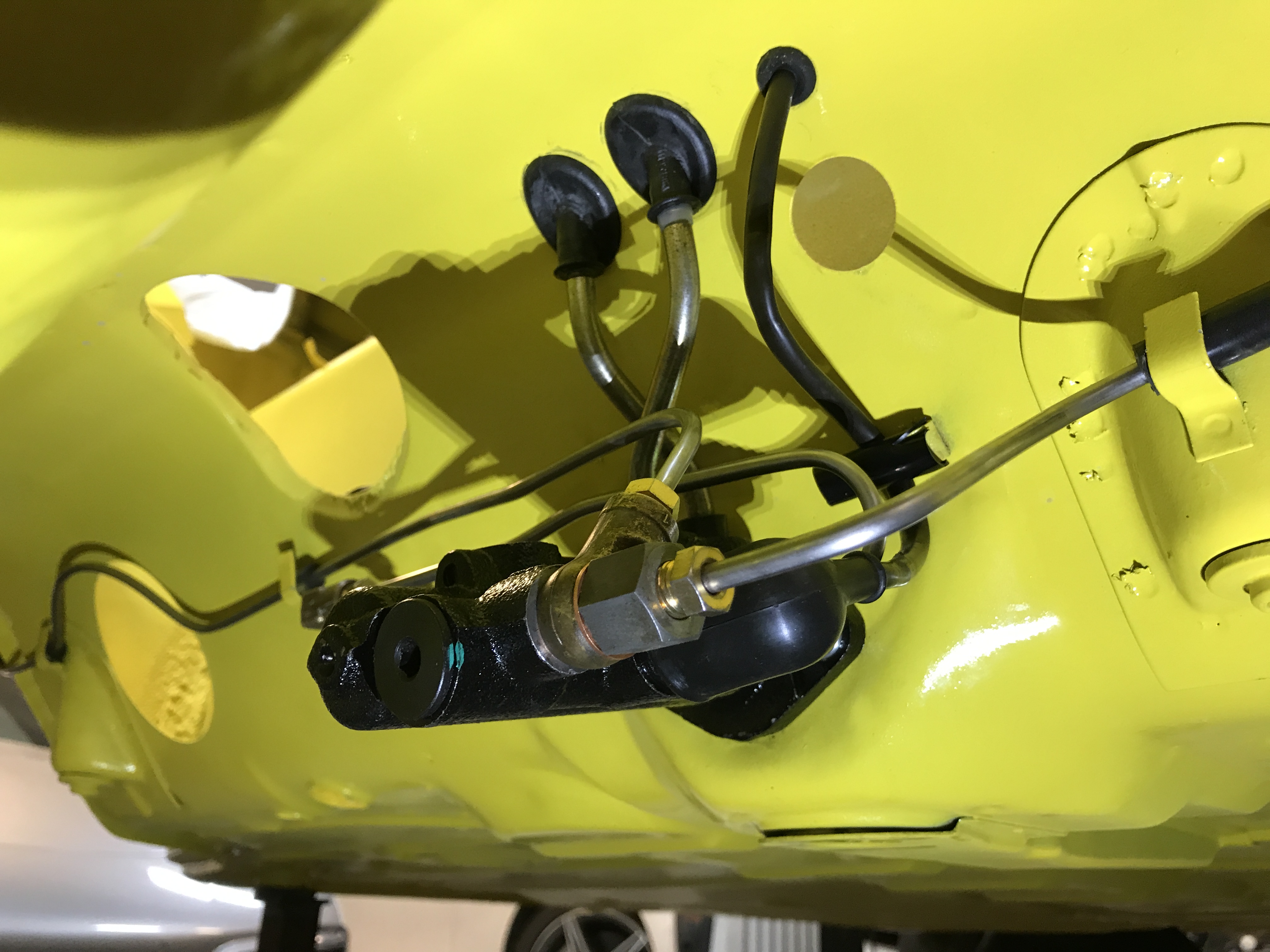

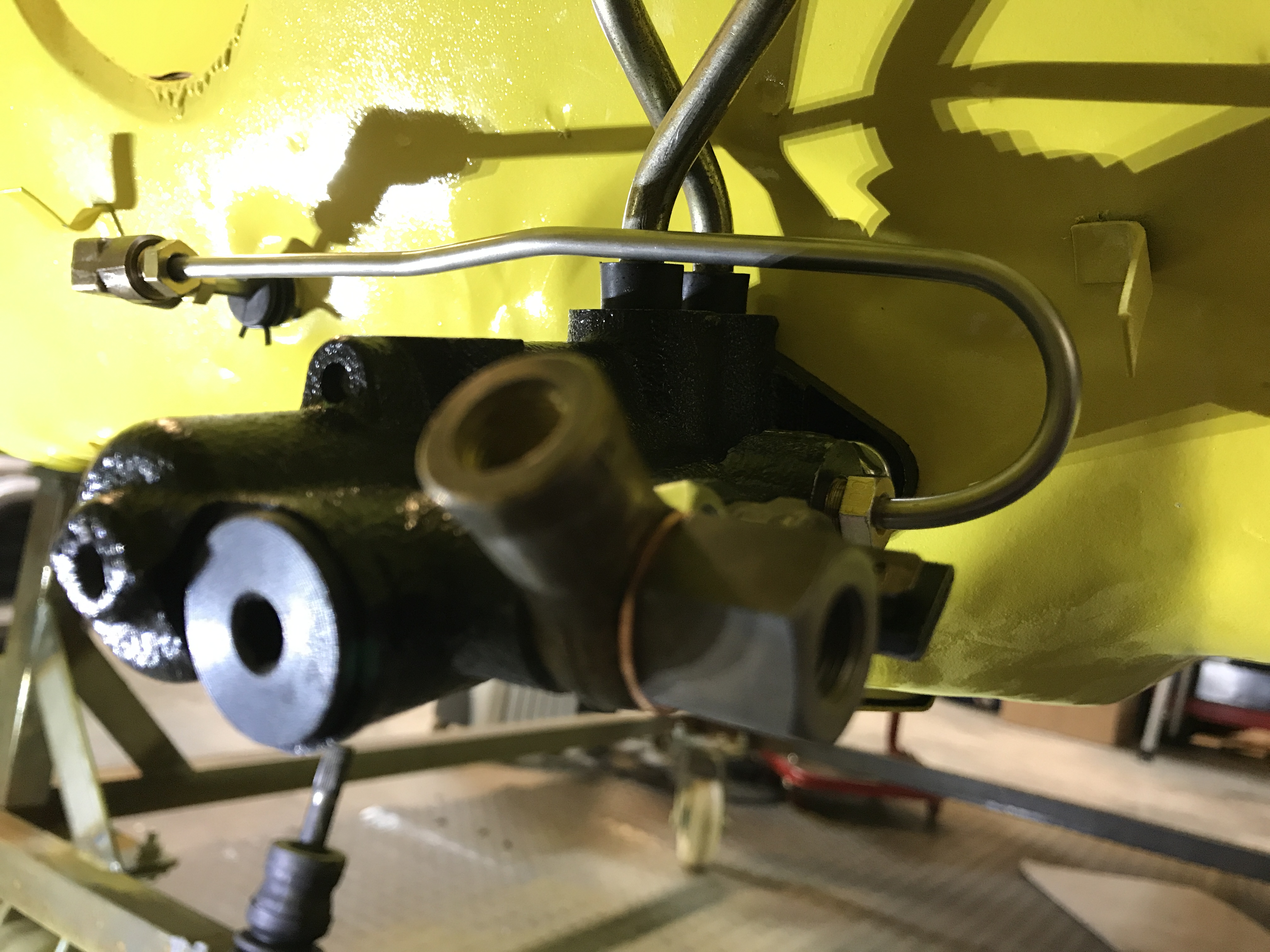

With the MC installed, I adjusted and installed the rear output line.
bkrantz
post Jan 2 2021, 09:36 AM
Post #1862
Posts: 8,763
Joined: 3-August 19
From: SW Colorado
Member No.: 23,343
Then the front line to the right side.
bkrantz
post Jan 2 2021, 09:37 AM
Post #1863
Posts: 8,763
Joined: 3-August 19
From: SW Colorado
Member No.: 23,343
And the front line to the left. As expected, all the lines required a bit of adjustment, i.e. bending.
bkrantz
post Jan 2 2021, 09:39 AM
Post #1864
Posts: 8,763
Joined: 3-August 19
From: SW Colorado
Member No.: 23,343

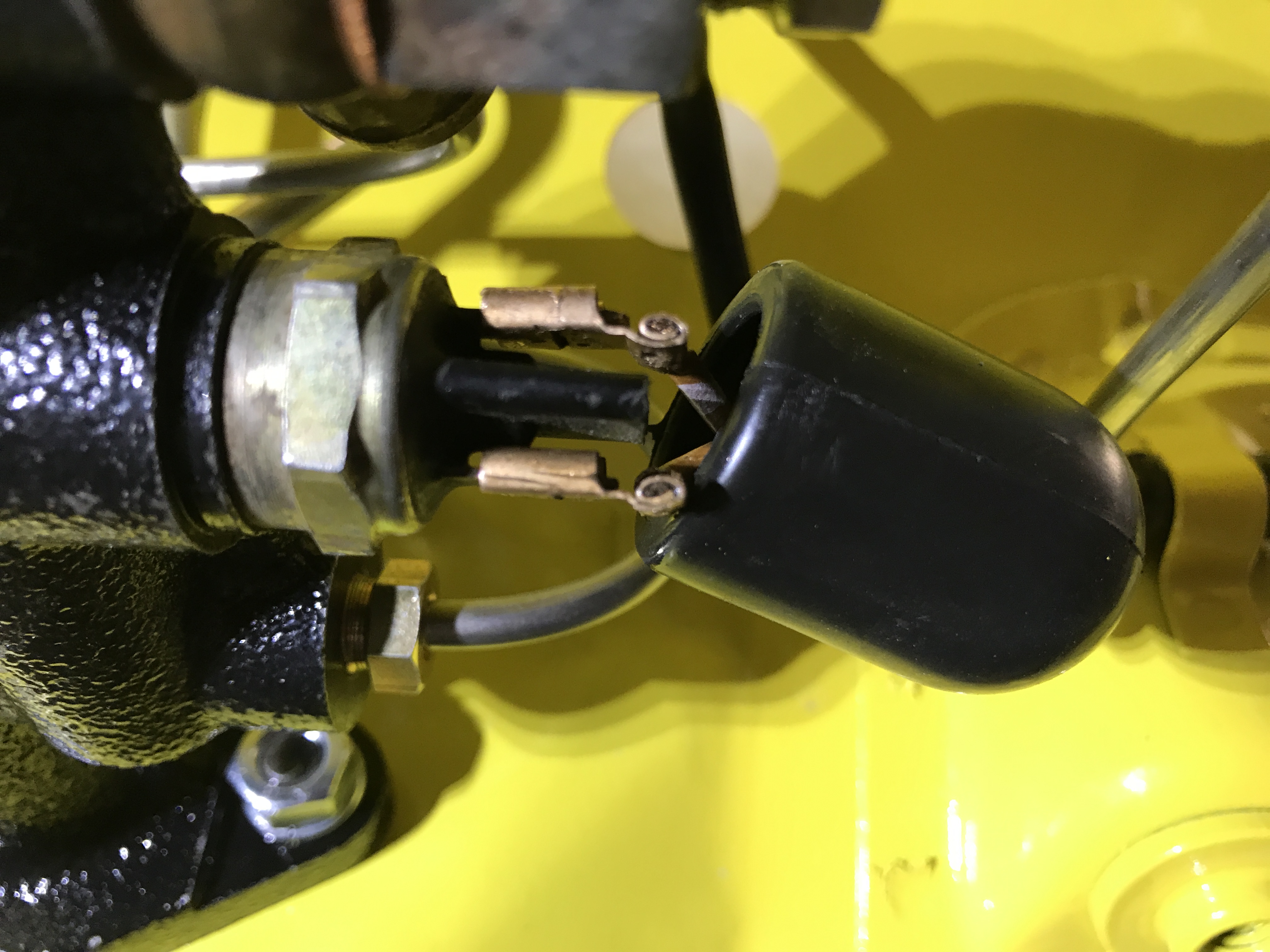

Finally, the warning switch connectors and new boot.
bkrantz
post Jan 2 2021, 09:40 AM
Post #1865
Posts: 8,763
Joined: 3-August 19
From: SW Colorado
Member No.: 23,343
Done (I hope).

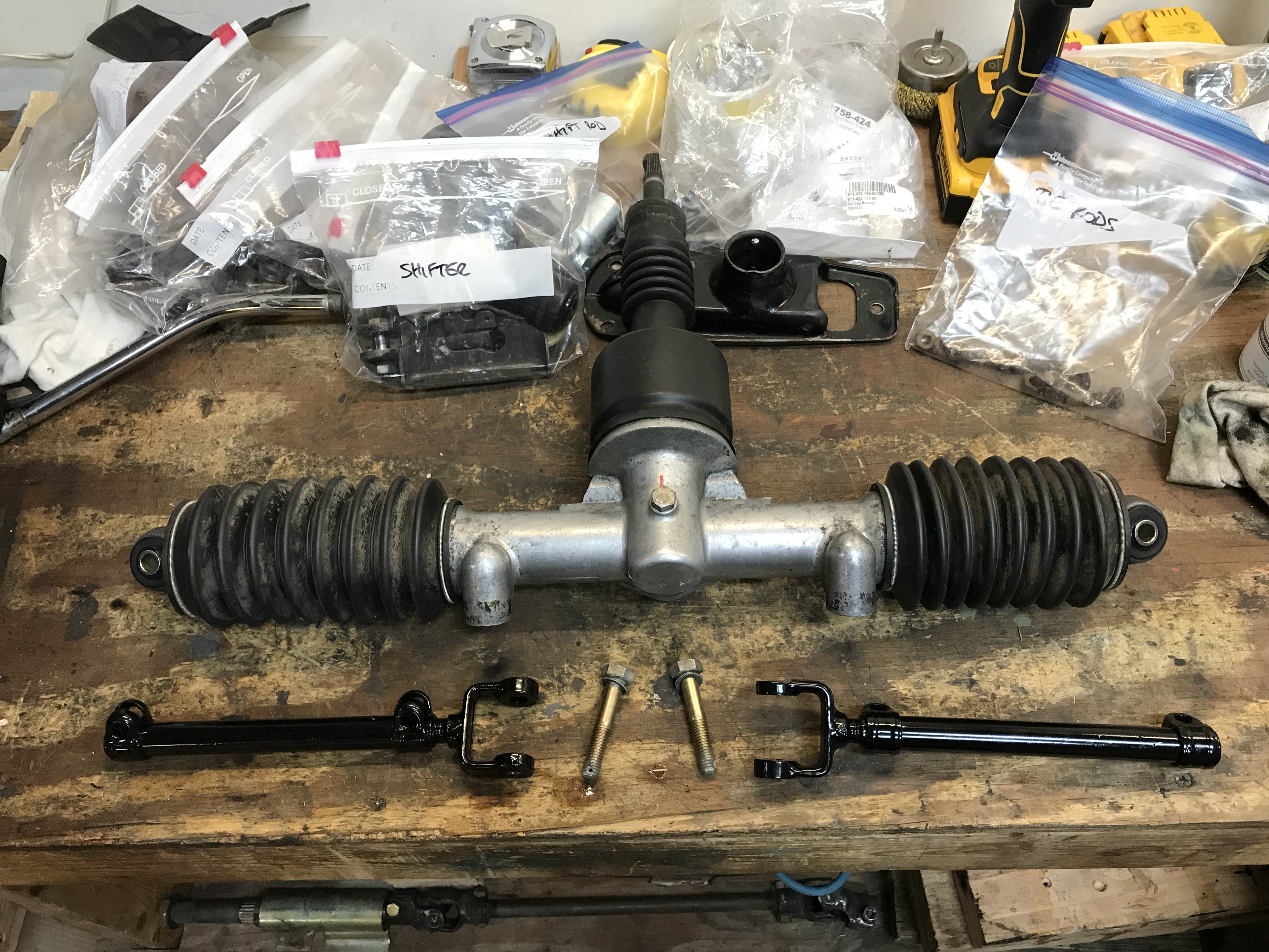

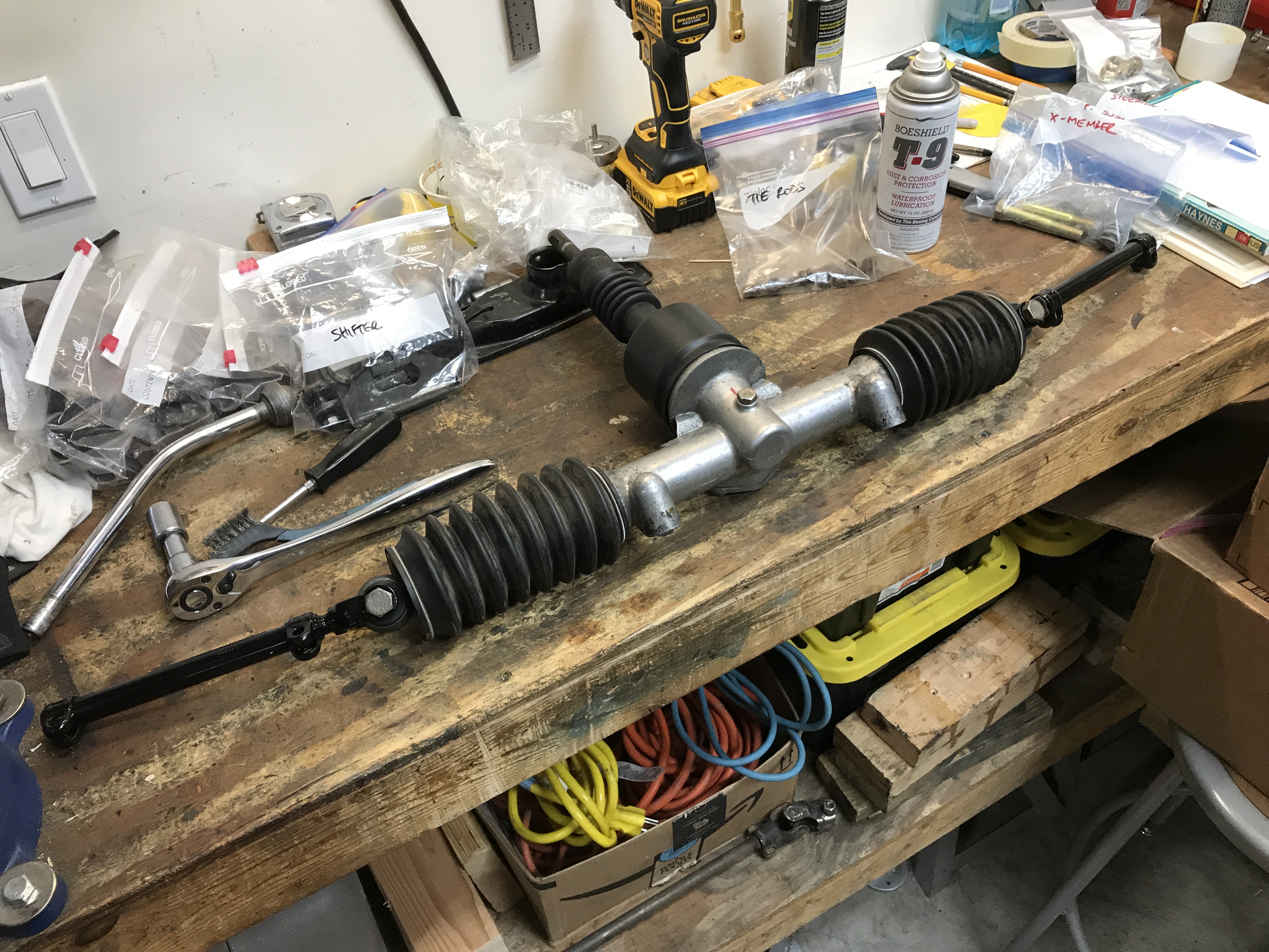

While under the front, I decided to start some suspension installation, starting with the steering rack and tie rods. I had rebuilt the rack a few months ago, and had the rods (and most of the suspension parts) powder-coated.
bkrantz
post Jan 2 2021, 09:44 AM
Post #1867
Posts: 8,763
Joined: 3-August 19
From: SW Colorado
Member No.: 23,343
I know my sequence is not normal, but it worked out. And I did some test fitting first.
Anyway, I installed the tie rods.

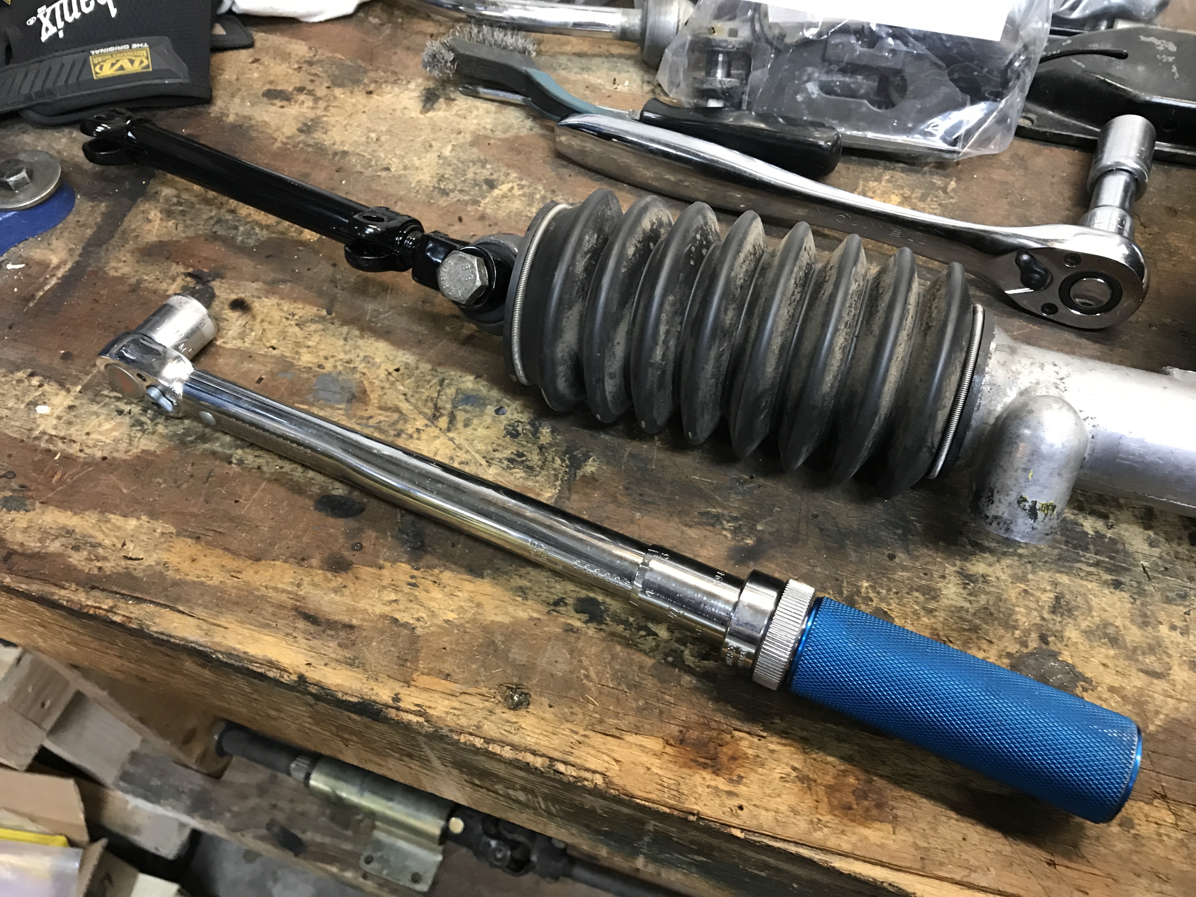

And another rebuild personal milestone: first fastener torque wrenching!

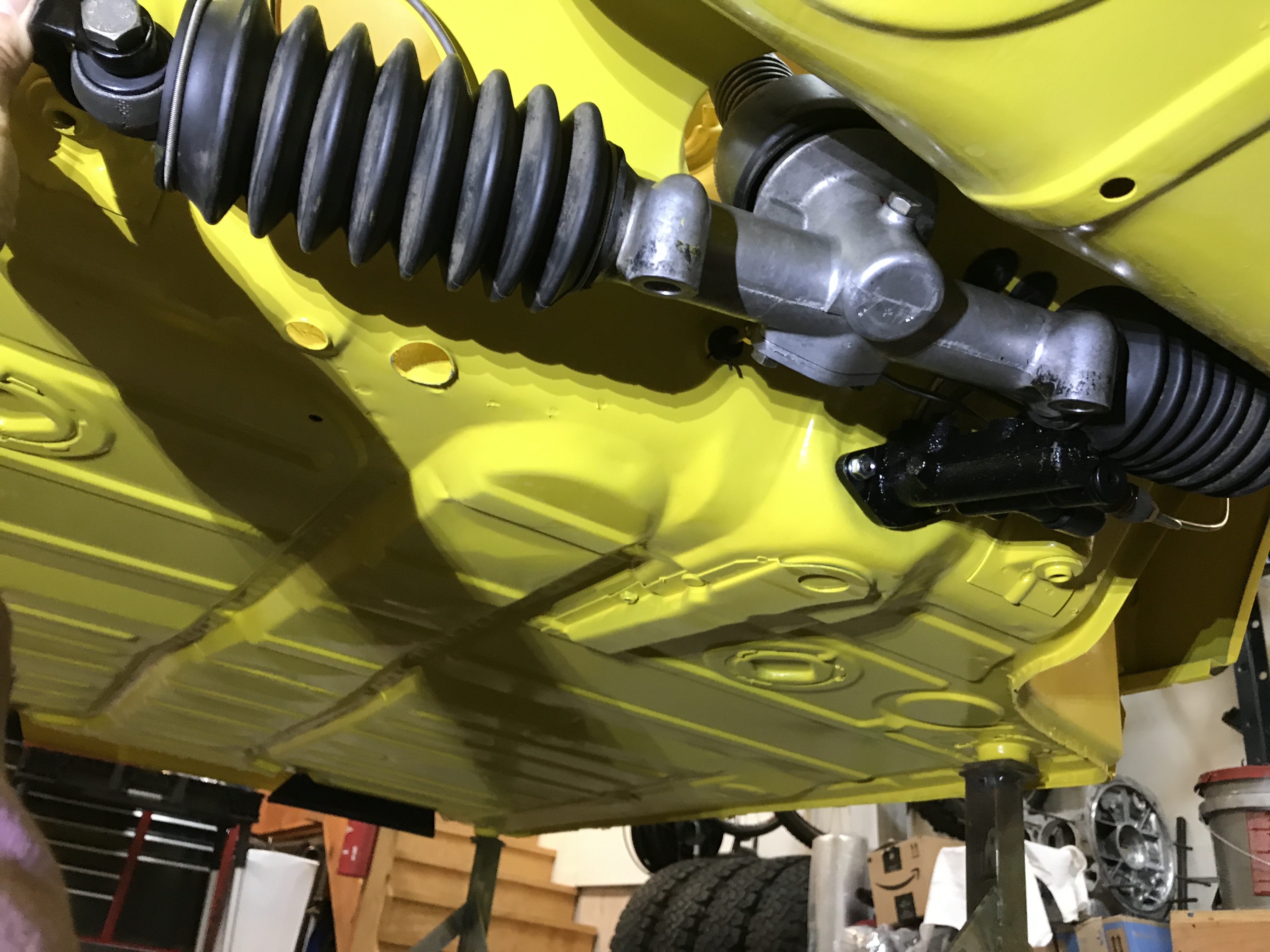

I then snuck the rack up into place, with reasonable clearance past the MC.
(Spoiler alert: I forgot a part that I will reveal later. Can you guess?)

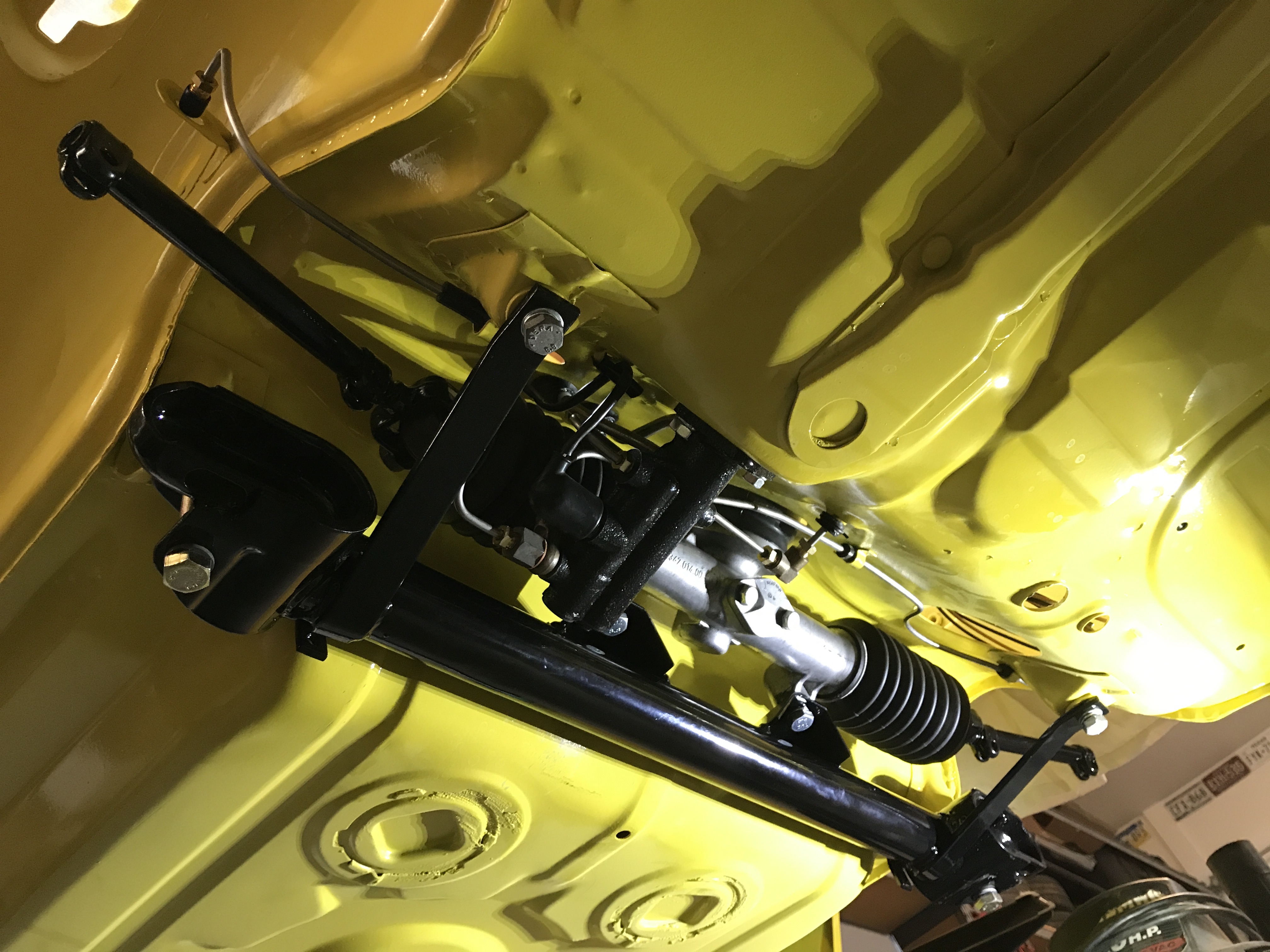

I then installed the front suspension carrier cross bar.

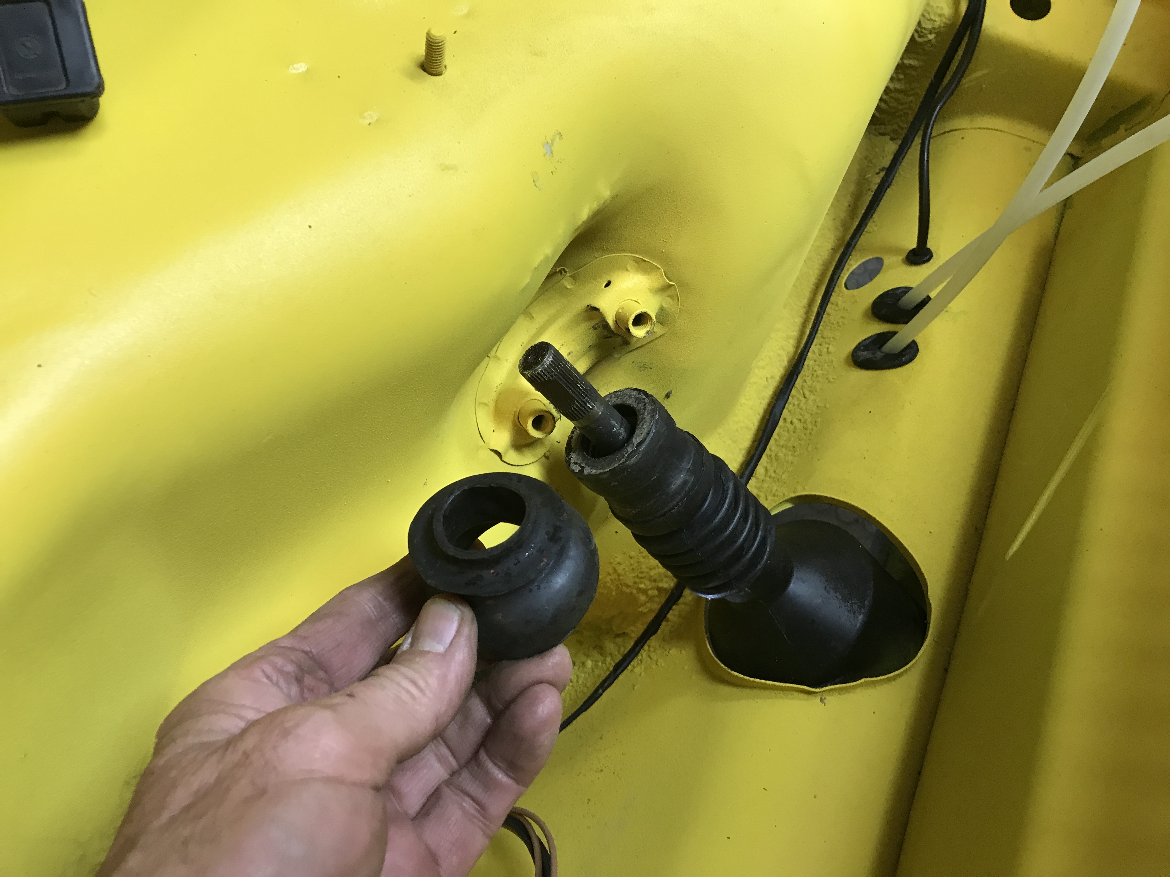

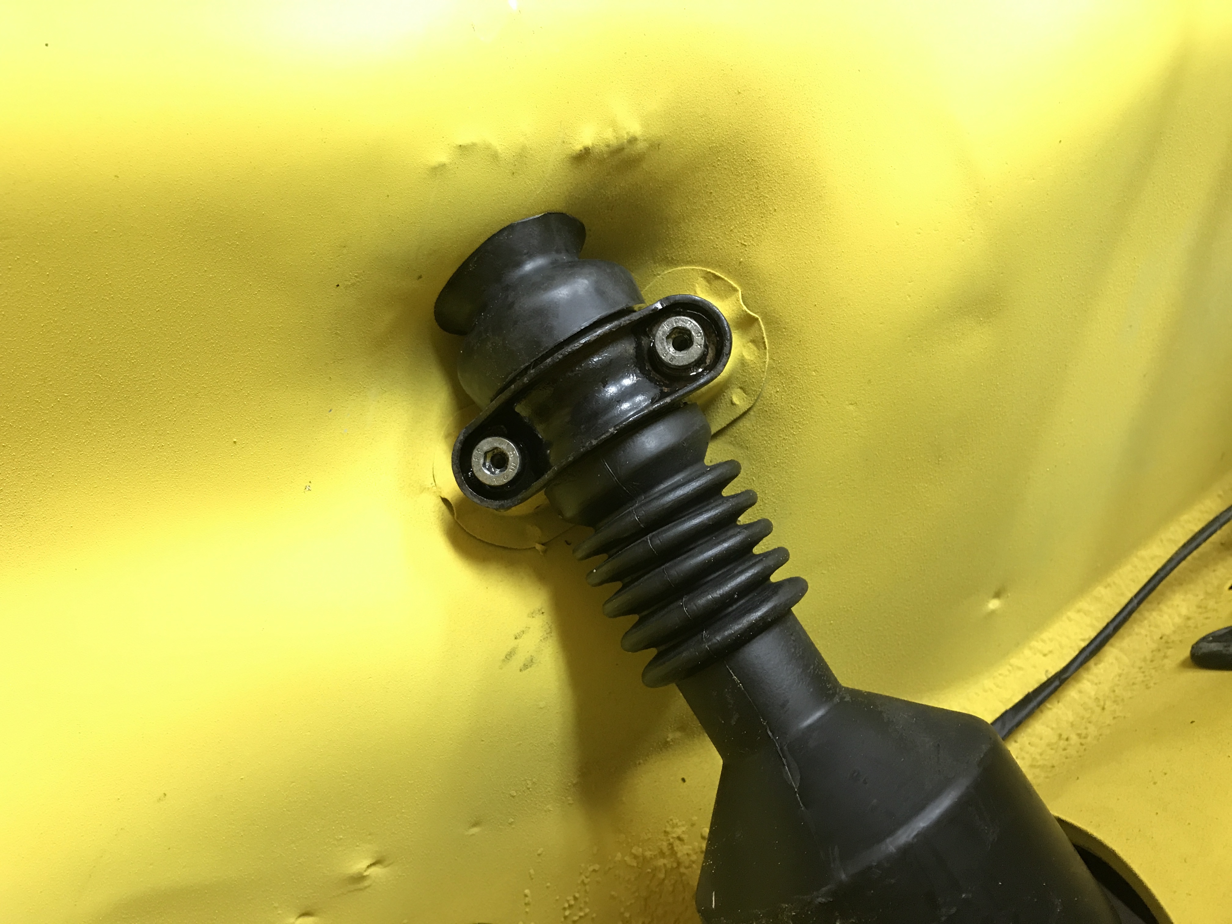

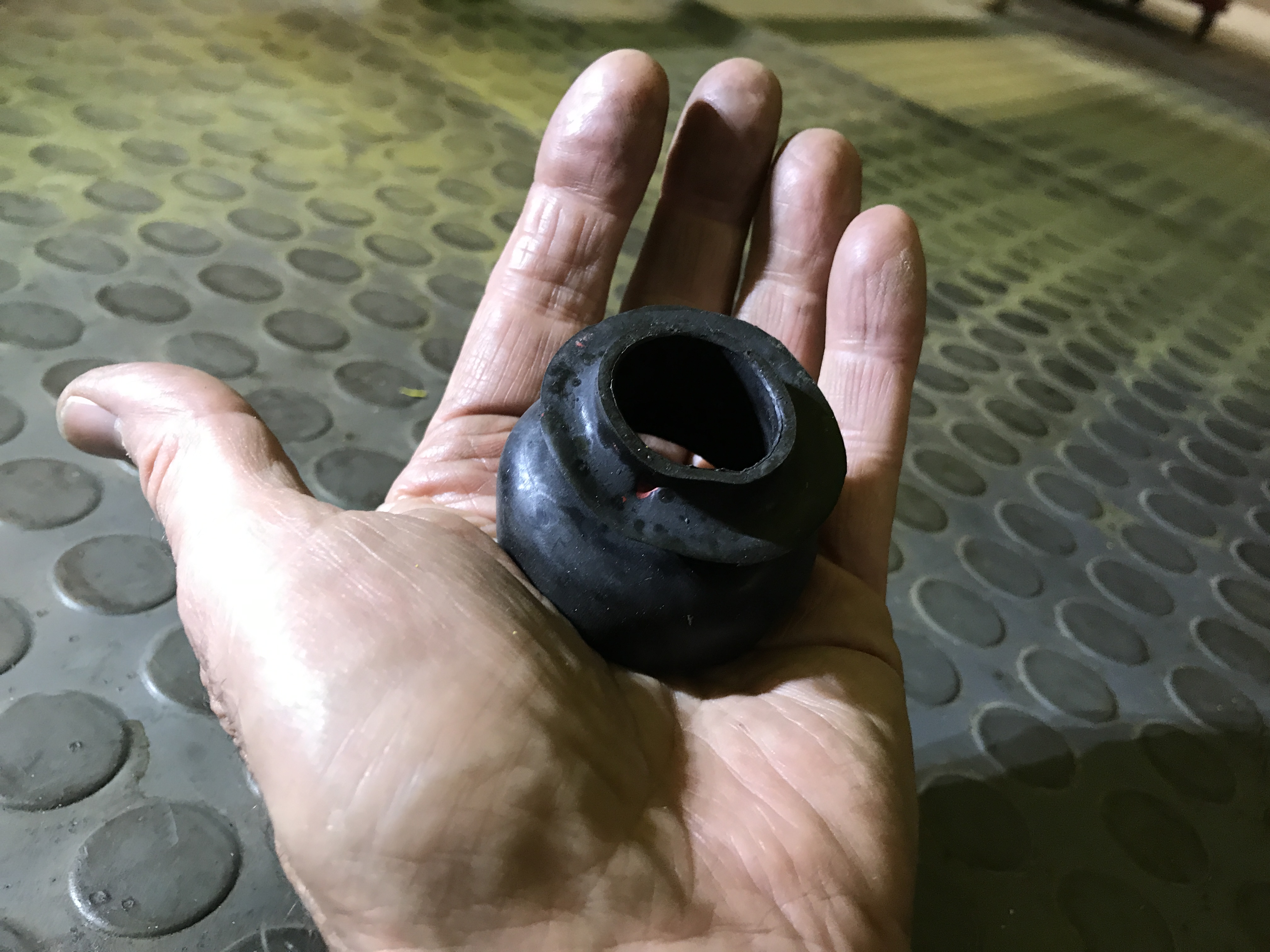

And then discovered I forgot this. Recognize it?
bkrantz
post Jan 2 2021, 09:50 AM
Post #1872
Posts: 8,763
Joined: 3-August 19
From: SW Colorado
Member No.: 23,343
This is the big rubber grommet that seals the front bulkhead around the steering shaft. To install this, I had to unbolt the cross bar and lower the rack.
bkrantz
post Jan 2 2021, 09:51 AM
Post #1873
Posts: 8,763
Joined: 3-August 19
From: SW Colorado
Member No.: 23,343
With everything back in place I installed the shaft bushing retainer.

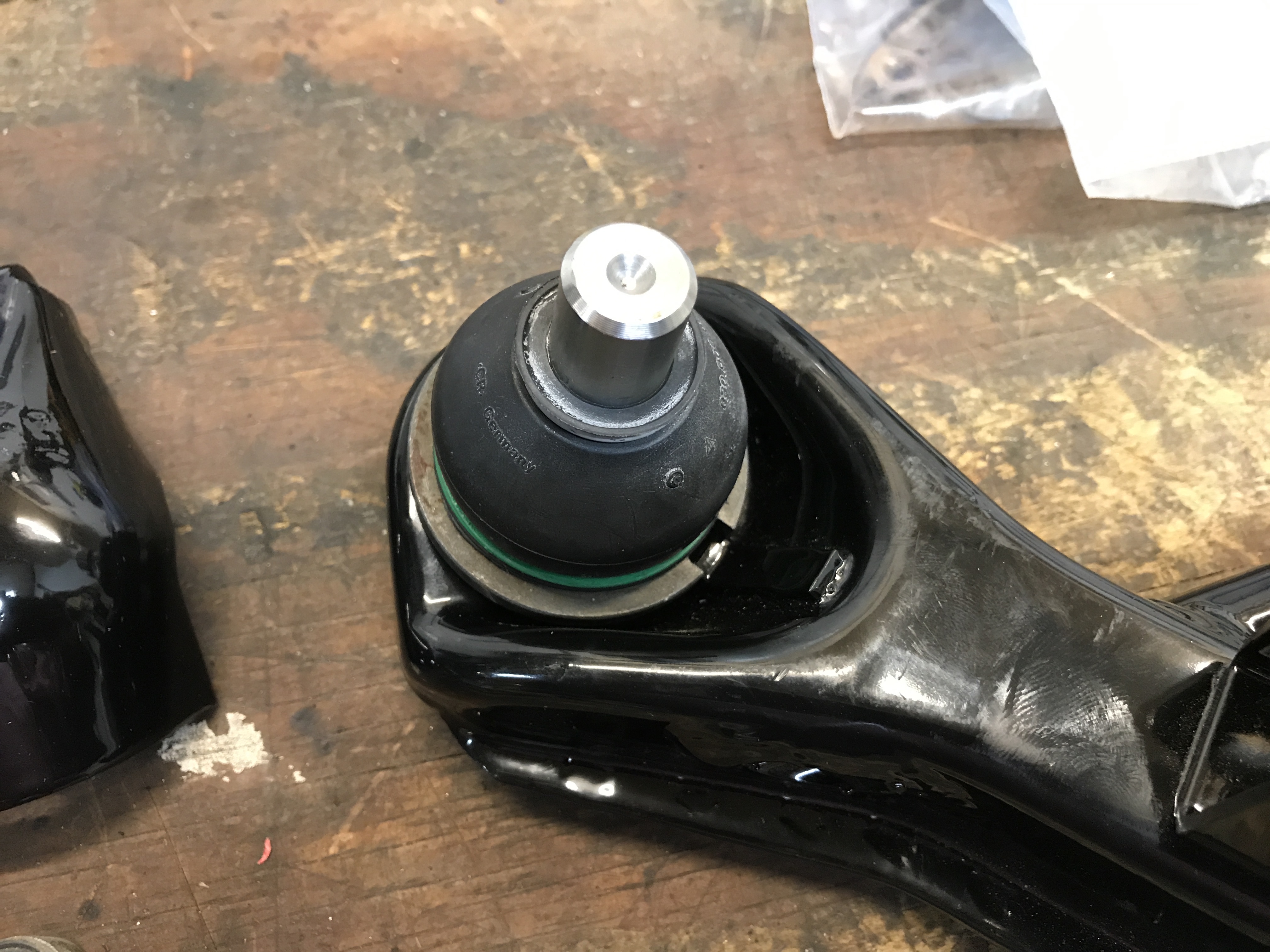

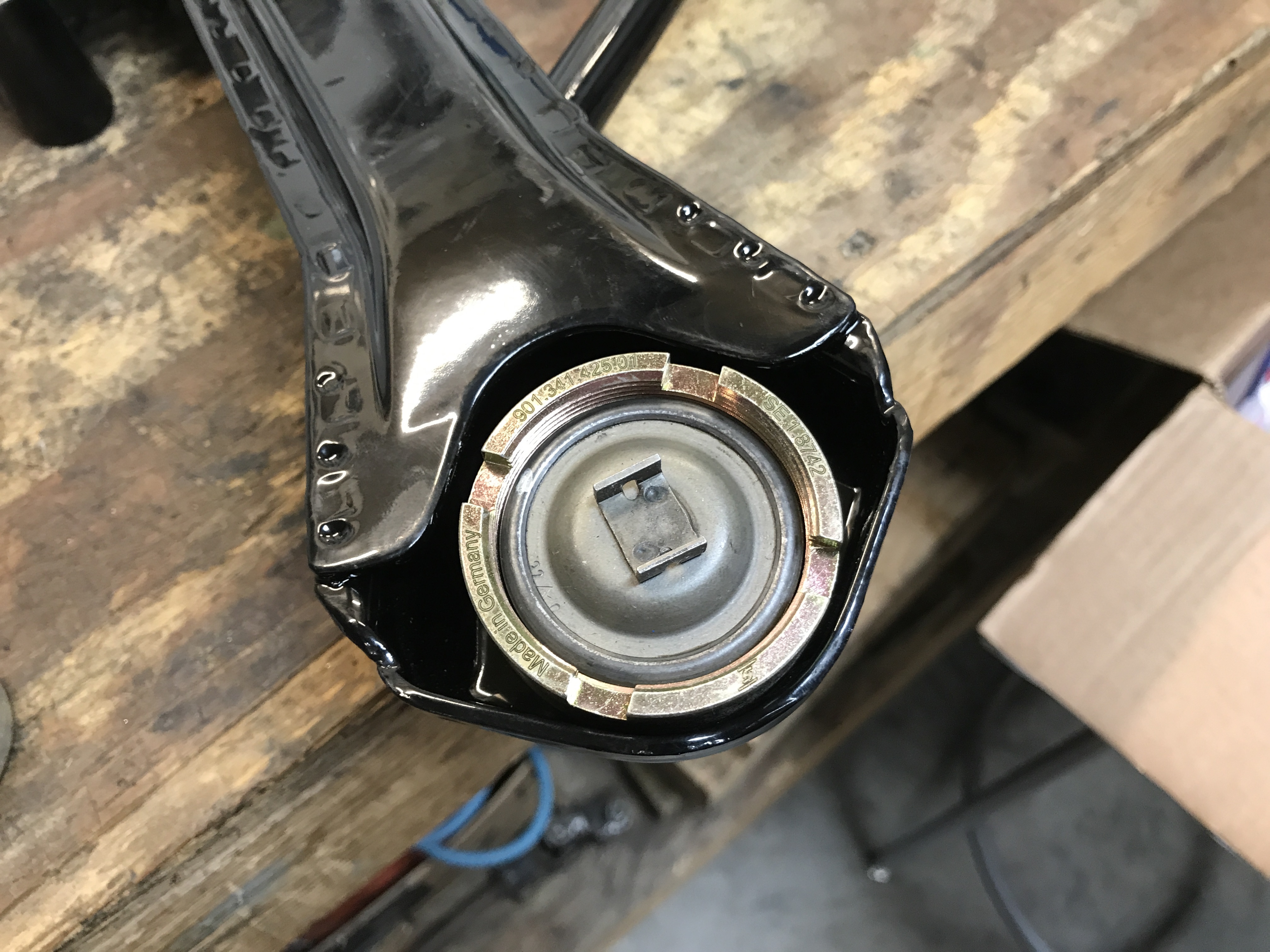

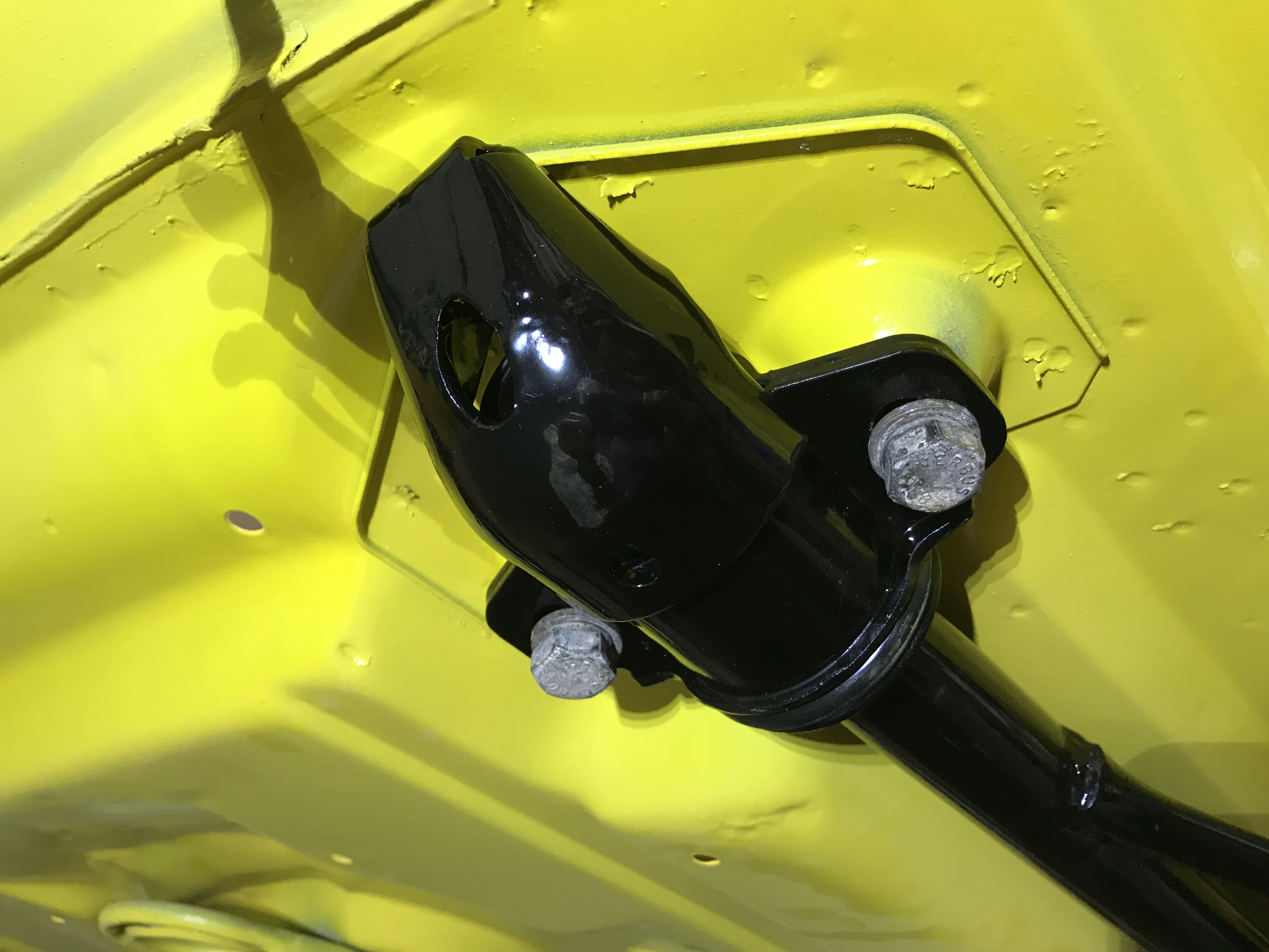

Yesterday, I kept going on the front suspension. Here is the ball joint installed in the left A-arm. Shiny new parts are very fun to work on! (I did not install the lock ring yet.)
bkrantz
post Jan 2 2021, 09:54 AM
Post #1875
Posts: 8,763
Joined: 3-August 19
From: SW Colorado
Member No.: 23,343
Top view
bkrantz
post Jan 2 2021, 09:55 AM
Post #1876
Posts: 8,763
Joined: 3-August 19

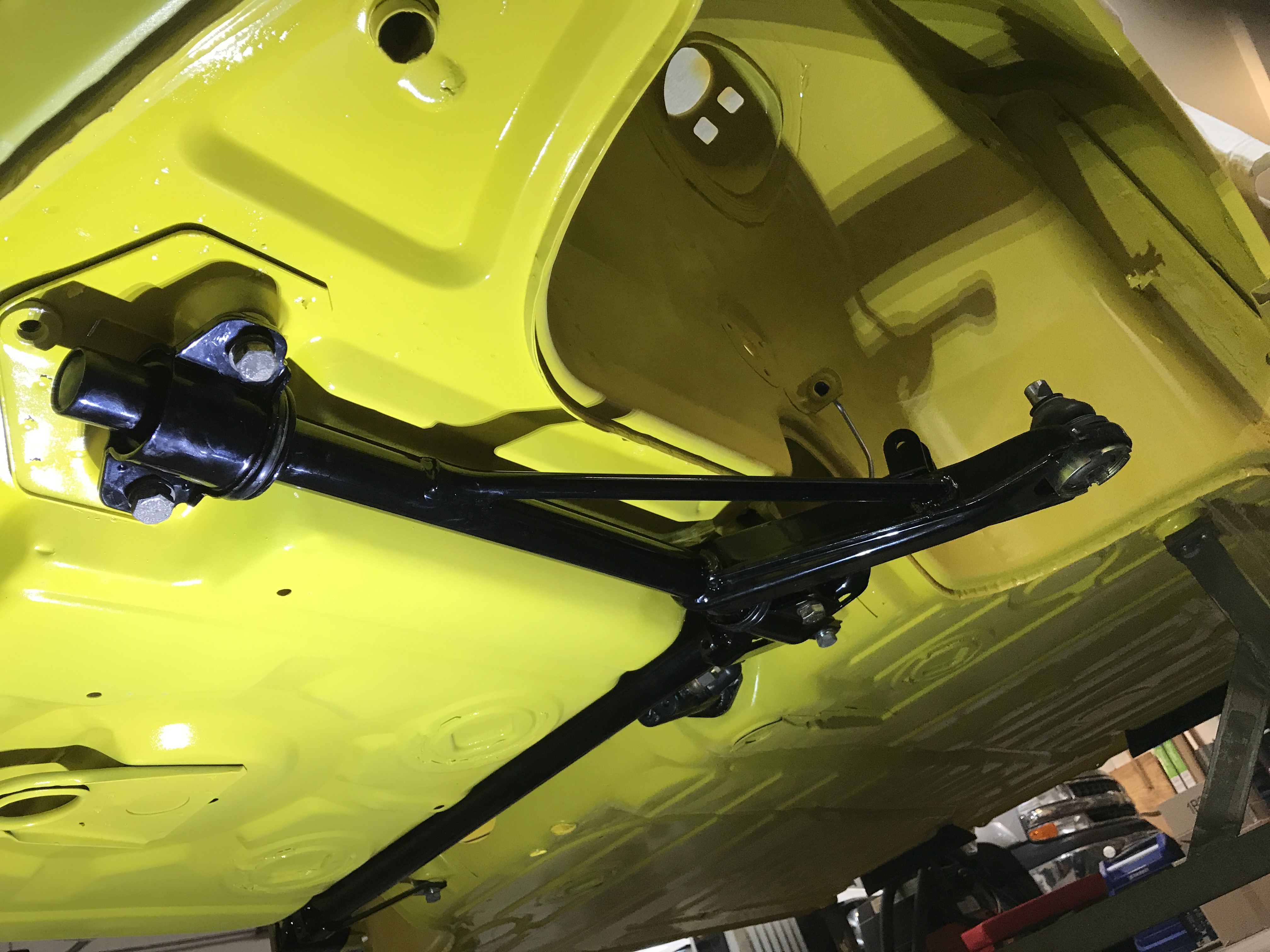

From: SW Colorado
Member No.: 23,343
A-arm installed. This is starting to look like something.
bkrantz
post Jan 2 2021, 09:56 AM
Post #1877
Posts: 8,763
Joined: 3-August 19
From: SW Colorado
Member No.: 23,343
And the front A-arm cap. I did not get the correct new bolts, so have to order those. (Please stop my OCD!)

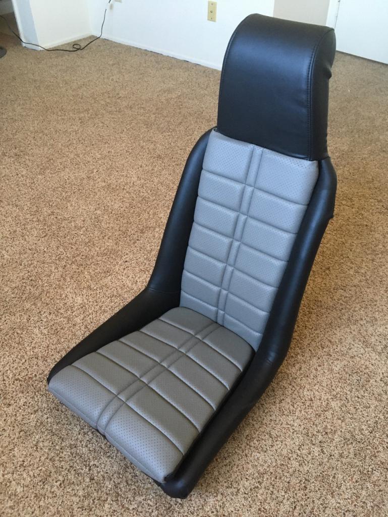

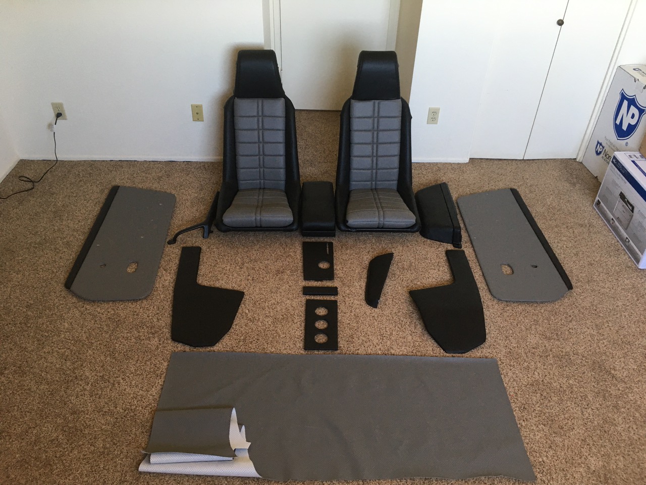

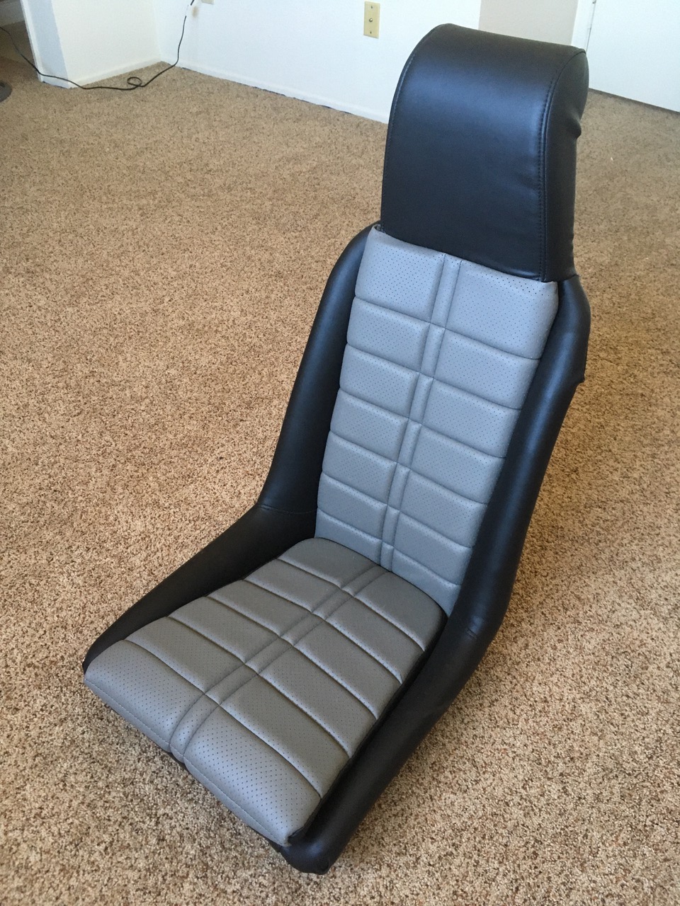

Here's a sneak preview of the interior. My son picked up re-covered parts from the upholstery shop in Tucson (Pancho's), and sent these photos.
bkrantz
post Jan 2 2021, 07:56 PM
Post #1879
Posts: 8,763
Joined: 3-August 19
From: SW Colorado
Member No.: 23,343

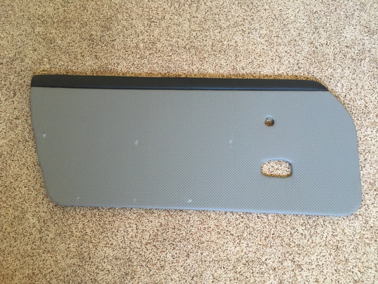

Definitely not stock! The look is black vinyl with perforated gray inserts.
bkrantz
post Jan 2 2021, 08:03 PM
Post #1880
Posts: 8,763
Joined: 3-August 19
From: SW Colorado

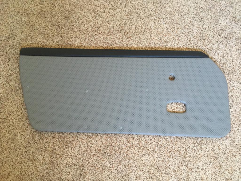

Member No.: 23,343
And the same on the door panels.
