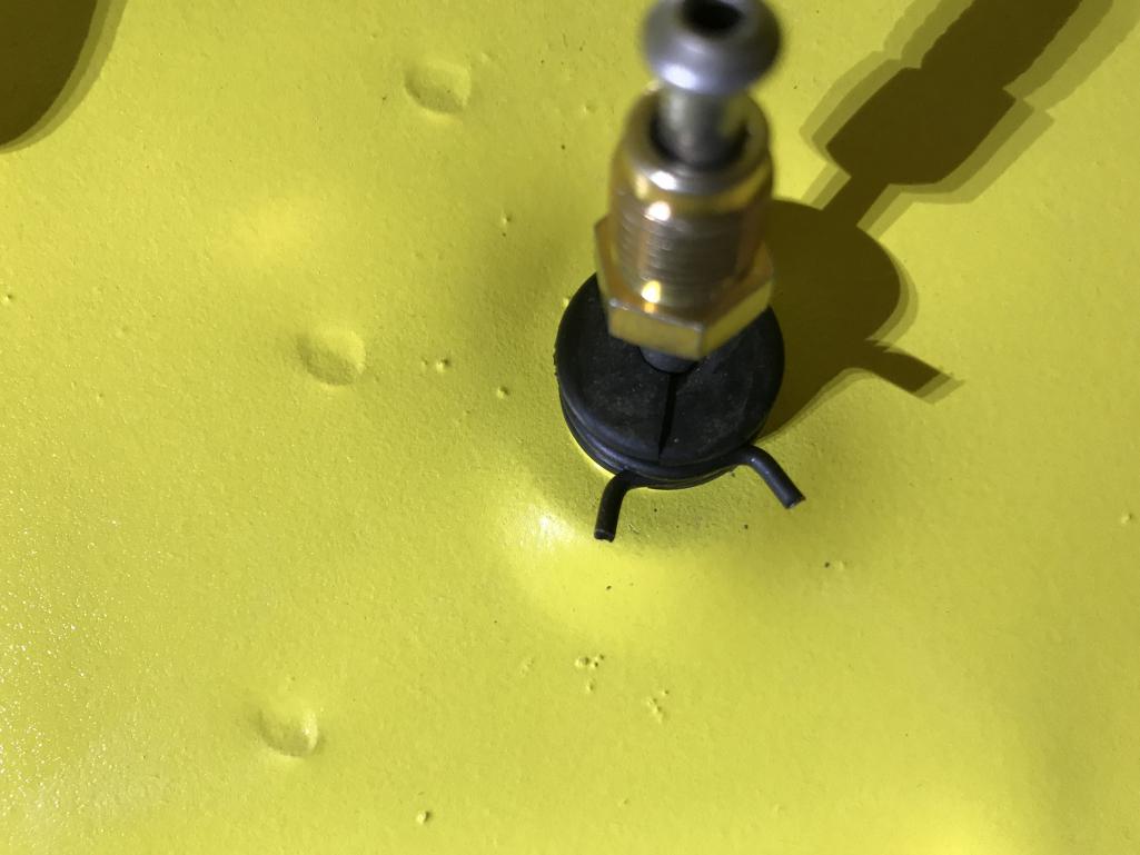

I also got and installed the circular retaining clips for the tunnel brake line grommets. Not exactly a tight fit.
I had the same issue. I think the rubber grommets are not made correctly (too small) but it could be that the clips are too big as well. There hope that helped. Ha

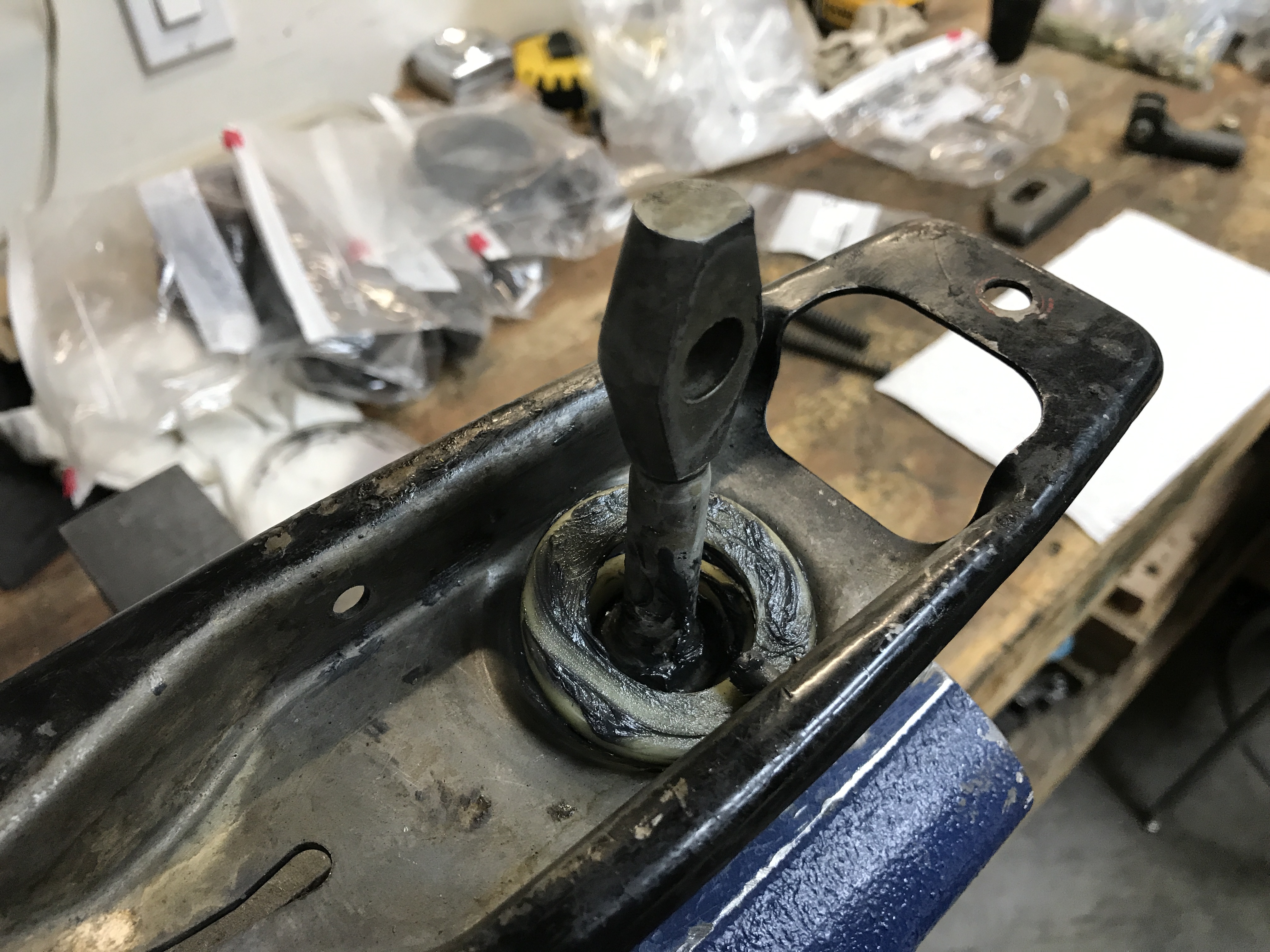

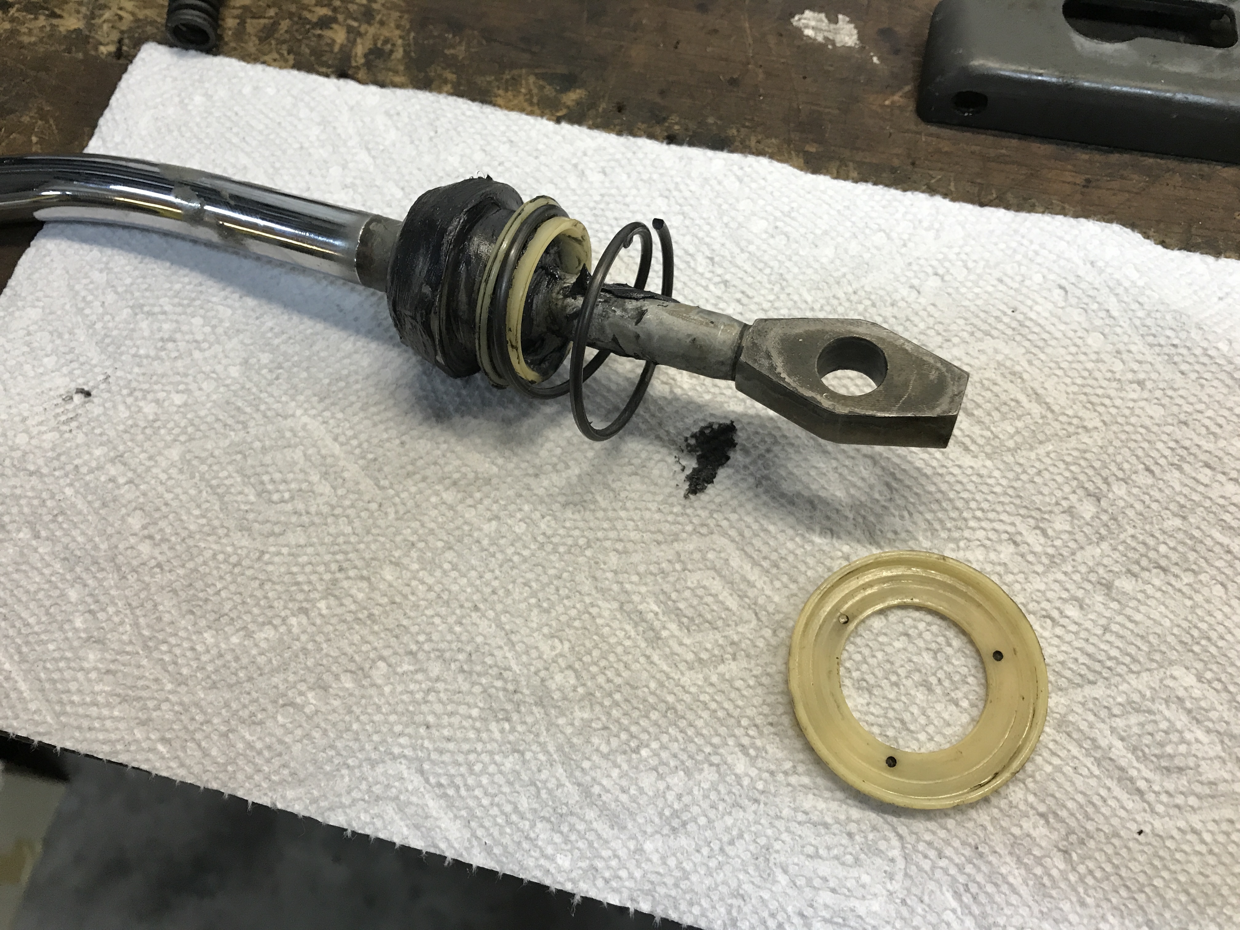

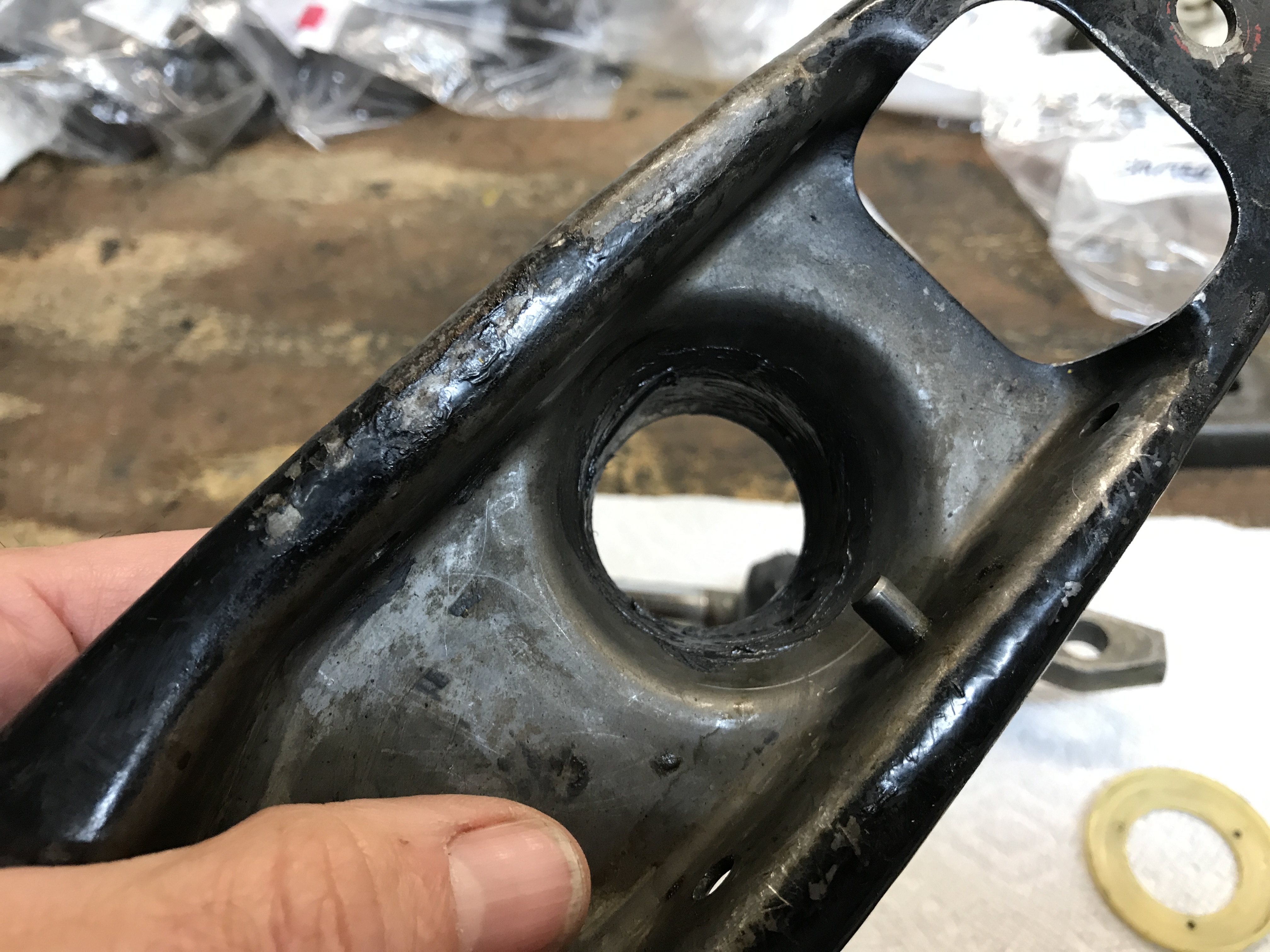

With recent parts delivery, I got back to the shift lever. That started with greasing the ball end of the lever and the nylon bushings.
bkrantz
post Jan 3 2021, 07:34 PM
Post #1885
Posts: 8,763
Joined: 3-August 19
From: SW Colorado
Member No.: 23,343
And the socket in main bracket.

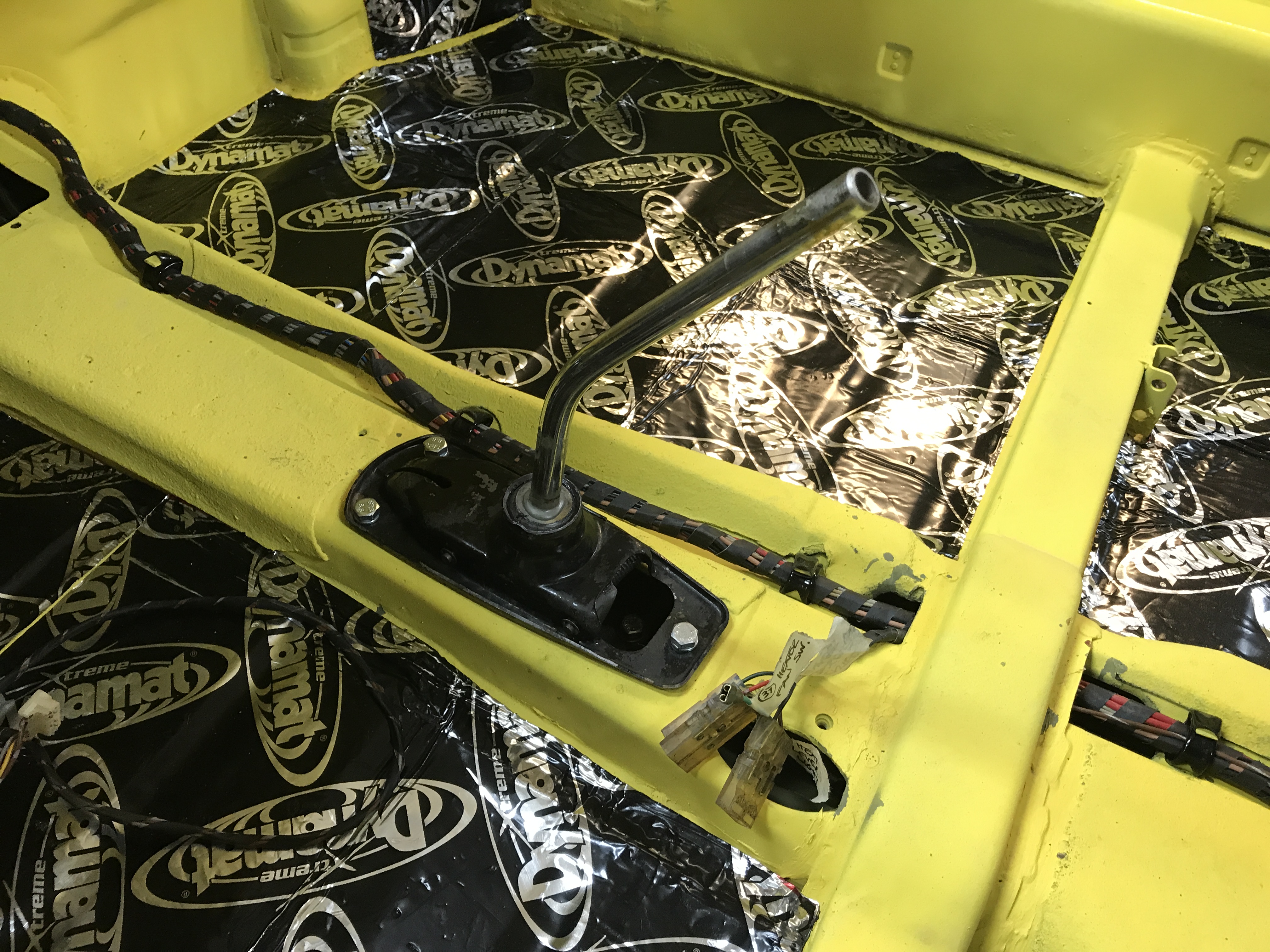

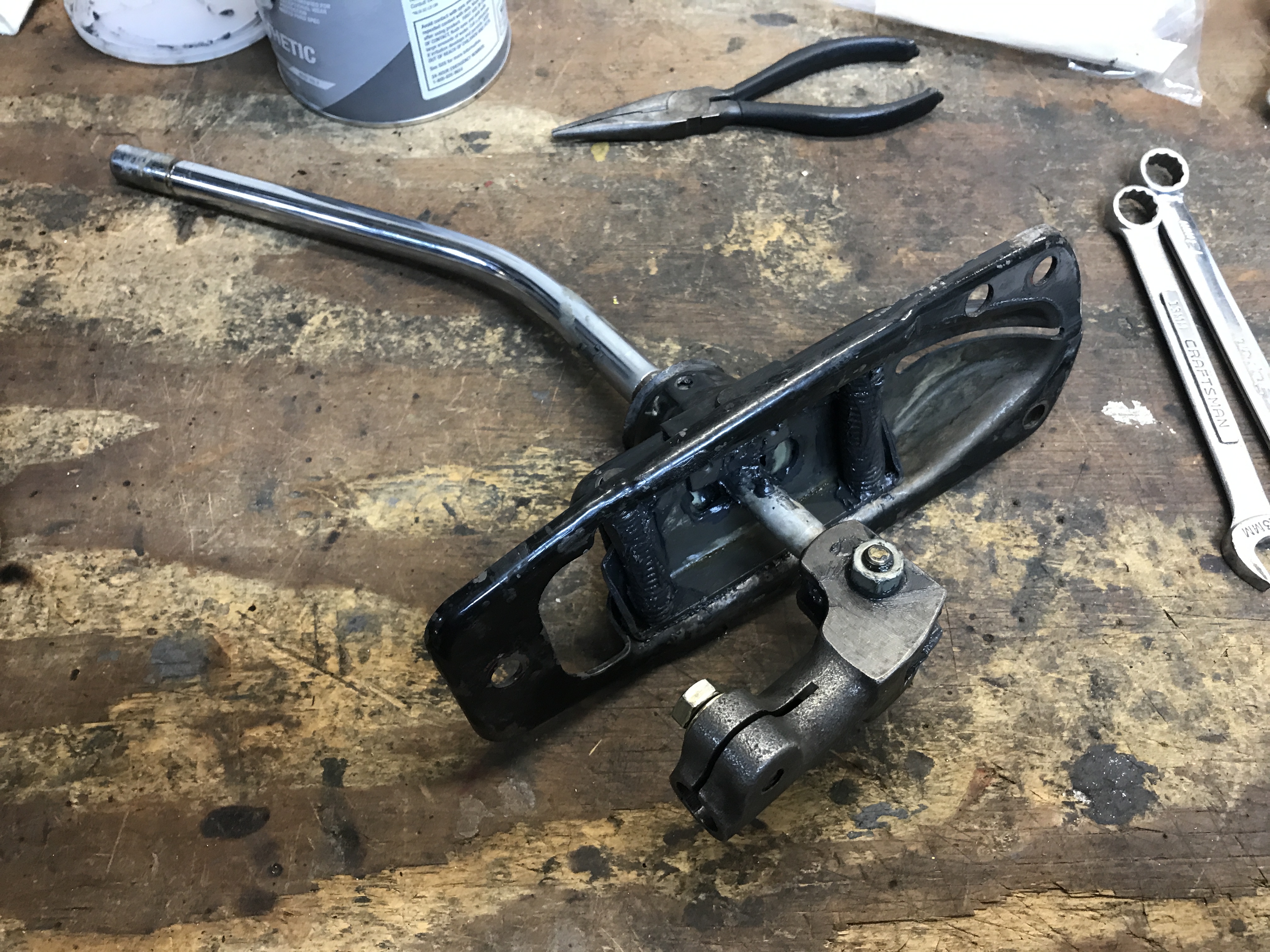

Here's the lever in place (upside down).

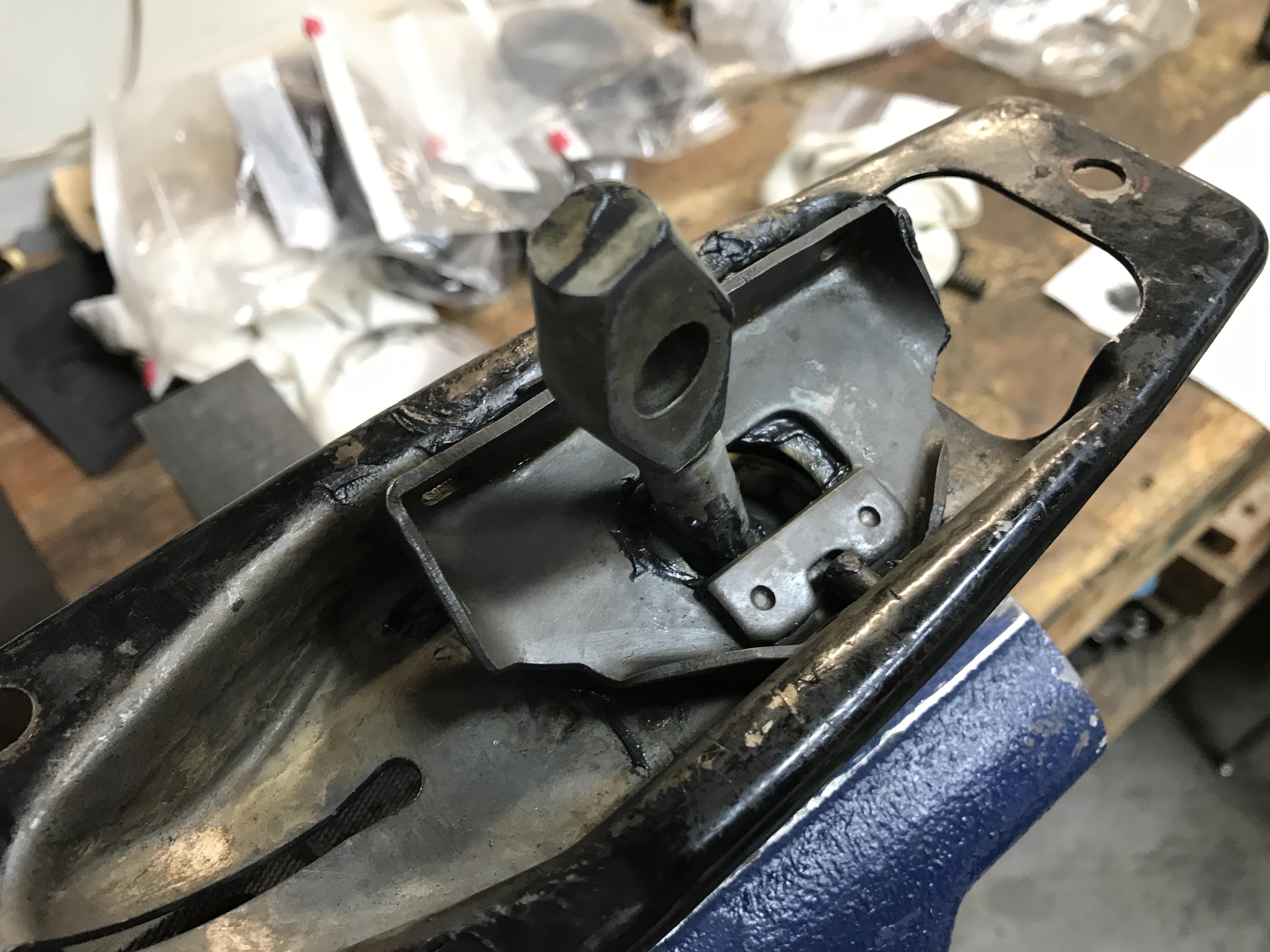

And the sliding plate.

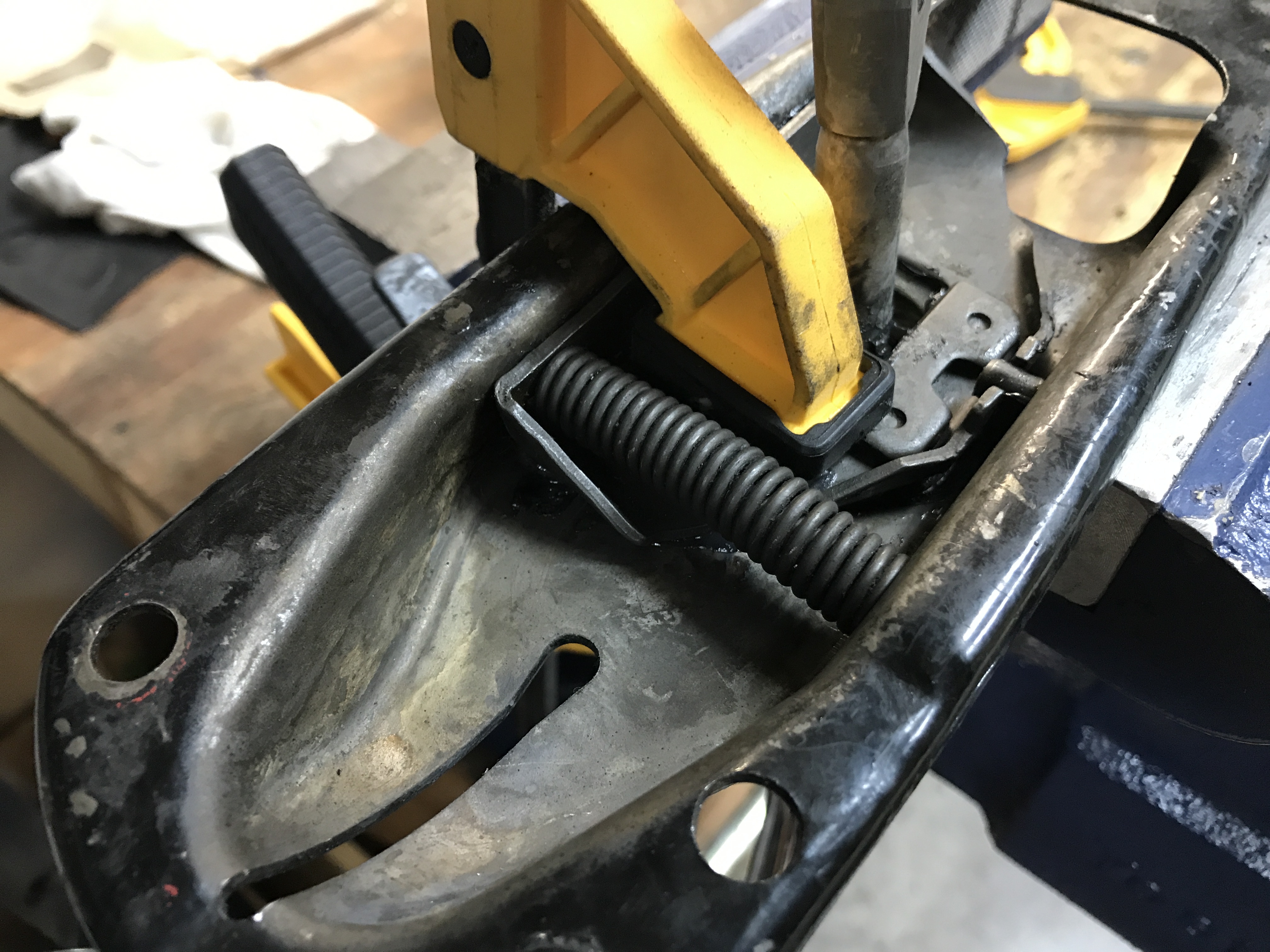

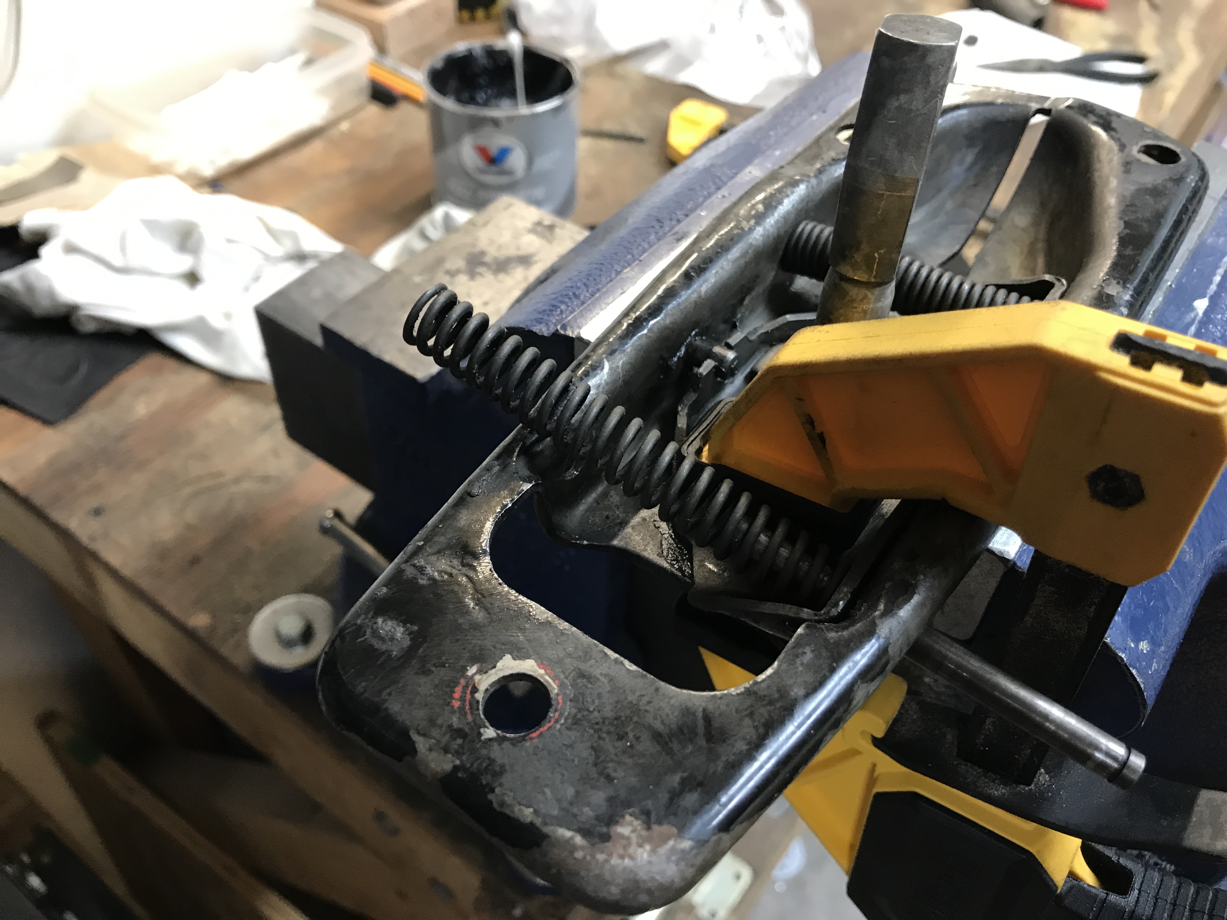

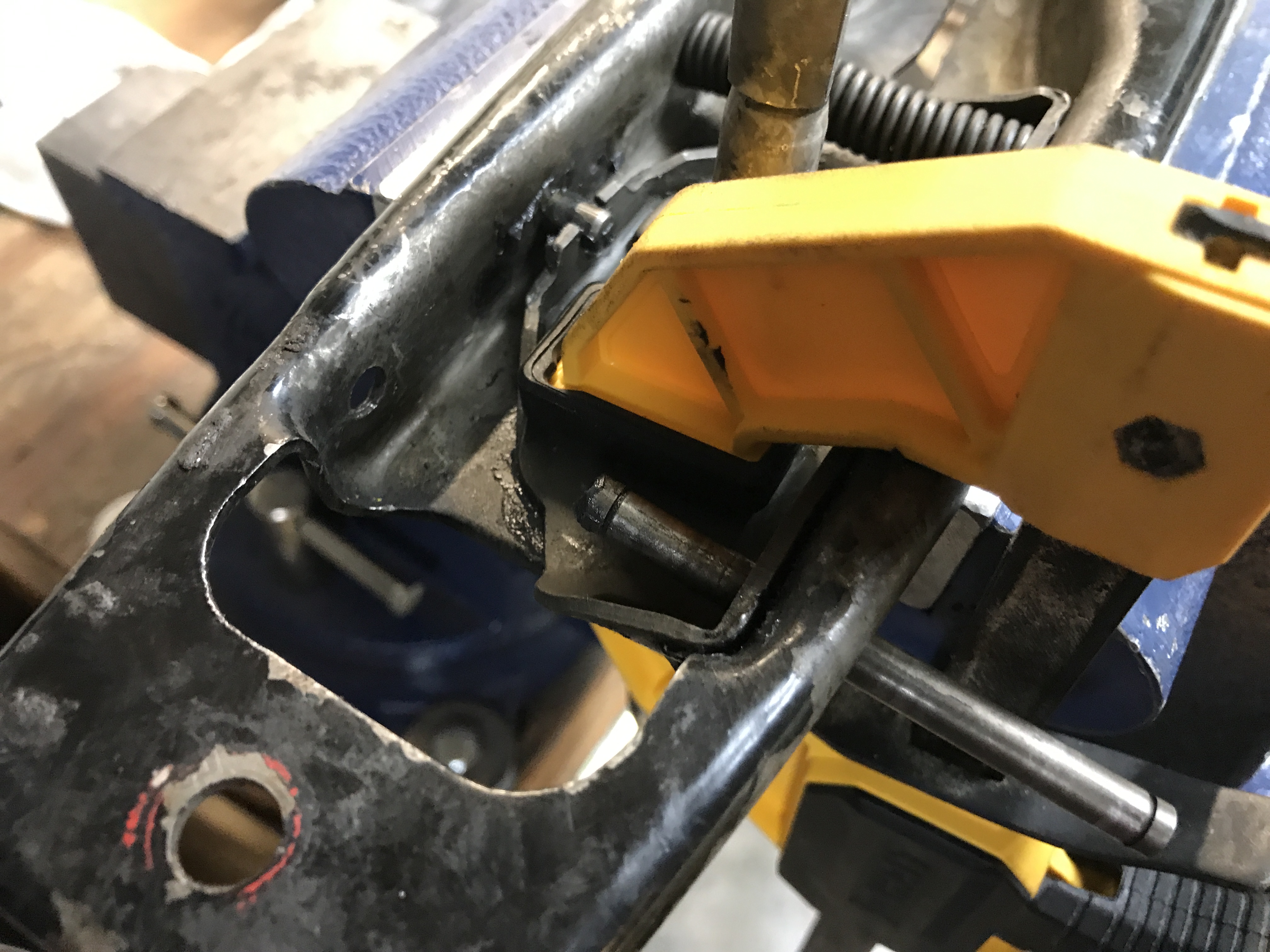

The springs for the sliding plate turned out to be a PIA. Getting the first one in place took about 30 minutes.

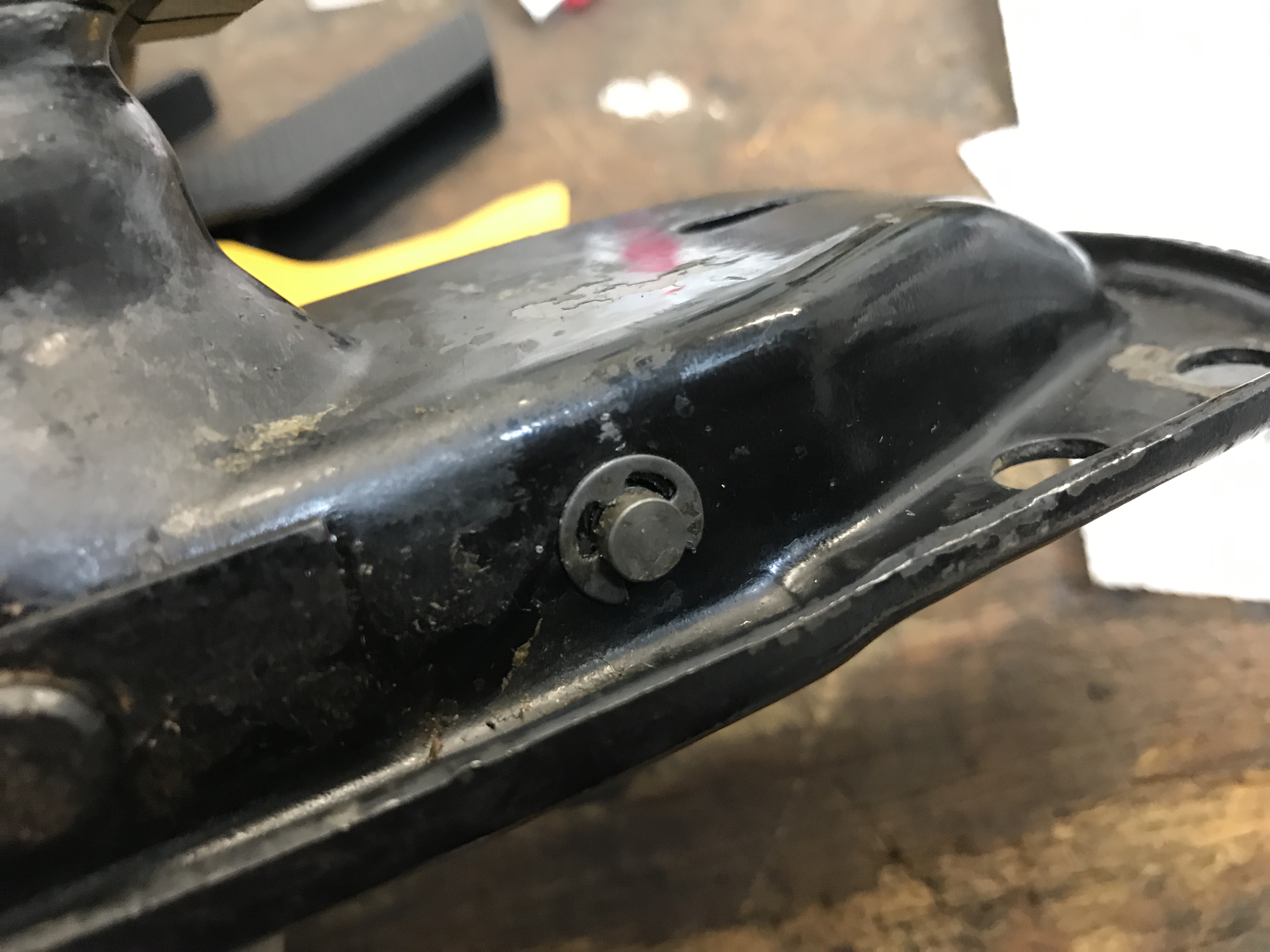

And I could use the new circlips, and lock the pin in place.

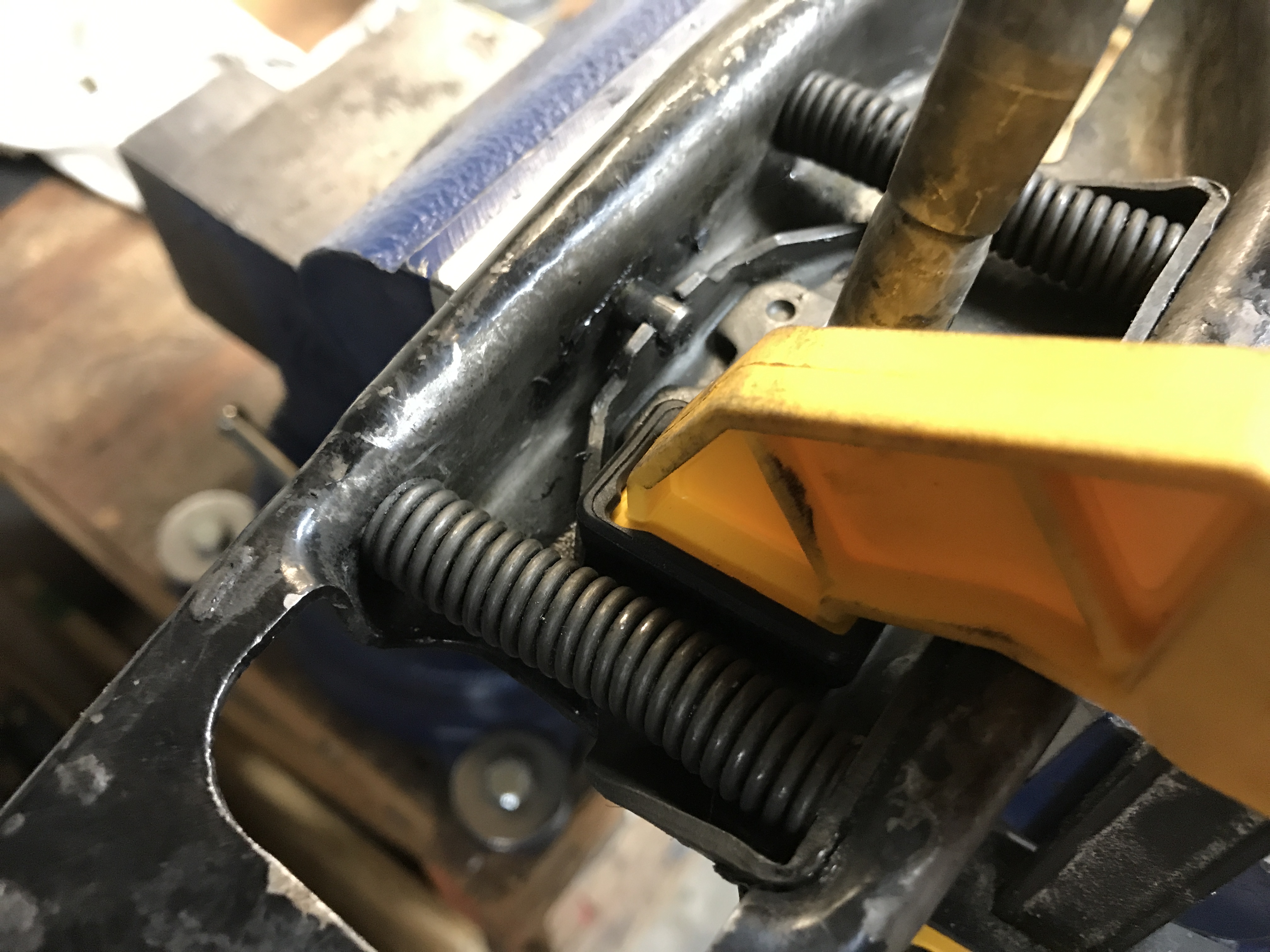

For the second spring, here's how I got in place. First I inserted the pin about 1/2 inch.
bkrantz
post Jan 3 2021, 07:43 PM
Post #1891
Posts: 8,763
Joined: 3-August 19
From: SW Colorado
Member No.: 23,343
Then I put one end of the spring on the pin.
bkrantz
post Jan 3 2021, 07:45 PM
Post #1892
Posts: 8,763
Joined: 3-August 19
From: SW Colorado
Member No.: 23,343
Even with the experience with the first spring, it still took about 5 minutes of fussing to tuck the other end inside the bracket, push it down, and insert the rod all the way.

Finally, I greased and added the bottom lever.
bkrantz
post Jan 3 2021, 07:48 PM
Post #1894
Posts: 8,763
Joined: 3-August 19
From: SW Colorado
Member No.: 23,343
And then installed the gear shift in the car.

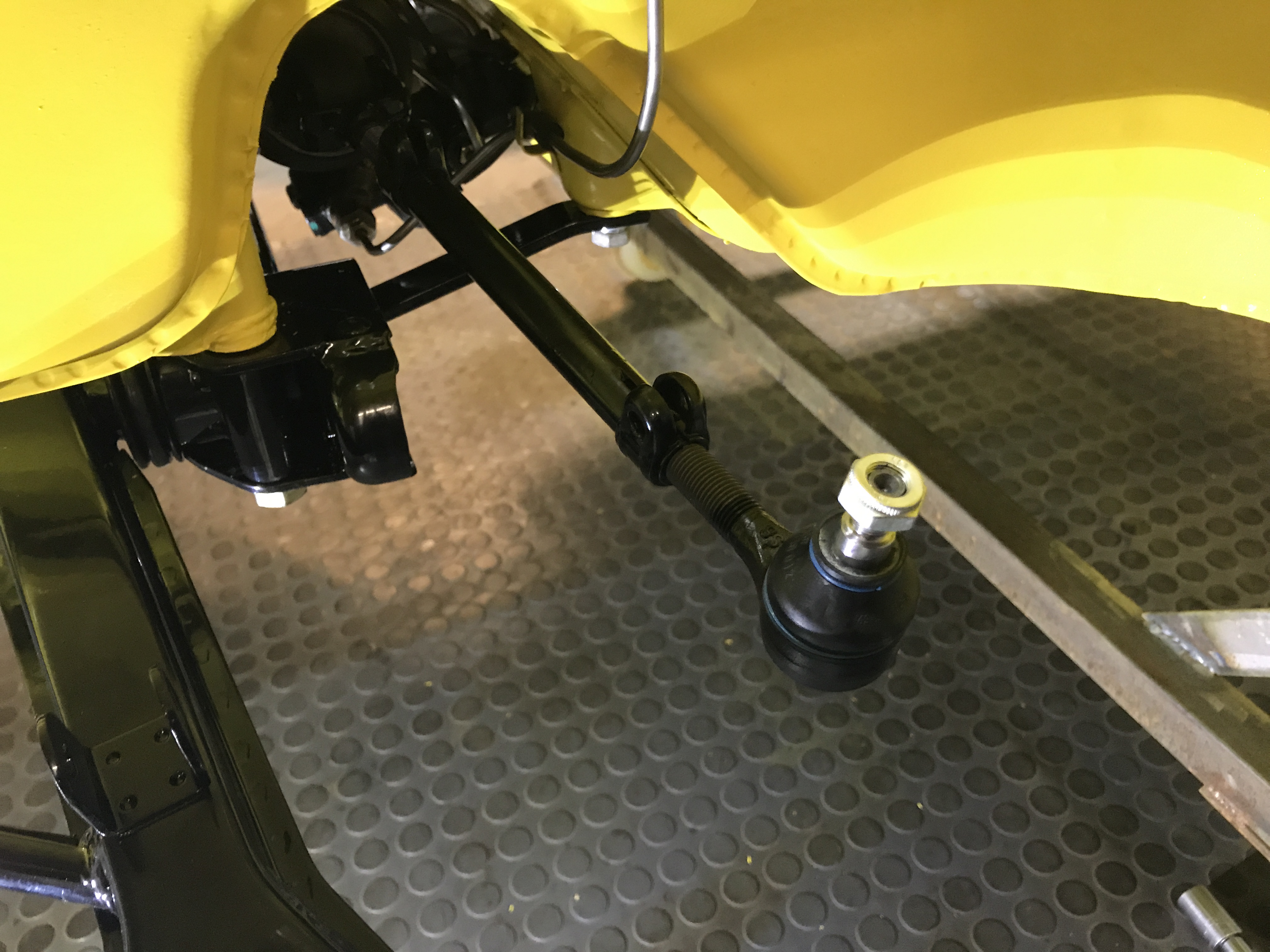

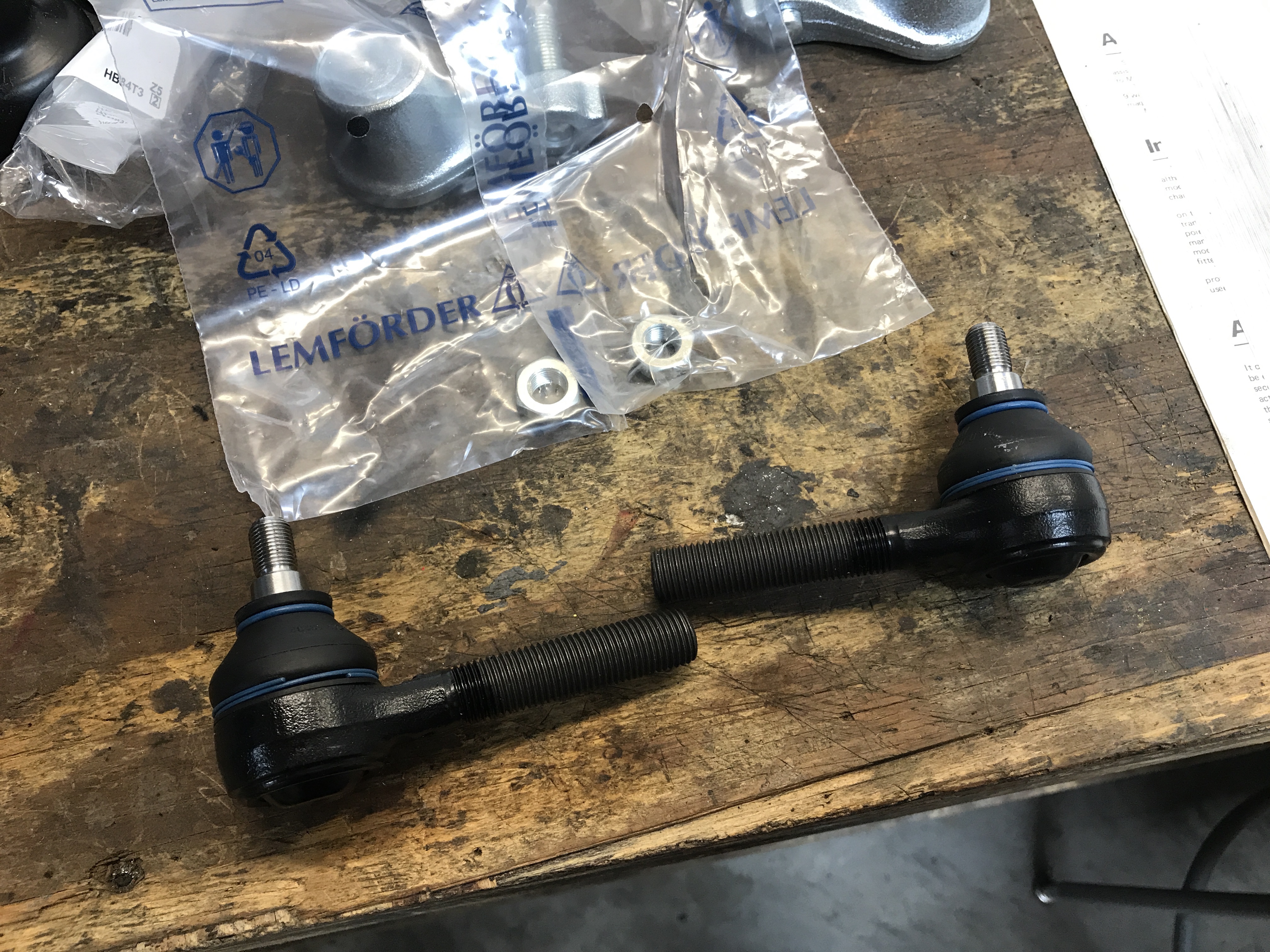

I had more time, so I went back to the new parts box, and got the tie rod ends.

And screwed them in place.

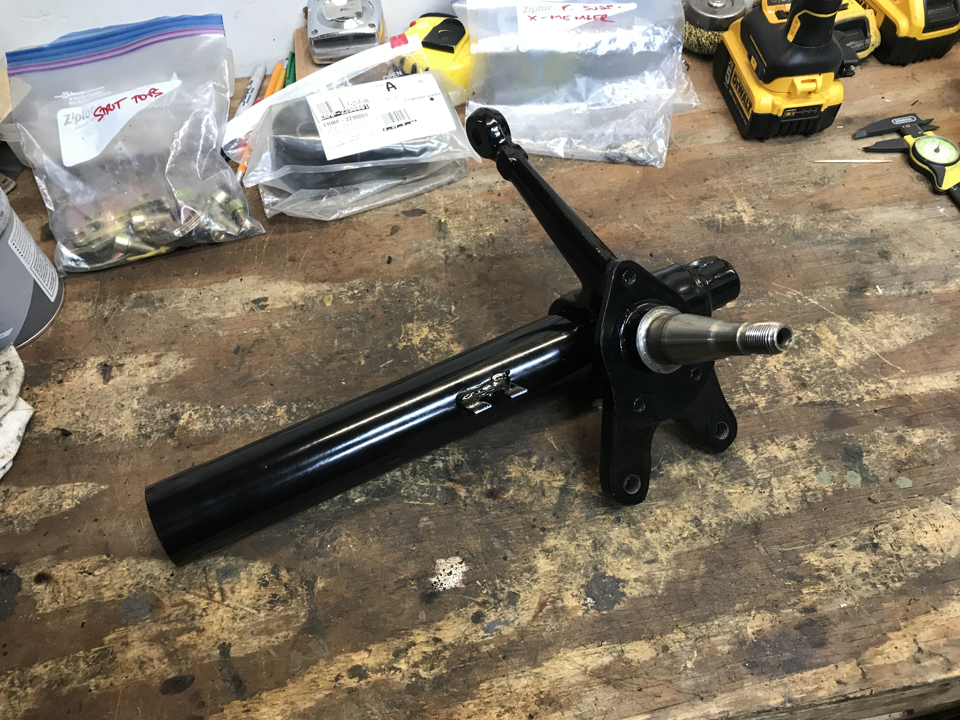

That inspired me to get the left strut. I had to do a little clean up from some "extra" powder coating.

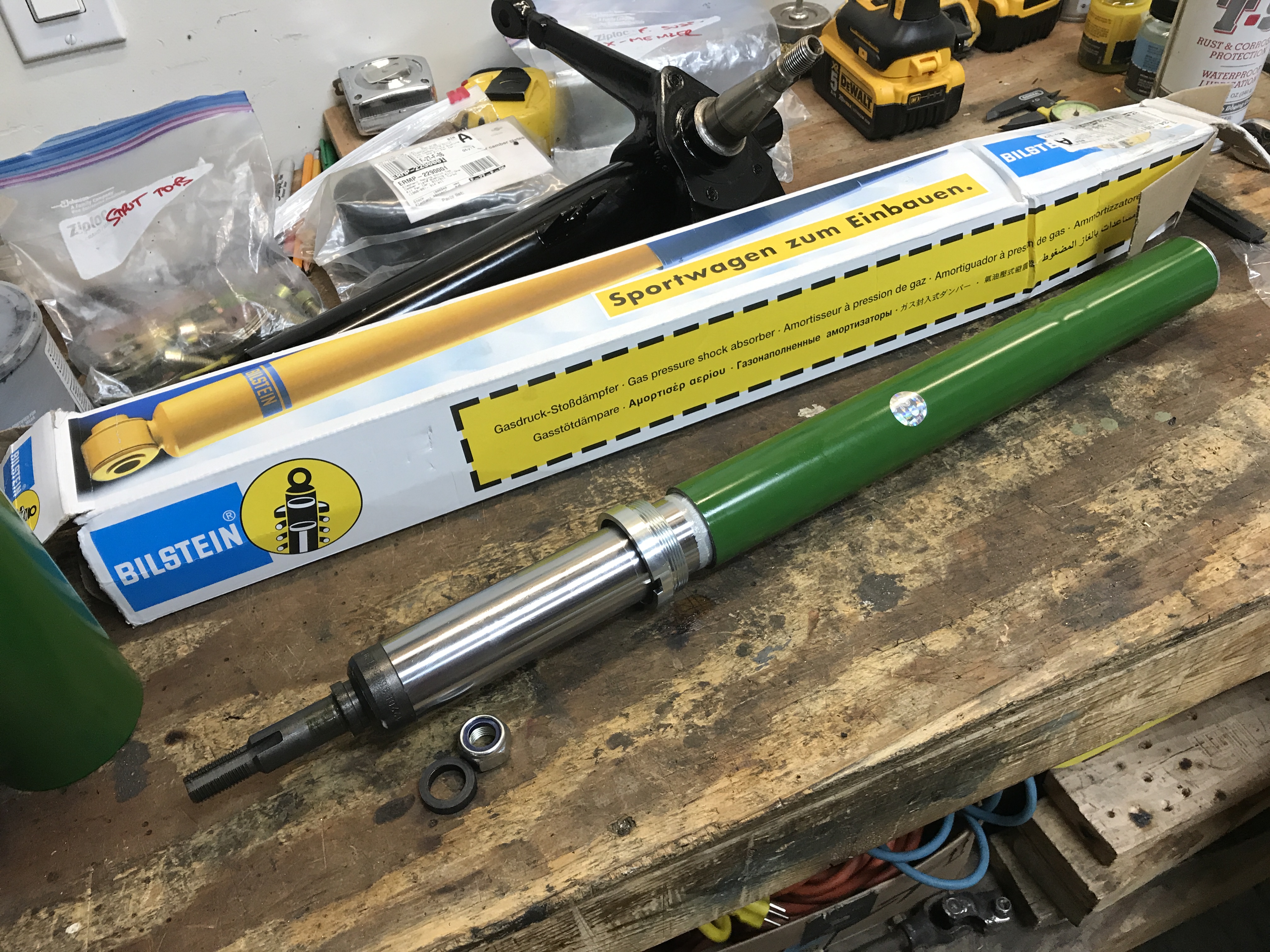

And the new Bilstein insert.
bkrantz
post Jan 3 2021, 07:56 PM
Post #1899
Posts: 8,763
Joined: 3-August 19
From: SW Colorado
Member No.: 23,343
Fits perfectly, and all tightened up.

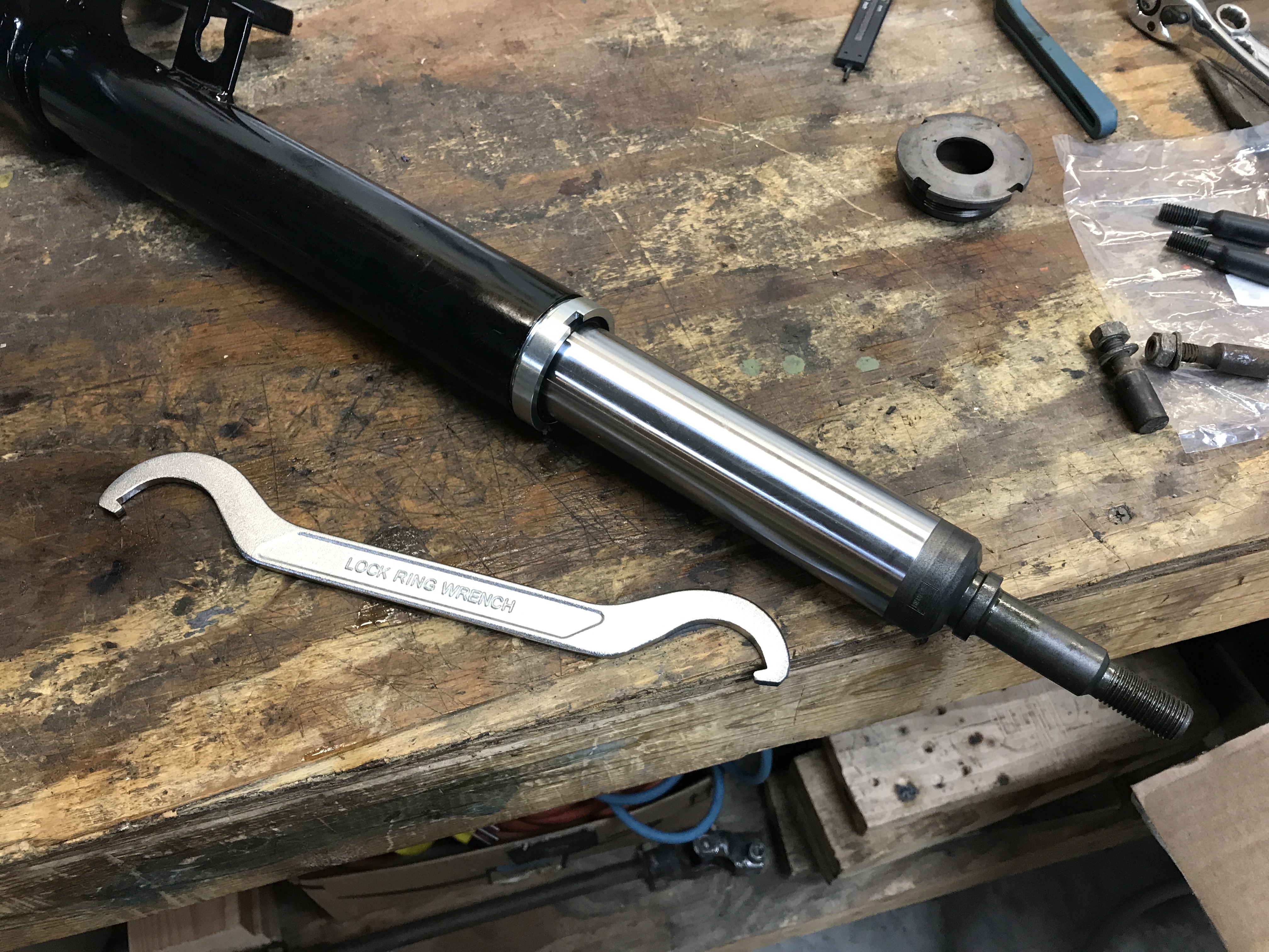

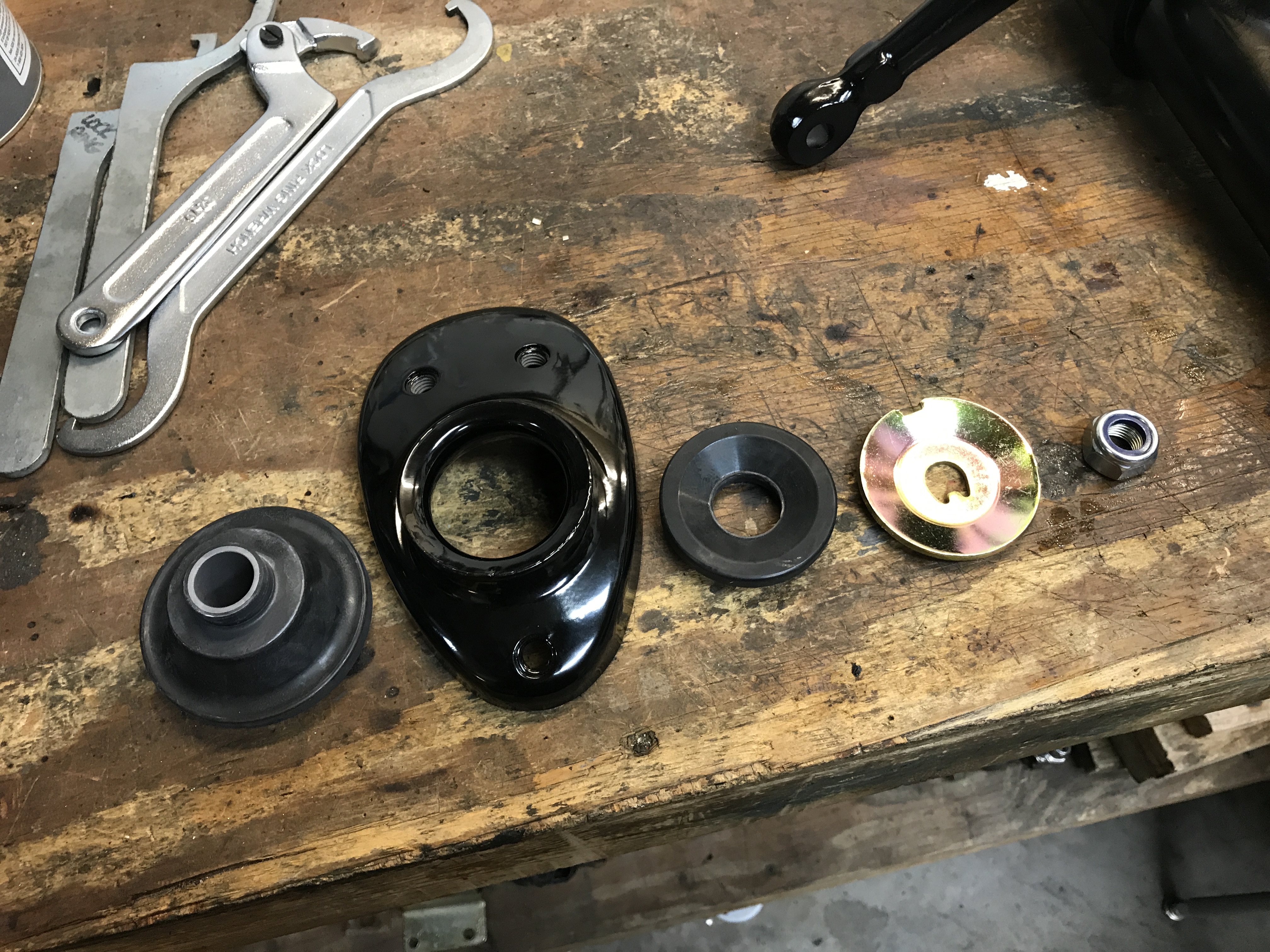

Here's the strut top hardware, including new 2-part bushings from Elephant Racing.
