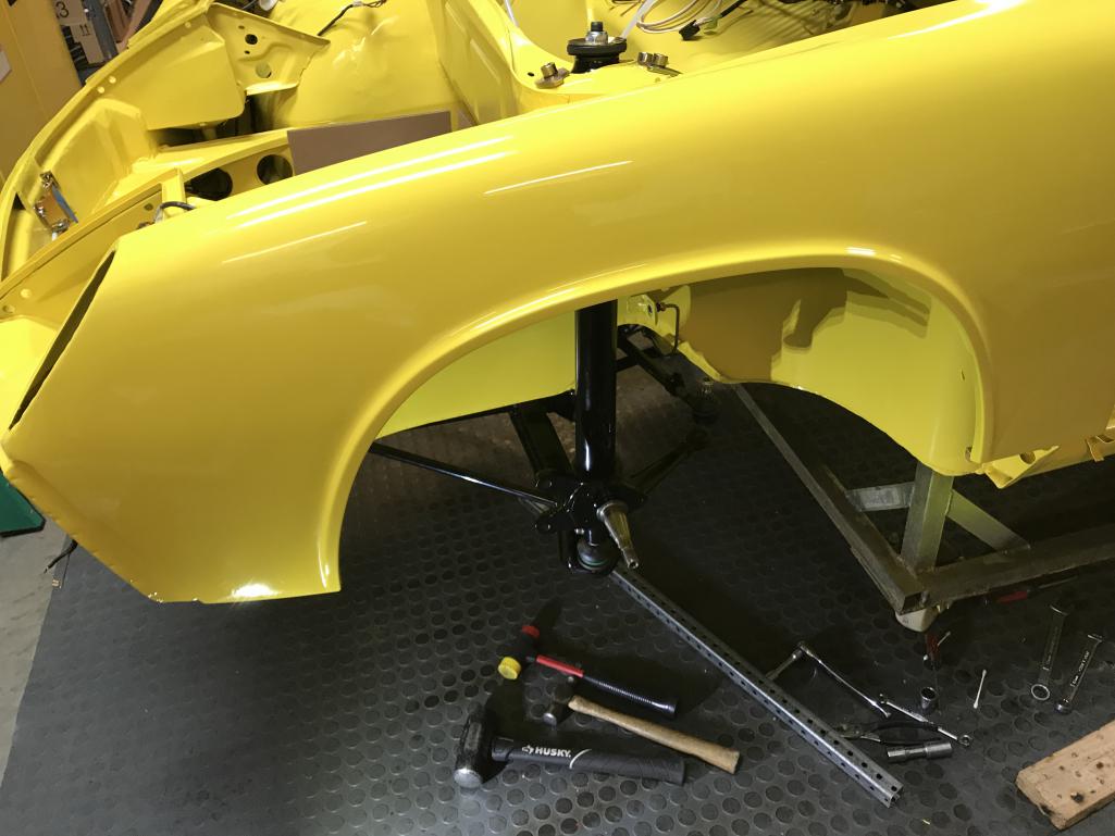

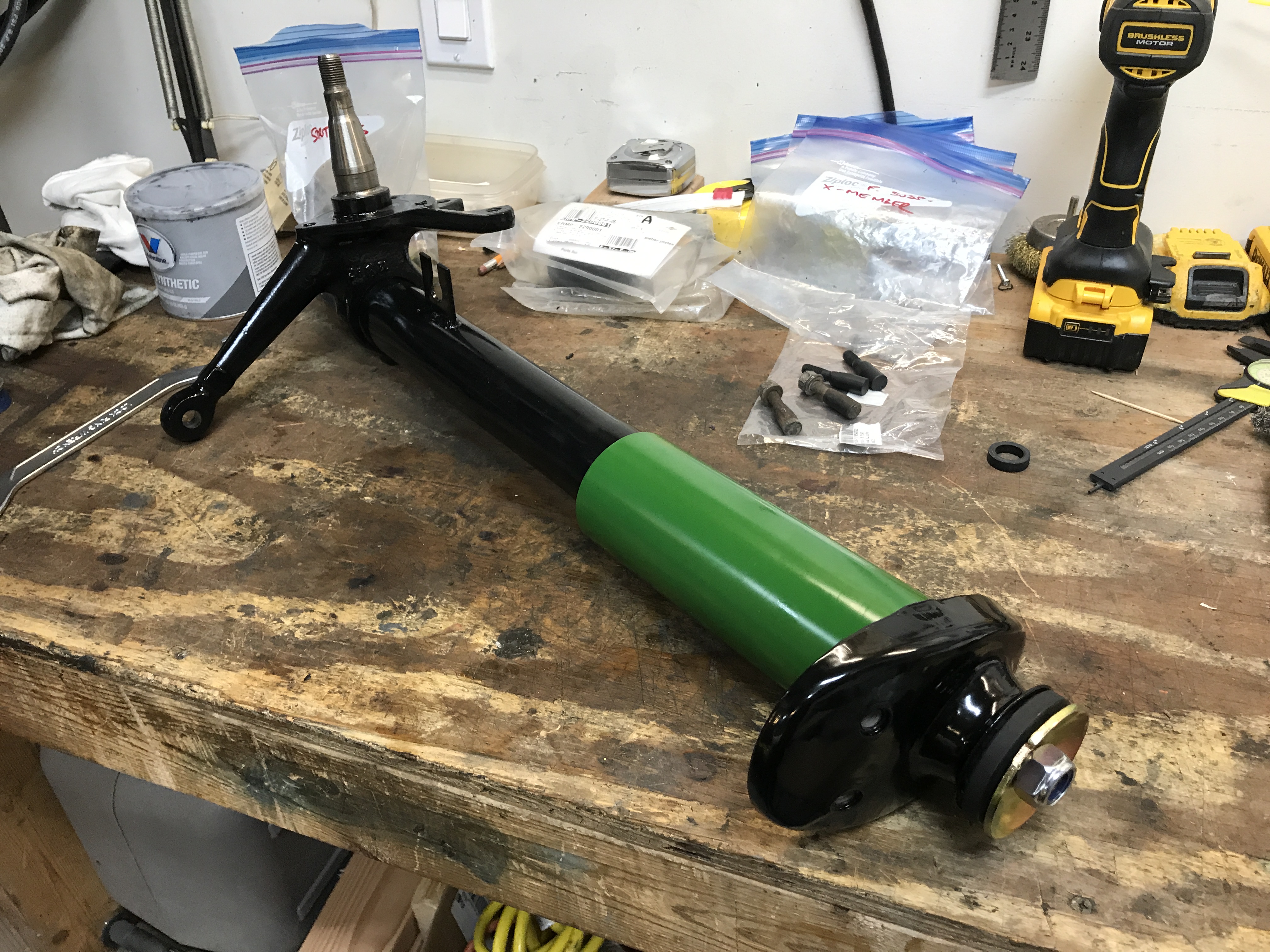

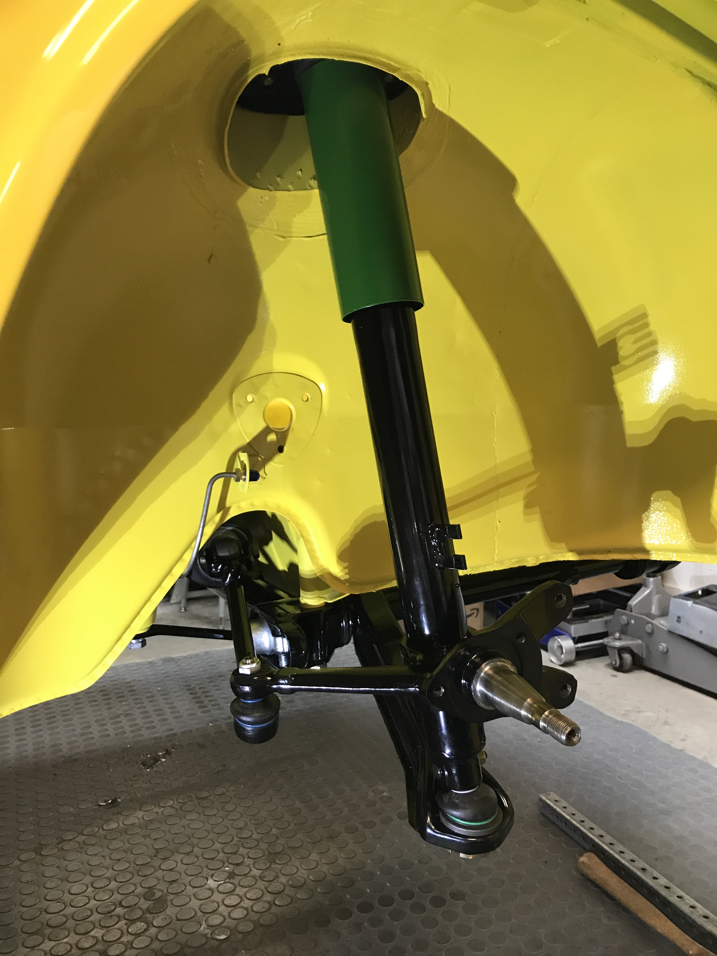

Complete strut assembly.
bkrantz
post Jan 3 2021, 08:00 PM
Post #1902
Posts: 8,763
Joined: 3-August 19
From: SW Colorado
Member No.: 23,343

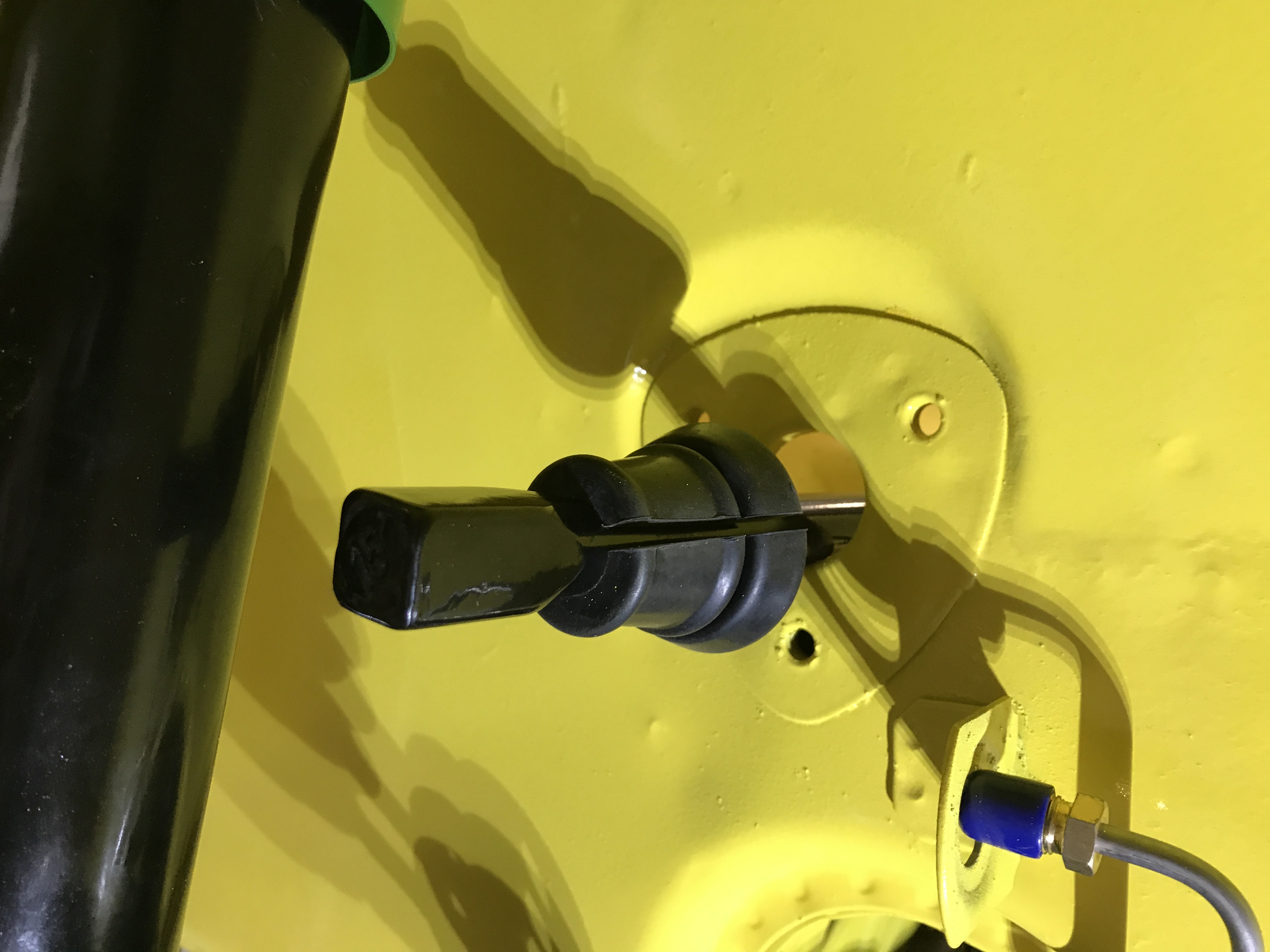

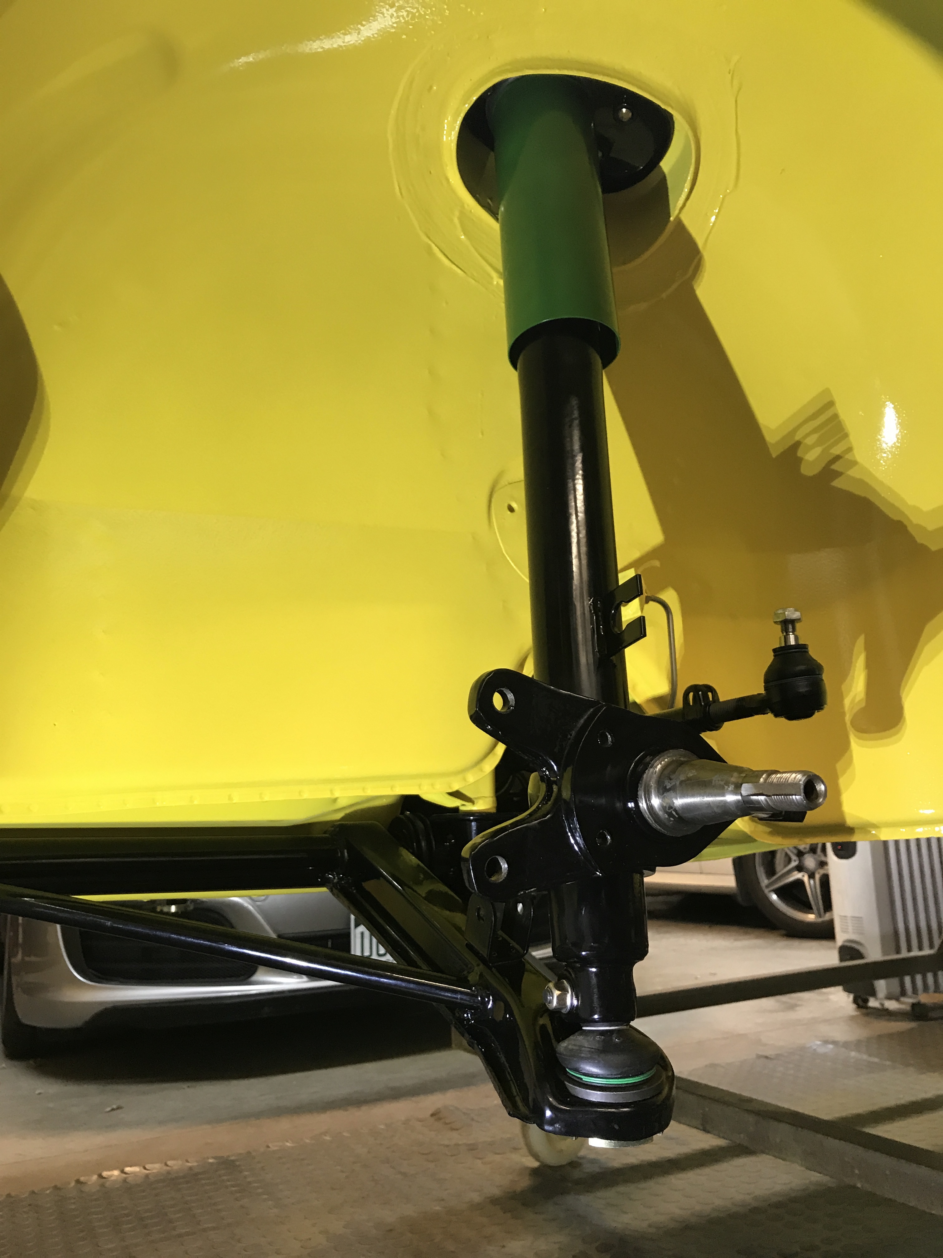

Installed in the car, starting with the top, and then inserting the ball joint stud into the bottom of the strut.

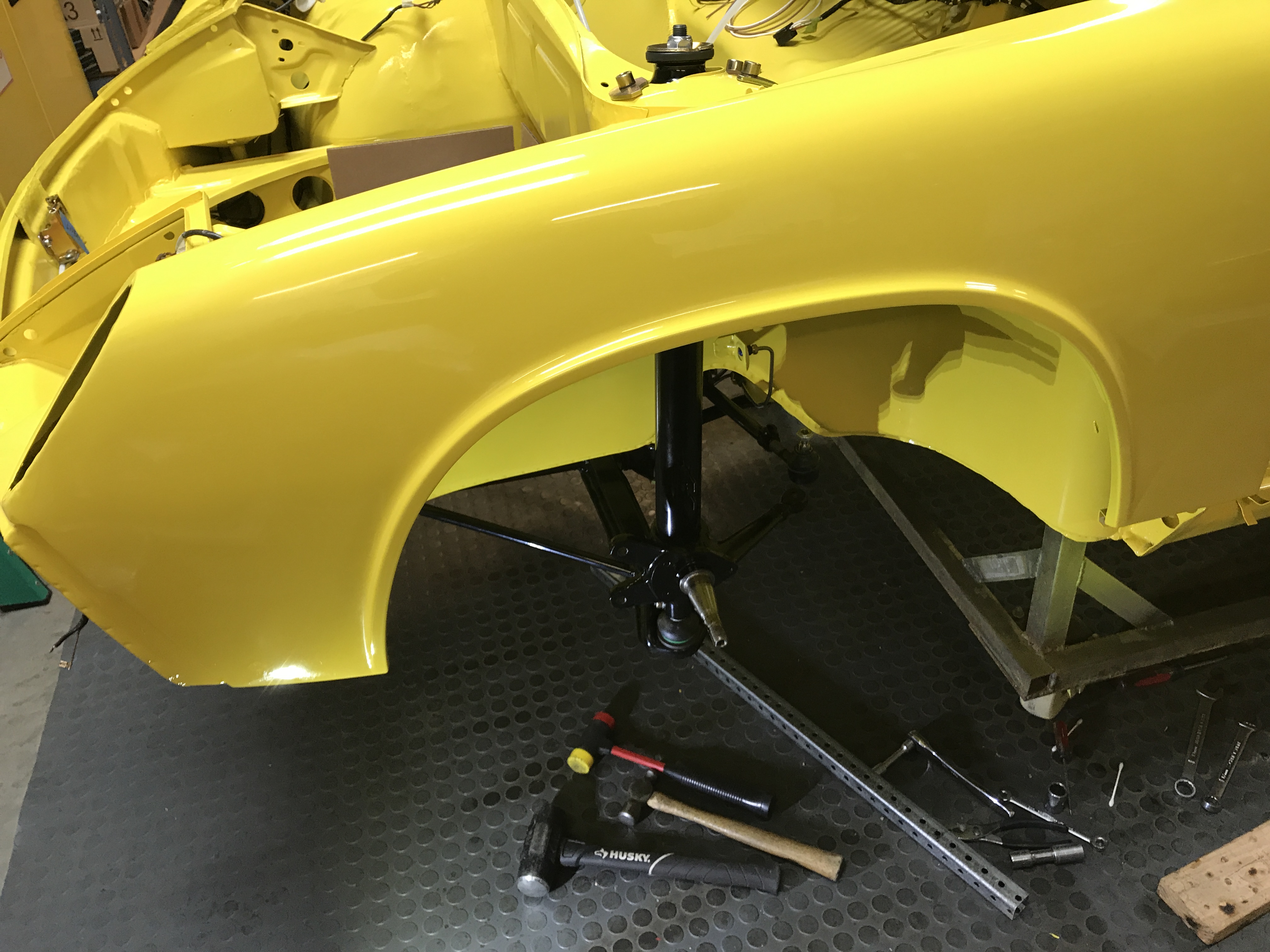

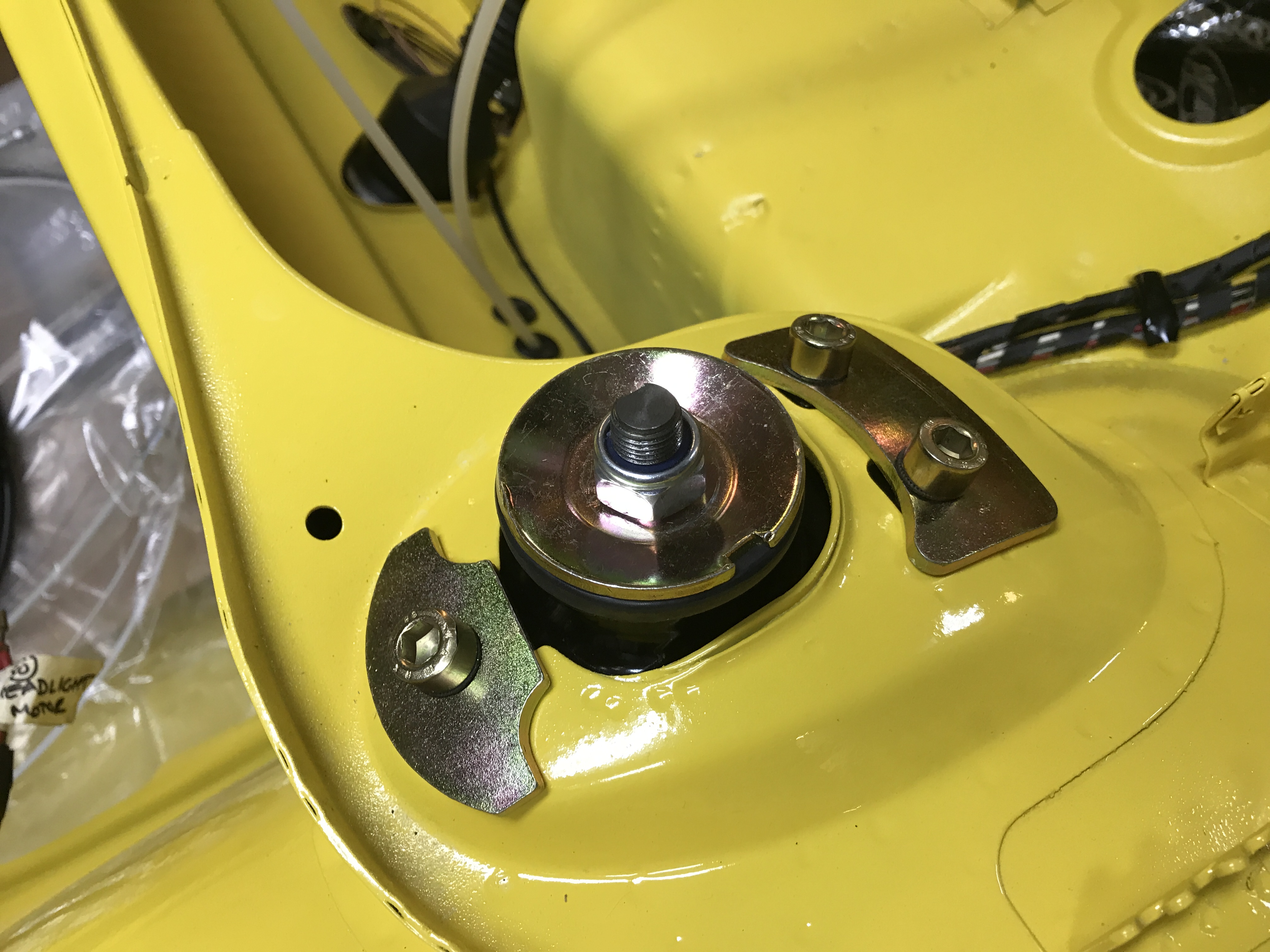

Shiny top hardware!
bkrantz
post Jan 3 2021, 08:02 PM
Post #1904
Posts: 8,763
Joined: 3-August 19
From: SW Colorado
Member No.: 23,343
All done.

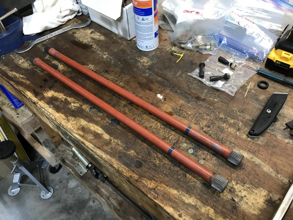

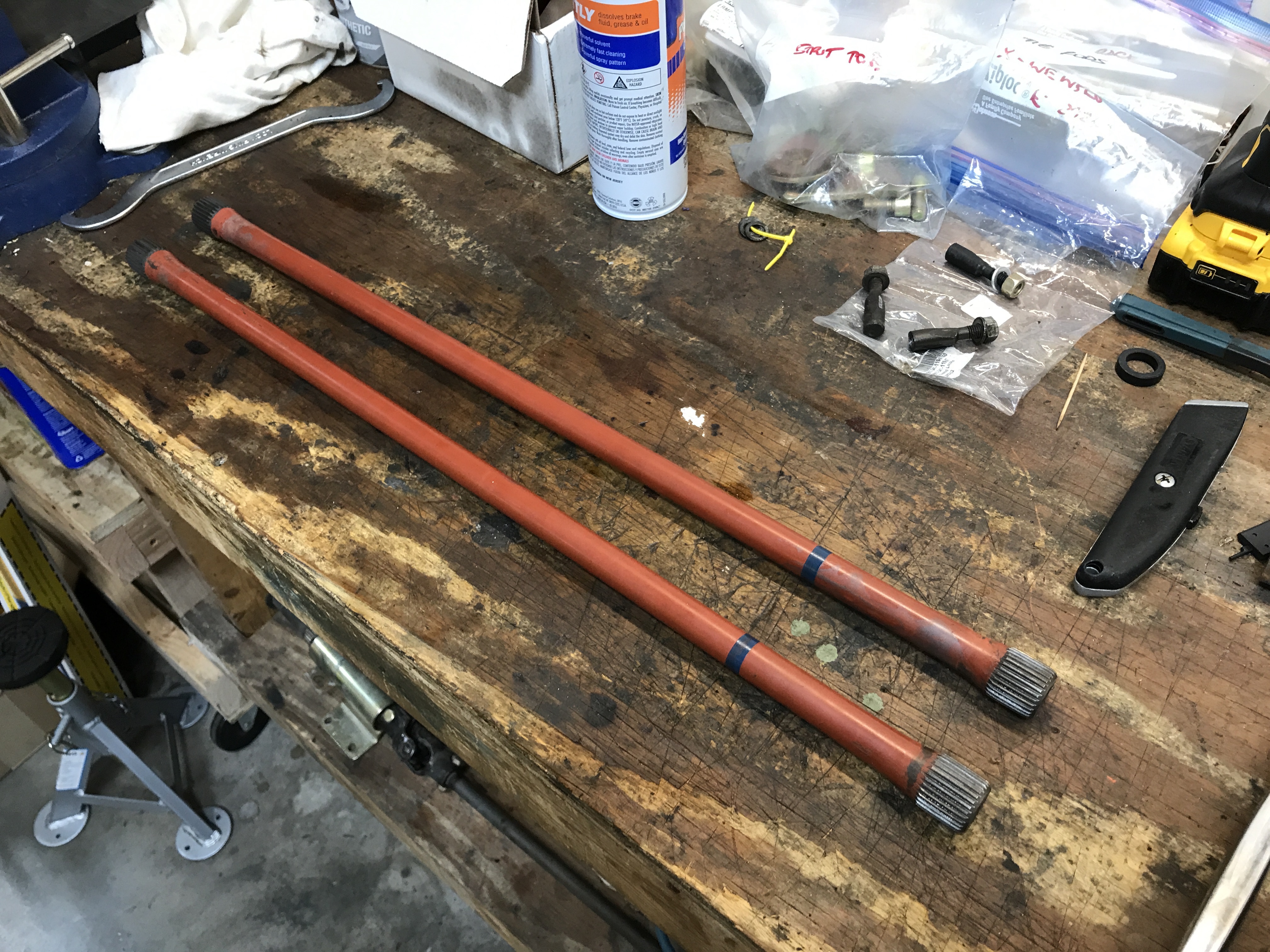

Last suspension component on the left, torsion bar. Here are the original stock bars.
bkrantz
post Jan 4 2021, 08:13 PM
Post #1911
Posts: 8,763
Joined: 3-August 19
From: SW Colorado
Member No.: 23,343

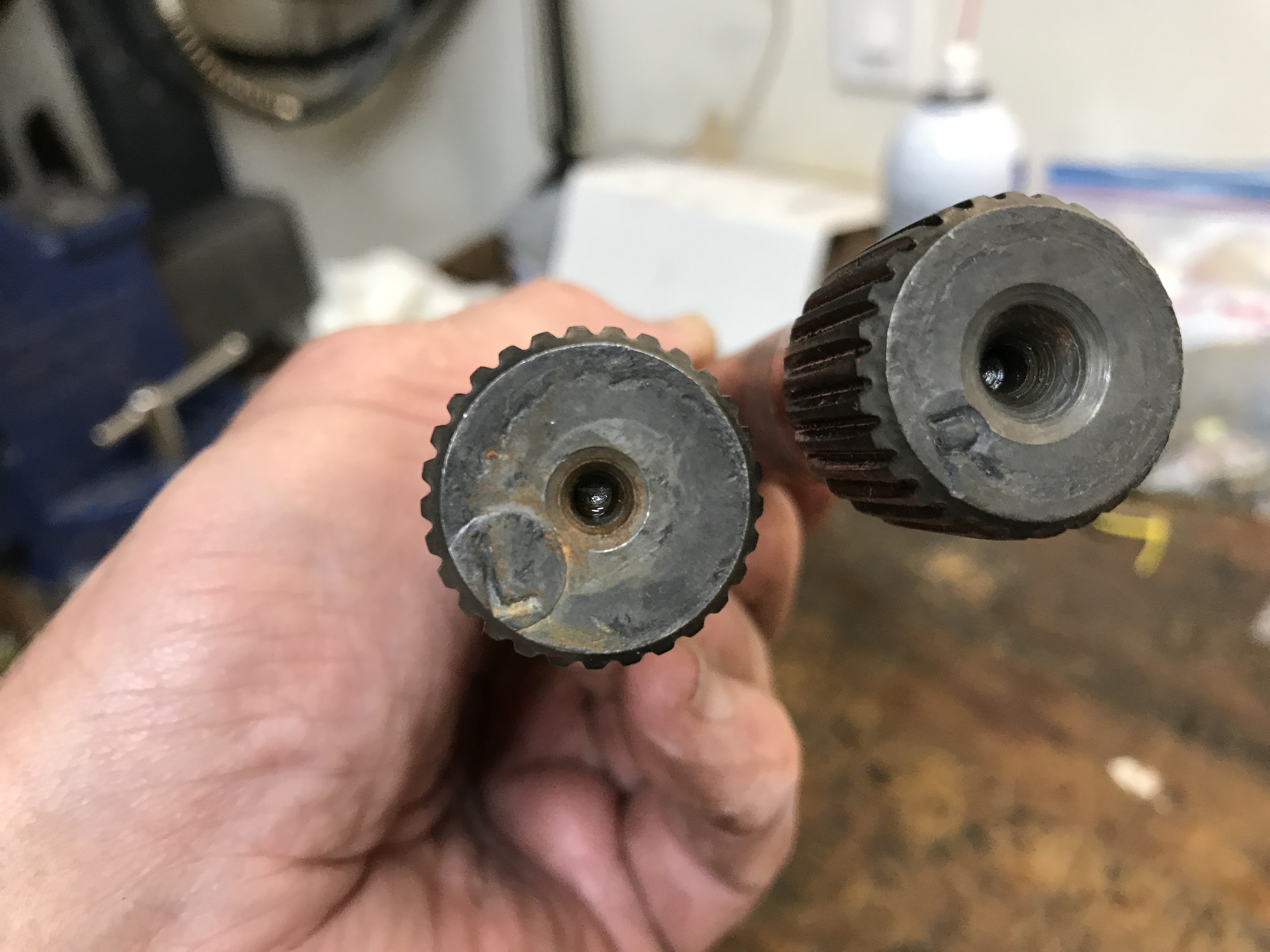

Must remember L and R!

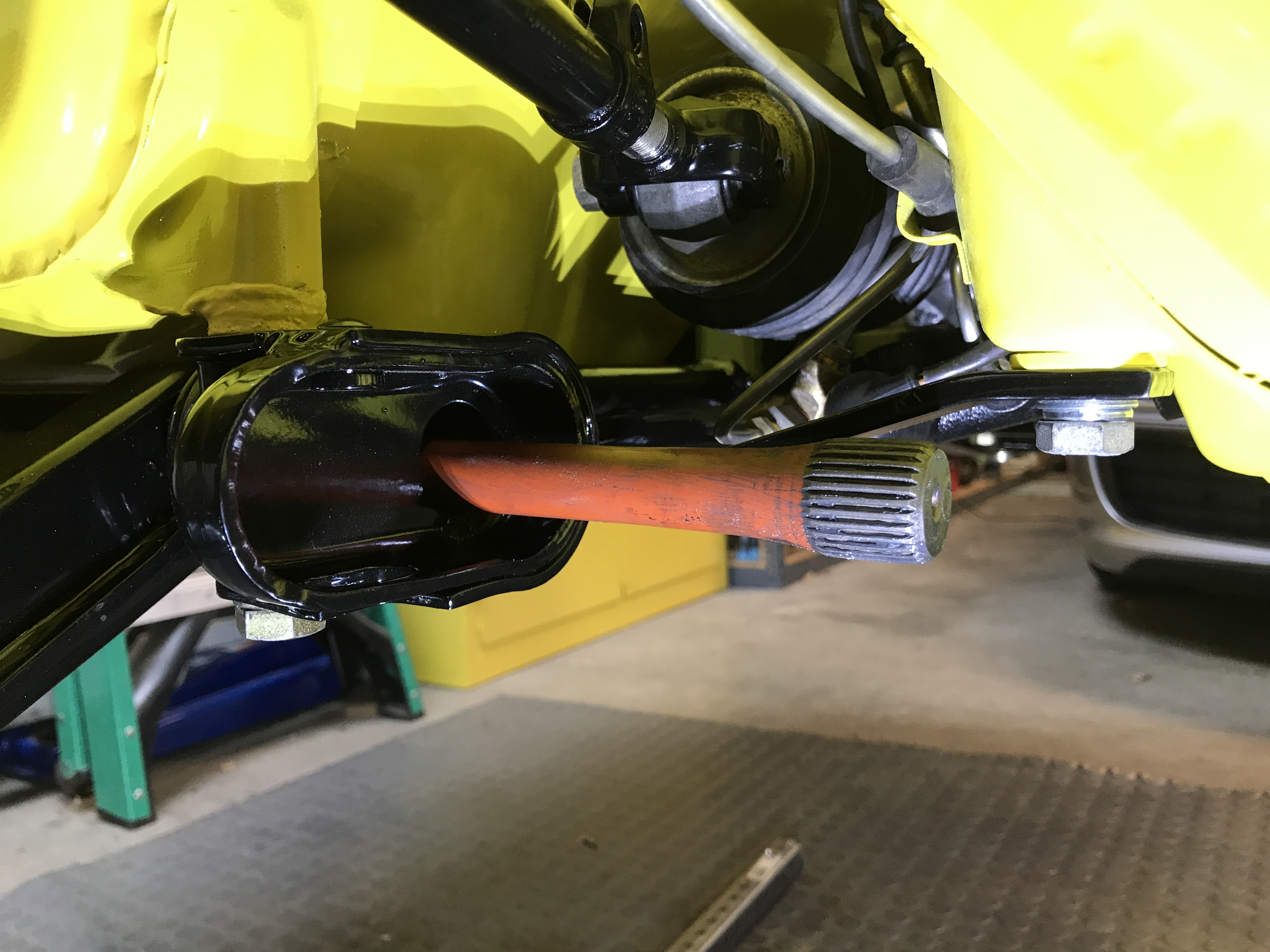

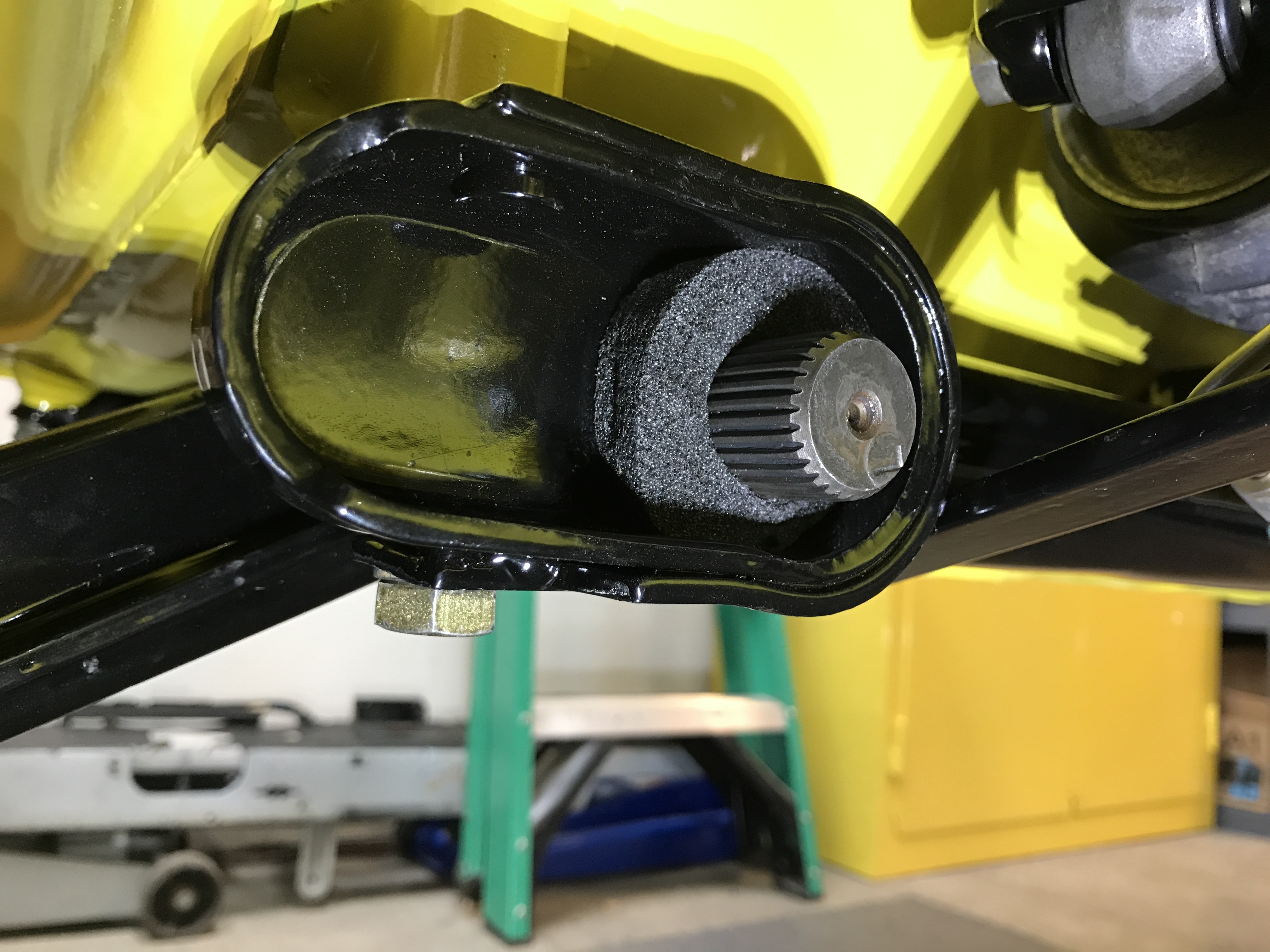

Left bar going into the A-arm. It took a bit of tapping to get it seated in the front socket.

New gasket.

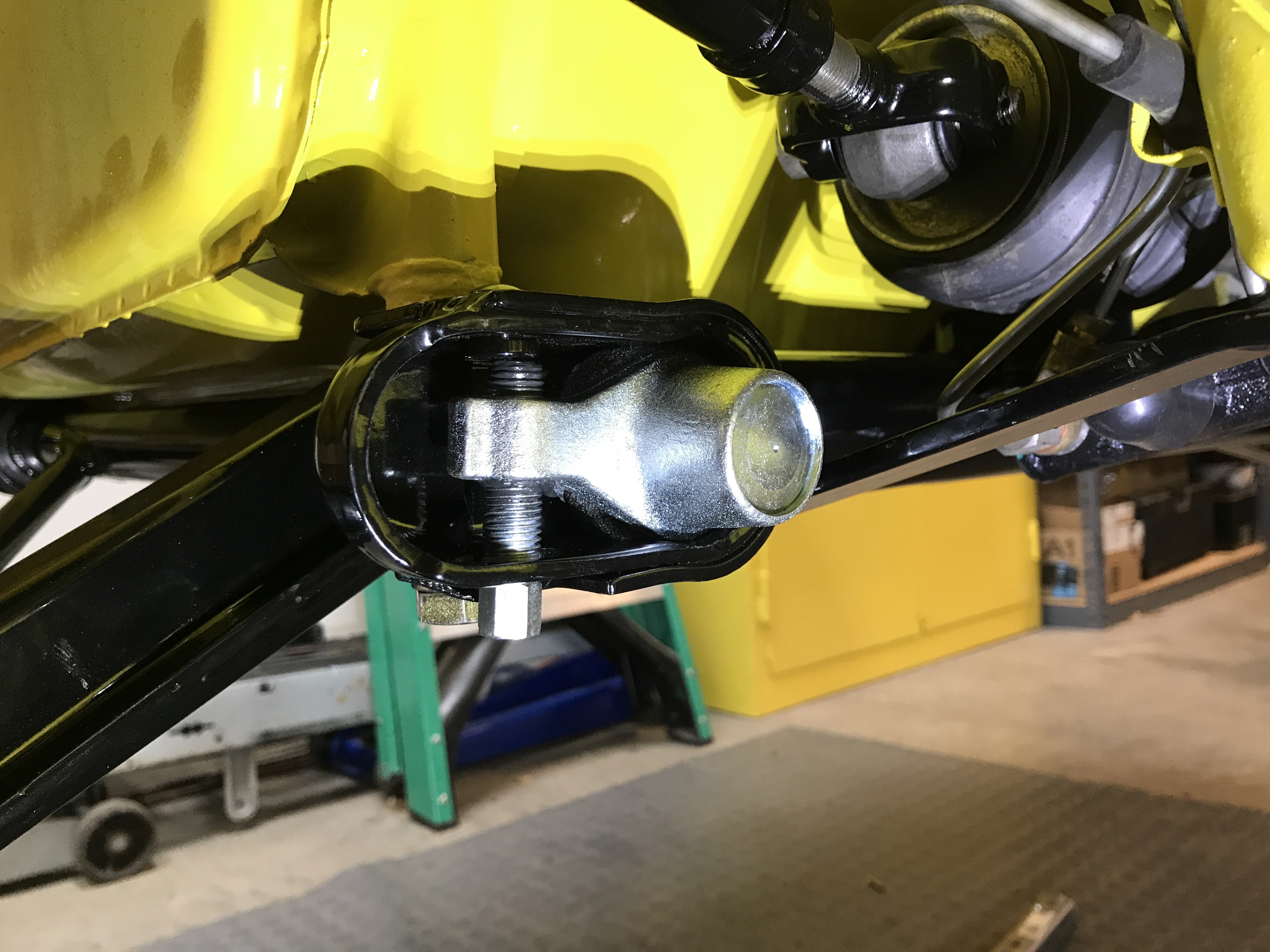

Member No.: 23,343

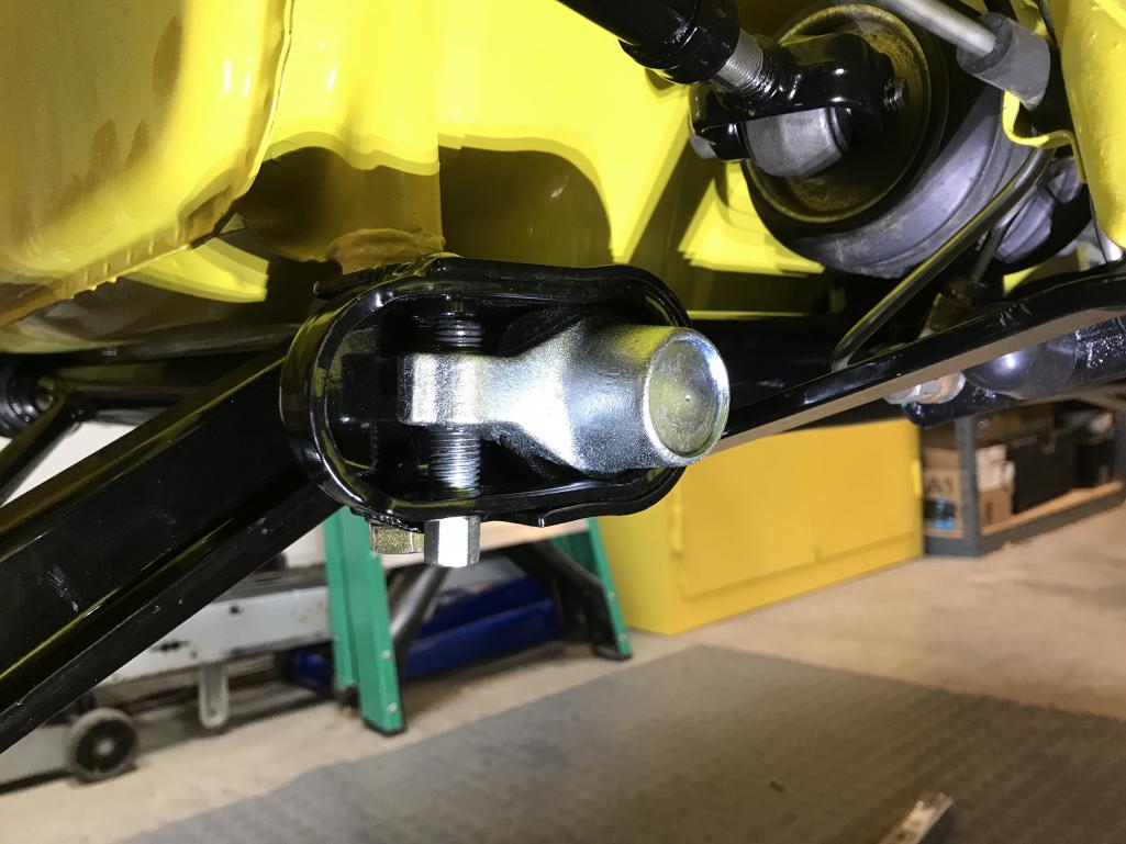

And the adjuster cap. More shiny!

QUOTE(bkrantz @ Jan 4 2021, 07:15 PM) *
Will you document the indexing of the torsion bar when the time comes? I need to do that on the Willow car.
bkrantz
post Jan 5 2021, 07:40 PM
Post #1916
Posts: 8,763
Joined: 3-August 19
From: SW Colorado
Member No.: 23,343
QUOTE(Kansas 914 @ Jan 5 2021, 08:46 AM) *
I only had 2 or maybe 3 positions (notches) to choose from when putting on the caps, and did what the manual describes: put the cap on with the lever arm as close to the top of the recess as possible. For now, I cranked the adjuster screws just slightly past making contact.

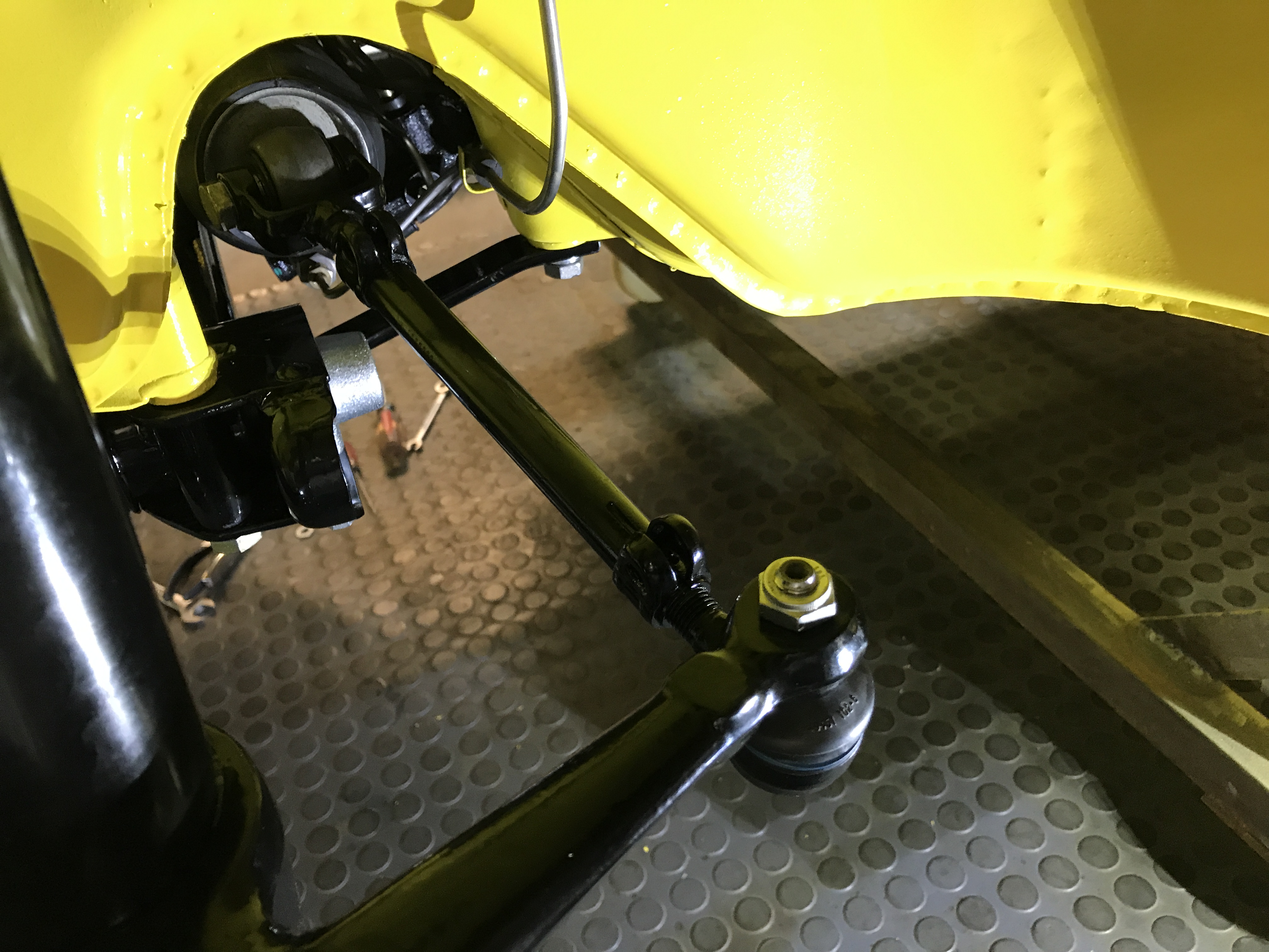

Member No.: 23,343

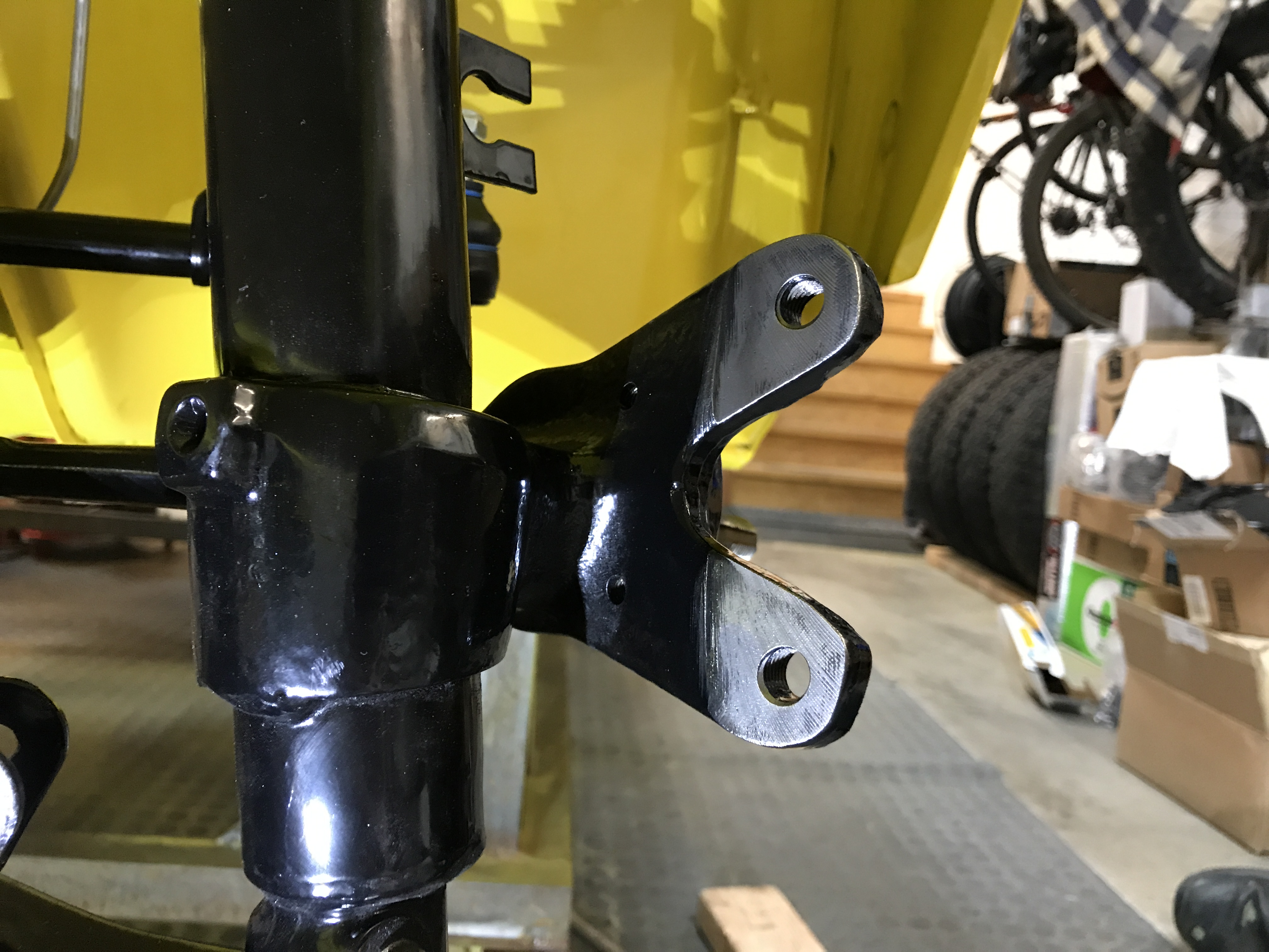

Going back to photos I took during disassembly, the tie rods had about 1/4 inch of threads exposed on both the yoke end and the ball joint end, so I set the new rods to be the same, and installed the ball joint stud into the steering arm. Still waiting on new bolts for the tie rod collars.

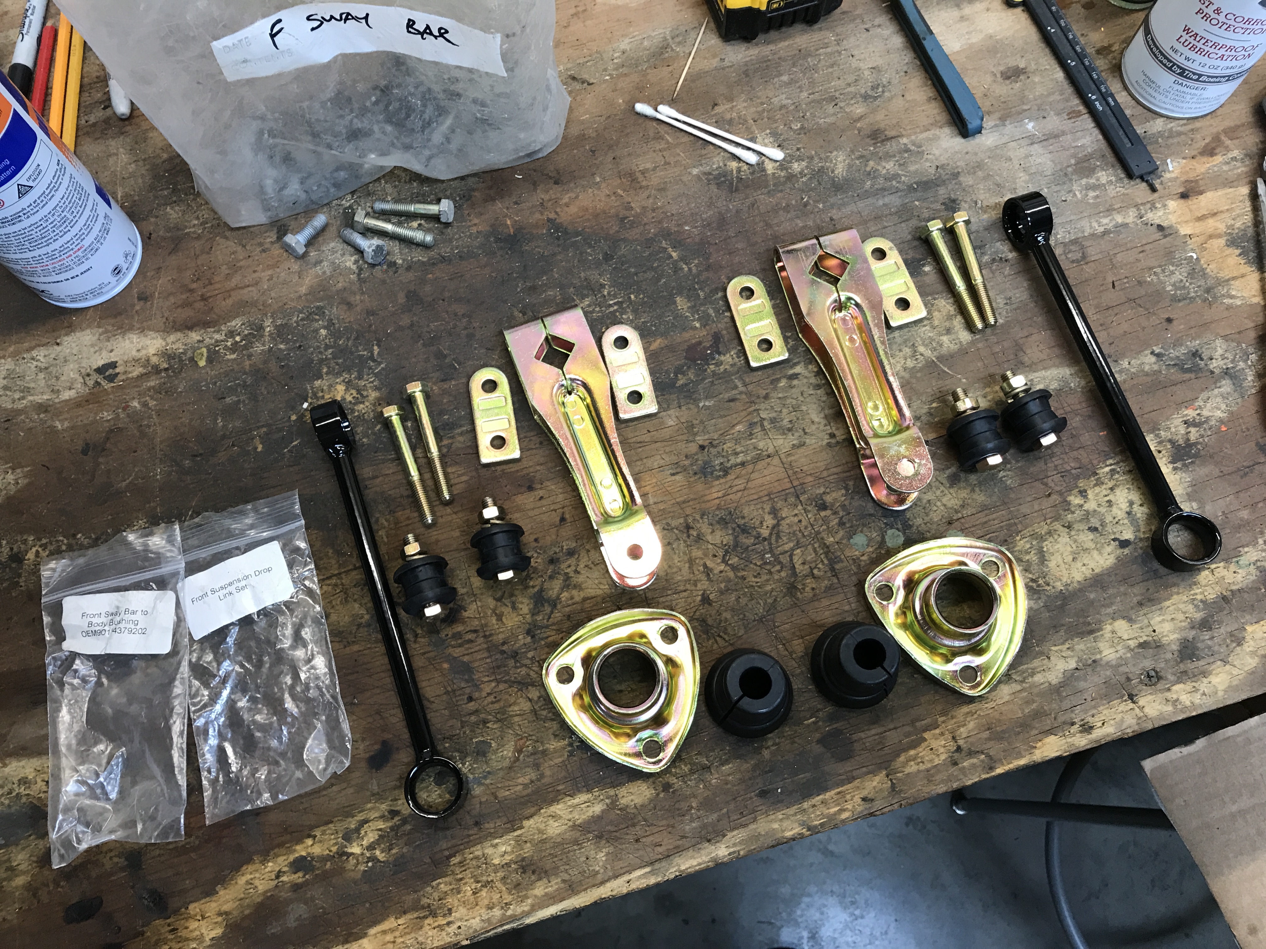

Hardware for the front sway bar, with new bushings from 914 Rubber.

Sway bar inserted with new bushings.
