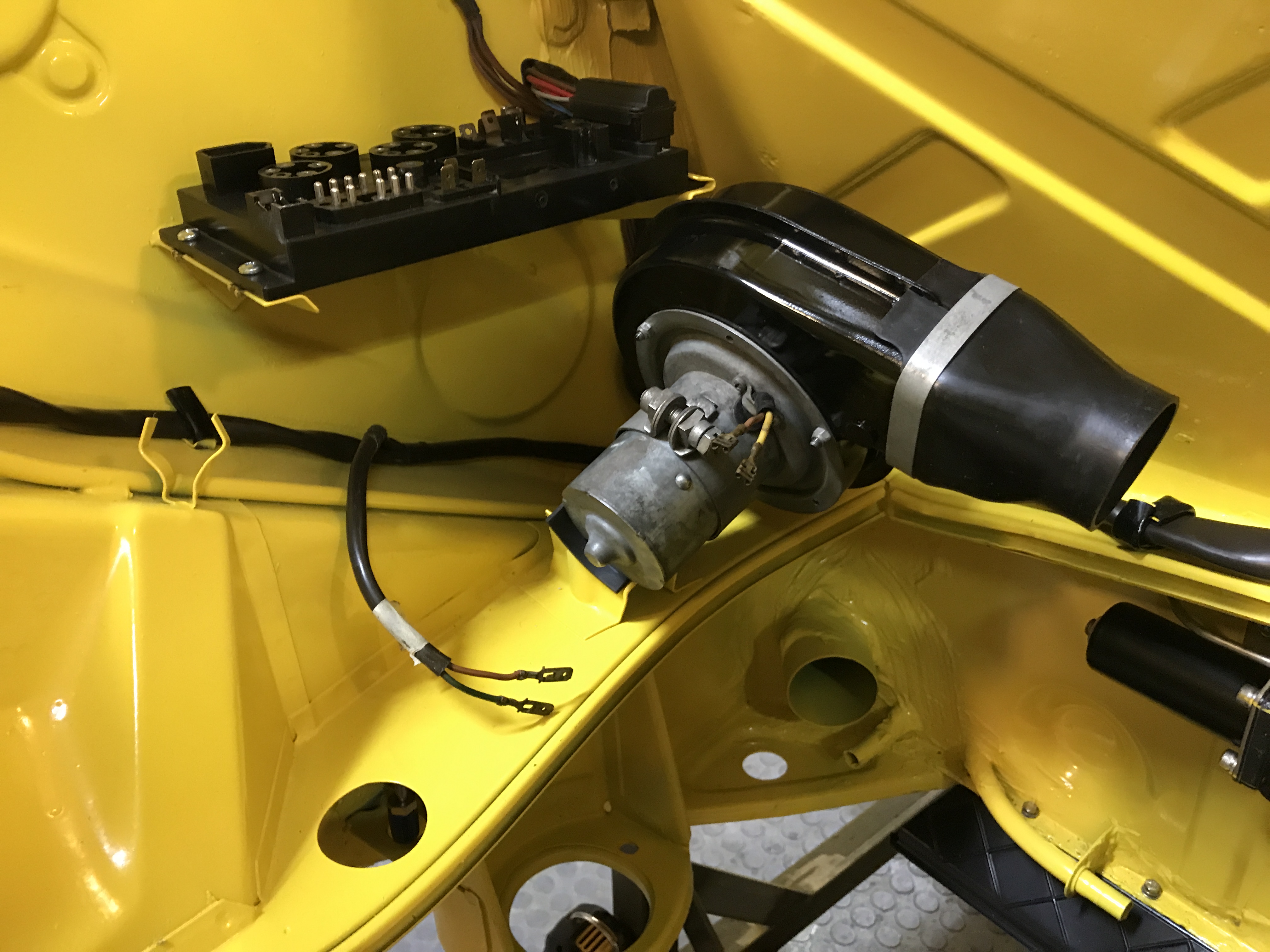

And mount it in the engine compartment.

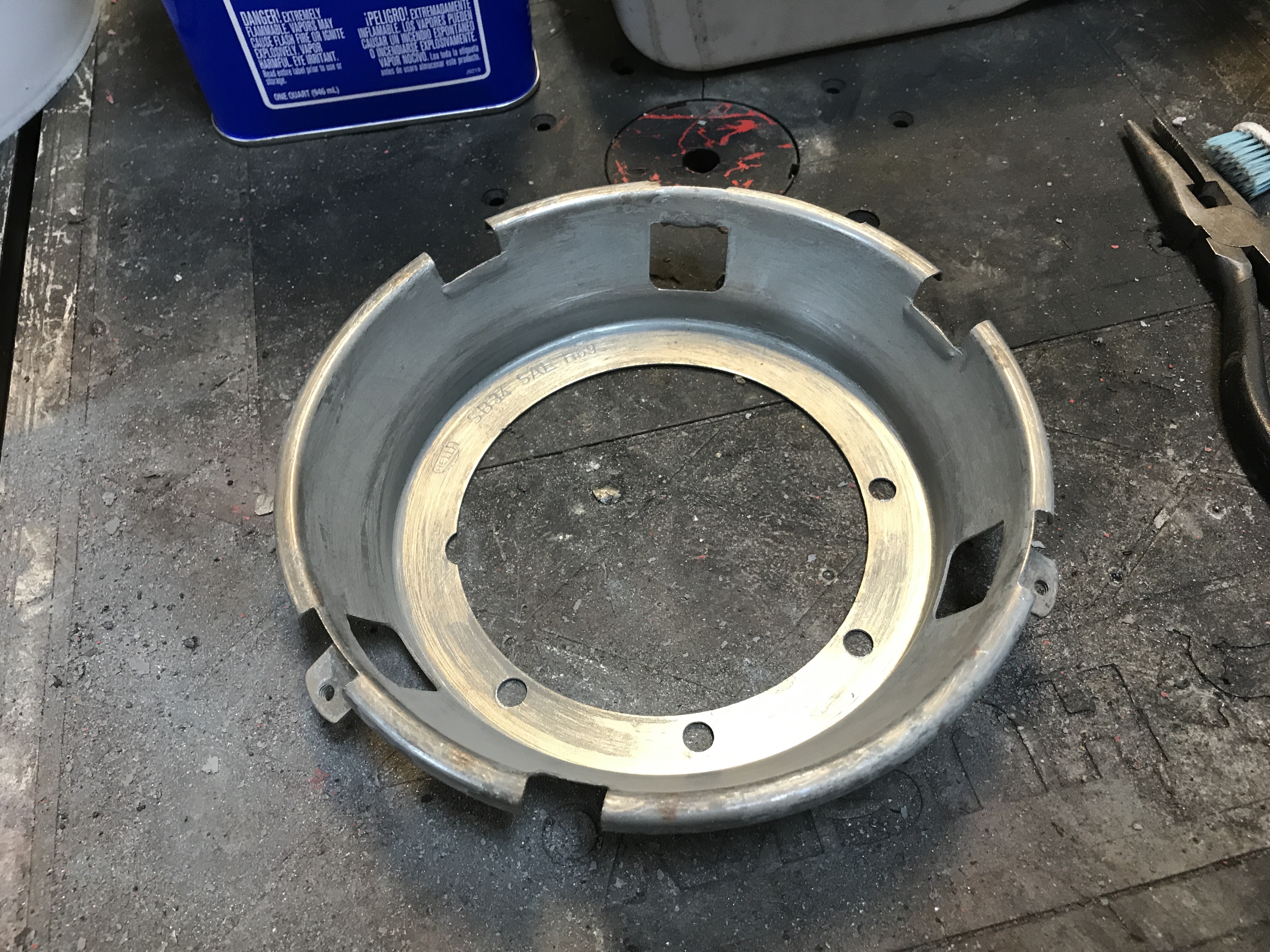

Still working on multiple components at the same time. Making progress with stripping overspray, undercoating, and (unfortunately) the original paint from the headlight brackets.

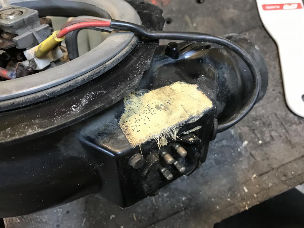

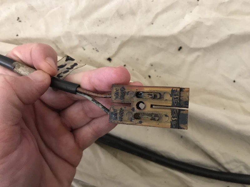

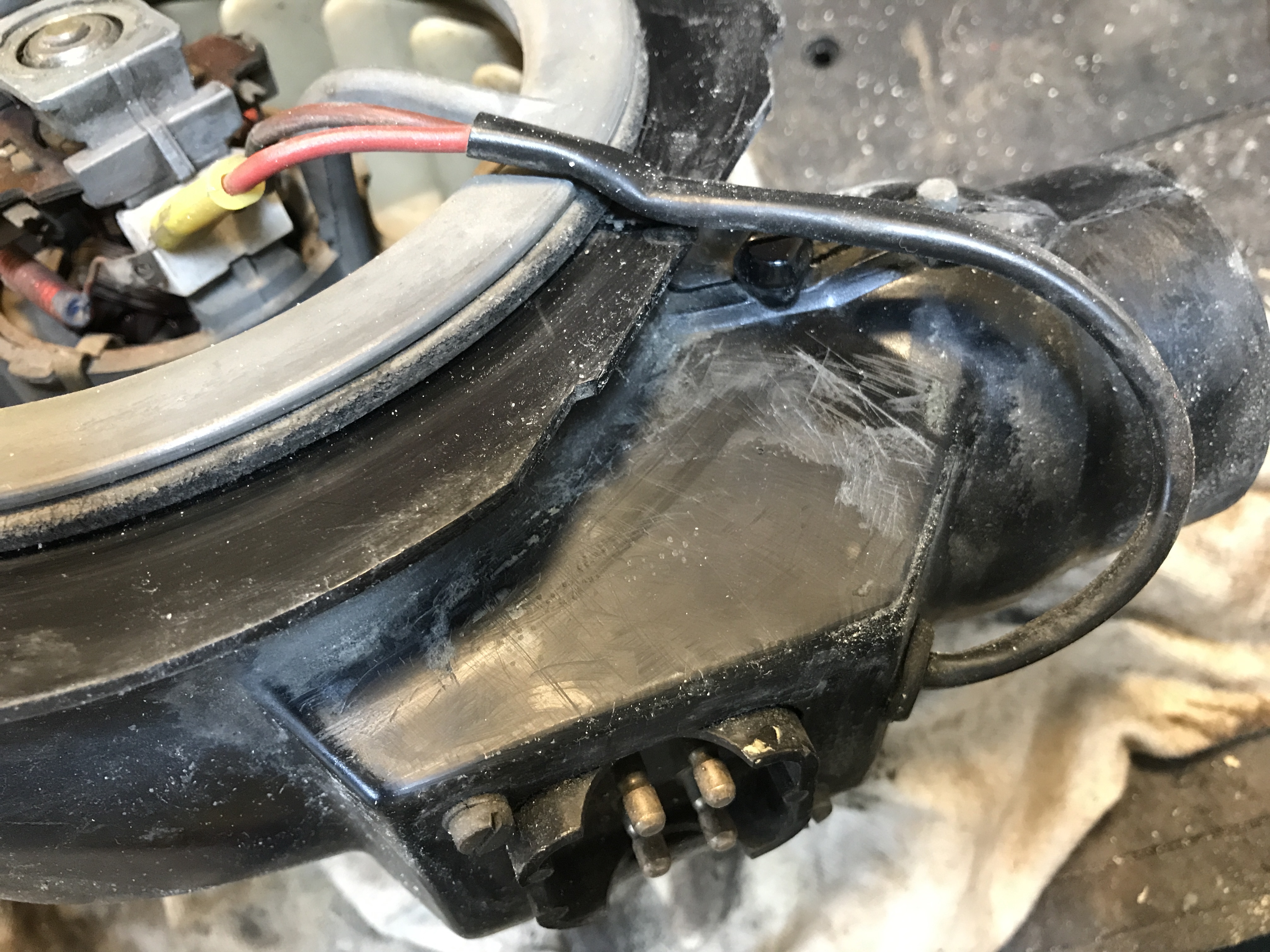

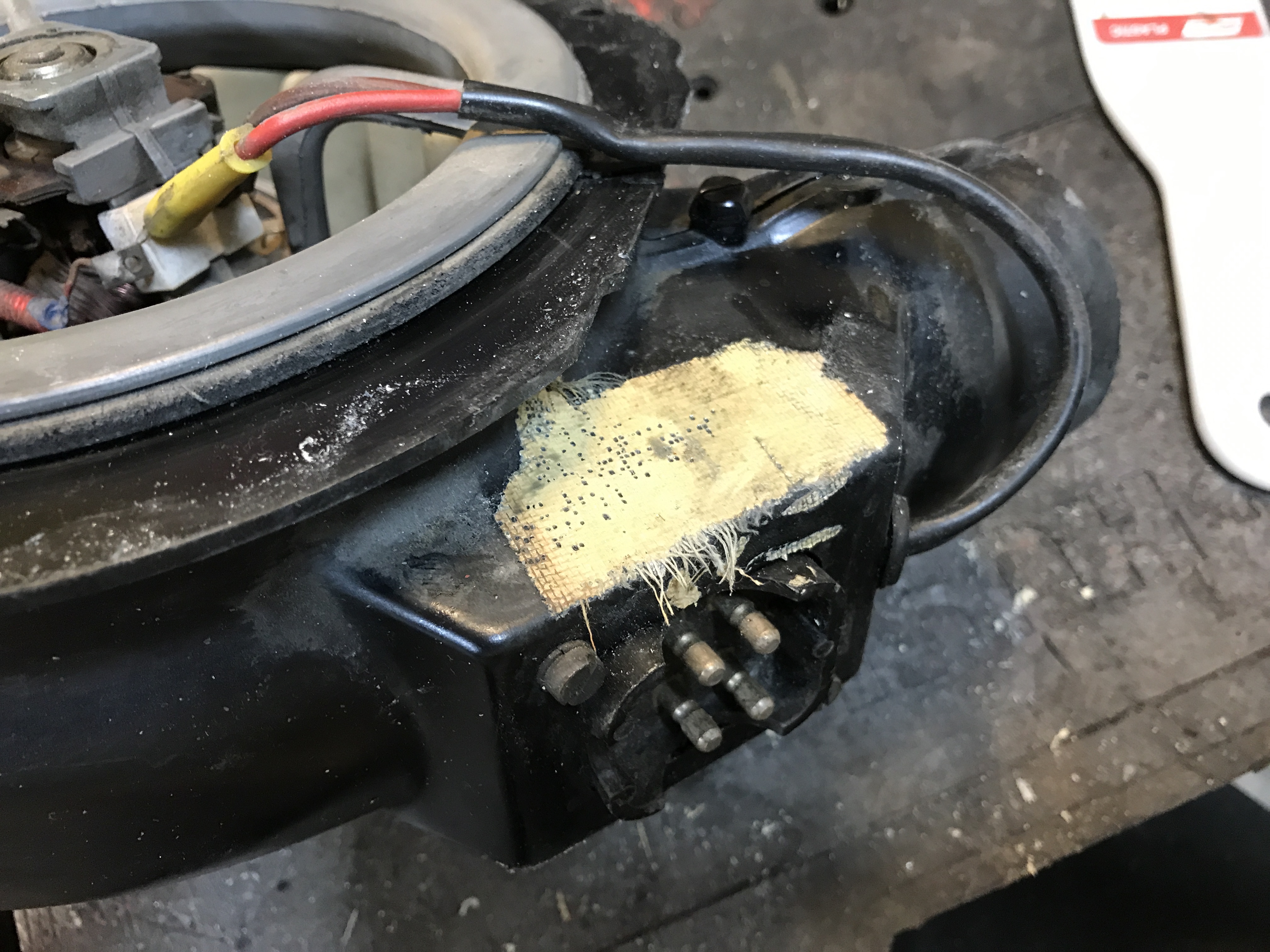

And progress on cleaning the blower section of the fresh air box. I got most of the undercoating off, and then tackled the fossilized duct tape that the PO used to keep the power plug in place.
bkrantz
post Jan 12 2021, 08:14 PM
Post #1985
Posts: 8,824
Joined: 3-August 19
From: SW Colorado
Member No.: 23,343

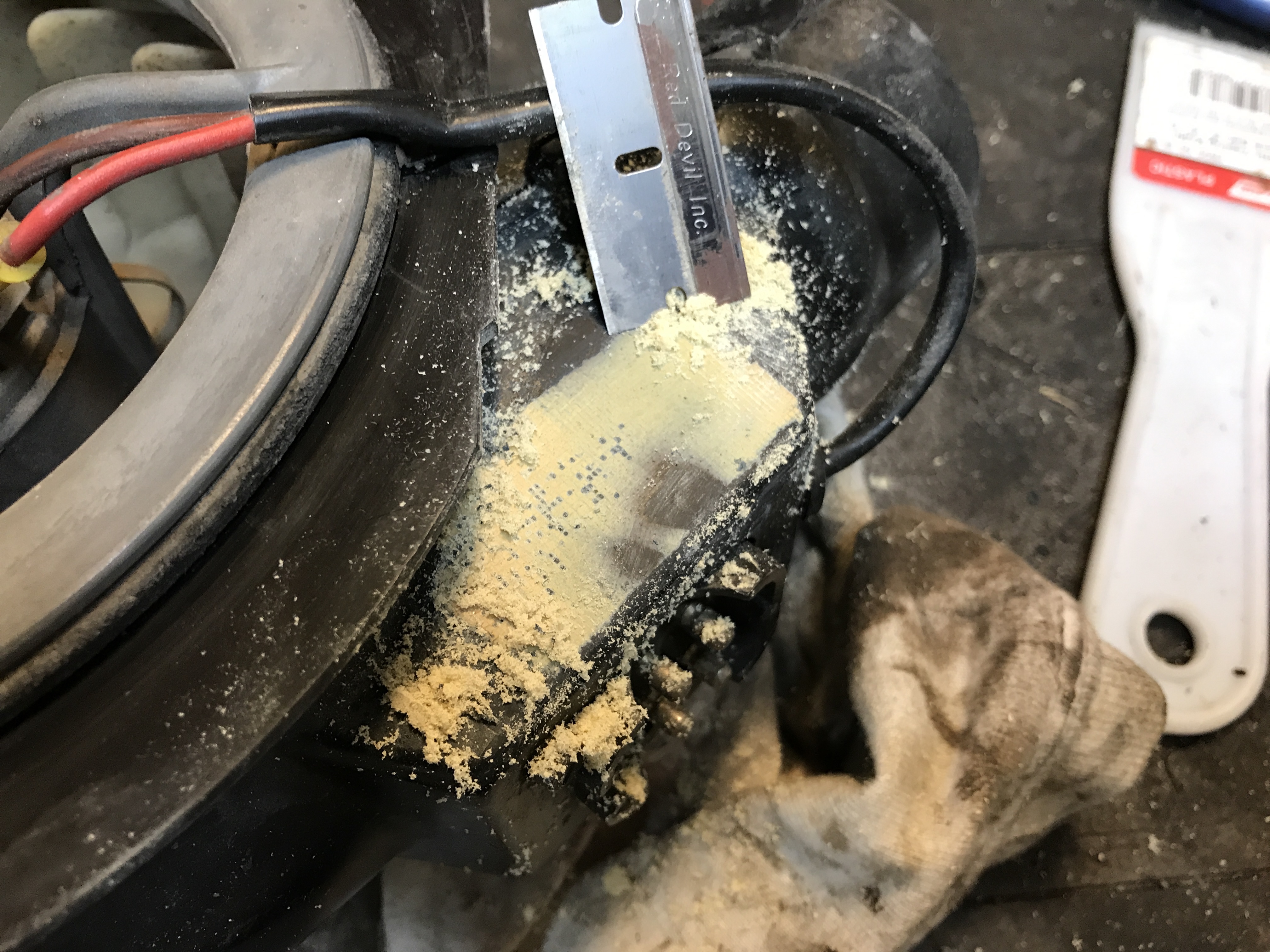

This was not coming off with any solvent, at least that would not erode the plastic housing, so I tried shaving, using several new razor blades and lots of patience.
bkrantz
Post #1986
Posts: 8,824
Joined: 3-August 19
From: SW Colorado
Member No.: 23,343

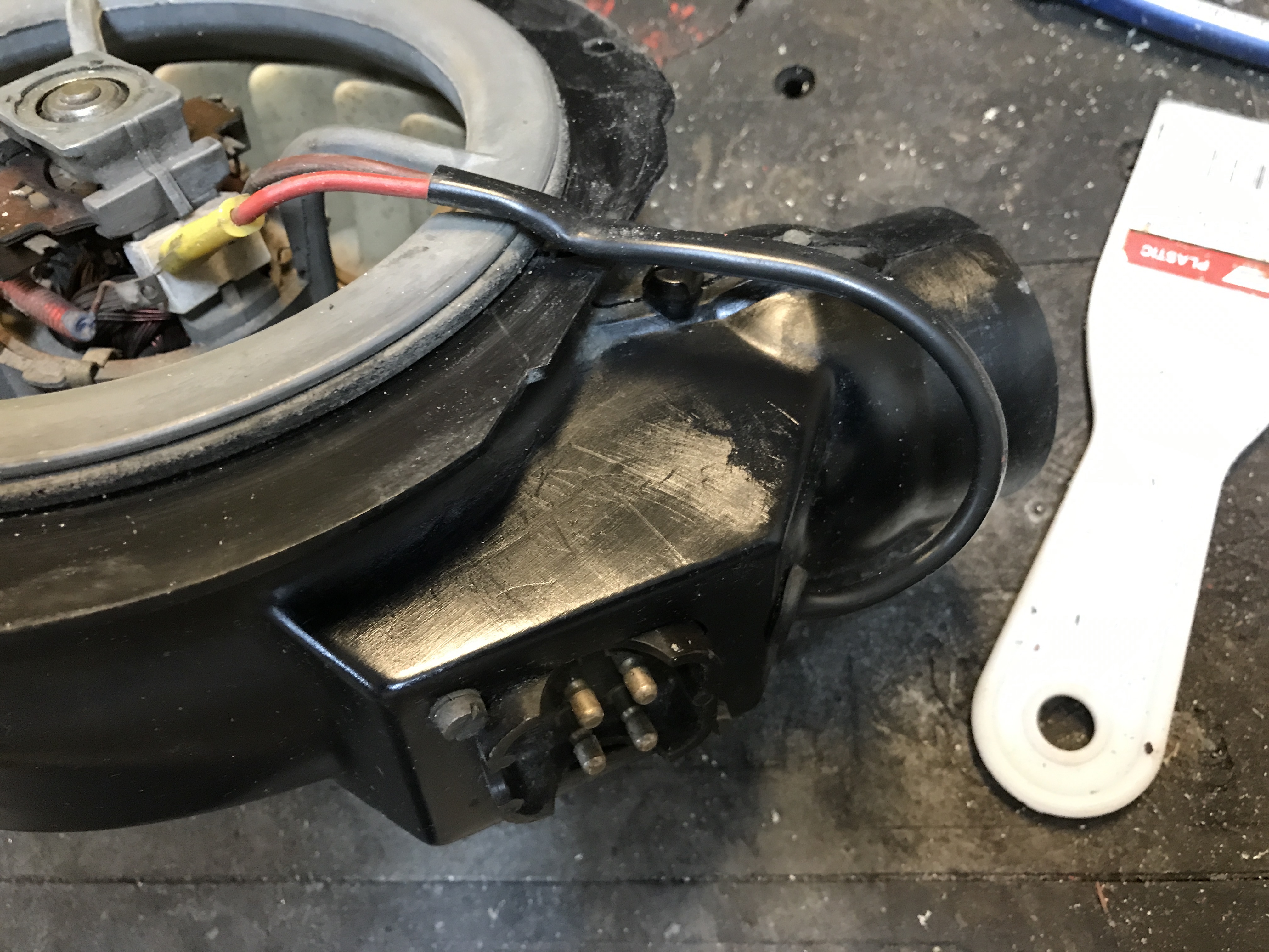

Mostly successful, with just a little damage.
bkrantz
post Jan 12 2021, 08:15 PM
Post #1987
Posts: 8,824
Joined: 3-August 19
From: SW Colorado
Member No.: 23,343
After wiping with GoofOff, which reacts slightly with the plastic, the shine cam back.

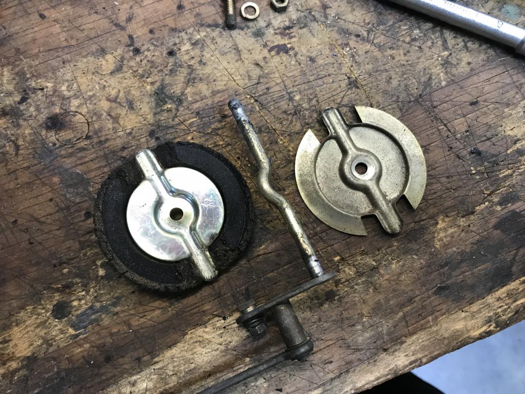

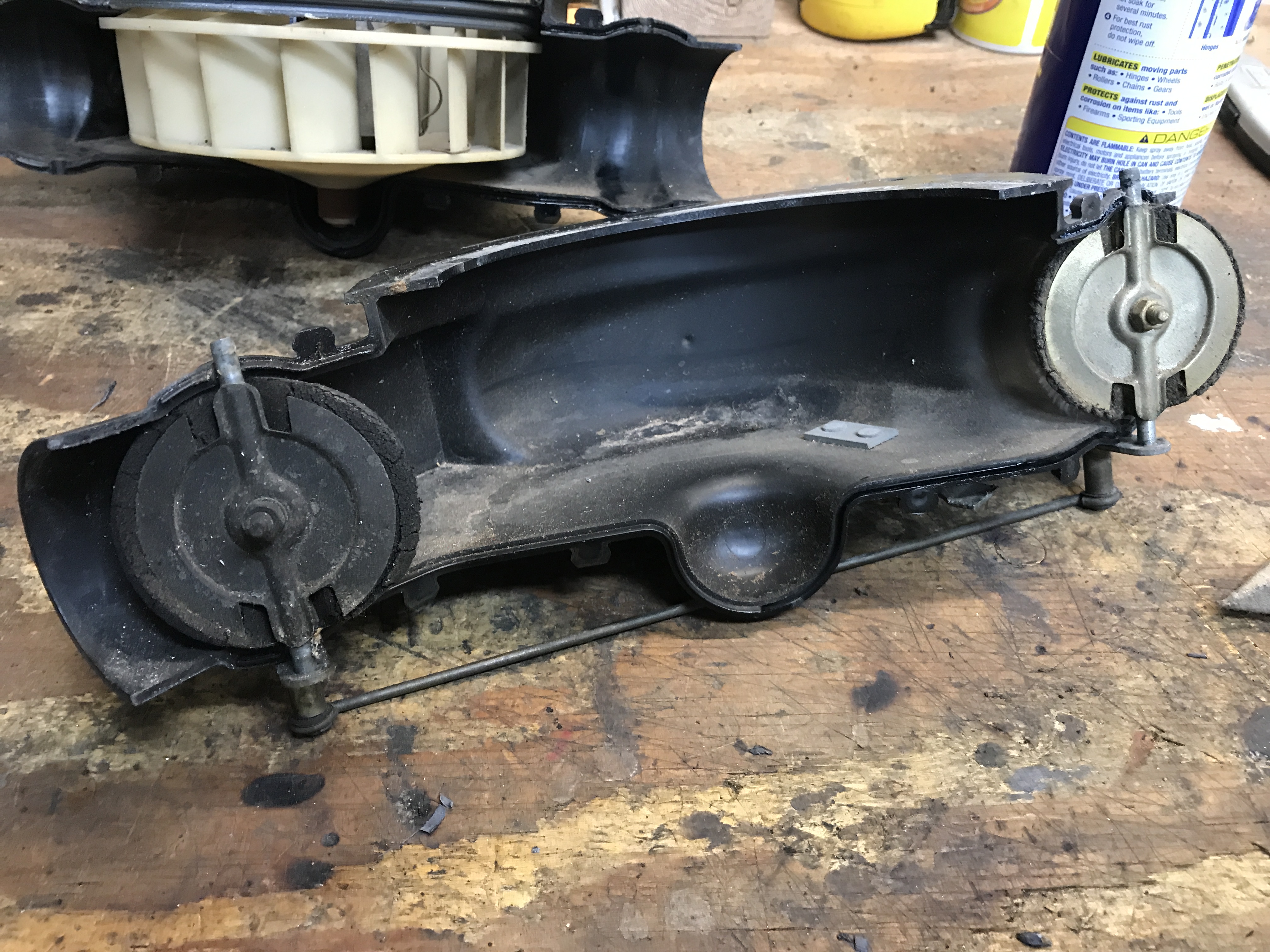

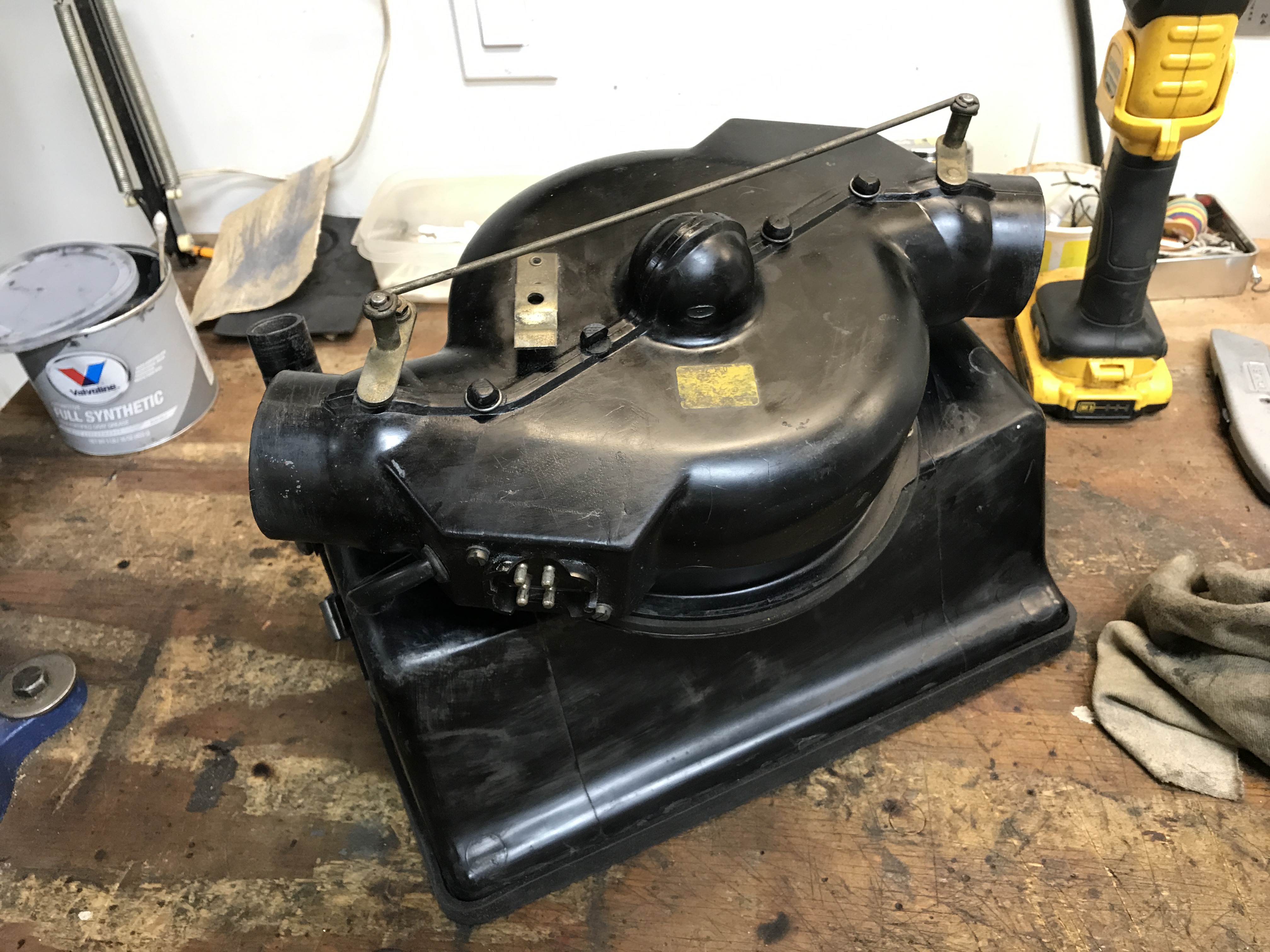

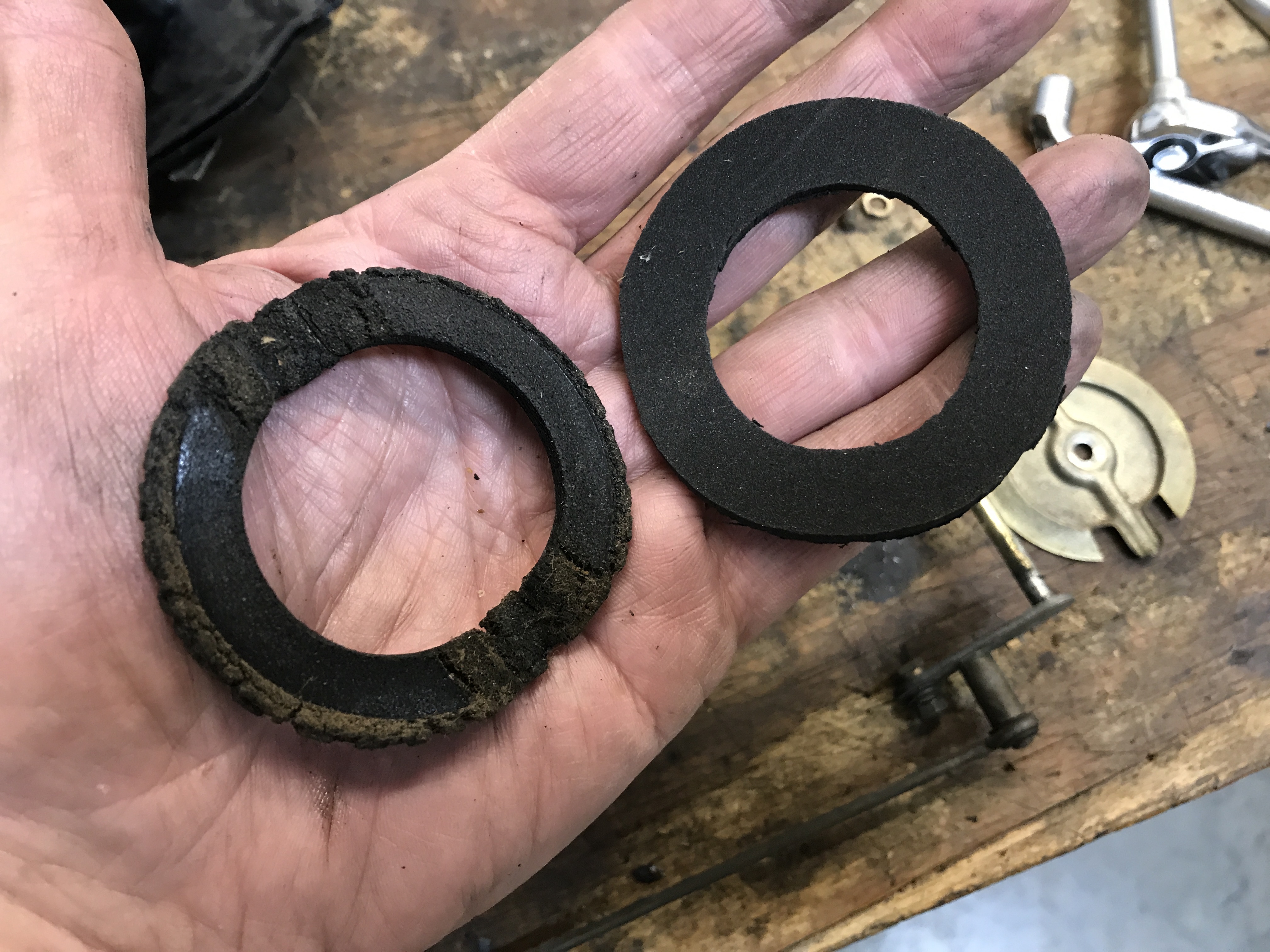

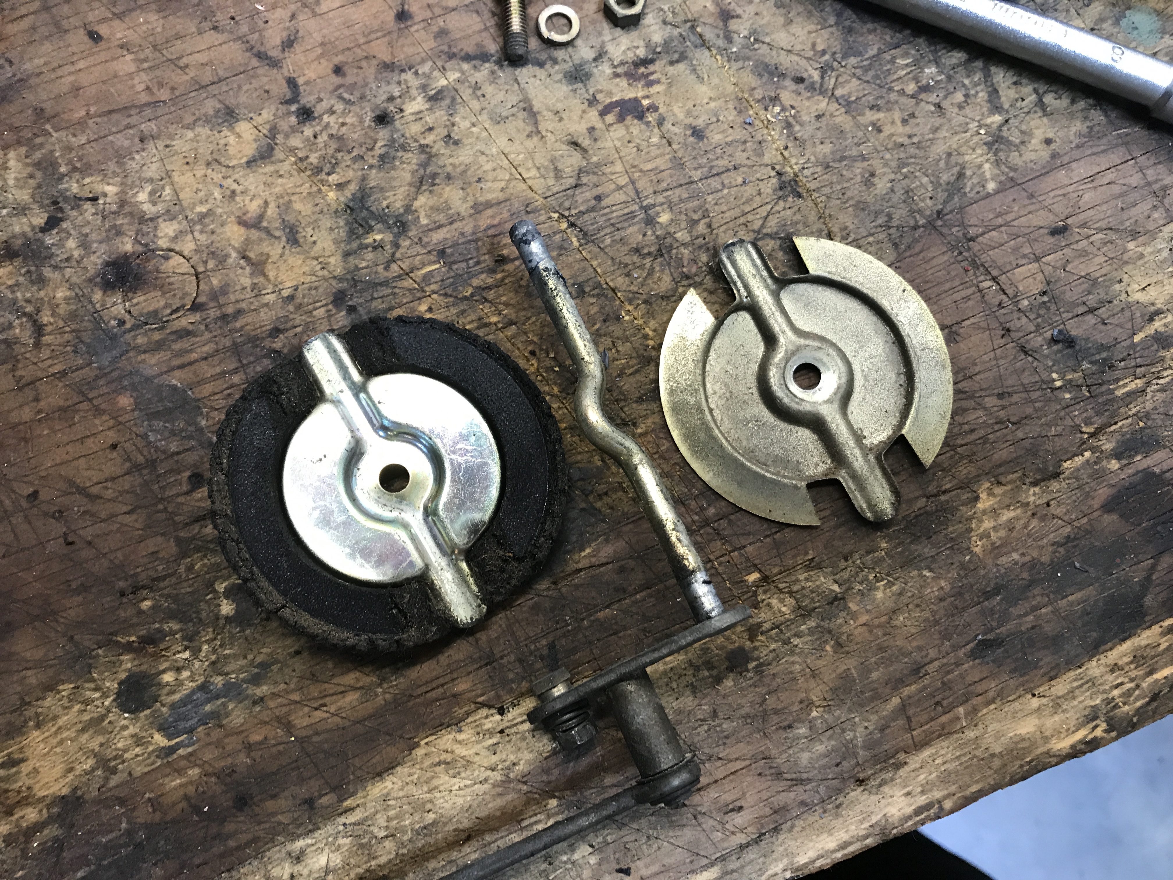

Next, I opened up the blower section so I could replace the baffle rings. Somehow the PO got undercoating in here (see baffle on the left).
bkrantz
post Jan 12 2021, 08:18 PM
Post #1989
Posts: 8,824
Joined: 3-August 19
From: SW Colorado
Member No.: 23,343
The baffles are easy to take apart.
bkrantz
post Jan 12 2021, 08:19 PM
Post #1990
Posts: 8,824
Joined: 3-August 19
From: SW Colorado
Member No.: 23,343
New rings, part of the 914 Rubber kit.

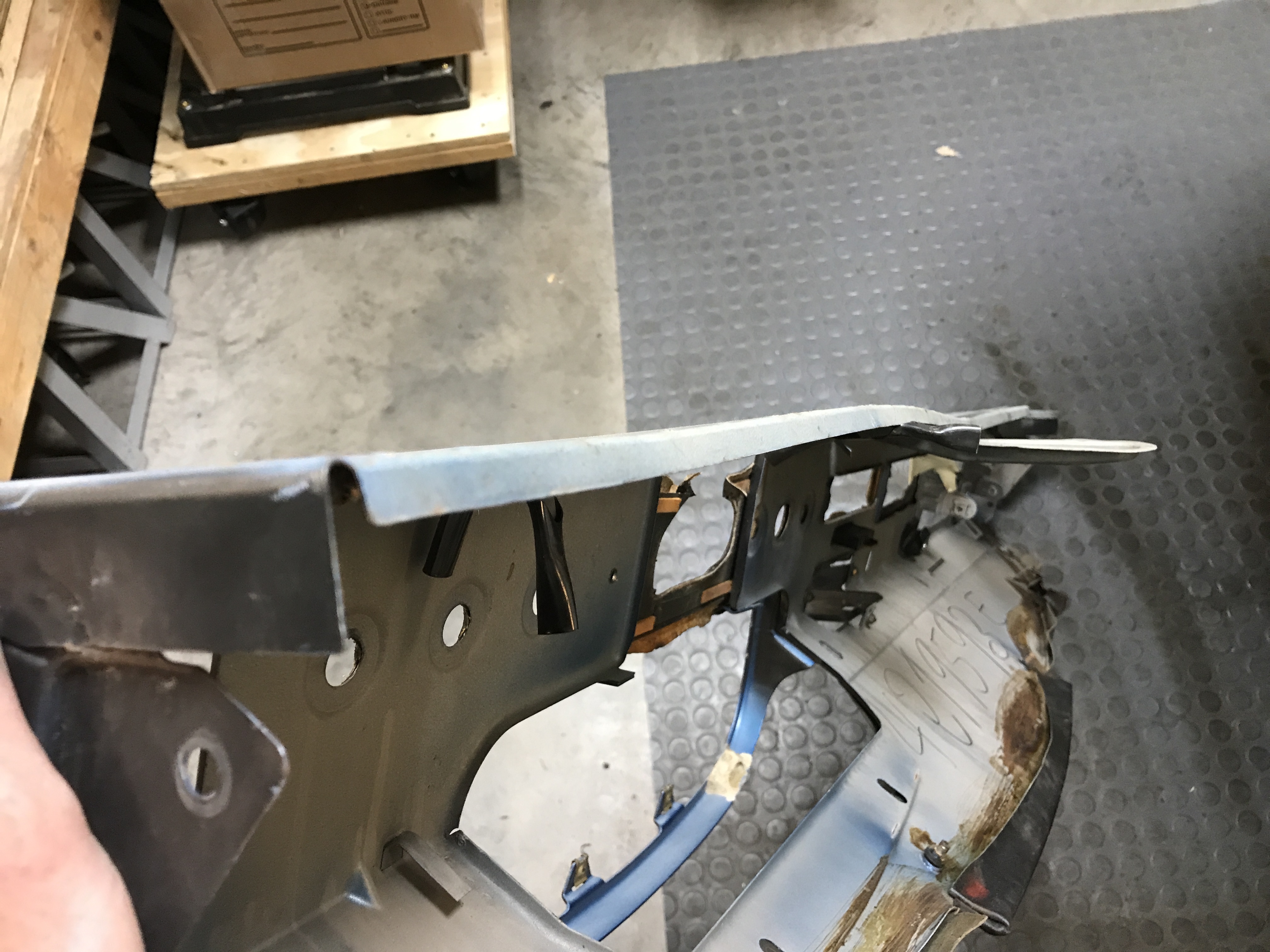

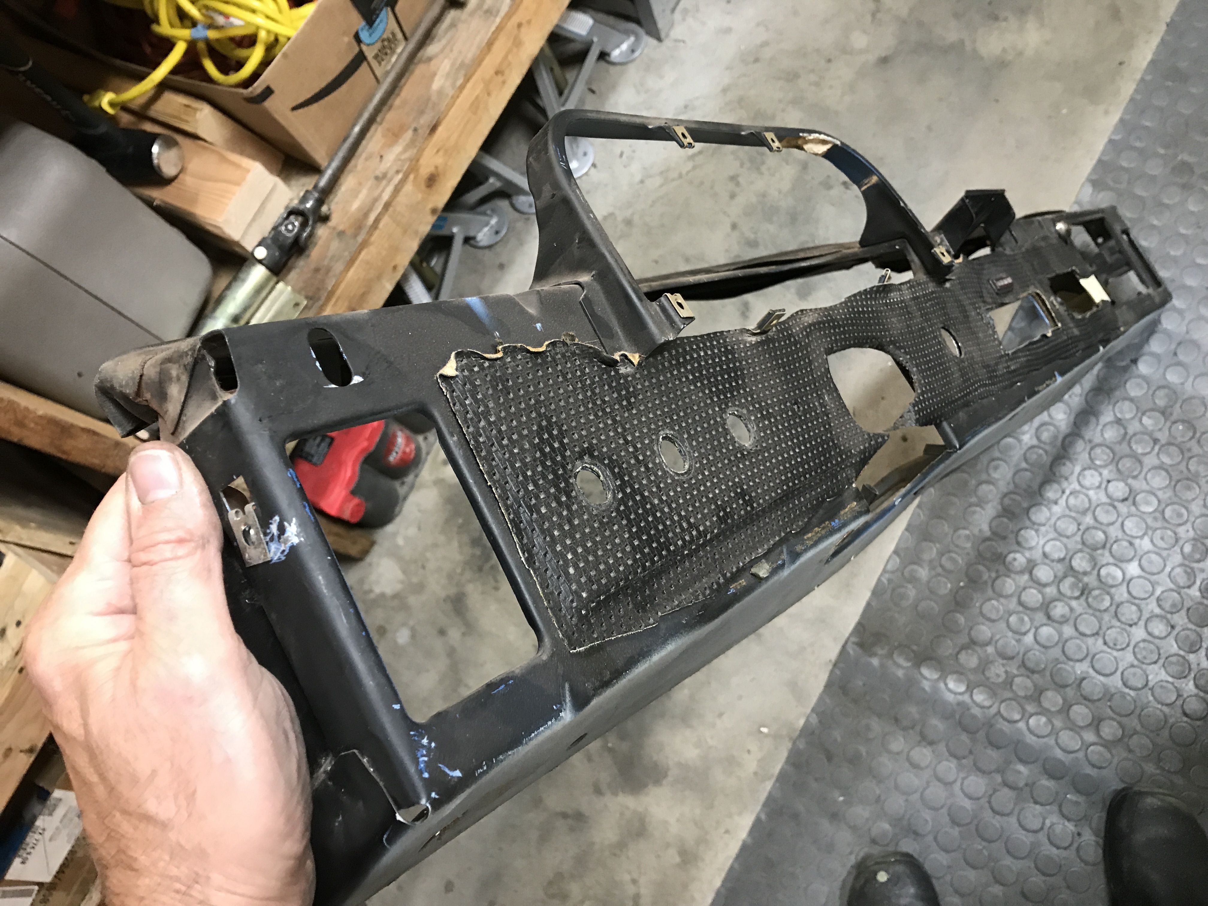

Since I was getting ahead of myself with the fresh air box, since I need to install the dash control levers and cables first, and that means I need to install the dash. And before doing that, I need to replace the top padded vinyl and the face vinyl. Note what seems to be a buckle along the lower edge.
bkrantz
post Jan 12 2021, 08:24 PM
Post #1992
Posts: 8,824
Joined: 3-August 19
From: SW Colorado
Member No.: 23,343
Another view of the lower dash edge. This should be straight, right?

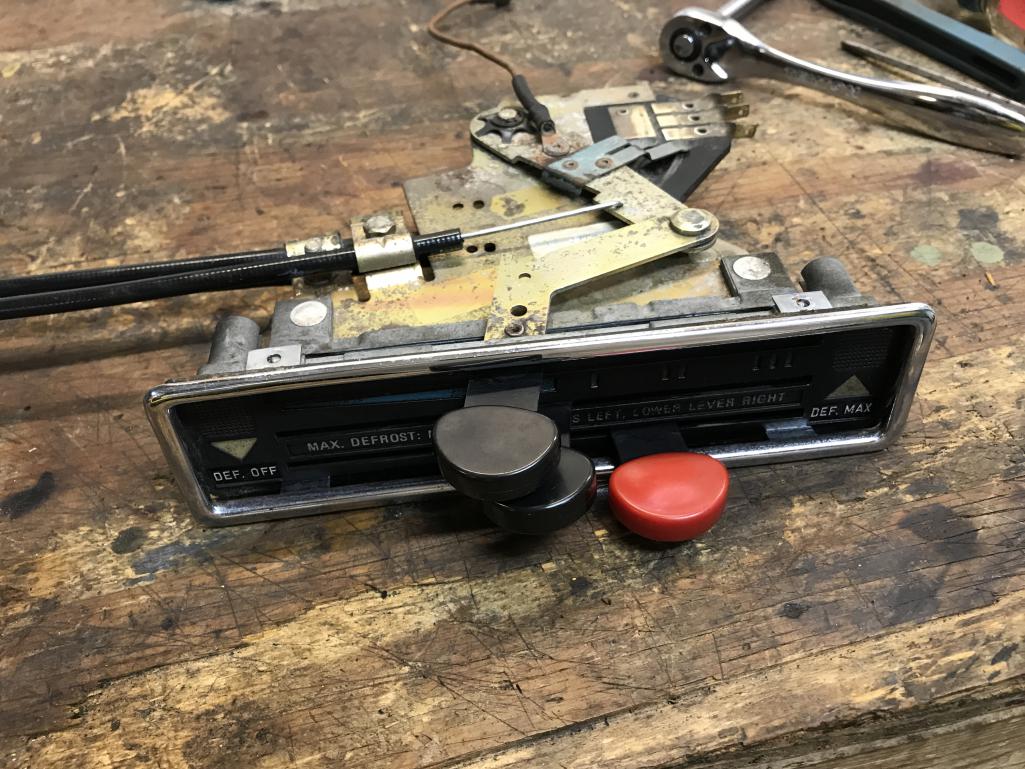

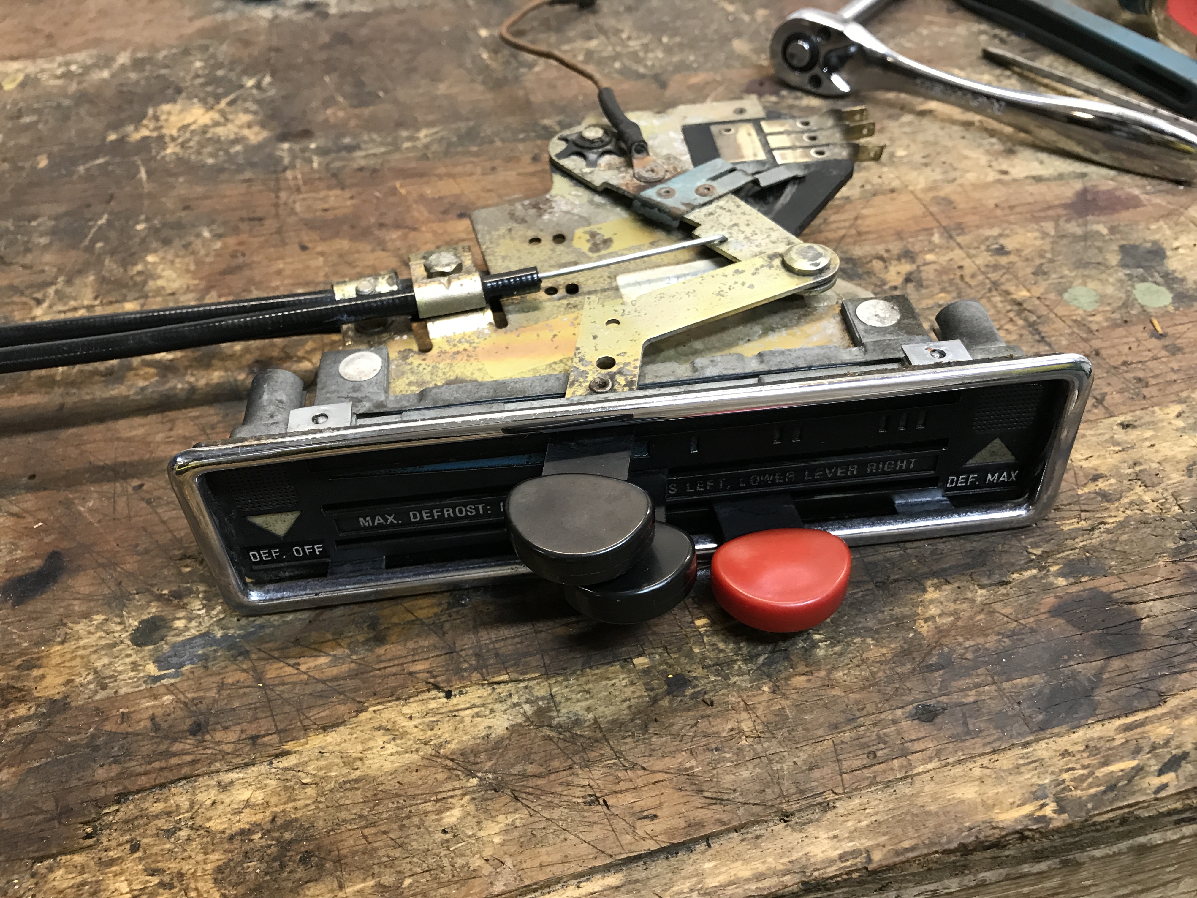

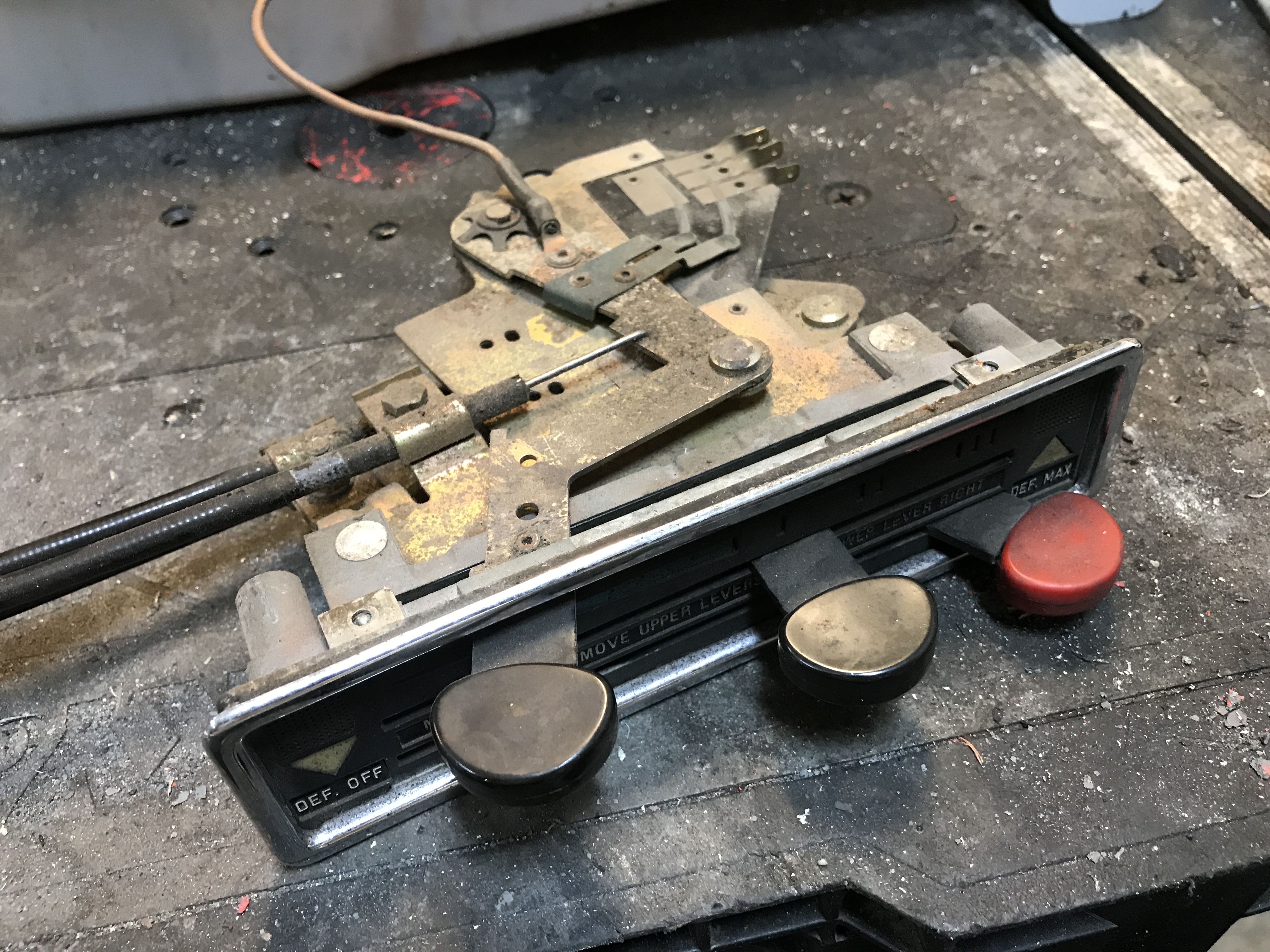

I also cleaned up the control levers. Quite a bit of dirt and some corrosion.
bkrantz
post Jan 13 2021, 08:25 PM
Post #1998
Posts: 8,824
Joined: 3-August 19
From: SW Colorado
Member No.: 23,343
Cleaned up.
bkrantz
post Jan 13 2021, 08:26 PM
Post #1999
Posts: 8,824
Joined: 3-August 19
From: SW Colorado

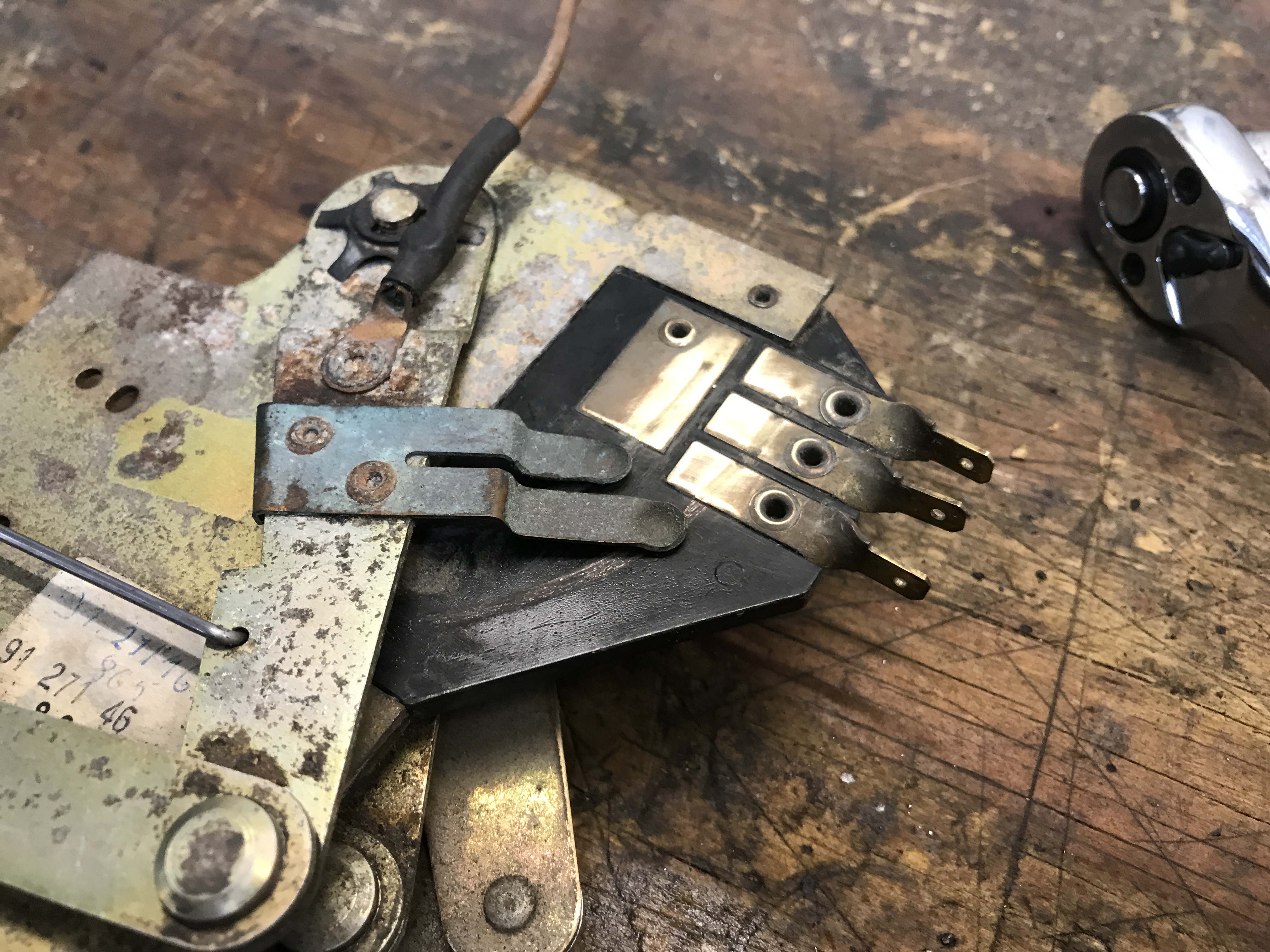

Member No.: 23,343
I used some fine emery paper on the contacts.
raynekat
post Jan 13 2021, 09:57 PM
Post #2000
Posts: 2,172
Joined: 30-December 14
From: Coeur d'Alene, Idaho
Member No.: 18,263
Check this fresh air fan switch for continuity on all 3 speeds before installing. I didn't so didn't have all the fan speeds once installed and had to remove the switch again with all the associated cuss words to sort the issue.
