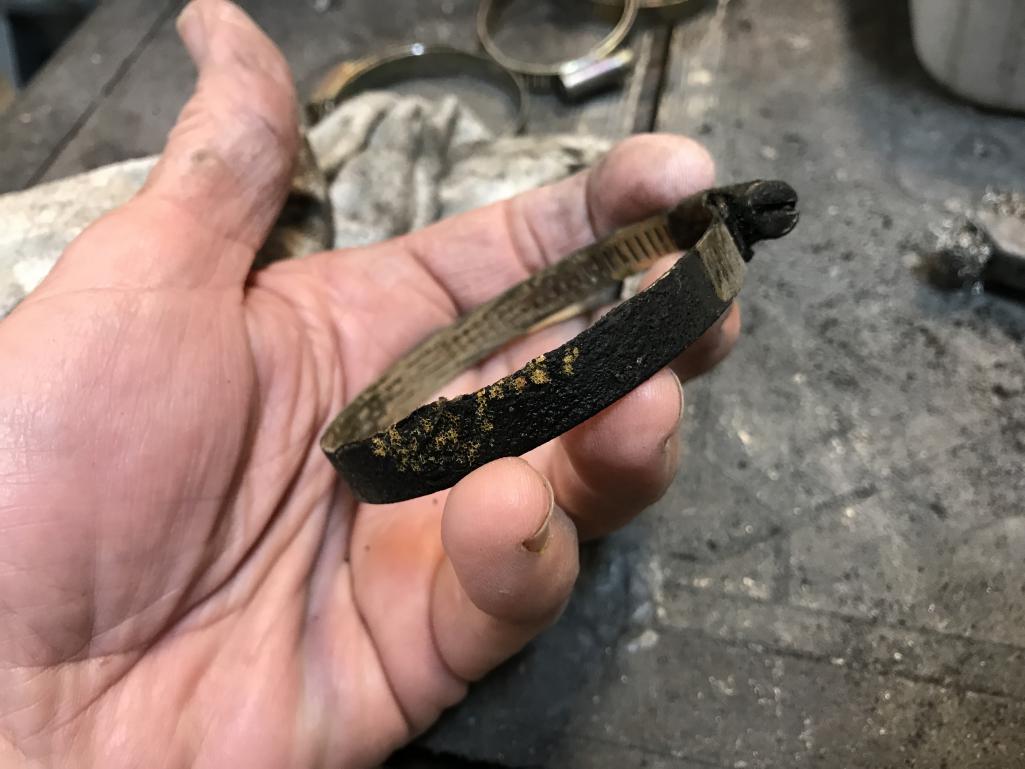

More cleaning paint and undercoating from headlight buckets and ventilation pieces, still a tedious and unhappy job. That includes stripping undercoating from everything, like small hardware and hose clamps. Have I mentioned lately how much I hate undercoating? (IMG:style_emoticons/default/headbang.gif)

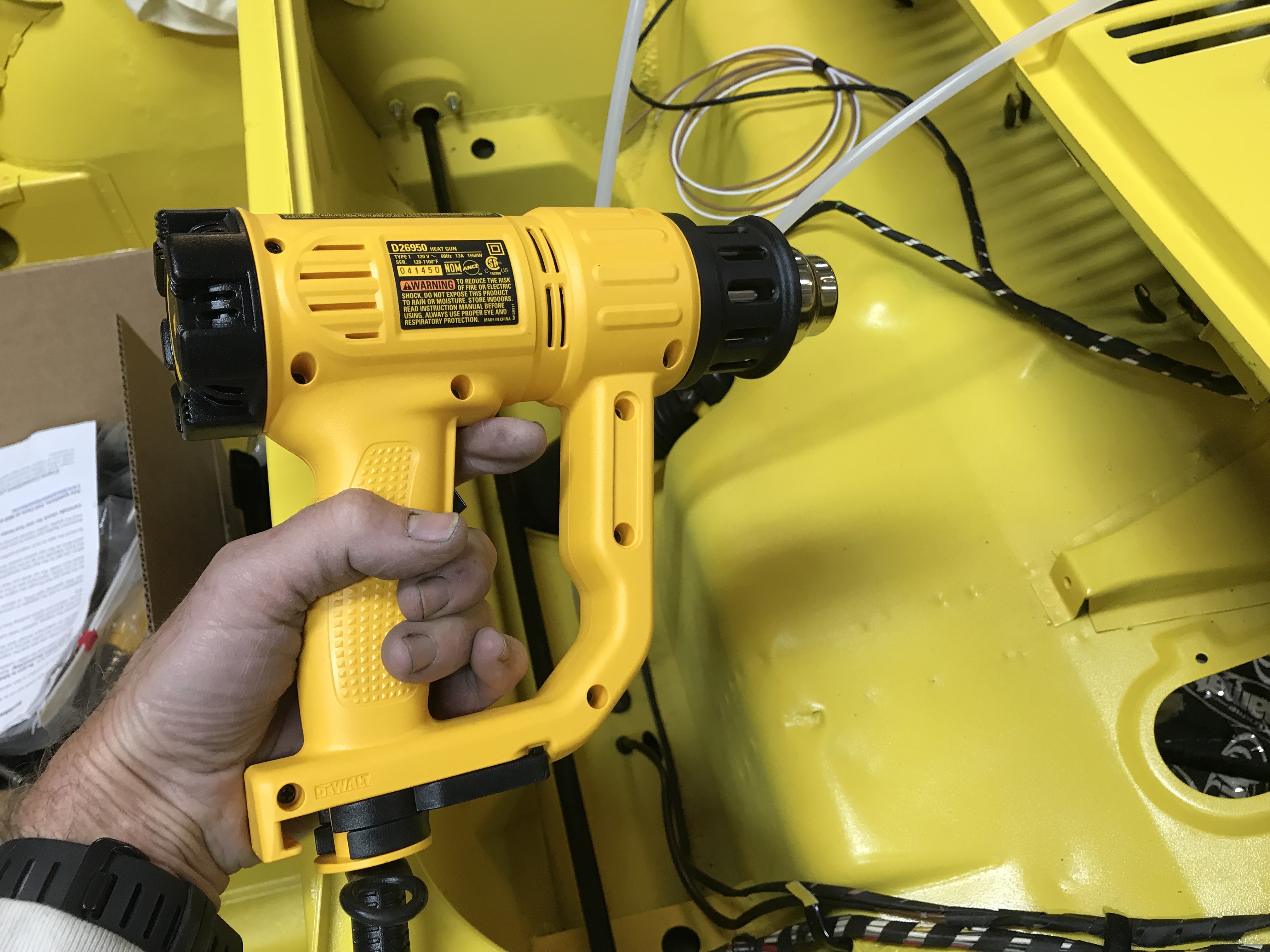

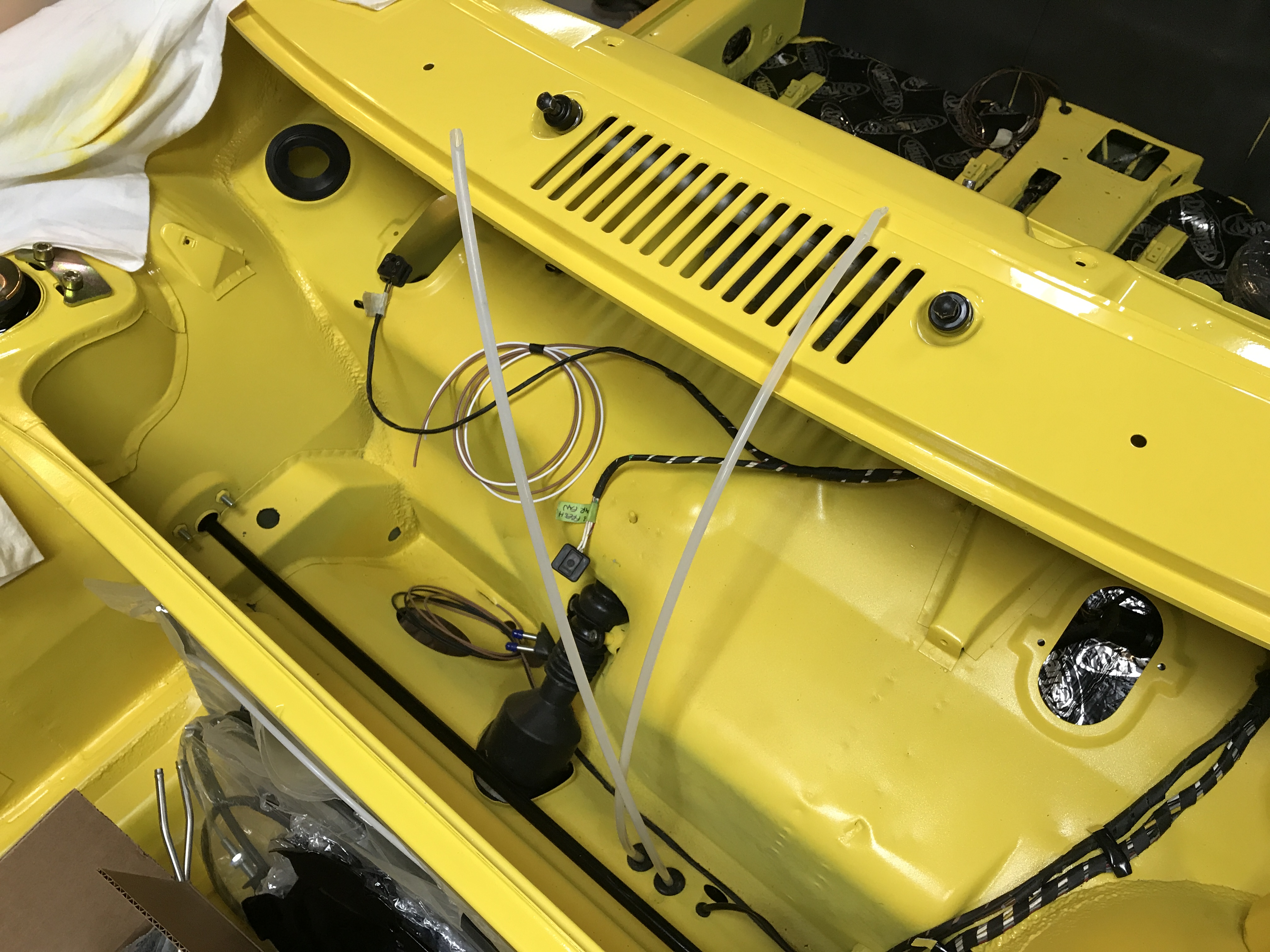

Out comes the trusty heat gun, set on medium.
bkrantz
post Jan 14 2021, 08:20 PM
Post #2007
Posts: 8,824
Joined: 3-August 19
From: SW Colorado
Member No.: 23,343
I tried to focus the heat on the outside of the bends, so the plastic could stretch rather than buckle on the inside of the bend. The result is not quite stock but should work.

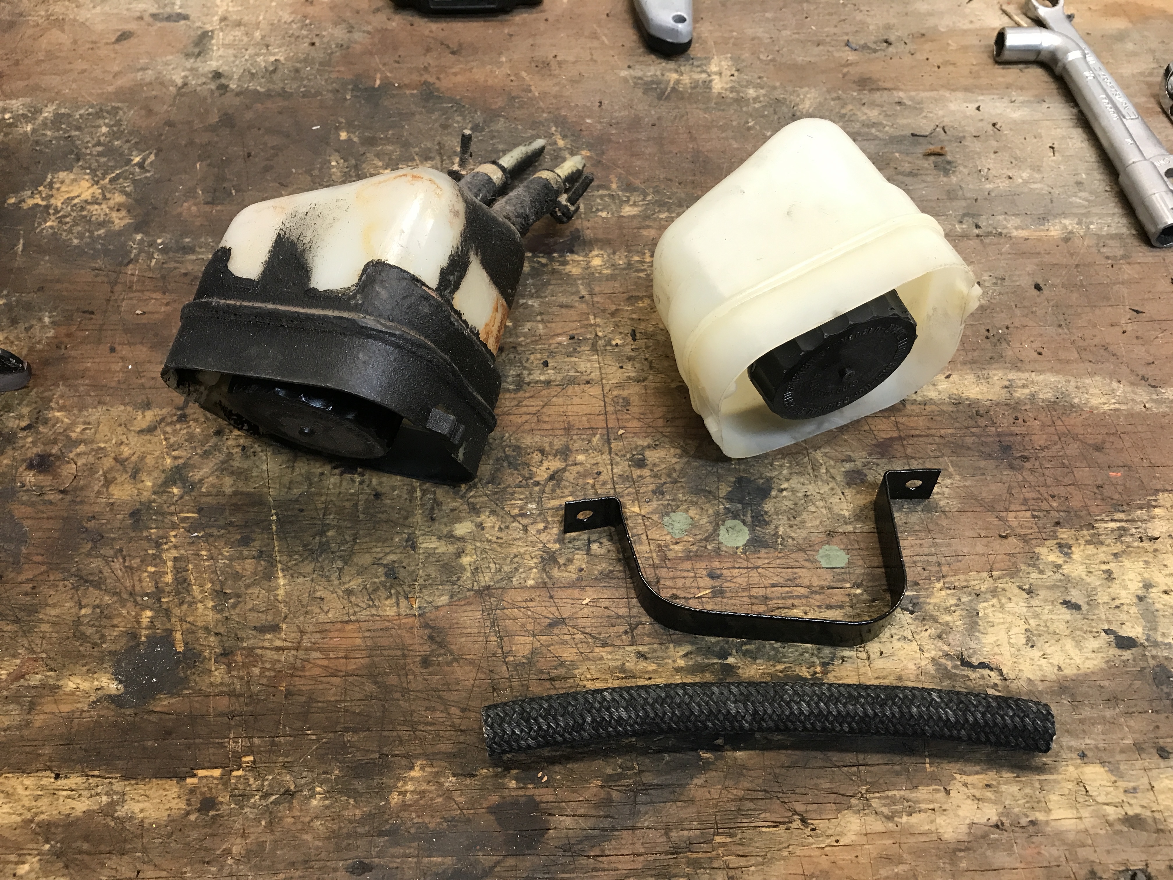

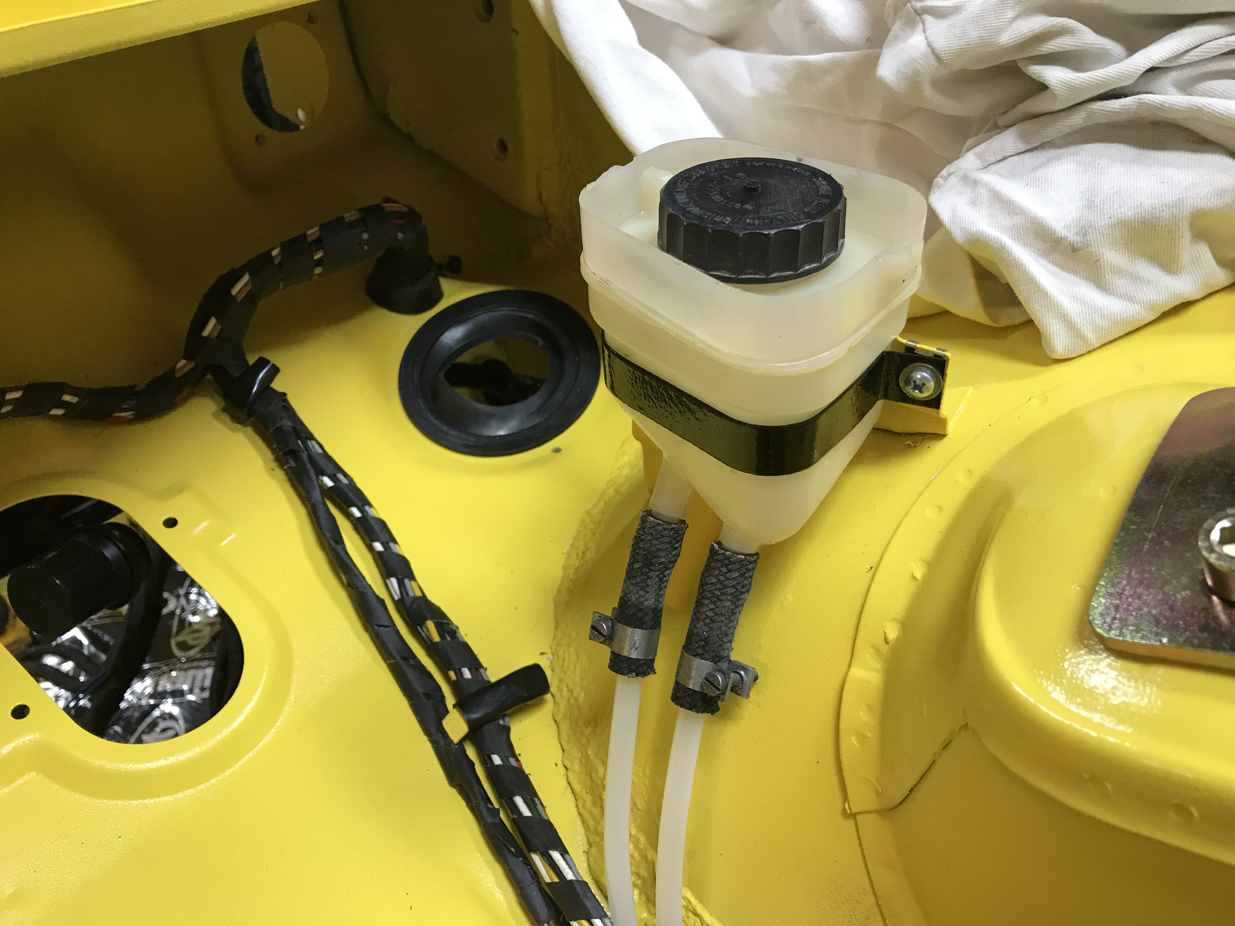

Here's the replacement reservoir with the nasty original. Know what I hate?
bkrantz
post Jan 14 2021, 08:23 PM
Post #2009
Posts: 8,824
Joined: 3-August 19
From: SW Colorado
Member No.: 23,343
Reservoir mounted to measure for cutting the feed lines. I will get to this tomorrow.

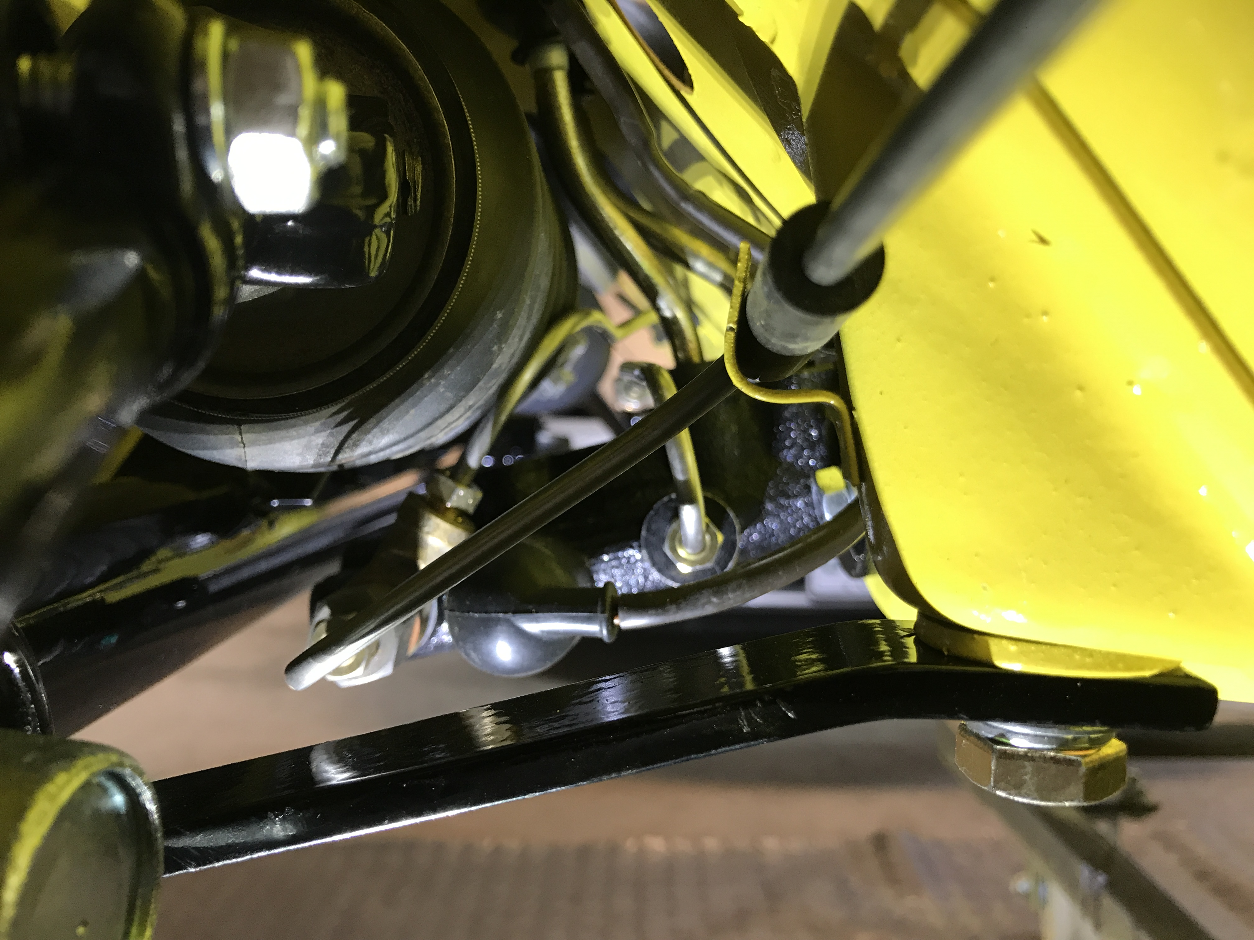

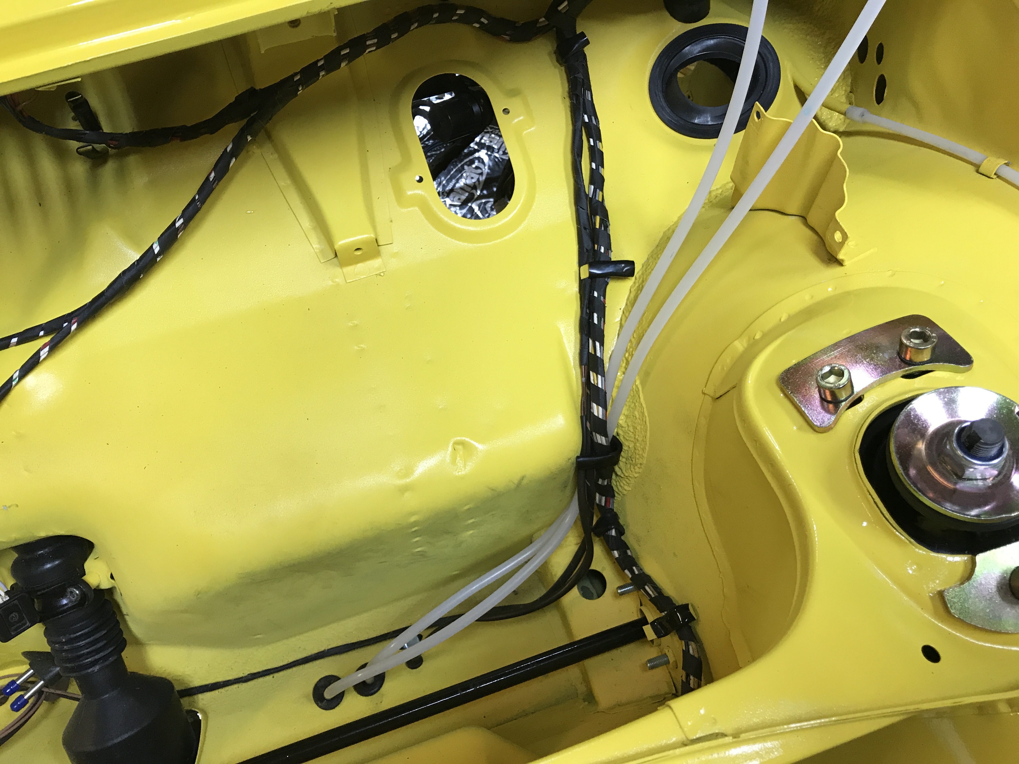

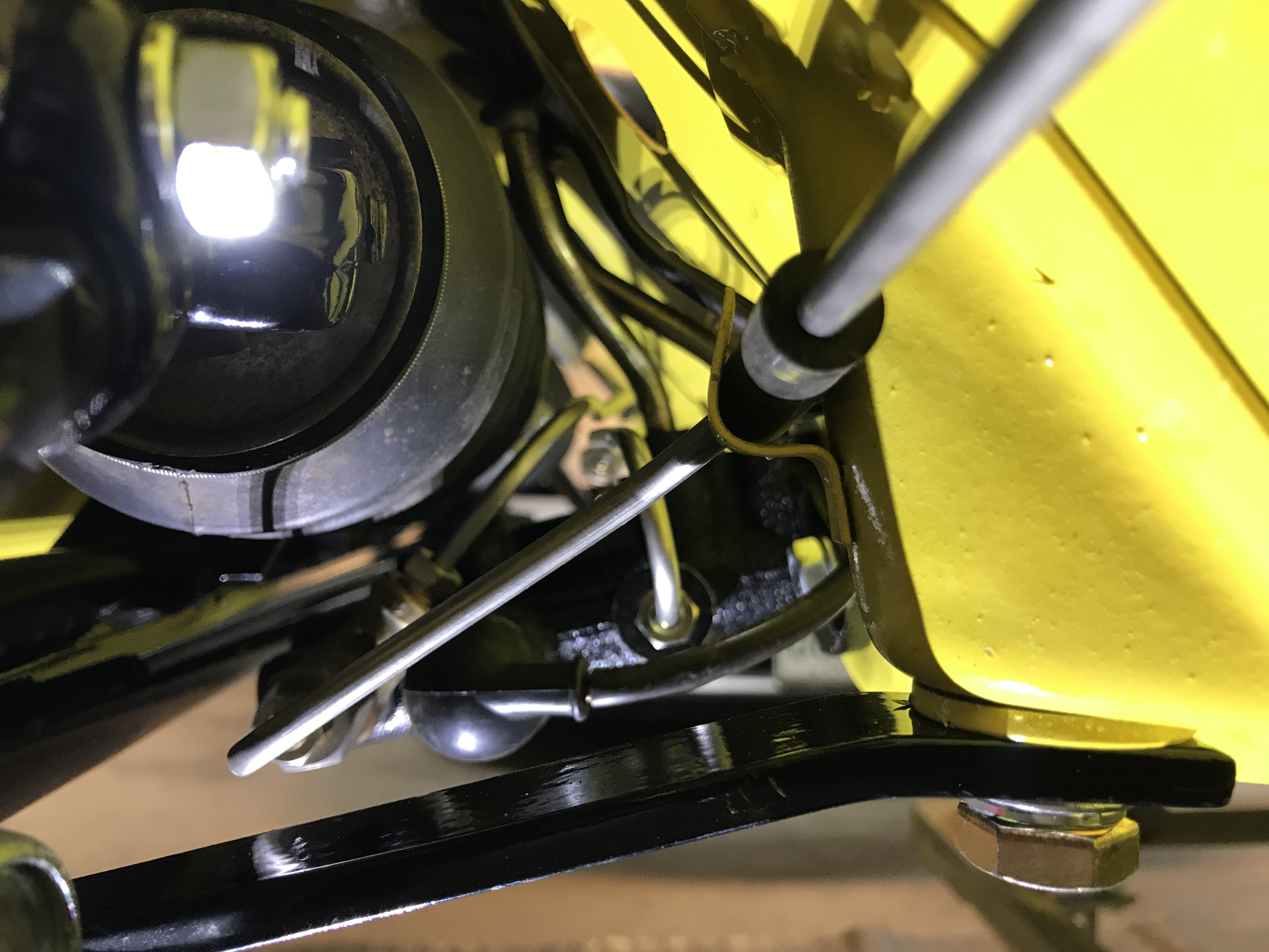

While checking the feed lines into the MC, I noticed a problem with the front output hard line. The way I installed this it rubs against the steering rack bellows (that I mounted after running the brake lines).
bkrantz
post Jan 14 2021, 08:26 PM
Post #2011
Posts: 8,824
Joined: 3-August 19
From: SW Colorado
Member No.: 23,343
Easy to turn the banjo fitting and tweak the hard line to get some clearance. Note the feed line fitting looks close to the bellows but there is clearance.

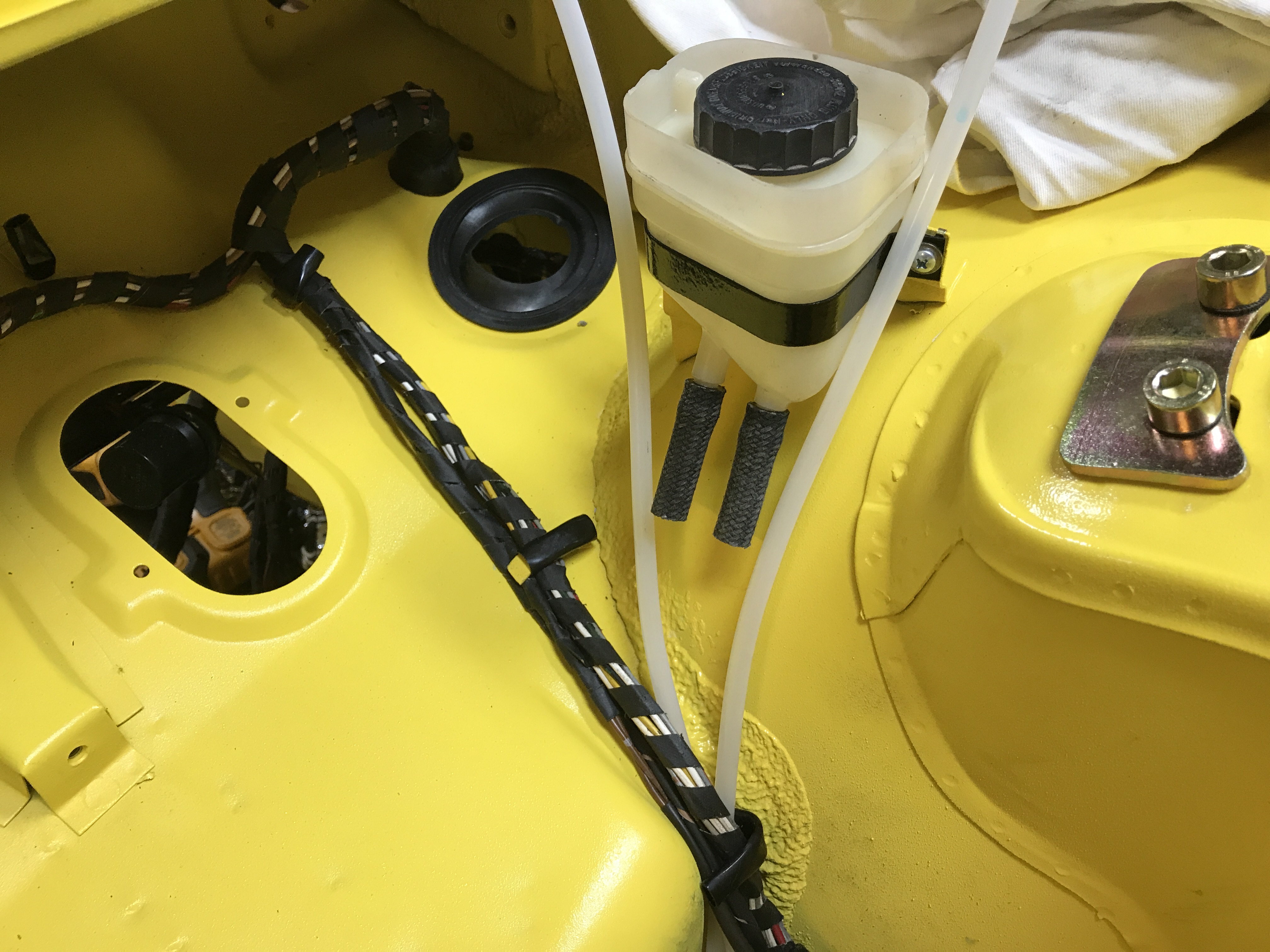

Just a quick trip to the garage today. I finished connecting the brake reservoir lines.

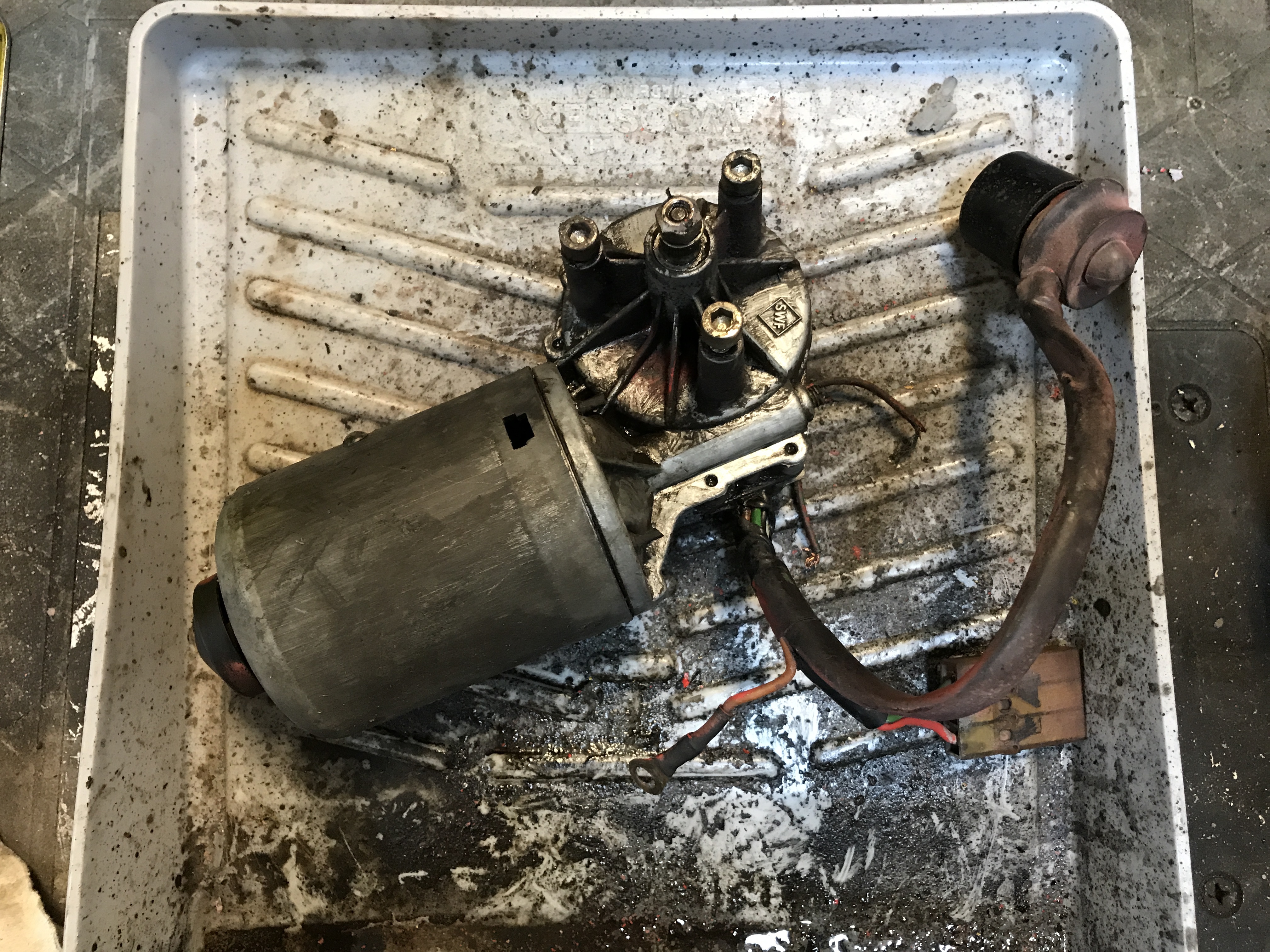

And I started cleaning the crud from the headlight motors.

@iankarr , @Kansas 914: If you google part number N203501-5 you should find plenty of options for blue, grey and black cloth brake line.
For what it's worth, my reservoir didn't look too much different than the "coated" one in the photo. I soaked mine for about 4 days in sulphamic acid (Lowe's stock # 643484) and it came out perfect...some paint overspray did not soak off but could be removed by fingernail after it's bath.

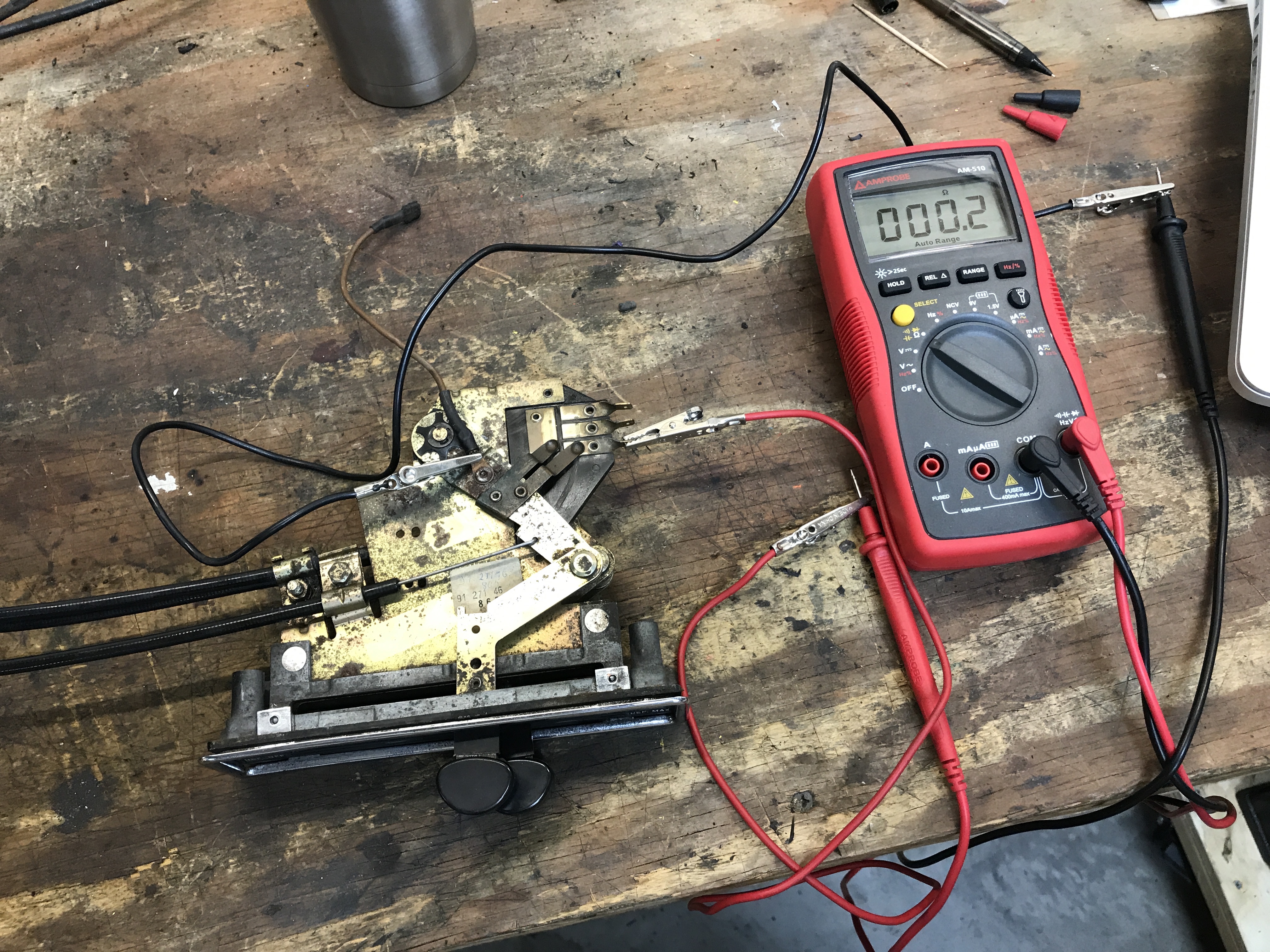

QUOTE(raynekat @ Jan 13 2021, 08:57 PM) *
Check this fresh air fan switch for continuity on all 3 speeds before installing. I didn't so didn't have all the fan speeds once installed and had to remove the switch again with all the associated cuss words to sort the issue.
Looking good.....
I checked the continuity today--all good. Thanks, again, Doug.
