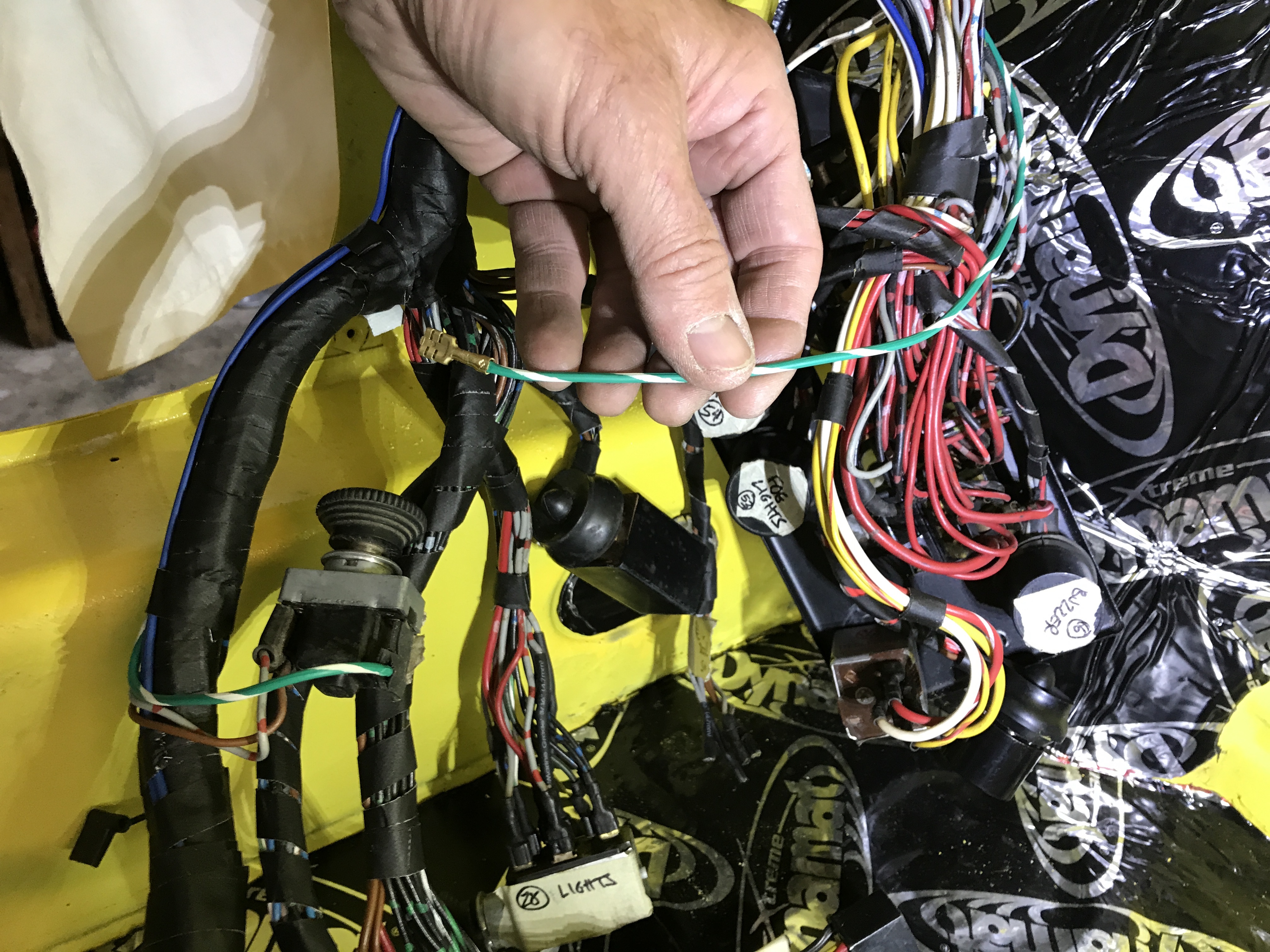

While I have easy access to the fuse panel, I rewired the fog light switch, so the fogs can come on without headlights.
Following multiple instructions from other 914 Worlders, I disconnected the white/blue wire for the fog relay from the fuse feed #1, and grounded it, disconnected the black/blue wire from the fog switch (and isolated it), and ran a new lead (here, green/white) from the switch to fuse feed #9.

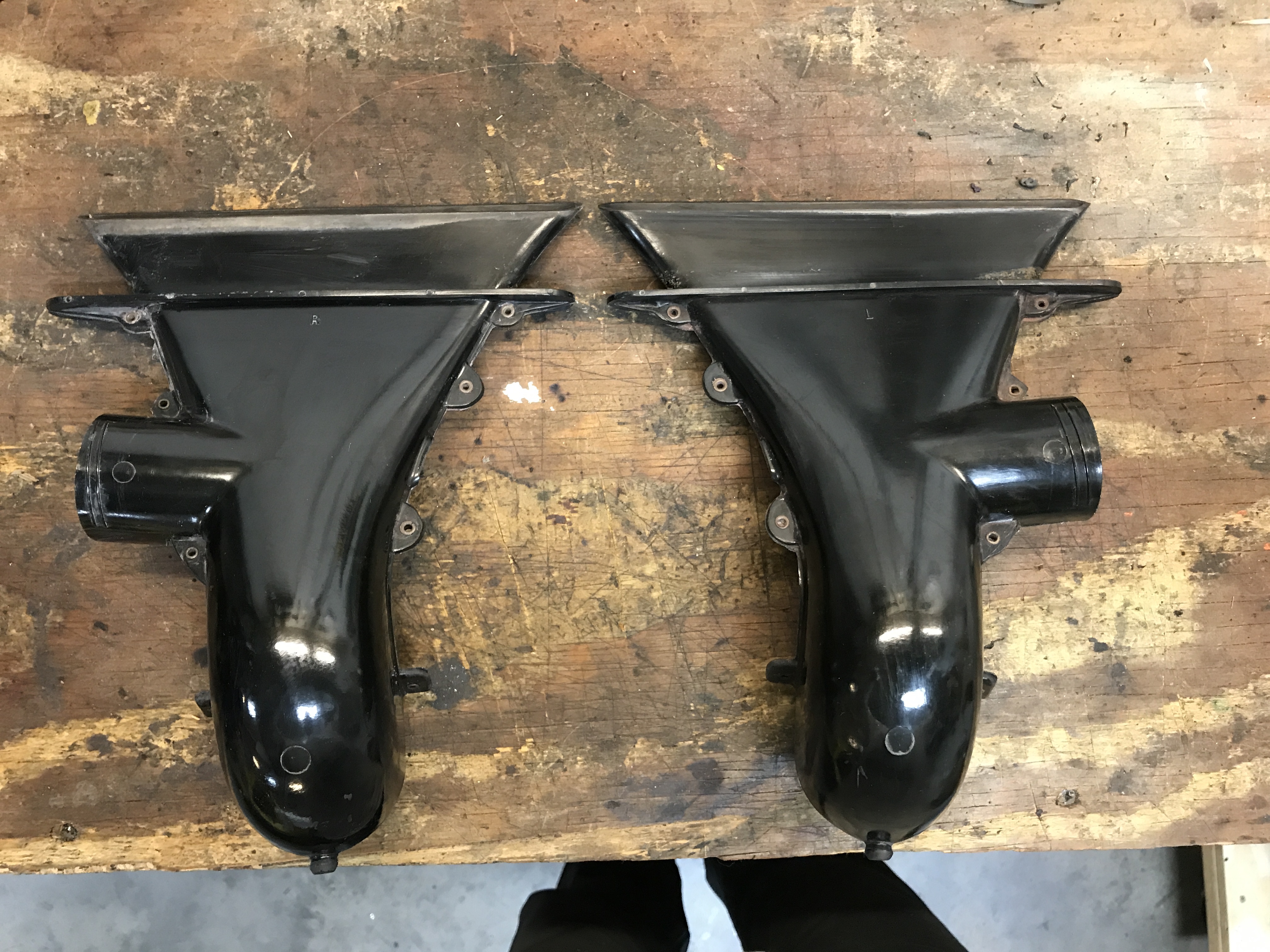

After fun stuff, I went back to cleaning parts. Here are the defroster ducts, mostly free of undercoating an overspray.
bkrantz
post Jan 16 2021, 08:27 PM
Post #2024
Posts: 8,824
Joined: 3-August 19
From: SW Colorado
Member No.: 23,343
One mixer box cleaned, one to go.

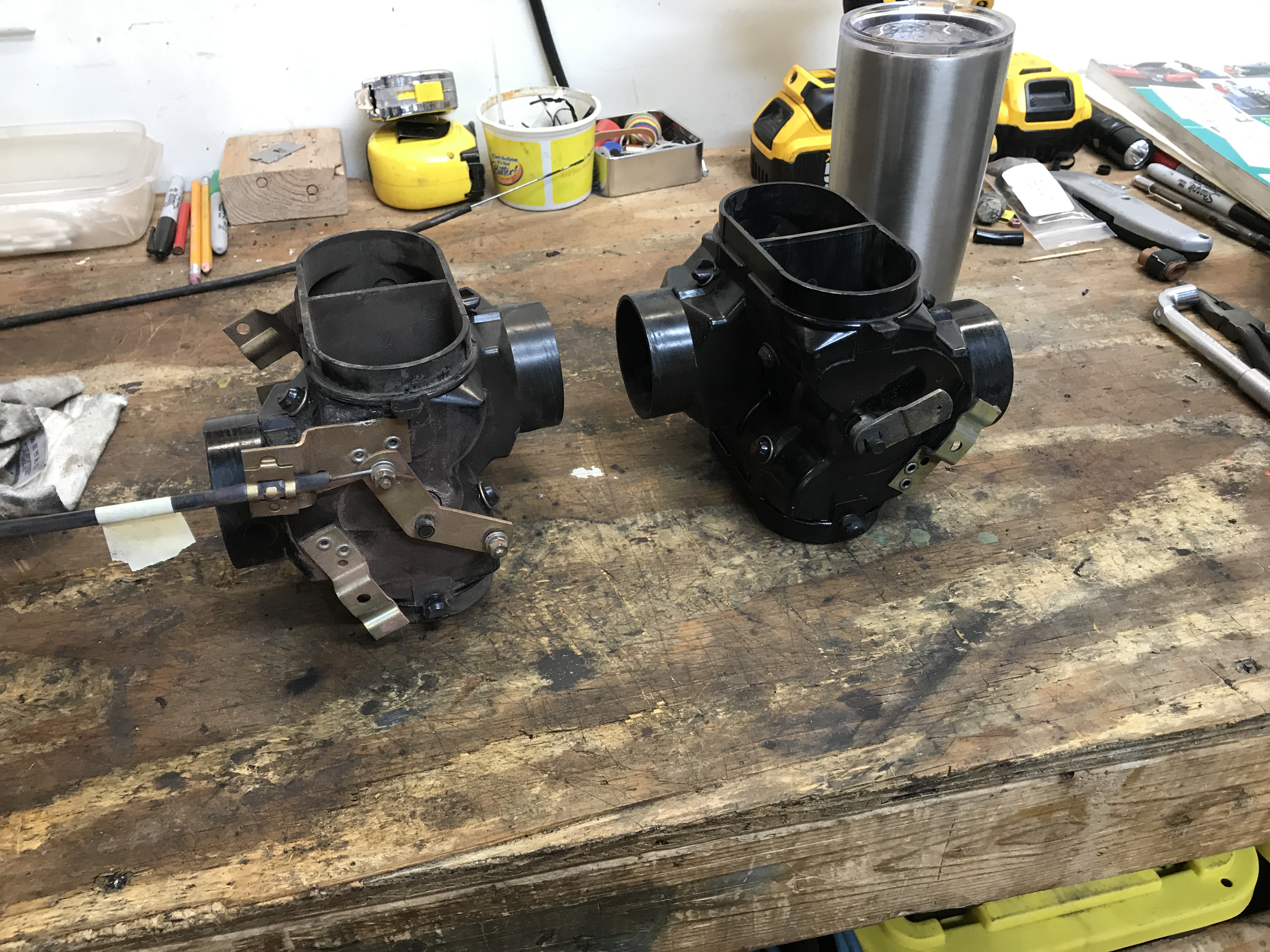

Got all the fresh air system components cleaned, and ready to install (I hope). As soon as I have the dash face mounted, I can continue with all the ventilate stuff.

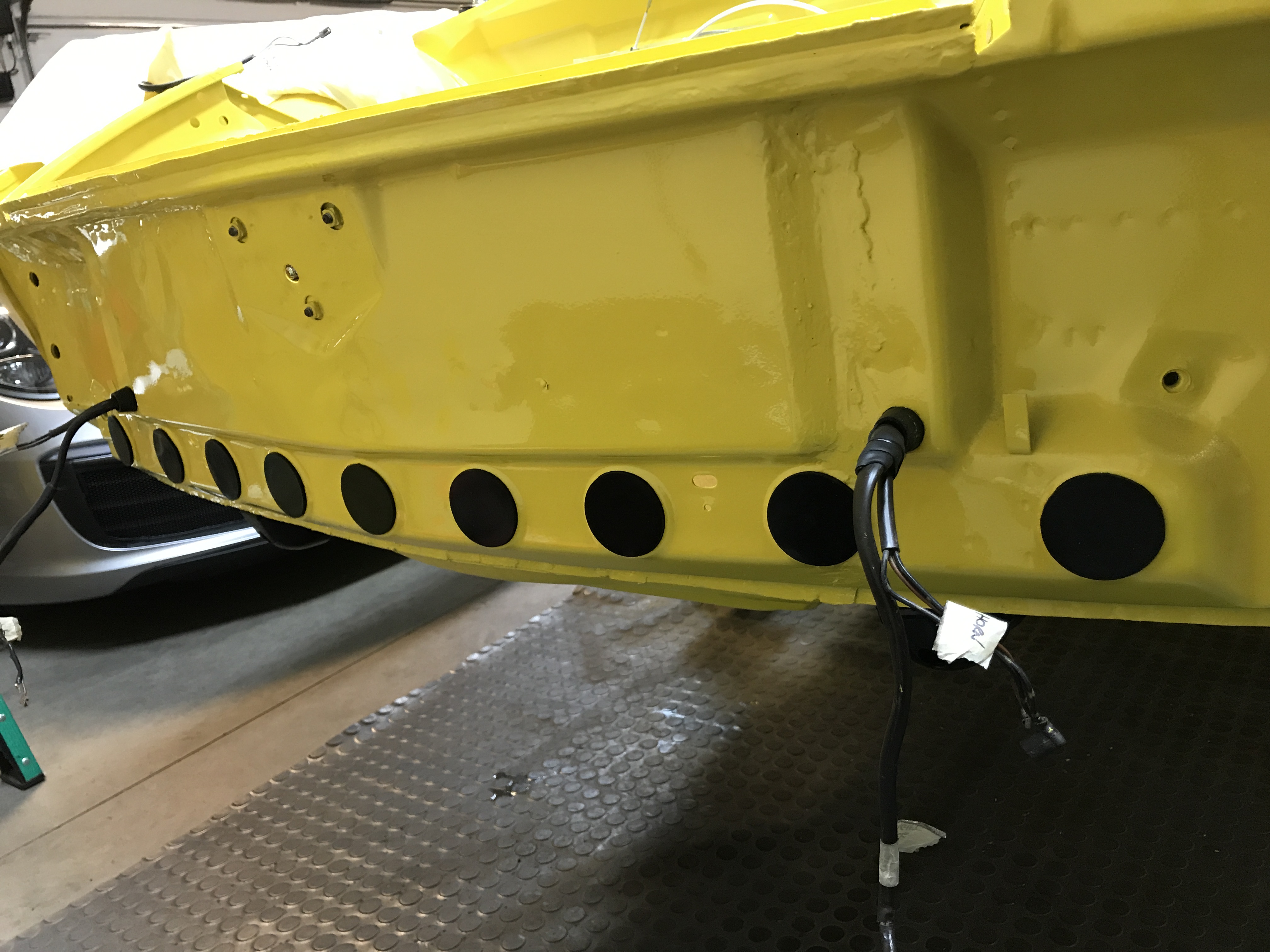

Meanwhile, a few trivial bit, like the plugs for the front nose panel.

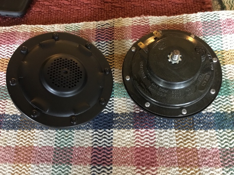

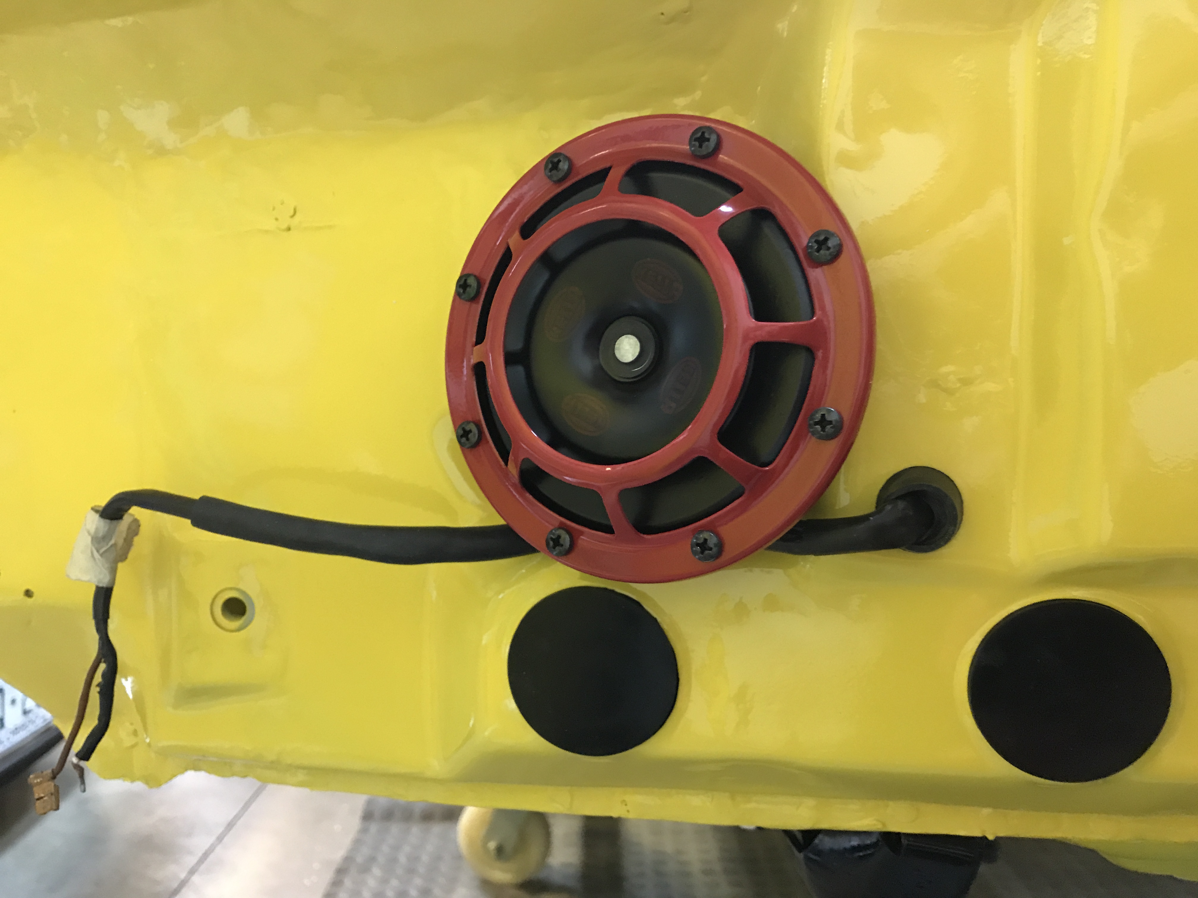

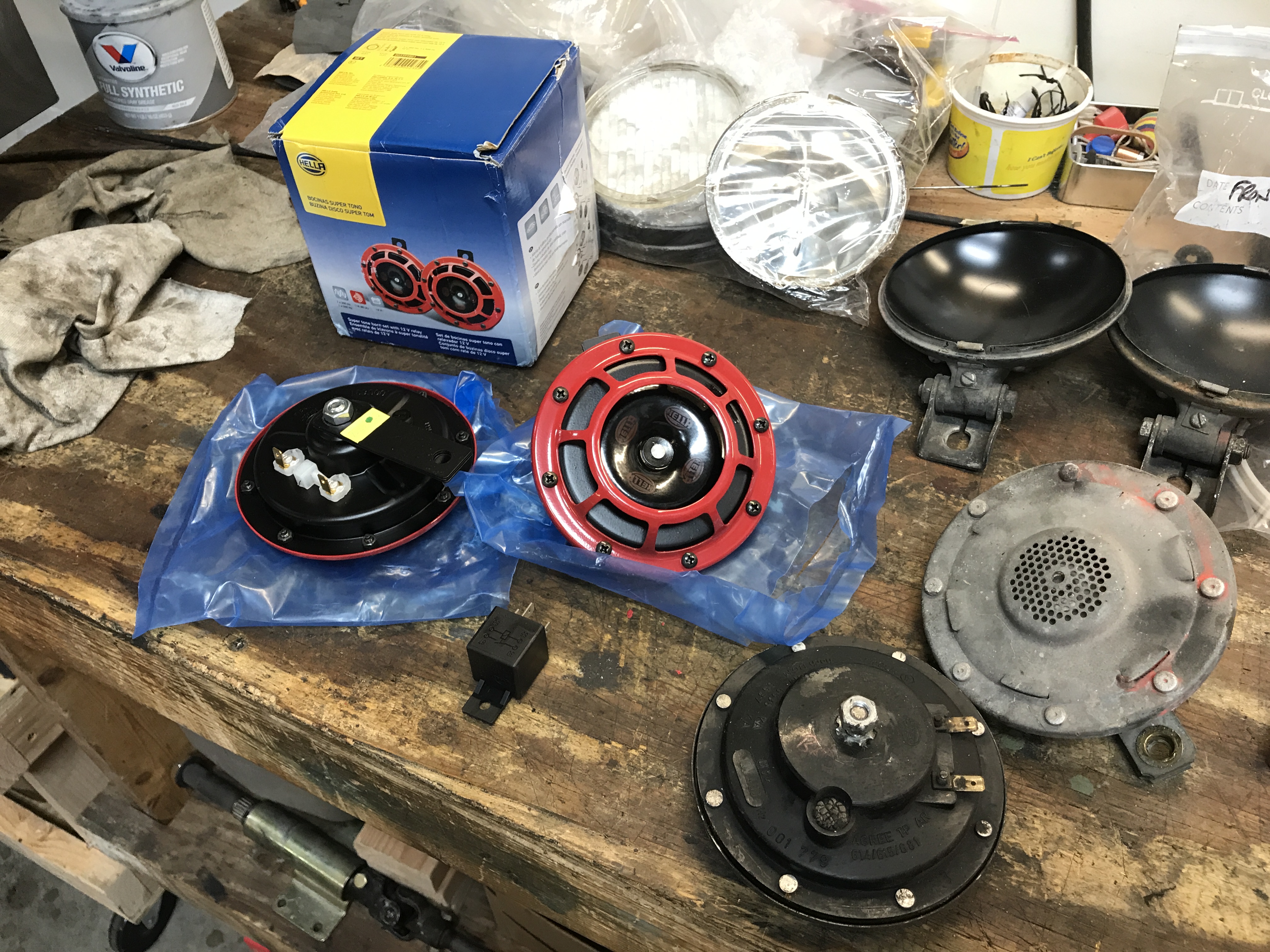

Now for some shiny new Hella horns, to replace the originals (with one not working). And the new horns don't have undercoating.
bkrantz
post Jan 17 2021, 07:40 PM
Post #2027
Posts: 8,824
Joined: 3-August 19
From: SW Colorado
Member No.: 23,343
Fit is exactly like the originals. And should be louder.

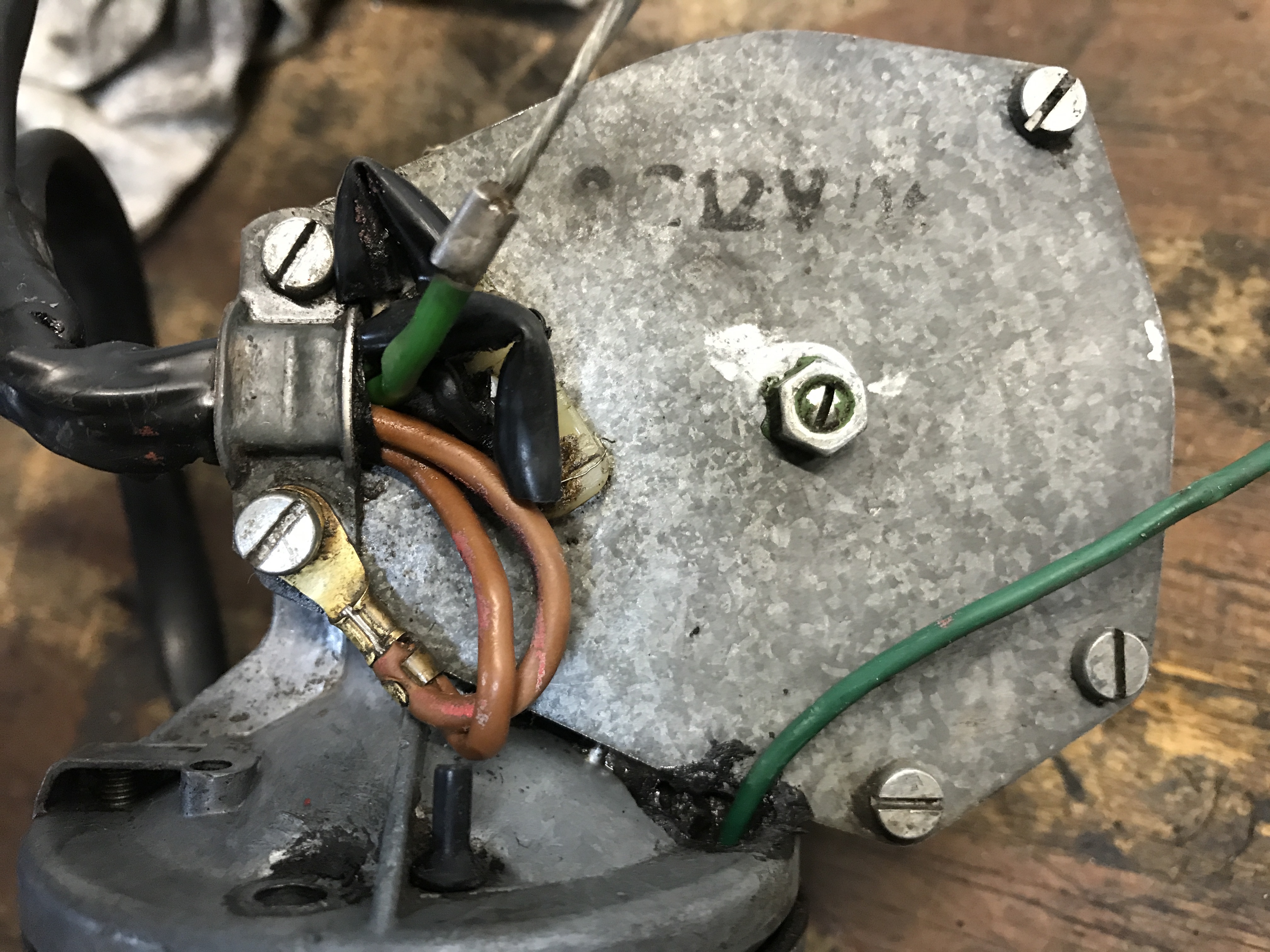

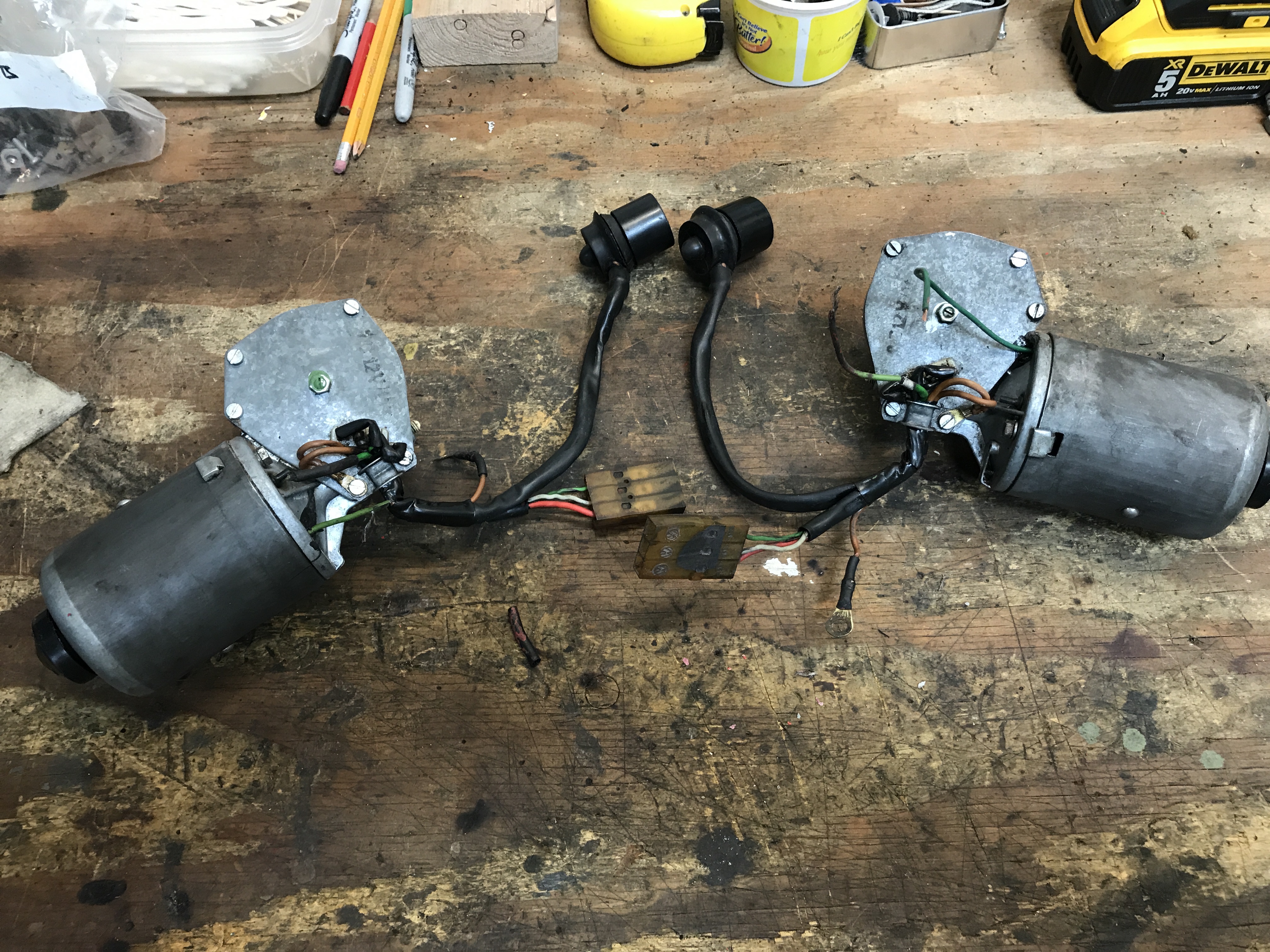

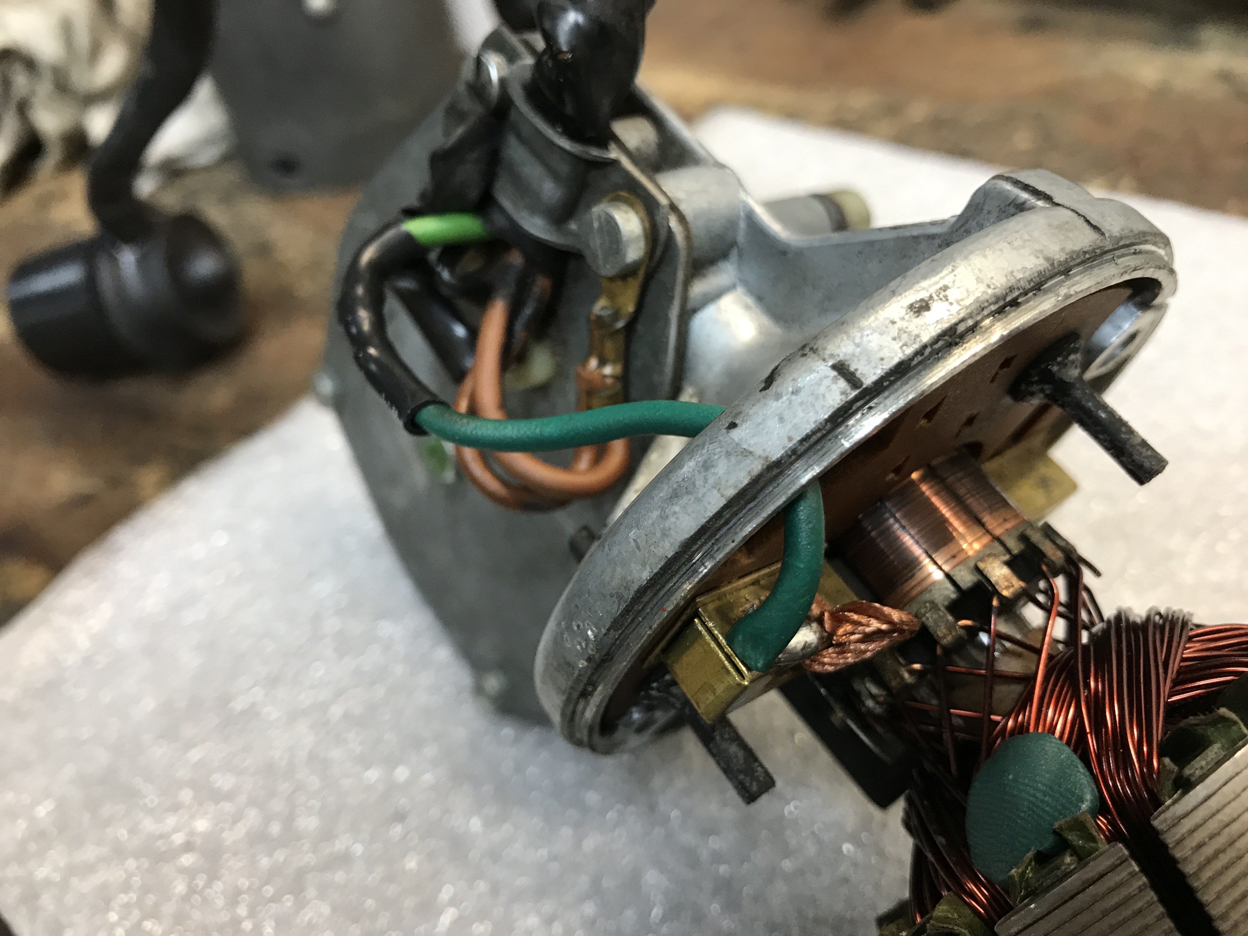

Then I went down a rabbit hole with the headlight motors. Both ran when tested, but both have broken wires.
bkrantz
post Jan 17 2021, 07:49 PM
Post #2029
Posts: 8,824
Joined: 3-August 19
From: SW Colorado
Member No.: 23,343
I repaired one lead, but there is a small contact widget that allows the armature to spin in one direction only. Is this normal?
bkrantz
post Jan 17 2021, 07:51 PM
Post #2030
Posts: 8,824
Joined: 3-August 19
From: SW Colorado
Member No.: 23,343
The other motor has been opened before, and is missing some hardware that holds the top casting to the case. And this one spins freely in both directions, so I can't unscrew the manual knob.
I think I need to source some replacements.

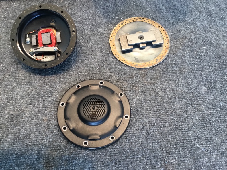

QUOTE(bkrantz @ Jan 17 2021, 05:38 PM) *
No, no, no, noooooooo......
After all the trouble you've gone to on this build, you're not going to clean up and rebuild/repair your horns?
Oh the horror.
Not that hard and the undercoating will clean up like a champ.
The non-working horn is likely the "points" inside that are easily cleaned with an emory cloth or some very fine sandpaper (I did this) and some satin black paint.
You'll end up with this.
And they are LOUD horns when working correctly. Ask me. Ha
Mine below.
Just saying and throwing out the gantlet.
See post #663 on my build.
http://www.914world.com/bbs2/index.php?sho...9327&st=640

QUOTE(raynekat @ Jan 17 2021, 08:38 PM) *
Oh the horror.
Mine below.
Sorry to be SUCH a disappointment. (IMG:style_emoticons/default/sad.gif)
I guess I just wimped out. But the new horns are sexy red. (IMG:style_emoticons/default/wub.gif)
Wait til you see what I have in mind for the fog lights.

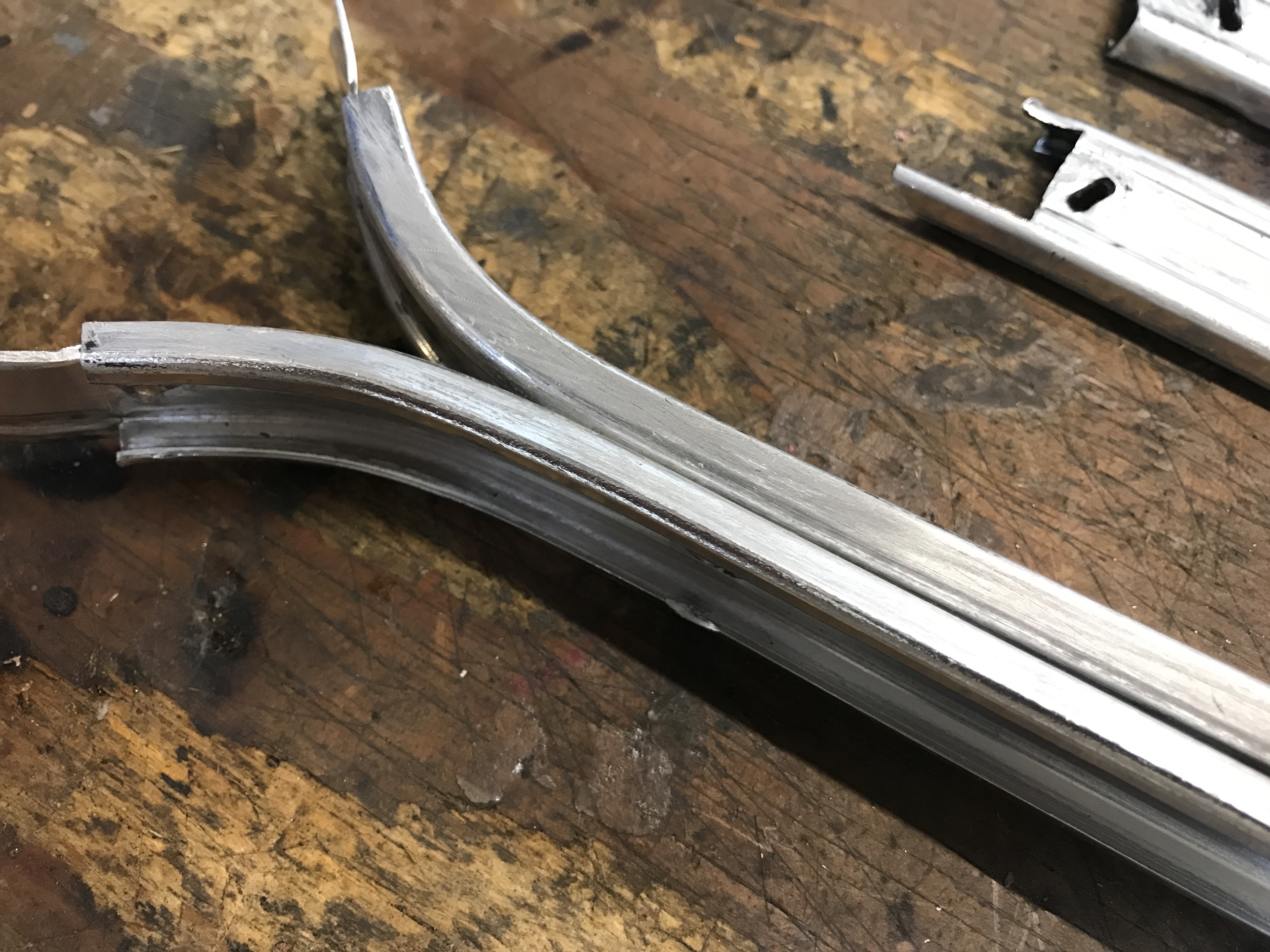

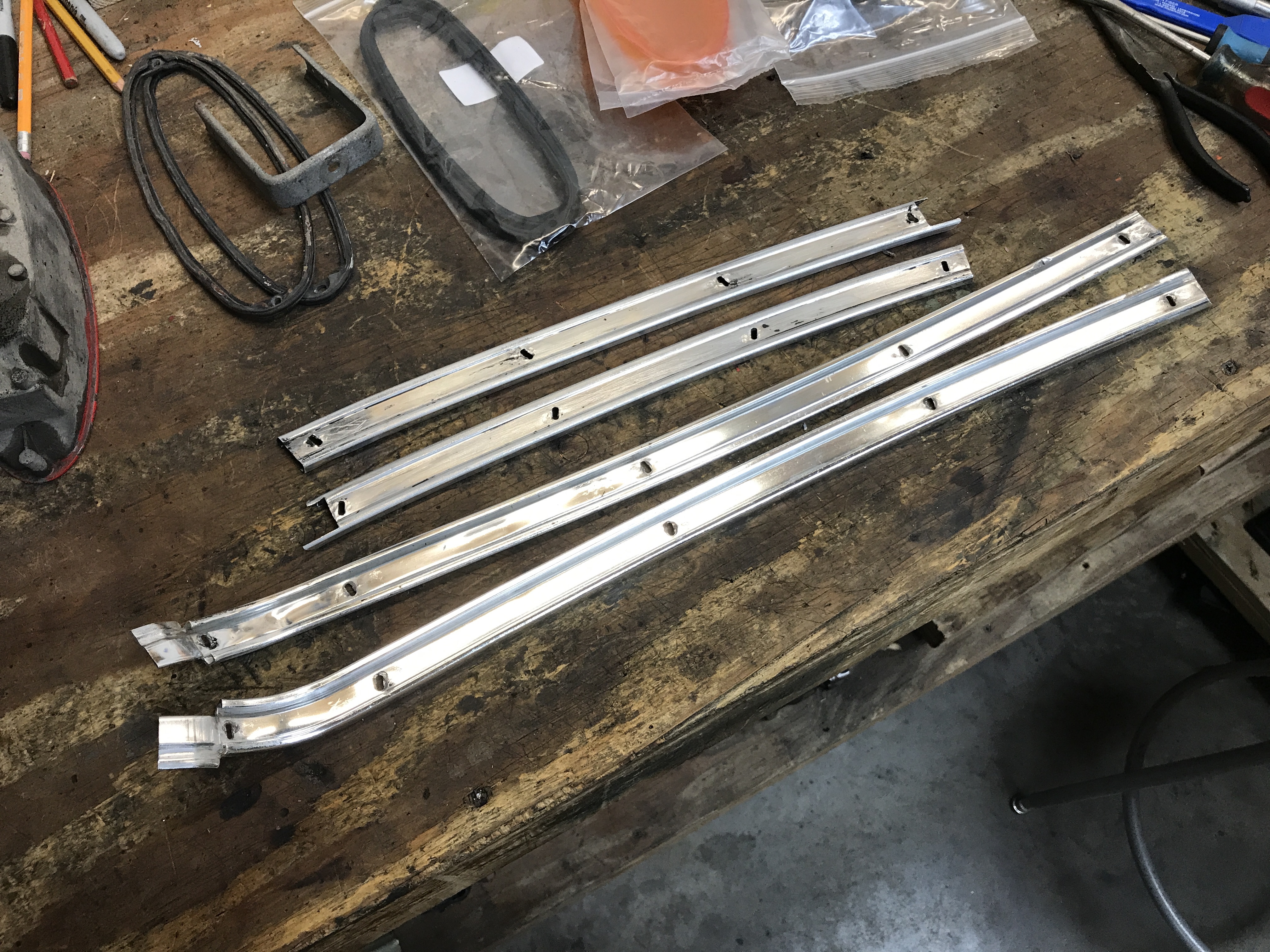

I pulled out the aluminum trim again. I did order new pieces for the targa sails, but want to see if I can rescue the window trim strips. I cleaned off the PO black paint.
bkrantz
post Jan 18 2021, 08:28 PM
Post #2034
Posts: 8,824
Joined: 3-August 19
From: SW Colorado
Member No.: 23,343
With all the half-a** work they did, why did they have to be dedicated enough to sand the trim before painting it black?
bkrantz
post Jan 18 2021, 08:30 PM
Post #2035
Posts: 8,824
Joined: 3-August 19
From: SW Colorado
Member No.: 23,343
My plan is to sand out the grooves as much as possible, polish, and seal. And this is just for the outer edges.

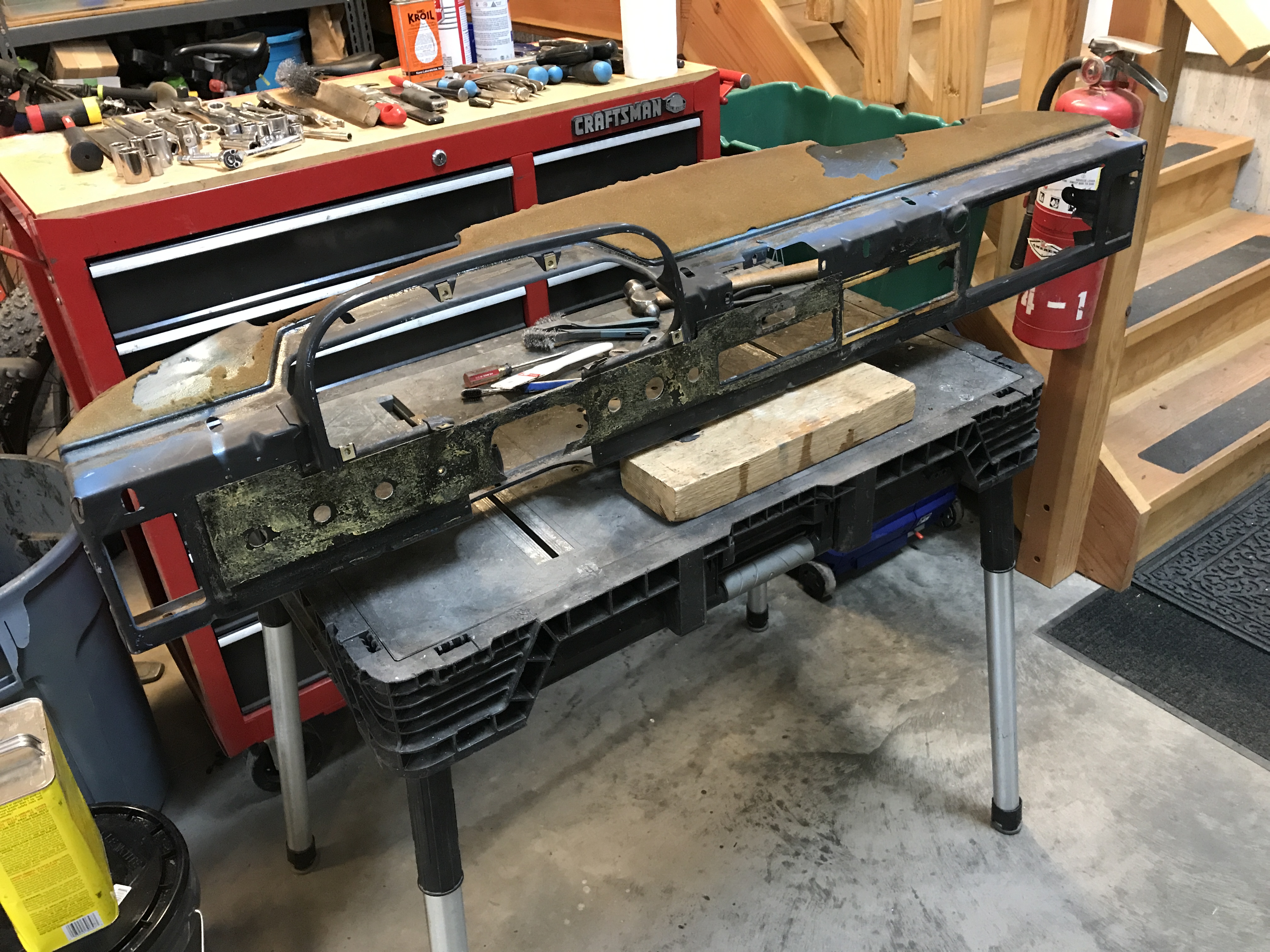

Member No.: 23,343

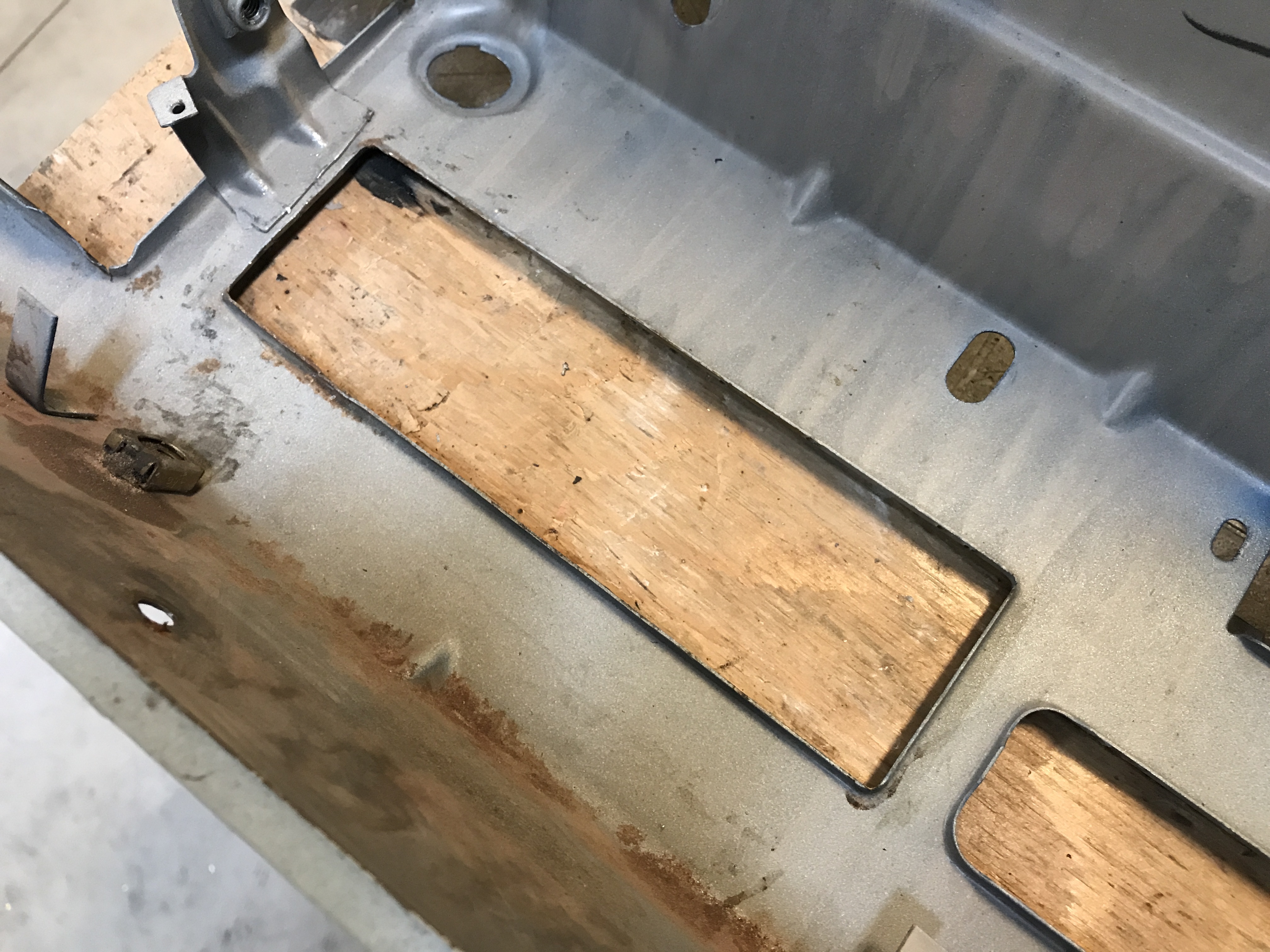

And I finally started with the dash. I will replace the vinyl on the top (stock black) and the face (gray perf, to match my new doors and seats).
bkrantz
post Jan 18 2021, 08:35 PM
Post #2037
Posts: 8,824
Joined: 3-August 19
From: SW Colorado
Member No.: 23,343
Just a little bit of metal working done, mostly around the radio opening.
