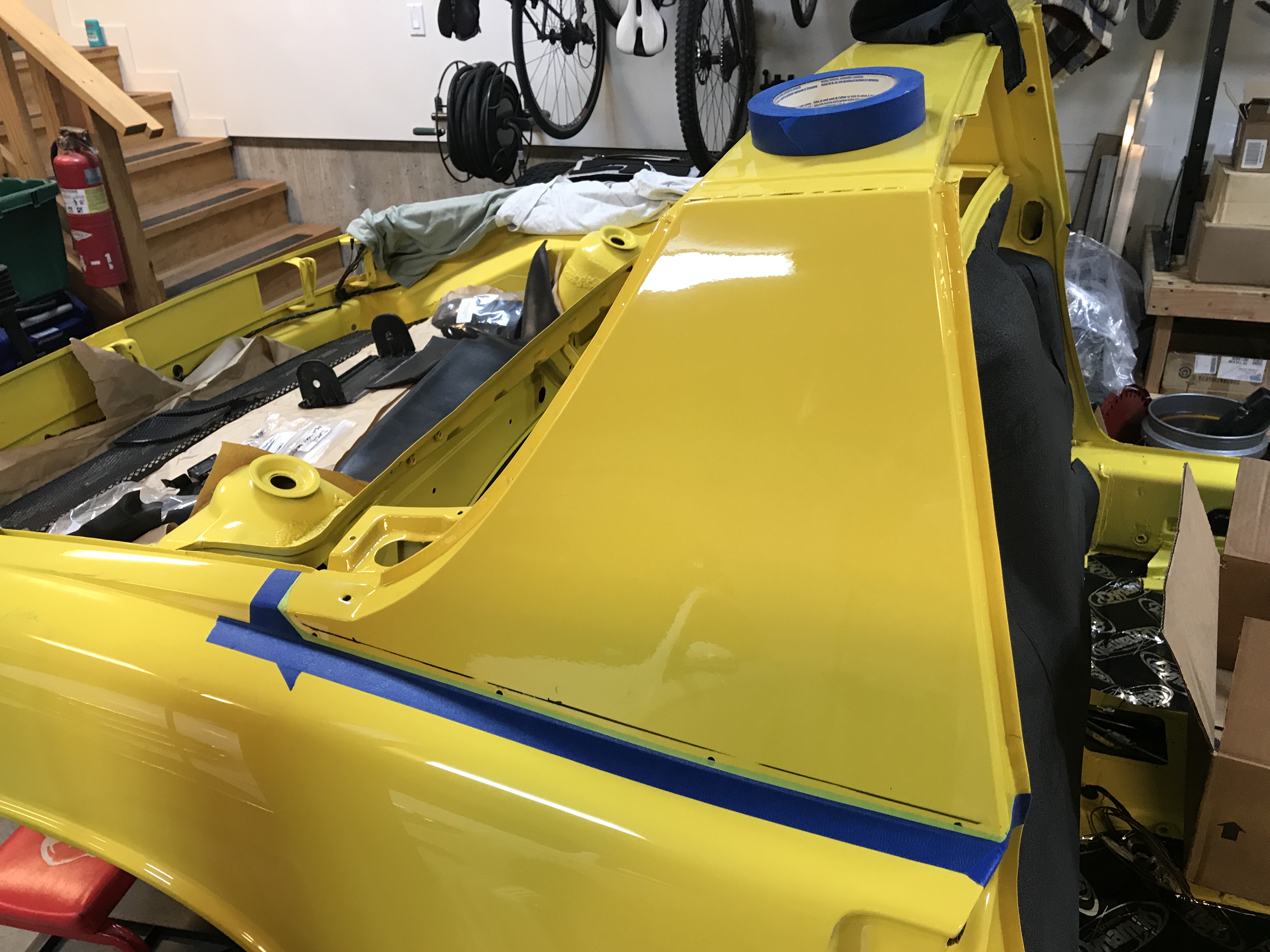

Then I marked off with tape where the edge of the vinyl should go.

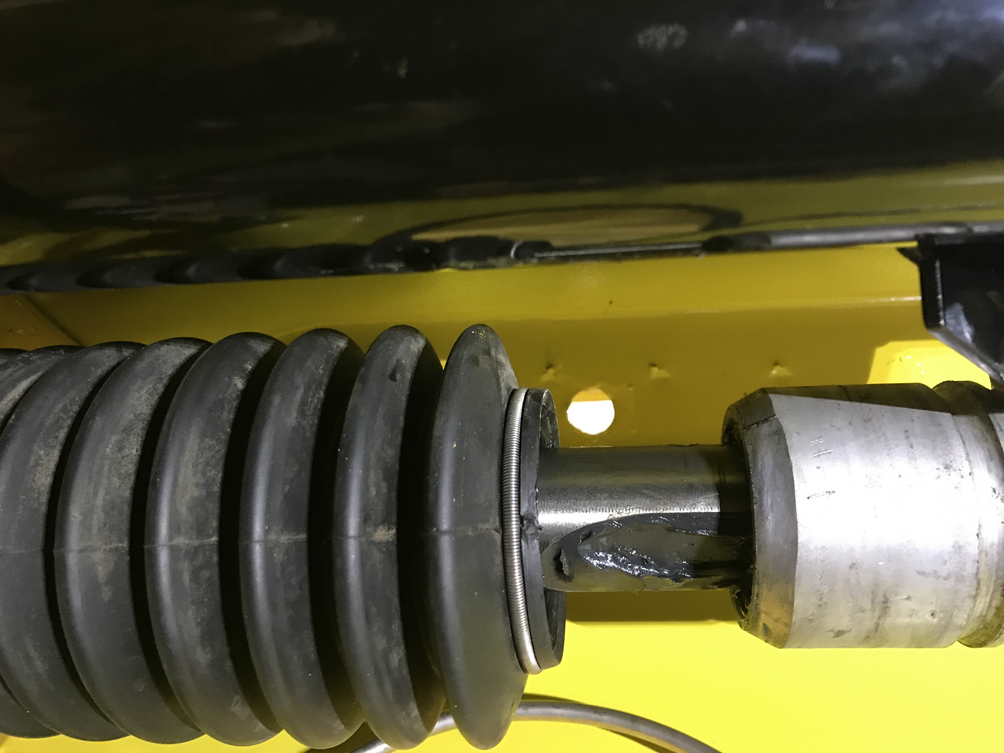

More work on the fuel pump mounting. To free the pump from the clamp and allow removing via the round hole (I hope) I drilled a small hole so a screw driver can loosen the clamp bolt from below.

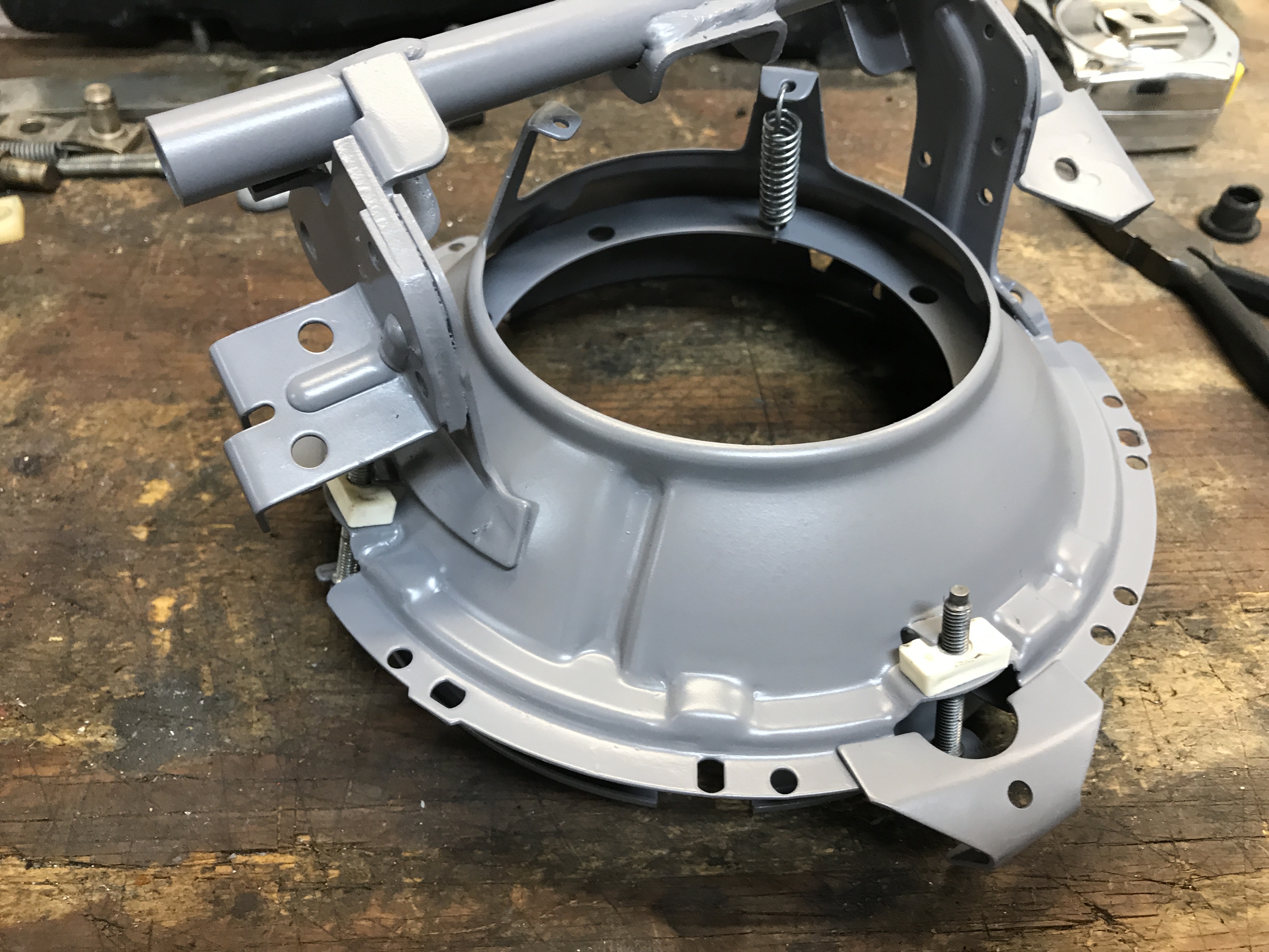

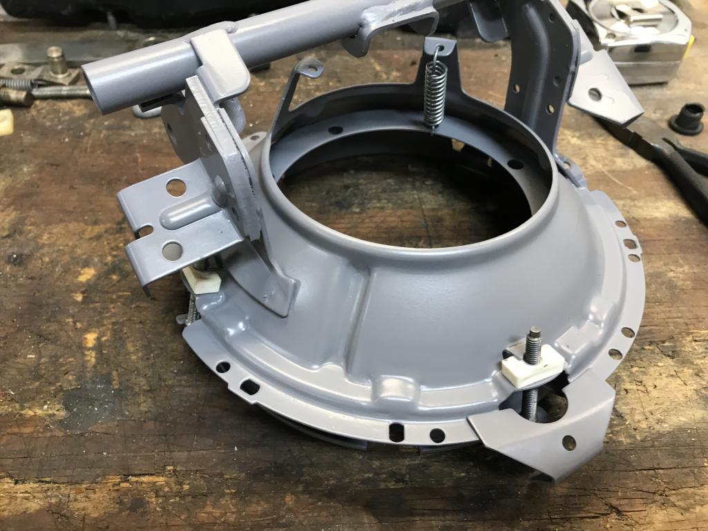

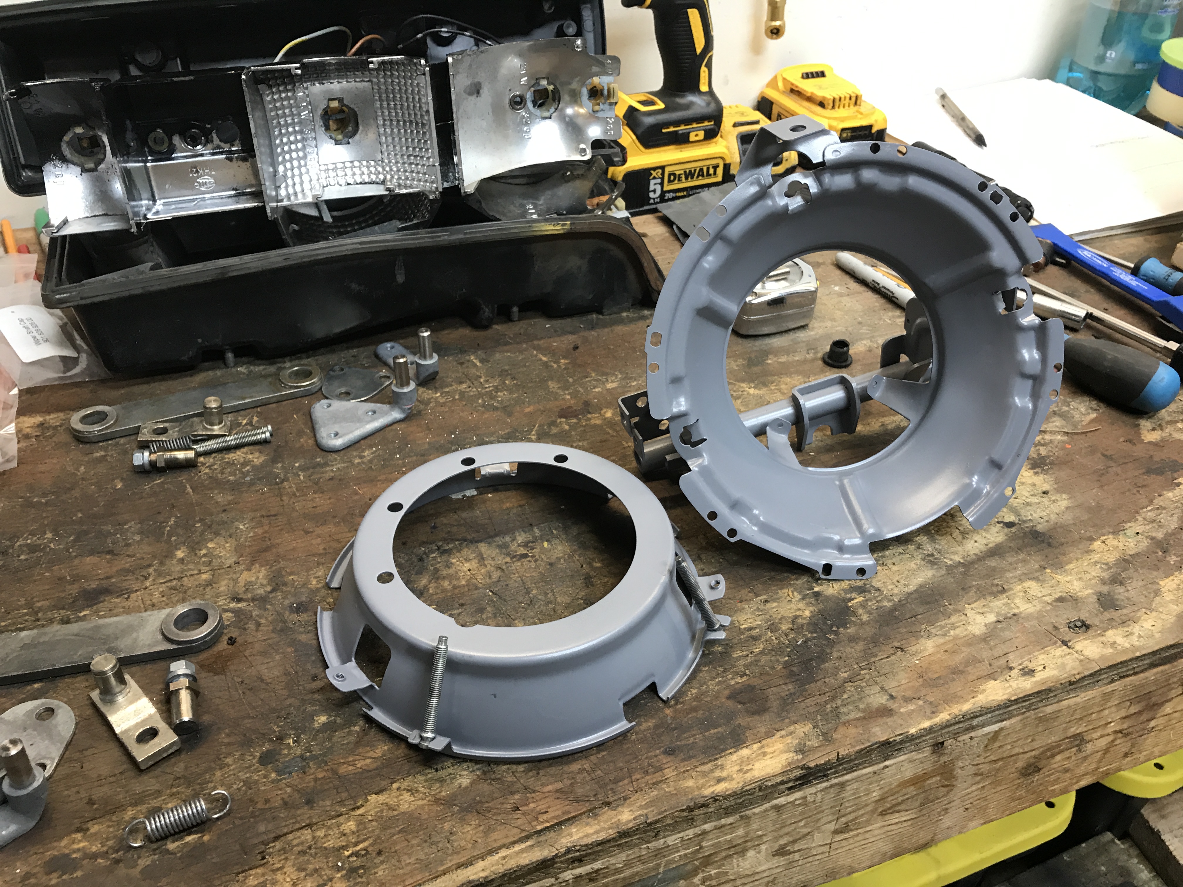

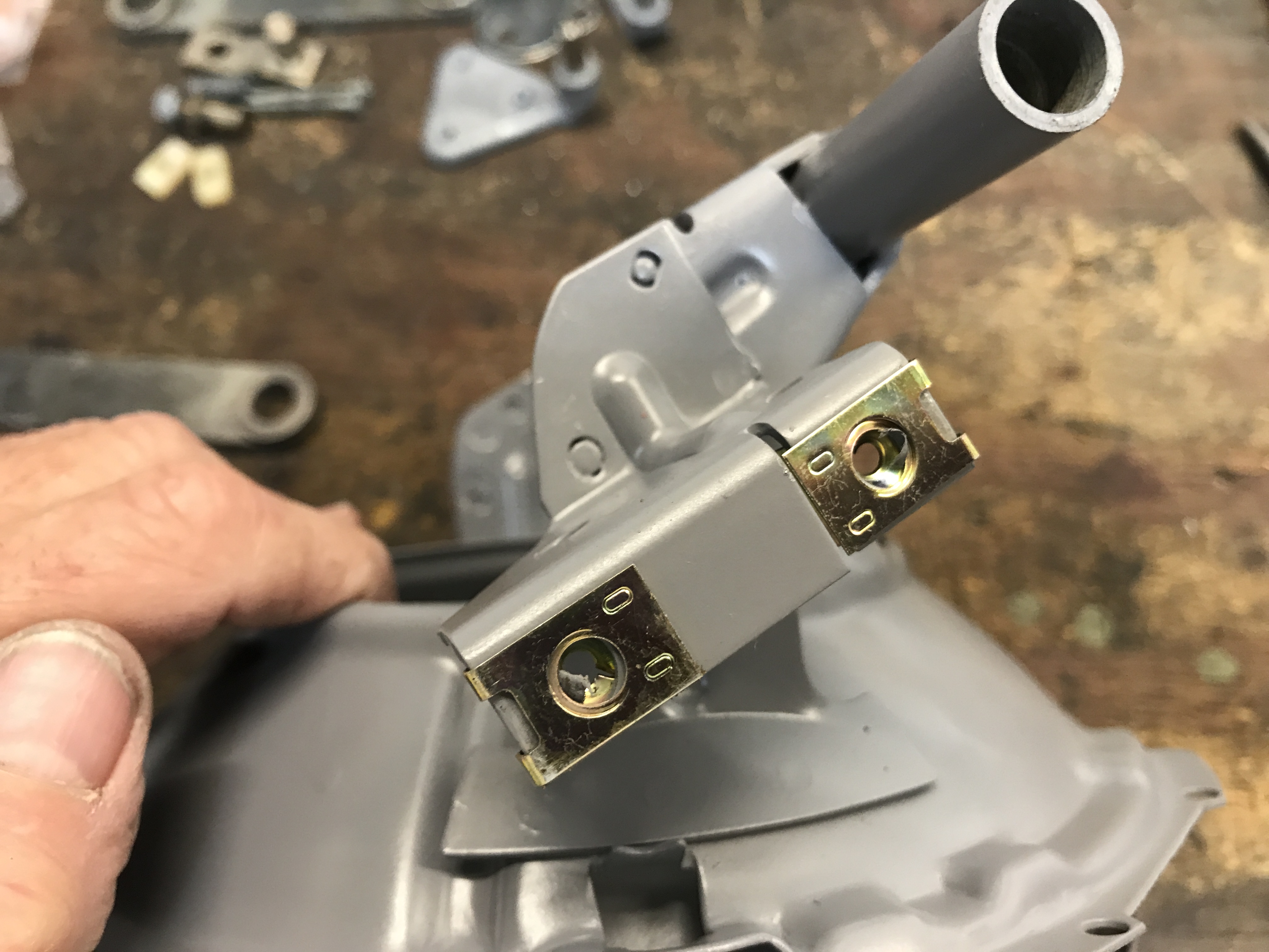

While waiting for touch-up paint on the new holes to dry, I played a bit with the headlight carriers.
bkrantz
post Jan 25 2021, 08:19 PM
Post #2086
Posts: 8,824
Joined: 3-August 19
From: SW Colorado
Member No.: 23,343
All tidy with clean hardware, and the Rustoleum satin gray paint.
bkrantz
post Jan 25 2021, 08:20 PM
Post #2087
Posts: 8,824
Joined: 3-August 19
From: SW Colorado
Member No.: 23,343

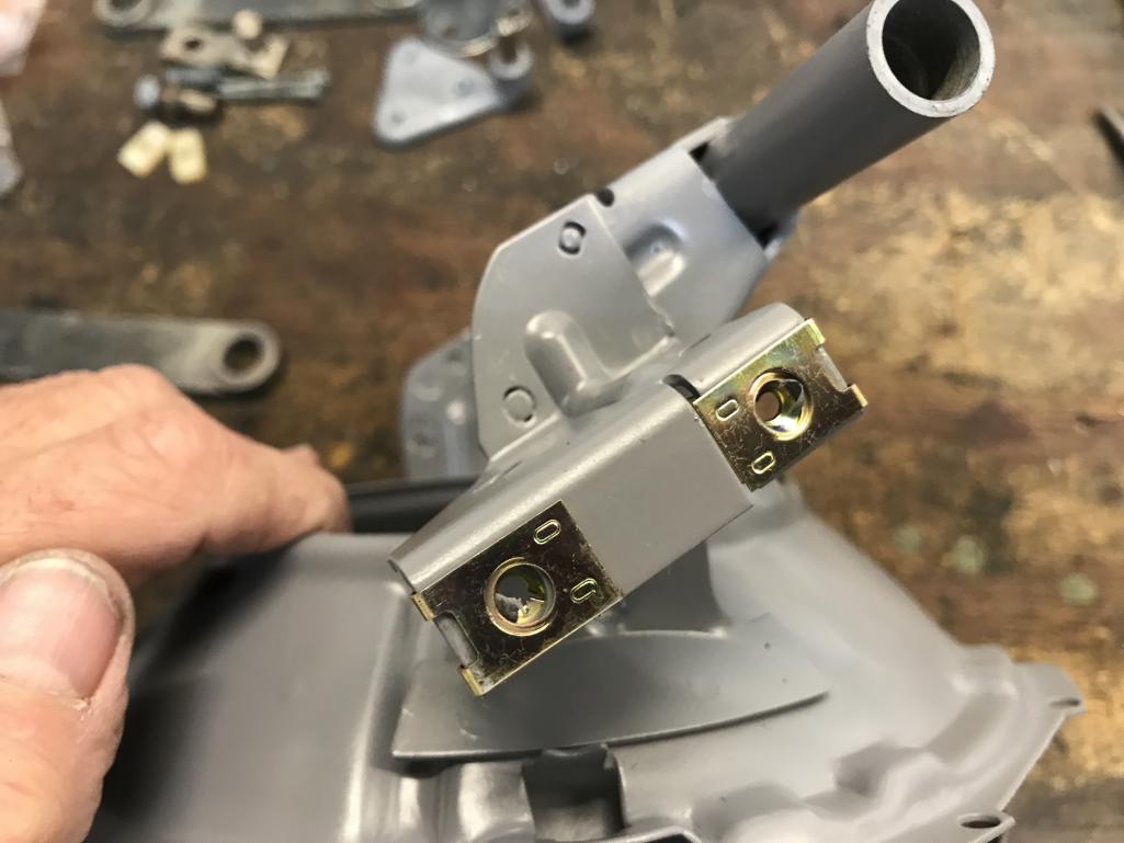

And new speed nuts from Belmetric.
bkrantz
post Jan 25 2021, 08:21 PM
Post #2088
Posts: 8,824
Joined: 3-August 19
From: SW Colorado
Member No.: 23,343

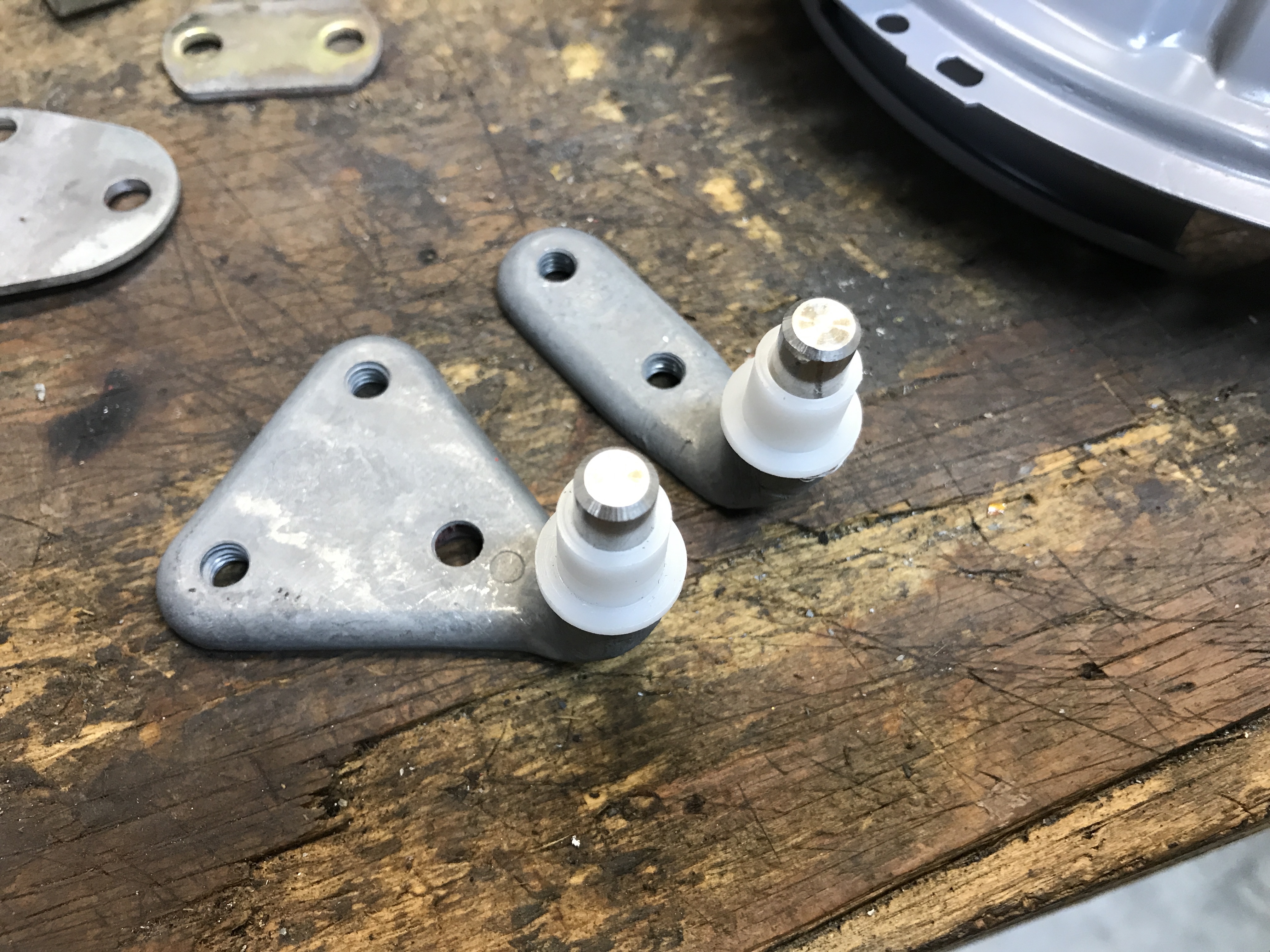

And and new plastic bushings from 914 Rubber.
bkrantz
Post #2089
Posts: 8,824
Joined: 3-August 19
From: SW Colorado
Member No.: 23,343

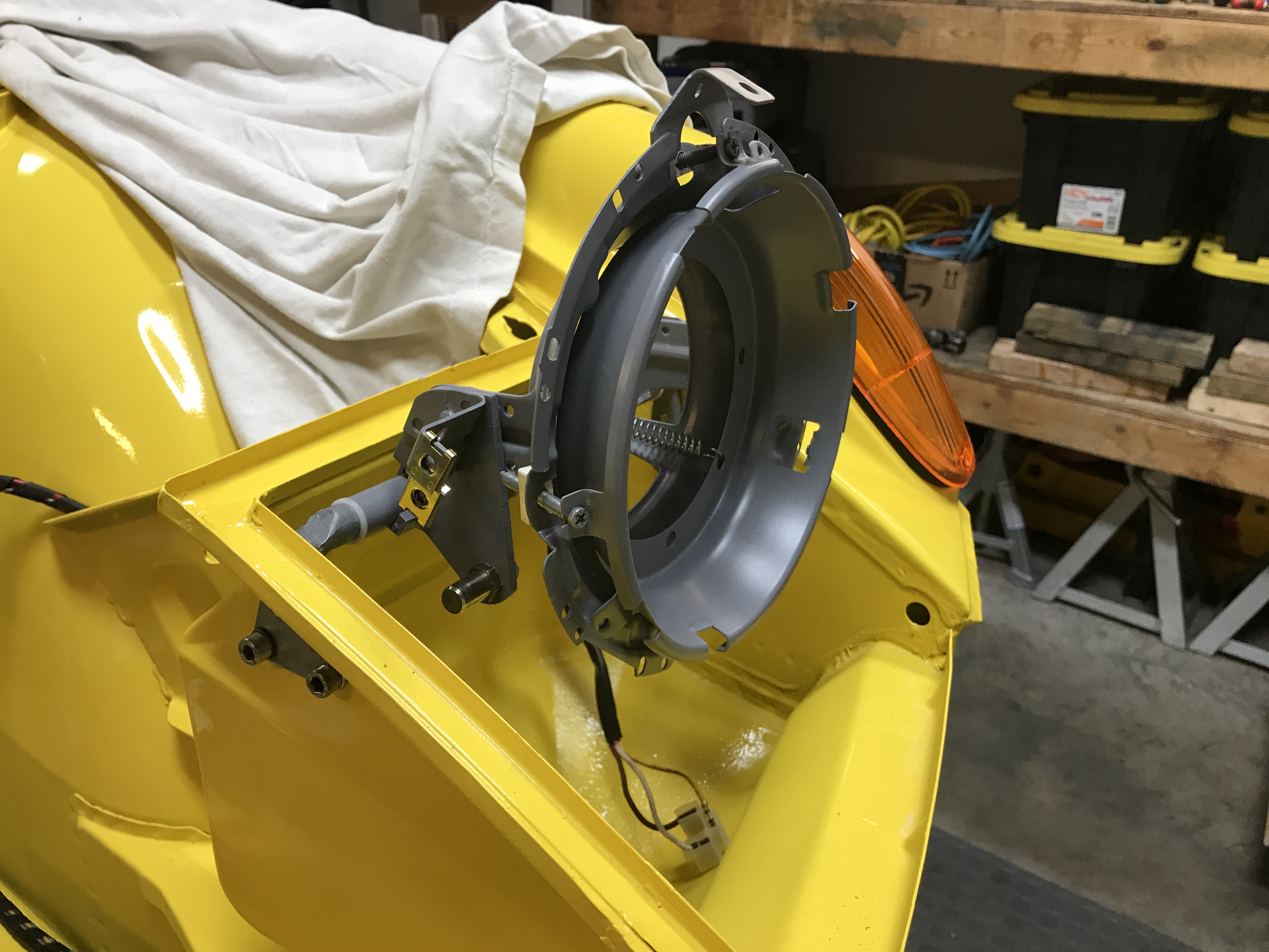

Carrier installed.

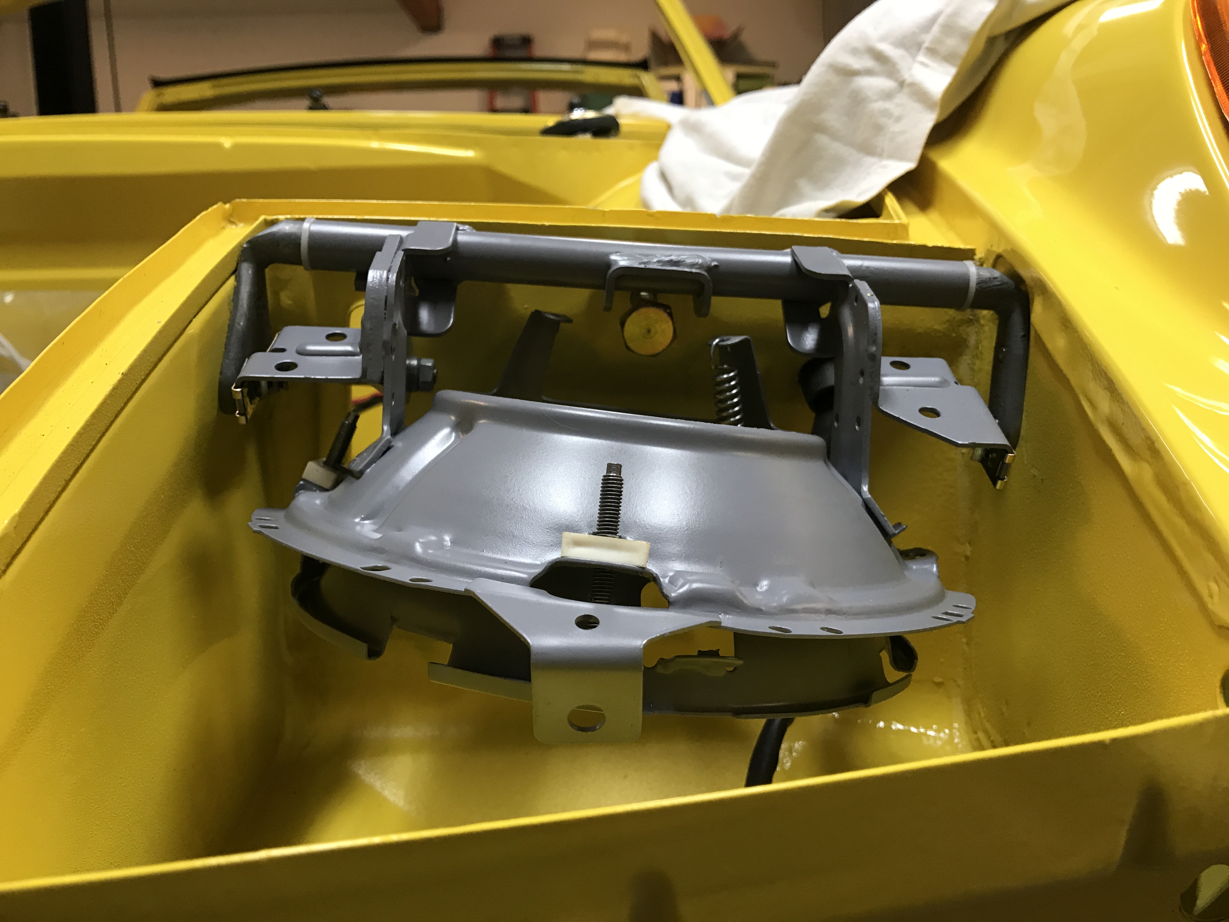

bkrantz
post Jan 25 2021, 08:23 PM
Post #2090
Posts: 8,824
Joined: 3-August 19
From: SW Colorado
Member No.: 23,343

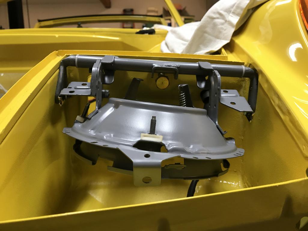

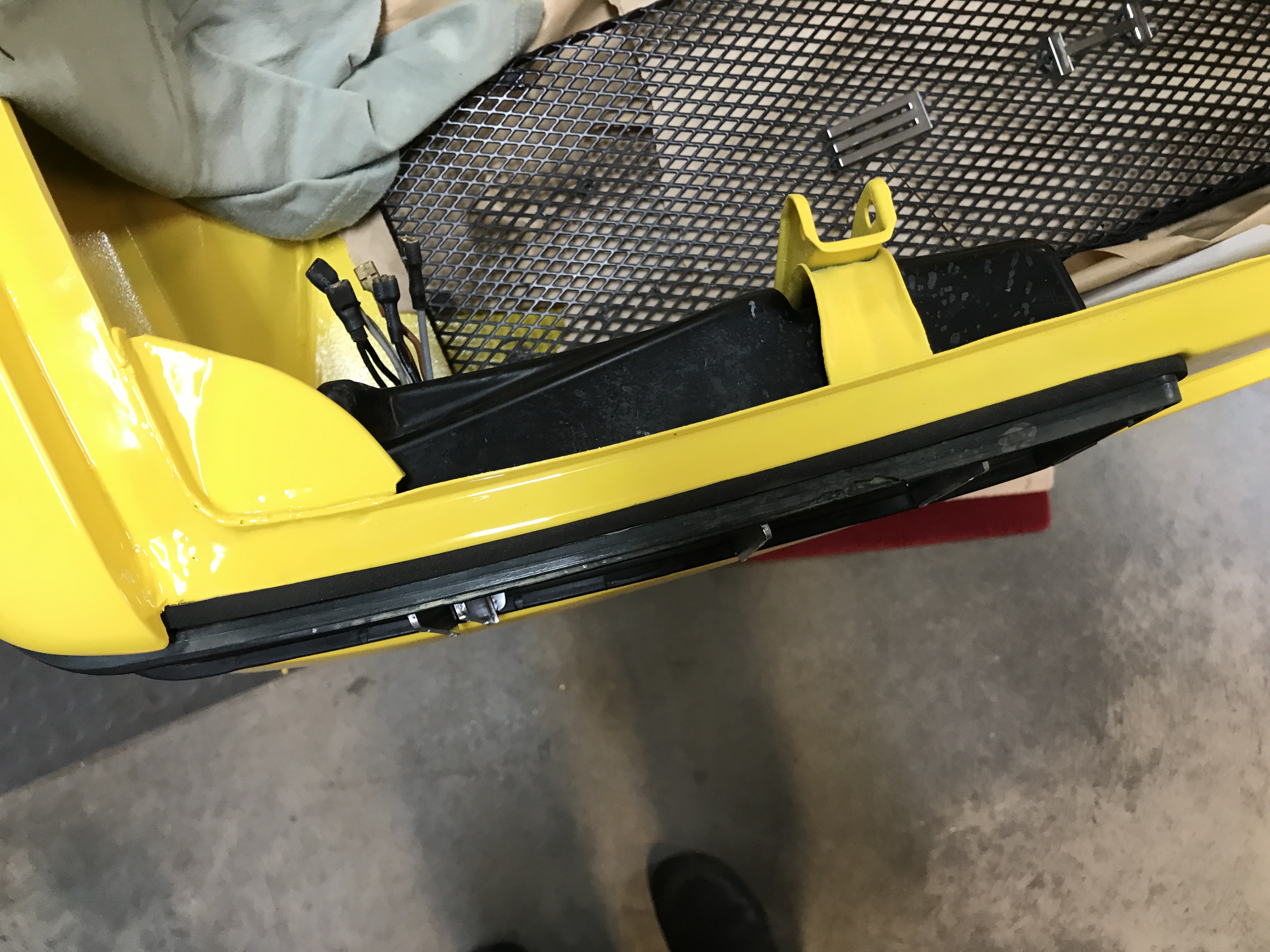

Not sure about this. The inside pivot looks high, even at the limit of adjustment on both sides. Is this right?
euro911
post Jan 25 2021, 09:26 PM
Post #2091
Posts: 8,951
Joined: 2-December 06
From: So.Cal. & No.AZ (USA)
Member No.: 7,300
Trial fit the pop-up lid and see how it lines up (IMG:style_emoticons/default/confused24.gif)

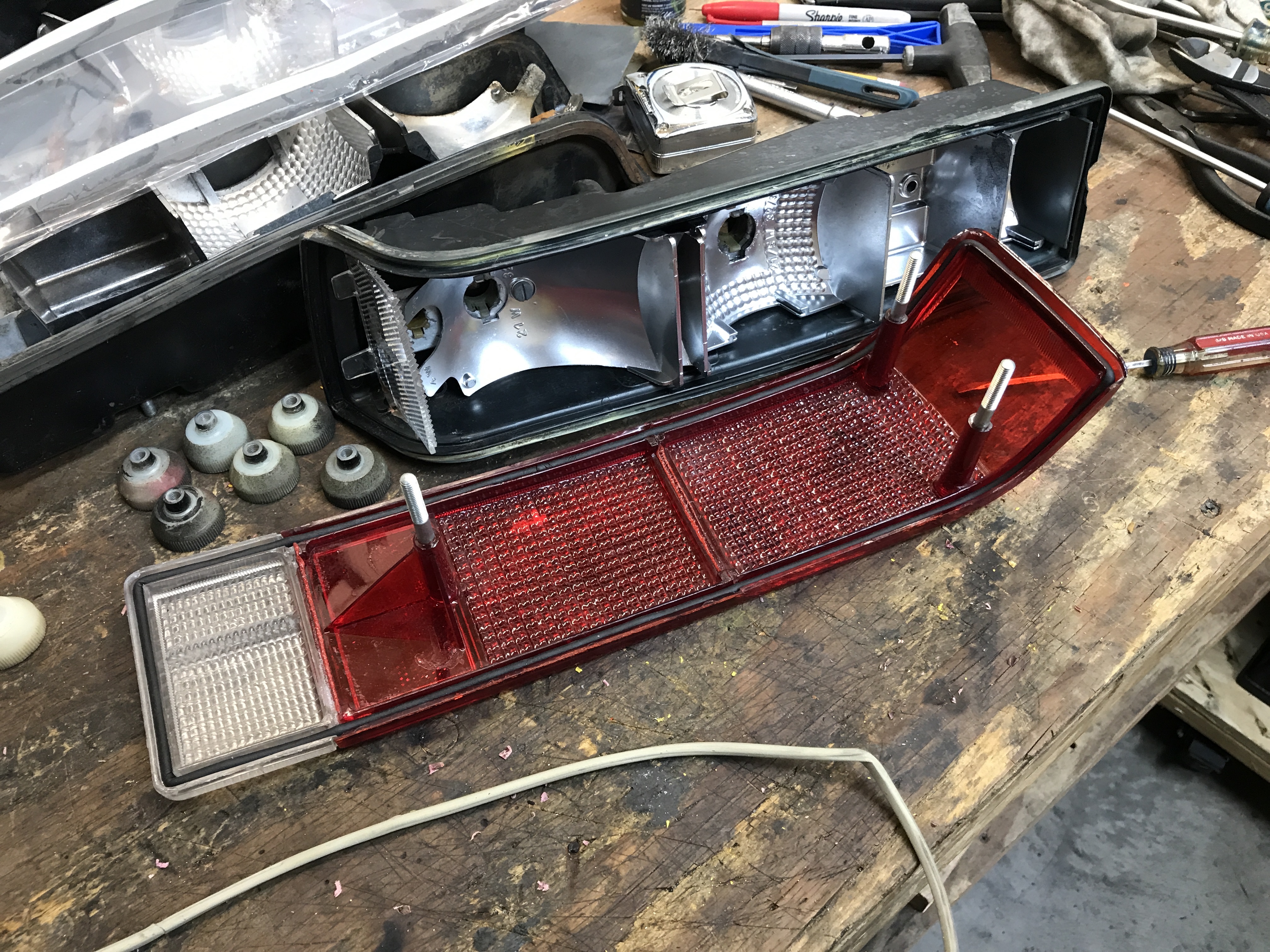

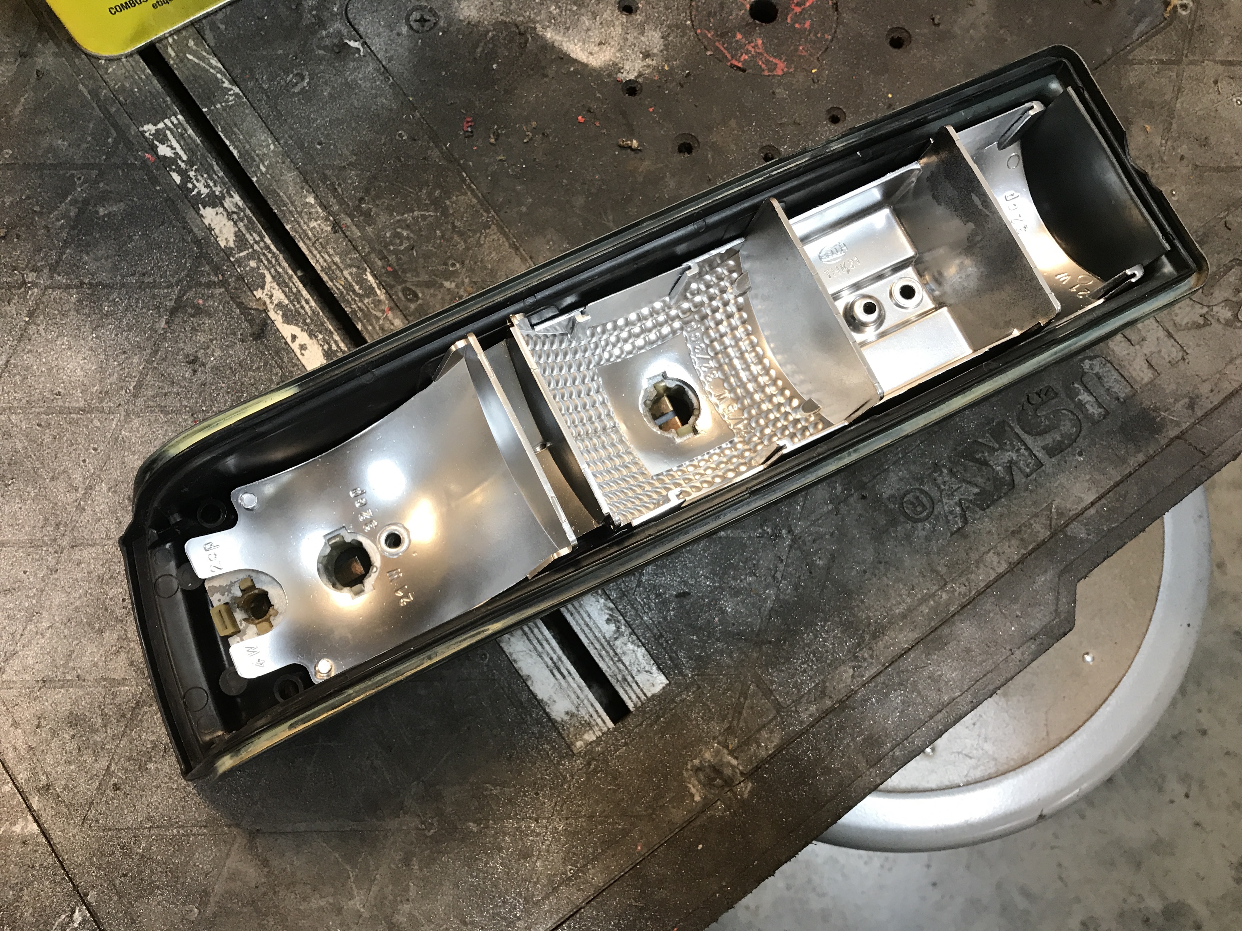

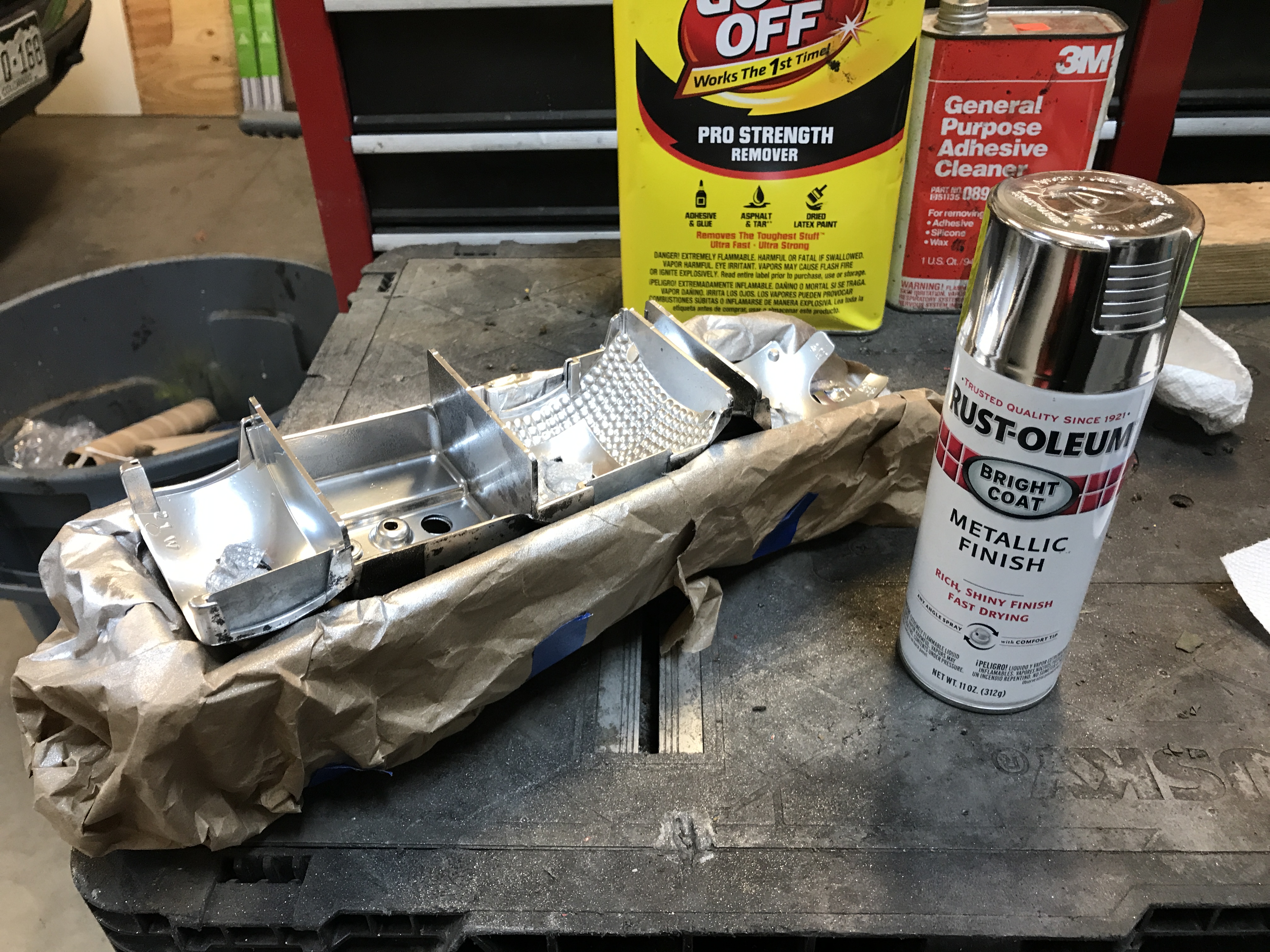

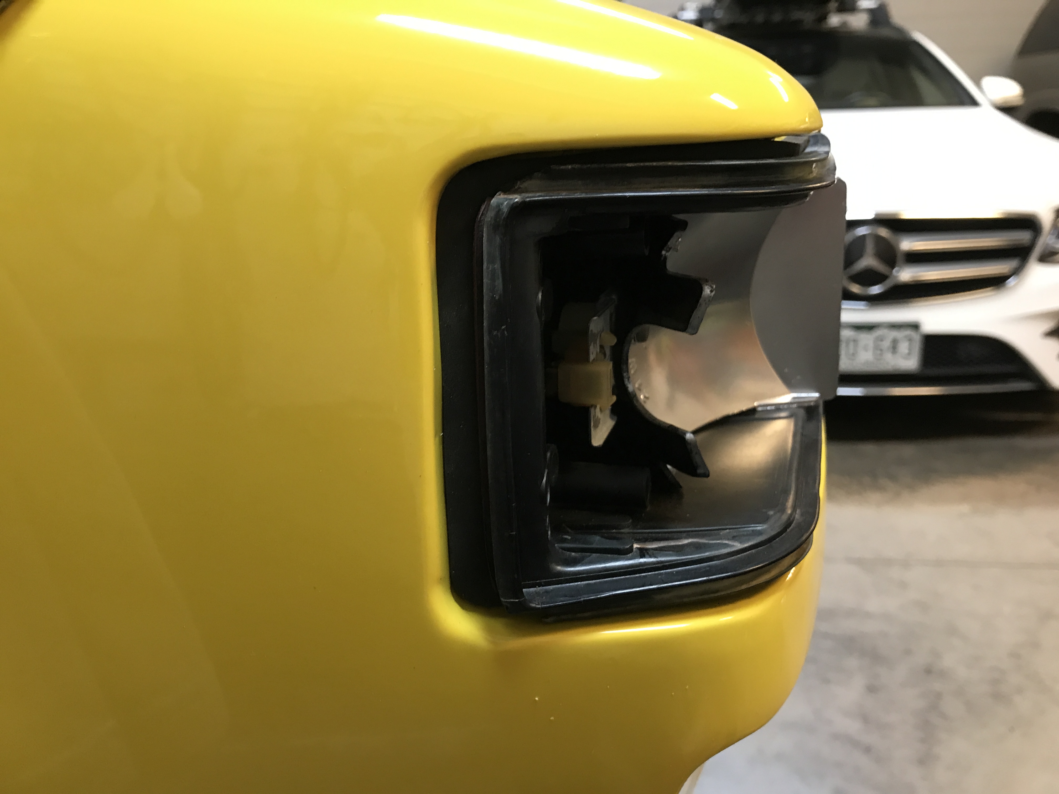

Tail light day.
Yesterday I finished de-corroding the replacement housing I got for the left side, especially the bulb contacts. And then I sprayed the reflectors with chrome paint.
bkrantz
post Jan 26 2021, 07:47 PM
Post #2093
Posts: 8,824
Joined: 3-August 19
From: SW Colorado
Member No.: 23,343
Looks better.
bkrantz
post Jan 26 2021, 07:49 PM
Post #2094
Posts: 8,824
Joined: 3-August 19
From: SW Colorado
Member No.: 23,343

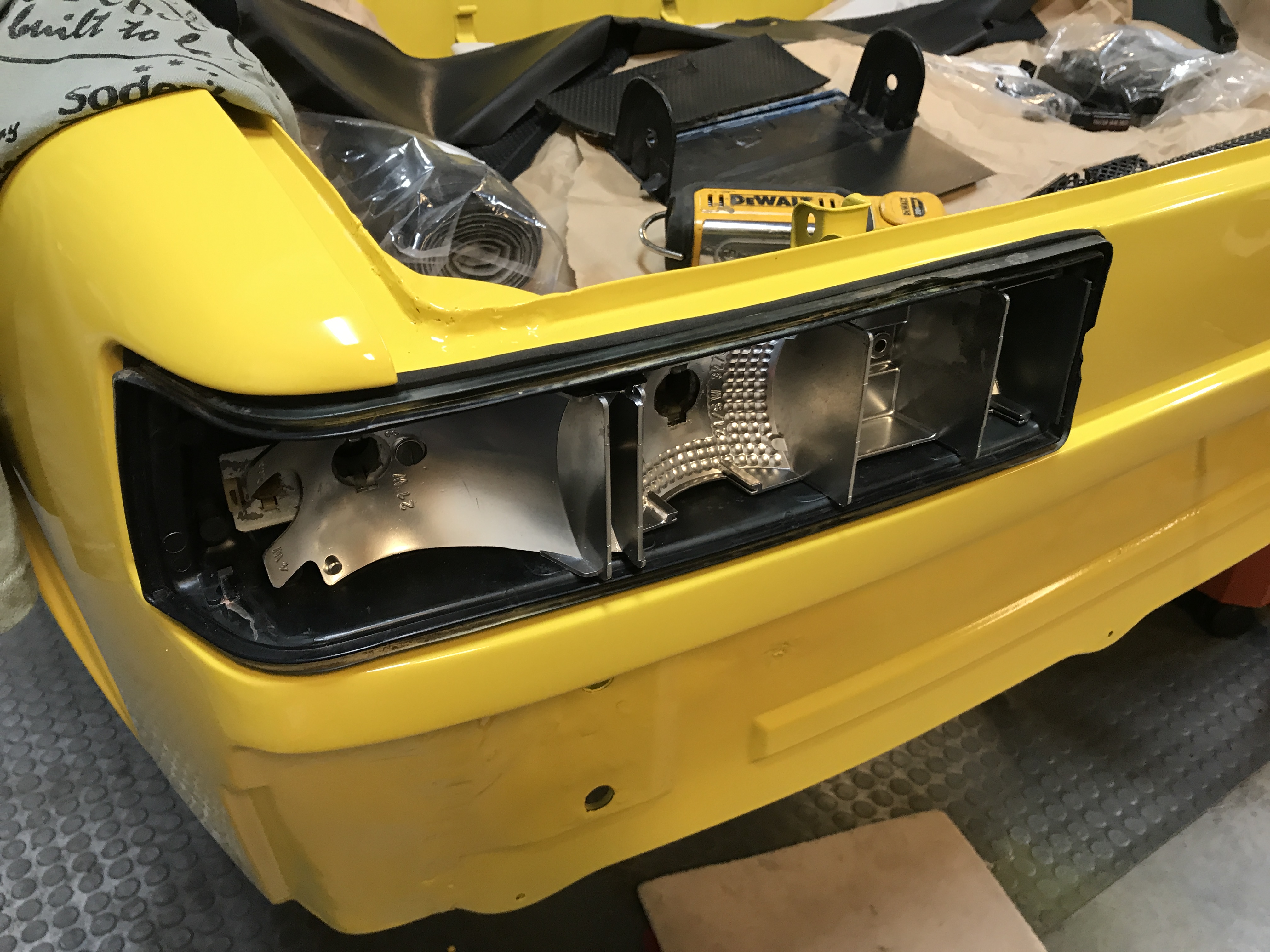

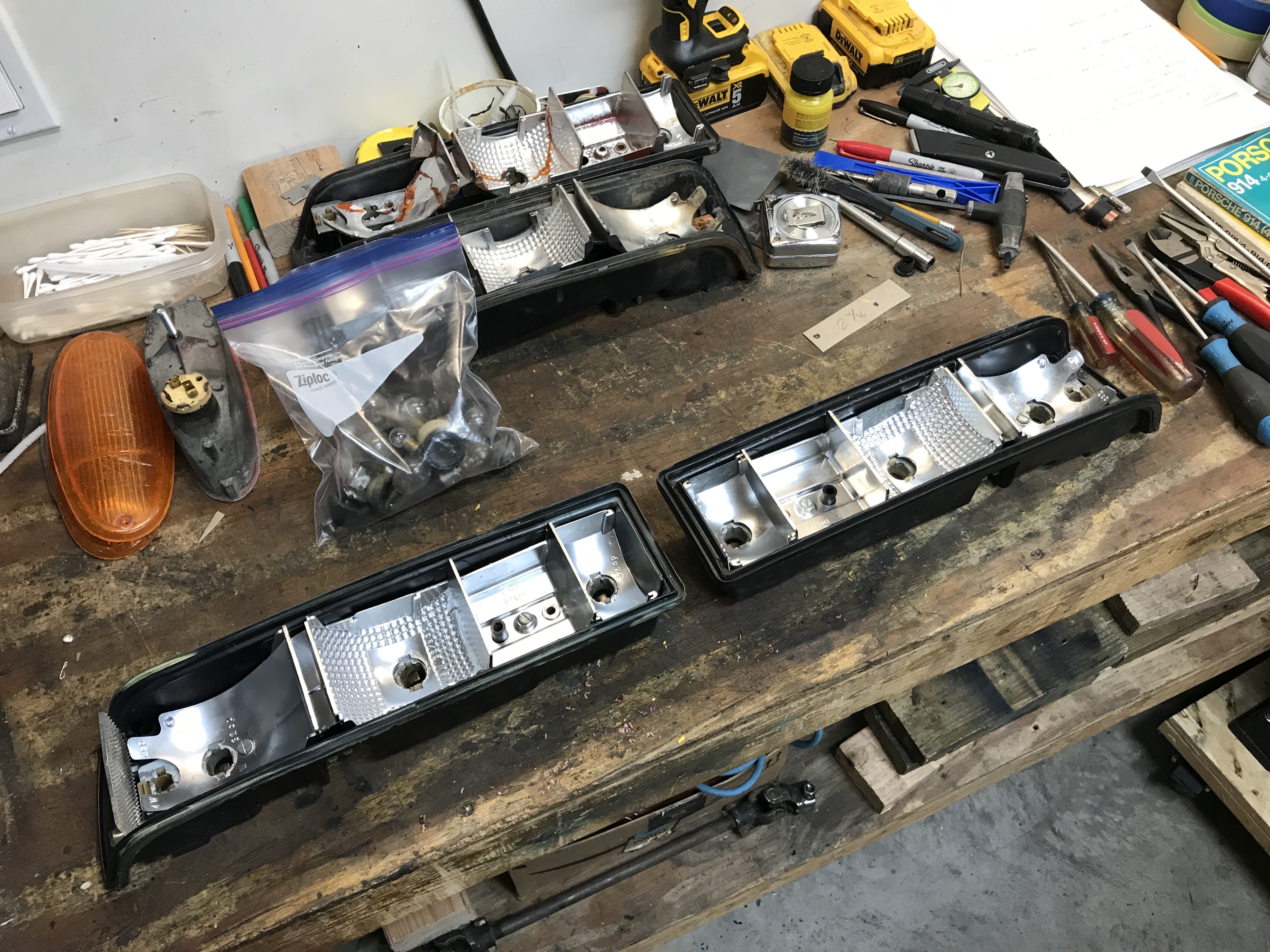

Both housings ready. Not perfect but pretty good. I need to find the side diffusor insert for the right side.

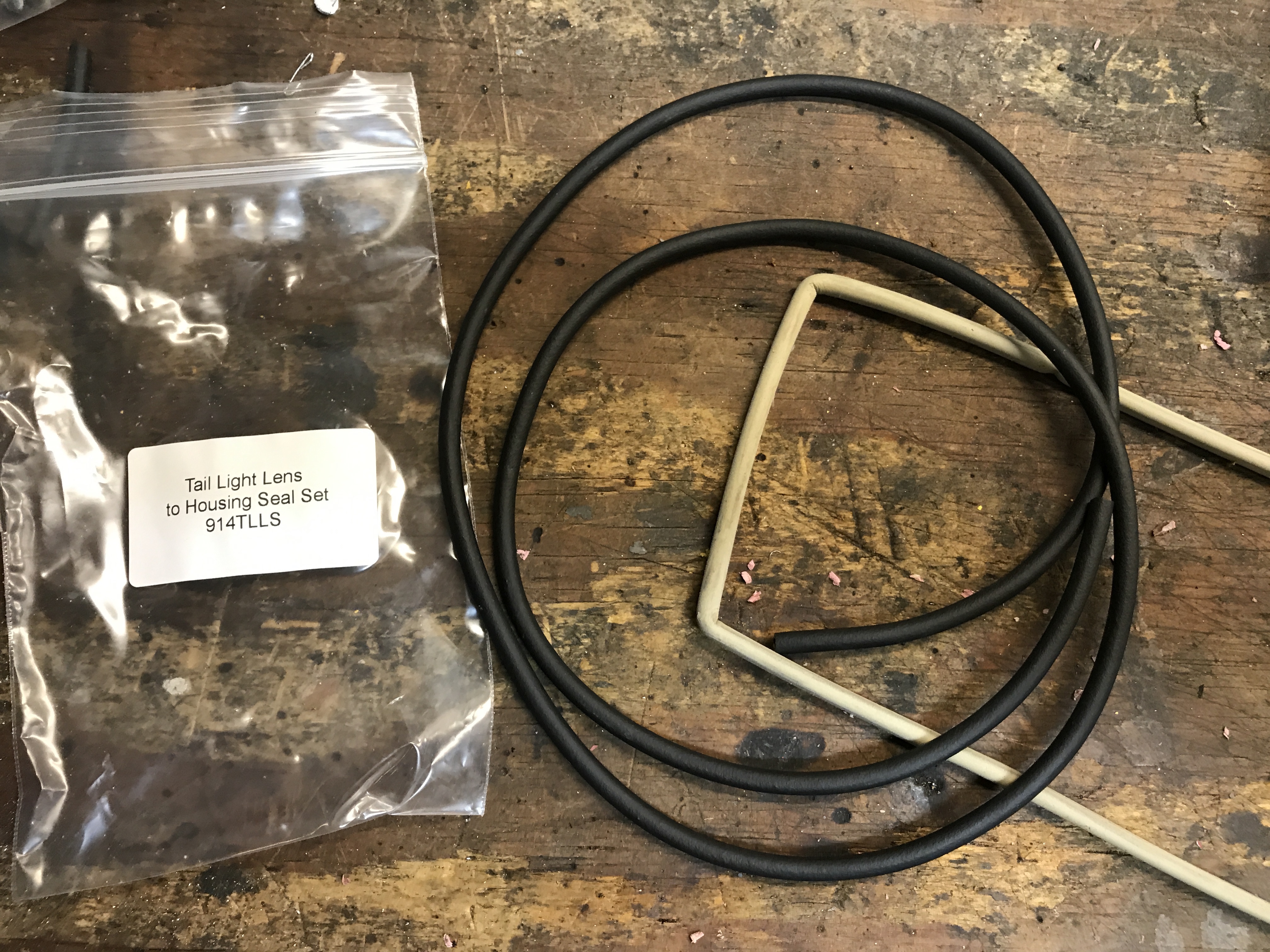

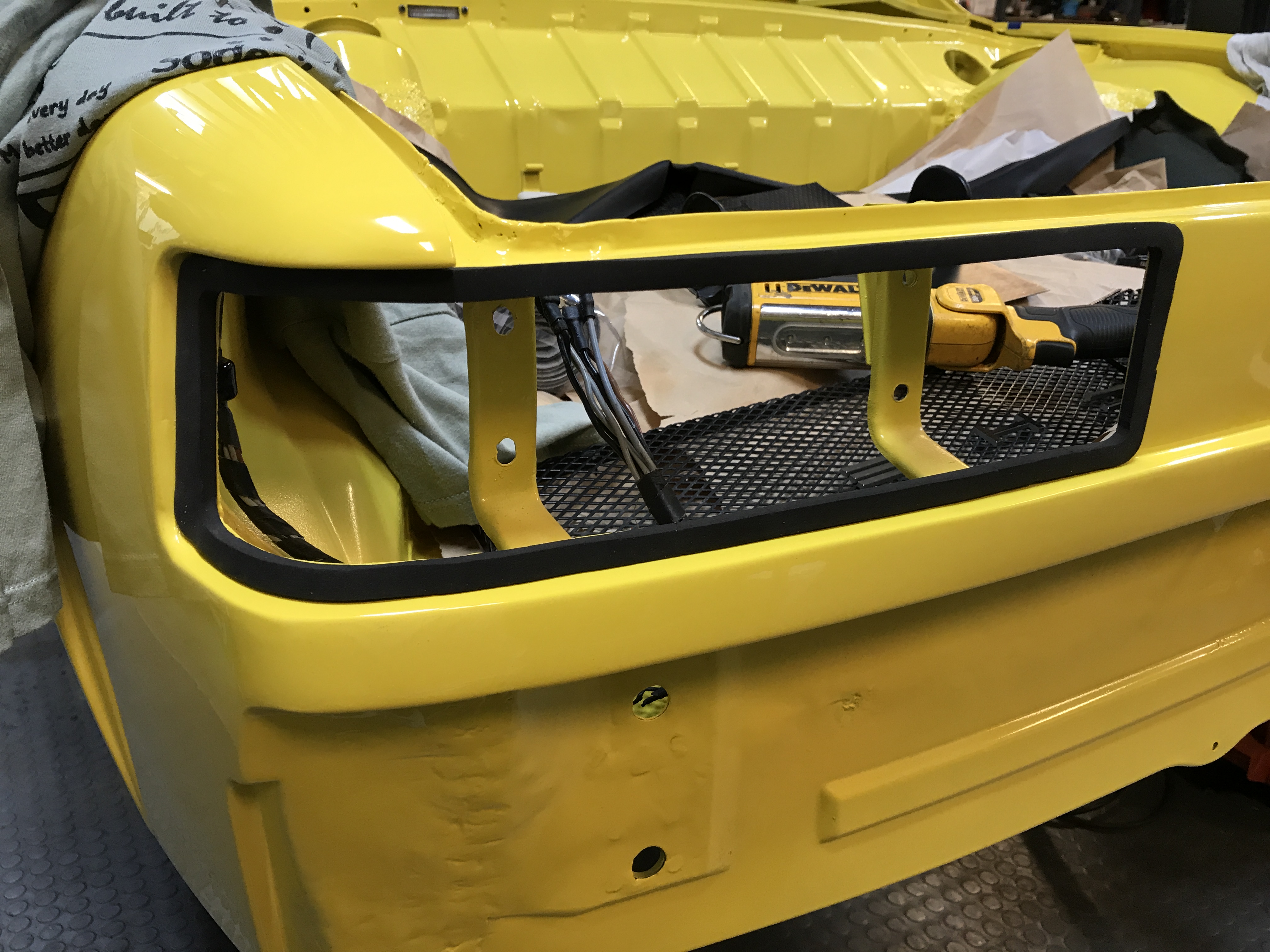

I hope to keep at least some water out, so I got replacement gaskets from 914 Rubber. The lens gasket is an O-section, similar in size and firmness to the original, but black instead of white.
bkrantz
post Jan 26 2021, 07:53 PM
Post #2096
Posts: 8,824
Joined: 3-August 19
From: SW Colorado
Member No.: 23,343
New gasket in the left lens--very easy.
bkrantz
post Jan 26 2021, 07:55 PM
Post #2097
Posts: 8,824
Joined: 3-August 19
From: SW Colorado
Member No.: 23,343
The gasket for the housing is actually a foam layer with adhesive. I mounted this around the body opening. My hand-formed opening is not perfect, so this helps fill the gaps.
bkrantz
post Jan 26 2021, 07:57 PM
Post #2098
Posts: 8,824
Joined: 3-August 19
From: SW Colorado
Member No.: 23,343
I left the original gasket in place on the housing.
bkrantz
post Jan 26 2021, 07:58 PM
Post #2099
Posts: 8,824
Joined: 3-August 19
From: SW Colorado
Member No.: 23,343
From above, decent fit with no gaps.
bkrantz
post Jan 26 2021, 07:59 PM
Post #2100
Posts: 8,824
Joined: 3-August 19
From: SW Colorado
Member No.: 23,343
Also OK from the side. I expect the foam gasket will collapse a bit more with time.
