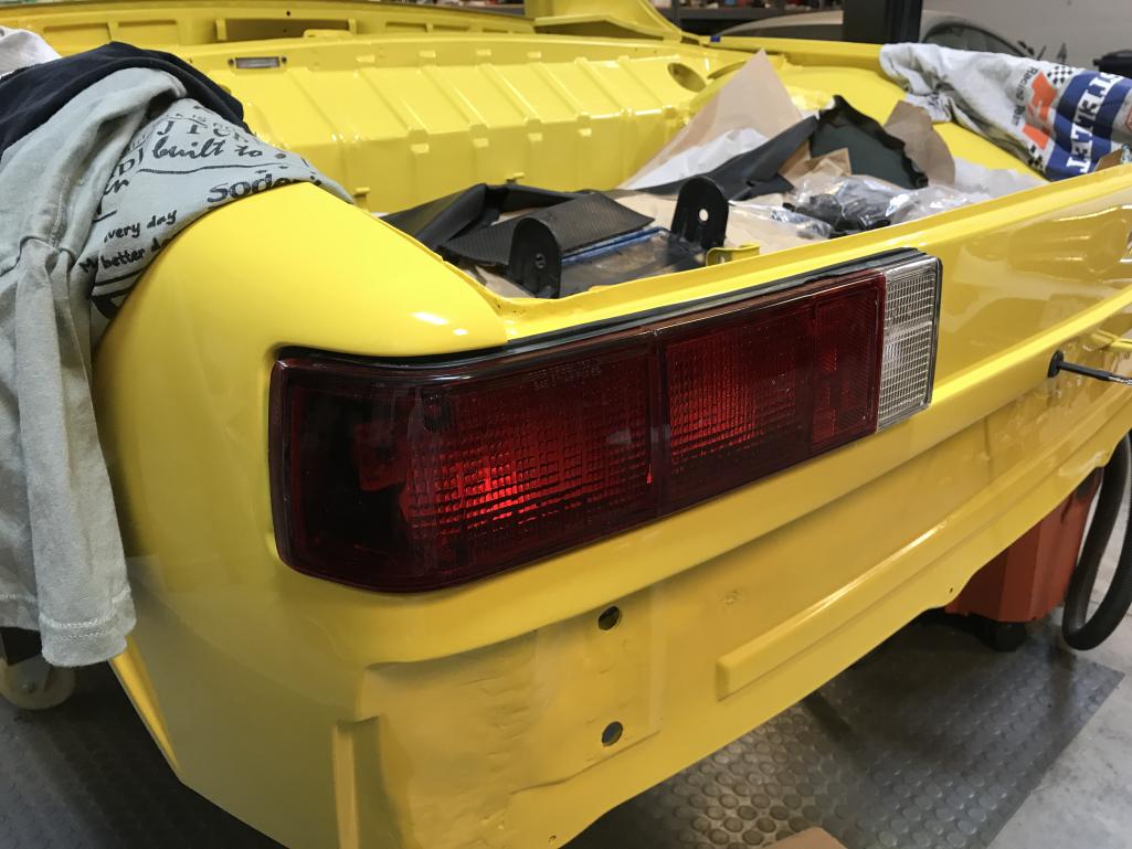

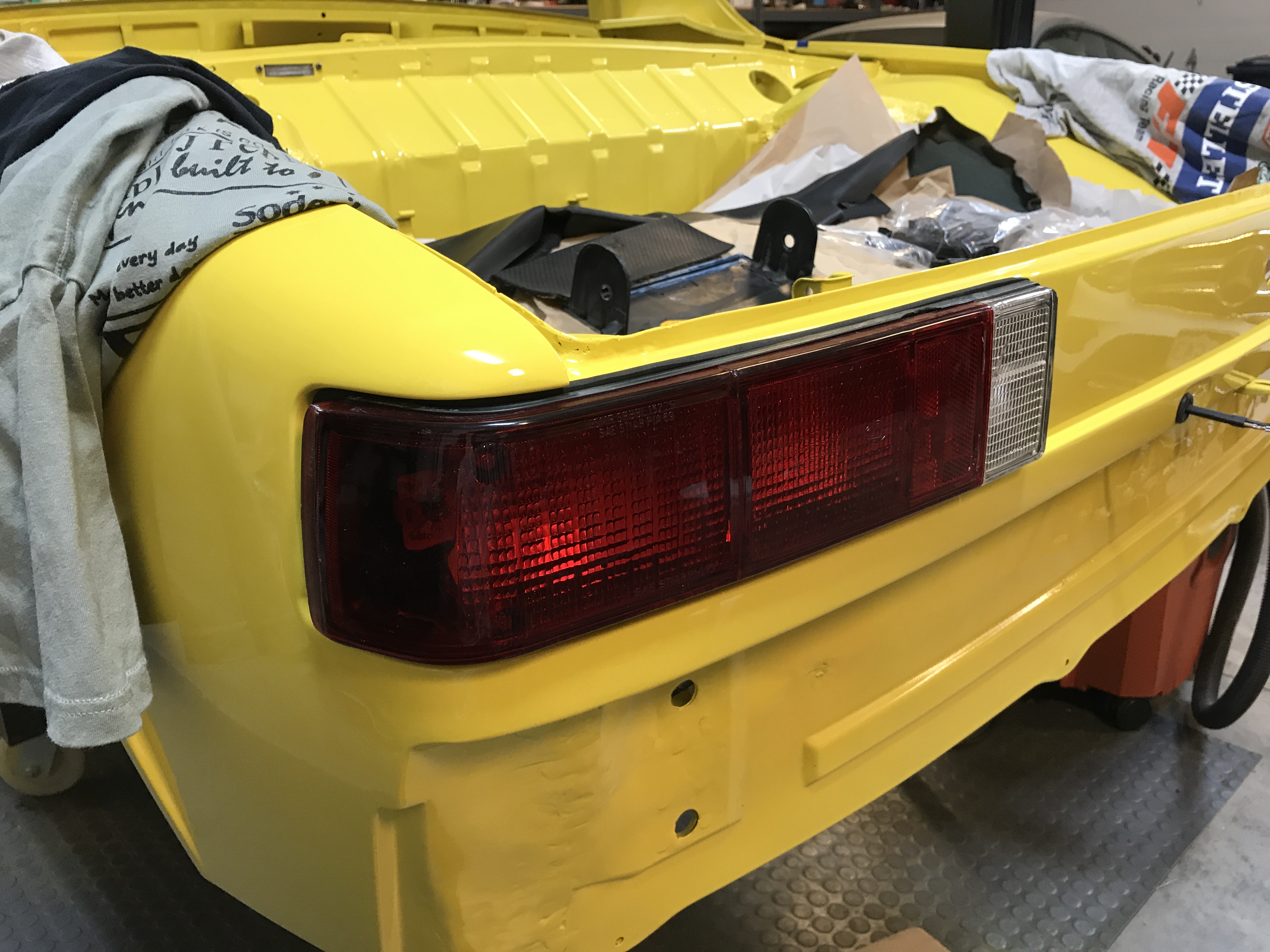

Looks good with the lens in place.

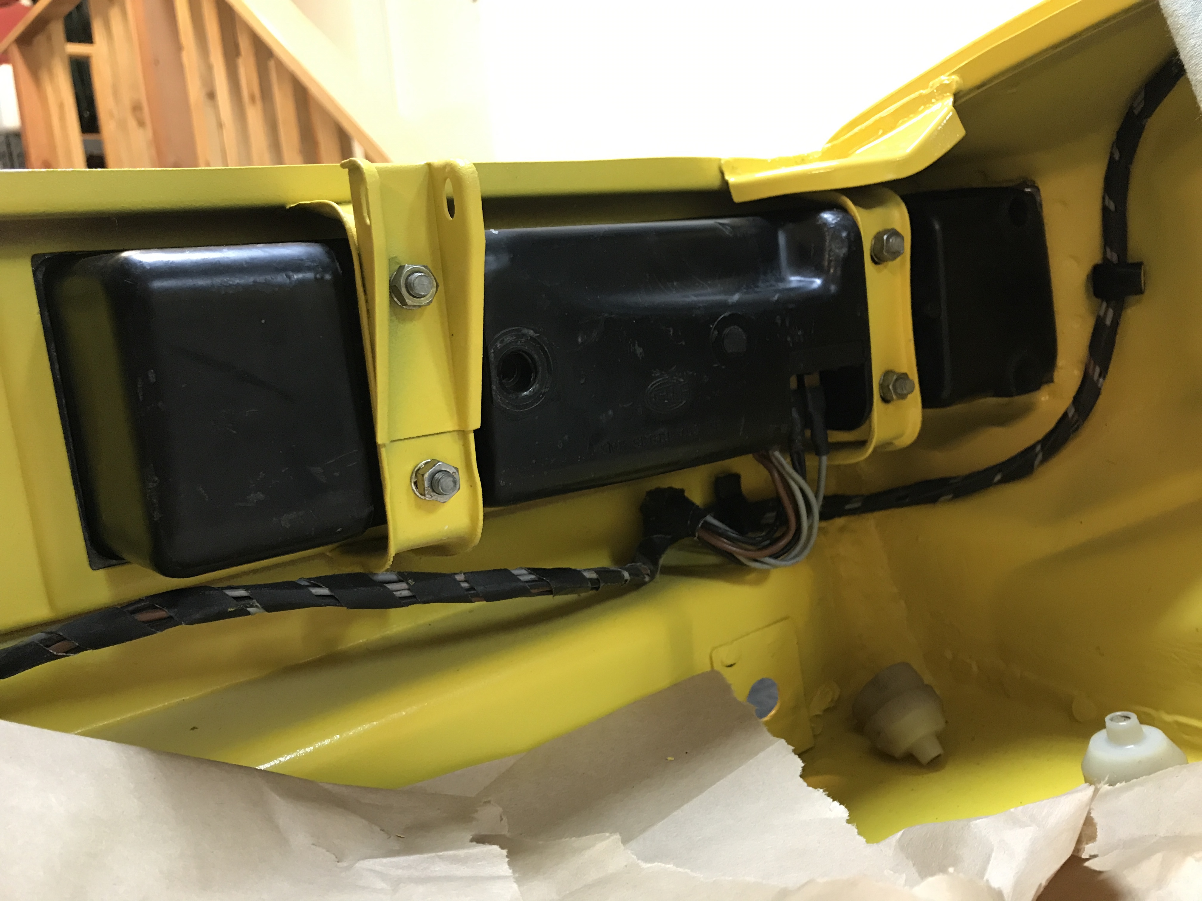

And the inside, too, with the wires connected. I had some challenge deciding which gray wire was which since the stripes on both gray wires were pretty much gone.

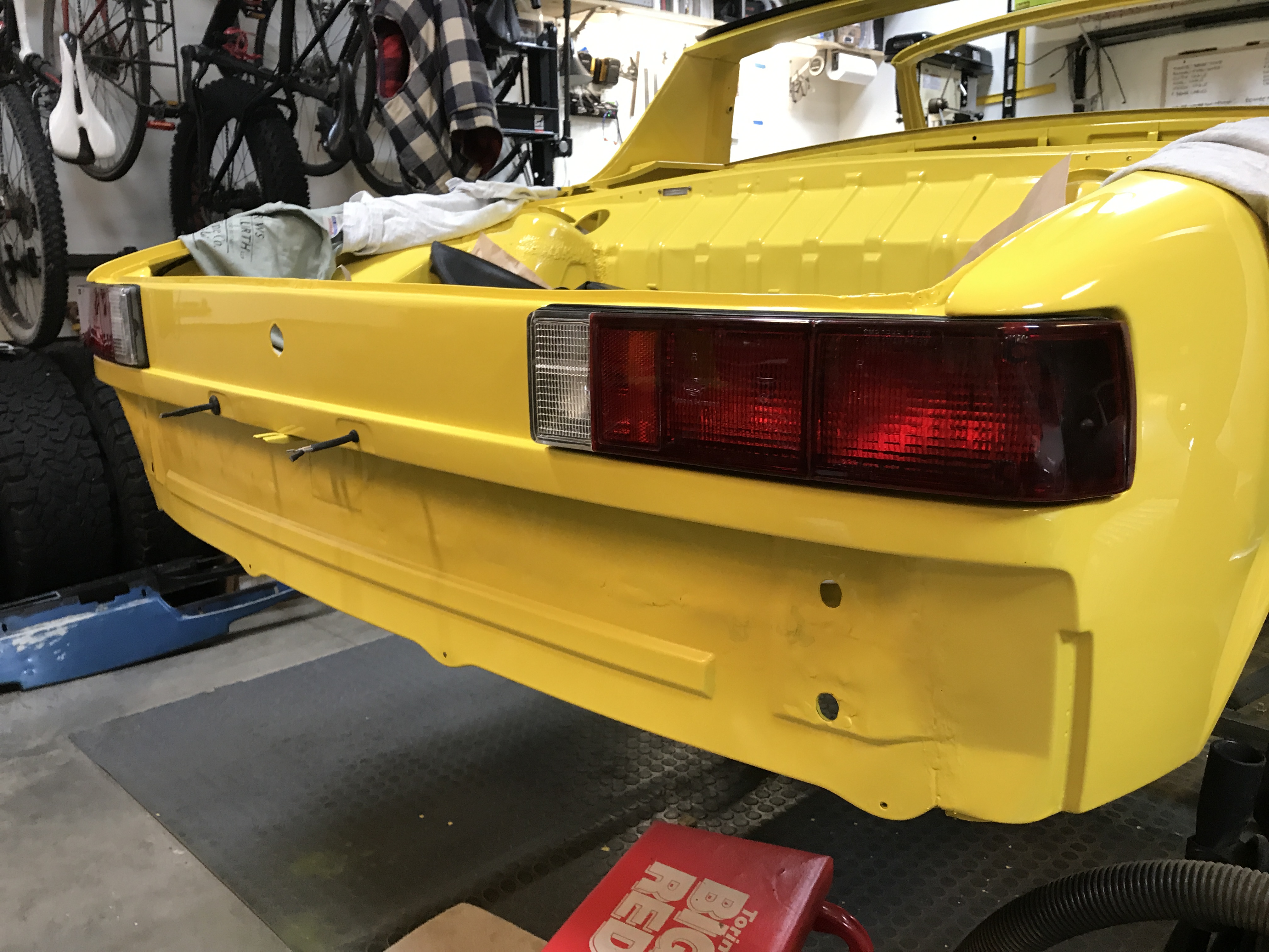

Right side, too.

Looks a bit more like a car.

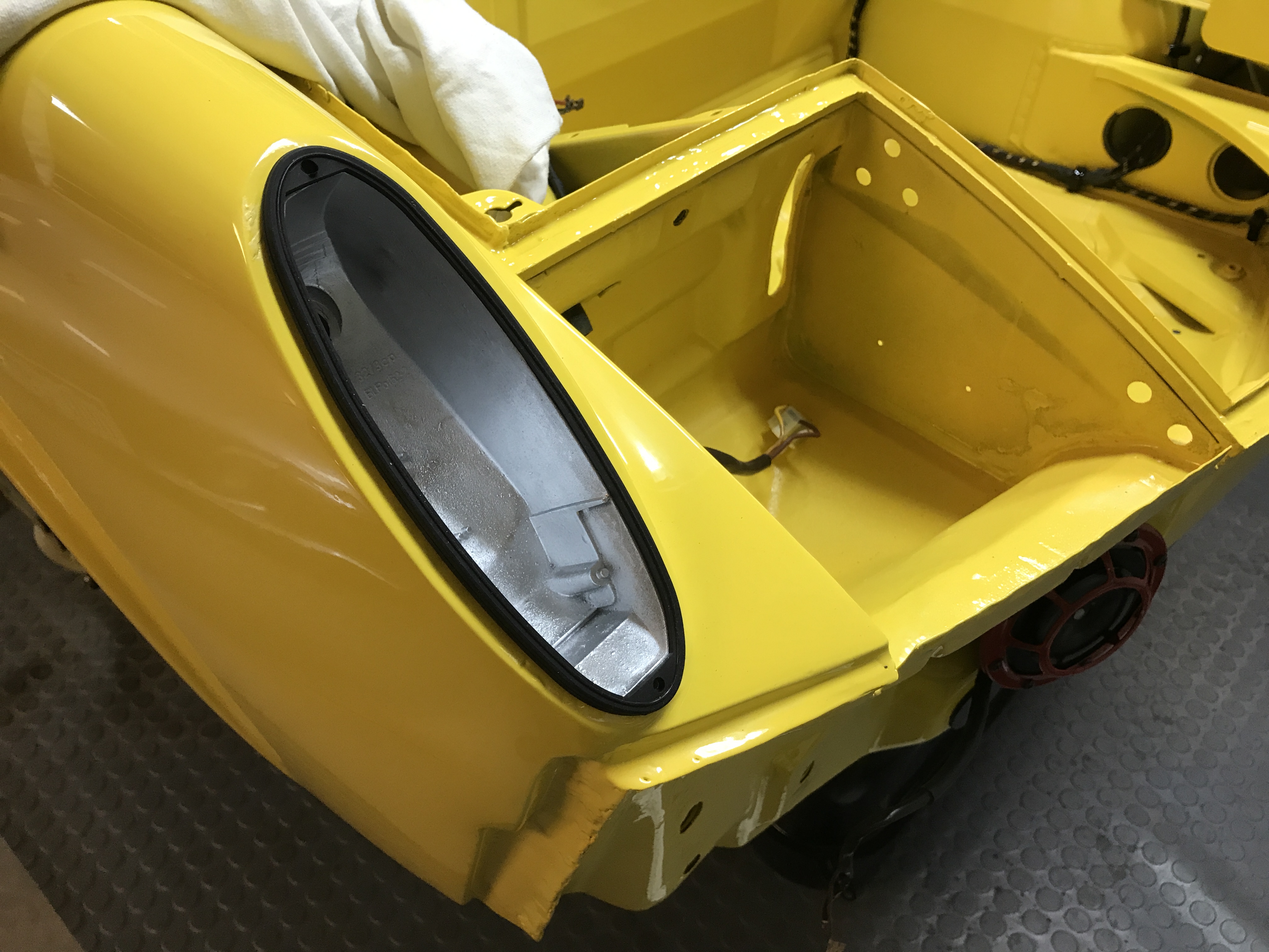

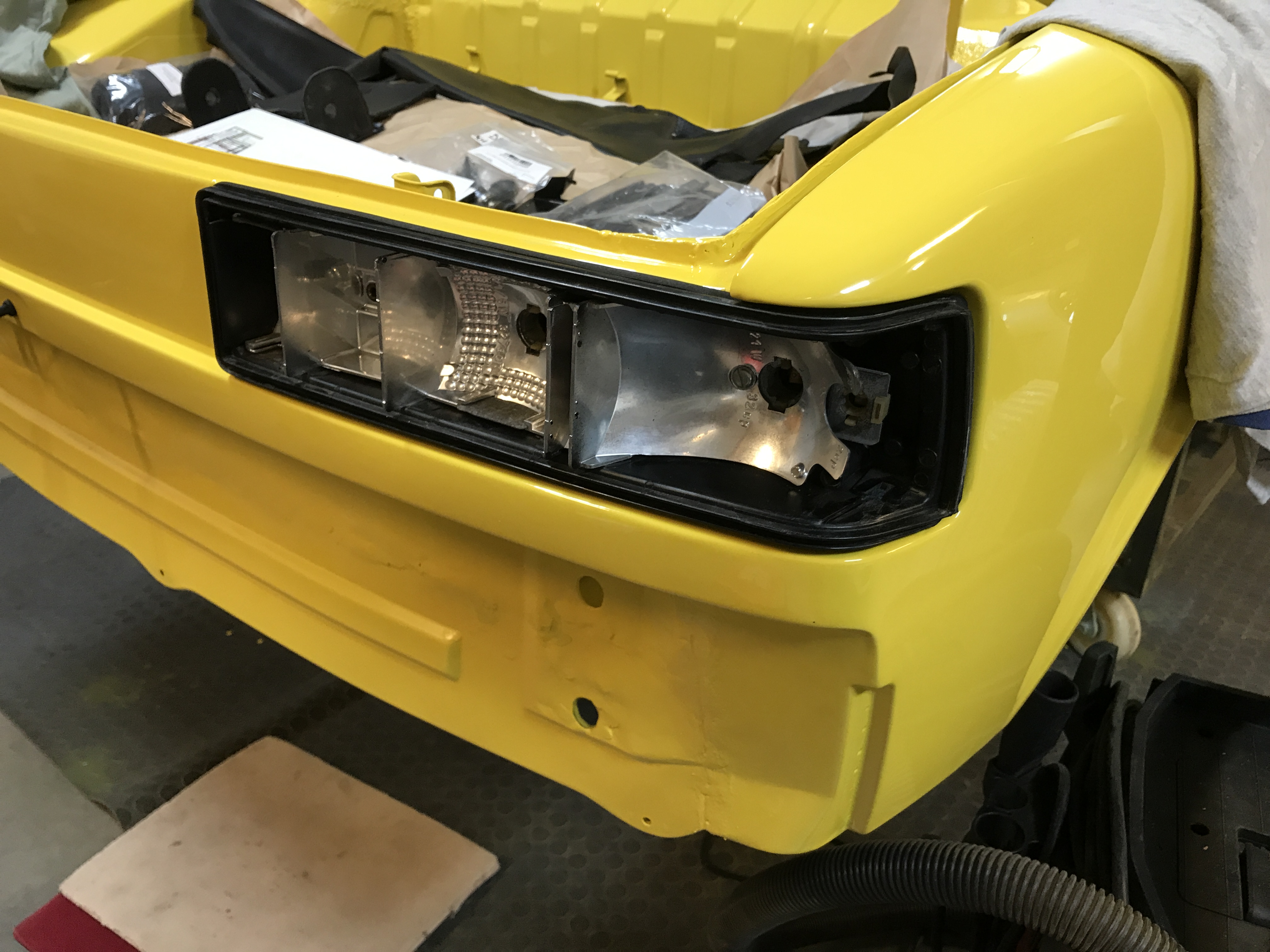

And I got the front right turn signal bucket installed and connected. As soon as I get the right screws I will install the lens.

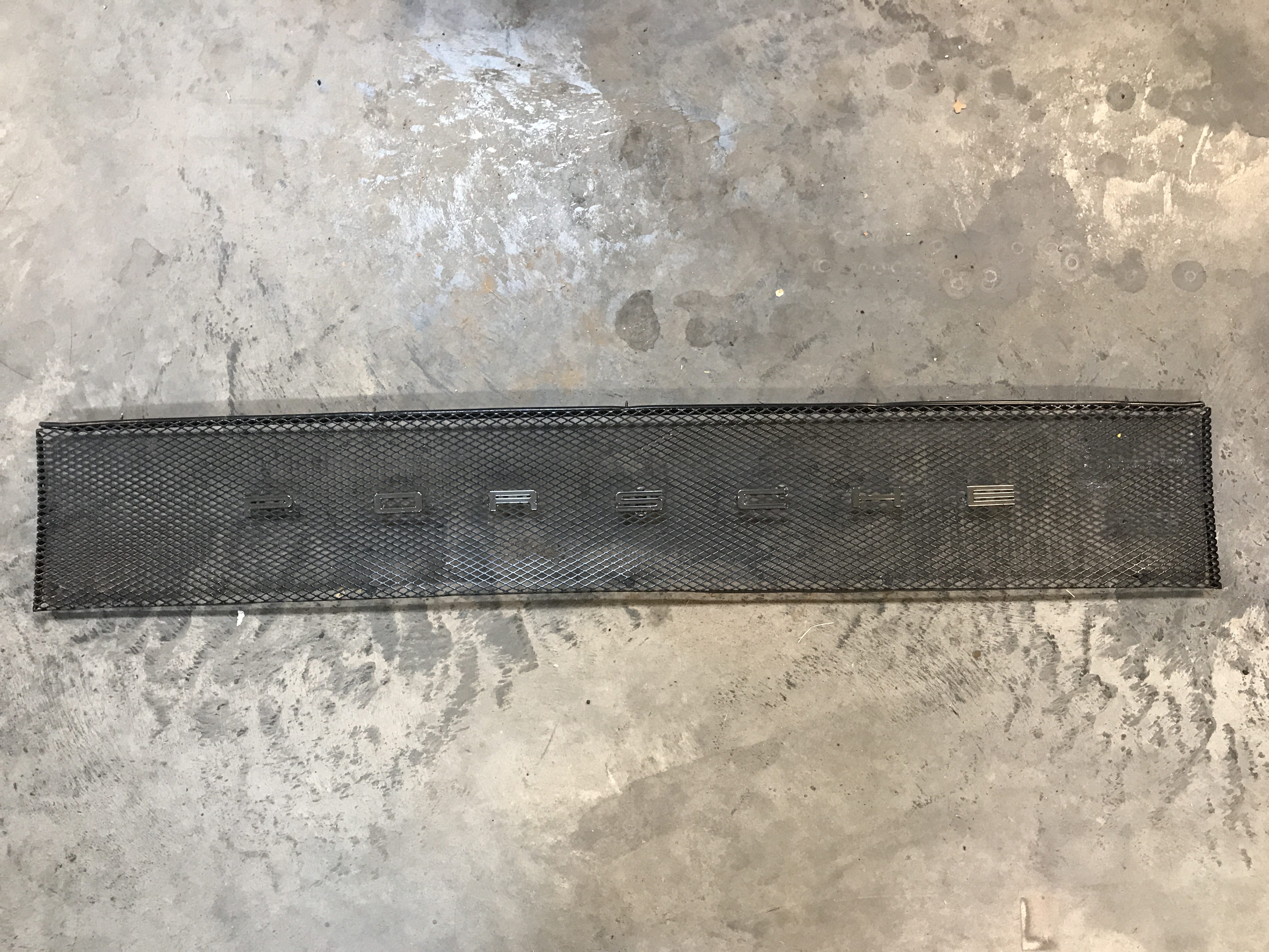

Getting ready to take another batch of parts to the powder coat shop. I will have them do the engine lid and side panels in satin black. Of course, in removing the letters I broke off a couple of studs.

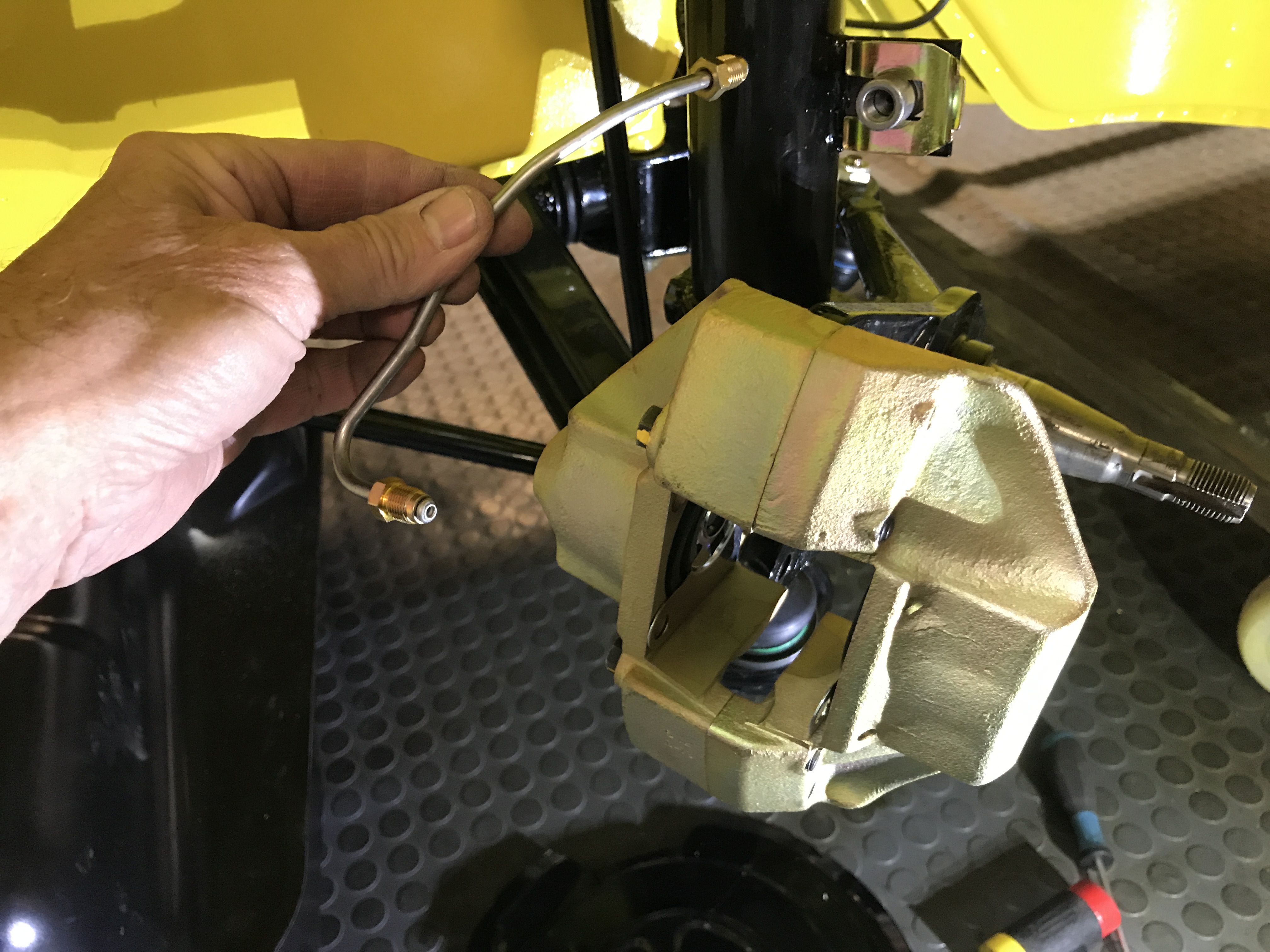

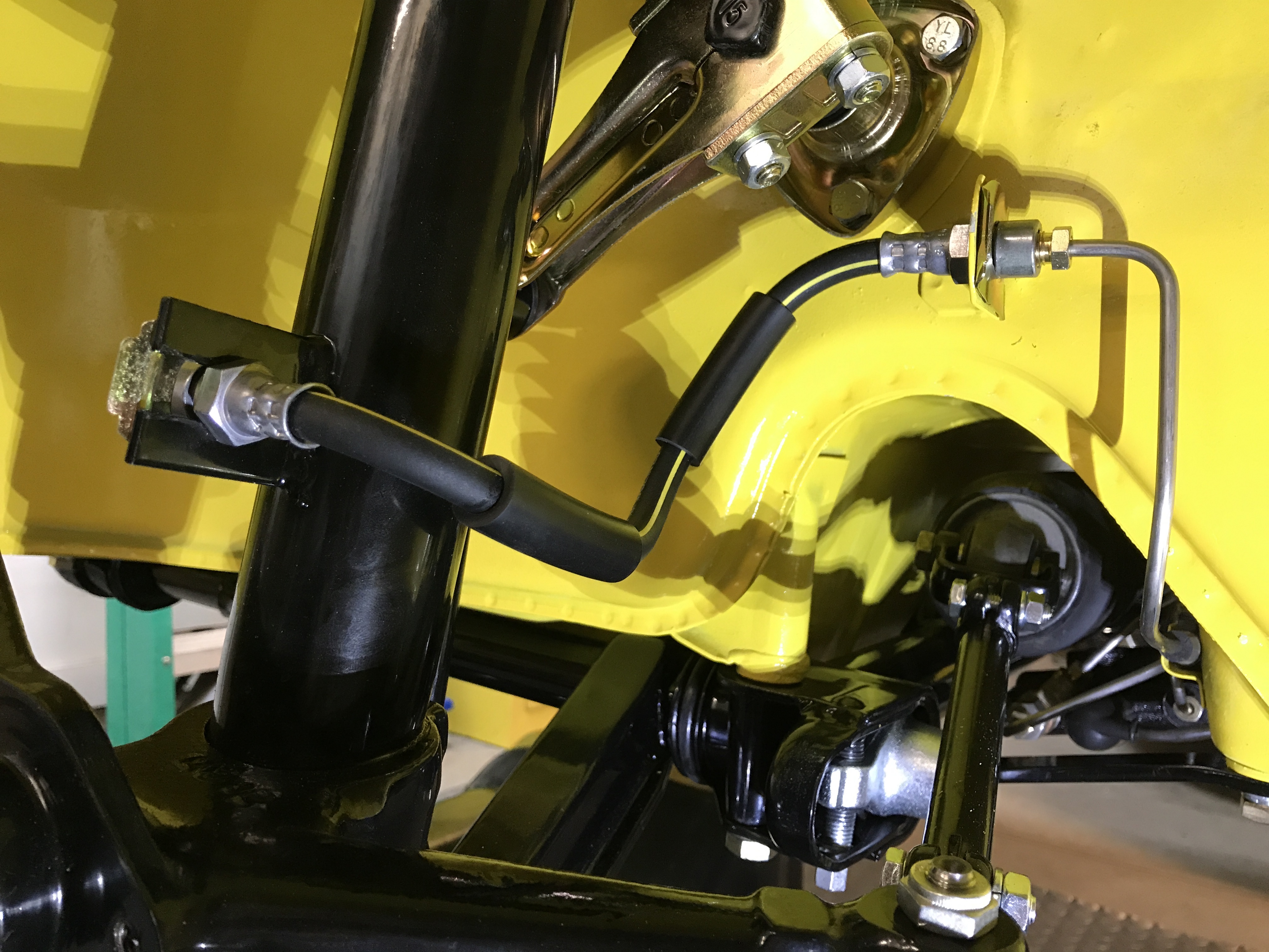

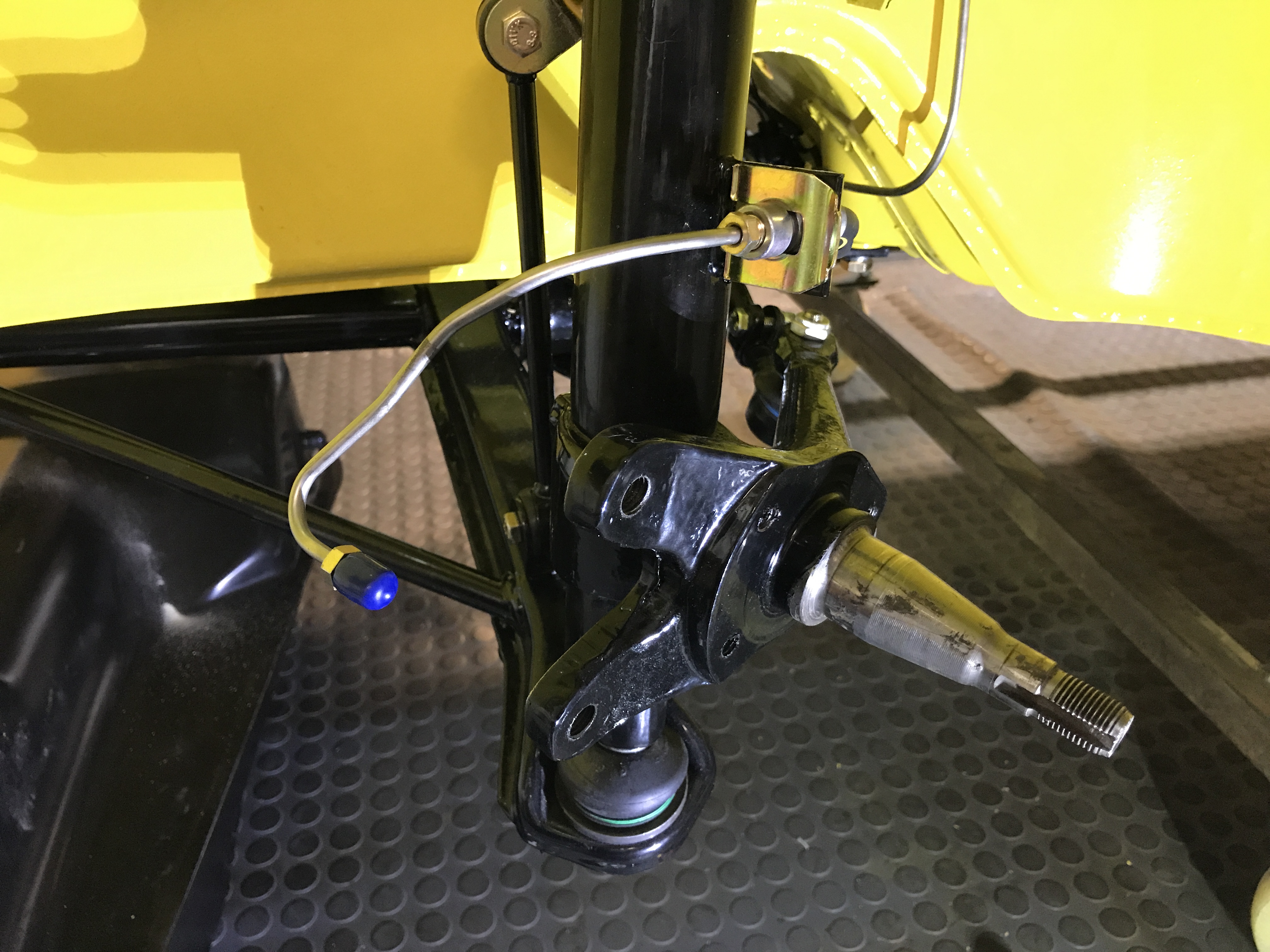

Another different task: back to the front brakes. I installed the flex lines.

And then mounted the calipers temporarily so I could adjust the fit of the hard line.

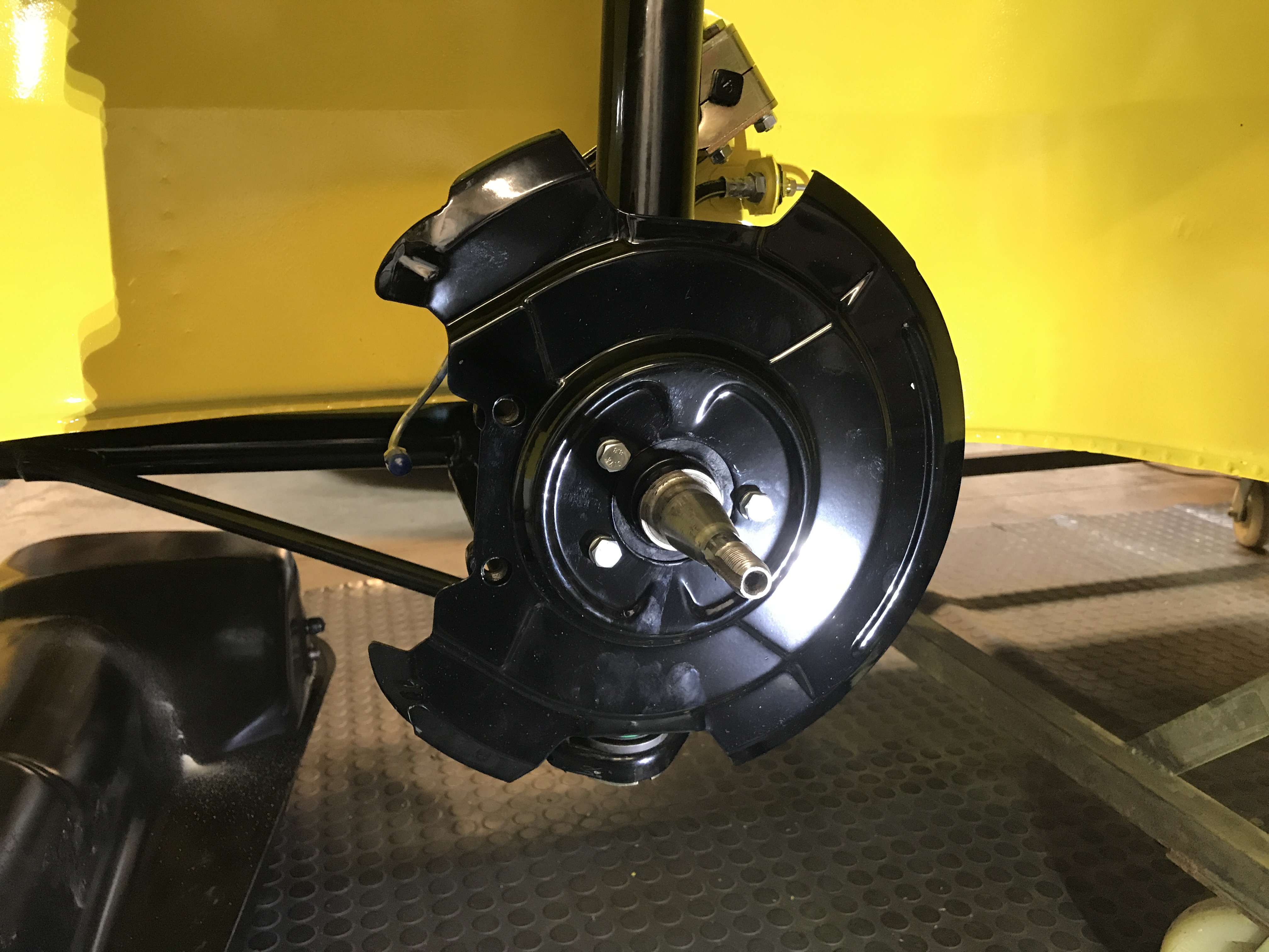

Fit done, caliper removed.

And backing plate installed.

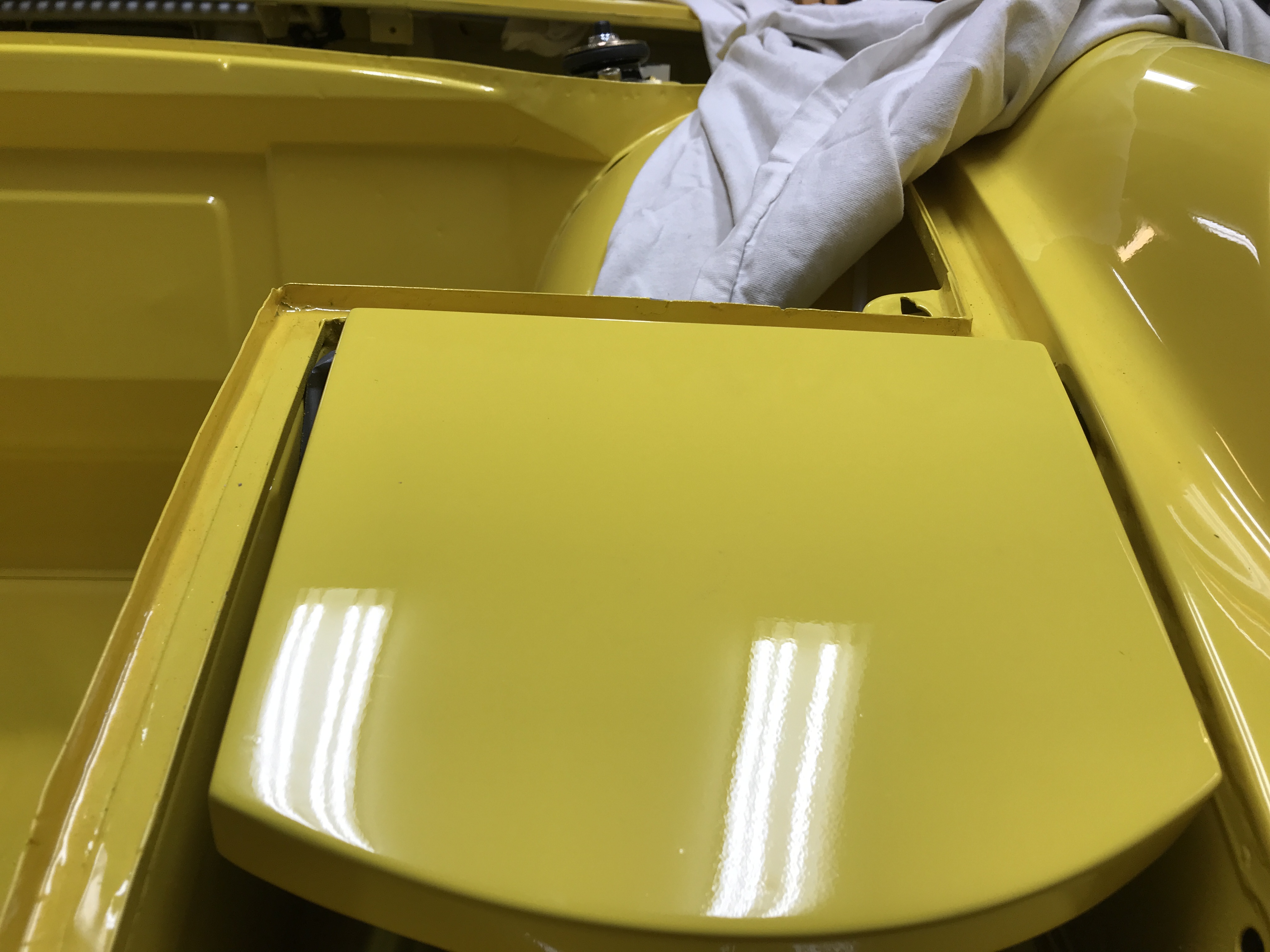

QUOTE(euro911 @ Jan 25 2021, 08:26 PM) *
Trial fit the pop-up lid and see how it lines up (IMG:style_emoticons/default/confused24.gif)
Good idea, Mark. Here's how it looks--probably OK.

QUOTE(bkrantz @ Jan 27 2021, 09:30 PM) *
Funny how in sync our builds are. I'm just finishing up a video on this. I now not only have car-envy, but gap envy as well. your car is super straight. As you know by now, those brackets have a little play in them so you can line things up. Check the gap against the hood in the down position as well. Also put the brow in and make sure there's enough clearance before tightening the brackets.

QUOTE(iankarr @ Jan 28 2021, 11:34 AM) *
Good idea on checking the gaps with the eyebrows. But the real test will be on the right side where I replaced the headlight bucket and front half of the inner fender. Once I get the missing pivot I can install the headlight carrier and check.
