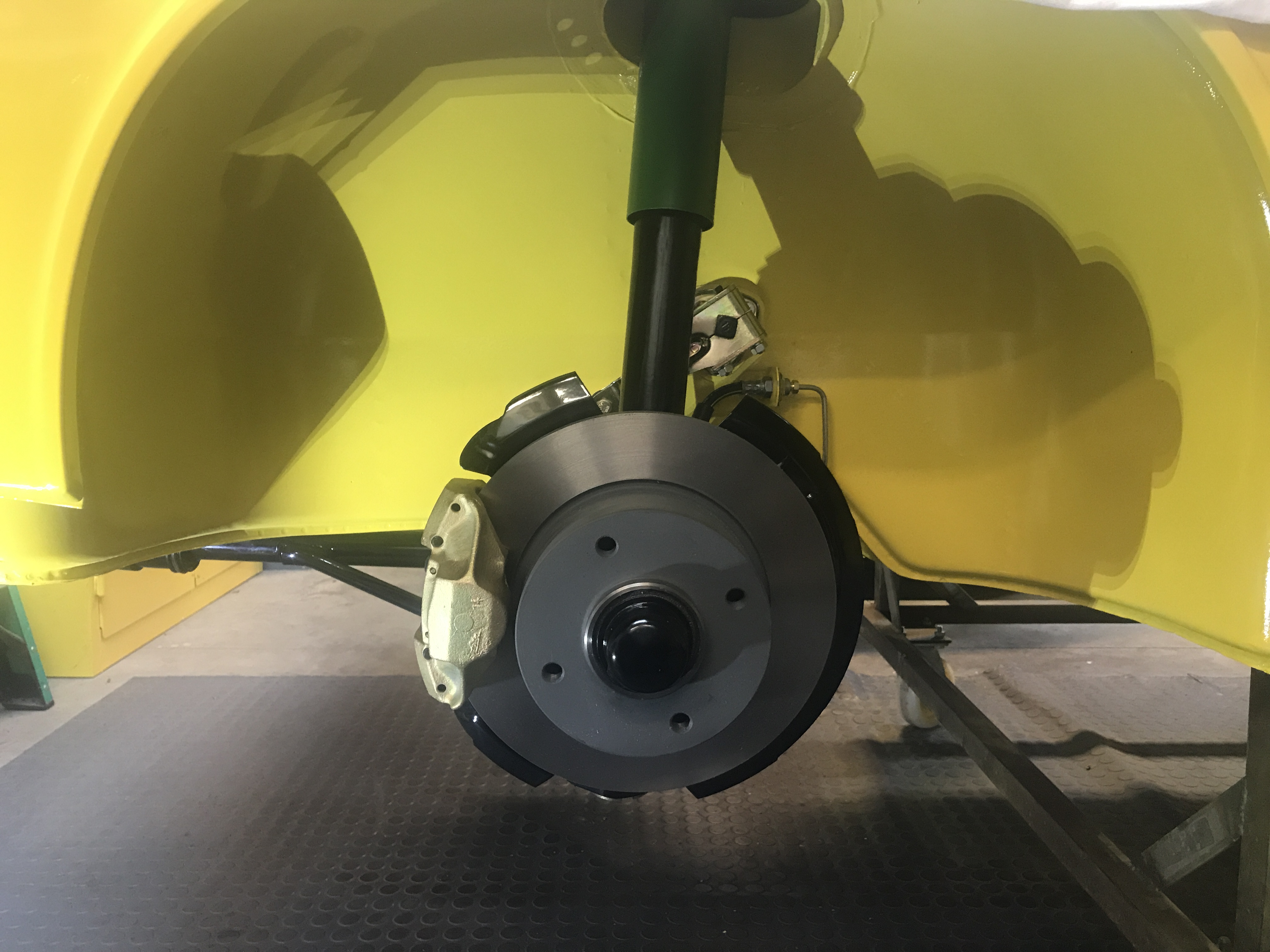

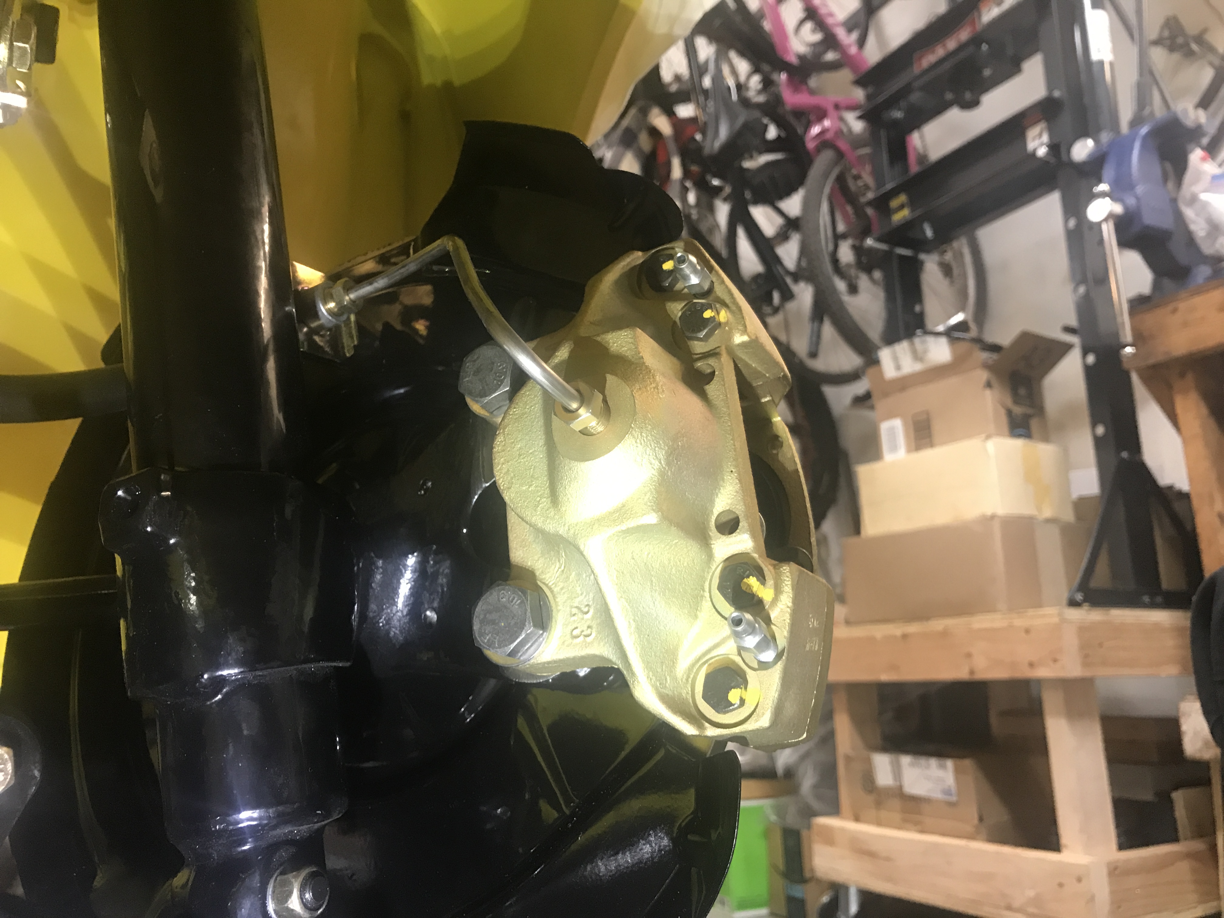

With the disks installed, I can mount the calipers, and connect the hard lines. I used the hardware I got with the rebuilt calipers from PMB. I will save the old bolts I had plated with yellow zinc for a special occasion.

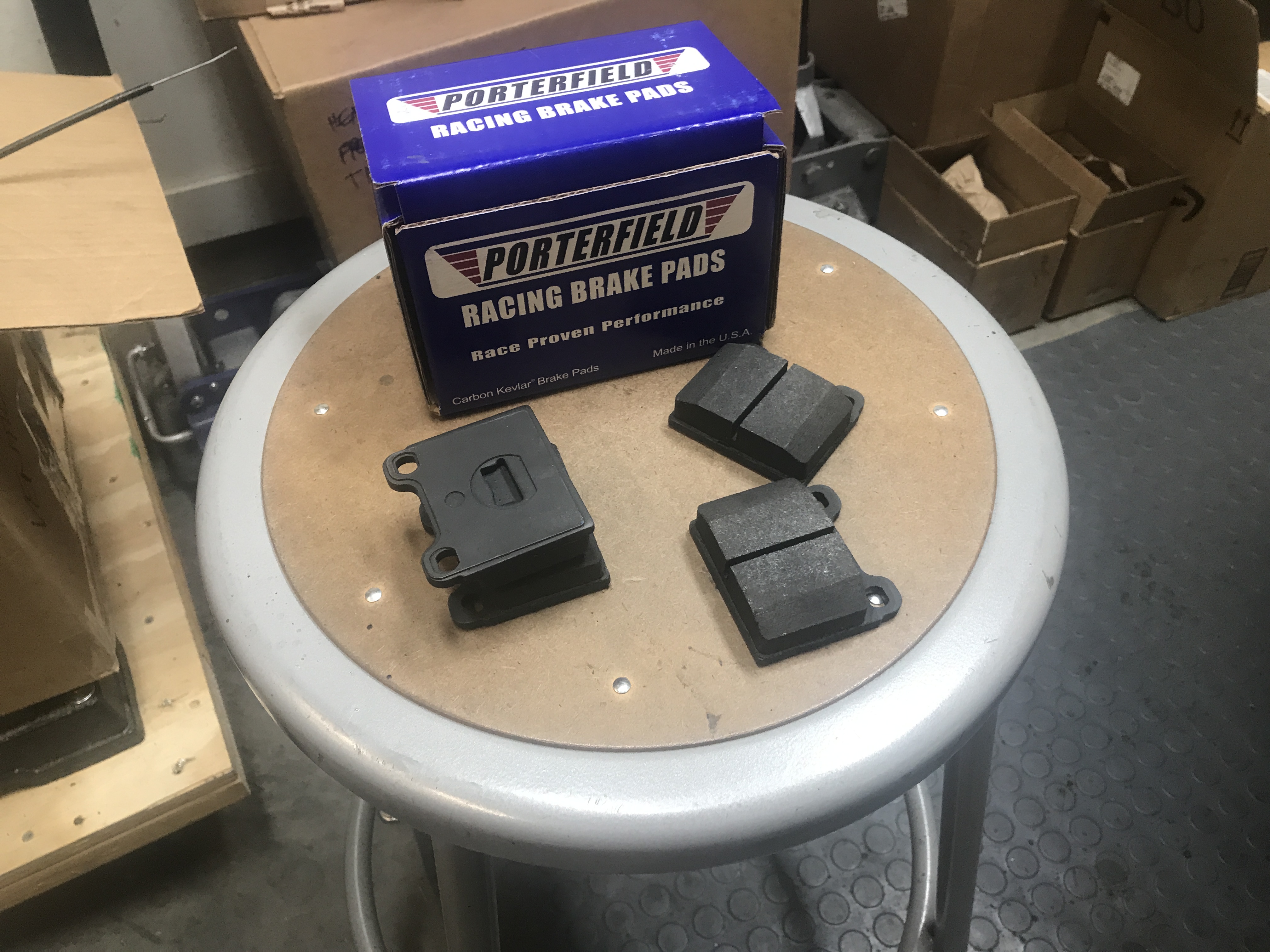

Next, brake pads.

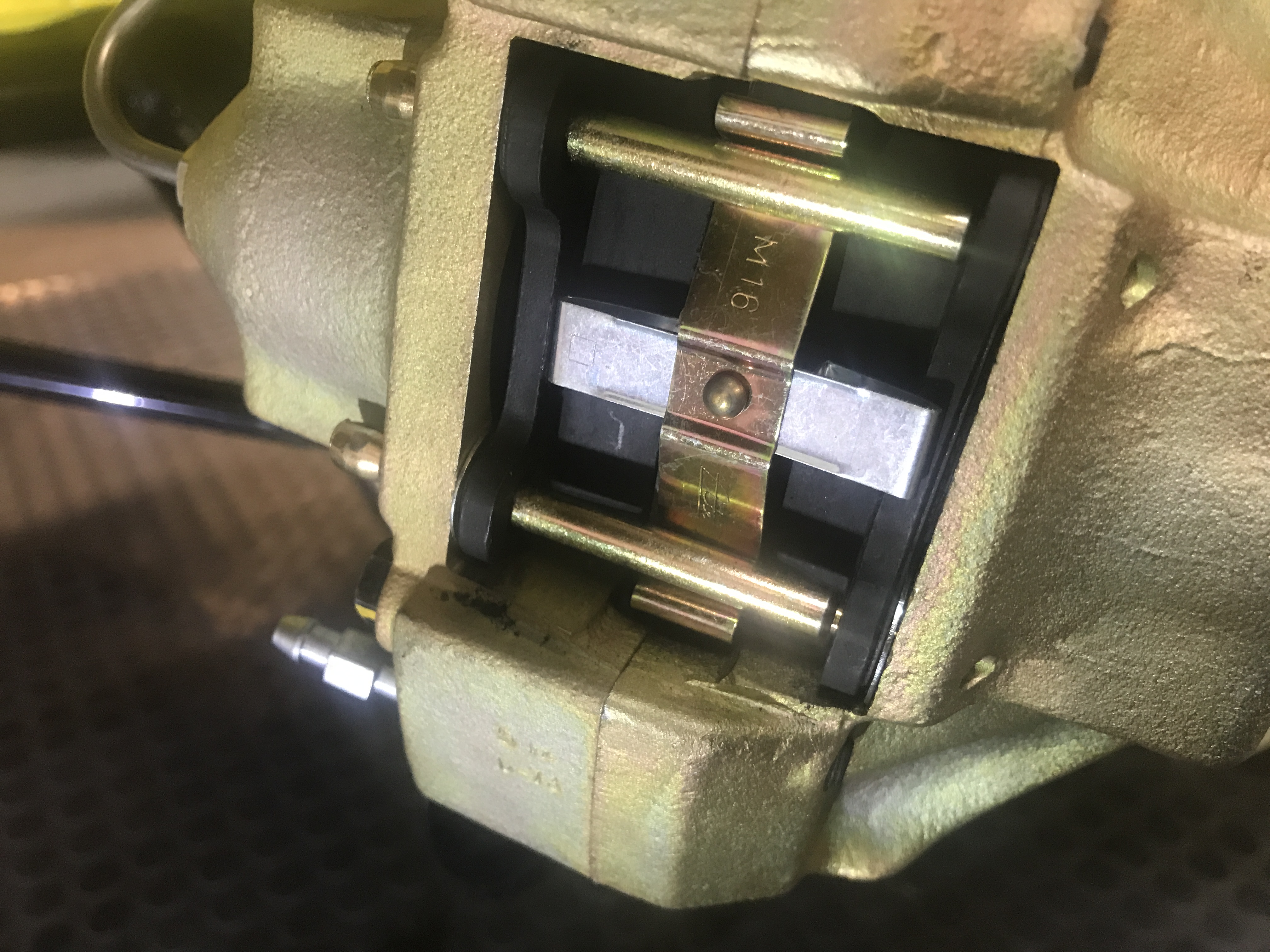

I tried to use the new spreader springs I got, along with re-plated pins. But the spreader wings are too short, and actually fall inside the pad backing plate. Probably not good. (IMG:style_emoticons/default/dry.gif)

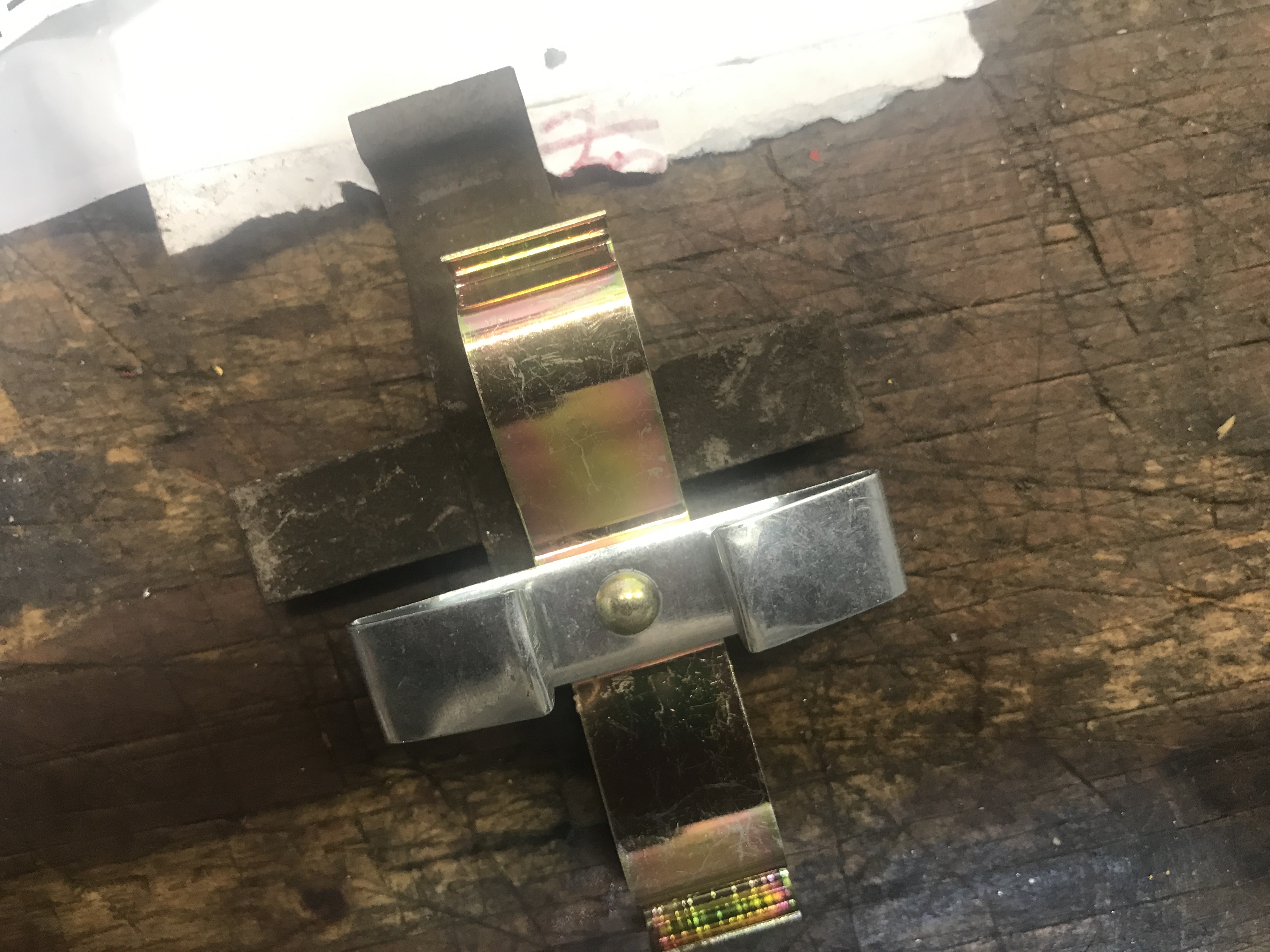

Here's the new spreader vs the old. I think the new one is for early calipers. Have to track down the correct ones, since one of my originals is broken (and dirty is not good).

Looks good to me.

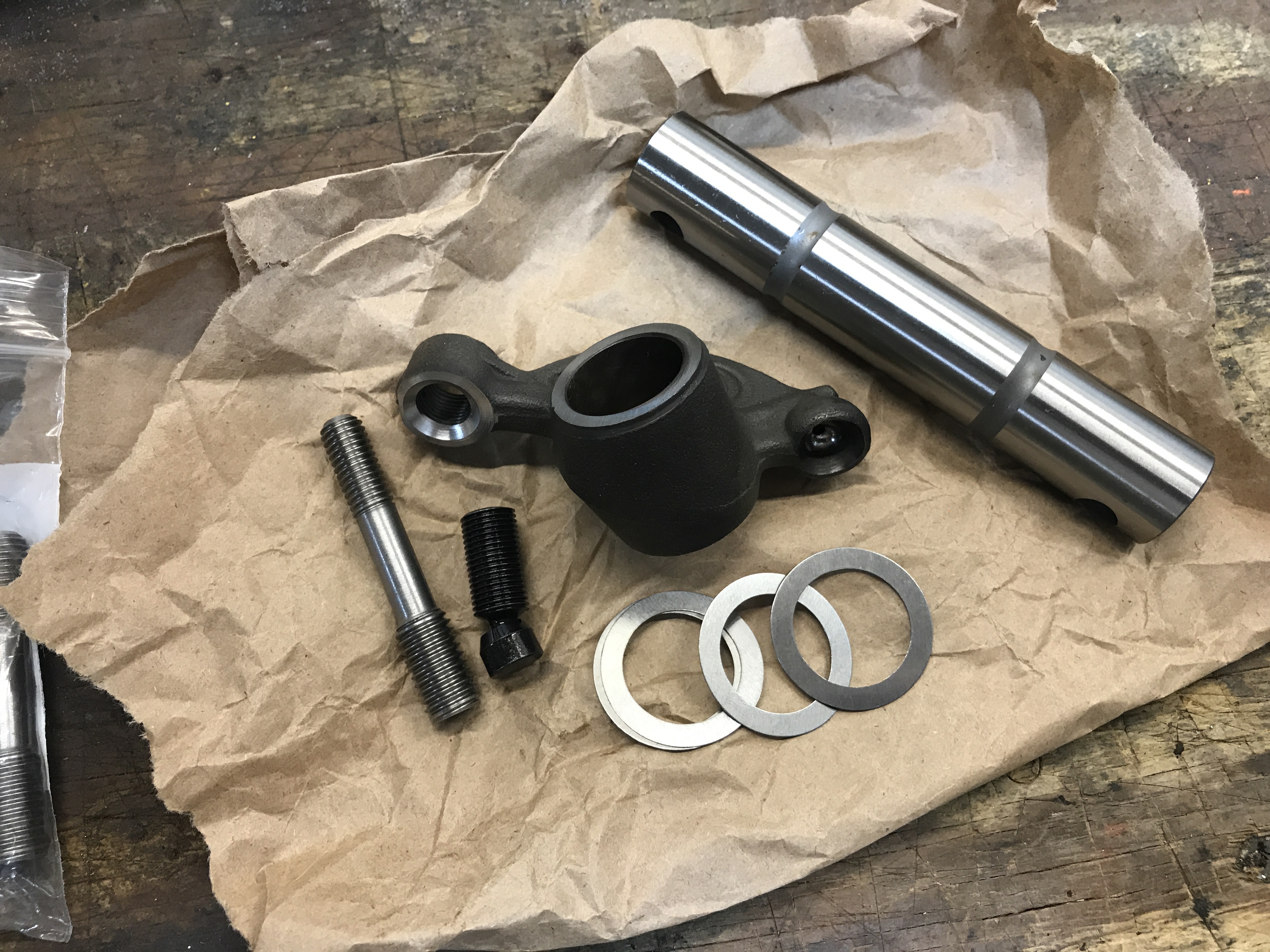

Member No.: 23,343
Got my modified rocker arms, plus new shims, studs, shafts, and swivel-feet adjusters, all from bugguy1967.

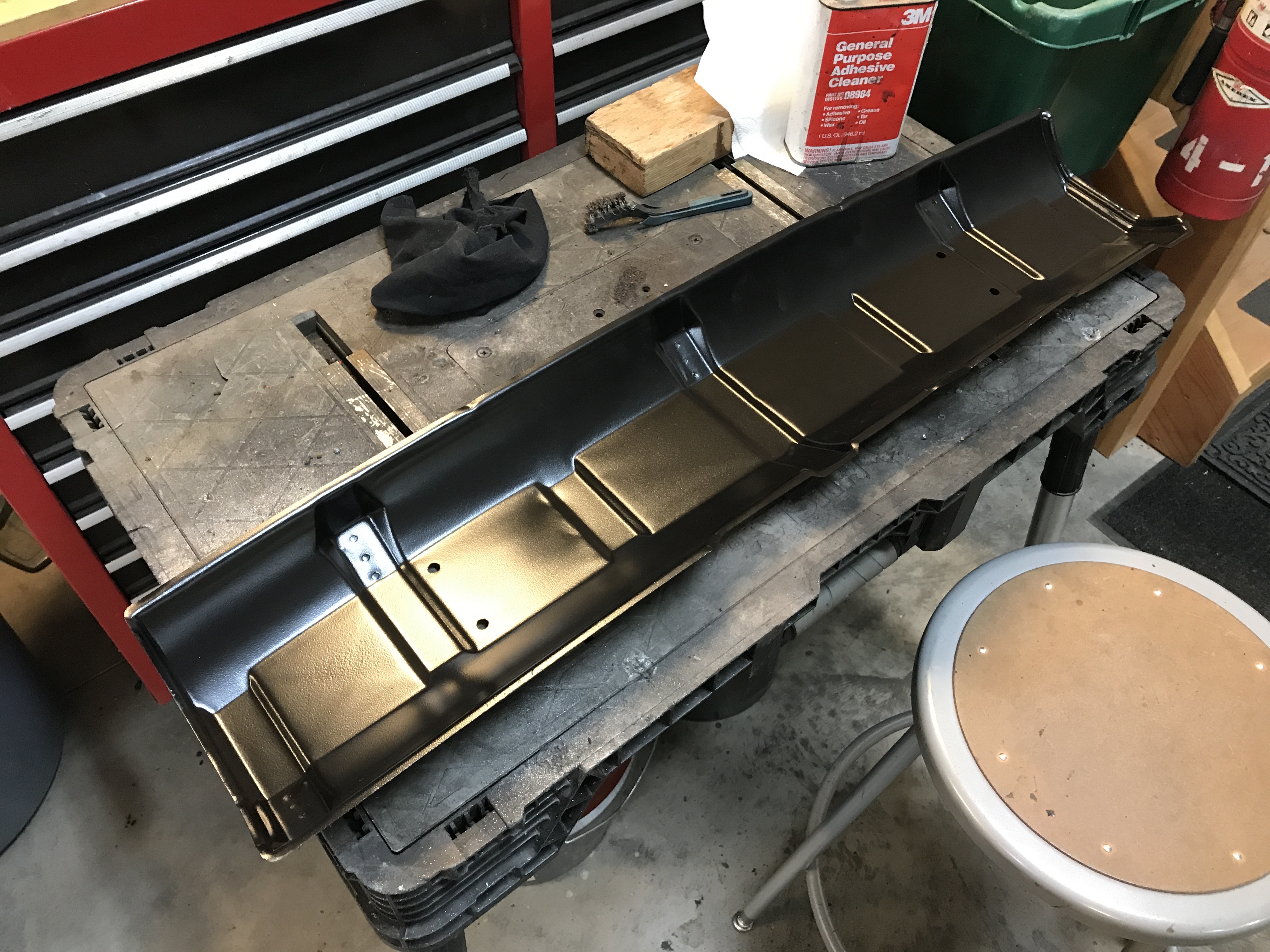

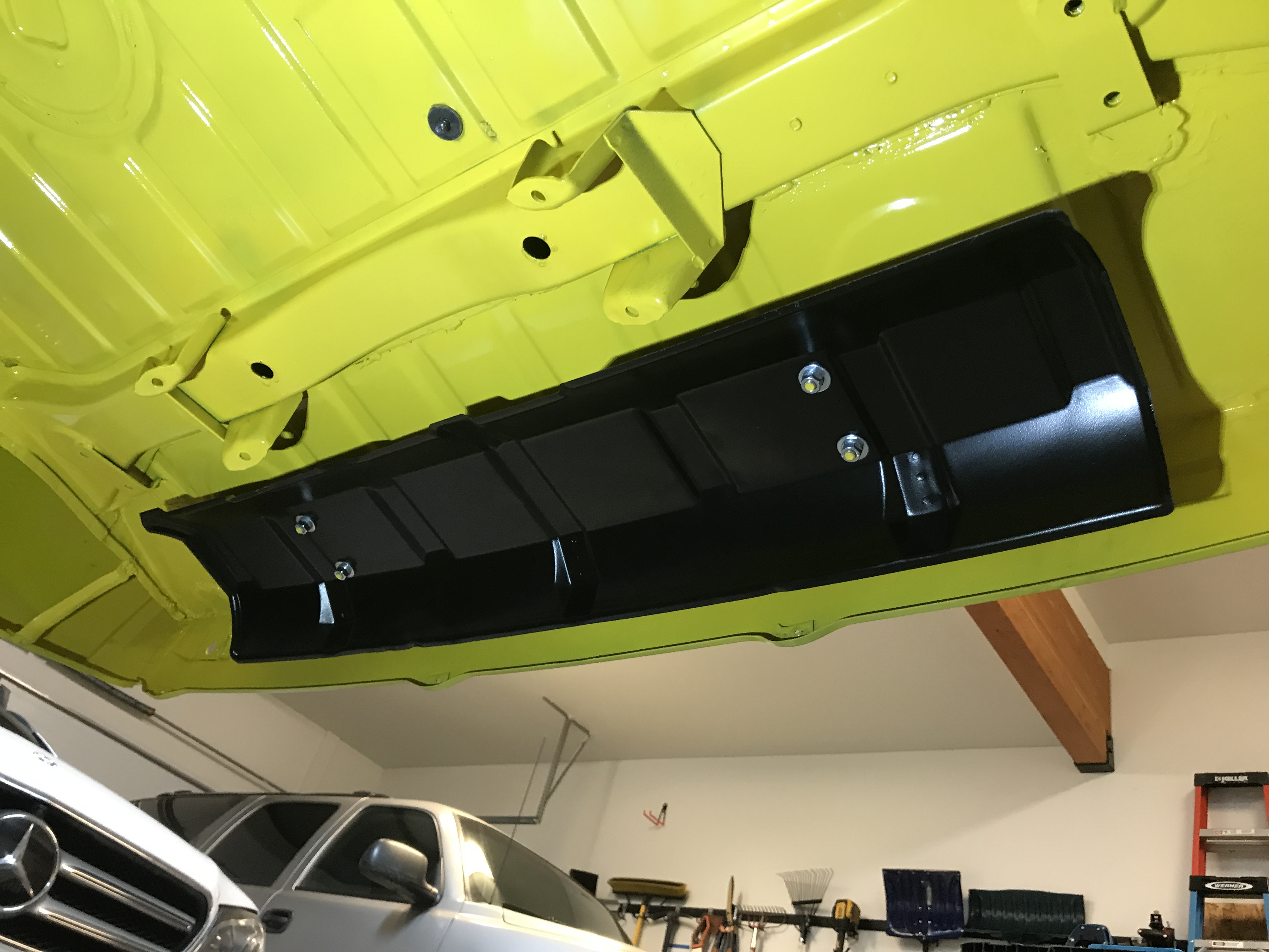

With just a bit of time, I decided to mount the muffler shield. I modified this to bolt in, and had the shield powder-coated with high-temp material.

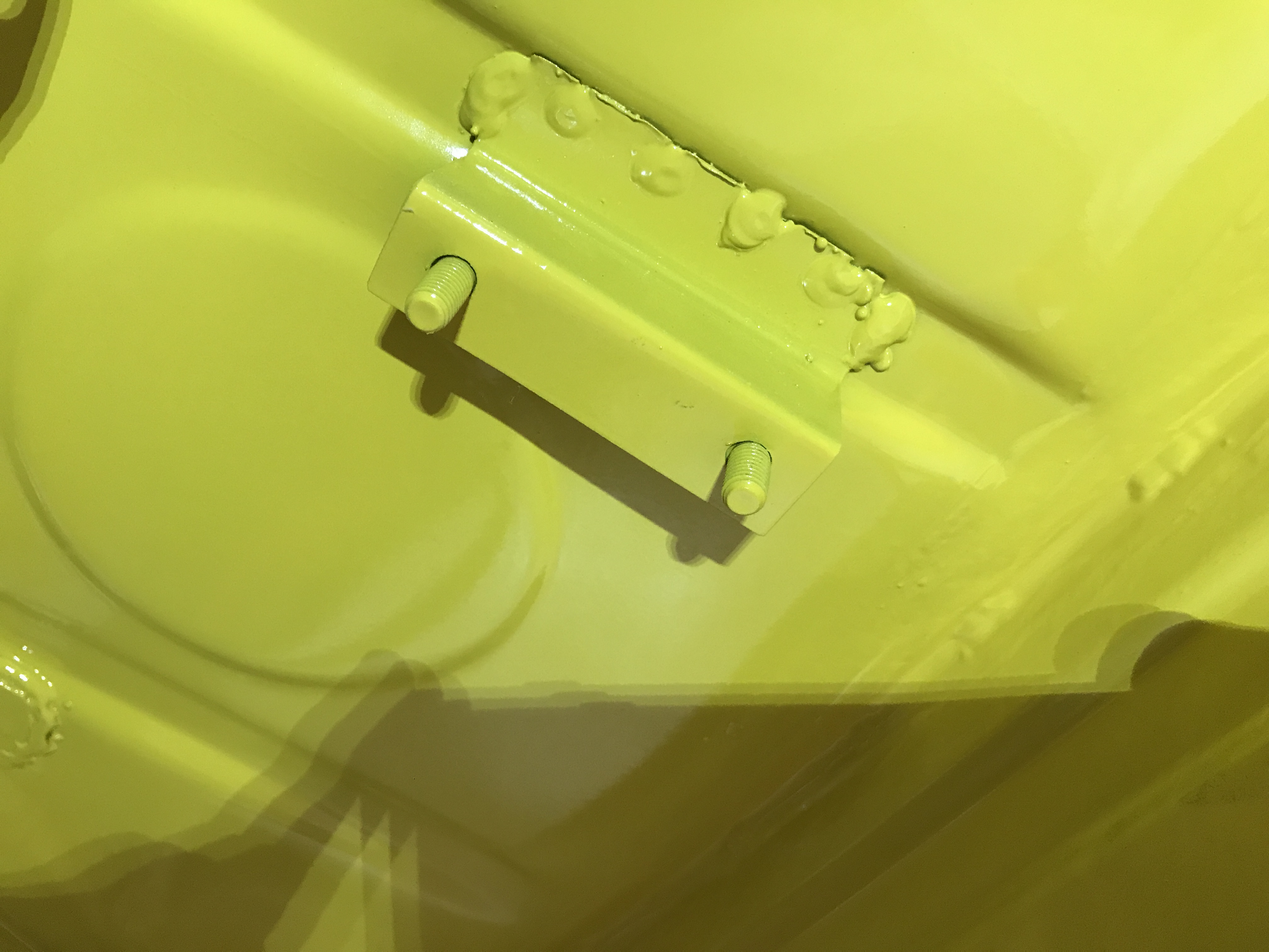

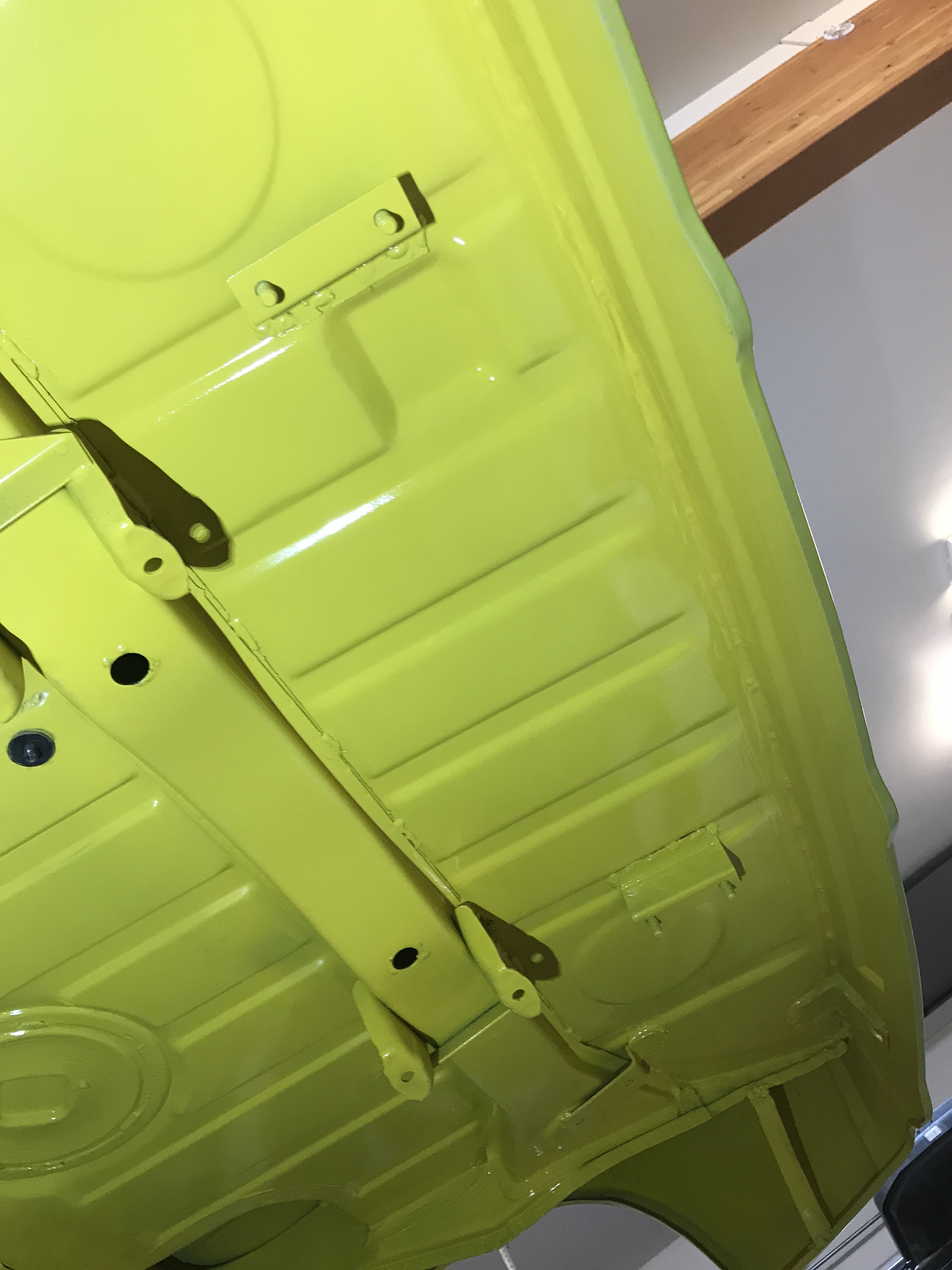

Here are the receiving studs, on the underside of the trunk, on custom Z-brackets.

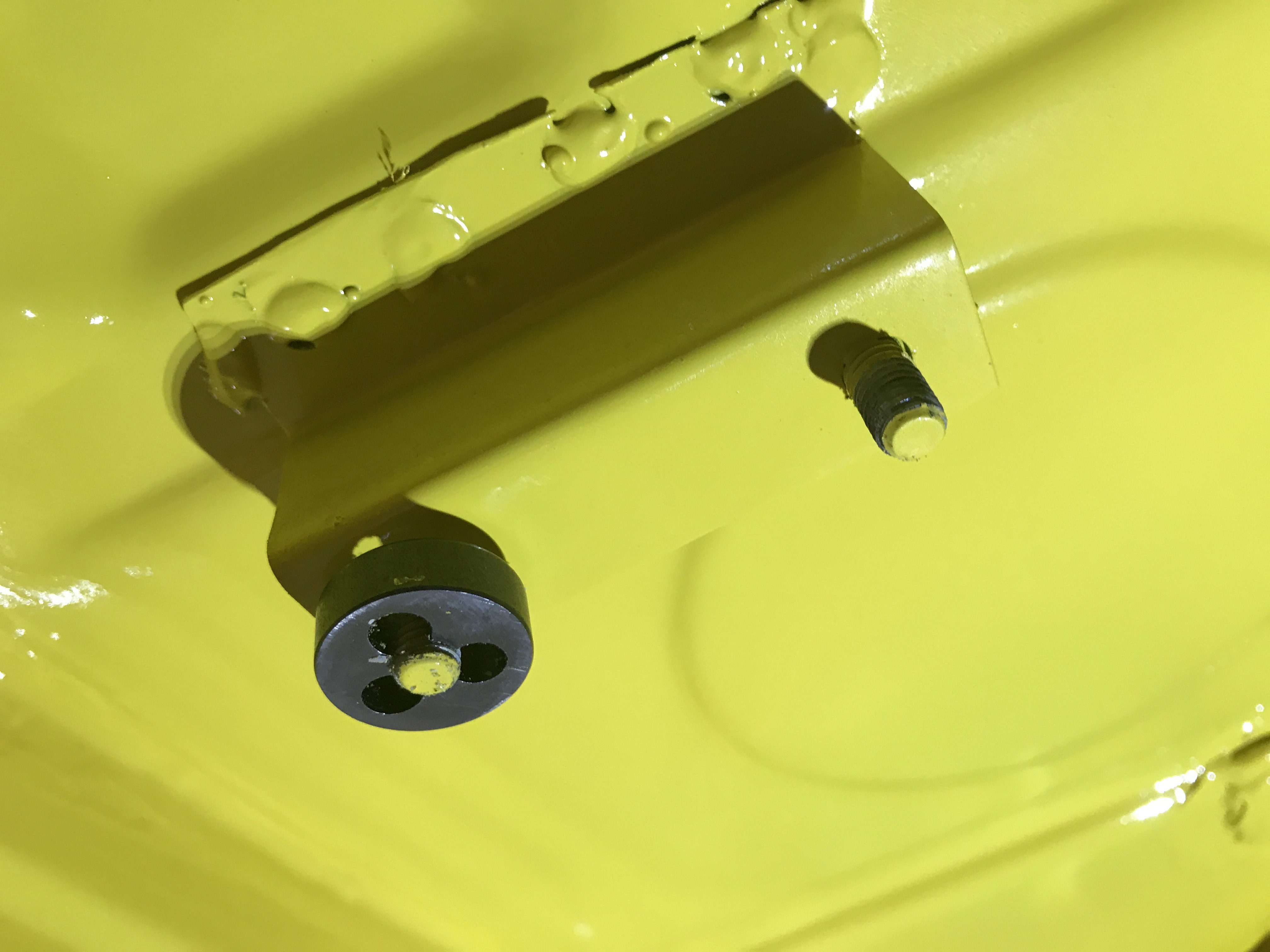

A bit too much paint on the studs, so...

I ran a die over the threads.

Shield in place. I may redo the fasteners with hi-temp anti-seize.

Nice job on modifying the muffler shield. I was looking at mine last weekend wondering how I can strip the trunk floor beneath it - is it originally spot welded on?

QUOTE(john77 @ Feb 5 2021, 07:57 PM) *
Originally, the shield was attached with C-shaped brackets, welded to the shield and floor. I wanted to be able to remove mine, so made it bolt-in.

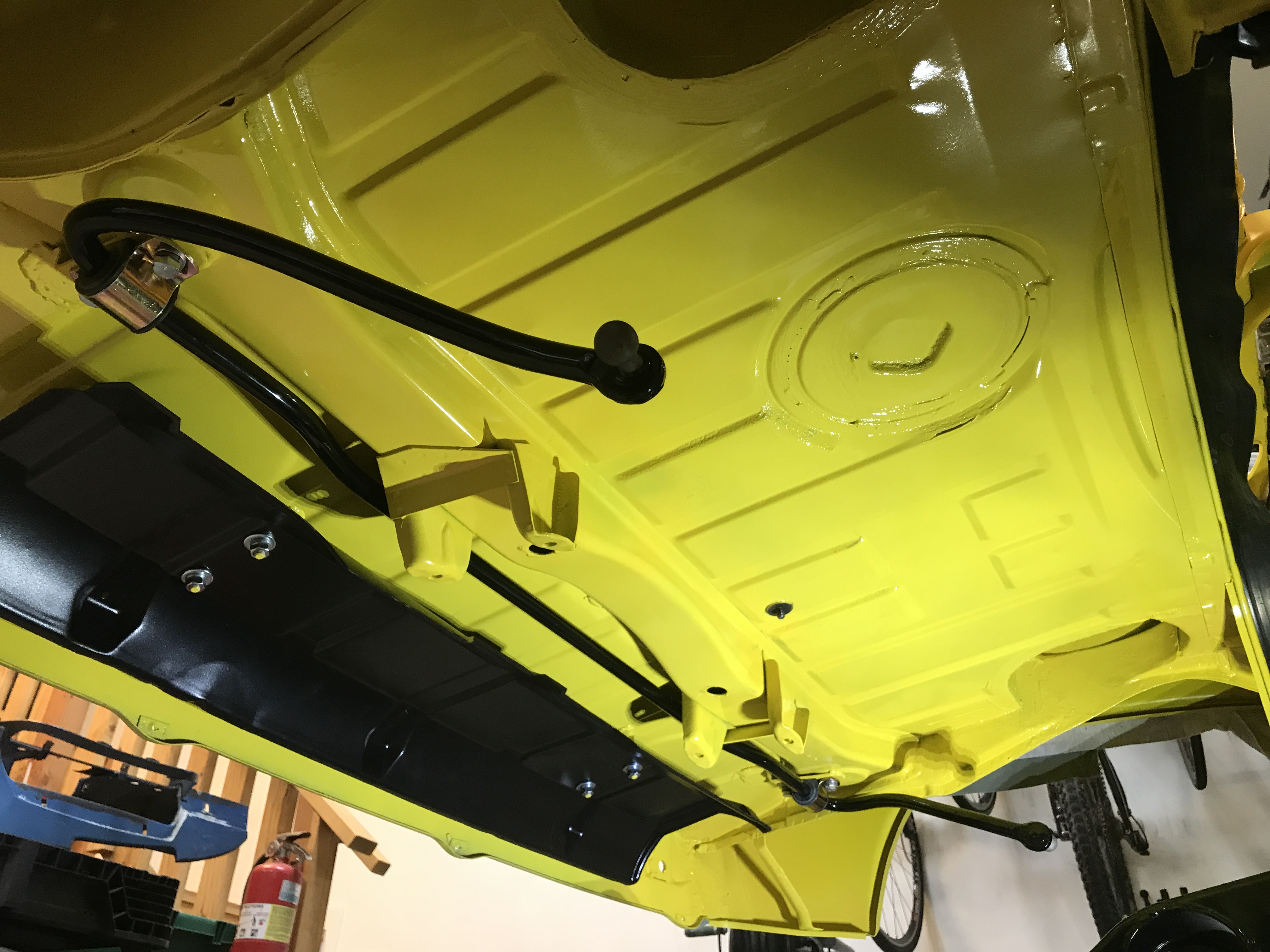

Member No.: 23,343
A bit out of order, but I installed the rear sway bar. Just enough room to sneak it past the muffler shield.
