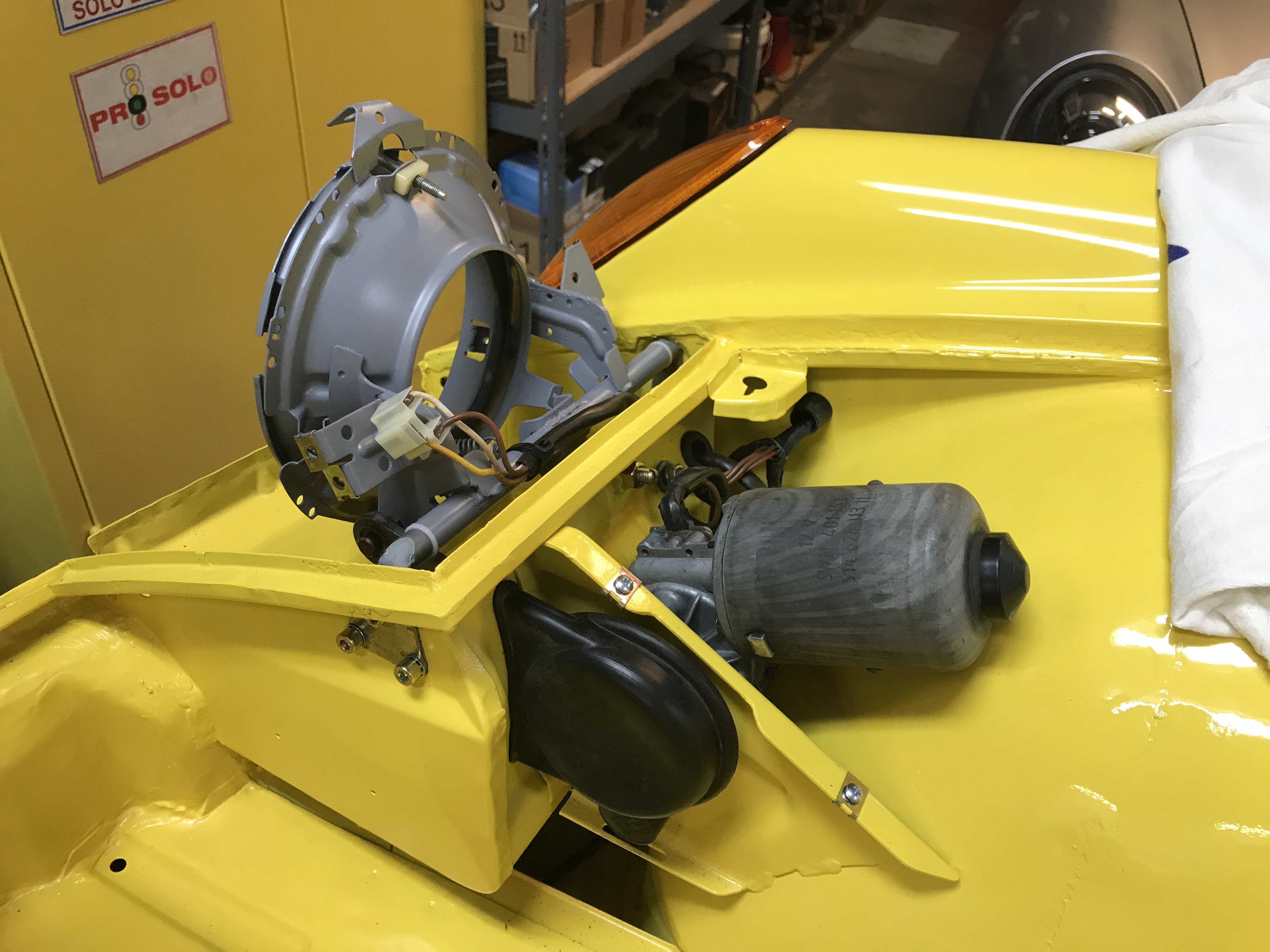

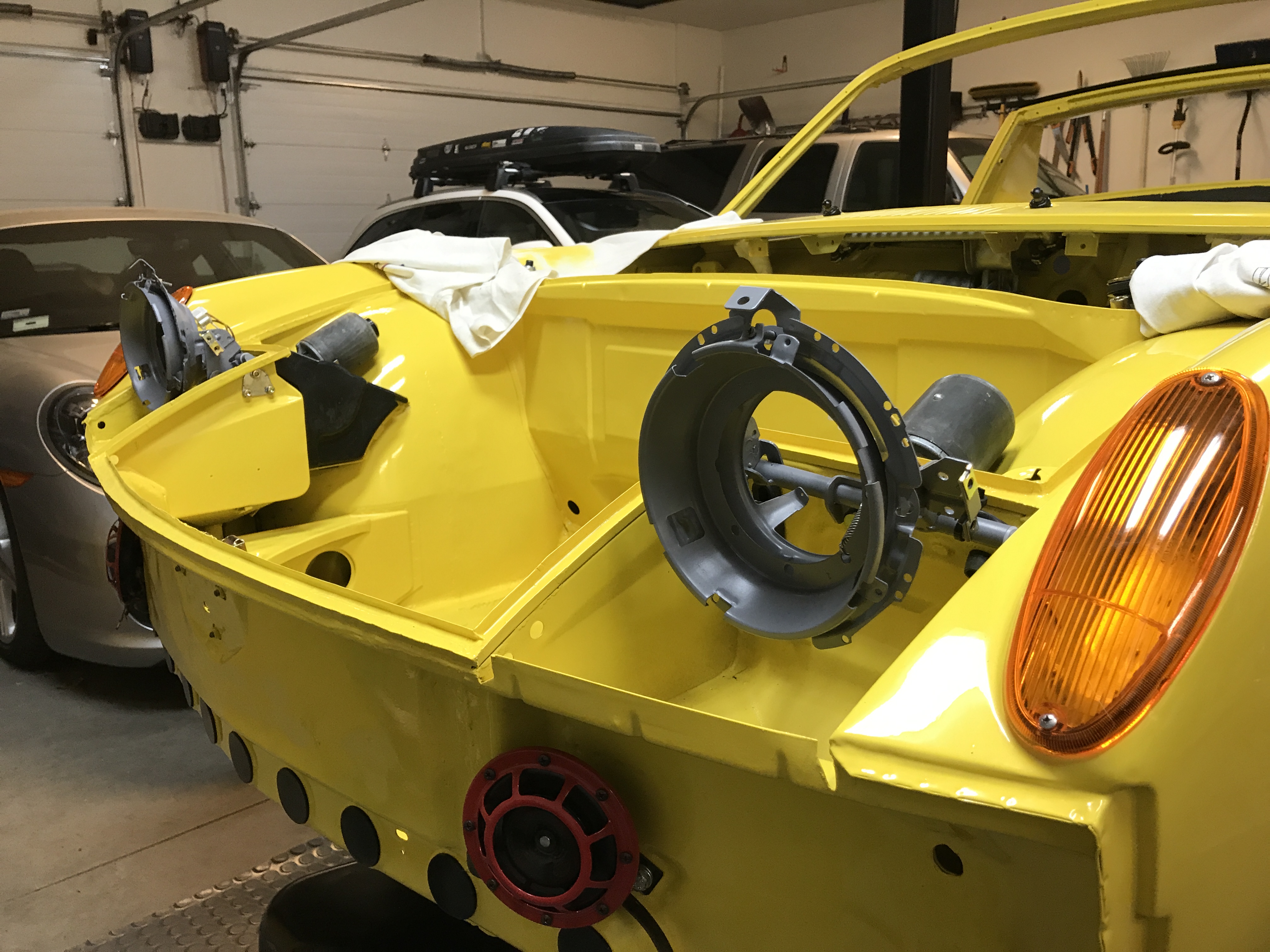

More parts arrived, so I finished the right head light assembly.
bkrantz
post Feb 10 2021, 08:15 PM
Post #2182
Posts: 8,824
Joined: 3-August 19
From: SW Colorado
Member No.: 23,343
Ready for lamps and trim. I got some LED head lights to try.

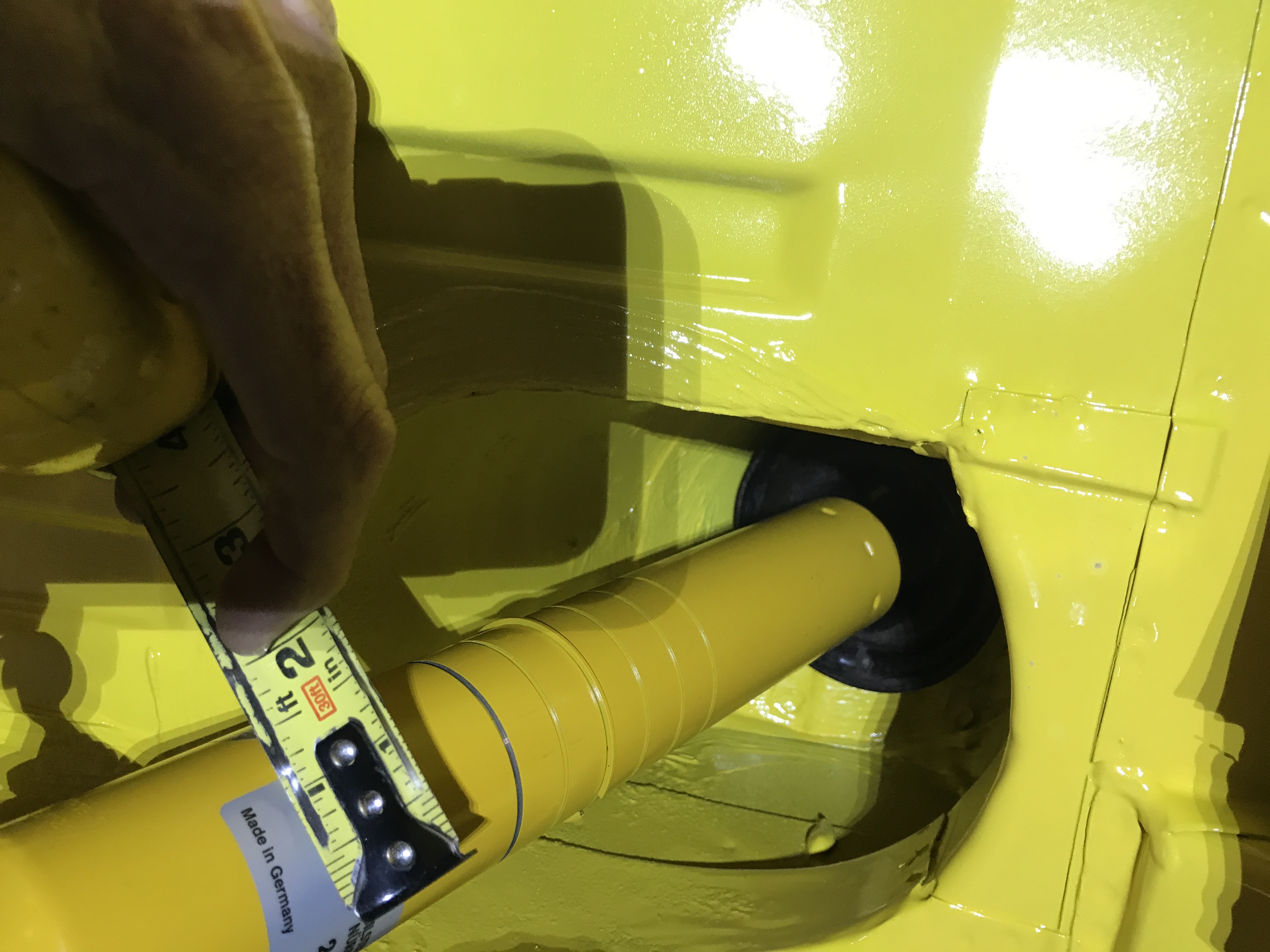

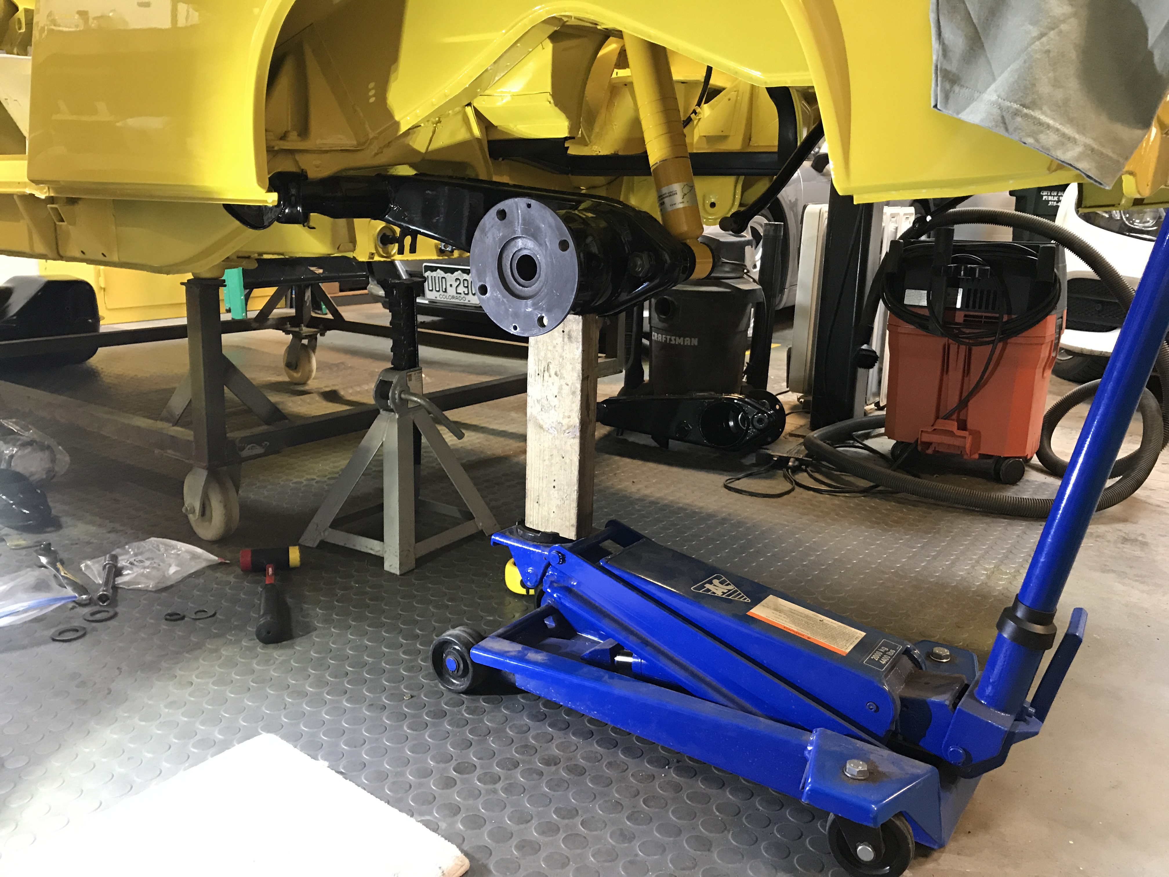

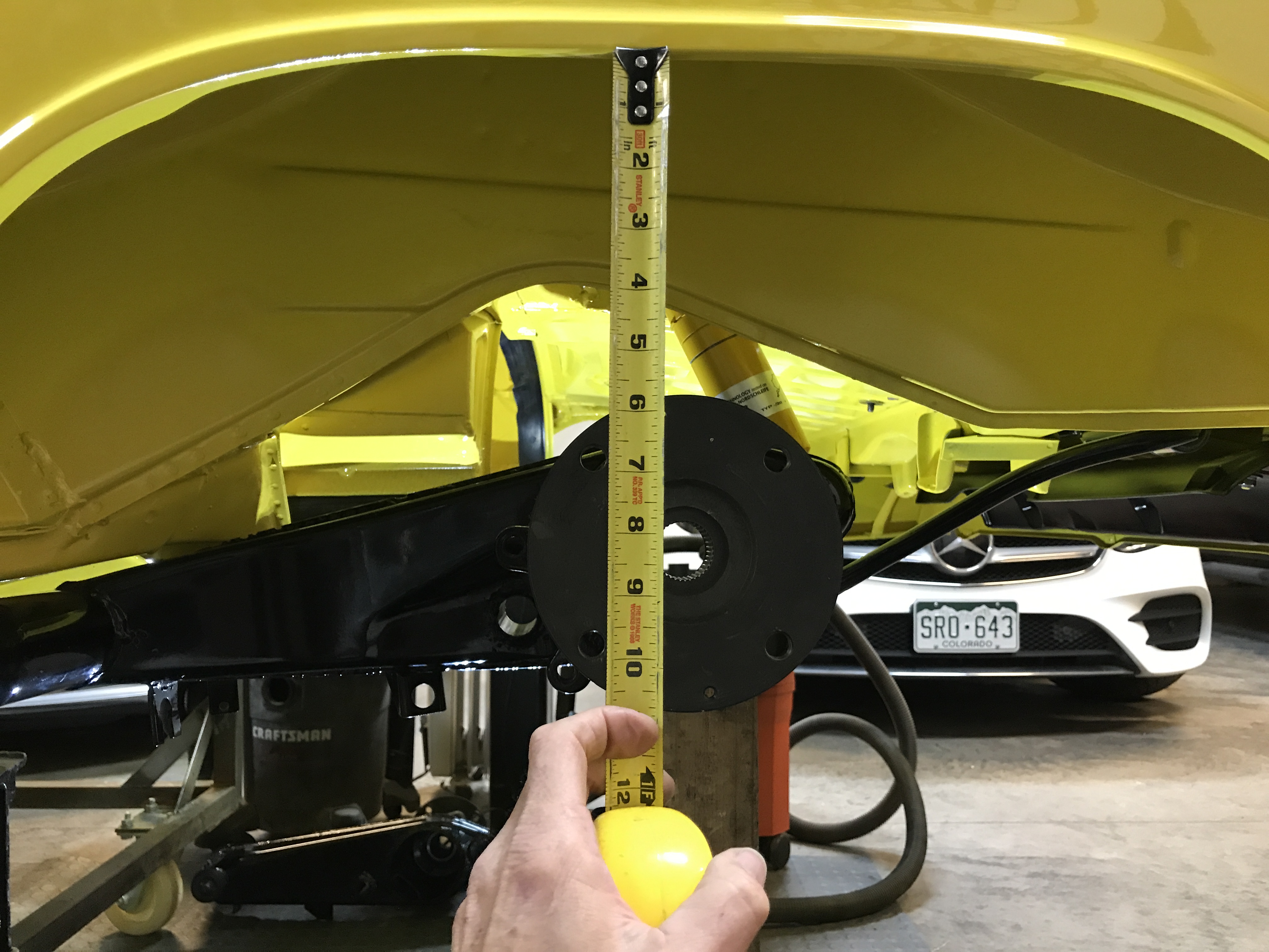

I also got parts and hardware for the rear suspension, except for the rubber bump stops. (See my other thread). So I decided to install one shock without the spring to see about dimensions and spacing for the bump stop. Since the Bilsteins are gas-charged, I used a floor jack to move the trailing arm up.
bkrantz
post Feb 10 2021, 08:20 PM
Post #2184
Posts: 8,824
Joined: 3-August 19
From: SW Colorado
Member No.: 23,343

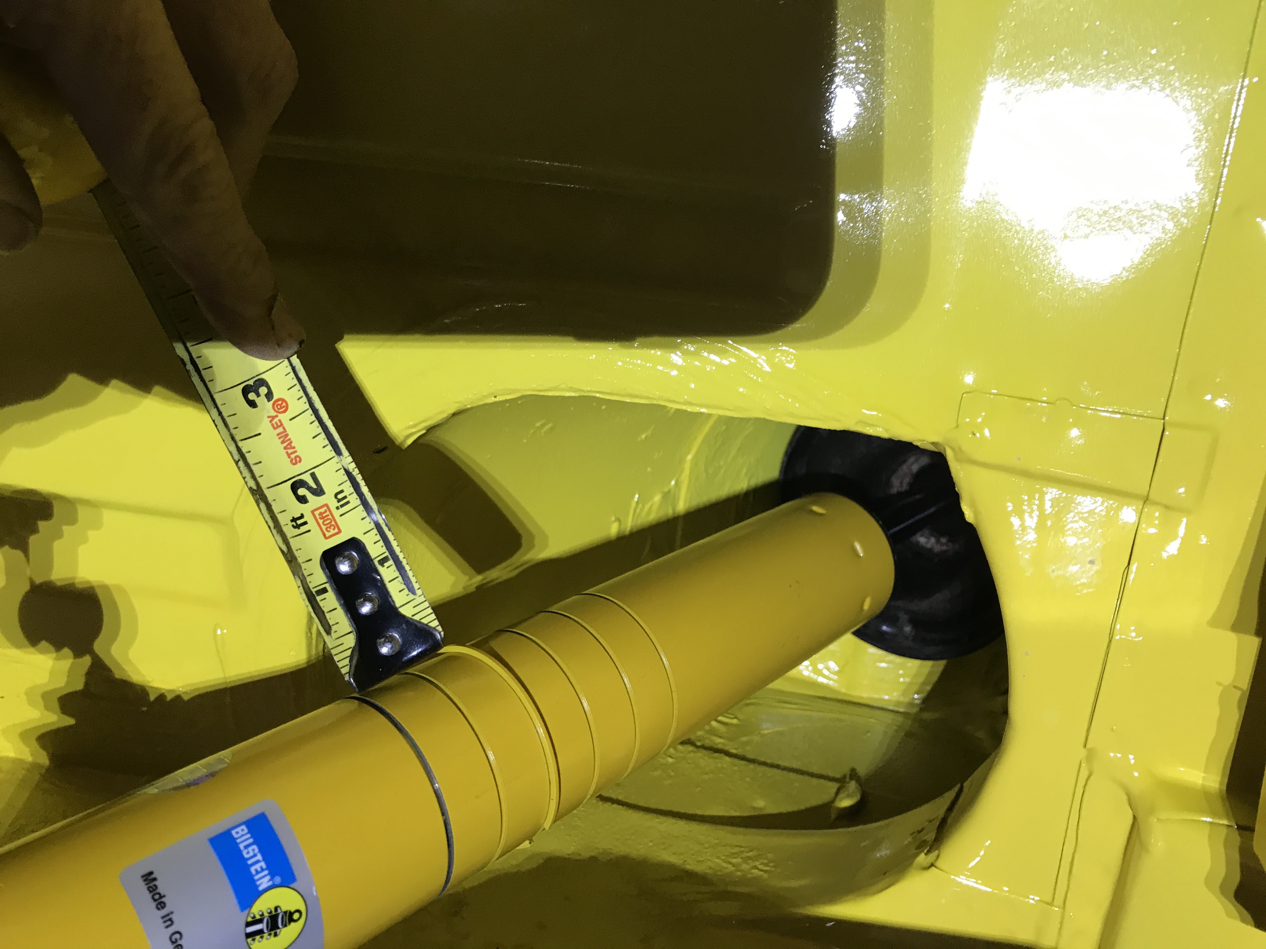

I checked the clearance at the top of the shock, and set it at 2 inches.

Here's where the trailing arm sits with the 2 inch spacing.

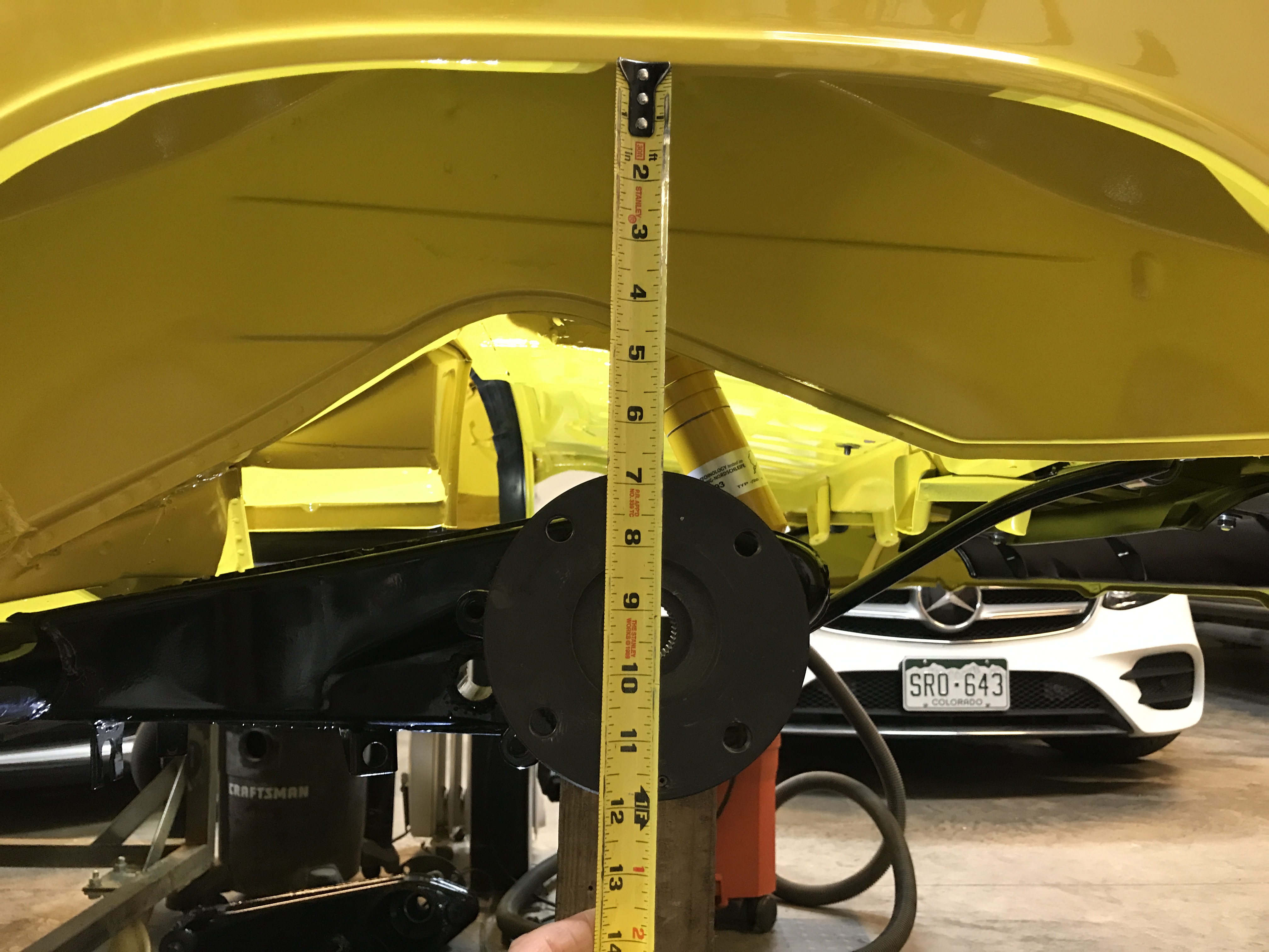

And then 3 inch spacing.

Trailing arm position.

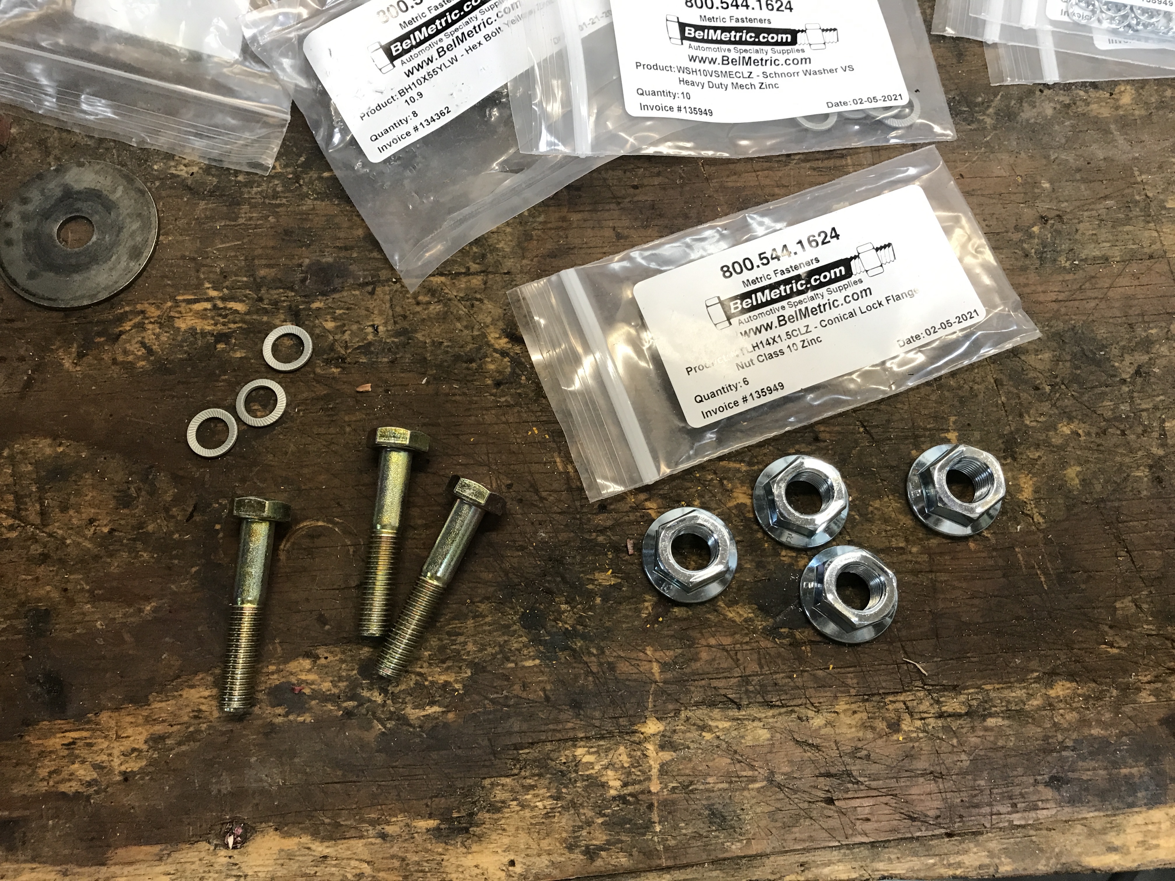

Here's the hardware I needed to complete the rear suspension installation, including new M14 lock nuts for the pivot shaft.

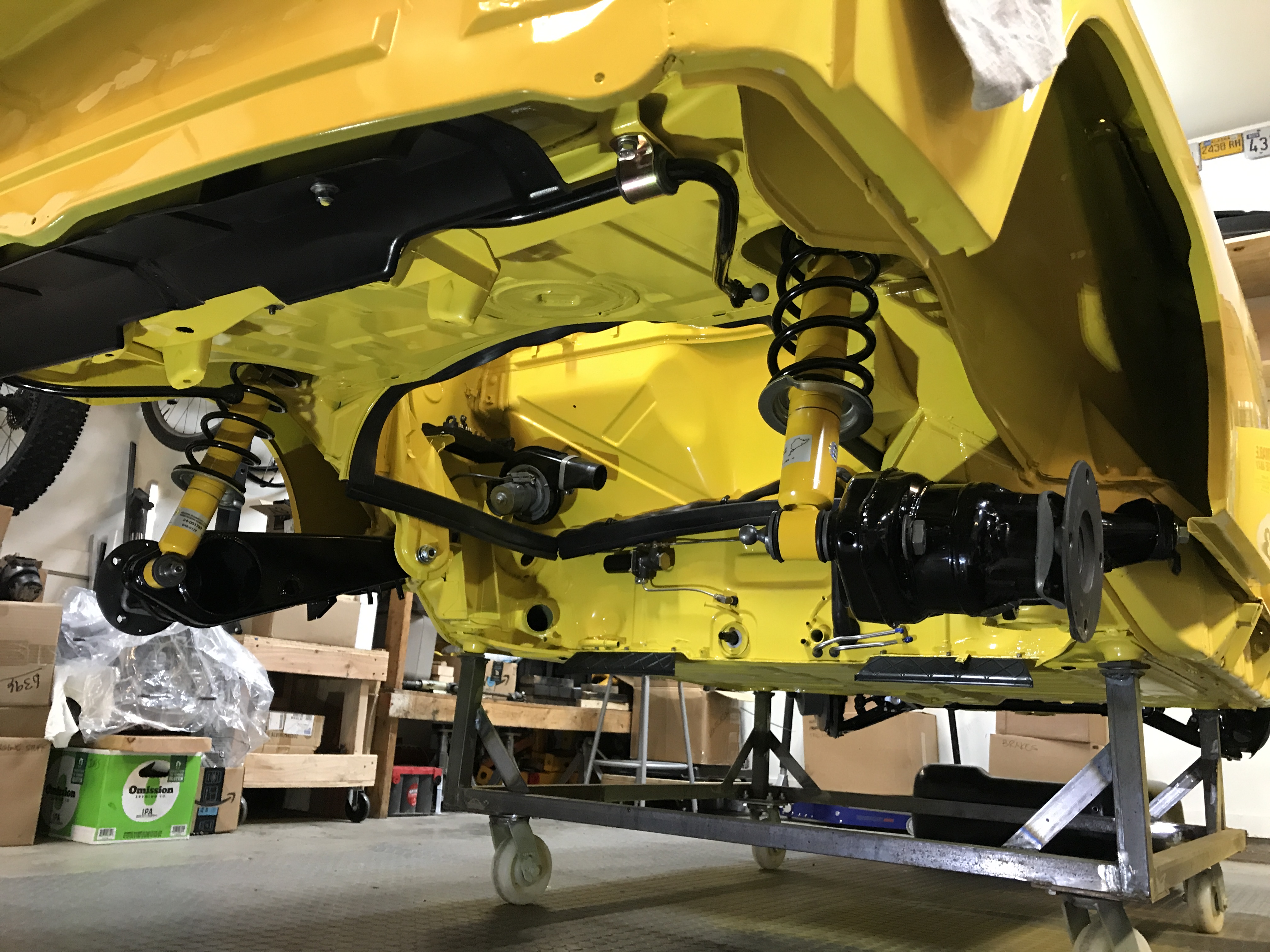

With everything laid out, I decided to install the springs and shocks. Once I get the bump stops I can R&R the shocks.

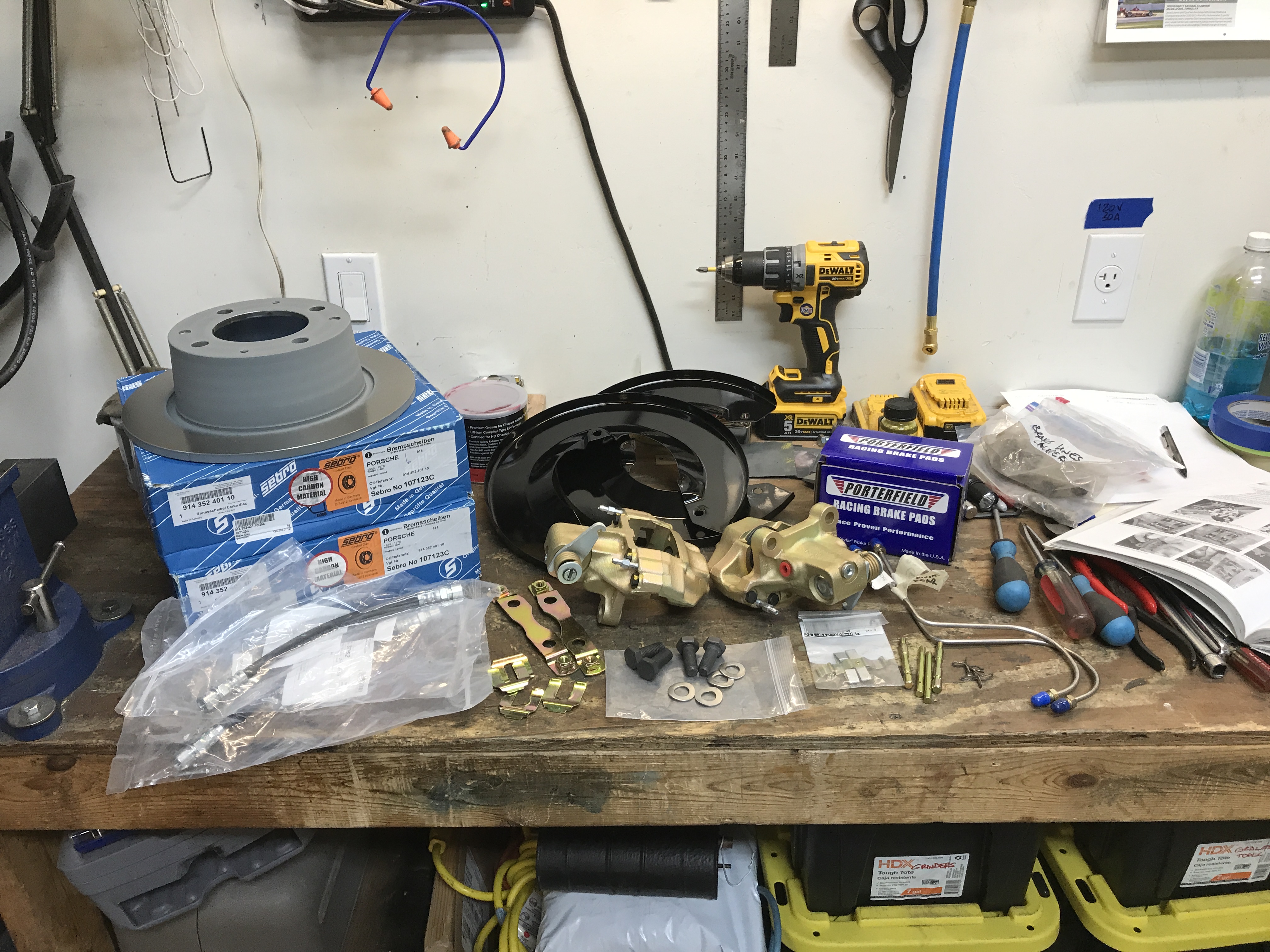

With the rear suspension in place, I can finish up the brake system. Here are all the new and rebuilt components.

QUOTE(bkrantz @ Feb 6 2021, 09:16 PM) *
I moved the shock spring perch up to the second groove from the bottom, but that leaves some slack space below the spring. I might try the 3rd groove.
I think you need to go a lot higher, like two or three from the top.

QUOTE(mepstein @ Feb 10 2021, 07:27 PM) *
Thanks--you might be right. I will have to take the springs off to add the bump stops and can adjust the preliminary height again.

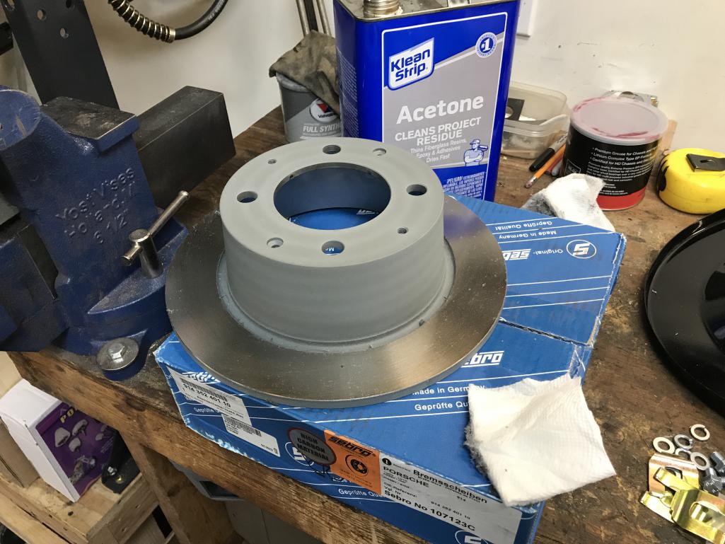

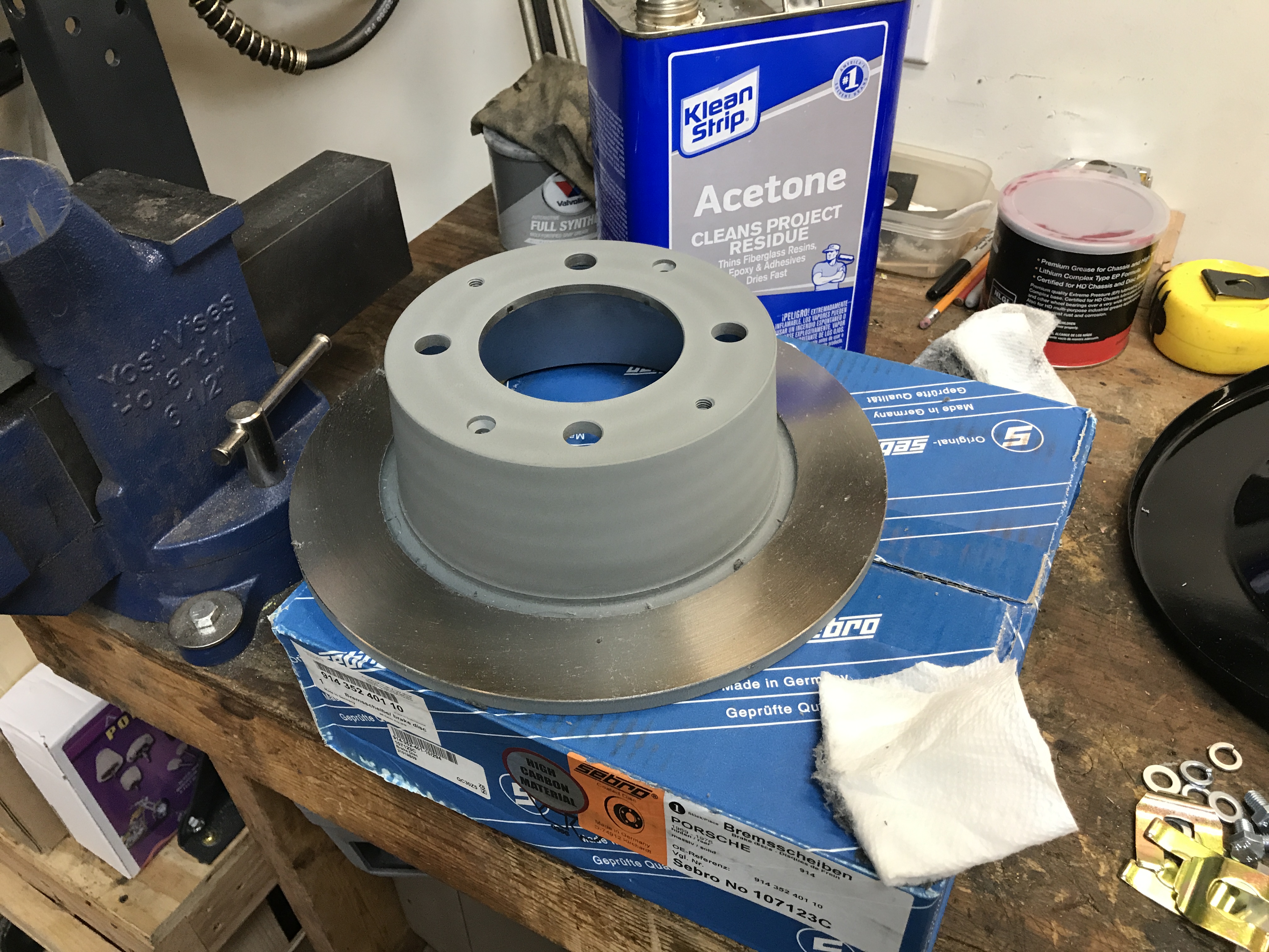

I got to play with the rear brakes today. Step 1, clean residue from the new disks.

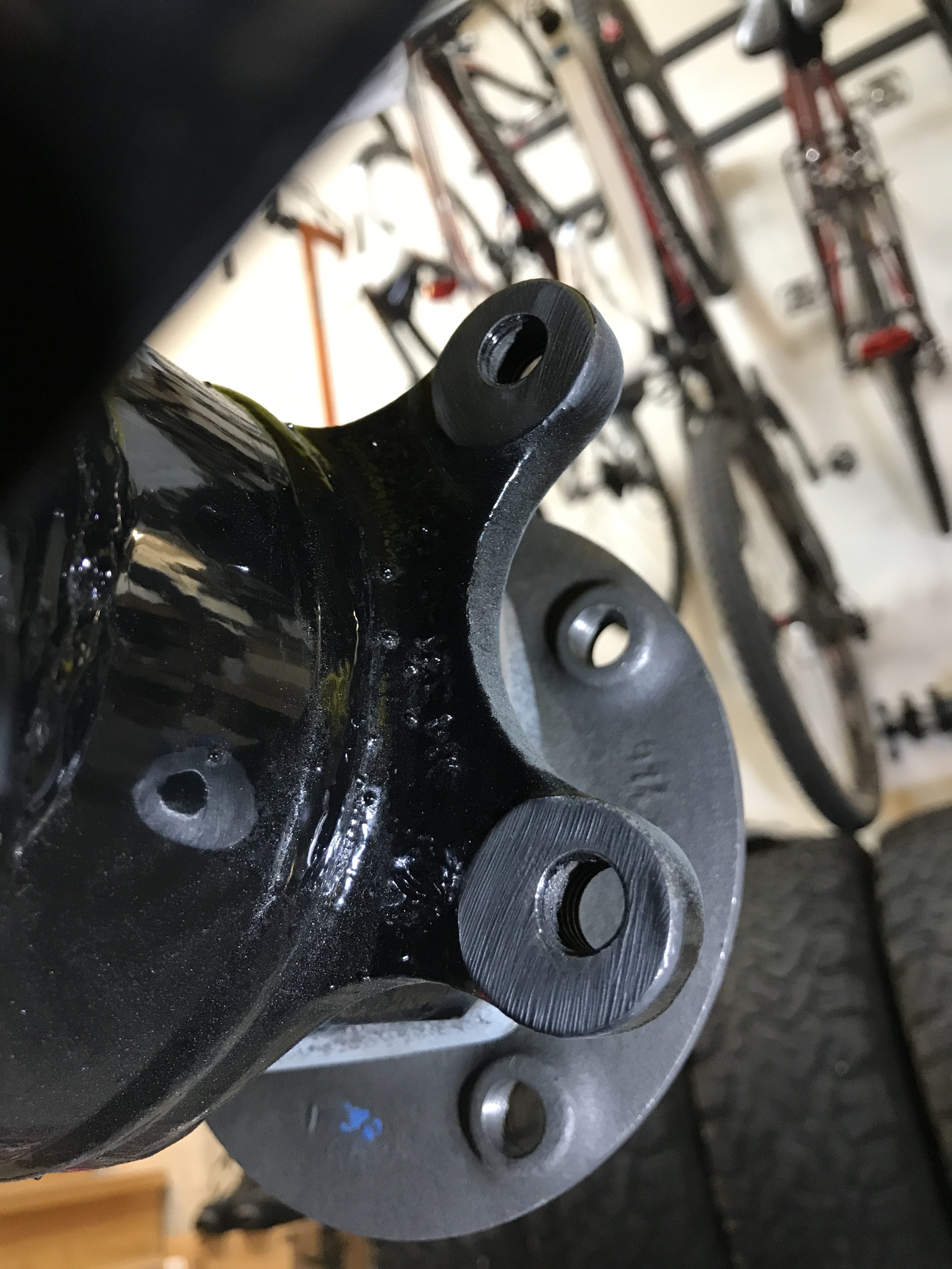

Then remove the powder coating from the mounting ears.

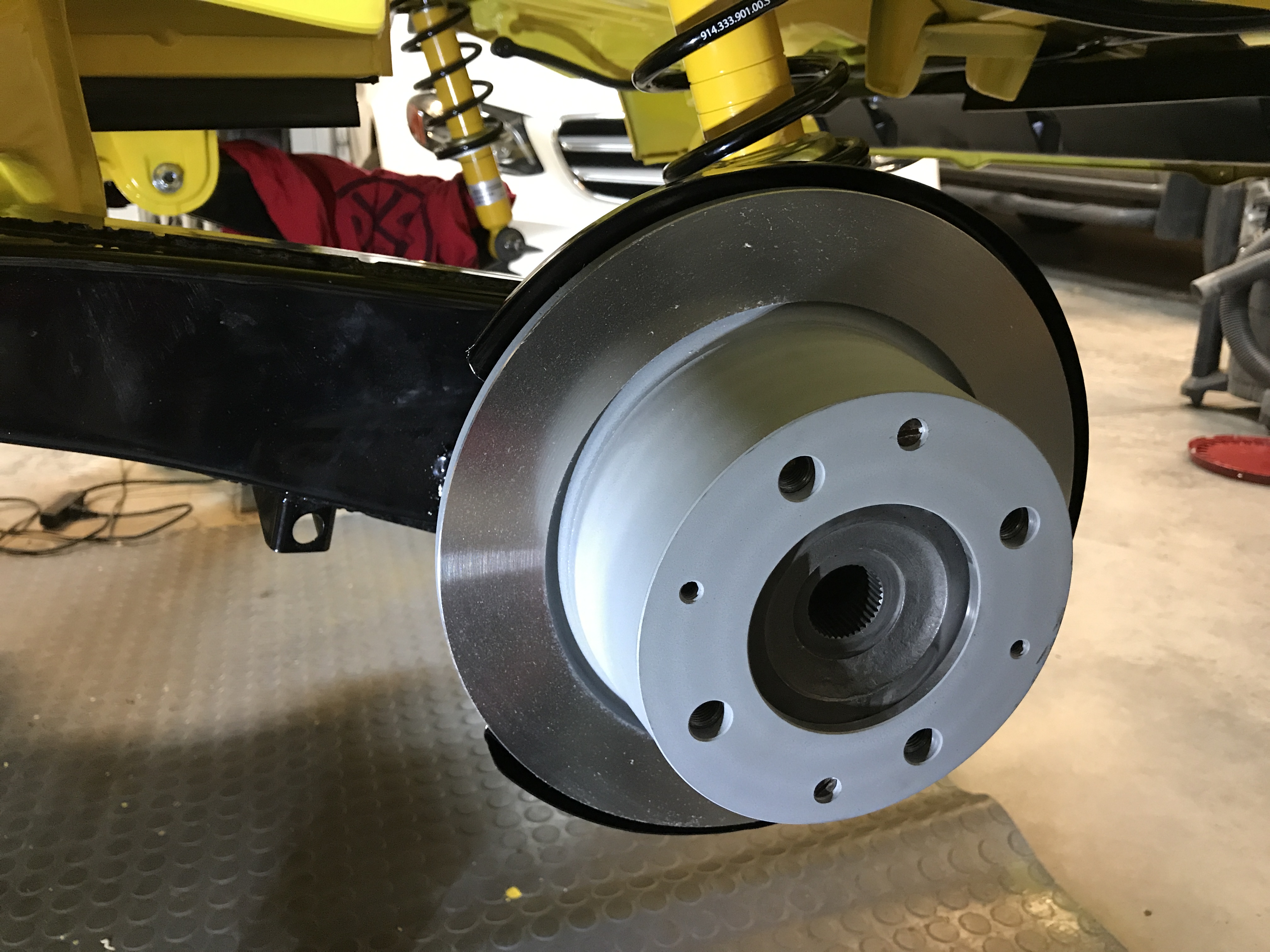

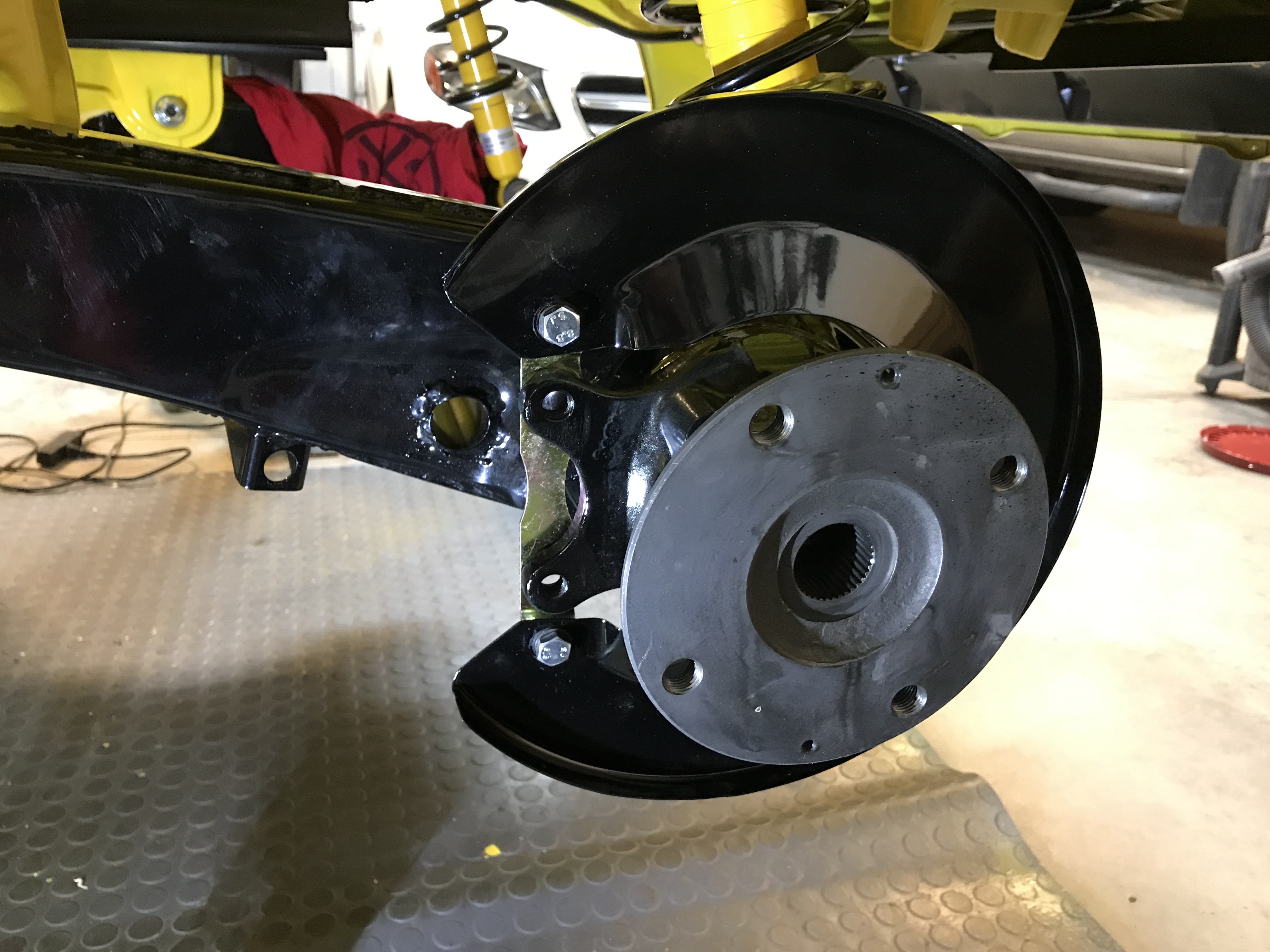

Mounted the backing plate. More new, re-plated, and powder-coated parts--shiny stuff.

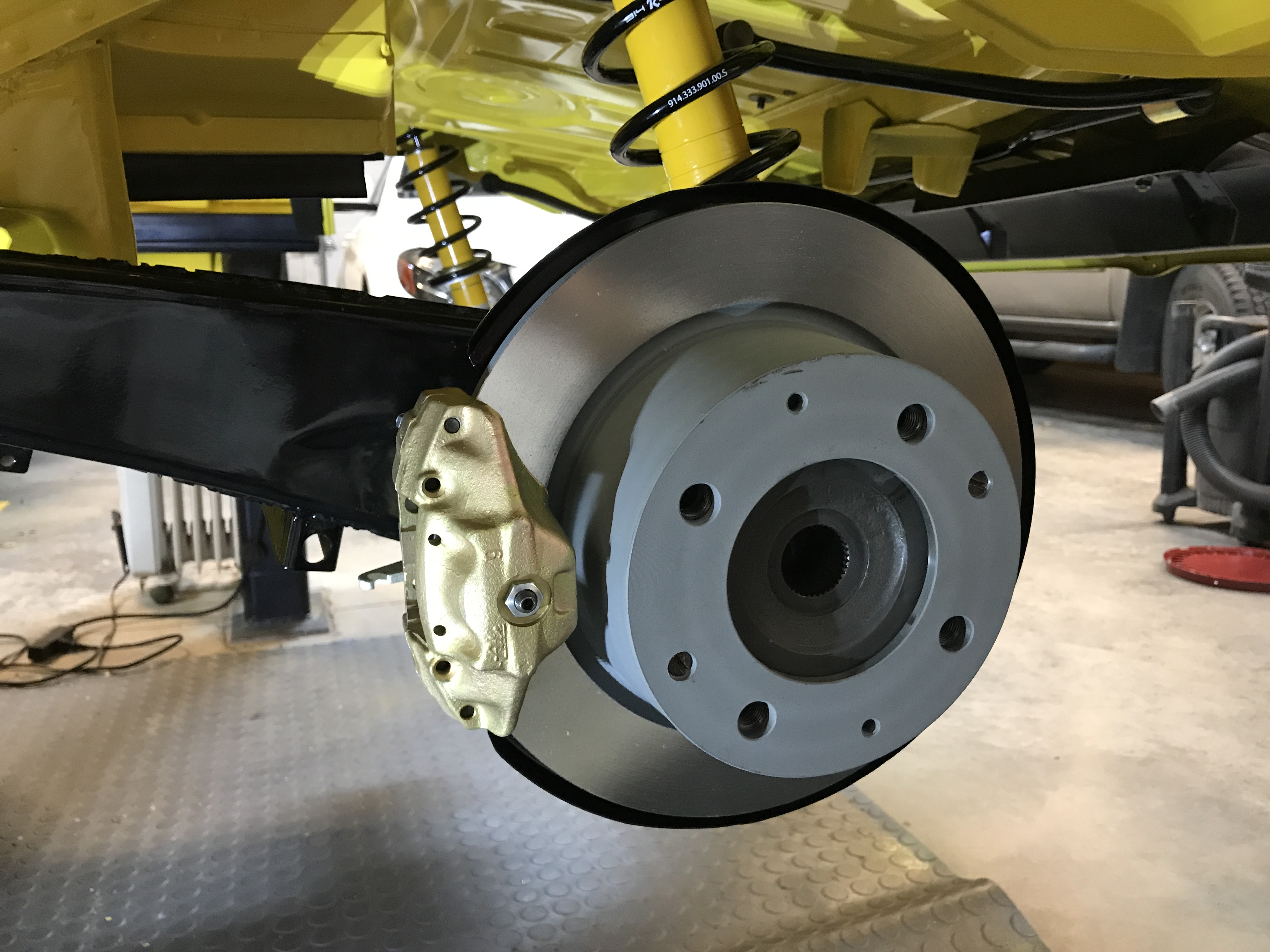

The new disk (with old retaining screws--I forgot to order new ones).

A rebuilt caliper from PMB.

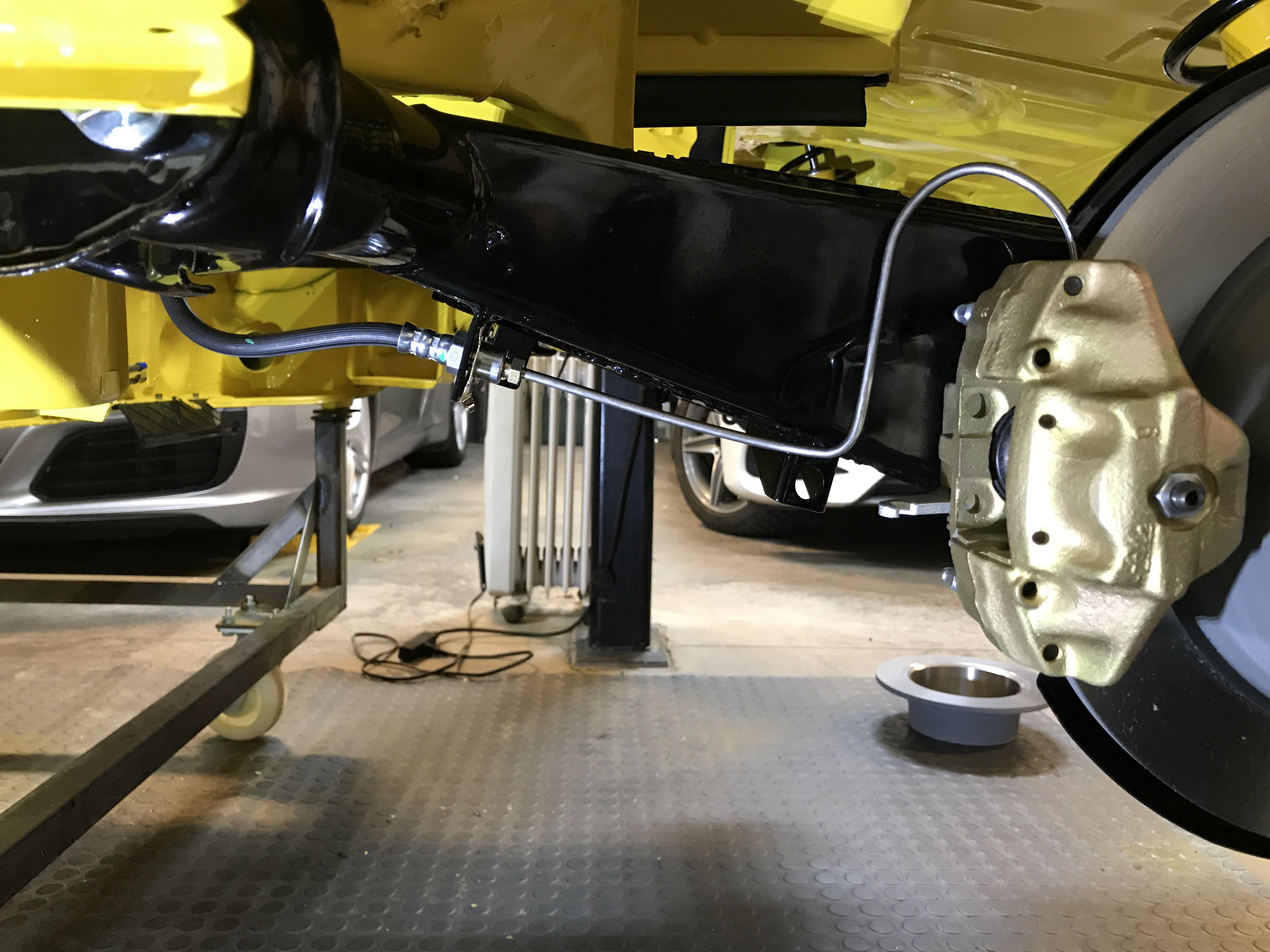

Plumbed with the last sections of hard line and flex line.
