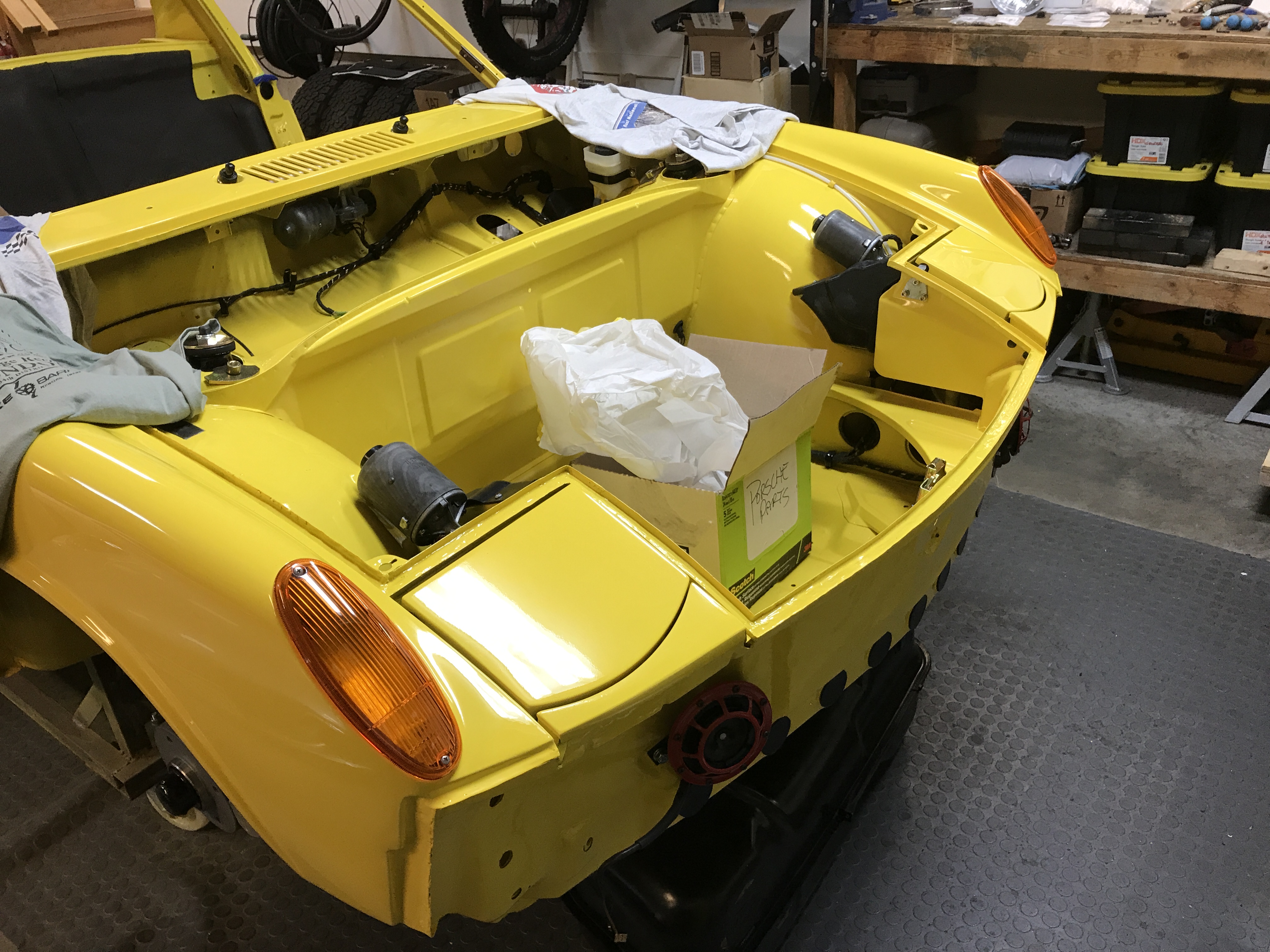

Member No.: 23,343
Starting to look more like a 914.

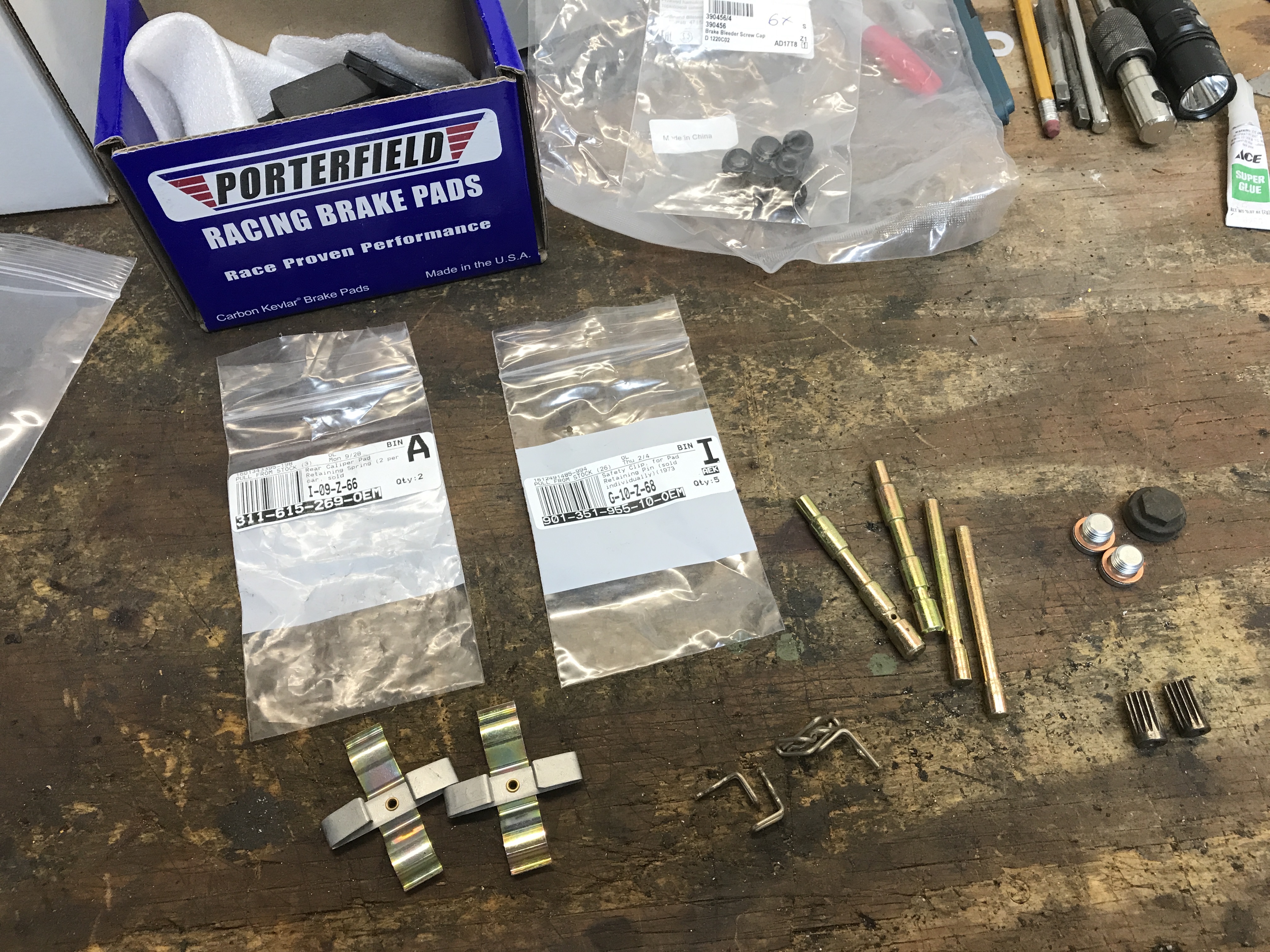

Member No.: 23,343

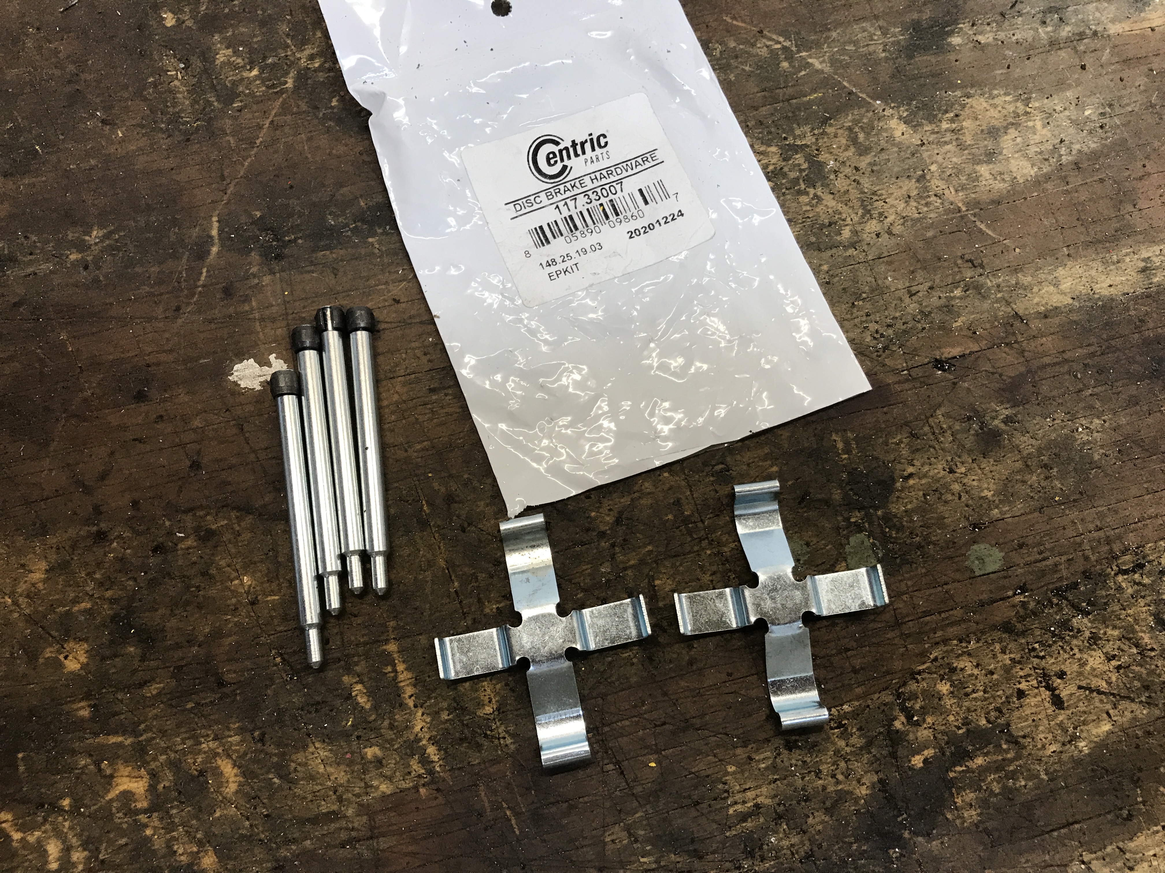

More parts arrived, including a front caliper hardware kit from an Ebay supplier.

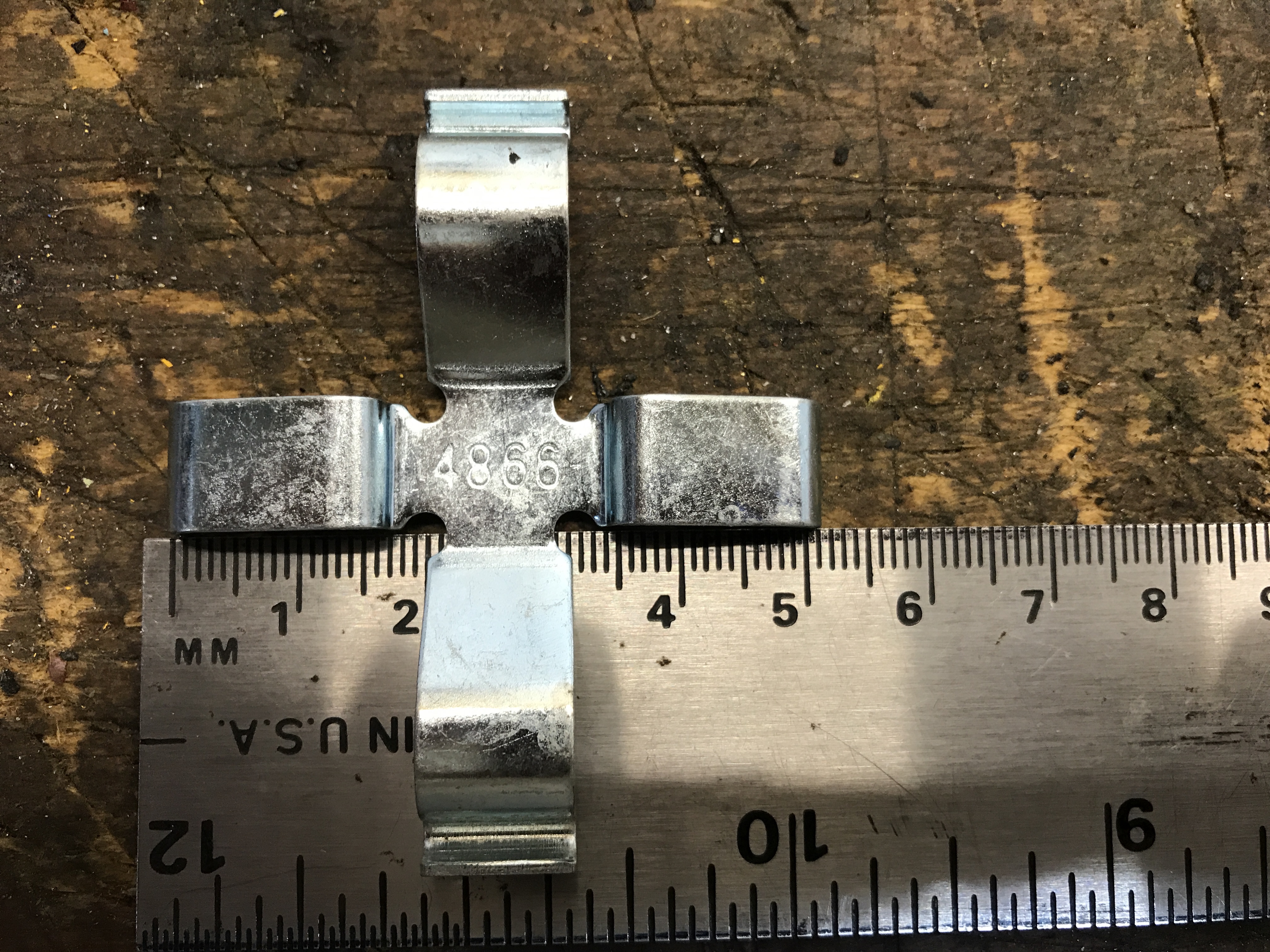

Member No.: 23,343

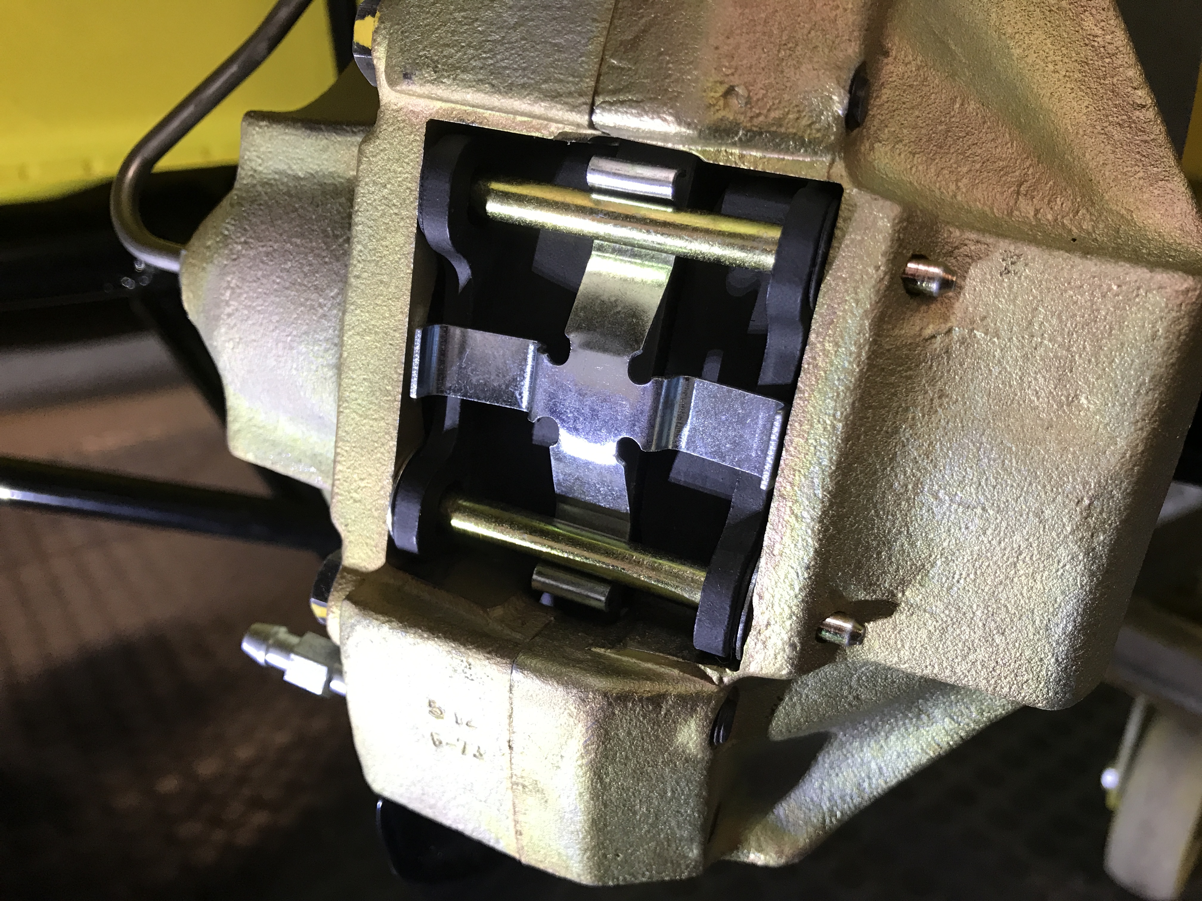

The pad spreader spring is one piece, instead of the original riveted two-piece, but it has the correct spread: about 51 mm.
bkrantz
post Feb 17 2021, 08:16 PM
Post #2264
Posts: 8,763
Joined: 3-August 19
From: SW Colorado
Member No.: 23,343
This should work!

Member No.: 23,343

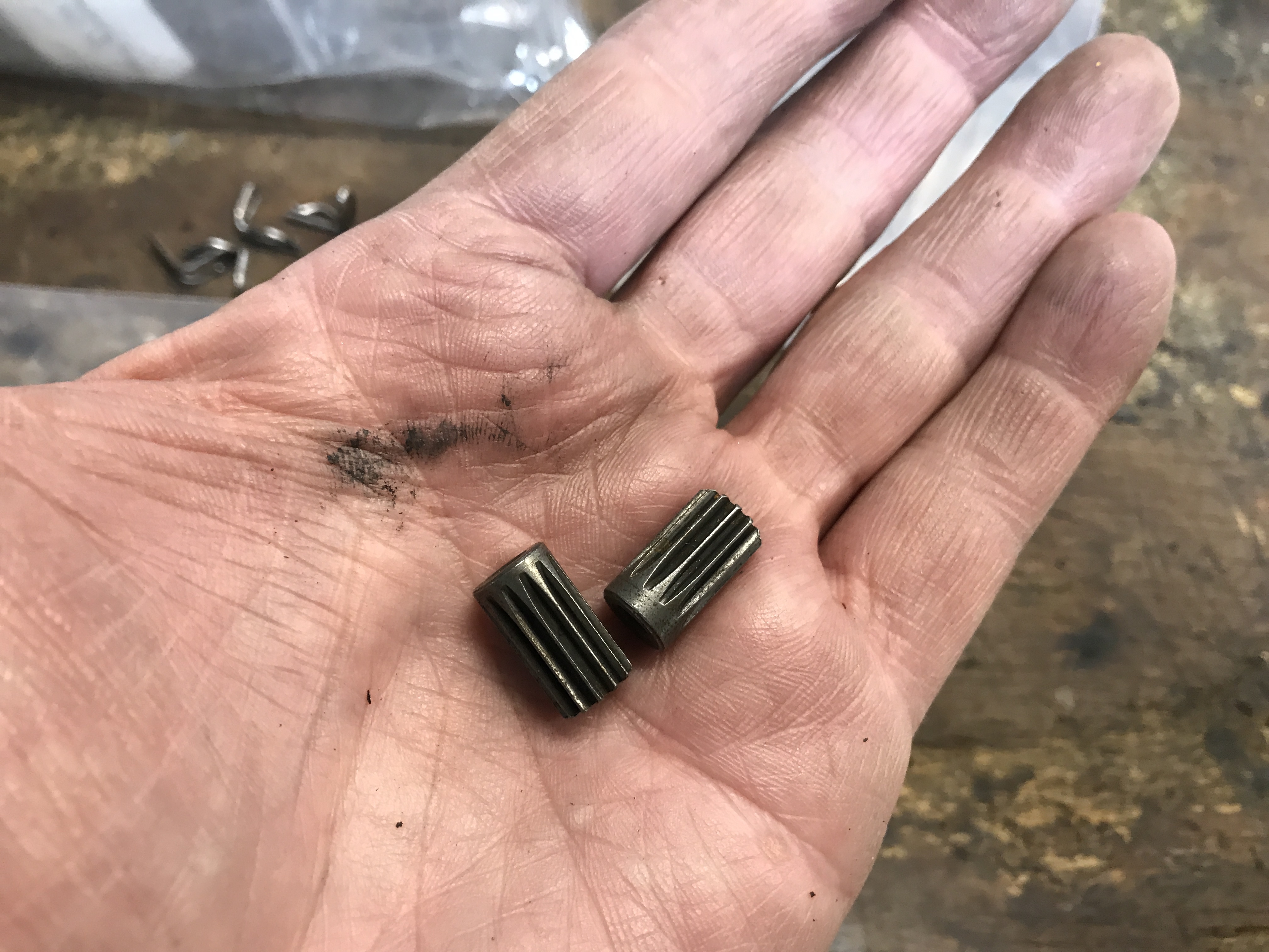

I also got the missing magic inner adjuster gears for the rear calipers.
bkrantz
post Feb 17 2021, 08:18 PM
Post #2266
Posts: 8,763
Joined: 3-August 19
From: SW Colorado
Member No.: 23,343
So now I should have all the rear caliper hardware.
bkrantz
post Feb 17 2021, 08:19 PM
Post #2267
Posts: 8,763
Joined: 3-August 19
From: SW Colorado
Member No.: 23,343

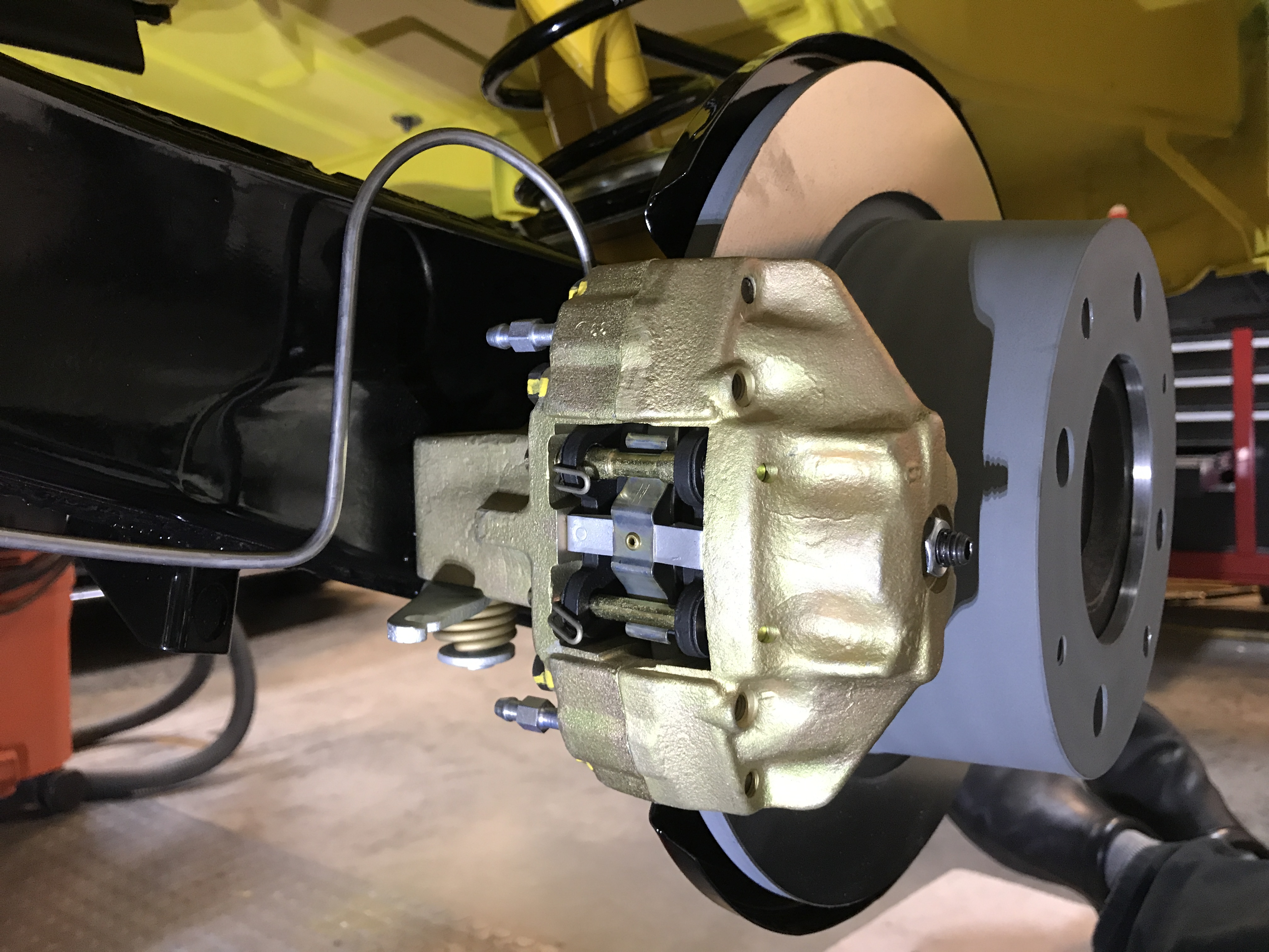

So that meant I could finish the rear brakes. Actual pad clearance adjustment will wait until I install the sub axles. Oh, and that brake bleeding thing.

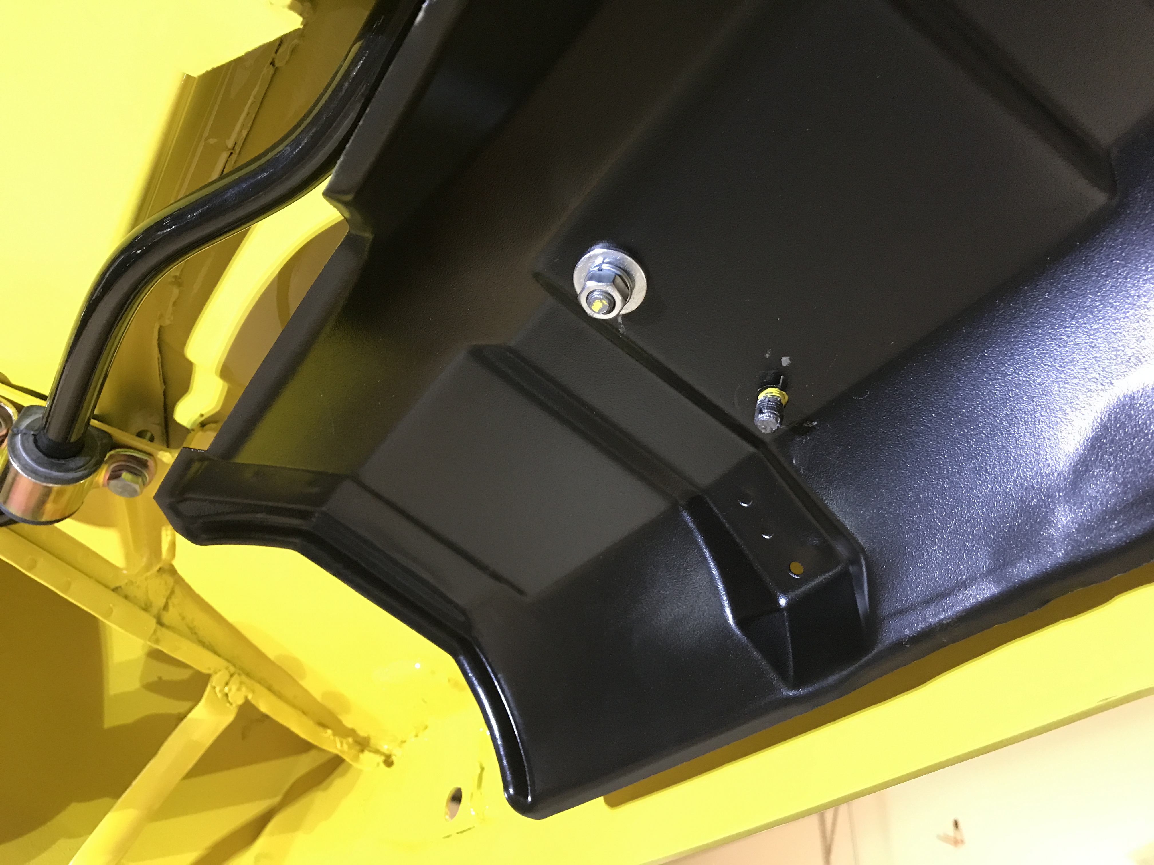

bkrantz
post Feb 17 2021, 08:25 PM
Post #2270
Posts: 8,763
Joined: 3-August 19
From: SW Colorado
Member No.: 23,343

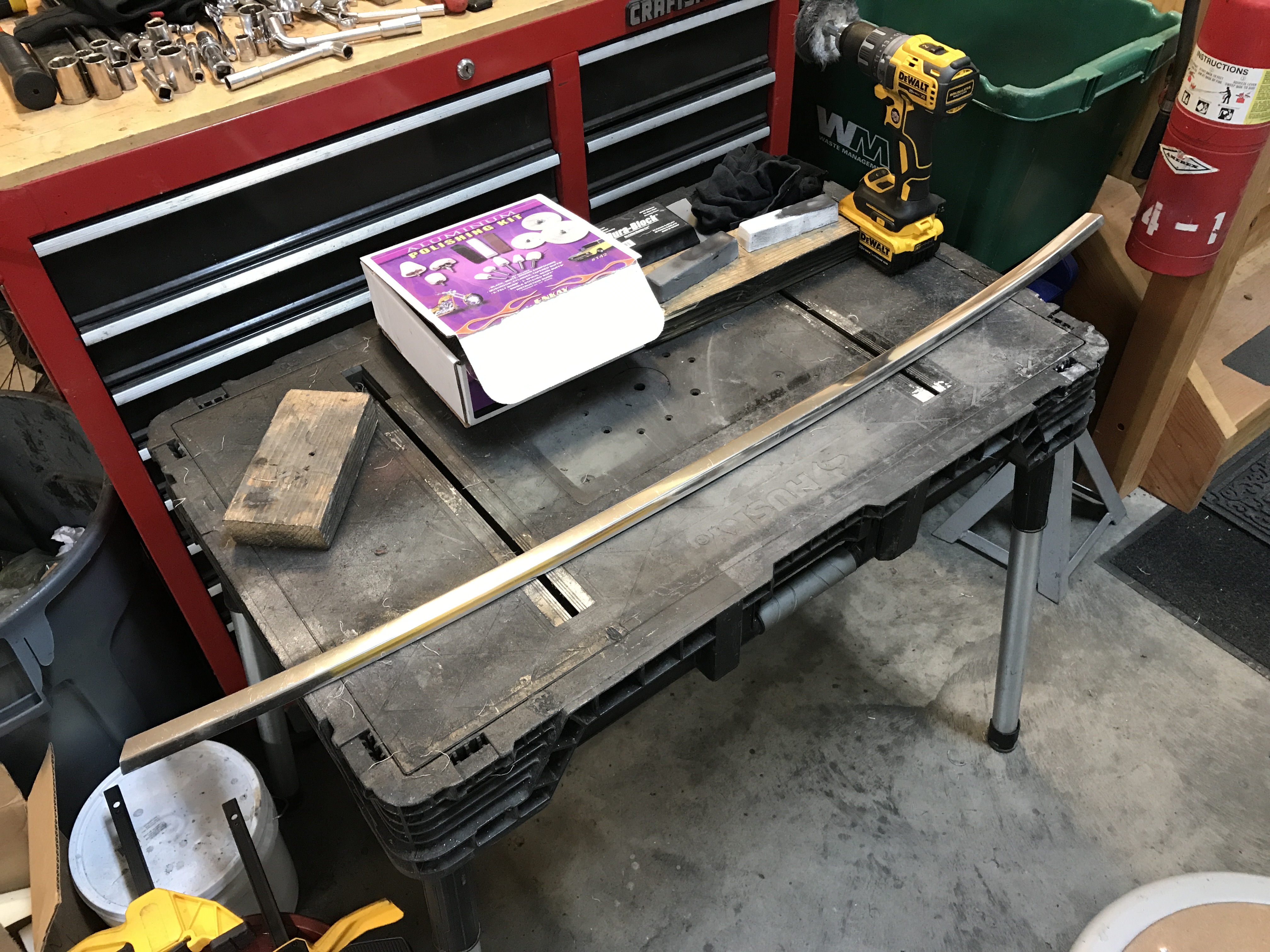

Last job today was to finish polishing aluminum trim, with the front and rear window weatherstrip retaining strips. These were also sanded and painted black by the PO.

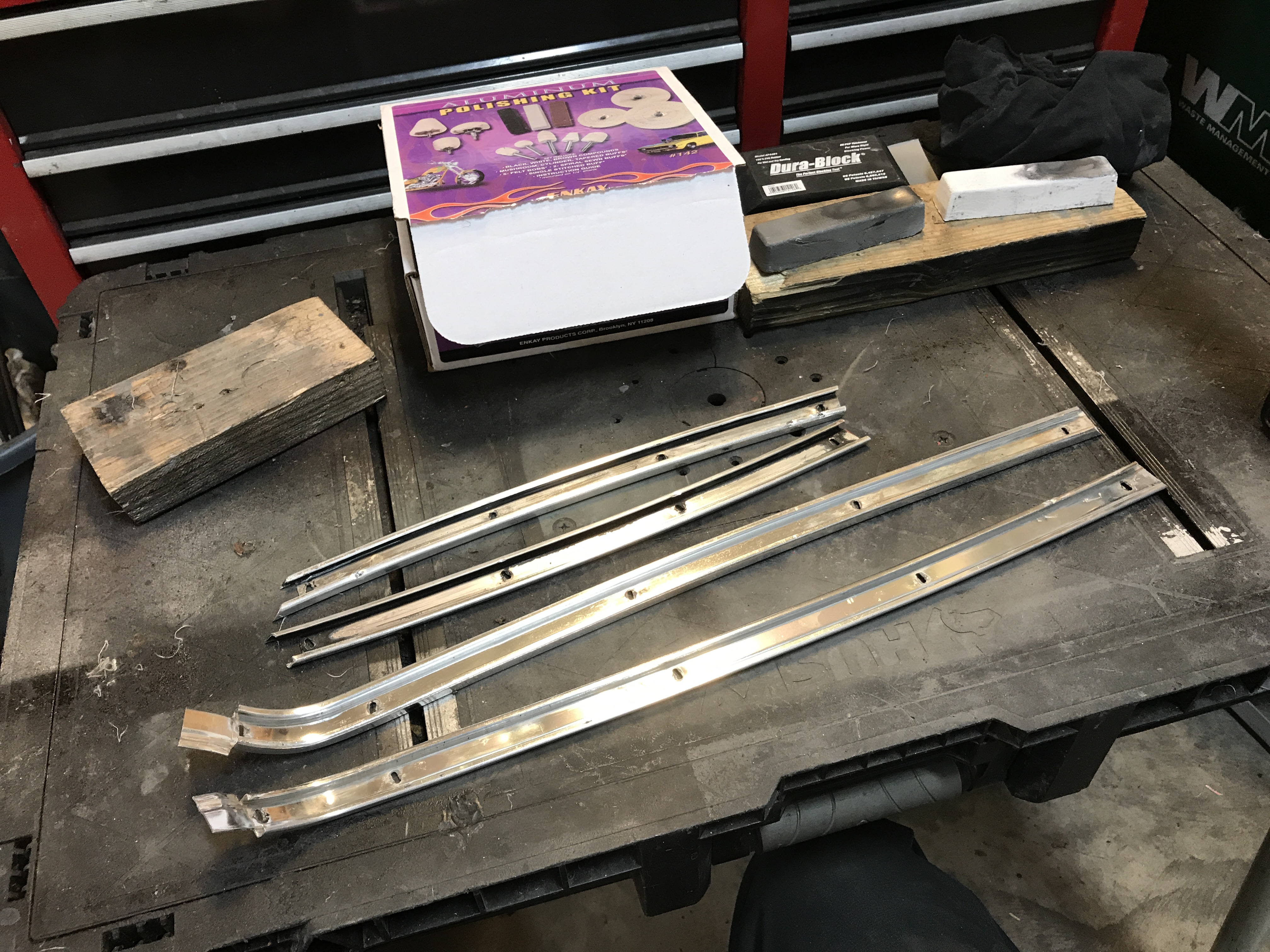

bkrantz
post Feb 17 2021, 08:26 PM
Post #2271
Posts: 8,763
Joined: 3-August 19
From: SW Colorado
Member No.: 23,343
Not perfect, and with a few local dings, but at least shiny now.

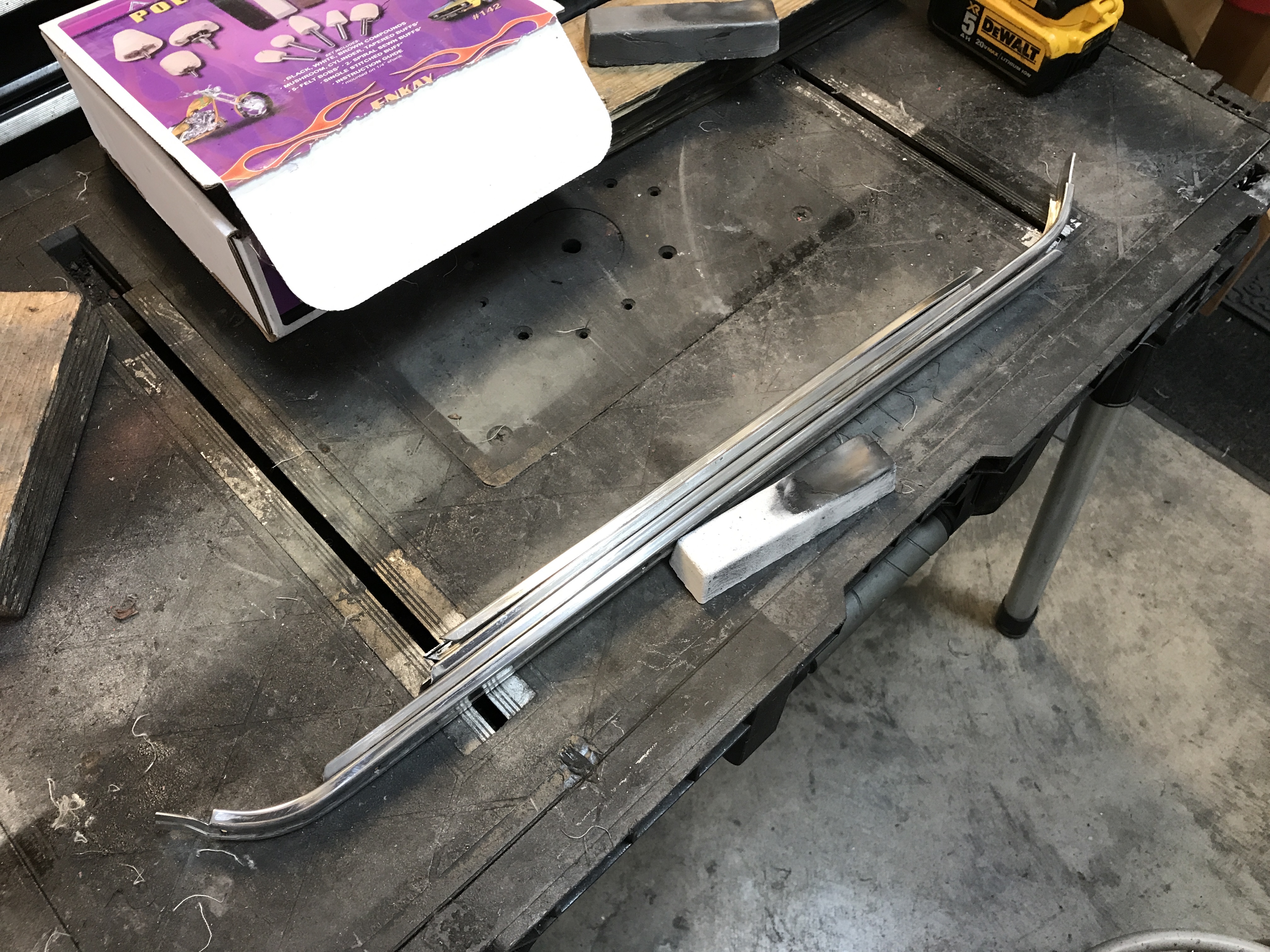

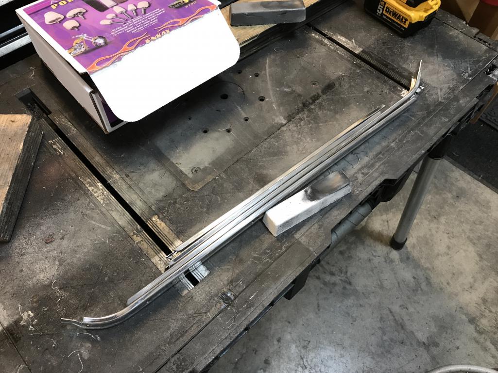

Member No.: 23,343
And I tried giving the targa hoop rear trim a polish of the anodized surface. This is a used replacement piece, not a backed-out version.

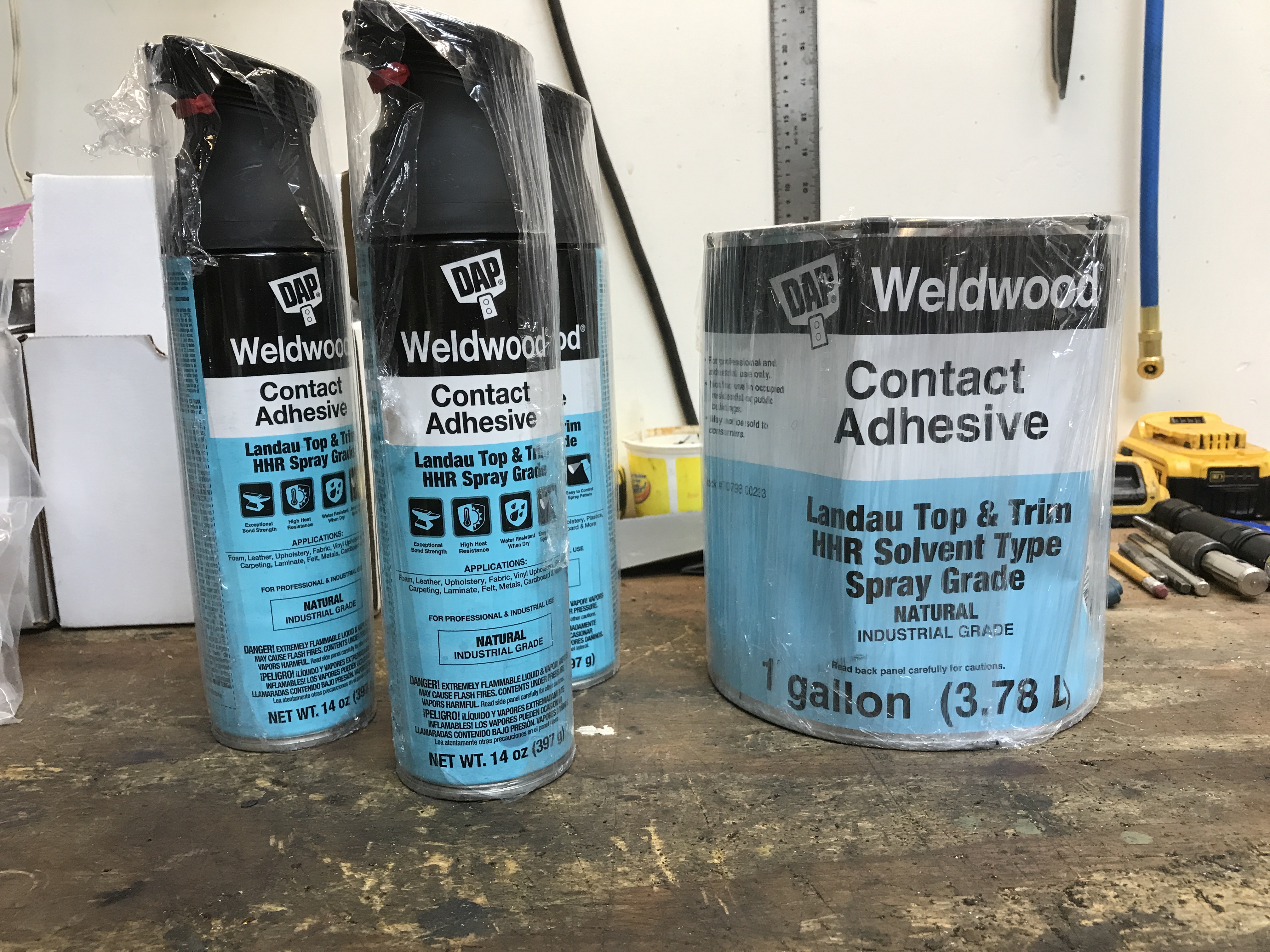

Last thing that arrived today is adhesive for vinyl (targa hoop and dash to start). Based on recommendations and concern for (1) good stick to vinyl and (2) heat resistance, I decided on DAP Landau contact adhesive. And I found aerosol cans to go along with the 1 gallon liquid can, for brush-on.

Very cool that you can get it in spray cans now. Amazon?

https://www.yourautotrim.com

From what I remember the blue label can is already thinned for a spray gun but it has been a while.

I’ve sprayed right out of that gallon can. But def wear a respirator...it’s nasty stuff that will get you dizzy in minutes (IMG:style_emoticons/default/smile.gif)

Thanks, guys. I got the liquid for if/when I need to brush some on, most likely around edges. I would have been happy to buy just a pint, but could only find the gallon size.

I'm not sure how well the thinned stuff brushes on. I would test first.
I use one on the $10 HF spray guns to spray it on. Clean with gasoline.
Use it up because it disappears like magic.
