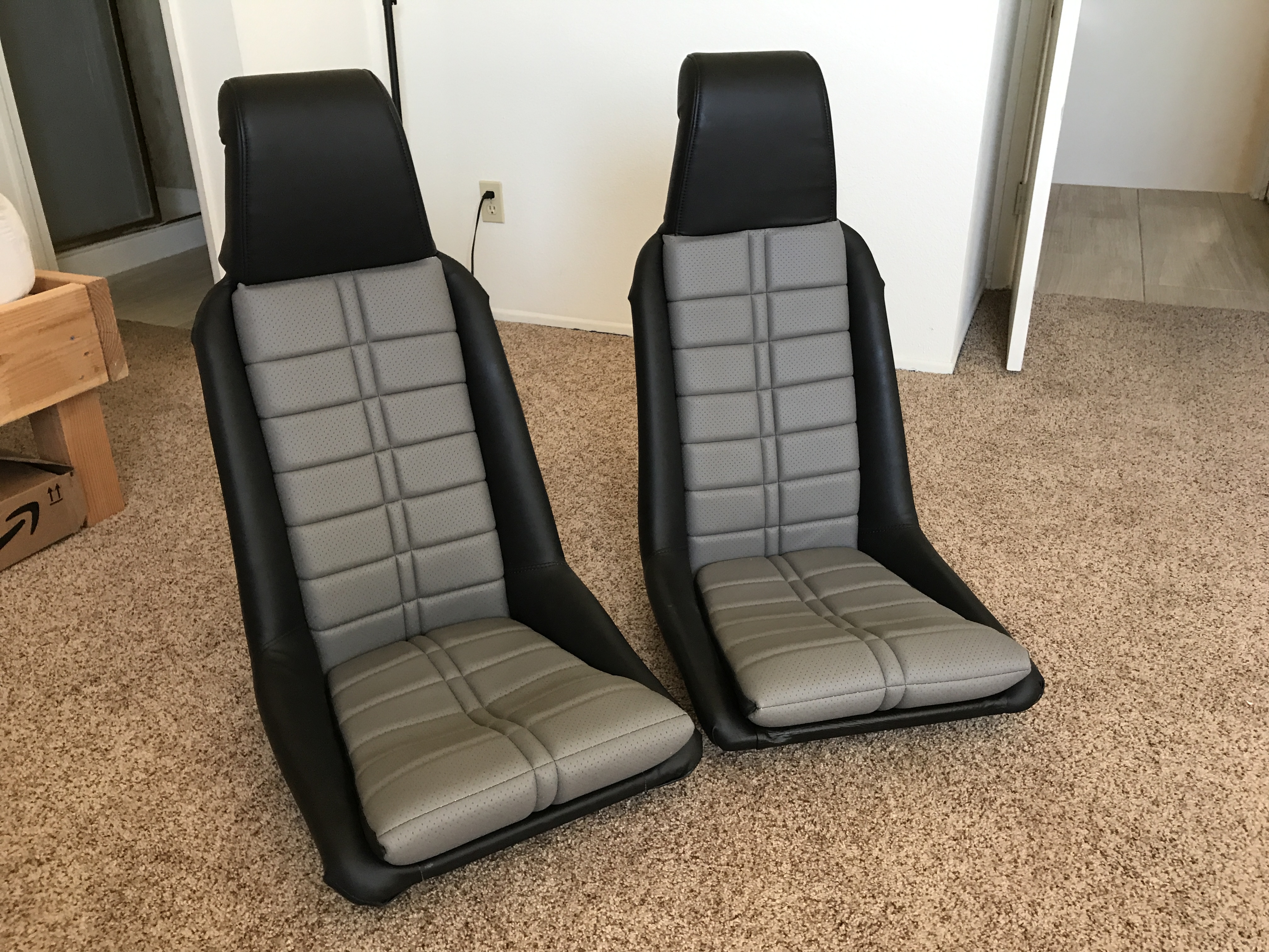

I finally got to see my seats and other interior pieces. Not perfect (and not original) but I am very satisfied.

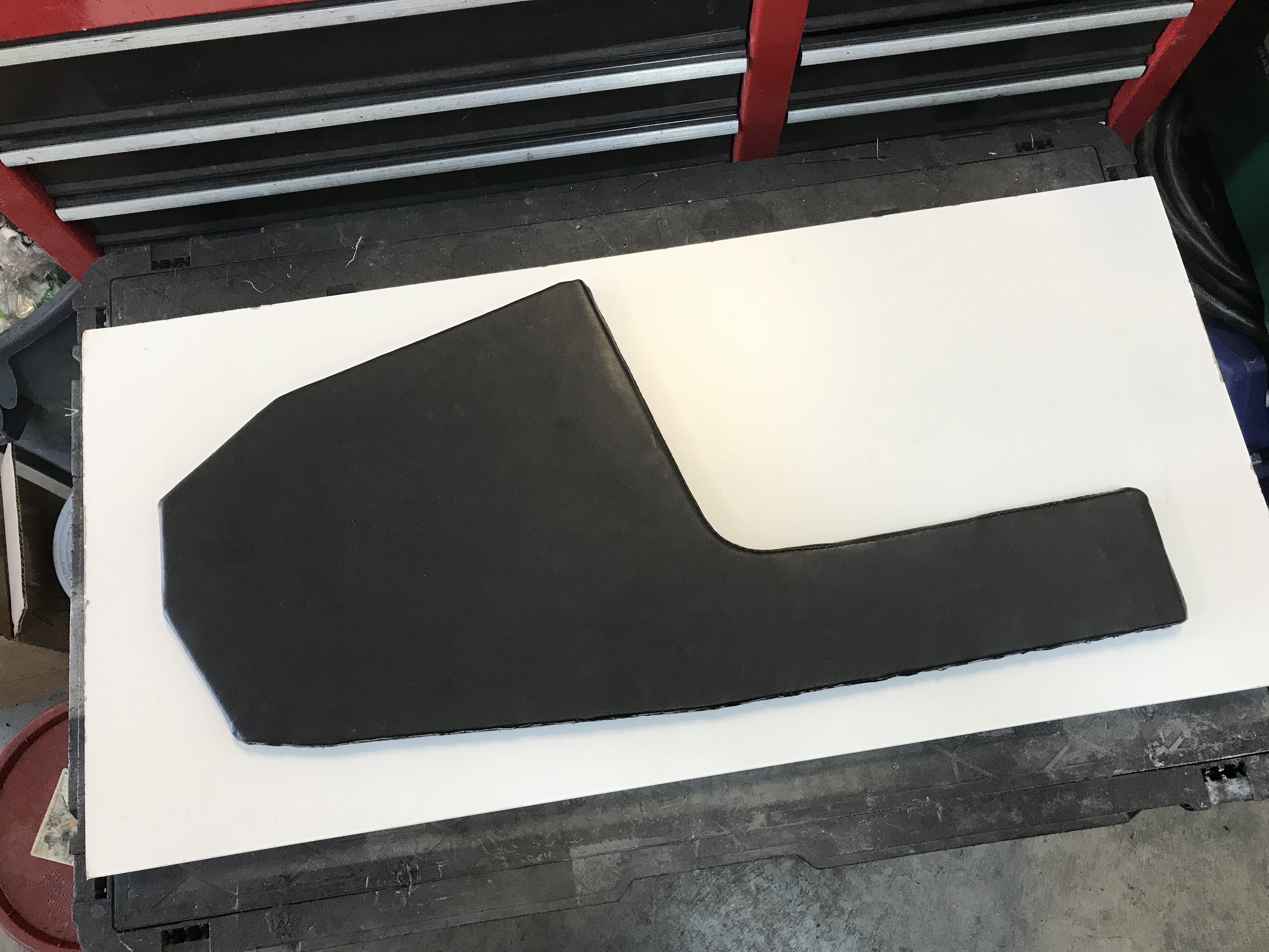

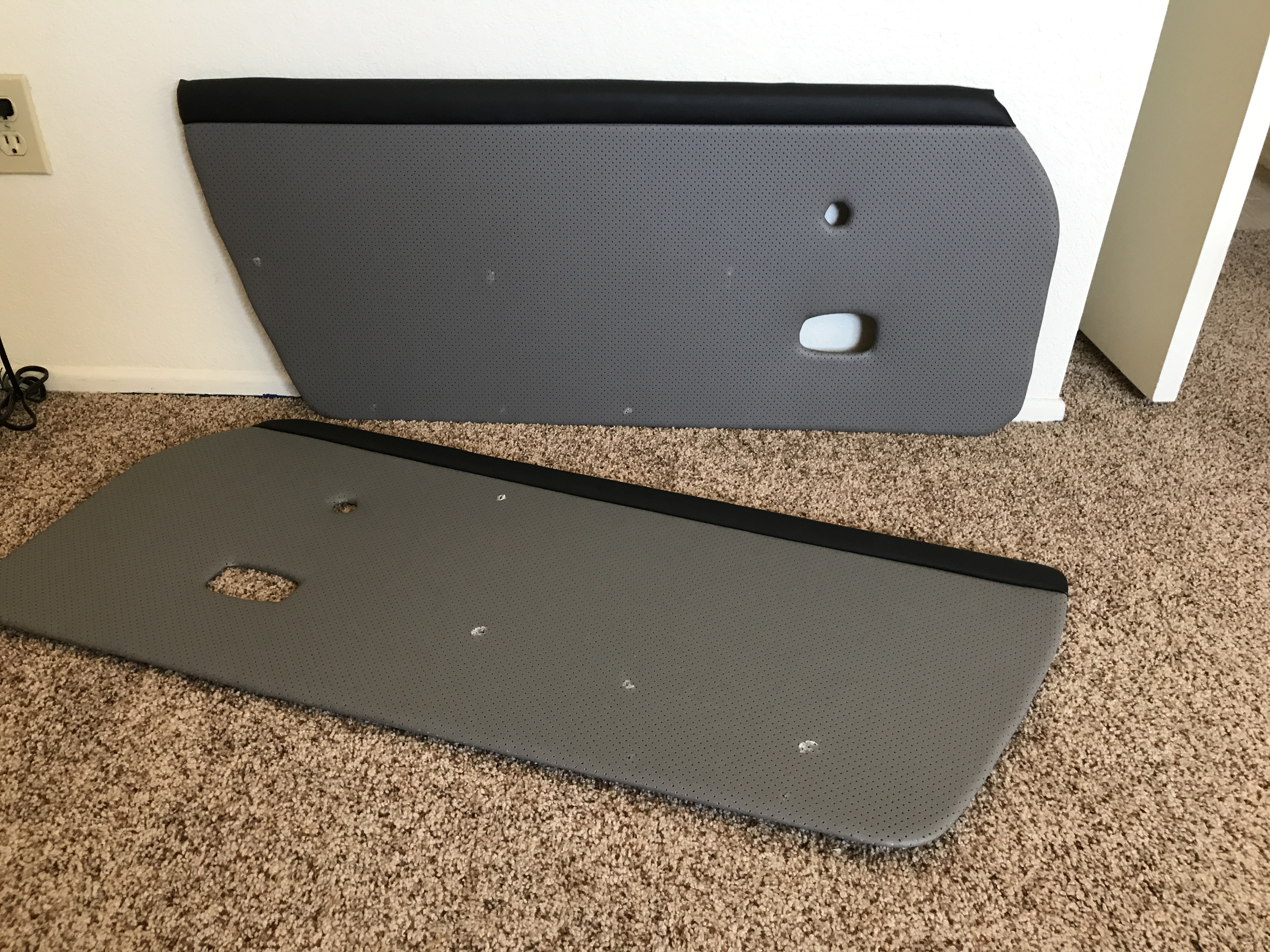

Door panels look good, too.

Those seats look fantastic! Seeing things like that makes me curse being afflicted with CW disease. (IMG:style_emoticons/default/drooley.gif)

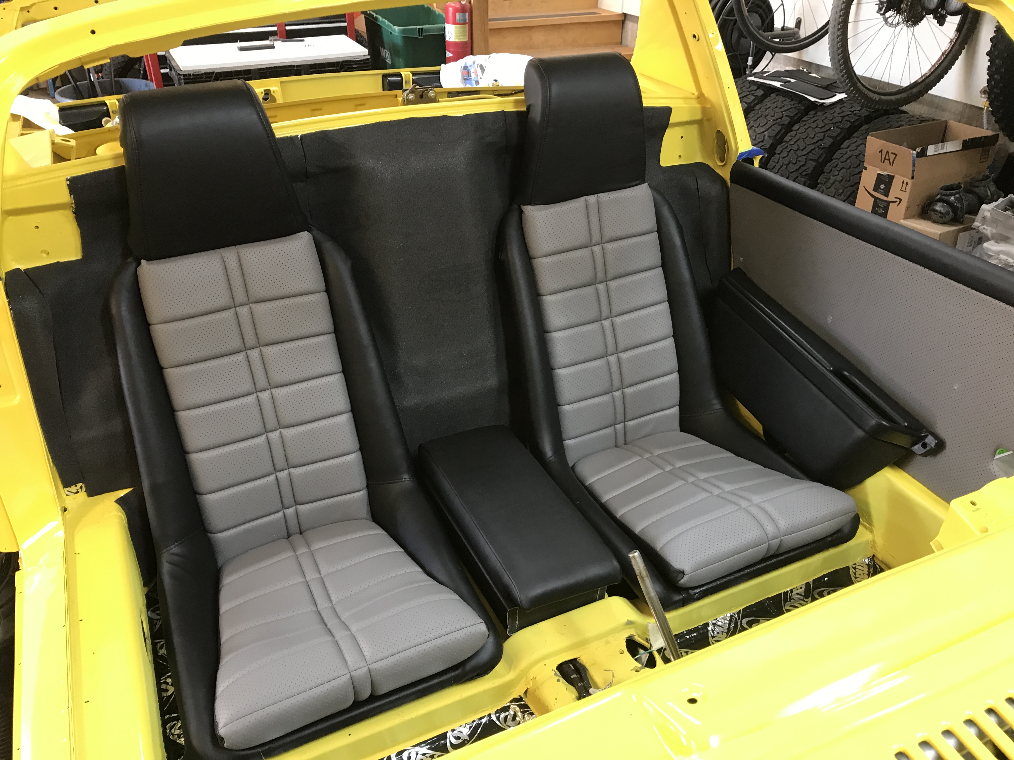

Finally home and ready to play in my garage again. Since I brought the recovered seats and interior parts home, I could not resist seeing how these look in the car.

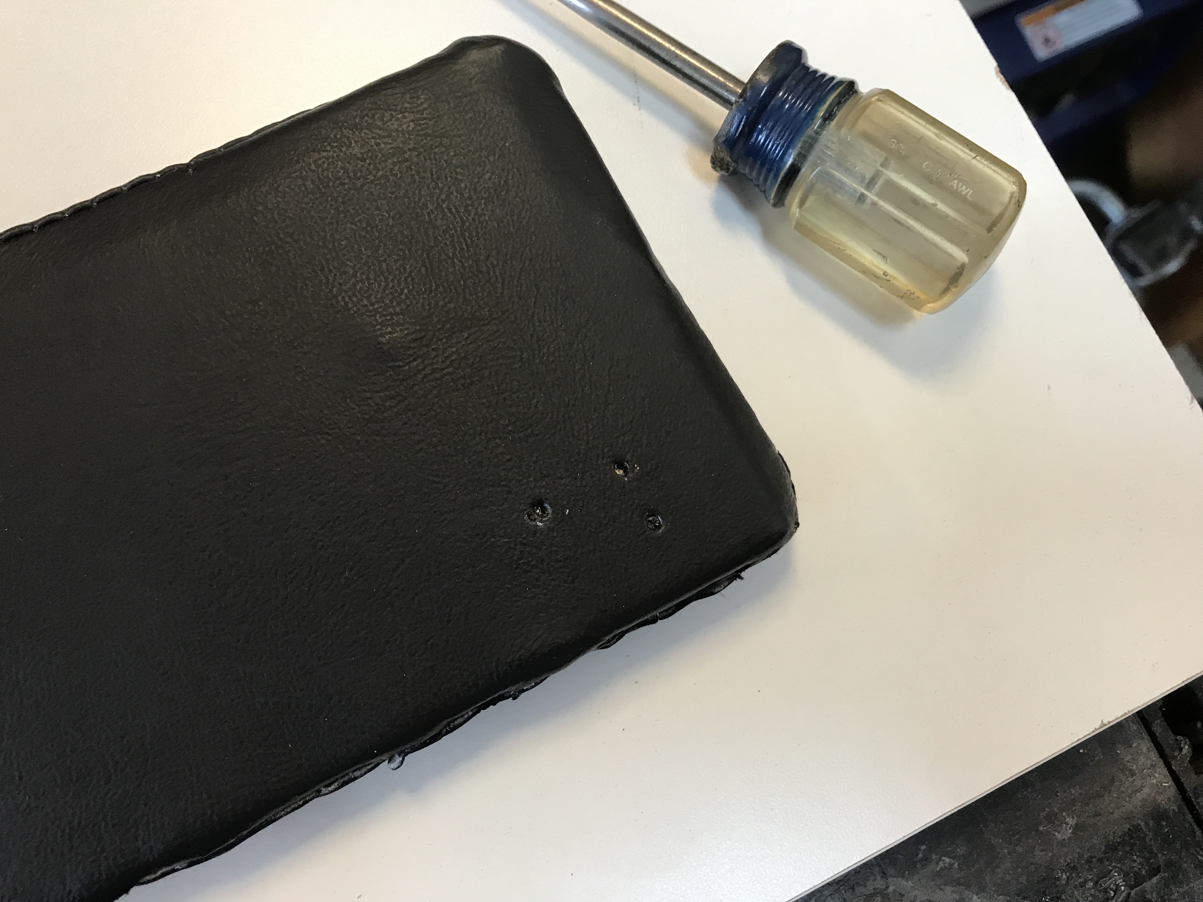

I also (literally) poked around on the center console panels. This is the right side interior.

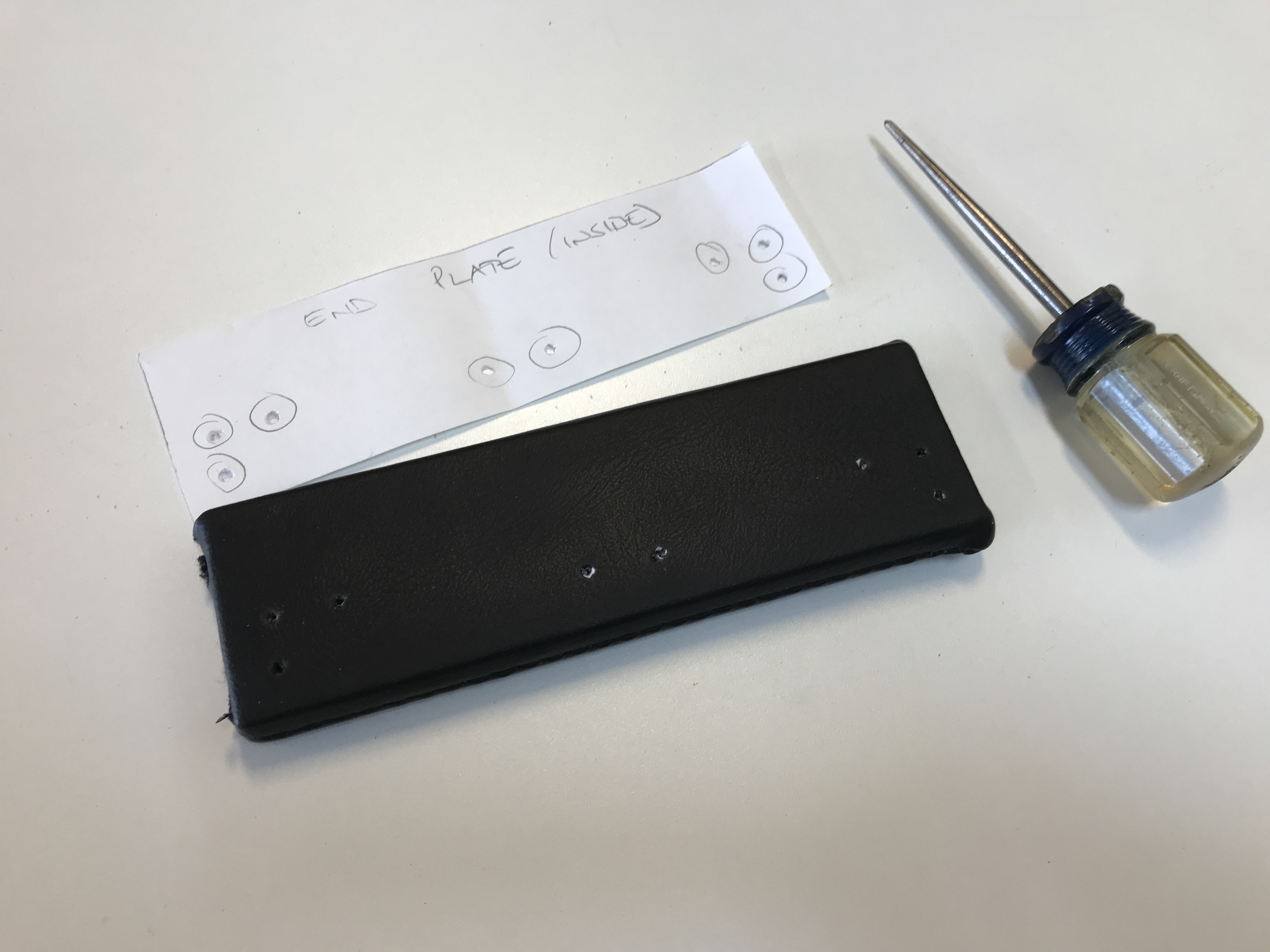

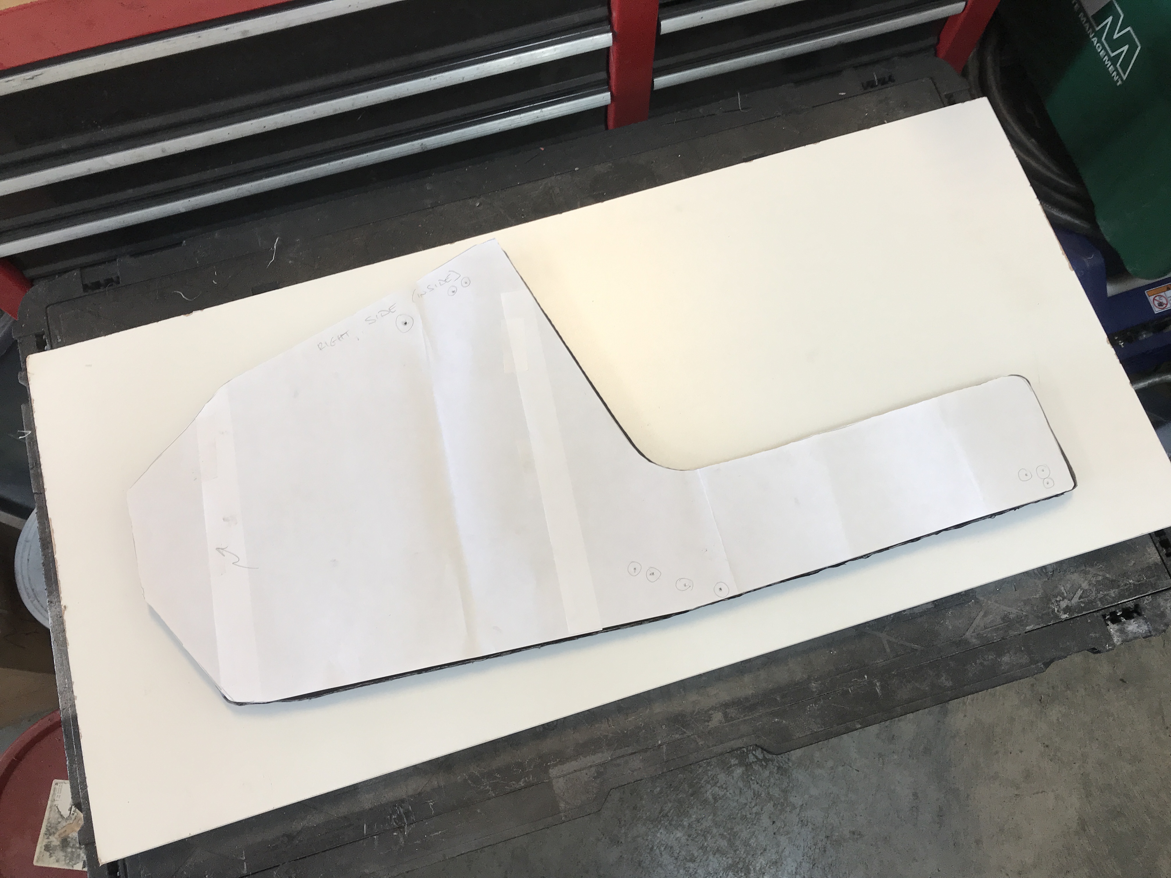

Months ago, I made paper templates to show all the holes for mounting hardware.
bkrantz
post Mar 2 2021, 08:26 PM
Post #2295
Posts: 8,763
Joined: 3-August 19
From: SW Colorado
Member No.: 23,343
I was able to find all the holes easily.

QUOTE(bkrantz @ Mar 2 2021, 08:23 PM) *
Those look great in the car. Once the carpet is in it will really pop

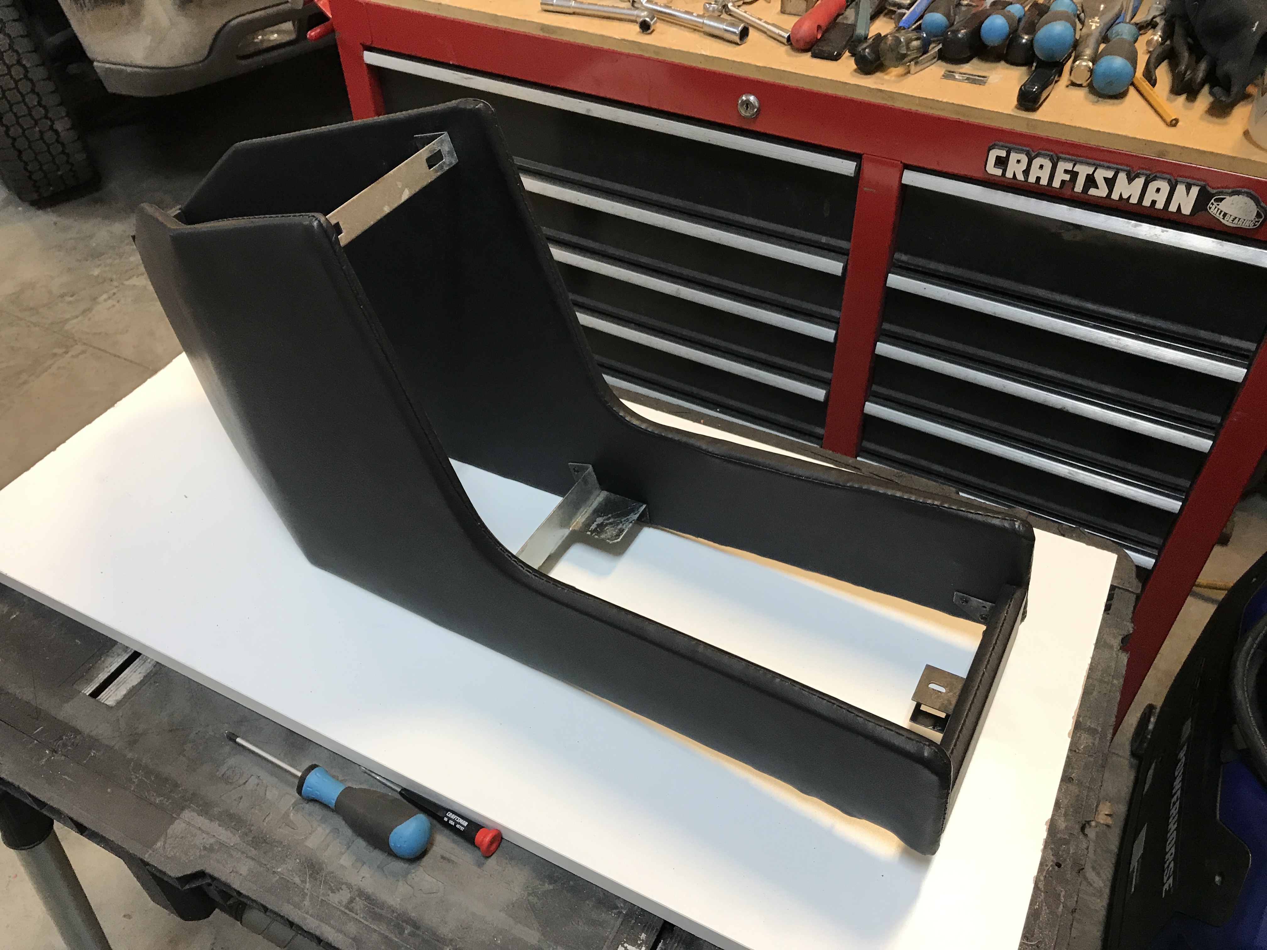

I finished the center console assembly, first with all the metal brackets.

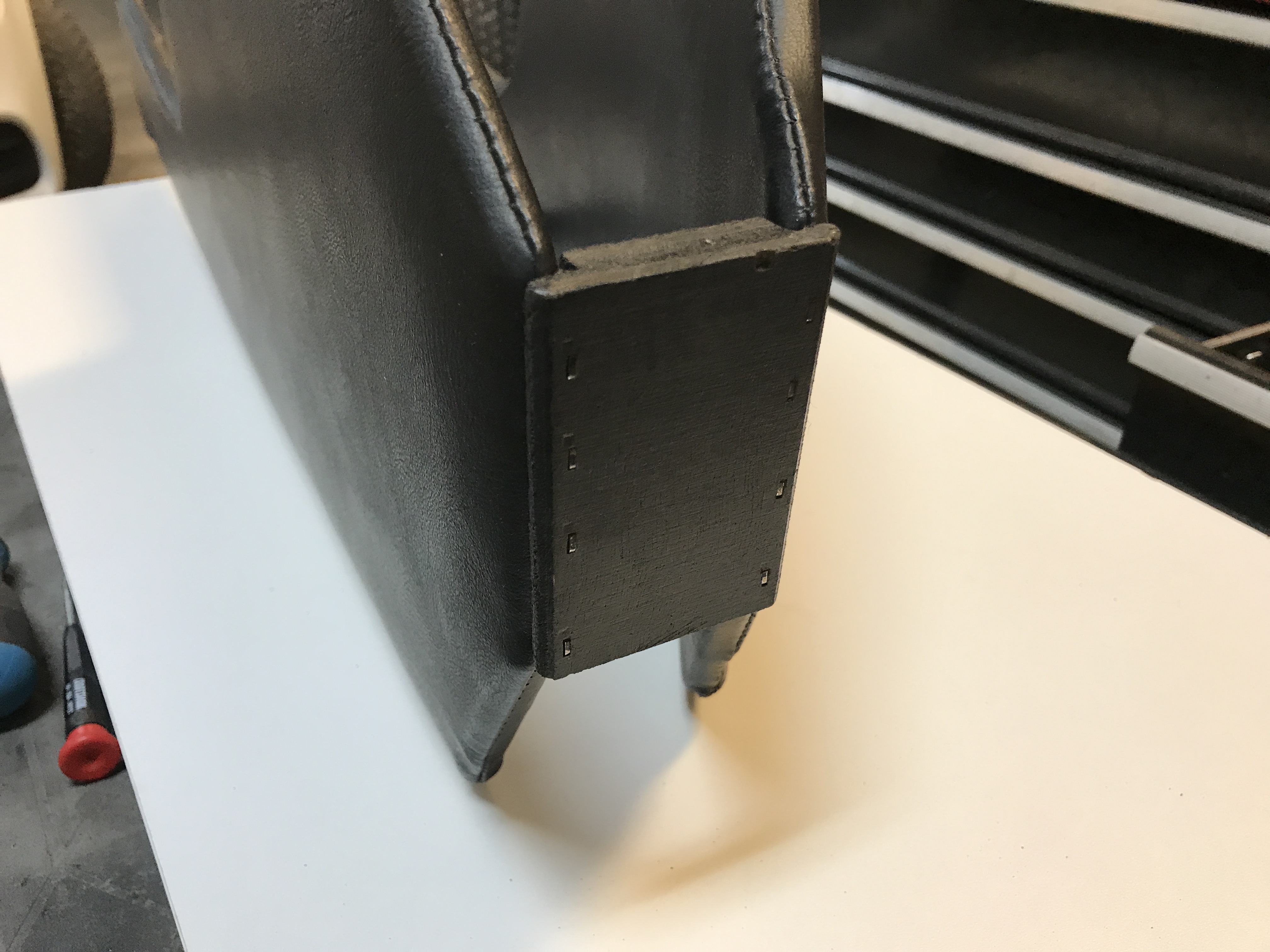

And the end plate, with the original staple nails plus a bit of all-purpose glue.

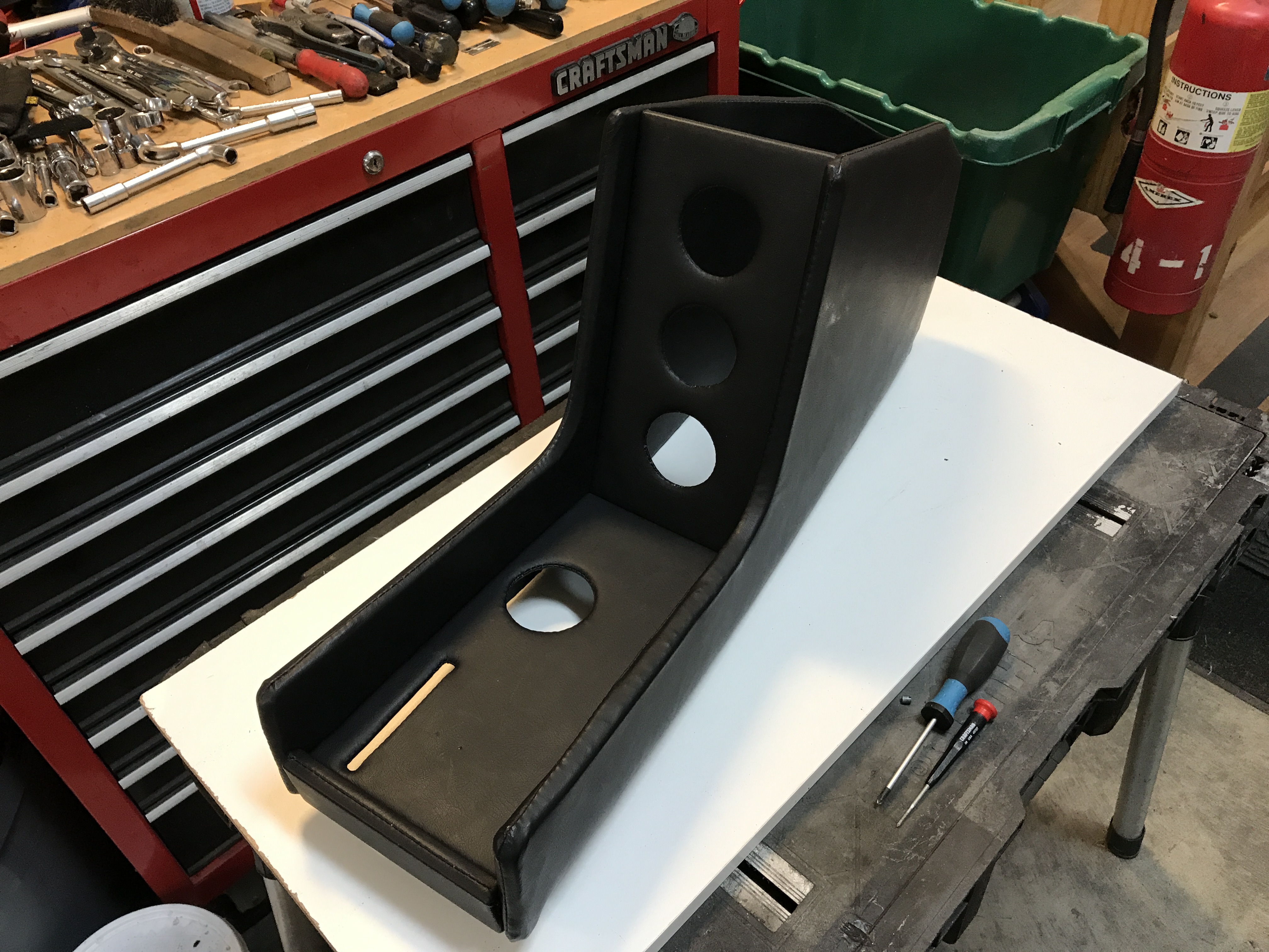

All done, with the bottom piece and the gauge panel. I am 90% satisfied--just the top seam along the right side that is not centered.
