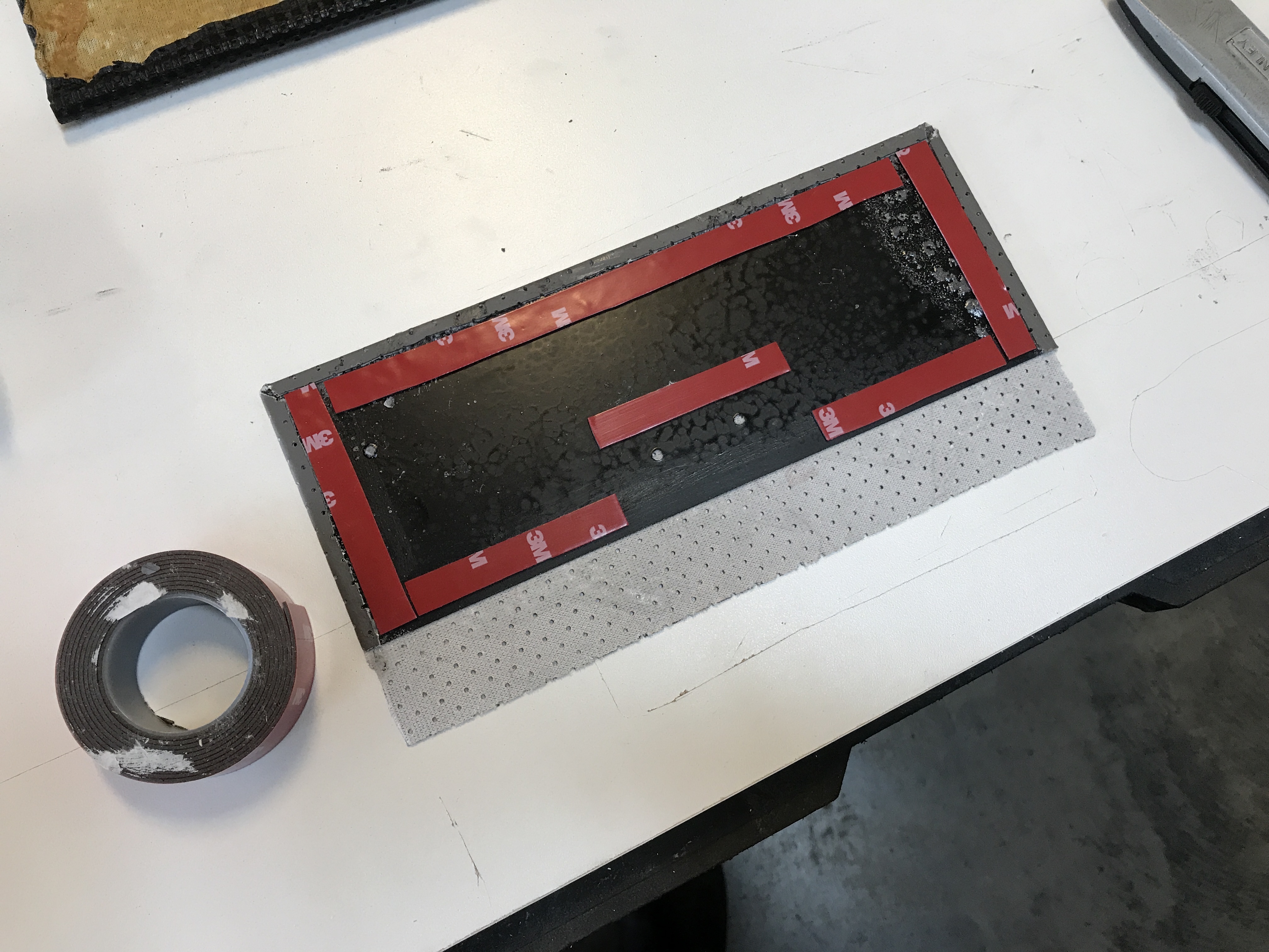

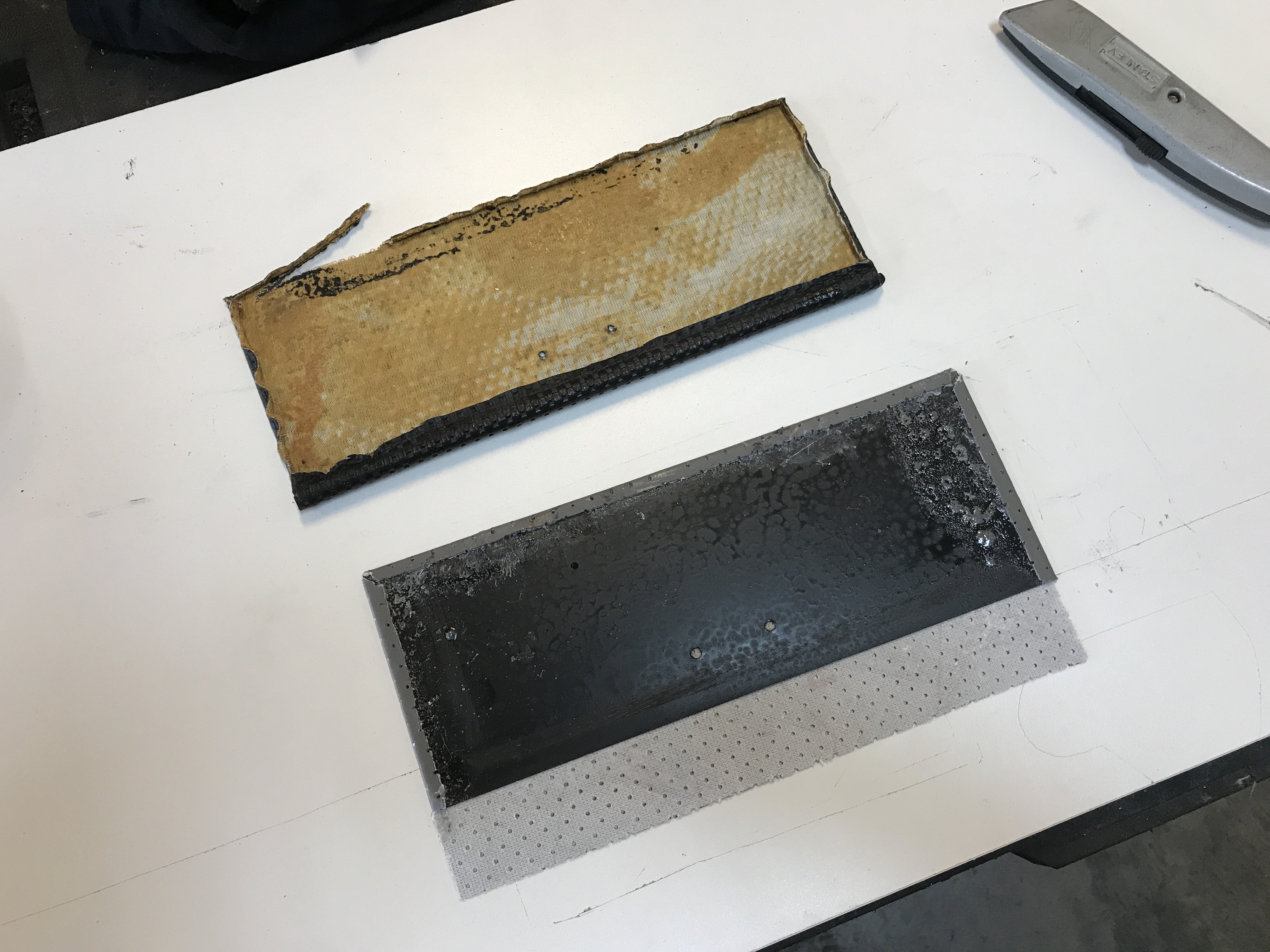

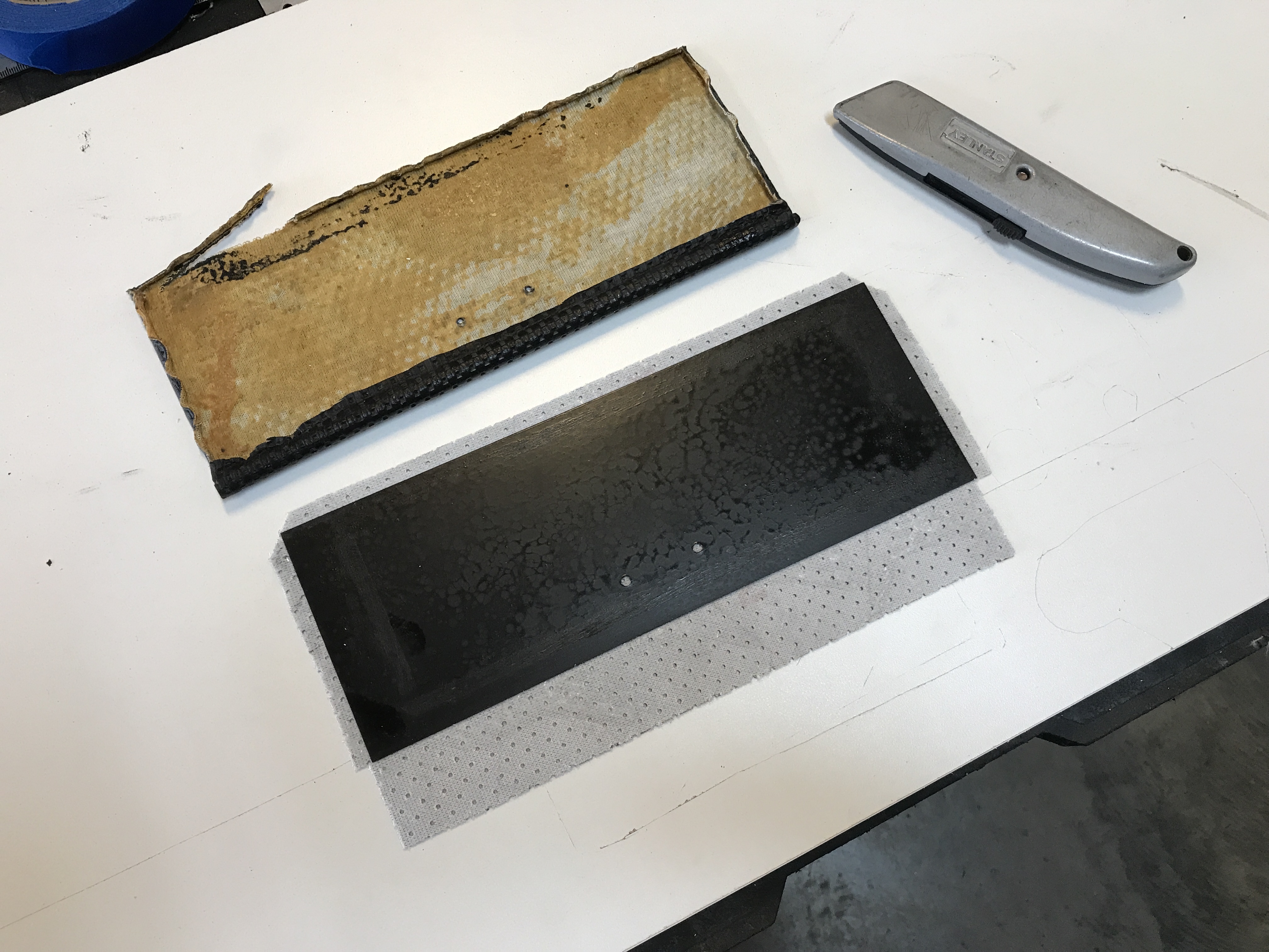

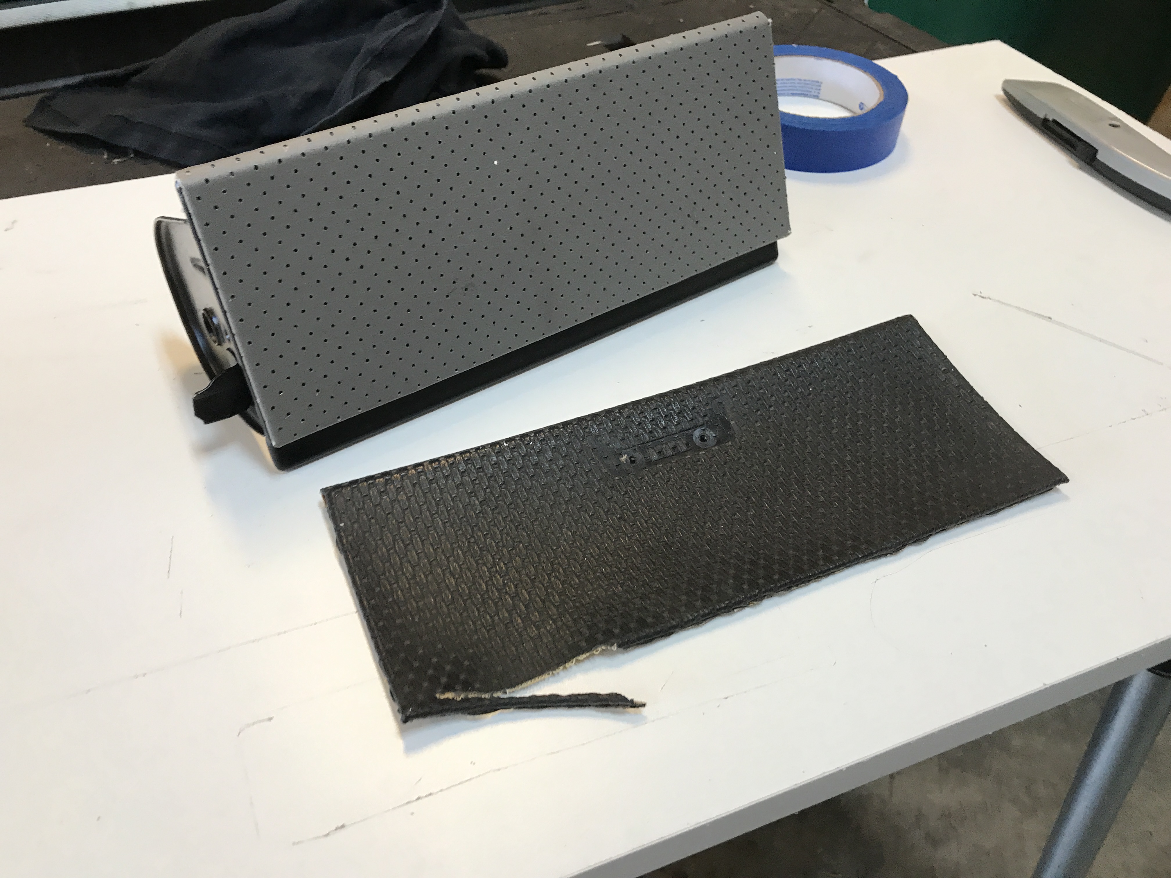

Trimmed close for wrapping on 3 sides, and longer on the edge that will wrap onto the door.
bkrantz
post Mar 4 2021, 08:52 PM
Post #2322
Posts: 8,763
Joined: 3-August 19
From: SW Colorado
Member No.: 23,343
Plate edges wrapped.
bkrantz
post Mar 4 2021, 08:53 PM
Post #2323
Posts: 8,763
Joined: 3-August 19
From: SW Colorado
Member No.: 23,343
I used 3M high strength auto tape to attach the plate to the door.
bkrantz
post Mar 4 2021, 08:55 PM
Post #2324
Posts: 8,763
Joined: 3-August 19
From: SW Colorado
Member No.: 23,343
Final product: plate attached to the door, and the vinyl wrapped over the door edge. This should work.

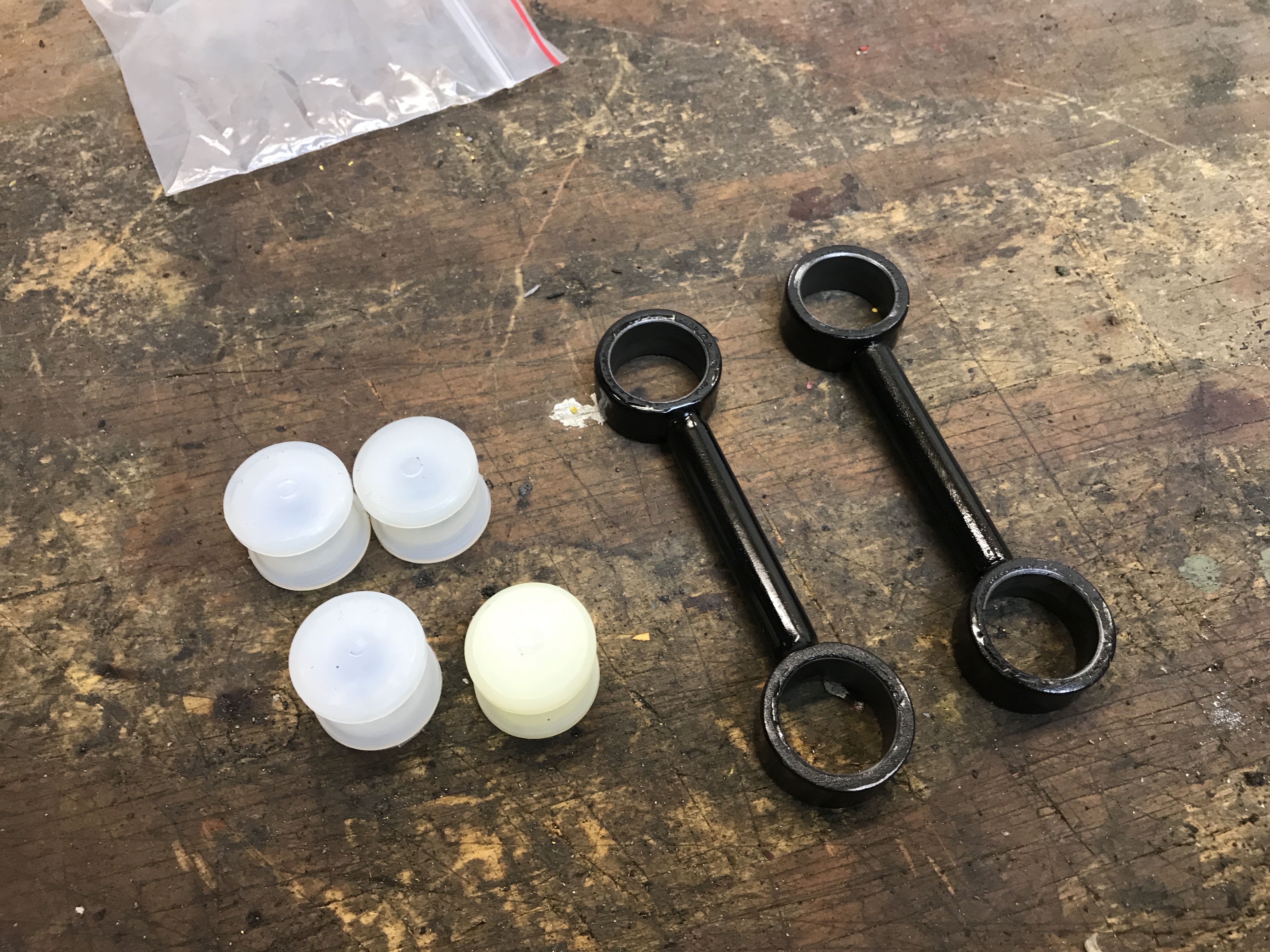

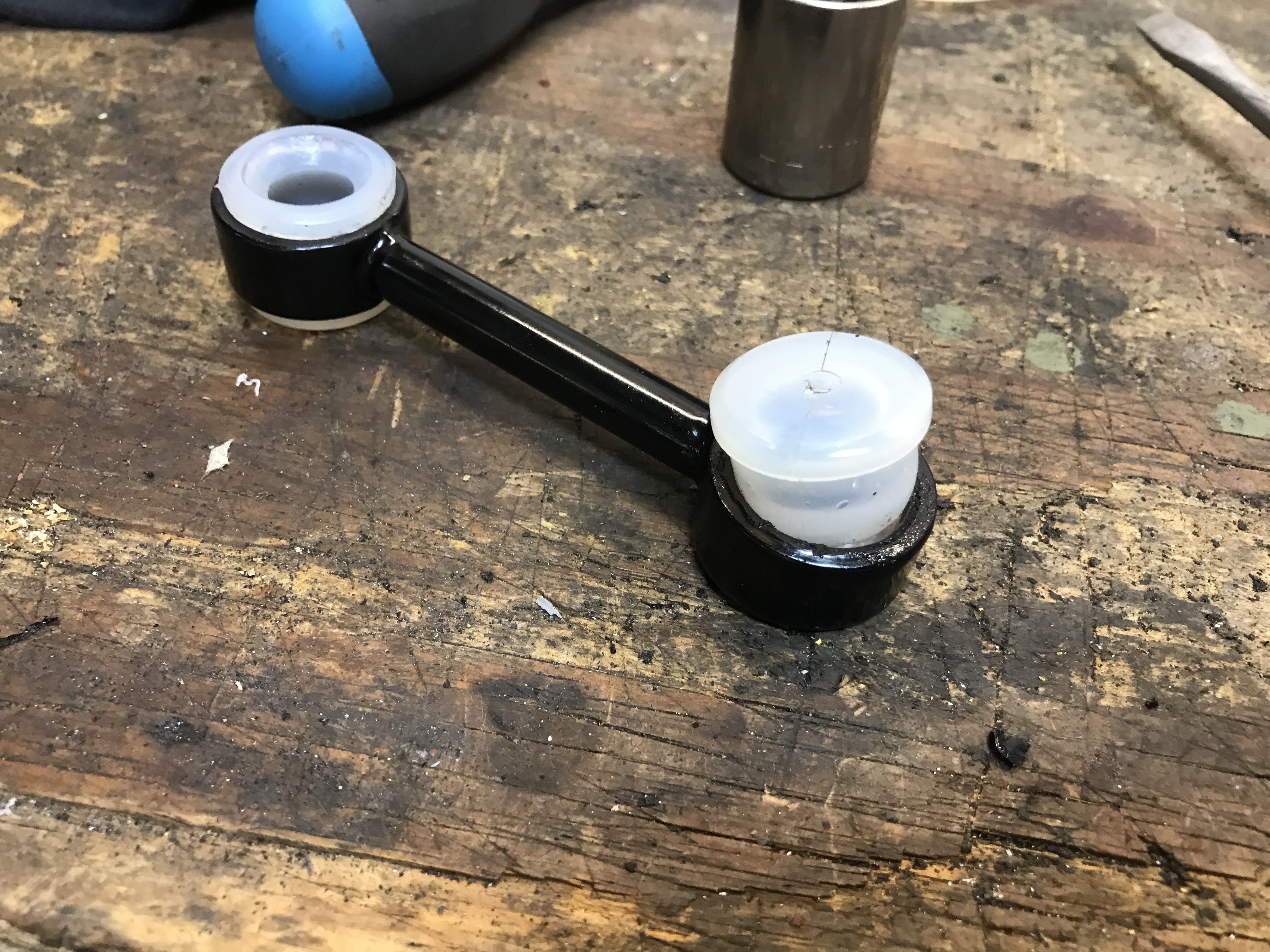

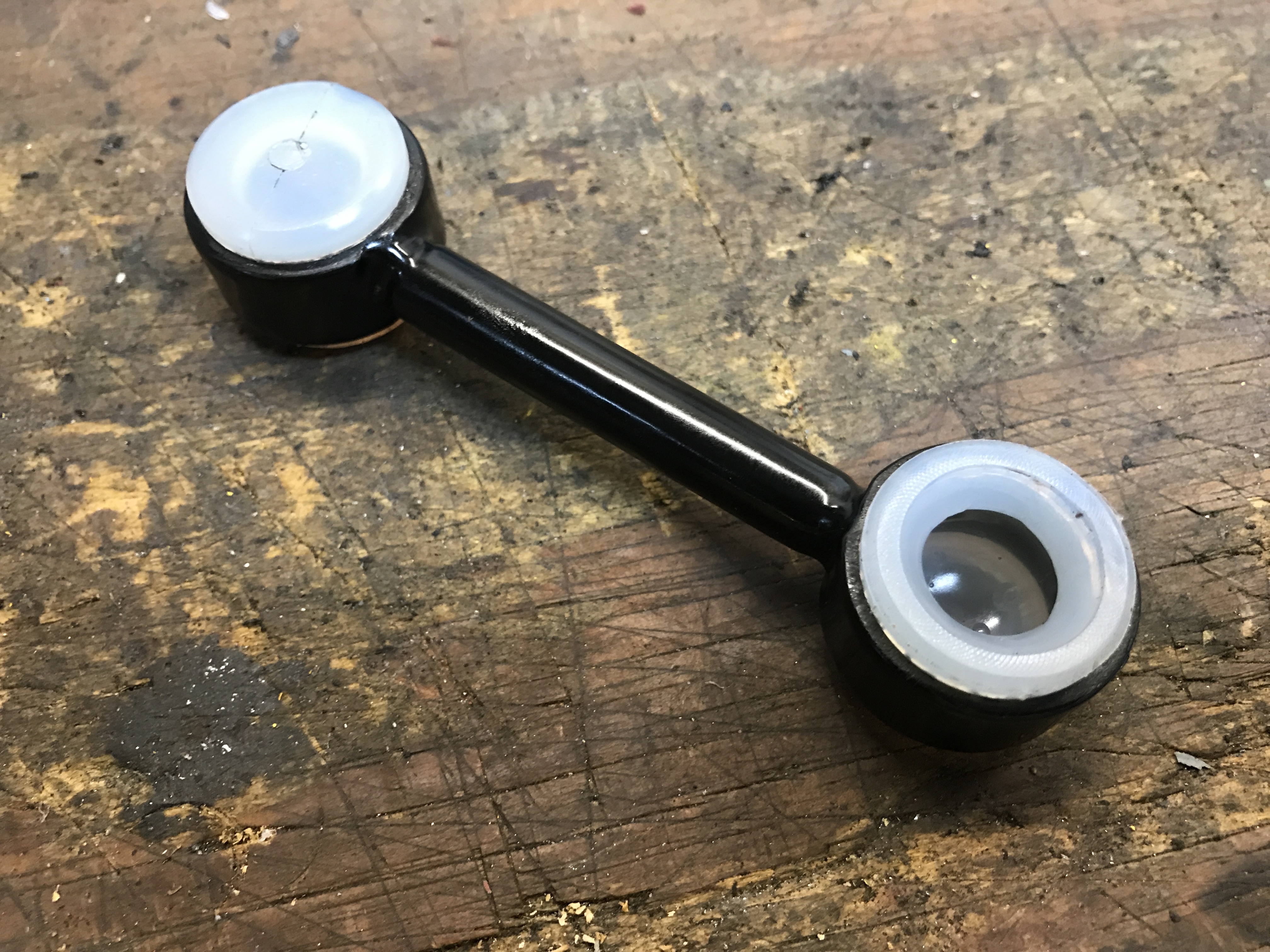

I had about an hour today, and felt calm, so I took on the rear sway bar link bushings. As often reported, this qualifies as a true PITA.
Note the one bushing that looks a bit yellow. This is the only "spare part" I got with the car, besides some fuses floating in the center box.

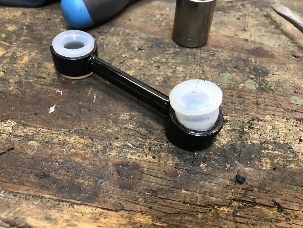

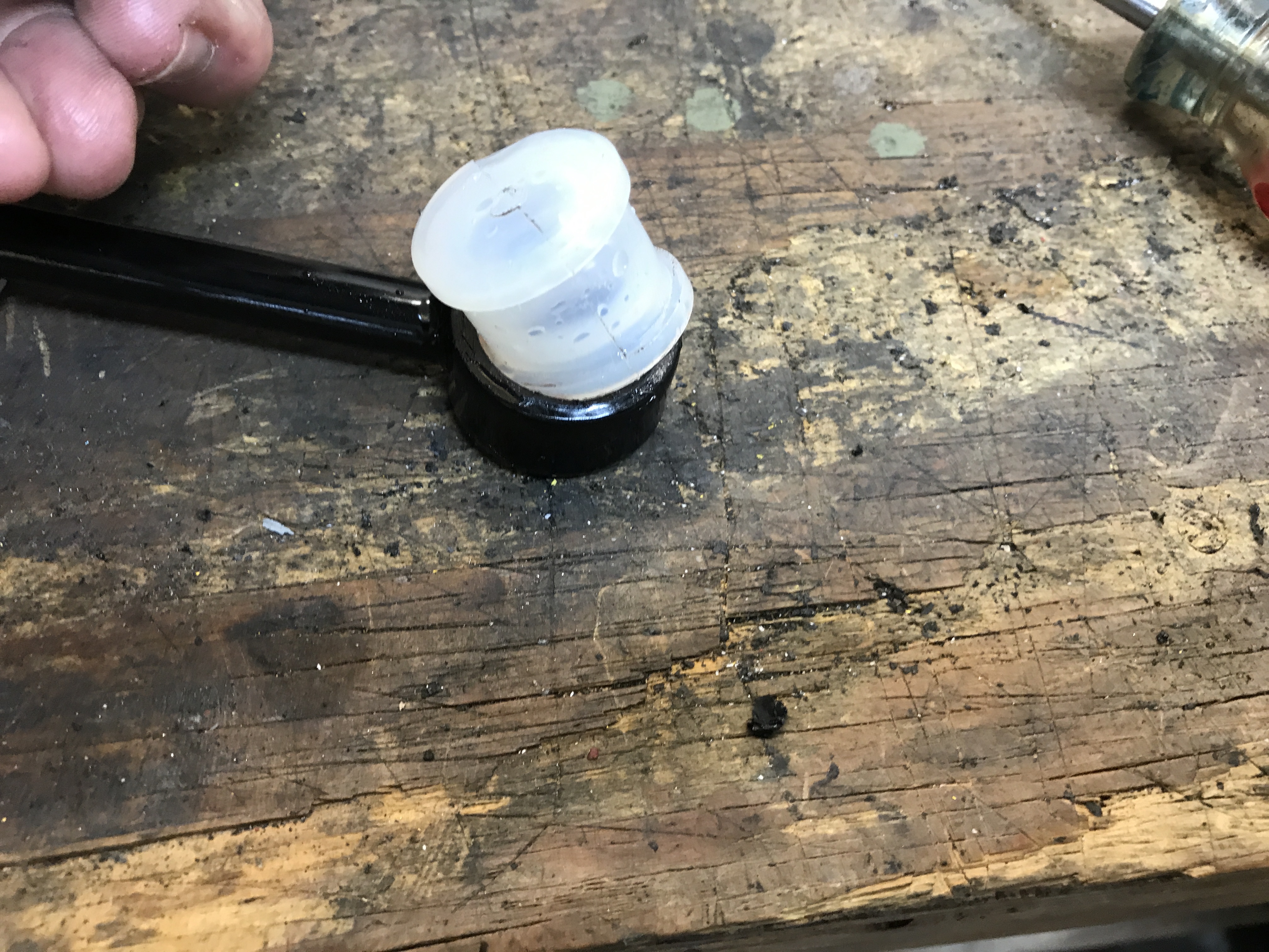

I tried a few things, including simple pressing, that did not work. What did work was inserting the open bushing end at an angle as far as possible, with the bushing warmed up and a bit of grease.
bkrantz
post Mar 5 2021, 08:40 PM
Post #2330
Posts: 8,763
Joined: 3-August 19
From: SW Colorado
Member No.: 23,343
I then muscled the remaining part of the open rim into the link rink, with some assistance from my pry tool (a dull screw driver).
bkrantz
post Mar 5 2021, 08:42 PM
Post #2331
Posts: 8,763
Joined: 3-August 19
From: SW Colorado
Member No.: 23,343
After that is was fairly easy to press the bushing through.

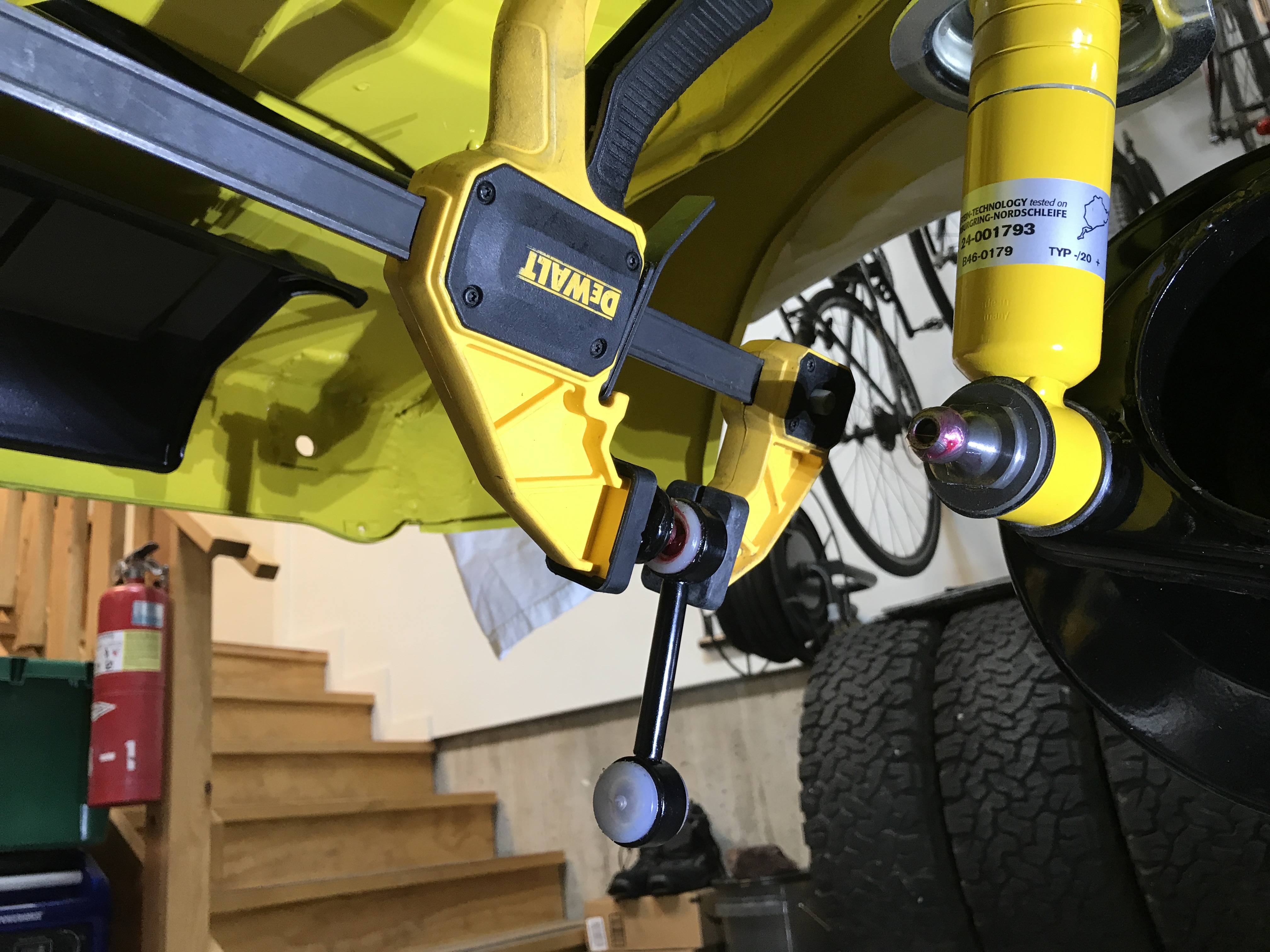

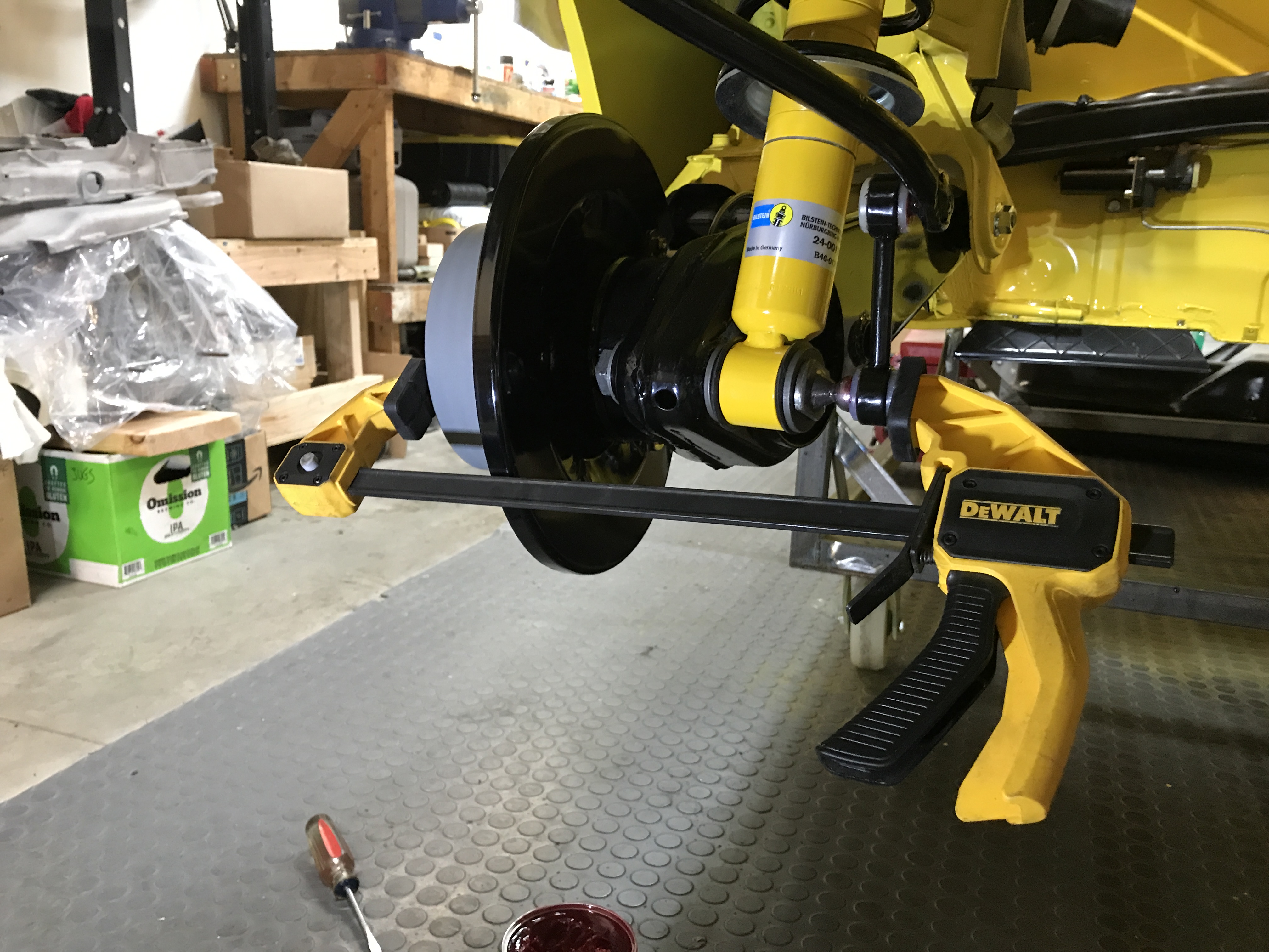

Then I pressed the links onto the sway bar. Helps to twist the link while pressing.
bkrantz
post Mar 5 2021, 08:44 PM
Post #2333
Posts: 8,763
Joined: 3-August 19
From: SW Colorado
Member No.: 23,343
And then I pressed the other ends of the links onto the shock bolts.

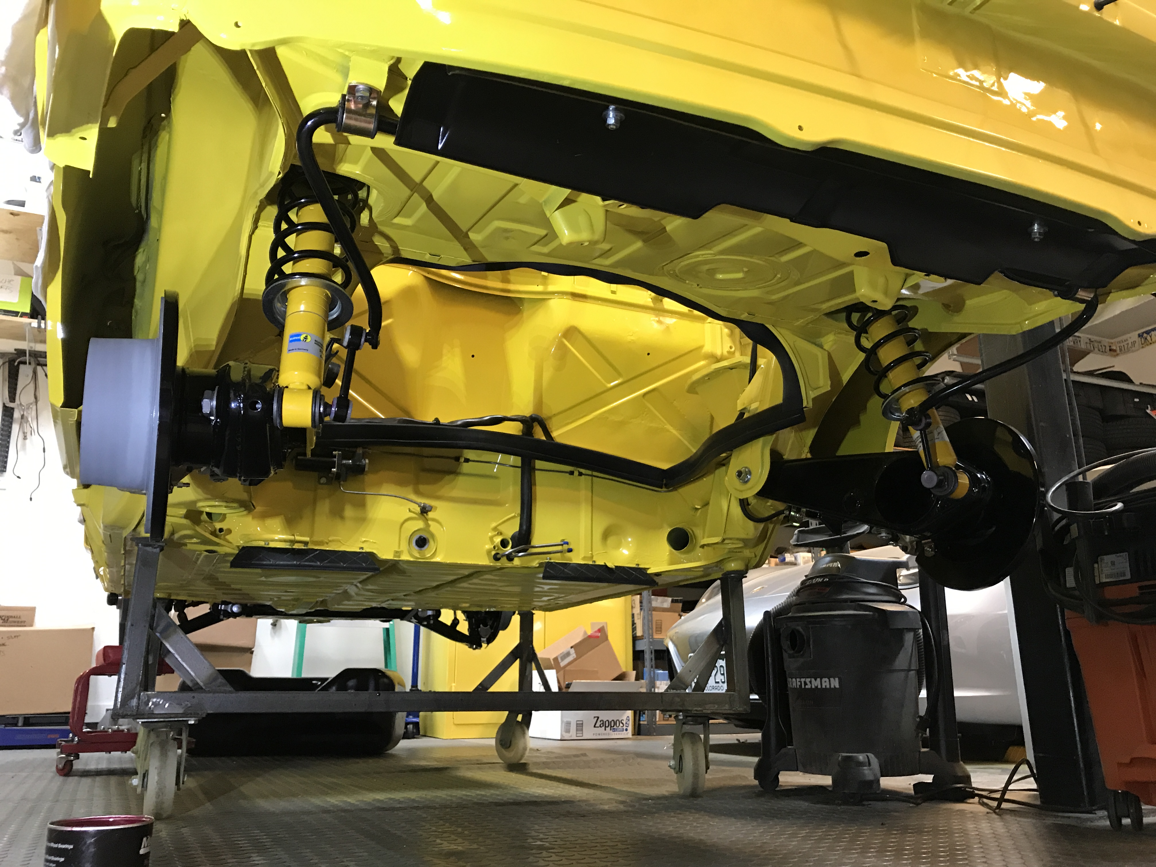

That is the last of the chassis work, including brakes. (IMG:style_emoticons/default/piratenanner.gif)

QUOTE(bkrantz @ Mar 5 2021, 08:46 PM) *
Man, the car looks absolutely awesome. Cant wait to see what is next.

Thanks, guys. It feels good to see progress, but still lots to do. The motor is still a pile of parts and boxes.

Satisfying just to see pics under the car—has to be enormously satisfying looking at them in person at this point in your journey.
Inspiring stuff!

QUOTE(horizontally-opposed @ Mar 7 2021, 10:26 AM) *
Inspiring stuff!
The underside is one of my favorite views, since it looks mostly done. Then I look at the interior and feel more urgent.
