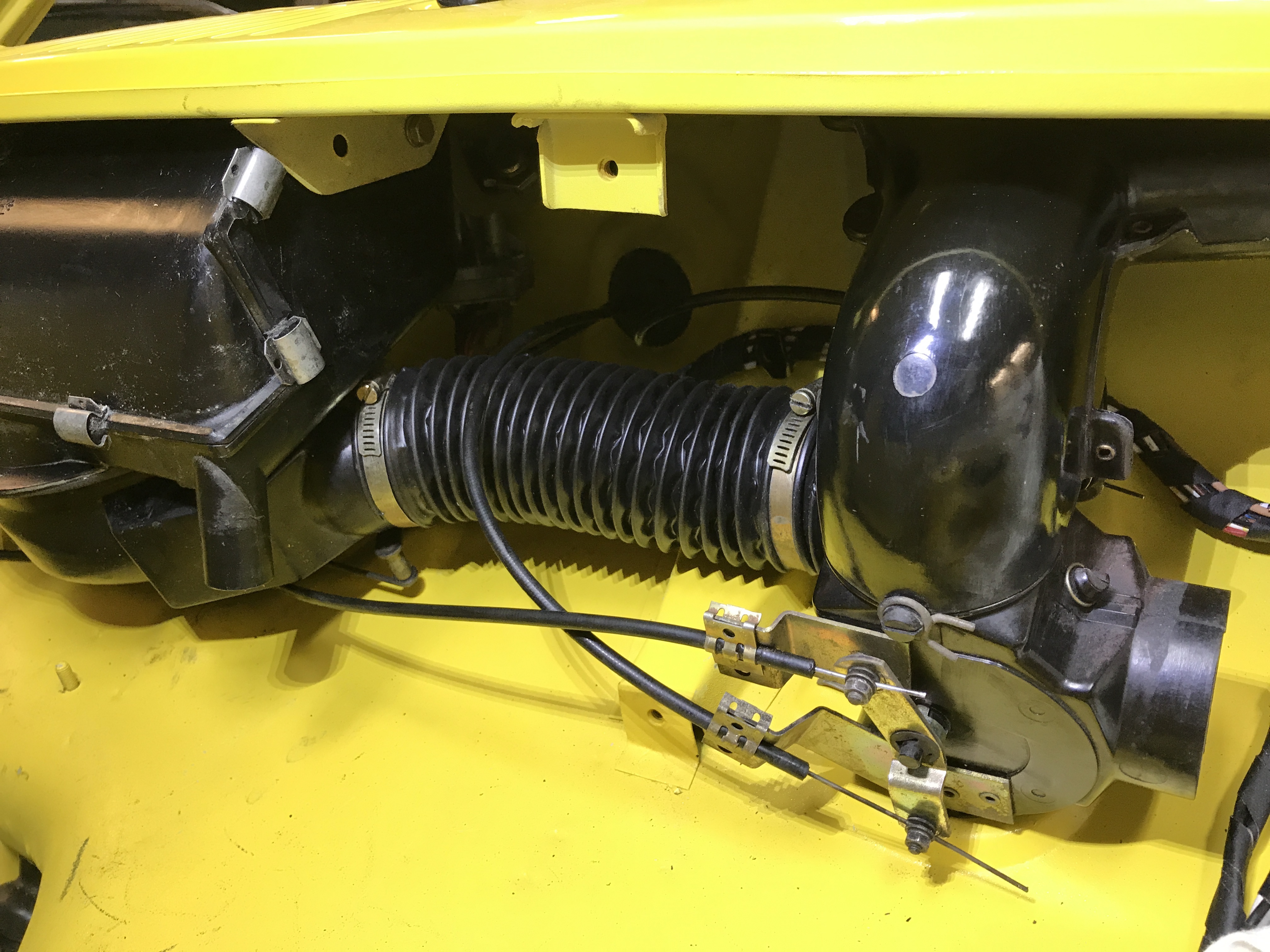

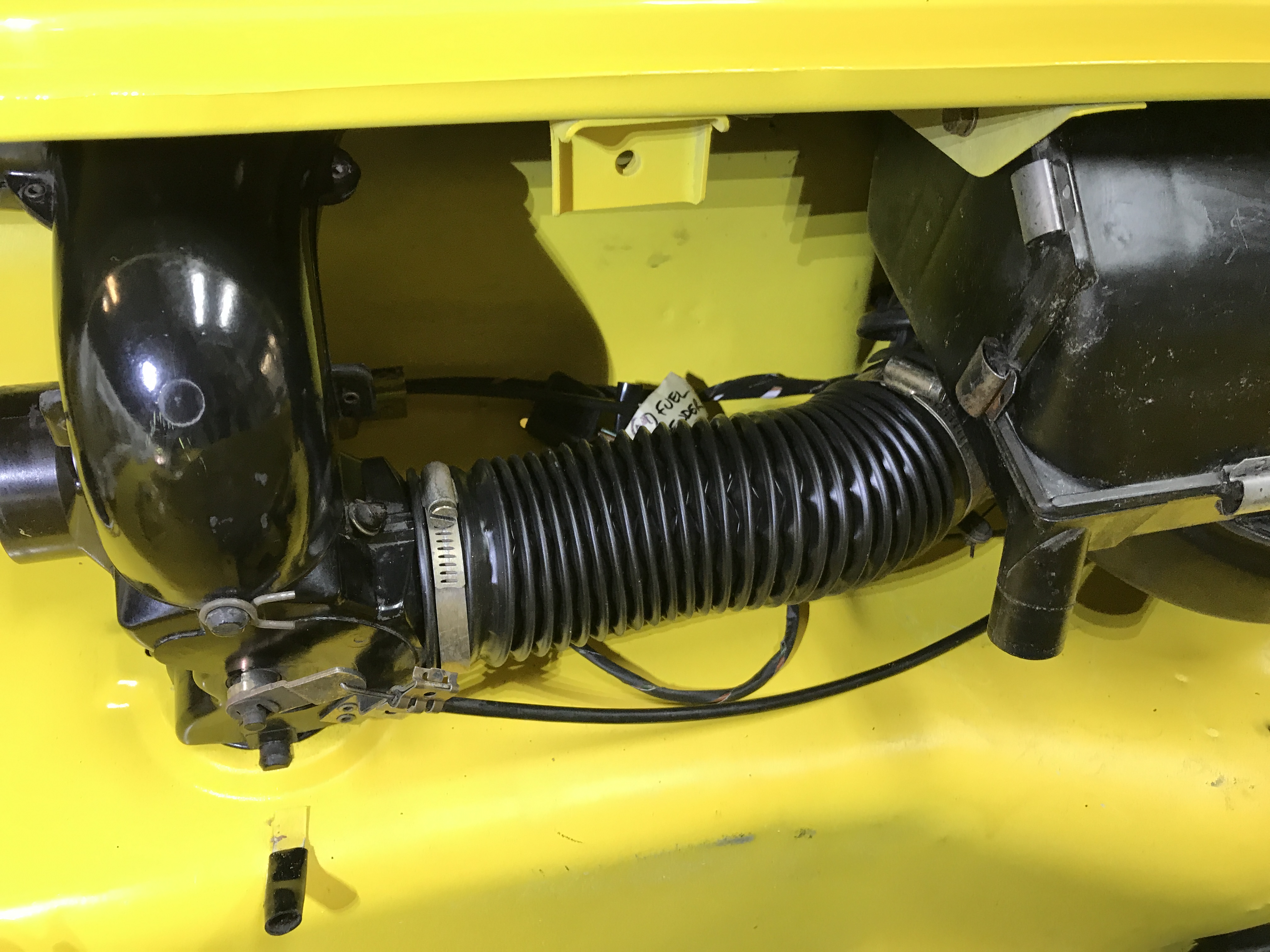

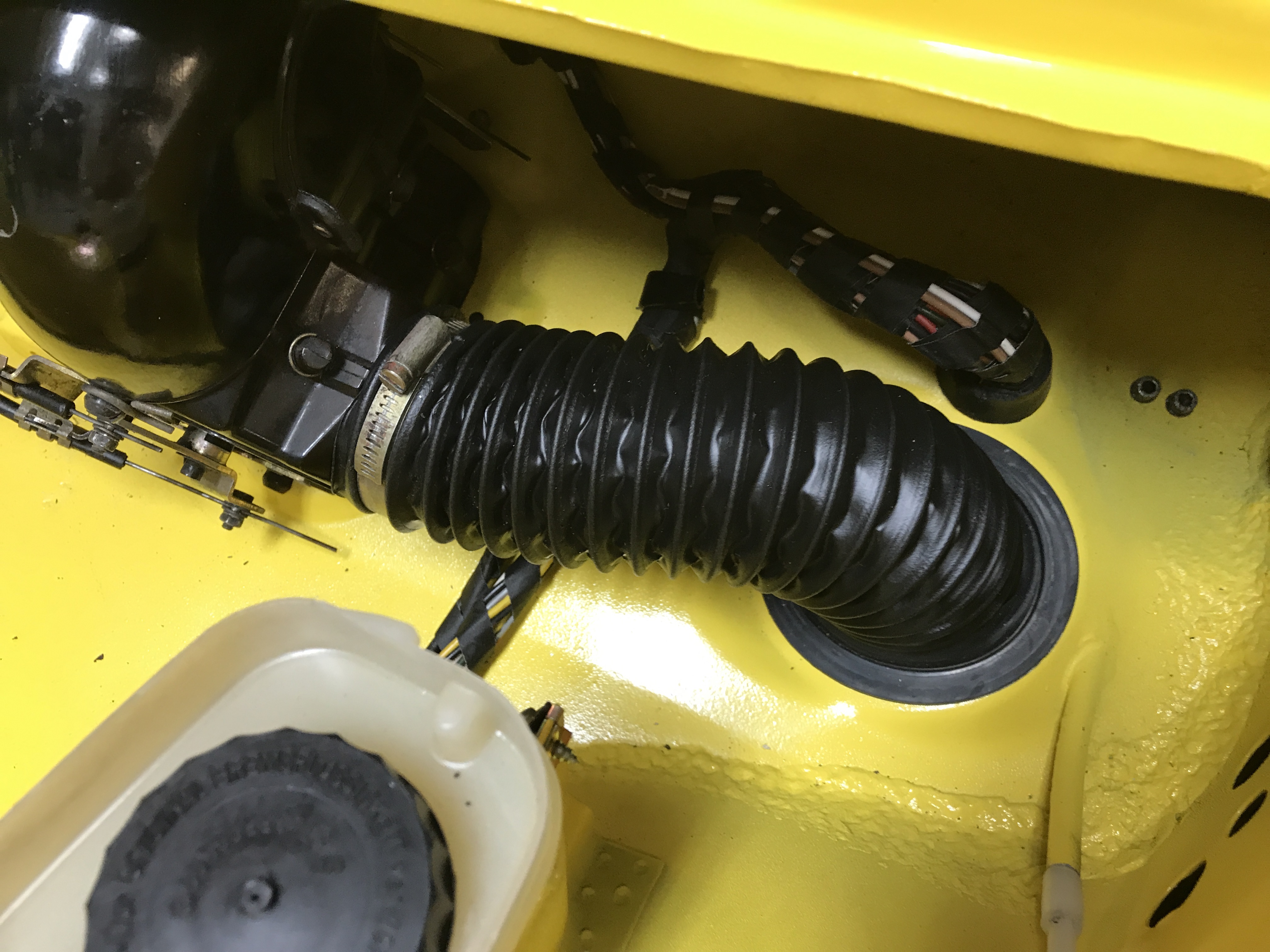

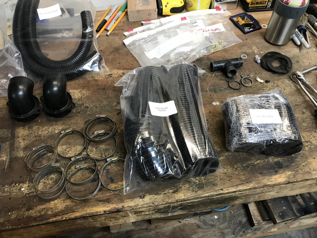

More air system work, with the replacement hoses from 914 Rubber.
bkrantz
post Mar 17 2021, 06:21 PM
Post #2462
Posts: 8,531
Joined: 3-August 19
From: SW Colorado
Member No.: 23,343
Short hoses for center air box to controllers. Right side.

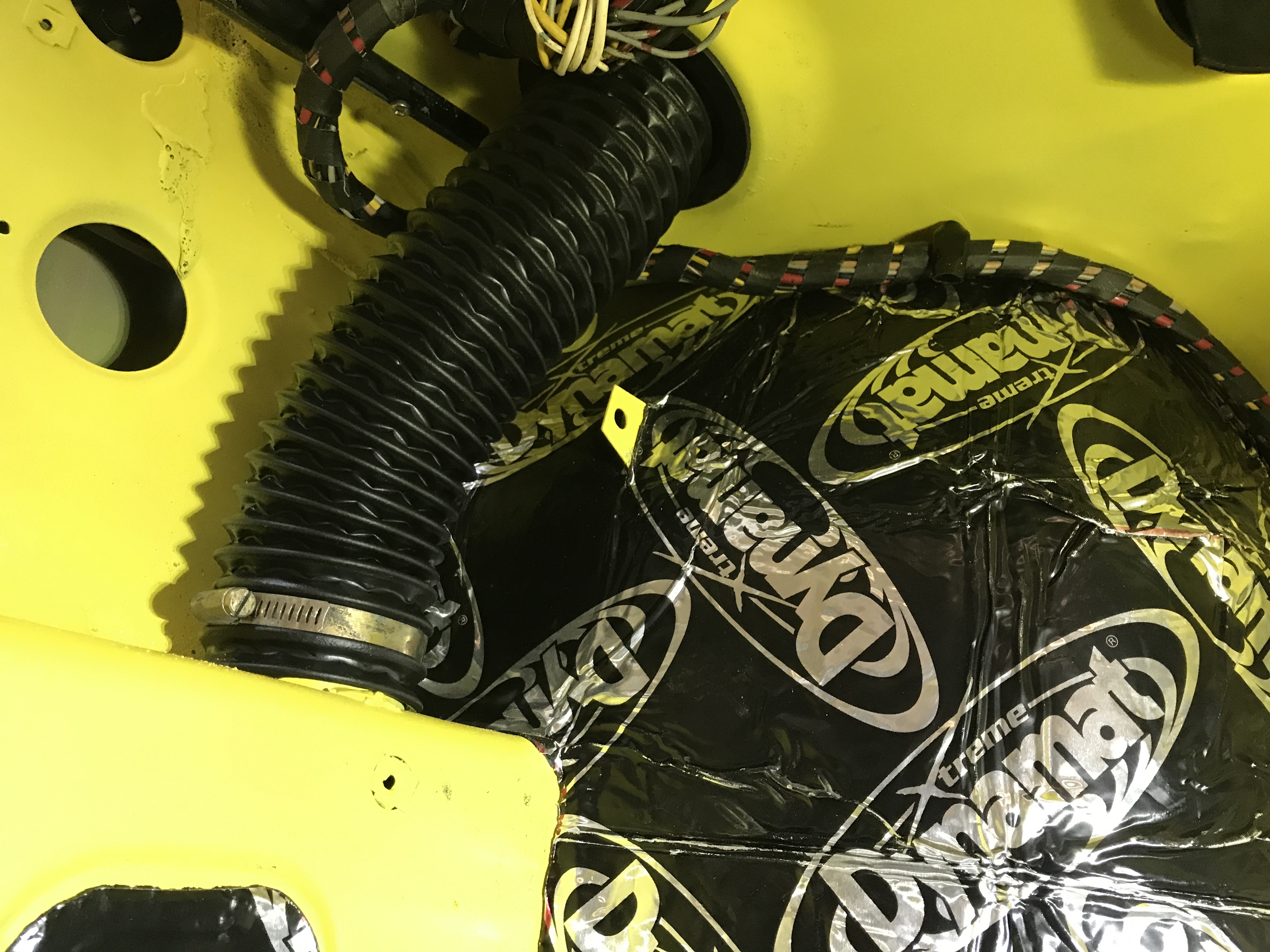

Then the feed hoses from the long tubes. A bit tricky to feed them through the new rubber grommets.
bkrantz
post Mar 17 2021, 06:24 PM
Post #2465
Posts: 8,531
Joined: 3-August 19
From: SW Colorado
Member No.: 23,343
Attached to the long outlet.

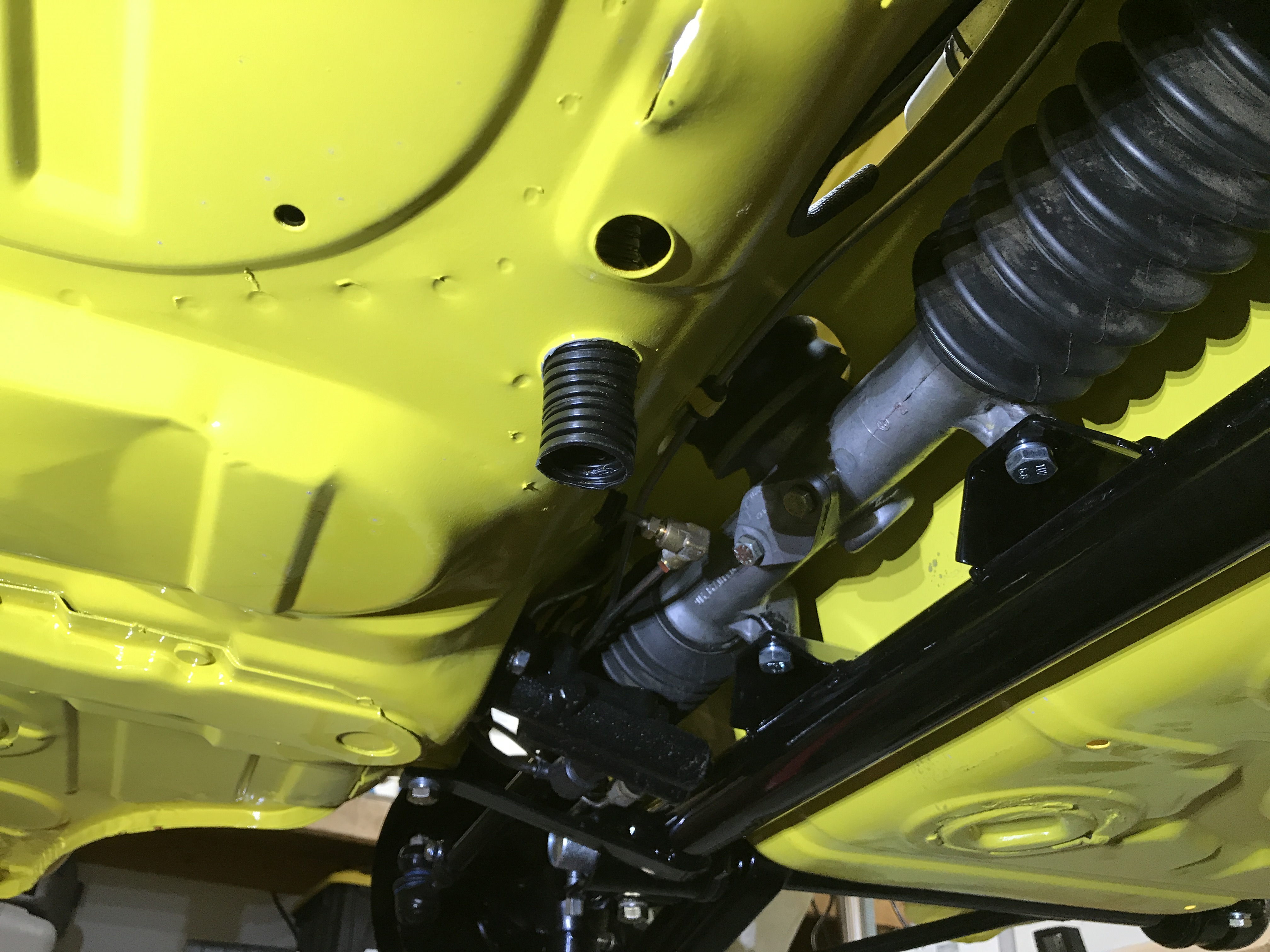

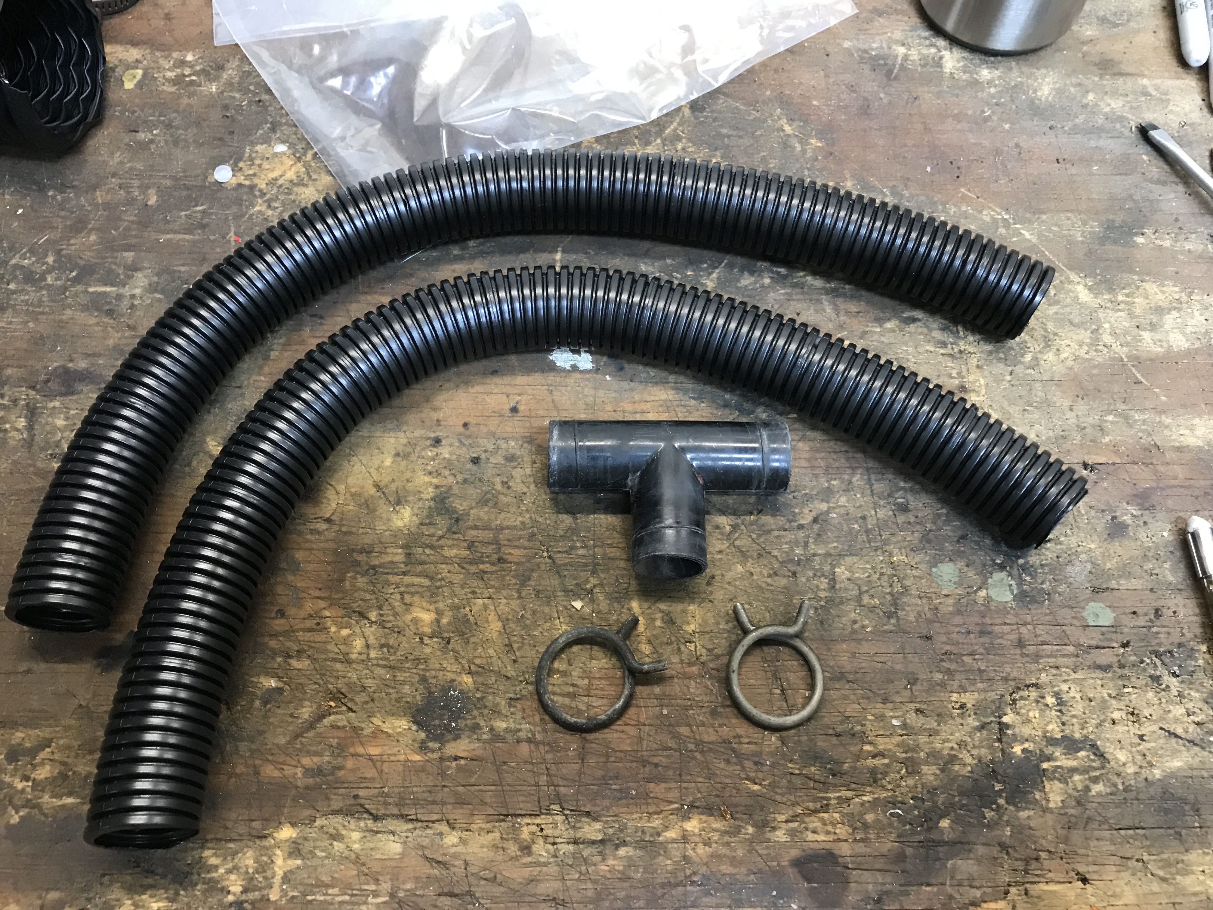

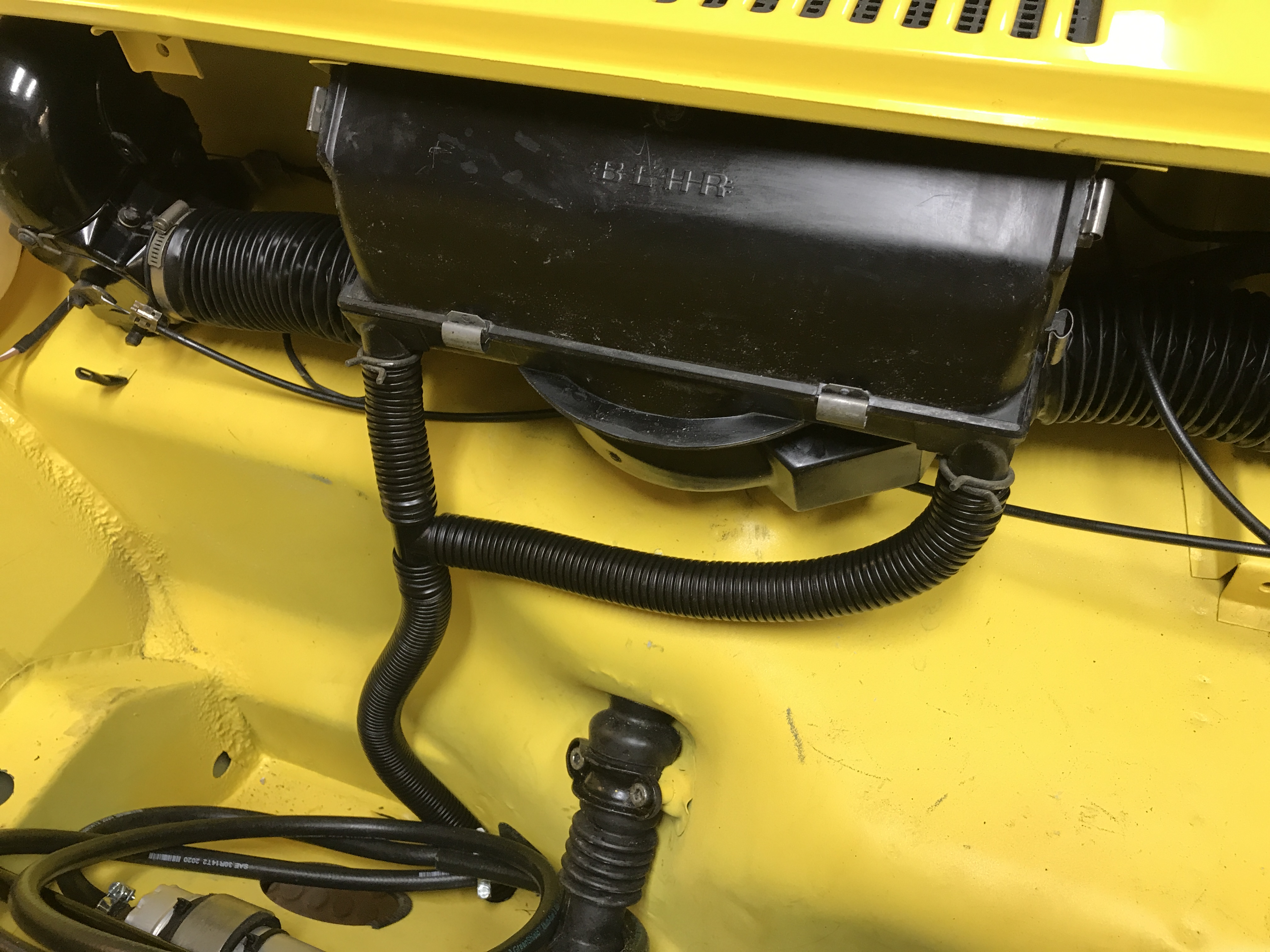

Then time for the drain tube.
bkrantz
post Mar 17 2021, 06:26 PM
Post #2467
Posts: 8,531
Joined: 3-August 19
From: SW Colorado
Member No.: 23,343
Pretty easy to put together, and push the hose onto the fittings. I made sure the cross piece slopes down to the T.
bkrantz
post Mar 17 2021, 06:27 PM
Post #2468
Posts: 8,531
Joined: 3-August 19
From: SW Colorado
Member No.: 23,343
Outlet under car.

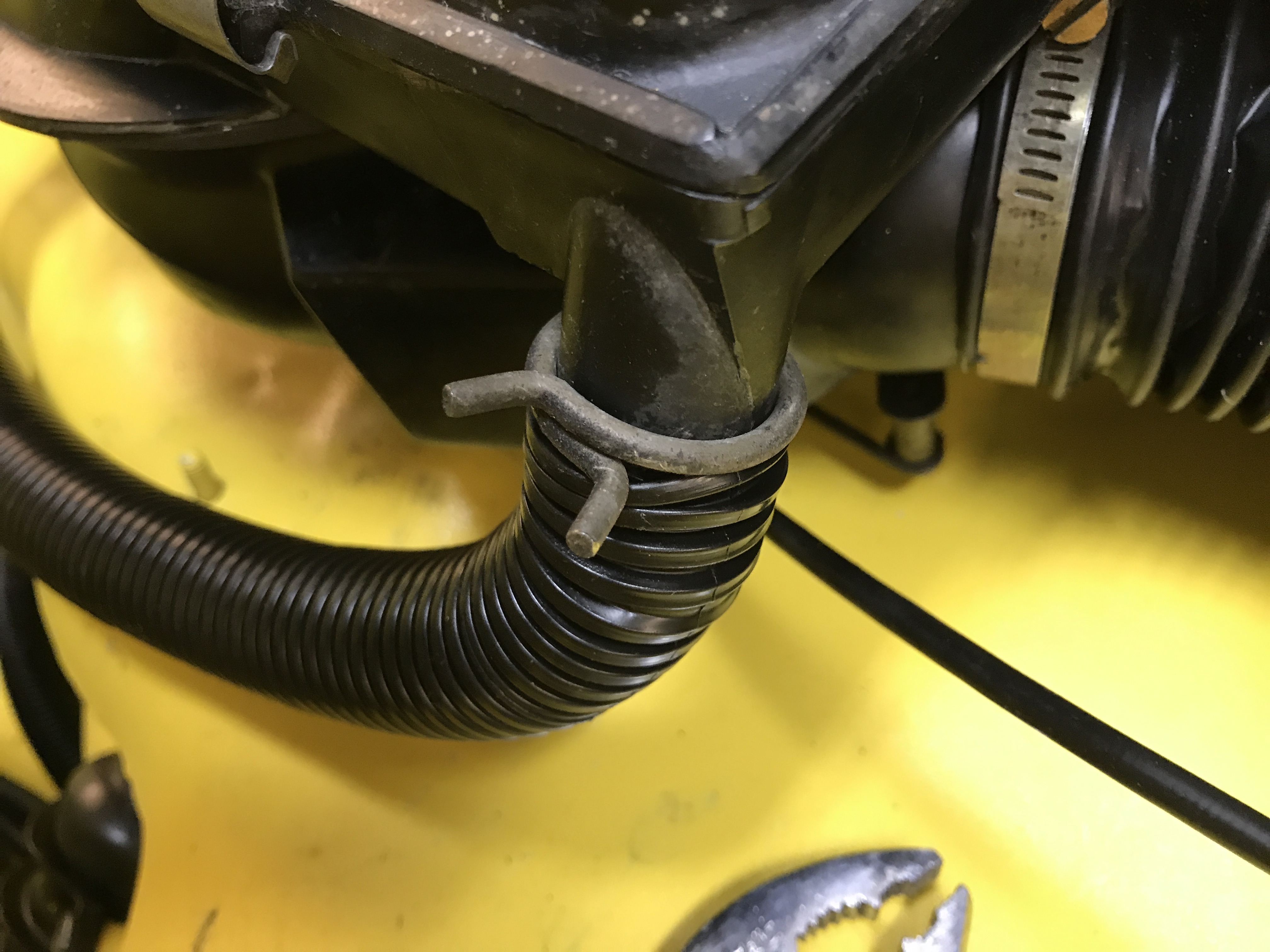

bkrantz
post Mar 17 2021, 06:29 PM
Post #2469
Posts: 8,531
Joined: 3-August 19
From: SW Colorado
Member No.: 23,343
But I failed to get the hose clamp rings on properly. The hose OD might be too big.

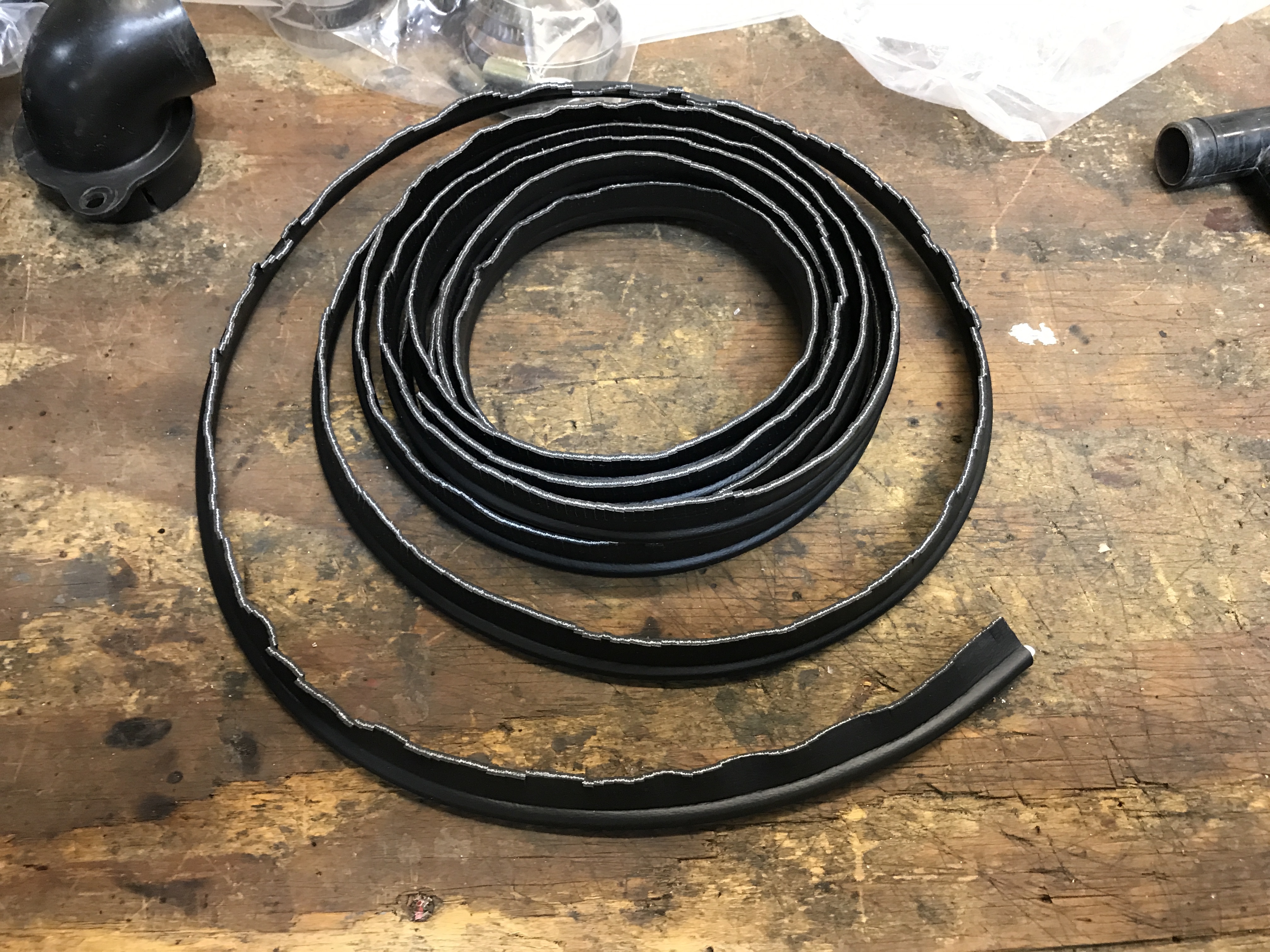

I also tried my plan for this stuff: black vinyl welting, with a 1/4 inch round edge.

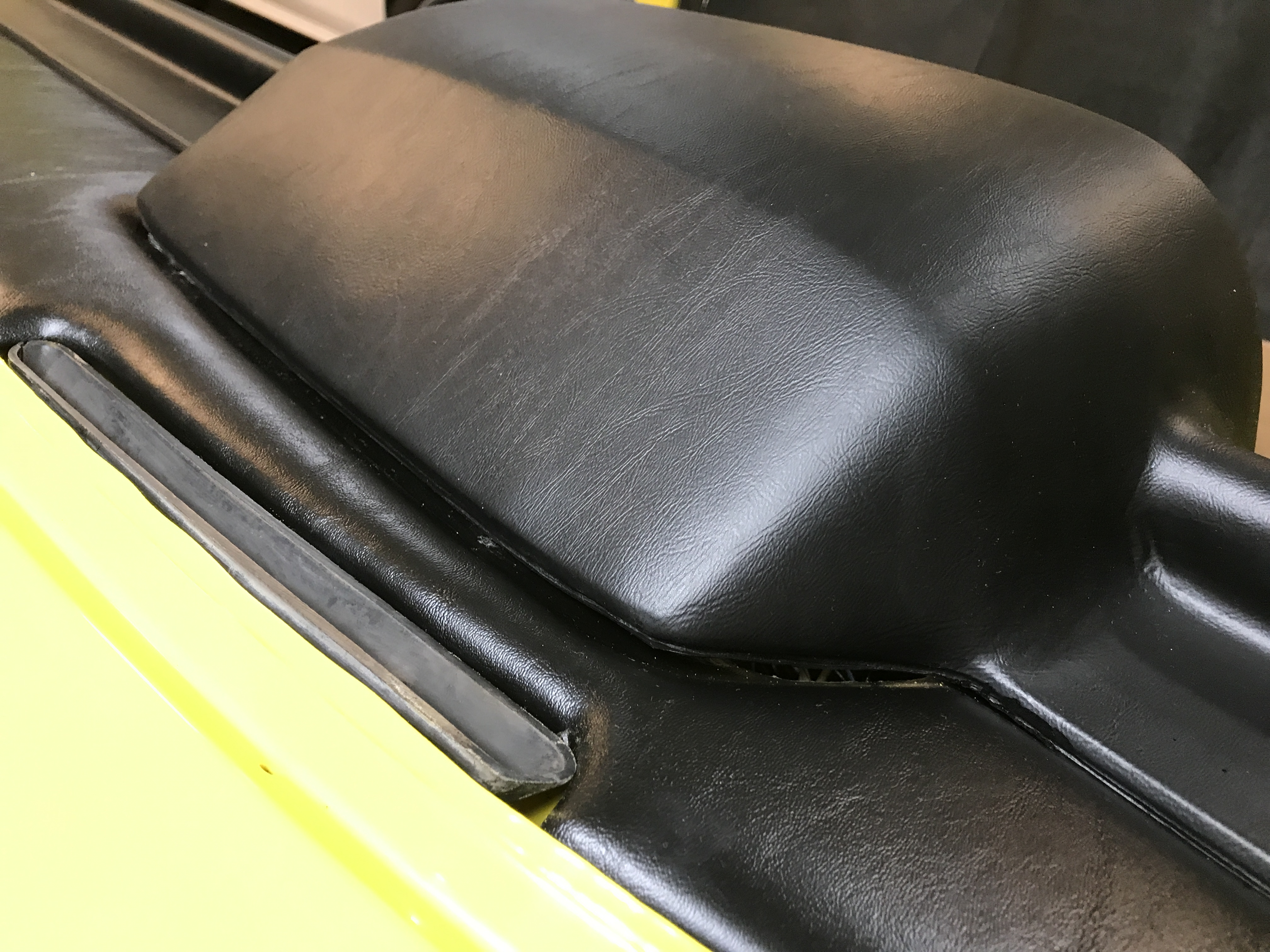

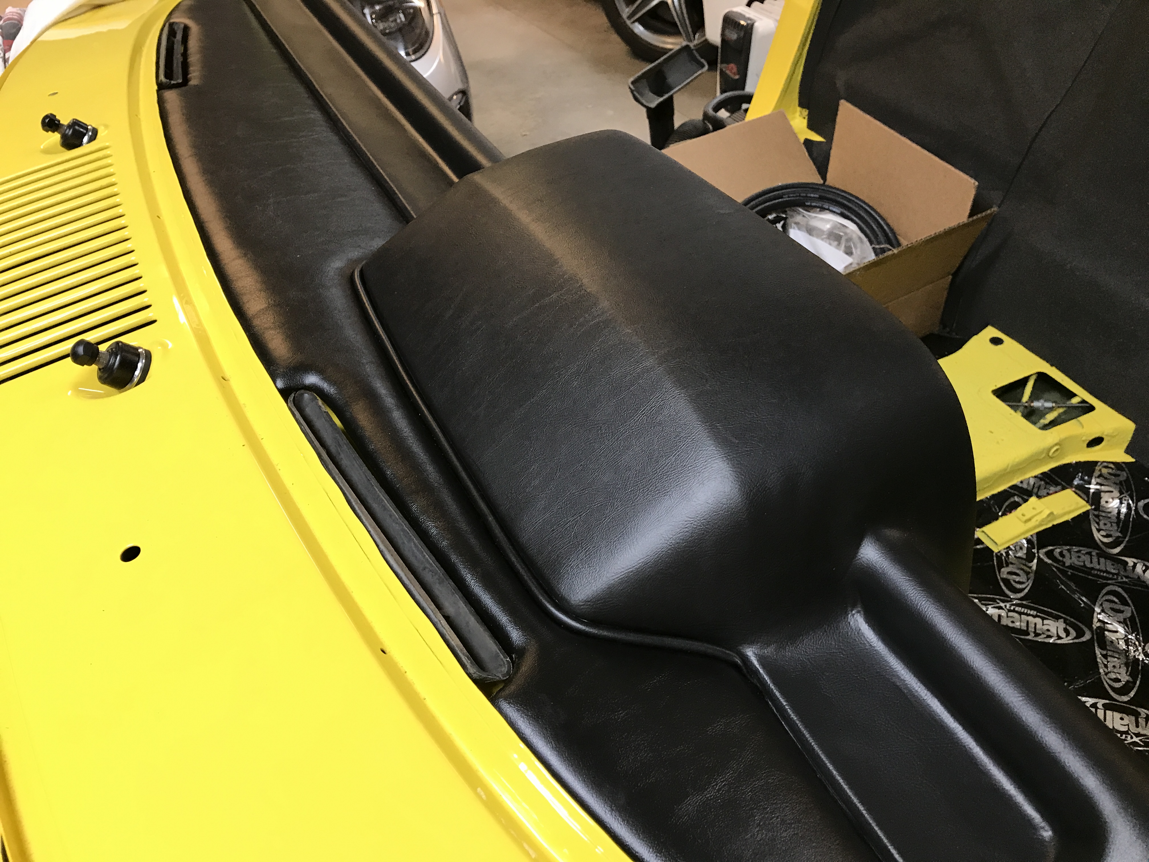

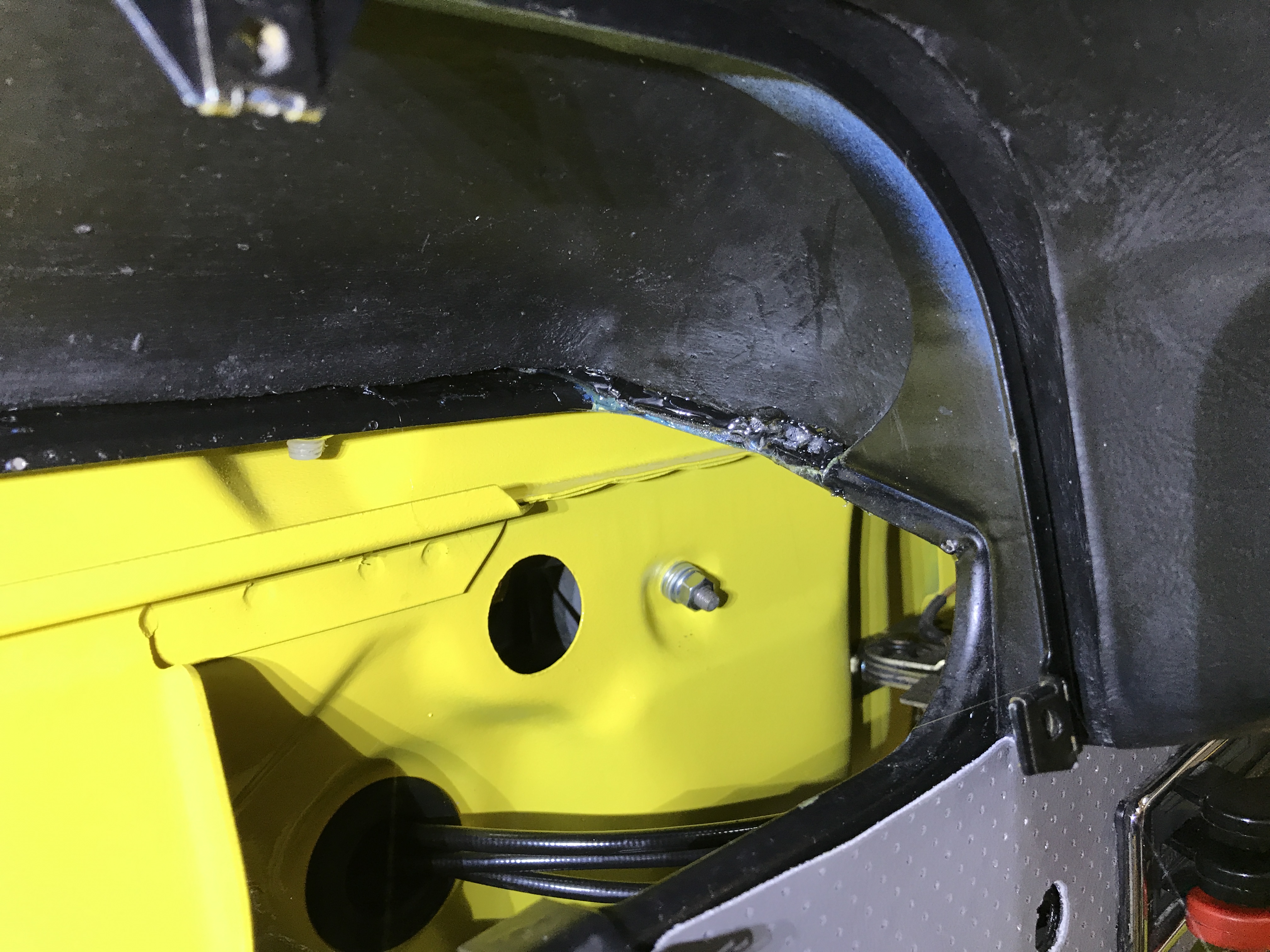

I was not happy with the fit between the new dash top and the vinyl. It looks worse here since I have the dash top attachment bolts loosened.
bkrantz
post Mar 17 2021, 06:35 PM
Post #2472
Posts: 8,531
Joined: 3-August 19
From: SW Colorado
Member No.: 23,343

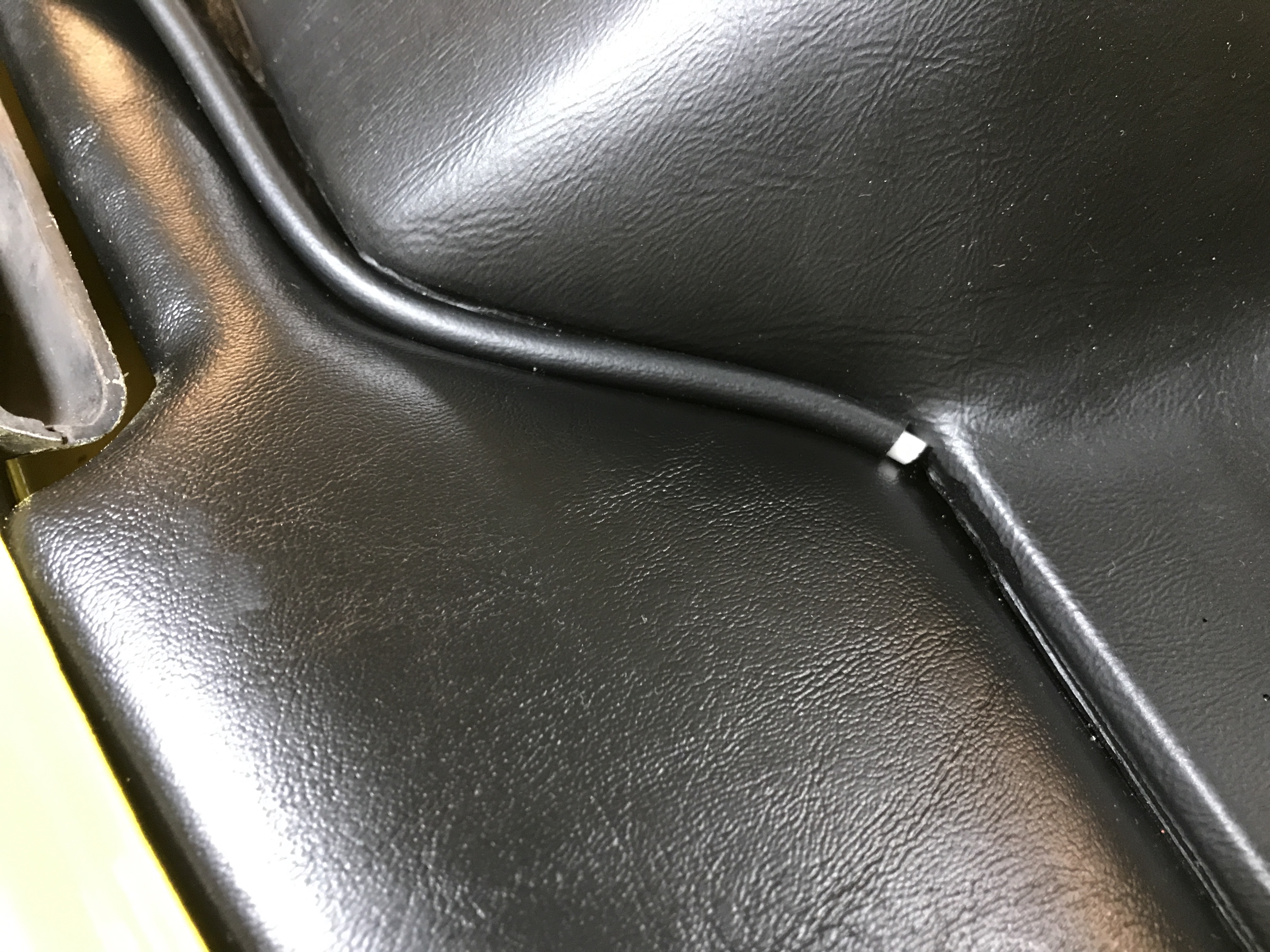

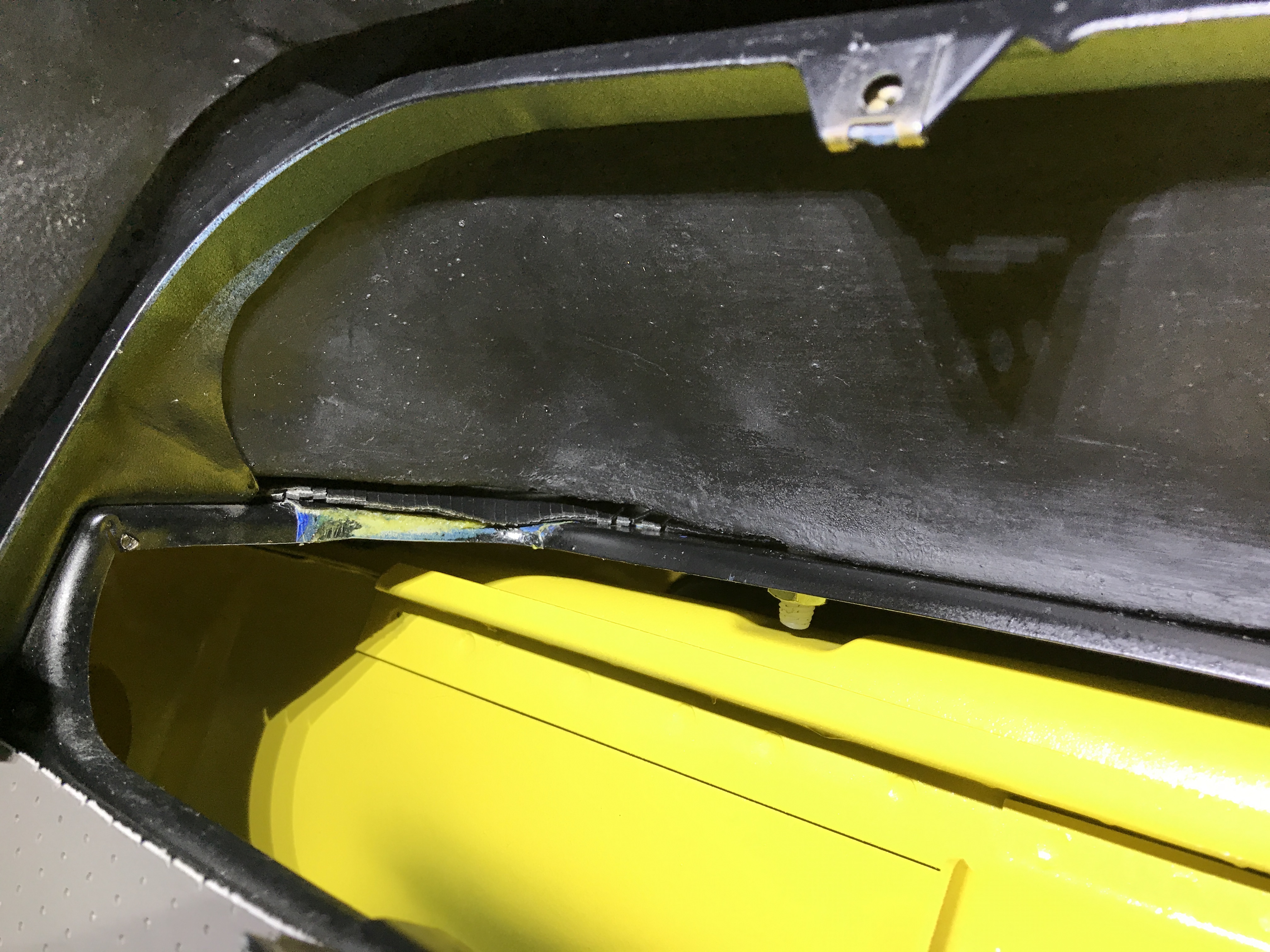

Here's my idea: use the welting between the dash top and the padded vinyl.
bkrantz
post Mar 17 2021, 06:36 PM
Post #2473
Posts: 8,531
Joined: 3-August 19
From: SW Colorado
Member No.: 23,343

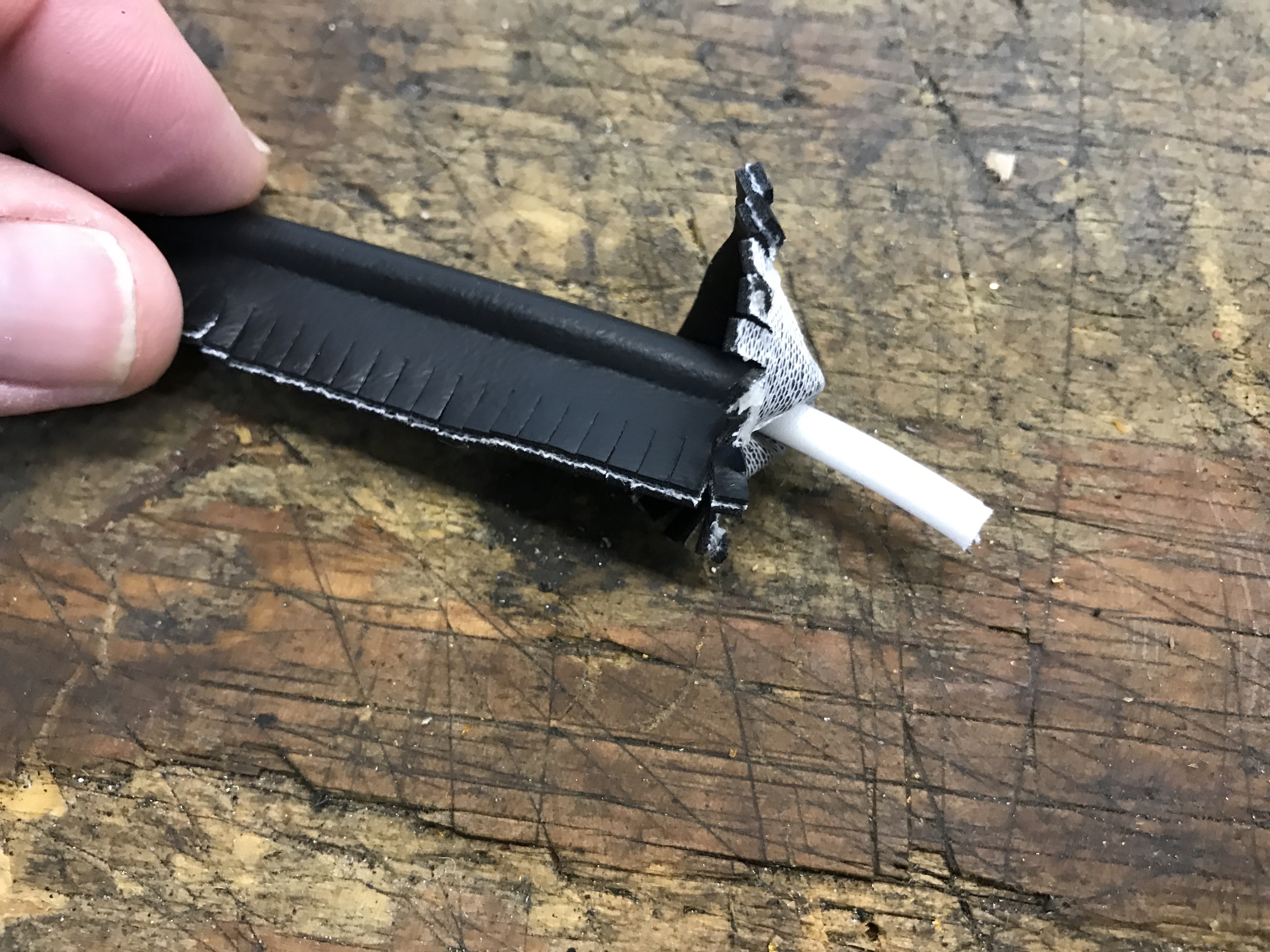

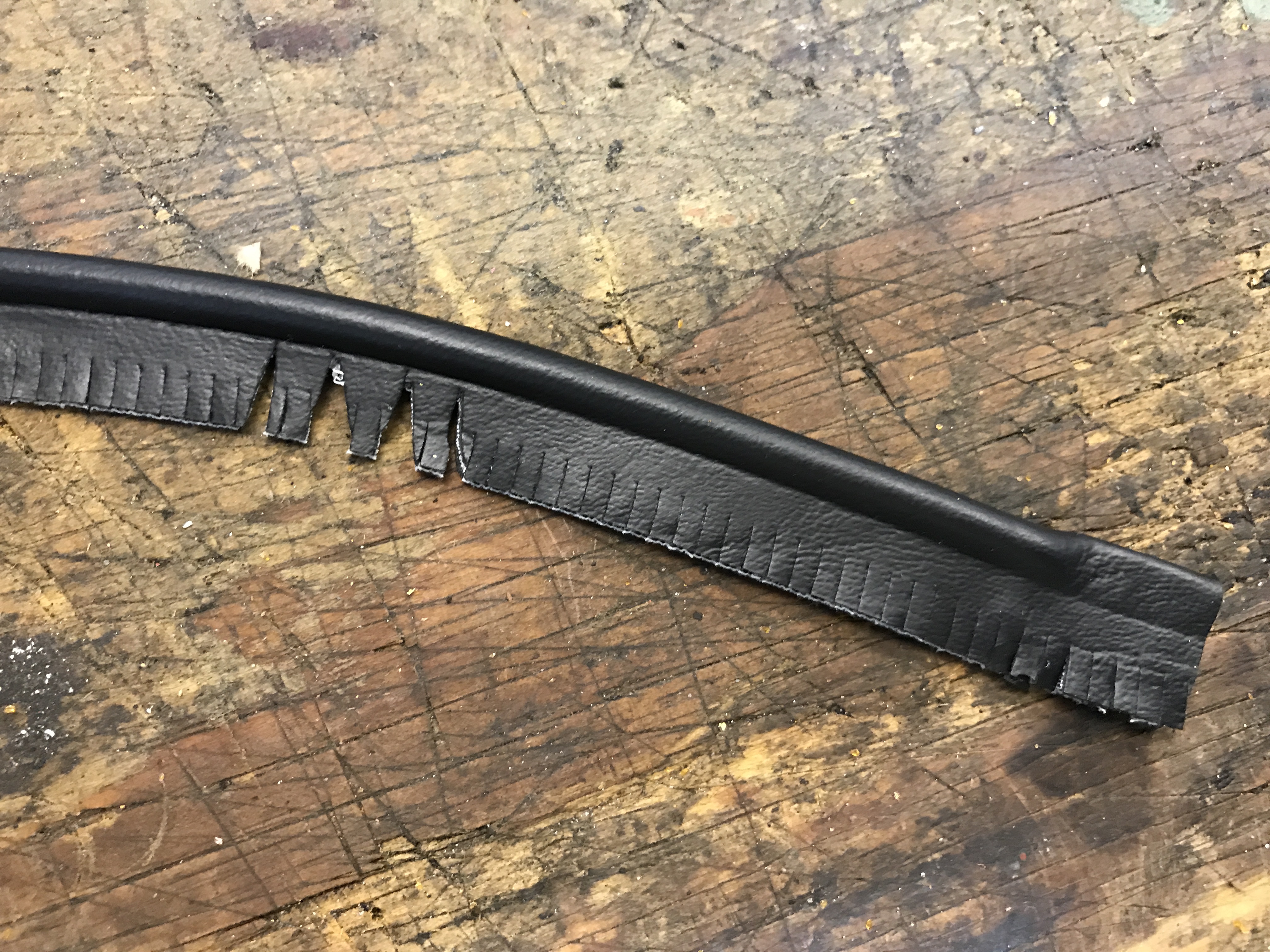

To make the end of the welting dive into the corner, I split about an inch and cut the internal cord.
bkrantz
post Mar 17 2021, 06:37 PM
Post #2474
Posts: 8,531
Joined: 3-August 19
From: SW Colorado
Member No.: 23,343
That makes for a flattened end. I also notched the segments that will bend around the cowl corners.
bkrantz
post Mar 17 2021, 06:39 PM
Post #2475
Posts: 8,531
Joined: 3-August 19
From: SW Colorado
Member No.: 23,343

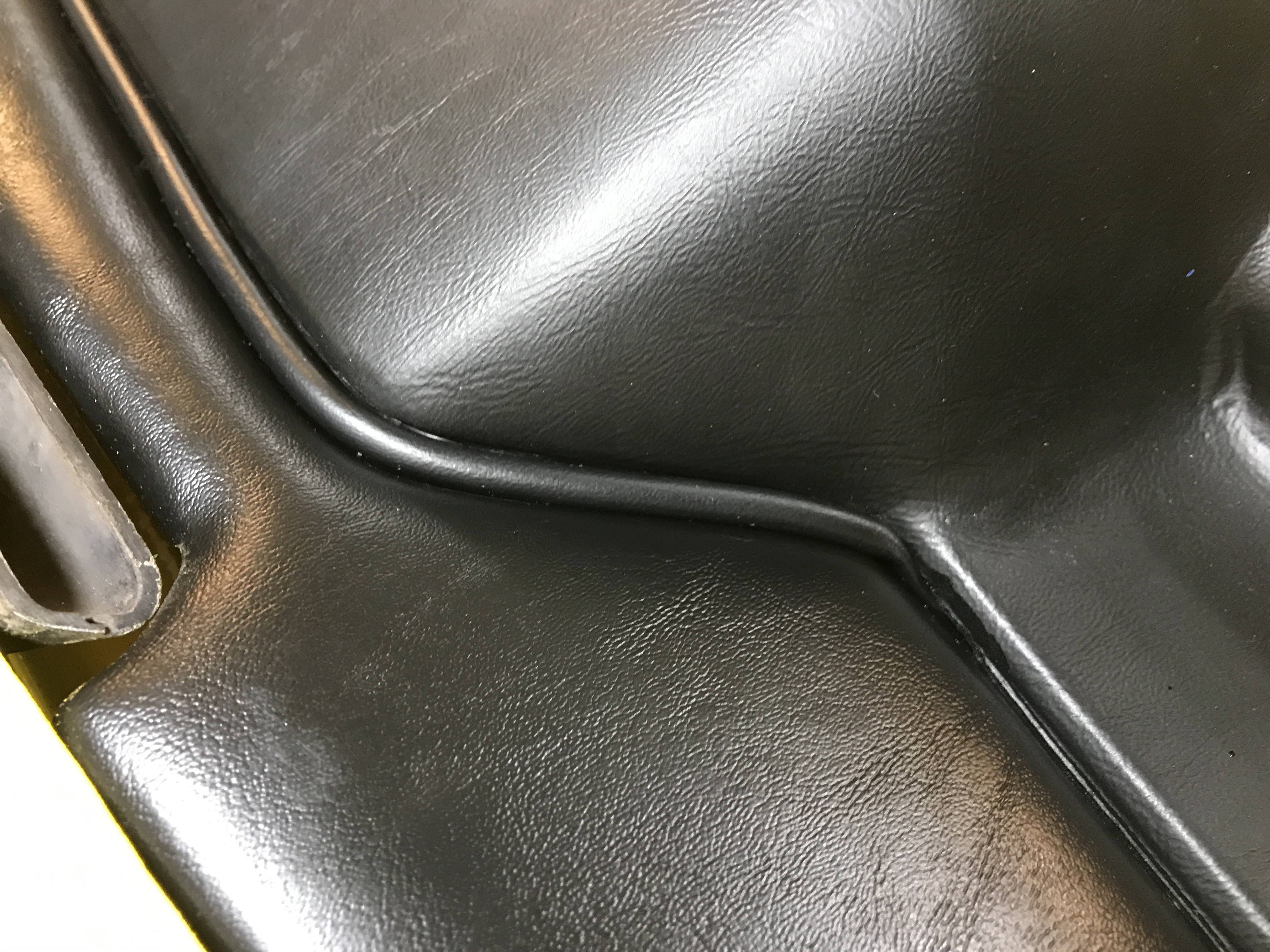

With the dash top loose, I was able to sneak the welting flap into the gap.
bkrantz
Post #2476
Posts: 8,531
Joined: 3-August 19
From: SW Colorado
Member No.: 23,343
Where I could reach, I added a bit of all-purpose glue.
bkrantz
post Mar 17 2021, 06:41 PM
Post #2477
Posts: 8,531
Joined: 3-August 19
From: SW Colorado
Member No.: 23,343
I then straightened the welting and tightened the dash top bolts. I like it.
bkrantz
post Mar 17 2021, 06:42 PM
Post #2478
Posts: 8,531
Joined: 3-August 19
From: SW Colorado
Member No.: 23,343
The sides of the cowl look much better.

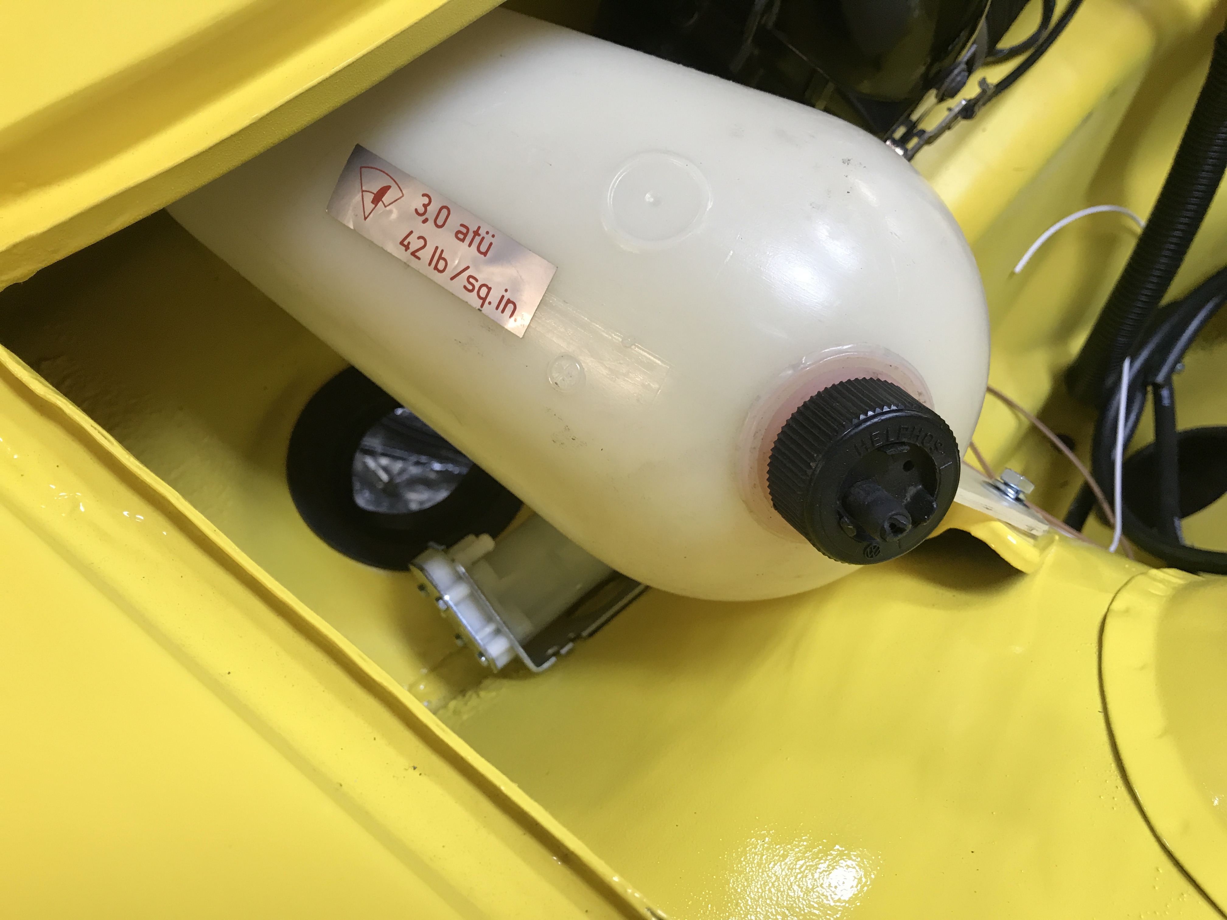

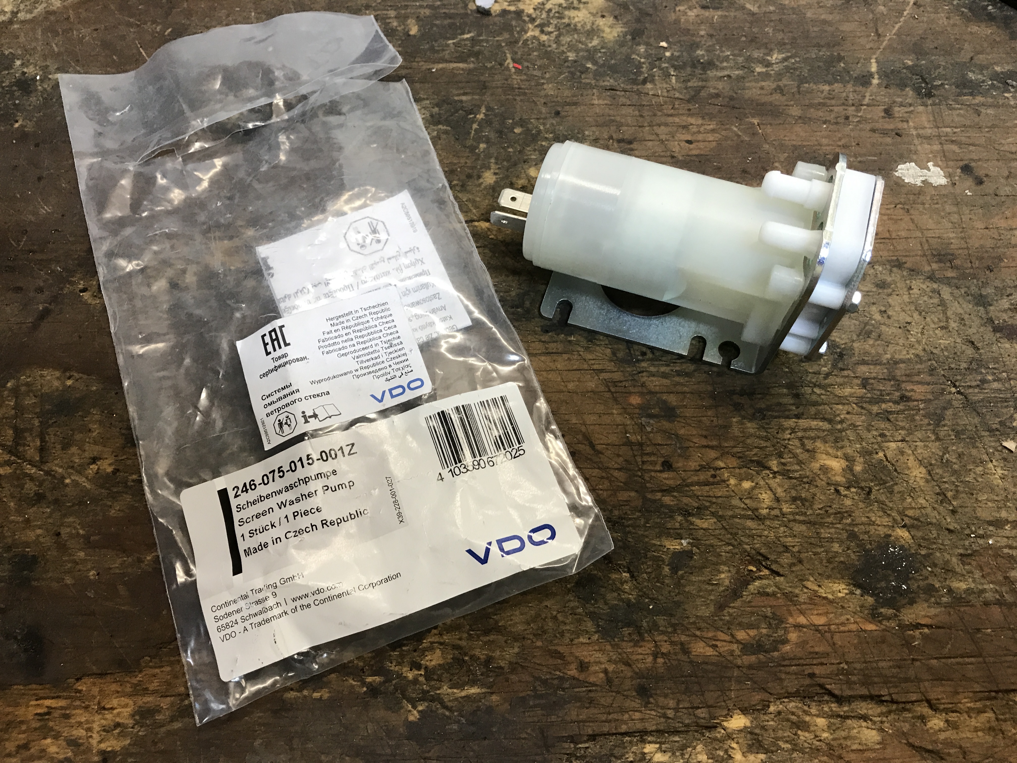

One last bit of exploration today. I will install a washer pump, and somehow live without the OE clever method of using the spare tire as a pressure source.
bkrantz
post Mar 17 2021, 06:45 PM
Post #2480
Posts: 8,531
Joined: 3-August 19
From: SW Colorado
Member No.: 23,343
One possible location: under the washer reservoir.
