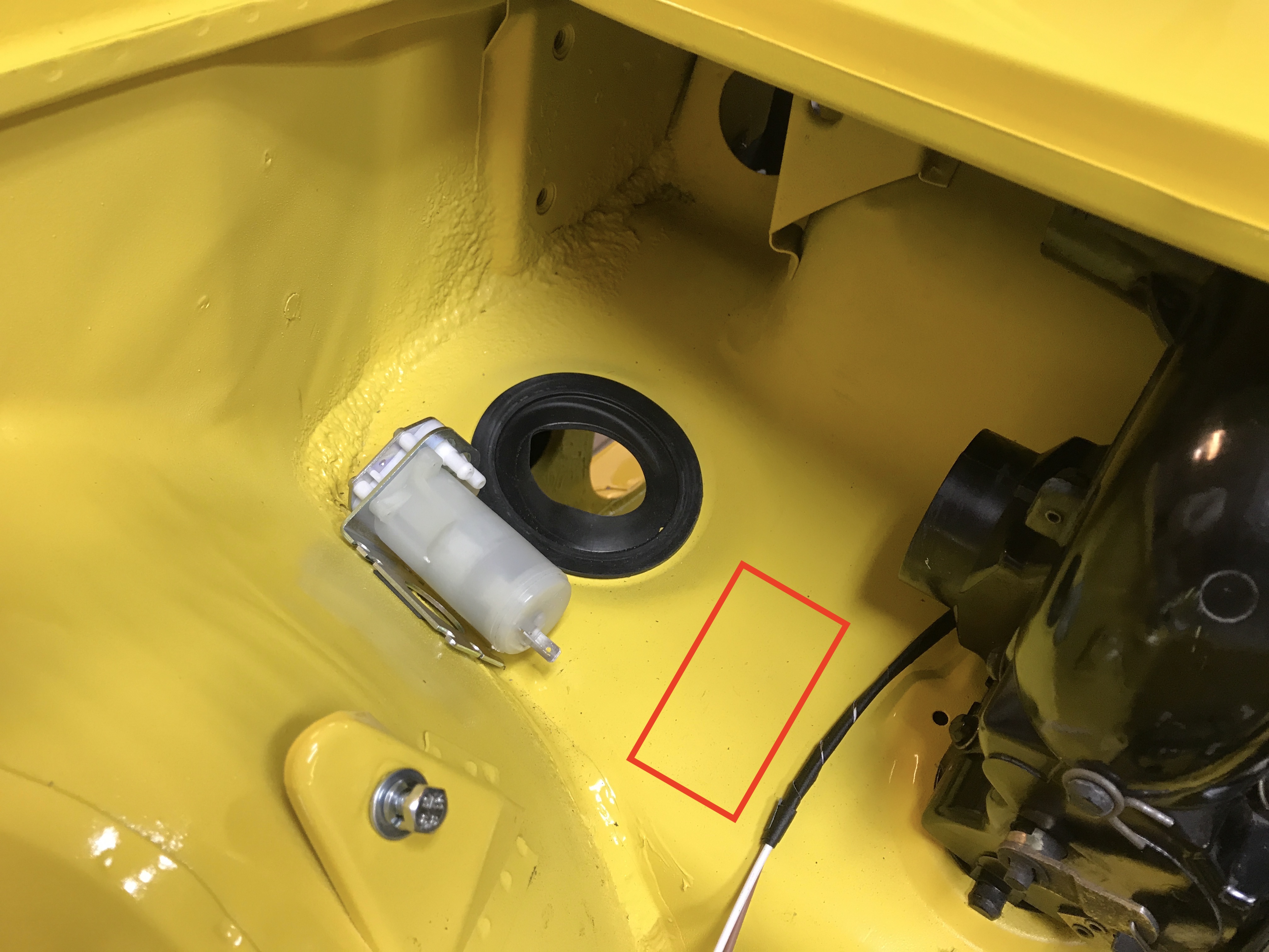

QUOTE(bkrantz @ Mar 17 2021, 06:45 PM) *
This could work.
Bob,
I will have to look to see where my electric pump is located on the /6. I'm not sure where it is.
FlacaProductions
post Mar 17 2021, 08:09 PM
Post #2484
Posts: 2,083
Joined: 24-November 17
From: LA
Member No.: 21,628
i believe I've seen them in this general area - with the little rubber nipple/insulators showing in the area above the footwell in the cabinAttached Image
Thanks, Brian. Before I drill and dress new holes I might try some industrial double-side tape. The location I proposed might work better for that since the surface is planar.

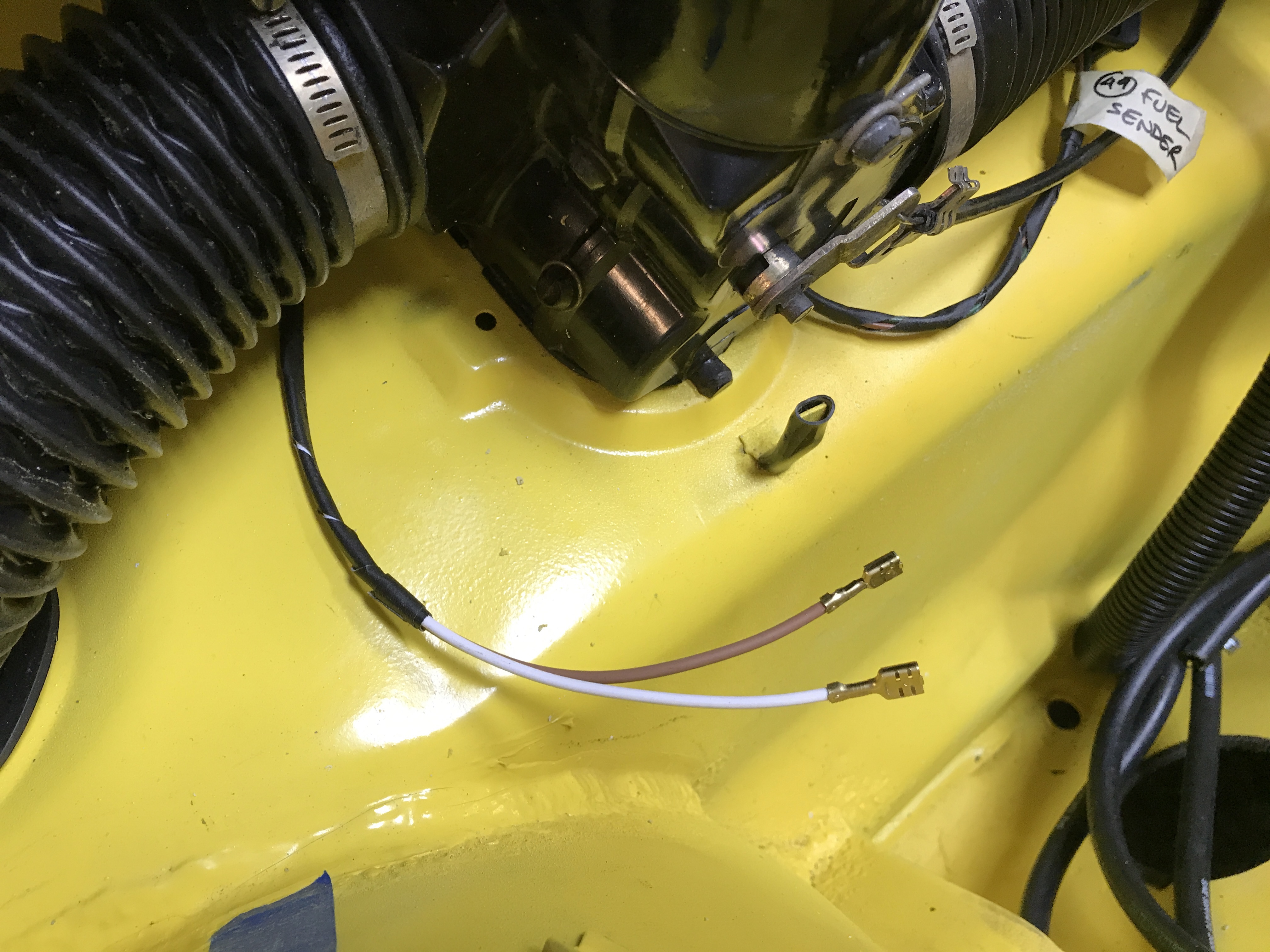

I trimmed the leads for the pump and crimped on new connectors. I did add an insulating cover to the positive lead.
The power lead comes from the fuse block, and the ground feeds through the new Carmagic switch I installed in the column.

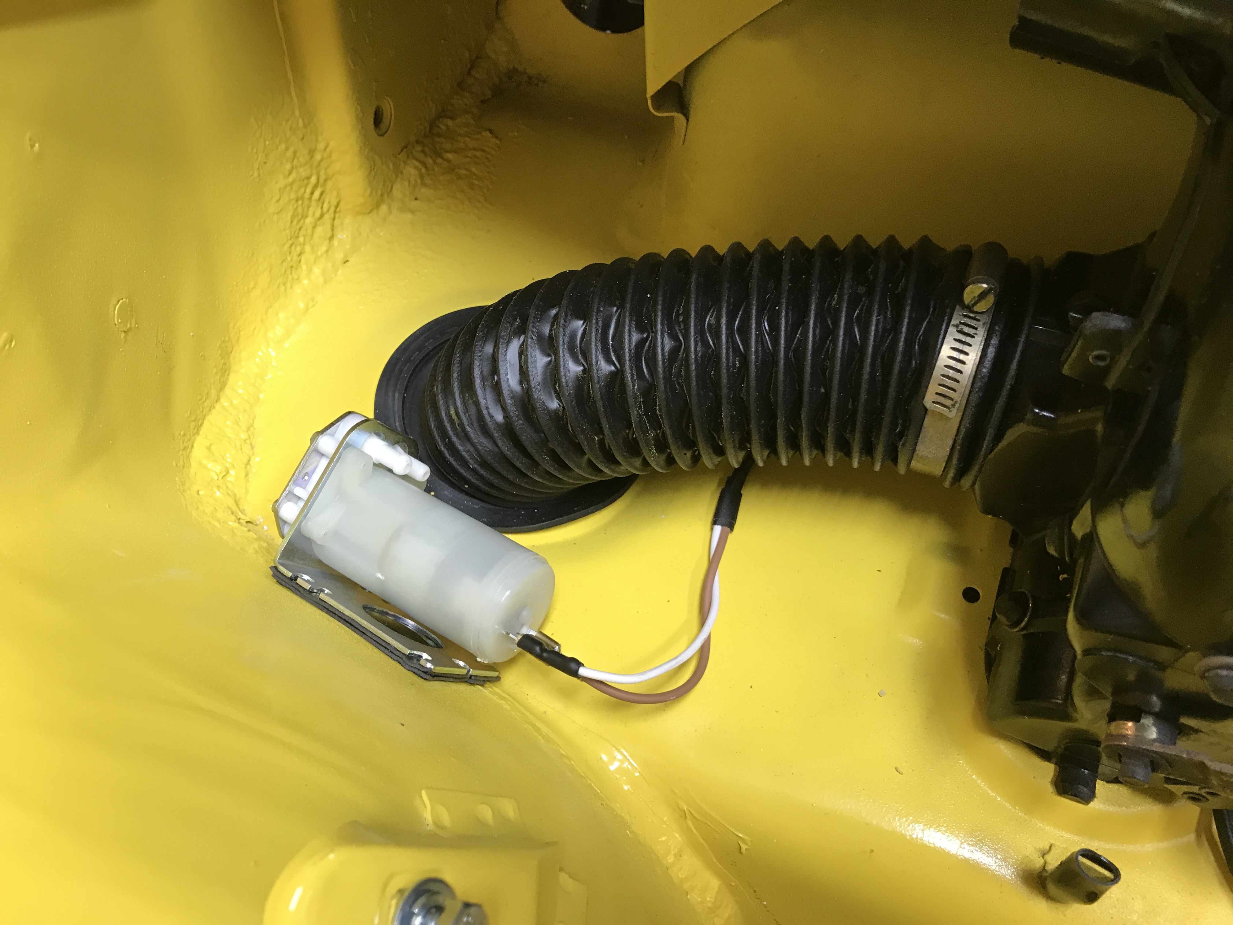

Member No.: 23,343
For now, I installed the pump with double-side auto adhesive. I want to test operations before drilling any holes.

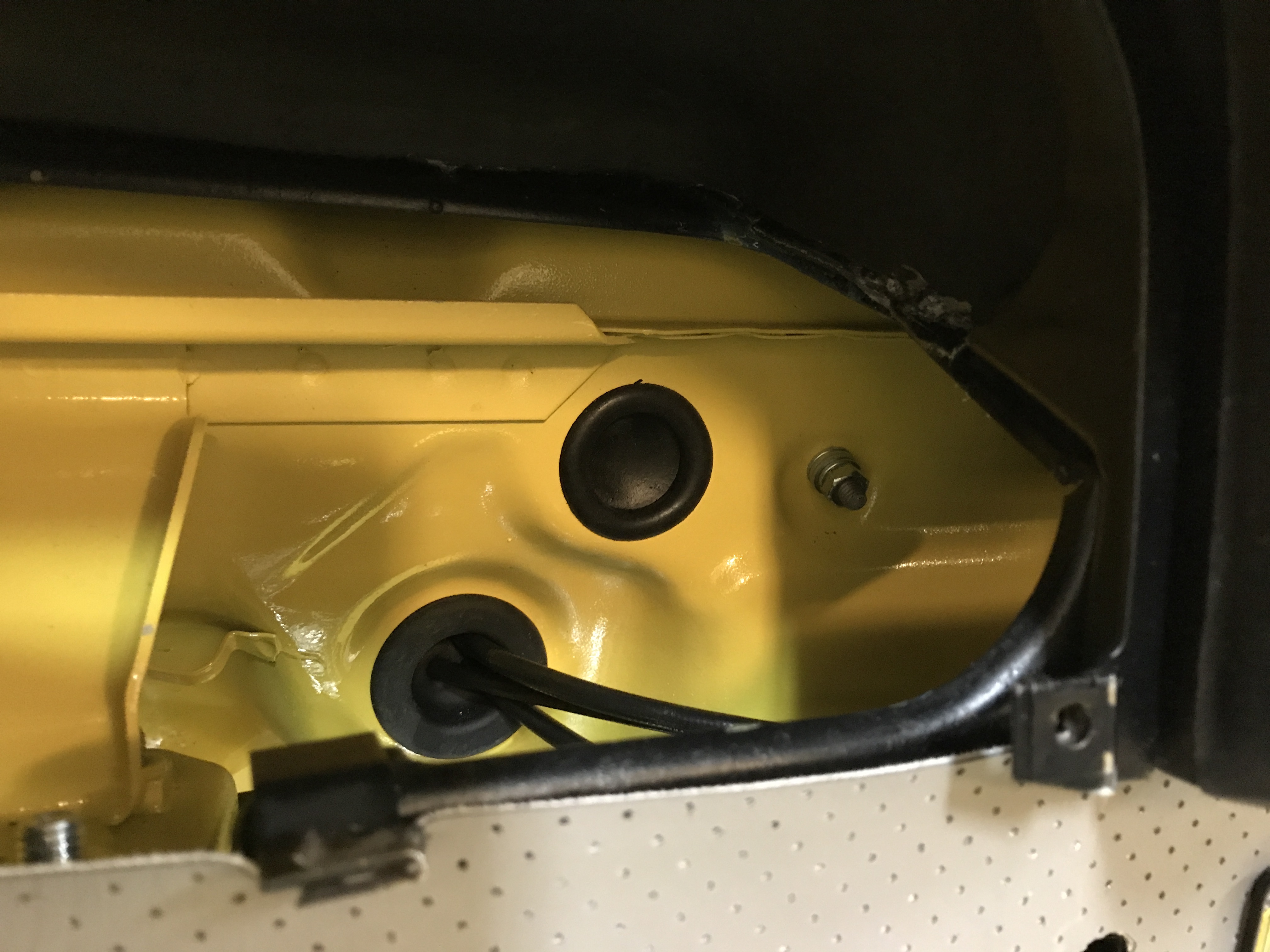

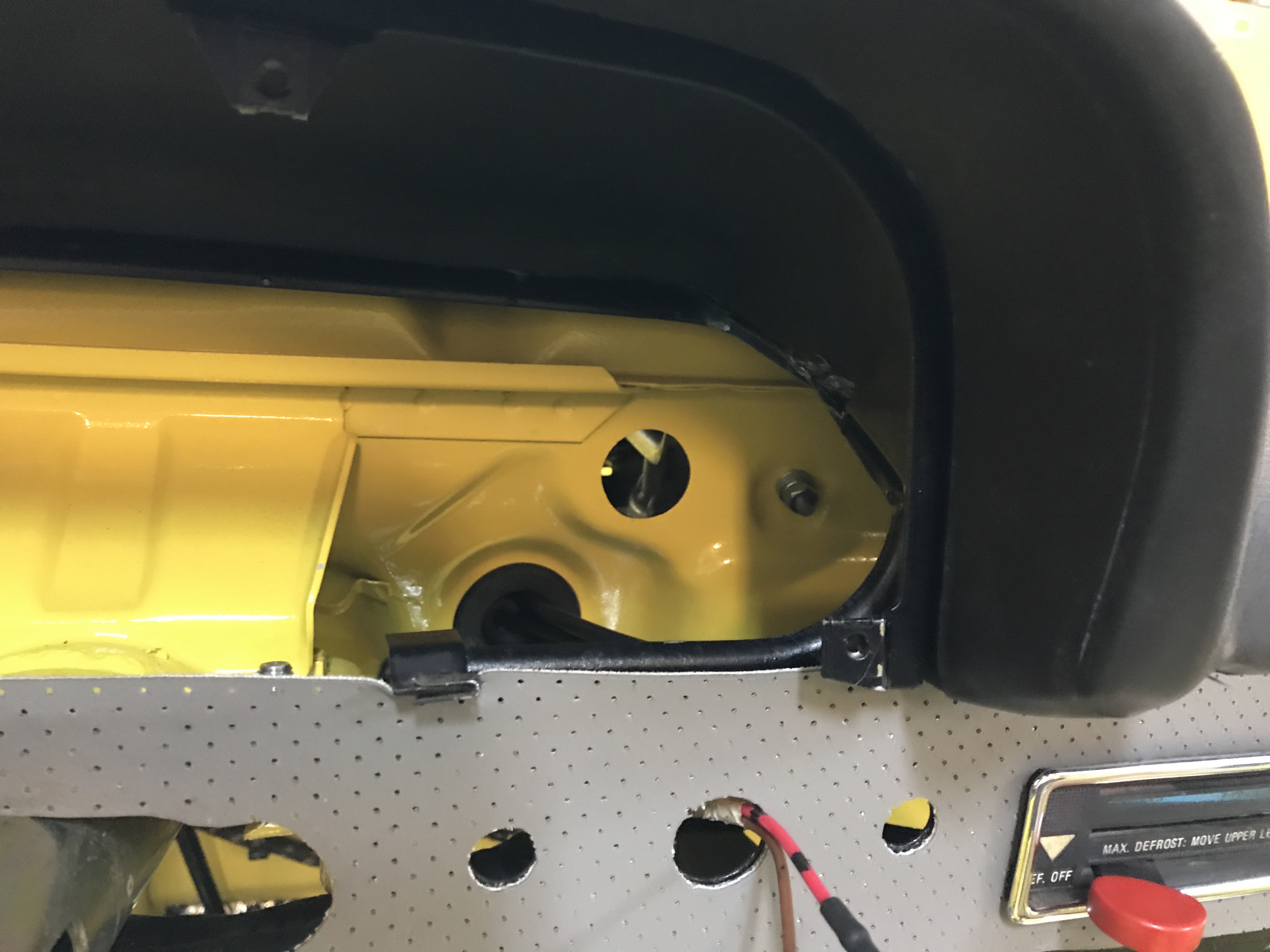

Had some more deliveries, so caught up with a few things.
Here's a 30mm hole in the dash, that I think is where the original washer fluid lines passed through.
bkrantz
post Mar 24 2021, 07:16 PM
Post #2499
Posts: 8,531
Joined: 3-August 19
From: SW Colorado

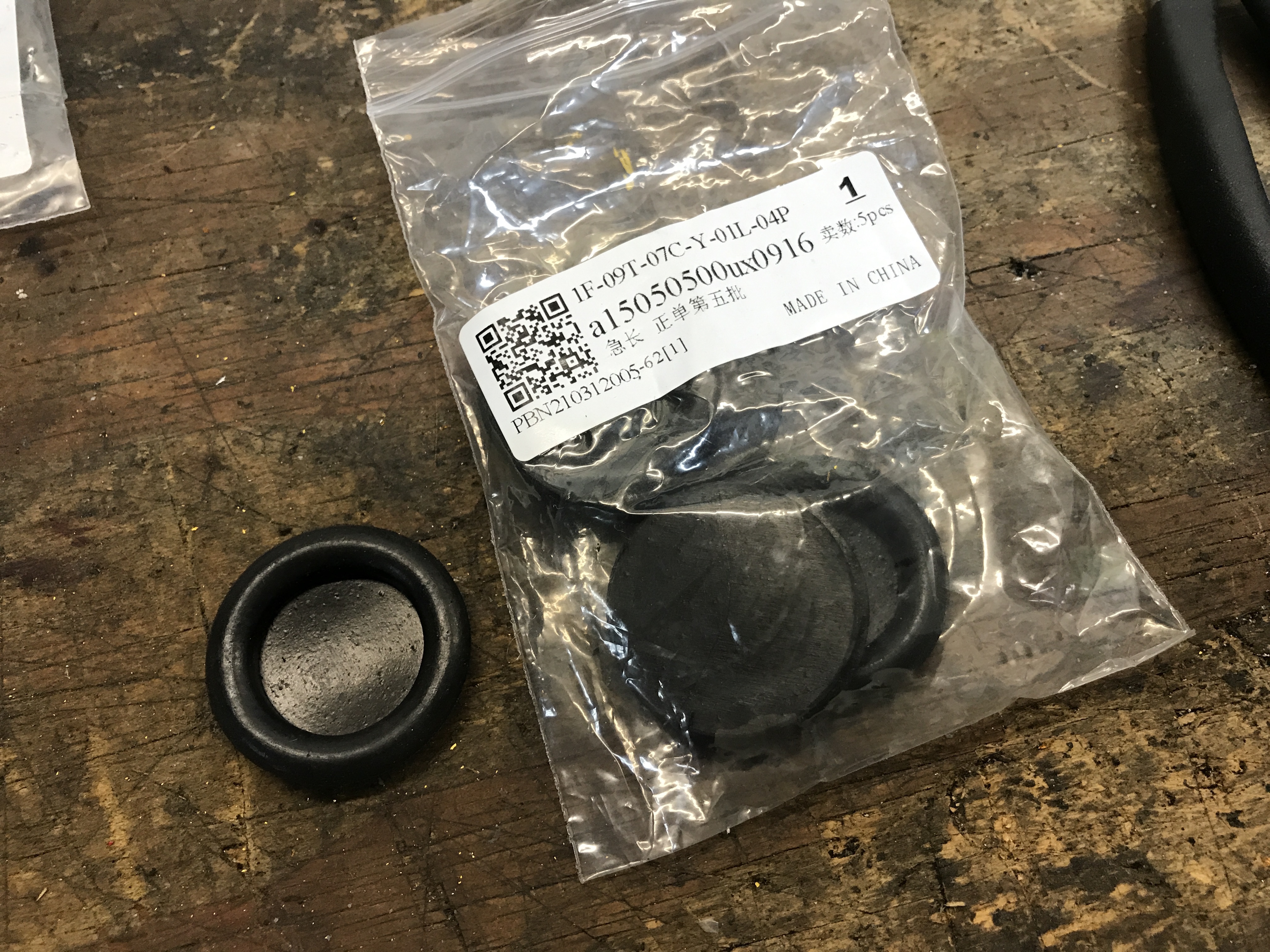

Member No.: 23,343
It took a couple of tries, but eventually I found some 30mm blanking grommets.
bkrantz
Post #2500
Posts: 8,531
Joined: 3-August 19
From: SW Colorado
Member No.: 23,343
Installed.
